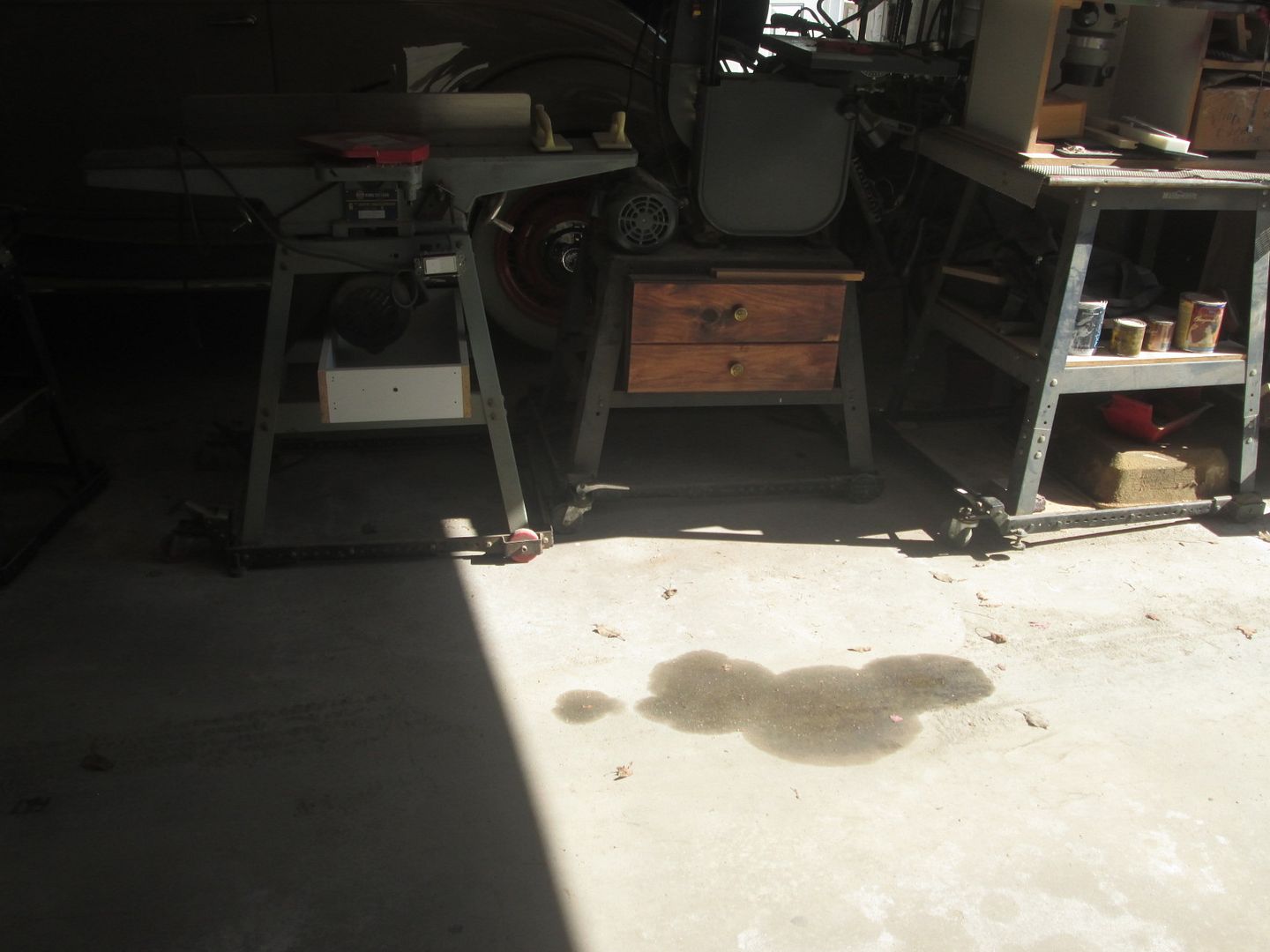

Spent part of a beautiful Sunday morning trying to find a hydraulic leak. It drips in front of the rear right wheel. Tightened a few fittings. Don't think I found it.

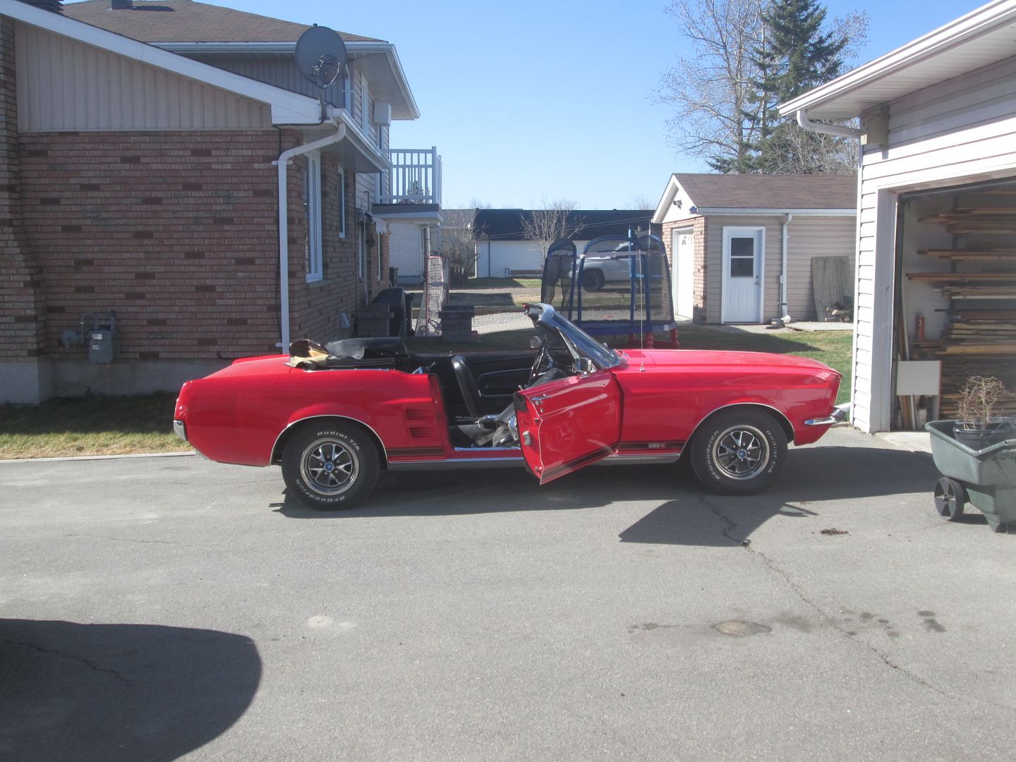

Gorgeous 'vert, have you made a model of it yet?

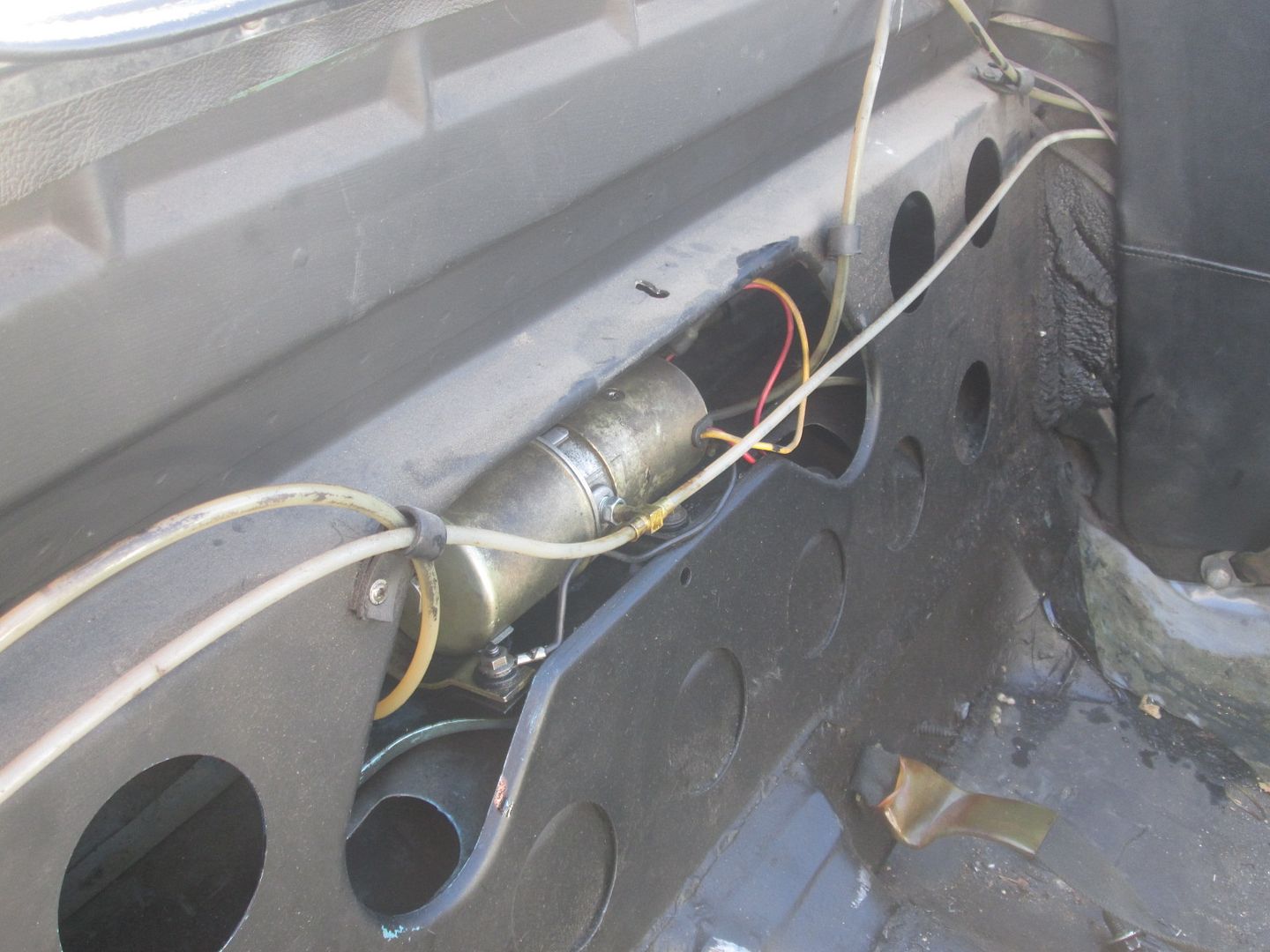

If I recall, is that cylinder on the sides or the center of the back seat? If it's in the center, it's right over the rear differential. Have you also checked that diff? They're notorious leakers. Follow the shiny oil trail. Run your hands along the entire system until you feel oily or wet areas. Look there when you find it.
Also, check those plastic hoses for contact areas that vibrate and rub against sharp metal areas. It may have started to rub through.
That is, of course, the hydraulic pump in the center of the rear panel in your photo.
There are, of course, two hydraulic cylinders on either side of the car.
The seals are well known to leak, and as already noted, the plastic lines can rub through over time.
Also as noted, wetness will be obvious at the source of the leak, but you need to have visual and physical access to every fitting, and the rods where they go in the cylinders.
Be very wary of over-tightening the fittings, too. It's easy to strip brass threads.

At first I suspected the right cylinder as the drip is on that side and It has been replaced. However there is no visible wtness in the bottom of the car underneath it and feeling around showed a very small weep at the upper fitting. The oil has gotten into the passenger side well under the seat and diluted the tar in the tar paper making a gooey mess. That tells me it isn't from the cylinder as oil doesn't flow uphill. I suspect the pump itself as there is wetness under it and it could go down behind the rear seat bulkhead and spread at the bottom finding its way to a drainhole in the rear "frame" in front of the rear wheel. I ran my hand up and down the lines and they are dry. Removing the pump for inspection is easier and I might do that before removing the top well and the trunk partition to see where it all goes.

the 67 is one of my favorite mustangs. you have a beautiful car.

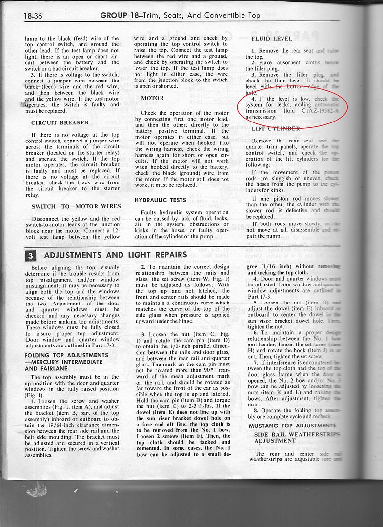

Ah yup....which means I should take the pump out, drain it & replace the seals. This may take while. Can the top be operated manually if disconnected from the cylinders?
Service manual says ATF C1AZ-19582-A, which I believe is Type F. I haven't had an early automatic Ford for a zillion years, so I don't know what has replaced Type F on the store shelves.
