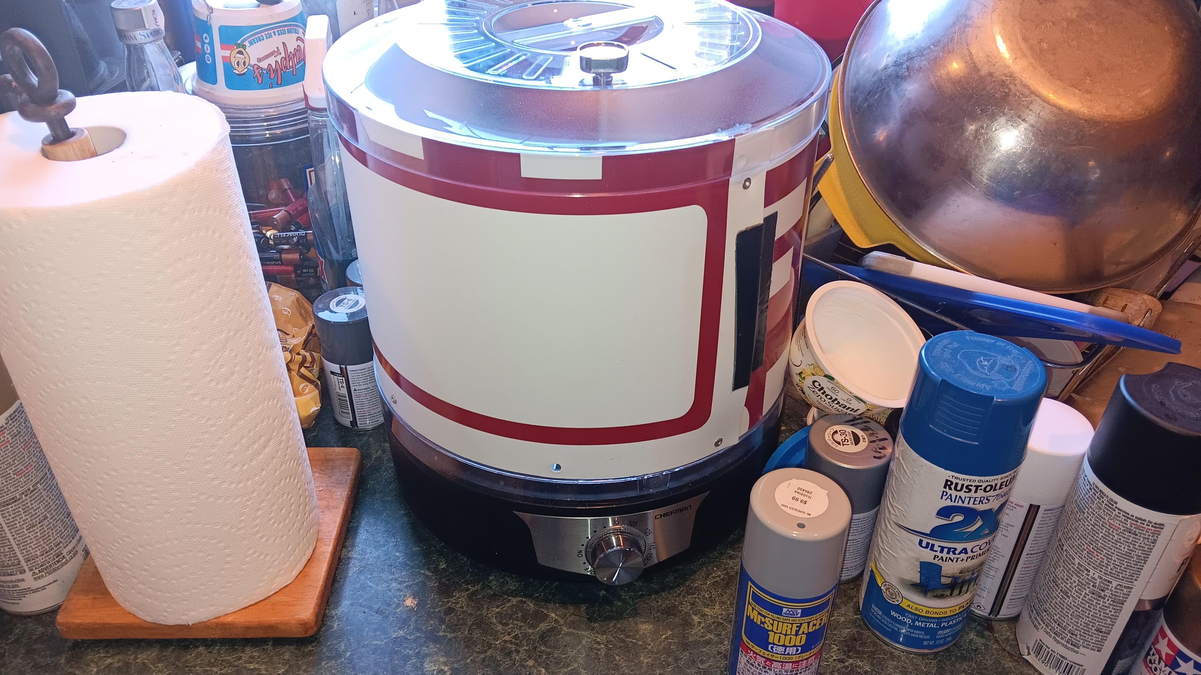

Mine took a dump on me a few years back. It is a Magic Chef, my brother found them at Walmart at the time. We did mine up first, got into the base and wired in a light switch type dimmer switch to control the heat. I just ran across the "schematic" I drew up for it back them. I know I can get a base on eBay.
My brother made his shallower than mine, he used a piece of plastic scrounged from work and is about 6" deep. Mine I used 10" chimney flashing, pop-riveted at the seam and to the bottom tray.

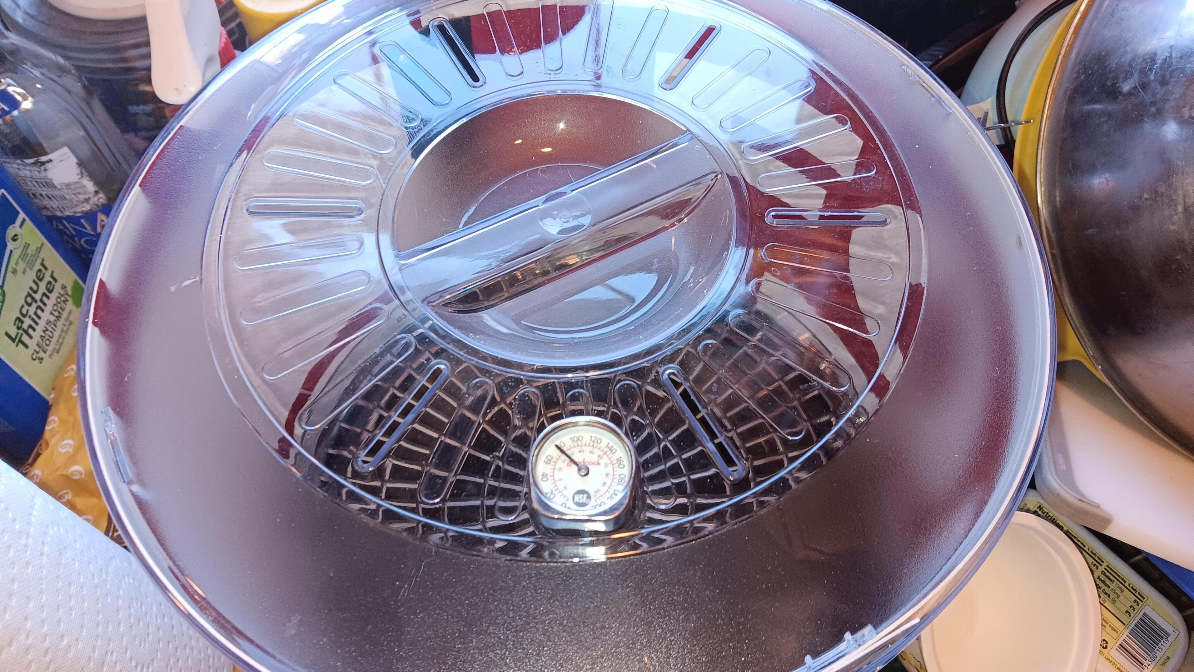

Lousy picture but you can see where I have the thermometer and the dimmer switch at the bottom left.

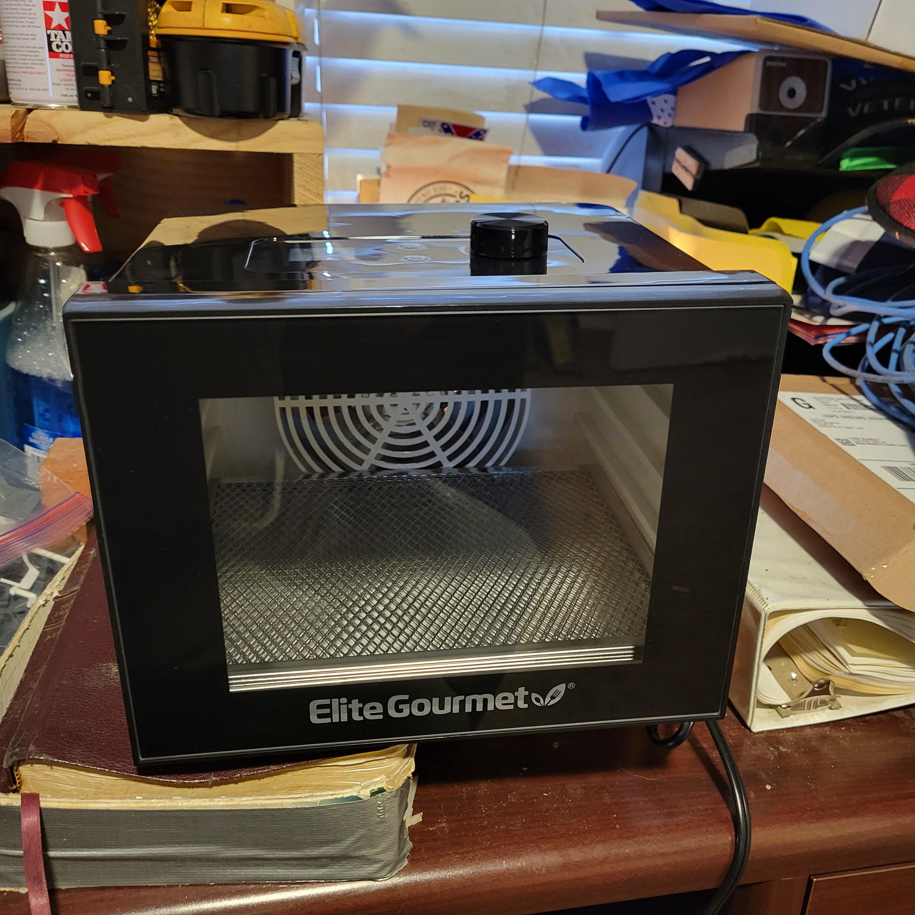

I justimage.thumb.jpeg.dc671999de968f70f622578d434c7dff.jpeg bought this one. Anybody use one before?
I have a similar one ,,works good,,I usually go 8hrs and 95-104 degrees
