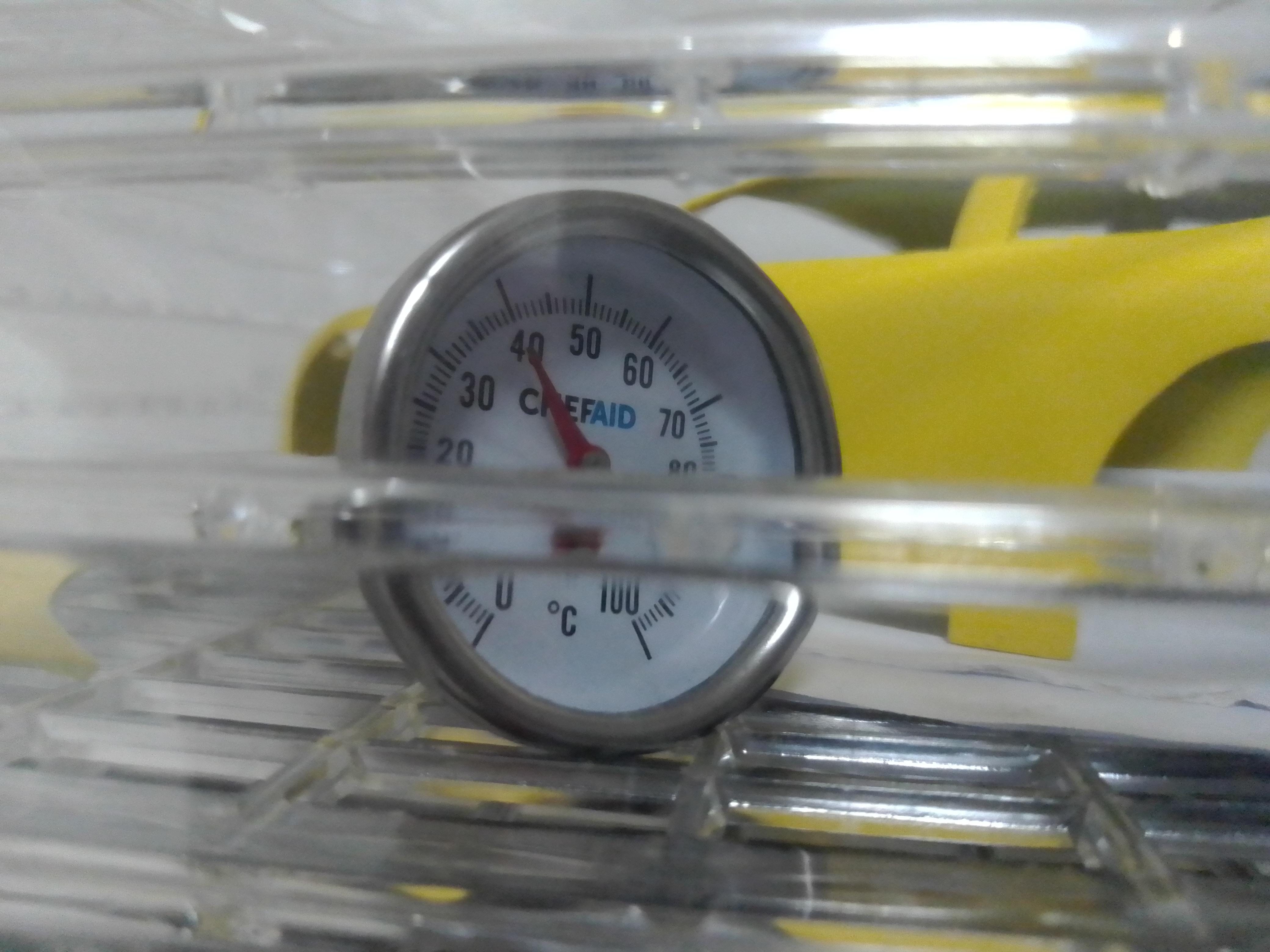

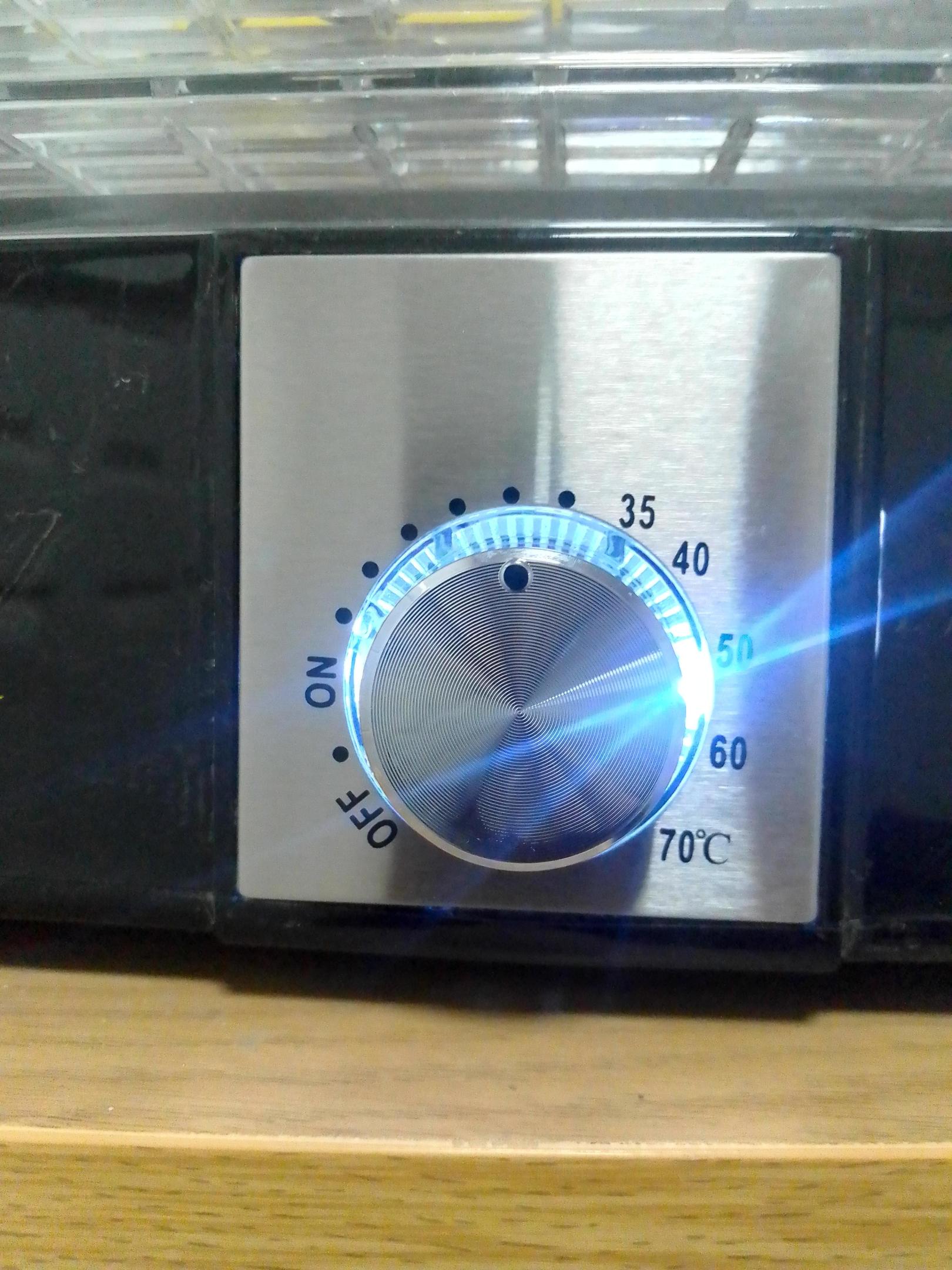

Likely old news, but for the new buyers of dehydrators, do an actual temp check of your new machine.
Perhaps the fan placement will decide on the heat produced?
Some pics of my unit and stated temp vs actual temp. Am in UK so Celcius is being used.
