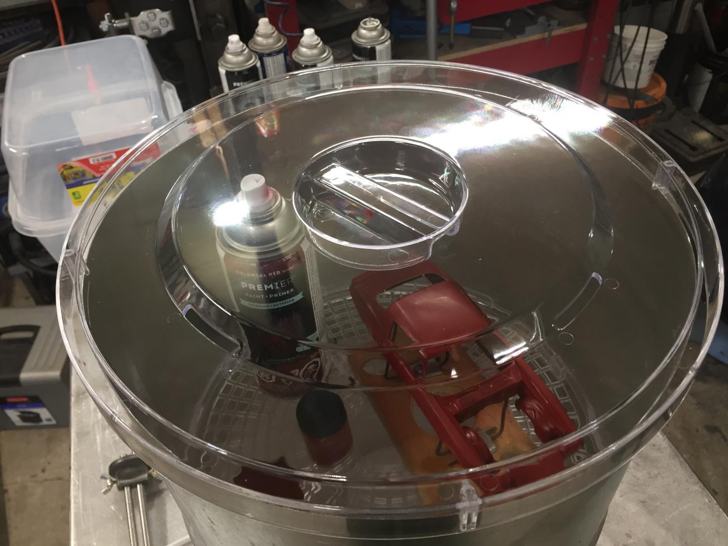

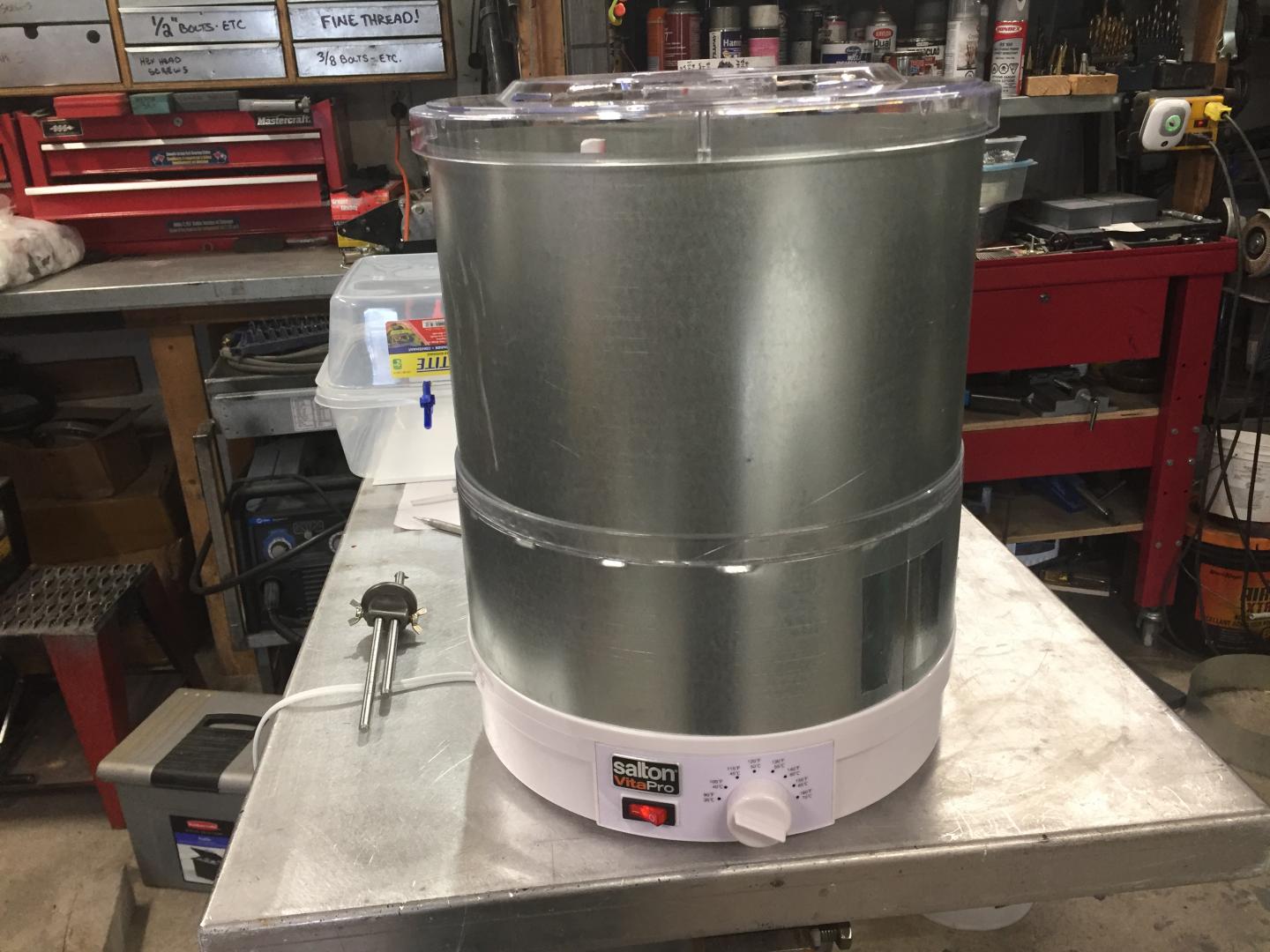

NOBLNG Posted January 11, 2019 Posted January 11, 2019 (edited) I bought this dehydrator last year because it was on sale for a good price. I finally got around to modifying it to work for drying paint. I didn't want to hollow out all the plastic trays, as I might want to use it for making Doggy Treats also. I made a 4" spacer from 26 gage metal to raise the tray up away from the heat a bit. Then a 6" spacer for the main compartment. Edit: I changed the upper section to 8" tall. This way I can put a full size spray bomb in there to warm up. It is -30C here right now. I have 2 electric heaters going in the garage and they barely keep up! Edited January 18, 2019 by NOBLNG change pics

Rider Posted April 20, 2019 Posted April 20, 2019 On 2019-01-11 at 4:45 PM, NOBLNG said: I bought this dehydrator last year because it was on sale for a good price. I finally got around to modifying it to work for drying paint. I didn't want to hollow out all the plastic trays, as I might want to use it for making Doggy Treats also. I made a 4" spacer from 26 gage metal to raise the tray up away from the heat a bit. Then a 6" spacer for the main compartment. Edit: I changed the upper section to 8" tall. This way I can put a full size spray bomb in there to warm up. It is -30C here right now. I have 2 electric heaters going in the garage and they barely keep up! Cool set up. What temp do you set when using it in the summer and how accurate is the setting?
NOBLNG Posted April 21, 2019 Posted April 21, 2019 5 hours ago, Rider said: Cool set up. What temp do you set when using it in the summer and how accurate is the setting? I have read on here that 105F is OK and will not damage styrene, so I set it at either 95 to warm the paint or 105 to dry it. I have never checked it for accuracy, but have not melted anything yet.
