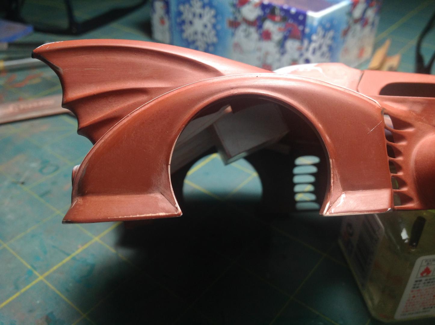

Picture:1
After taking a closer look at the pictures I noticed the front left side area lip/ridge was way too far out of alignment in comparison to the right side. This had to be fixed.

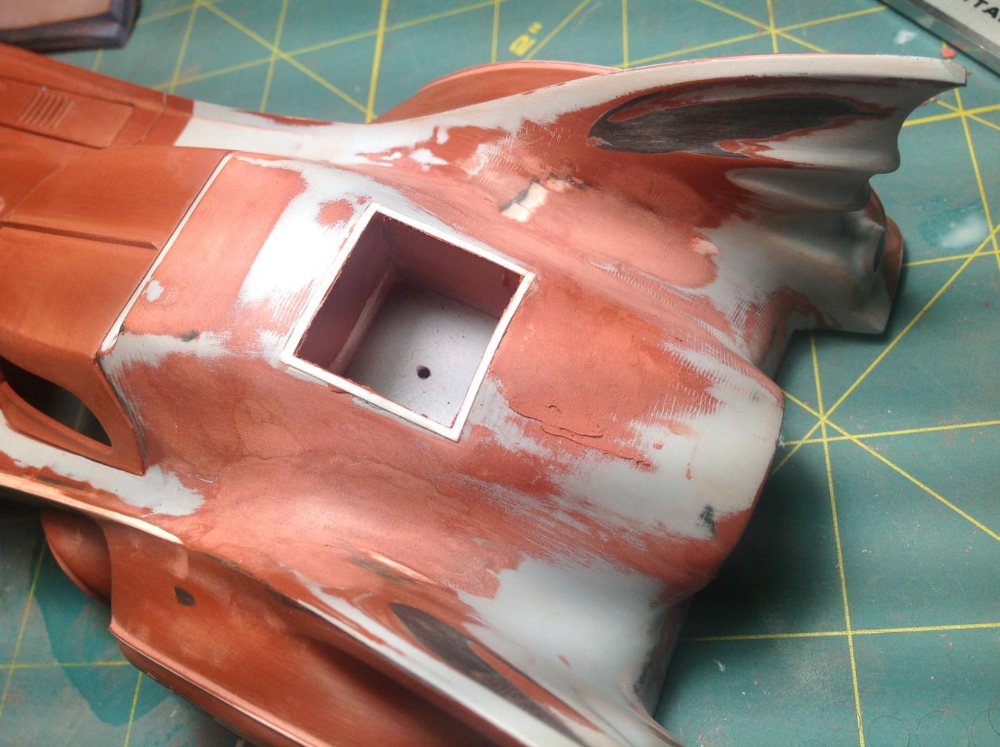

Picutre:2
The replaced part, much  better. I also started shaping and filling the right side lip/ridge.

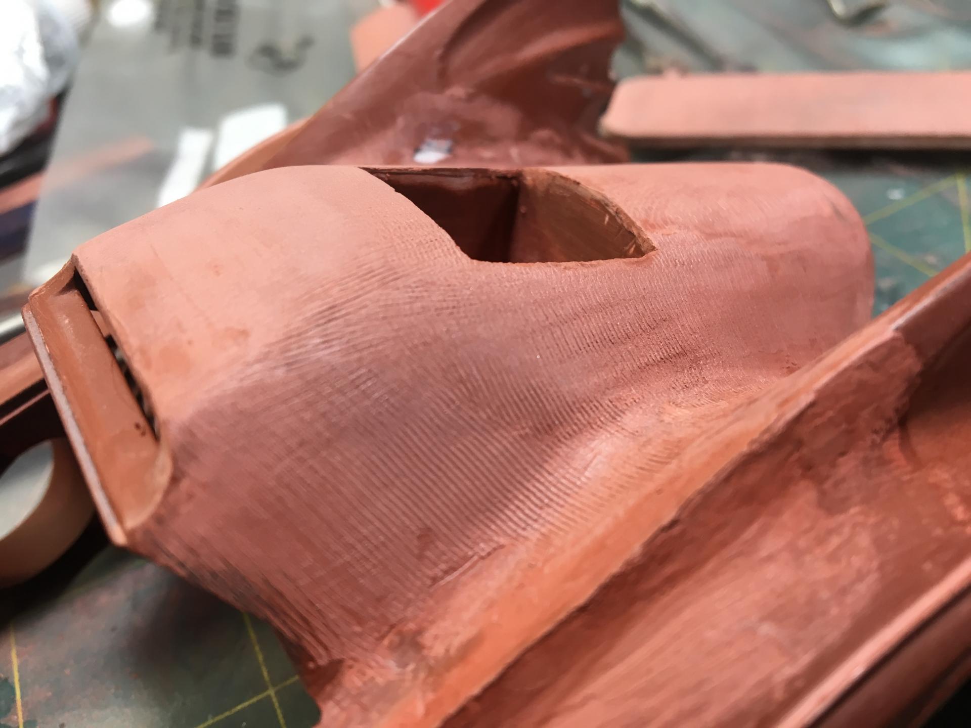

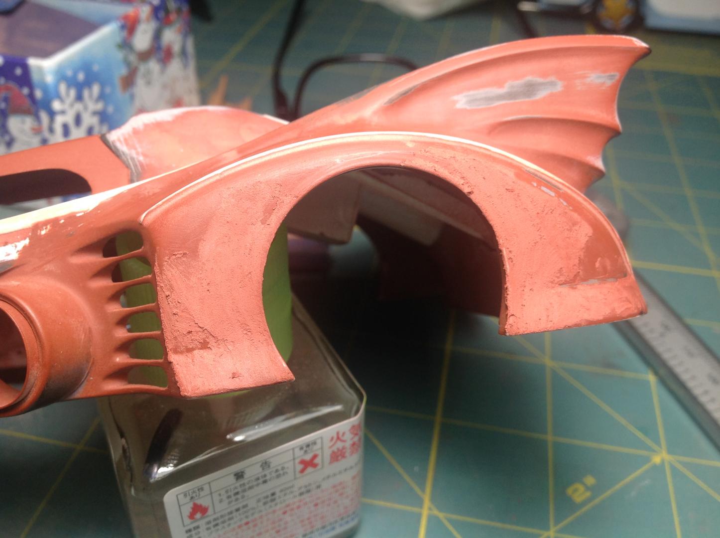

The slow arduous process of filling/sanding/shaping has begun. I managed to session tonight. Third coat is on in the photos.
I really enjoy this part, I find it super ralxing and highly focused, sometime too focused. On past projects I have completely forgot about the other end of a sanding pad or stick even a blade and done some real damage. Fortunately nothing like that happened this round.

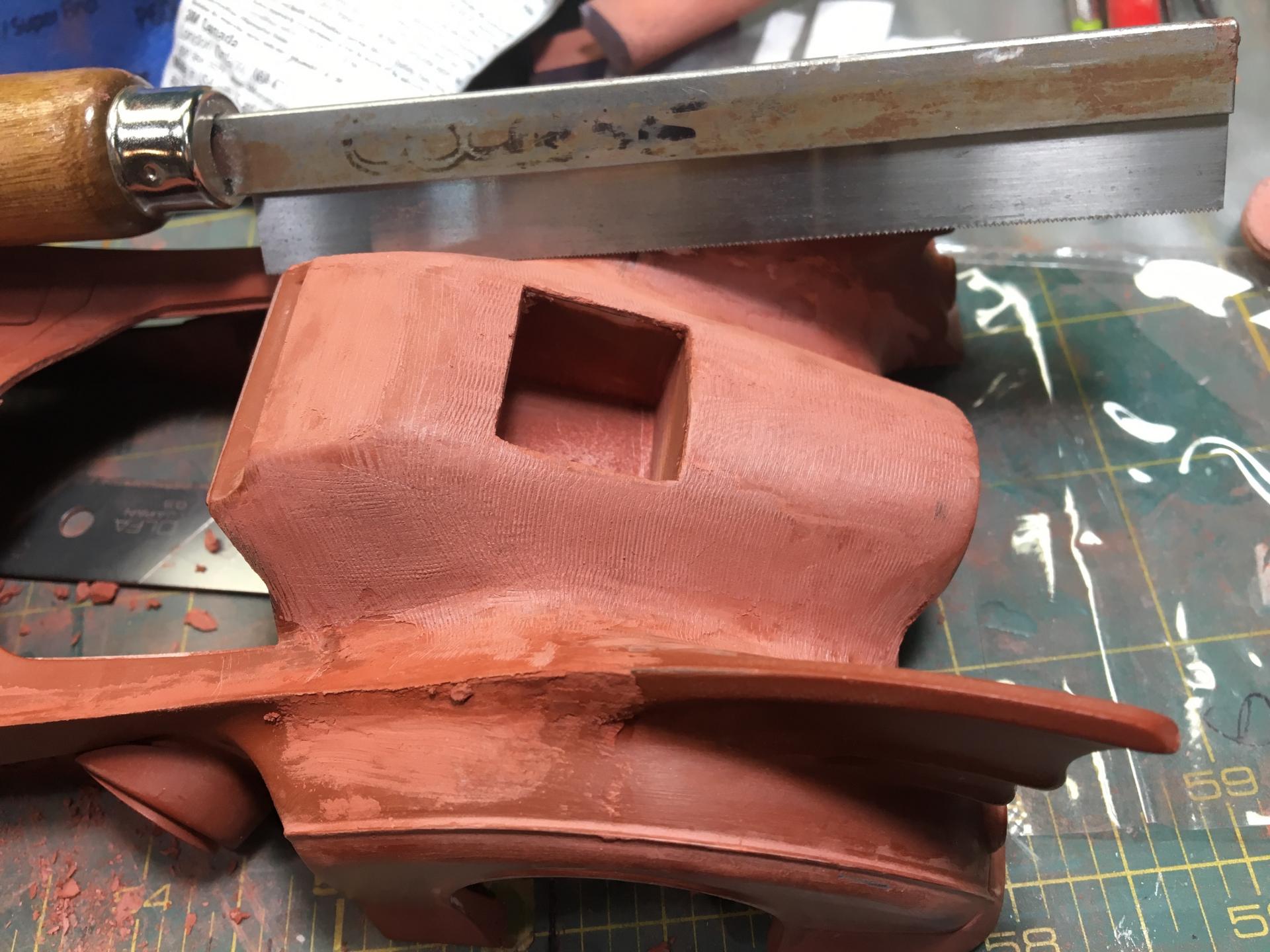

Shaping/sanding and filling today.
I like to  use the saw blade as a tool to knock down the rough filler, much like "the cheese grader" is used in the real world of auto body work. With it's fine teeth and it's straight edge it provides a much better starting point when dragged perpendicular in the normal direction of use. The the saw teeth really knock down the filler  providing a much straighter/flatter starting point, less  dips and peaks to deal with when sanding.

Wow! Surprisingly smooth!
I know, that sounds like an ad for tobacco or whisky or something. :D
Seriously though. Given the roughness of the surface in the first photo the second one is surprisingly smooth. Did you use a glazing compound or is that the result of sanding work?
David G.
Thanks guys.
David, it's all 3M glazing putty. Then shaped/scraped down with the saw, then sanded with 320,500 grit. I then  sprayed it with Dulpicolor polyester filler primer. This stuff is incredible, when used properly it saves a ton of time with glaze filling and sanding.

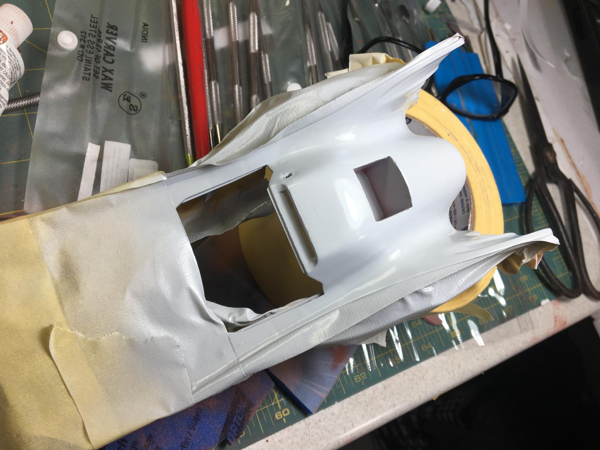

Thanks Dann. I'm excited to start the paint. The masking is going to be very labour intensive.

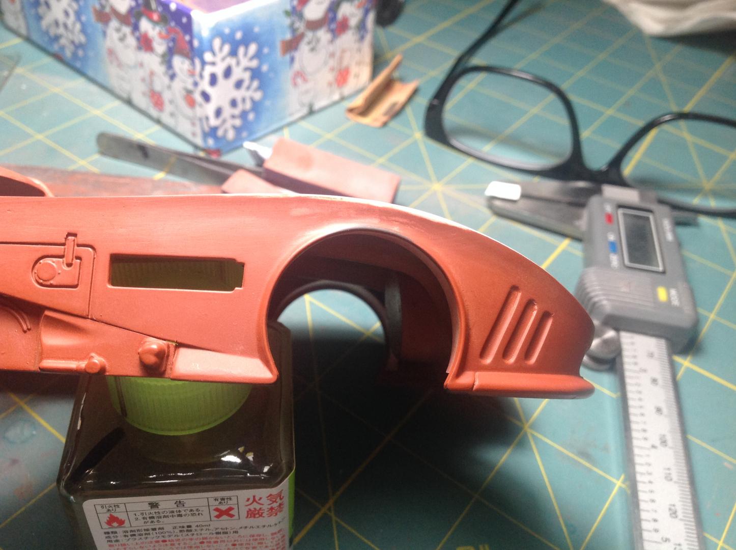

Small up date, lots of filler and shaping going on, and left to complete before paint.
The last pic is what I am attempting to replicate with the rear fender flares.
