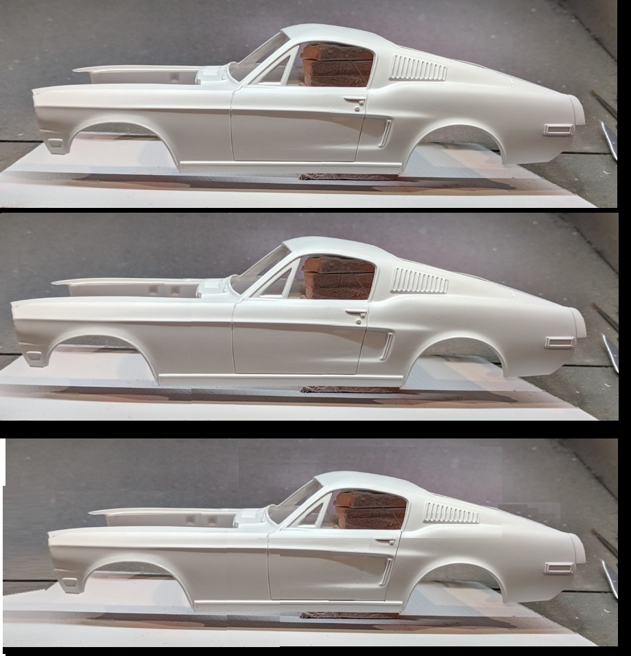

Hoffman Posted October 2, 2018 Posted October 2, 2018 Interesting concept. I remember seeing the shortened earlier Mustang. The top looks similar to a '67 Charger. On your version, by shortening the are you did, the proportions remind me of a Ferrari GTO, at least from the A pillar back. If you lengthened the front of the body, behind the front wheel opening, it would look like the picture below. What do you think?
Hoffman Posted October 2, 2018 Posted October 2, 2018 Of course, if the top were lowered slightly, and the door moved back, it would look even more like a GTO....
Hoffman Posted October 2, 2018 Posted October 2, 2018 Or, so as not to offend, a Cobra Daytona Coupe?
Rider Posted October 2, 2018 Posted October 2, 2018 3 hours ago, Hoffman said: Of course, if the top were lowered slightly, and the door moved back, it would look even more like a GTO.... The last pic looks real cool.
Ralph Henderson Posted October 3, 2018 Posted October 3, 2018 This is a great start to an interesting concept, and all of Hoffman's ideas also got me cooking up a little somethin'... now where did I leave that AWB 66 Must.....
Harpo Posted October 4, 2018 Author Posted October 4, 2018 (edited) Great mods, Tim! The long hood is a great look, but needs a flatter roof to go with it imo. Got a bit more done today: The easiest place to shorten the interior tub was right behind the seats: The locating pins make getting it right rather easy. Reinforced with styrene strips: Chassis gets the same treatment, in a slightly different location: Chassis cut, then trued up with a 3m sanding block: Kit also has locating pins between tub and chassis, so this fit is also pretty simple, just a matter of careful sanding. Here's tub and chassis in the body, fits good! Edited October 4, 2018 by Harpo
Alan Barton Posted October 4, 2018 Posted October 4, 2018 I'm no Photoshop guy, but looking at the side views, maybe flattening out the top of the door window opening would add a bit of sleekness (is that a word?) to your design. You clinical surgery on the section job is sensational - you have certainly raised the bar as far as that goes! Cheers Alan
Sledsel Posted October 4, 2018 Posted October 4, 2018 8 minutes ago, alan barton said: I'm no Photoshop guy, but looking at the side views, maybe flattening out the top of the door window opening would add a bit of sleekness (is that a word?) to your design. You clinical surgery on the section job is sensational - you have certainly raised the bar as far as that goes! Cheers Alan Calipers, dial indicator.... WOW... I eyeball and cut! LOL I agree, the slice job is fantastic, but the roof looks like a bubble and would look better flattened a bit (IMO). Then again, I have questioned others that in the end just came together, so I will stay tuned.
MrObsessive Posted October 4, 2018 Posted October 4, 2018 You're a braver man than I........cutting the body totally in two! Just the same, a very clean job and there's just a teeny suggestion I'd make-------I'd make the doors a bit longer, and lessen the distance between the trailing edge of the doors, and the leading edge of the rear wheelwells. That's just me though as I like 'sports cars' like this to have the rear wheels as close to the doors as possible. Think Corvette.
Snake45 Posted October 4, 2018 Posted October 4, 2018 9 hours ago, MrObsessive said: You're a braver man than I........cutting the body totally in two! Just the same, a very clean job and there's just a teeny suggestion I'd make-------I'd make the doors a bit longer, and lessen the distance between the trailing edge of the doors, and the leading edge of the rear wheelwells. That's just me though as I like 'sports cars' like this to have the rear wheels as close to the doors as possible. Think Corvette. I think MrObsessive is on to something here. If it were mine at this point, I'd move the door line back to just ahead of the rear fender "hump." Then I'd lengthen the side windows a like amount, which I think would also be an improvement. This would mean losing the fake vents on the C-pillars, but that might be a good thing too. Maybe someone can do a photoshop of this so we can see if I'm crazy. Of course, it's YOUR model, not mine, and YOU are the only one who has to be satisfied with the result, so, drive on!
Harpo Posted October 4, 2018 Author Posted October 4, 2018 40 minutes ago, Snake45 said: I think MrObsessive is on to something here. If it were mine at this point, I'd move the door line back to just ahead of the rear fender "hump." Then I'd lengthen the side windows a like amount, which I think would also be an improvement. This would mean losing the fake vents on the C-pillars, but that might be a good thing too. Maybe someone can do a photoshop of this so we can see if I'm crazy. Of course, it's YOUR model, not mine, and YOU are the only one who has to be satisfied with the result, so, drive on! These are some great ideas, but major mods are something I've never done before. This build and the one prior (Pirhana LSR) are my first efforts in learning to "think it/build it". I may yet change the roof line on this one, but my goal here is to learn and hopefully get a little better with each build.

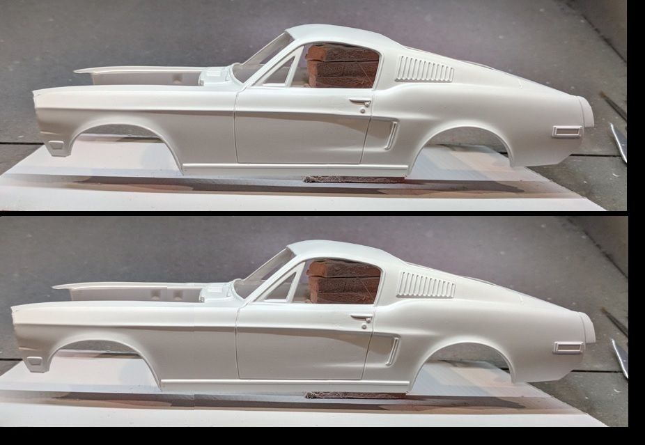

Harpo Posted October 5, 2018 Author Posted October 5, 2018 (edited) Top revisited... On careful examination, it's a bit too "peaked". Wanting to ease this without a major rework, here's what I did: Knowing things might get a bit thin, a strip of styrene is glued over the seam on the inside: Aggressive application of the sanding block (150 grit), followed by 320 and 400 gives a smoother profile: The difference is subtle in profile, but perceptible: Before: After: It's much more noticeable in reflected light, and this should give a big improvement when the final gloss is on: Before: After: My dad owned a body shop when I was young and all our family cars were rebuilt from totals, so I'm no stranger to getting contours correct. But doing body work on a car 1/25 the normal size is challenging, I think I need scale tools! Edited October 5, 2018 by Harpo
