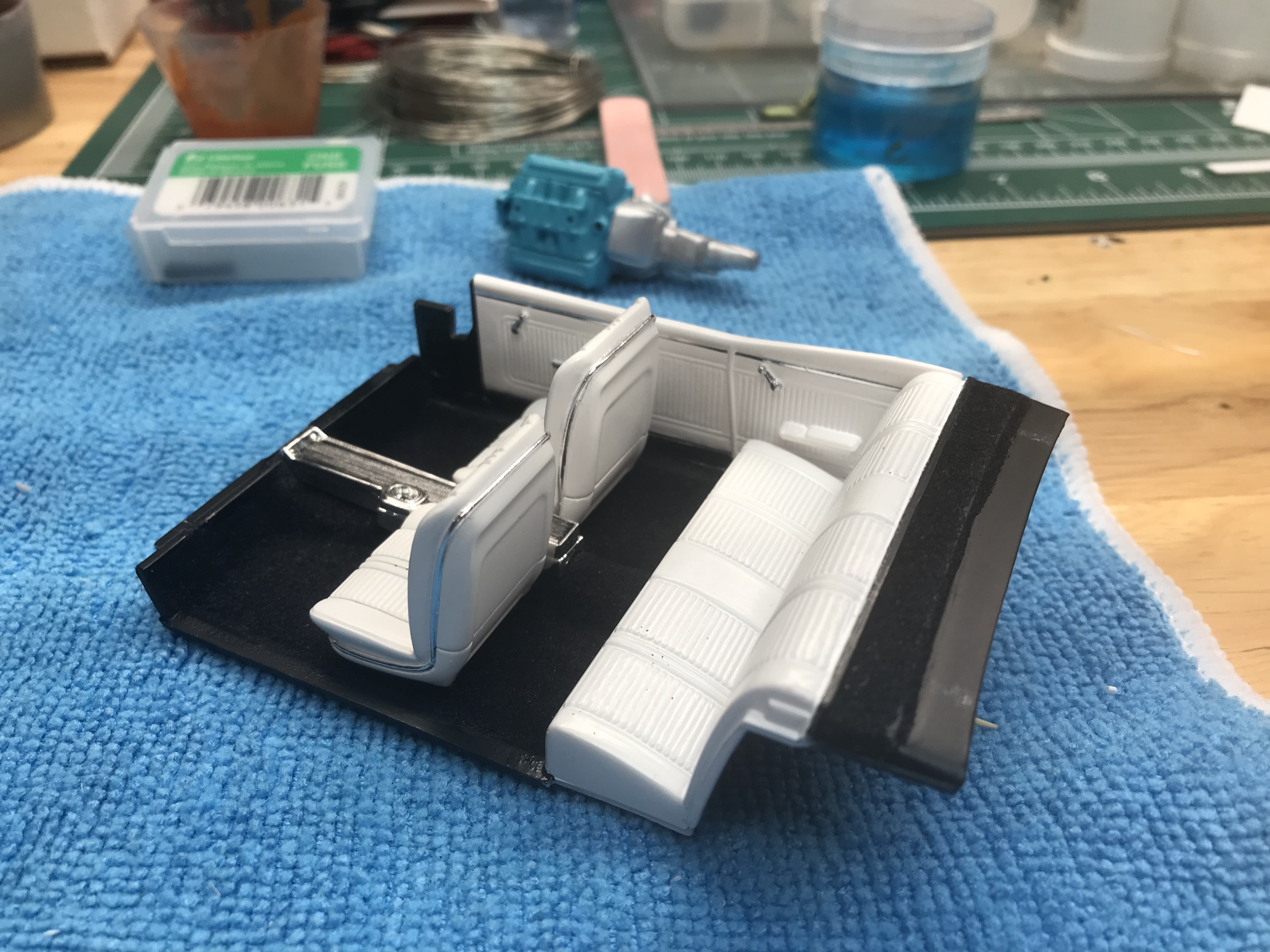

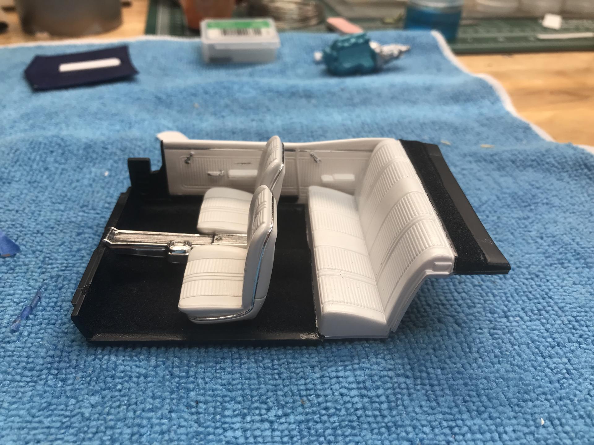

Got a little work done on the interior with some paint on the seats and door panels but I still need to detail the the window cranks and handles plus the trim on the front seats plus I used embossing powder for the carpet and I also have the engine block painted and the transmission painted . I have also started detailing the dash which I have cut aluminum tubing for the gauge bezels but I still need to get more aluminum tubing for the two gauges in the middle.
I like the Tri-Power setup, was that in the kit ? The dash is going to look great when you're finished. Are you going to have a Consul or just the shifter on the floor ?
David the tri power  carbs came with the kit but I'm on the hunt for a better tri power set up since they are not that detailed and yes I will be installing the the kit supplied center console that is factory to the GTO.

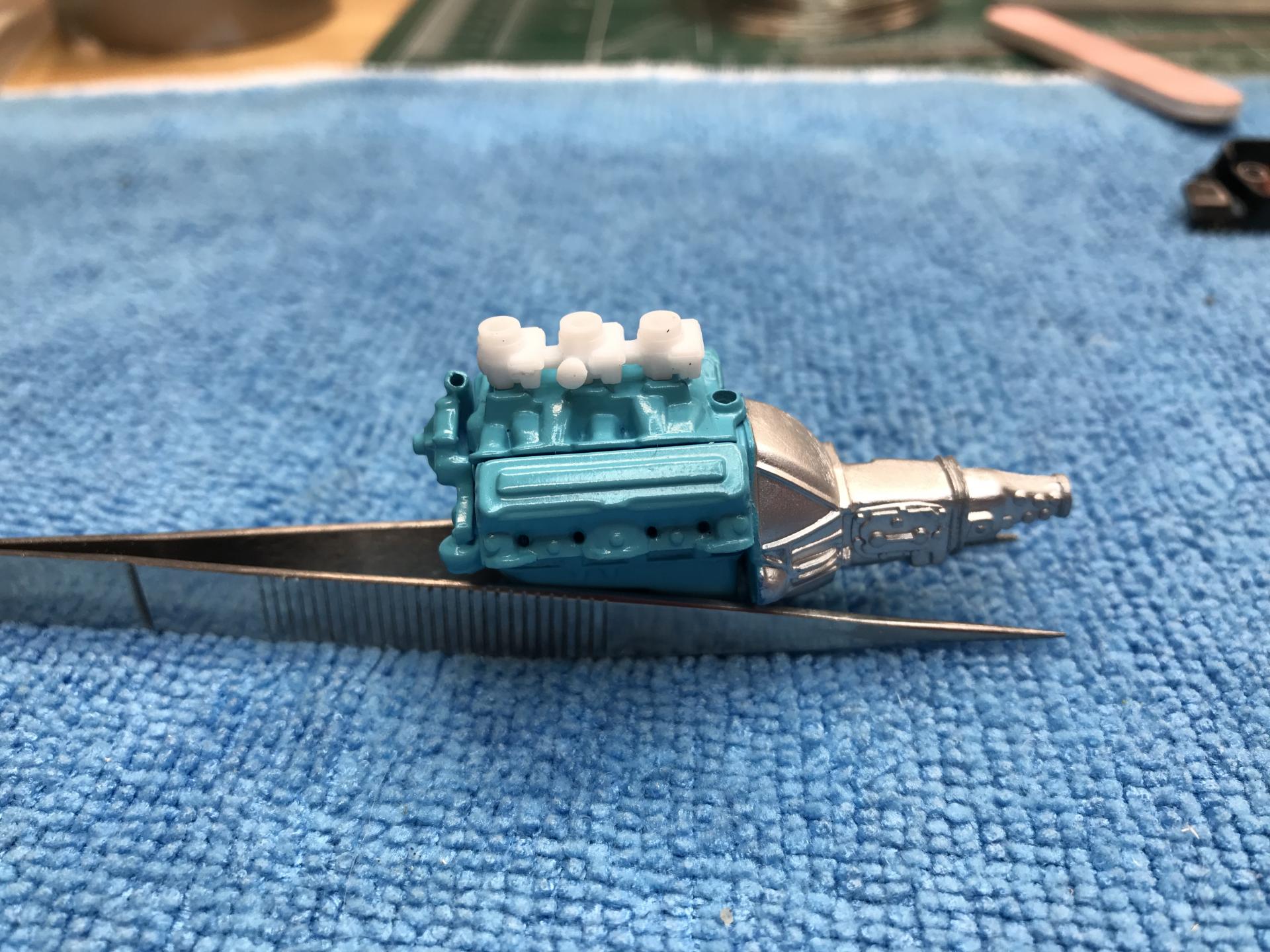

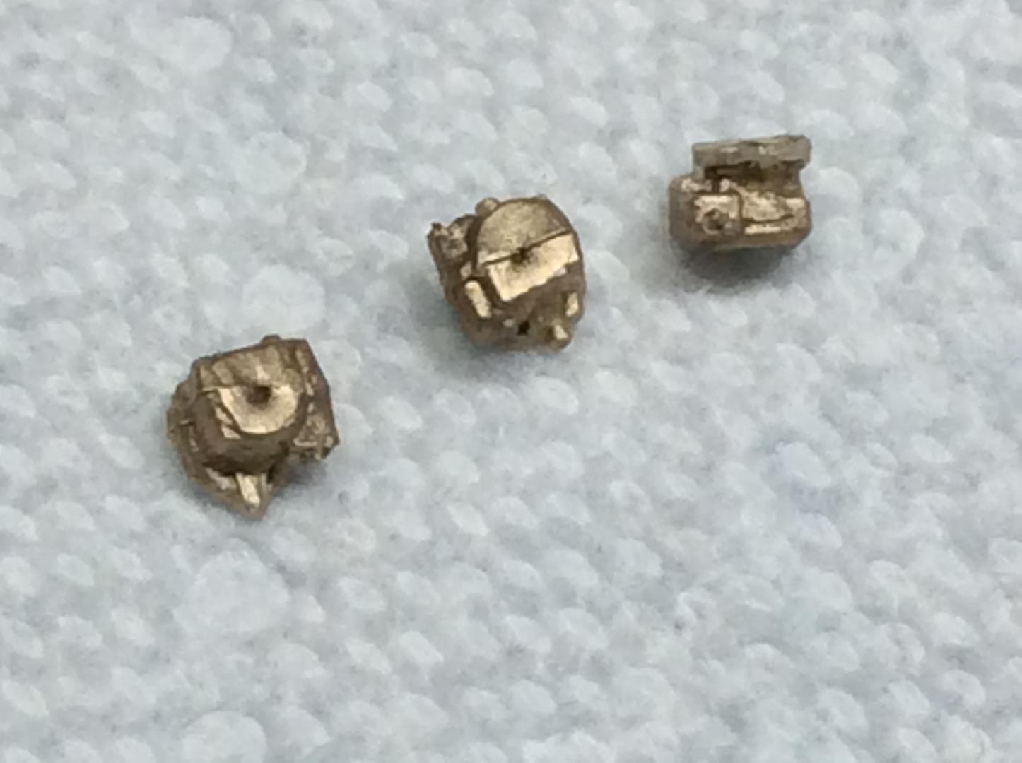

Seth, the white plastic tri-power carb set in your photoshould look fine once you cut them apart, although it looks like the throttle plate section of the carbs was cast onto the manifold rather than the bottom of the carbs.
The '66 tri-power carbs were a little smaller than the '67 tri-power carbs, and once you get them detailed (not much to the 2BBl Rochesters) with fuel lines and throttle linkage, they will look fine.

Mike, the Tri-Power setup I used on the '58 Chevy was out of the '59 which is quite nice with some detailing added. The difference in the '59 is that there are internal filters (something I forgot about), but it looks to be similar to what GM offered throughout those years.
In my experience with Rochester 2BBl carbs, the main external difference (that would be noticeable in this scale) is where the fuel enters the carb top section...either the front or the passenger side, and the outer two carbs.
For the most part the fuel bowl section, throttle plate section would all look the same at this scale (IMHO) and the top section has minor differences, the main visible difference in this instance is that the outer carbs don't have the "air valve" commonly referred to as the choke plate.
Since the outer carbs aren't used during cold engine running (they are locked out of use by factory design) the only carb that will have a choke plate will be the center carb with the required choke spring and heat pipe plumbed to the intake manifold cross over runner.
Thank you all for he info on the carbs and it looks as though I probably will just add some detail to them the best I can plus as I mention at the beginning of this build thread I will also attempt to scratch build the ram air for the carbs.
5c0f23fde8535_ScreenShot2018-11-11at7_35_49PM.png.445c399abf39a802d81b888fee3fe3d9.png
If it hasn't been mentioned. Your Tri Power carbs are on backwards. Float bowls go forward. On the middle carb the carb choke coil faces the right side of engine.

Richie yes the float bowls do face the front & the picture I posted was just a mock up and also so everyone could see that the carbs are not that we'll detailed.

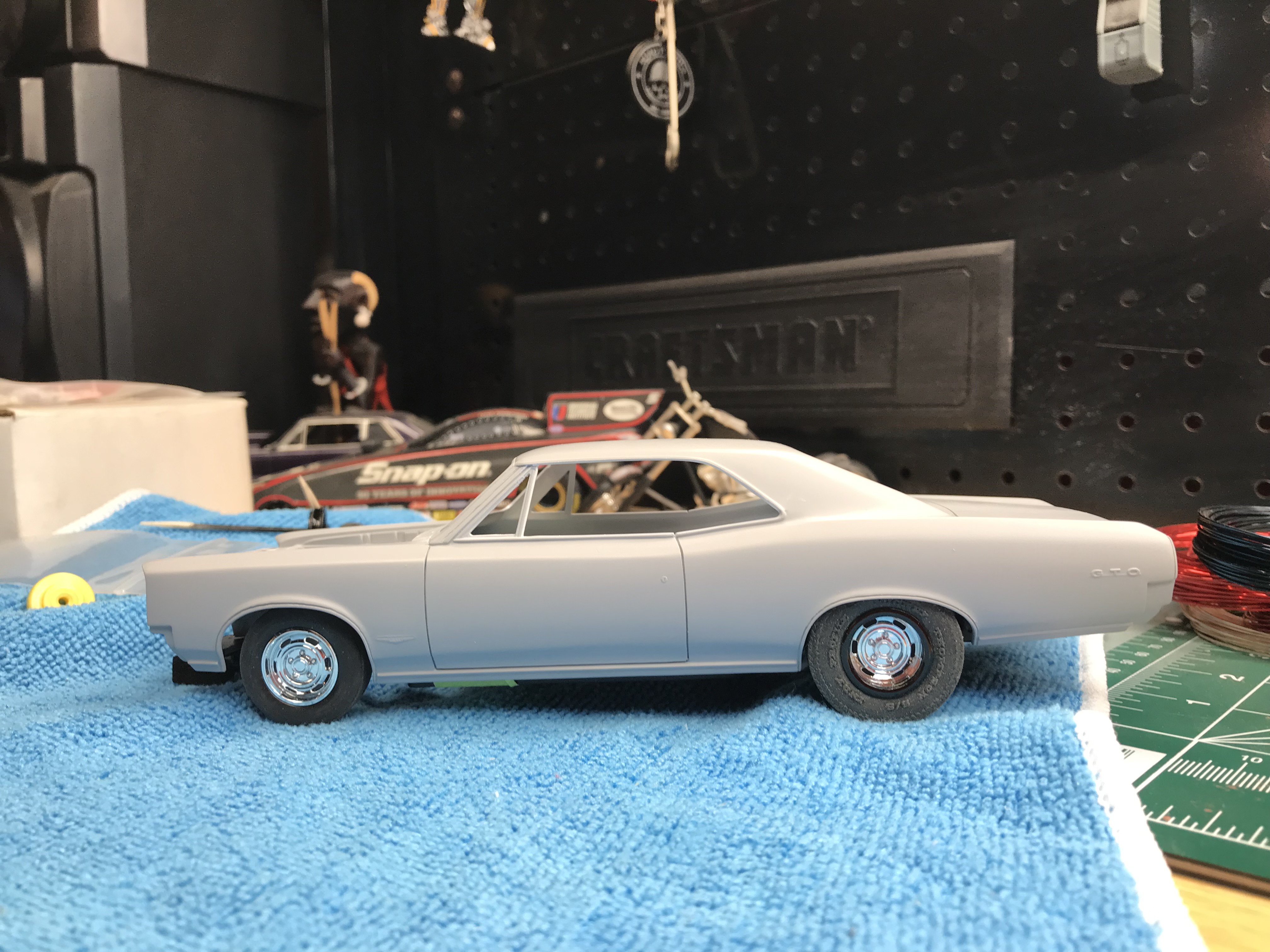

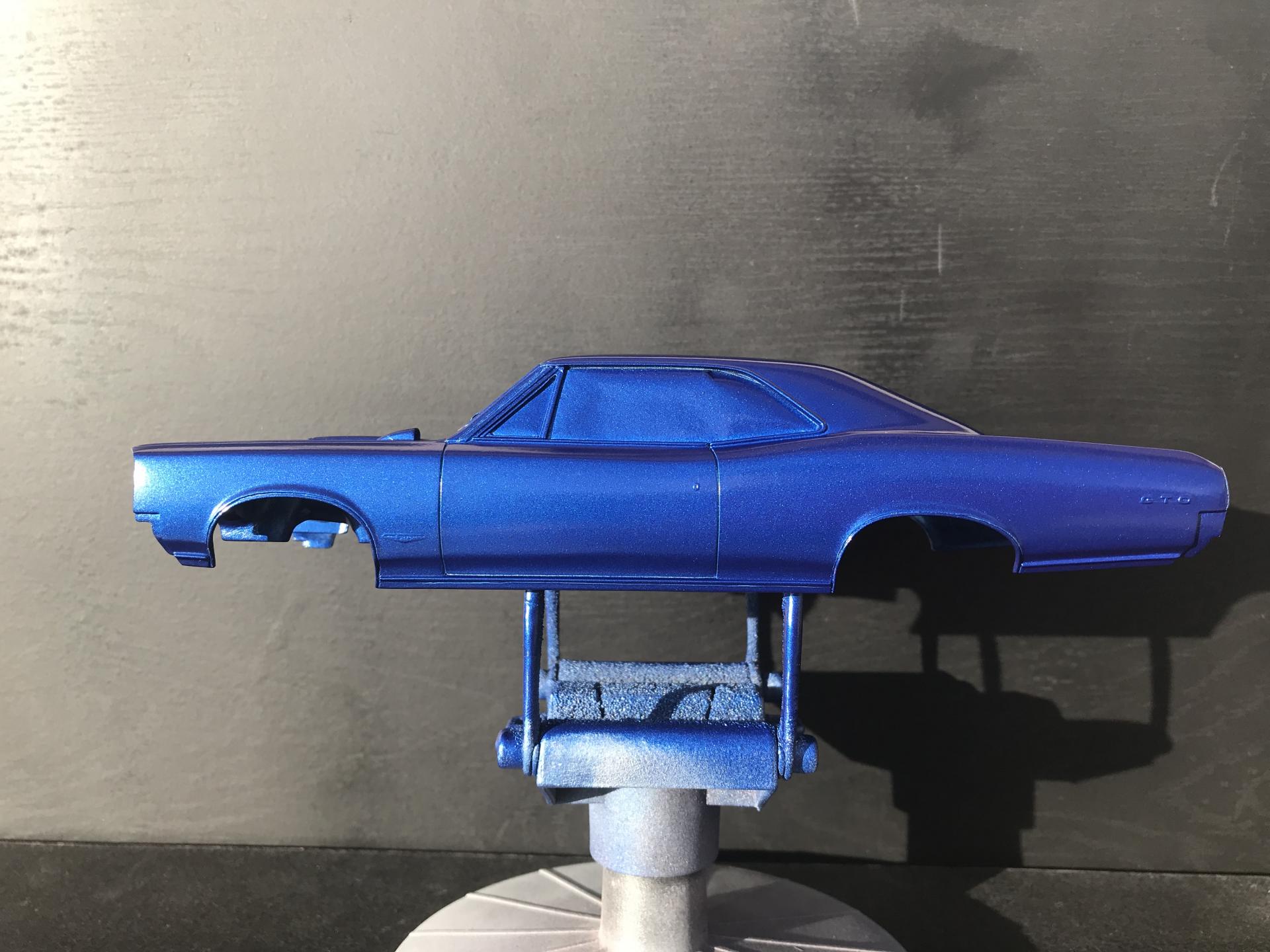

With the weather basically perfect today (70 degrees) I was able to shoot some Royal Blue Pearl on the GTO today which I'm not a real big fan of the color blue but it suits the GTO perfectly so after the paint gases out then I will shoot a few coats of clear on her.
That is looking VERY nice! You can find a reasonable replica of the Ram Air tub for the 65 and 66 GTO in the later 72 MPC original GTO kits. Don't know if I still have any left but I will look. I made Vac-U-Form repops of them as that made them much more to scale thickness on the shell.

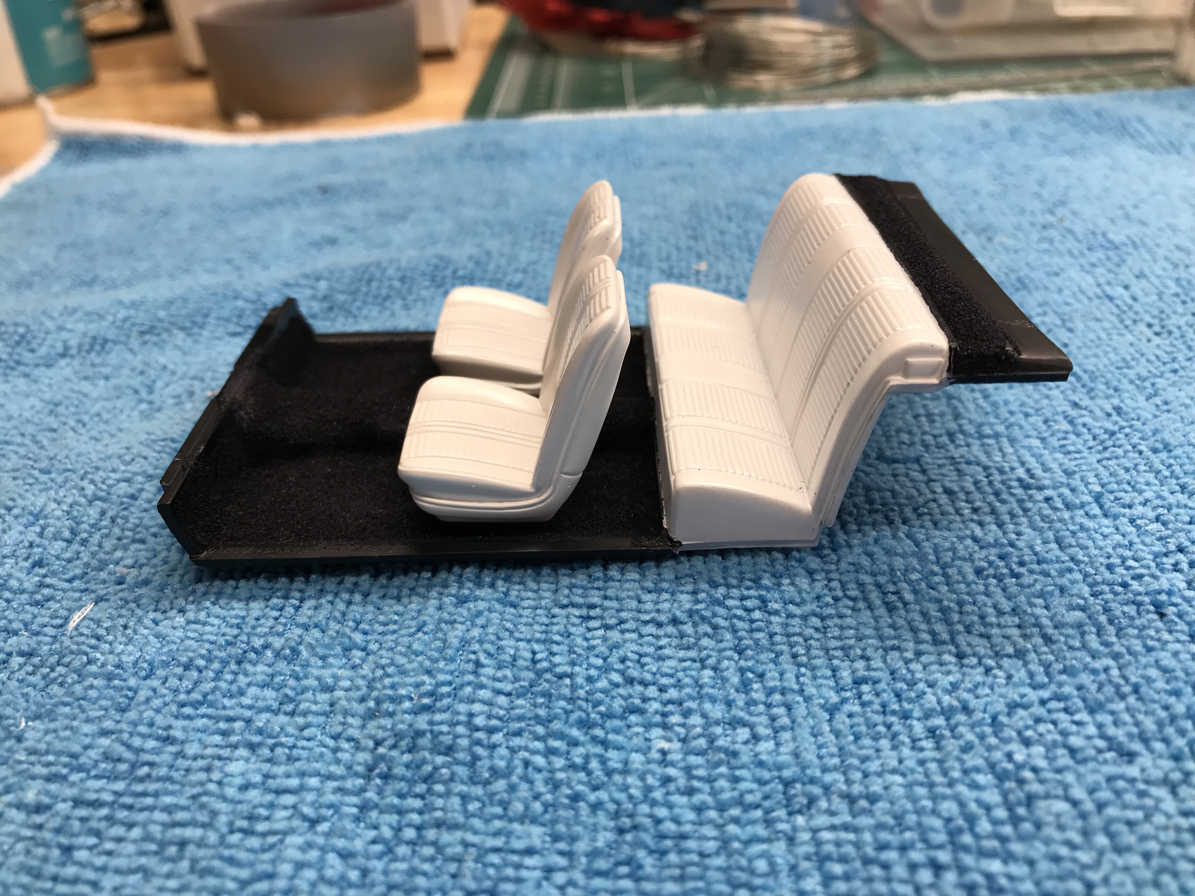

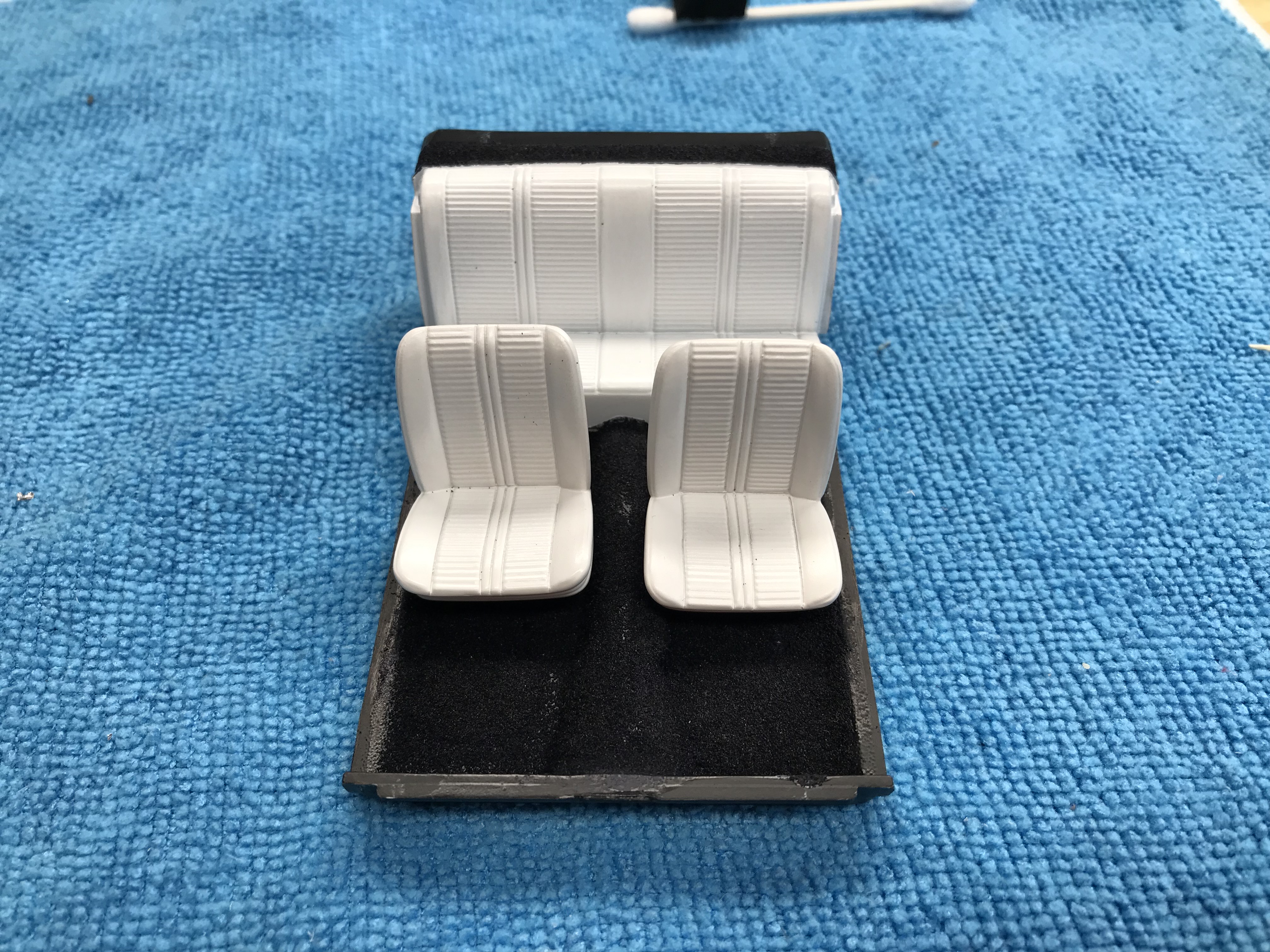

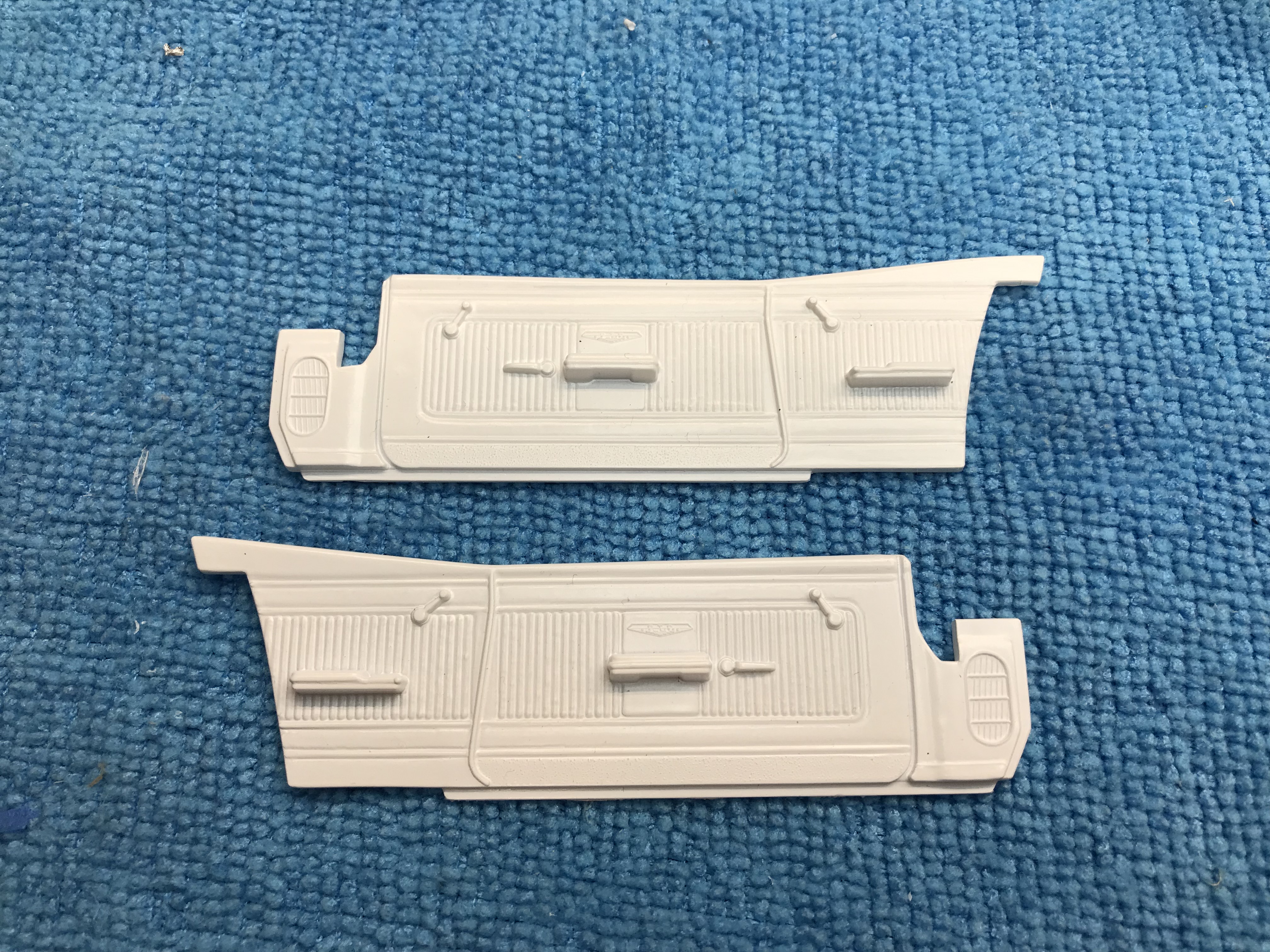

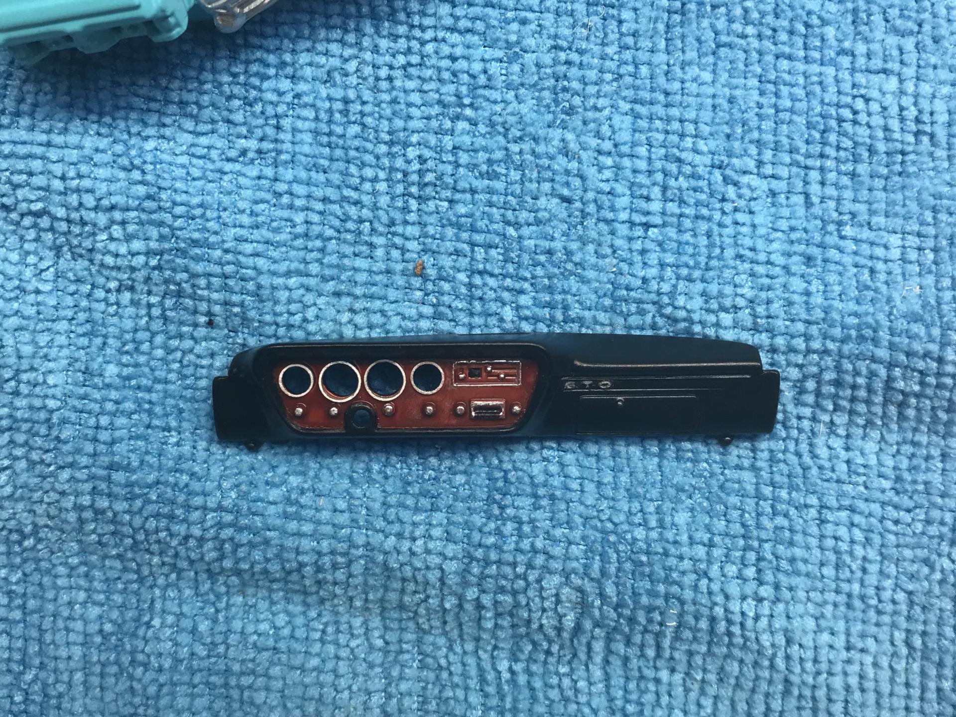

With the Christmas Holiday here there isn't not much time to get to the bench to work on the Goat but I have had a little time to get the  front seats and the interior panels detailed. Next I will be working on finishing up the detail on the dashboard which I have redone the paint on the wood grain so I will be detailing the heater controls and the radio etc.

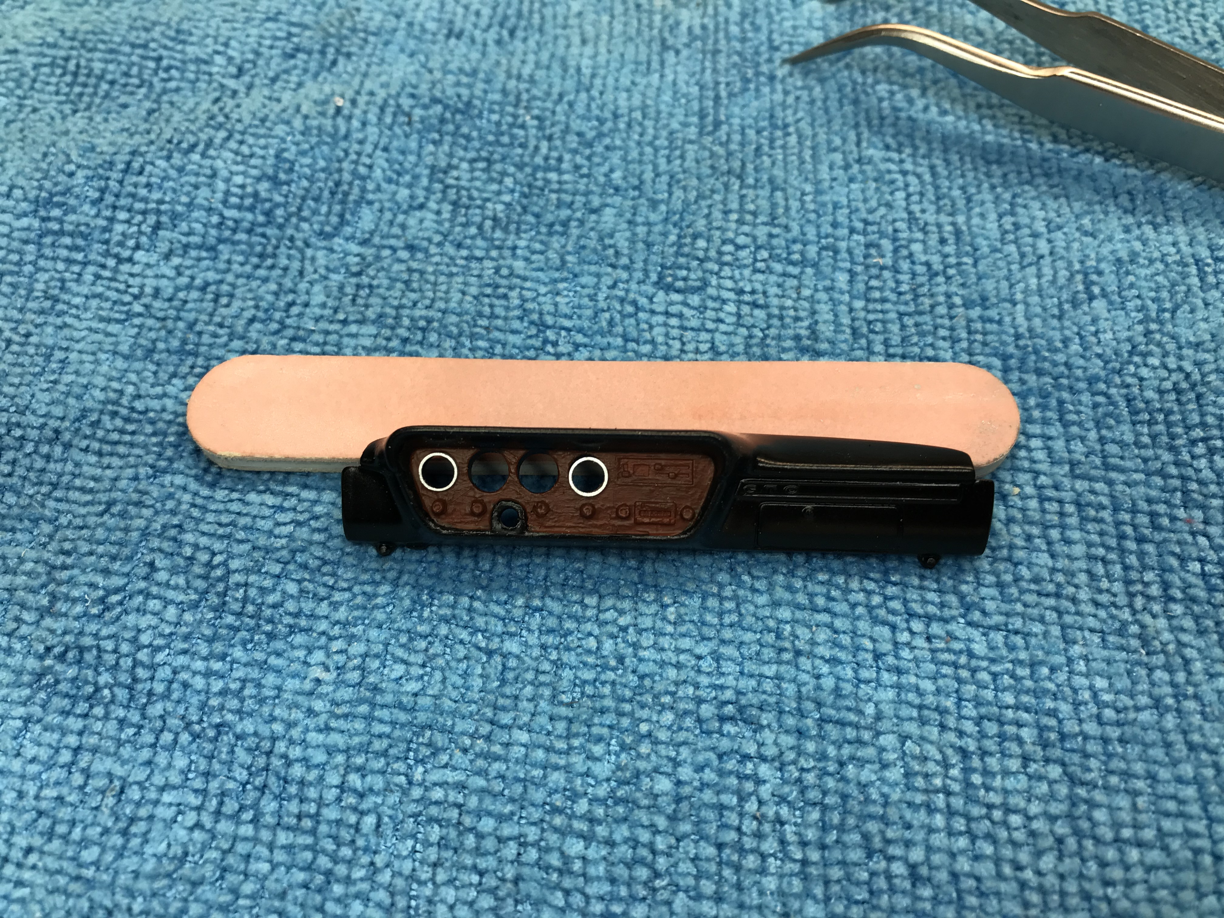

Got a little bench time in this morning so I have now detailed the dash with a mock up of the aluminum gauge bezels that I have cut from aluminum tubing.
