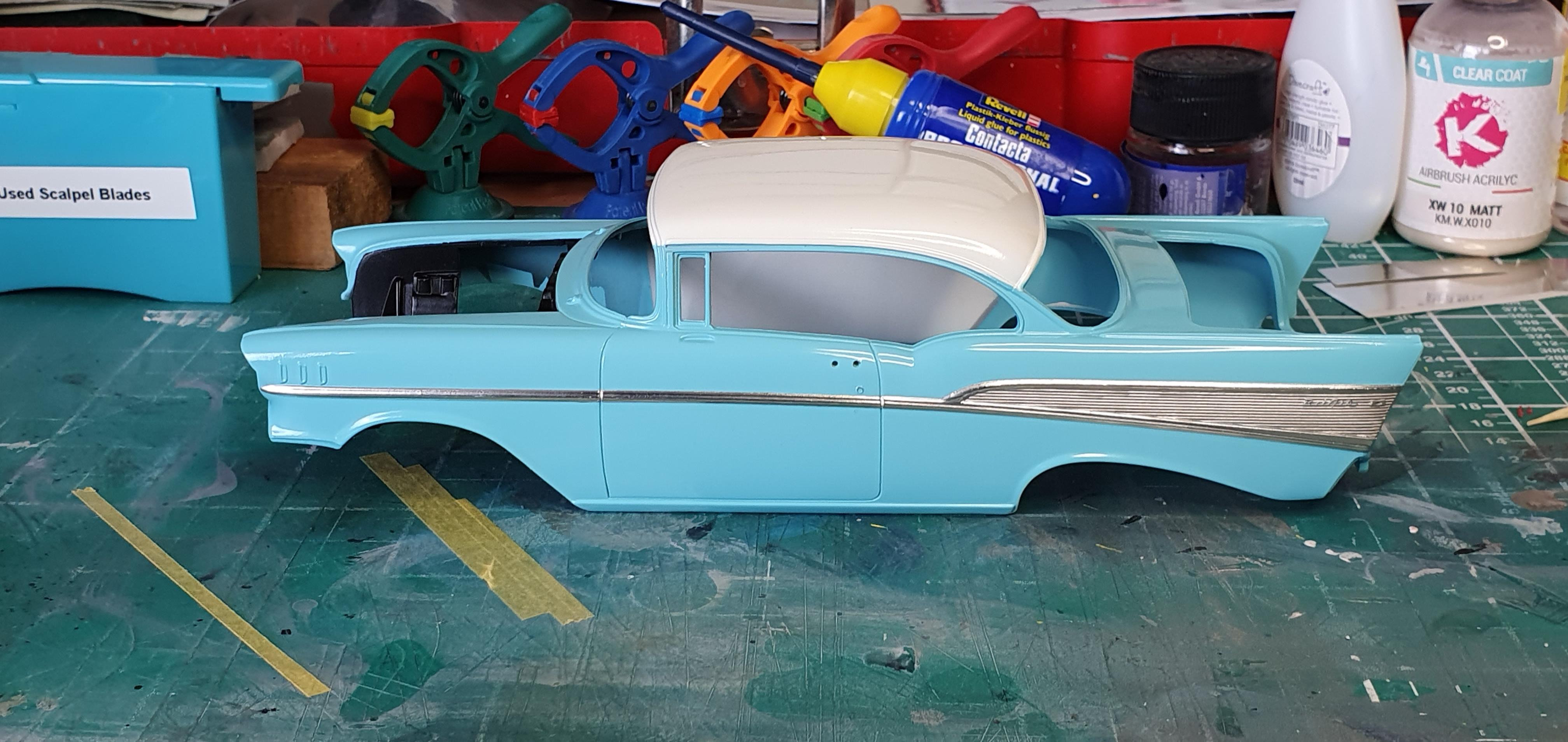

I've tired masking like that and the tape always takes the paint off. Or ruins the finish. What tape do you use?
Regular masking tape can do that sometimes.
That's part of the reason why I rarely use it.
I think I'm safe saying that Geoff used Tamiya masking tape.
It's pretty much the gold standard in masking tape for modeling.
Steve
What he said,  I've never had any problems with Tamiya tape taking off any paintwork
On 3/25/2020 at 6:26 PM, StevenGuthmiller said:
Let the foiling begin!! :D
Now I can get started with the BMF
Edited by GeeBee
OK. Thanks for the info guys. I've only found the narrower Tamiya tapes. I've never seen Tamiya tape as wide as in your photos.
It's available in 6,10,18 and 40mm

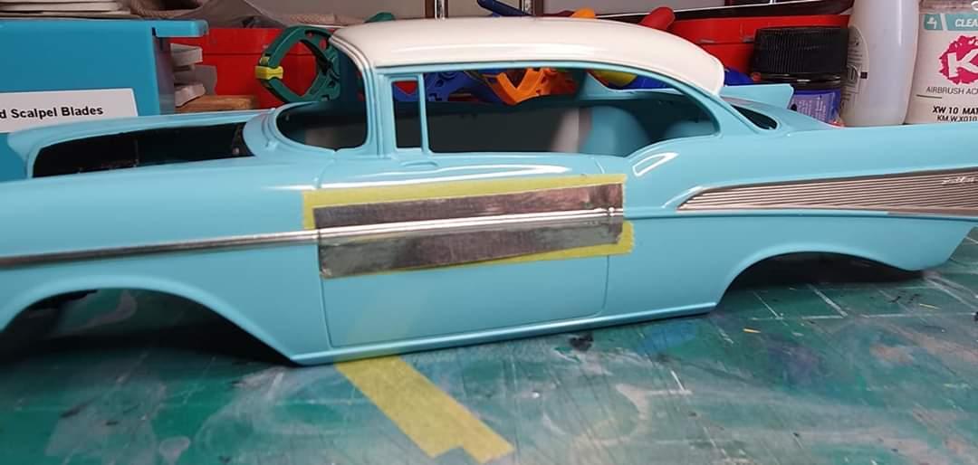

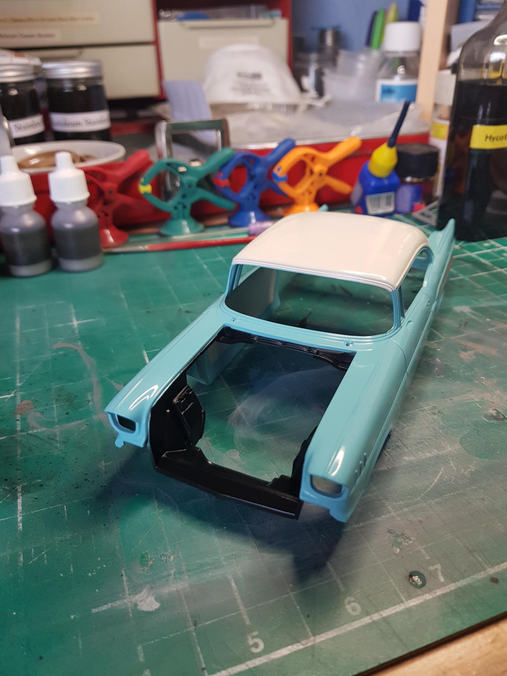

Although I've still got work to do on other models, for some reason I felt like doing some Bare Metal foil, so got the 57 Bel Air off the backburner, only managed to get two trim pieces done as I've been busy with other things today
Very nice work Geoff. This is a really nice kit, and you're doing a wonderful job. Shame you couldn't use the PE parts for the side spears, but what you've done looks equally good. Good idea with applying masking tape either side of the trim before applying the BMF. I have a couple of questions. Can you recommend a retailer for Scale Finishes and MCW paints in the UK? And, did you say you were doing this build for a magazine article - what magazine?

That looks fantastic! Just read through all five pages, excellent lunchtime viewing.
Interesting to see the use of masking tape either side of the BMF, not something I've seen before - is that to protect the paint, or give an edge to cut against?
Both really, as it gives two edges to cut up to, I've found it more useful when cutting around items like wheel arch trim, but as you also mentioned it does protect the paintwork from any accidental damage from the scalpel blade

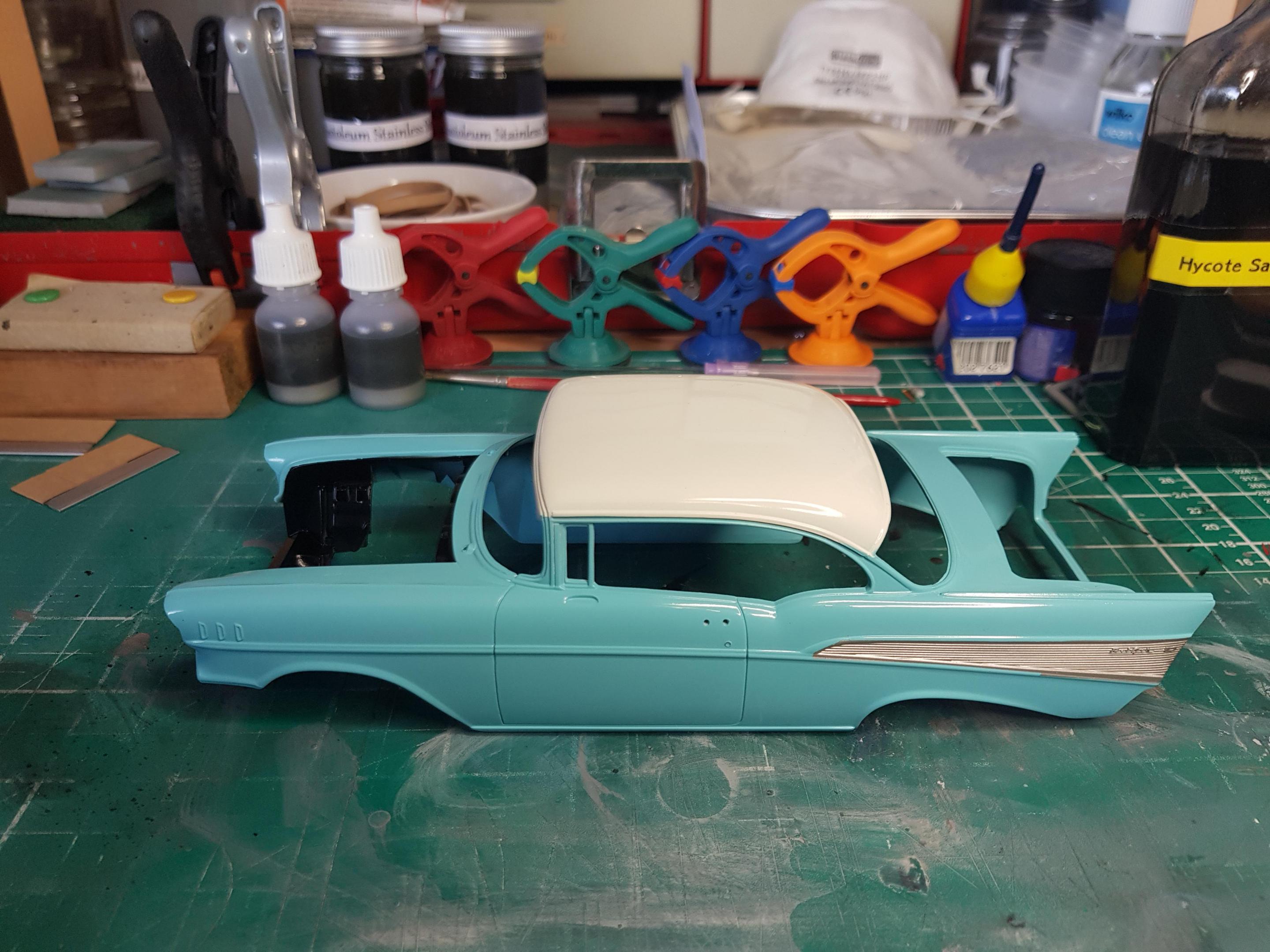

One side finished, had to touch up the Stainless steel trim, I'd airbrushed it using Rustoleum Stainless enamel, but it didn't like being masked, turned out ok though, so a little more, no a lot more still to do.....

Thanks for the info Geoff. I checked out the scalemodellingnow site - that looks interesting.
Just a note about the PE "side spear trim".  They dont fill the whole area inside the trim; it's why I used BMF.
I found several fit issues and the trans mounts that have to be glued to the frame are a bear to install/fit correctly. I  also did lots of sanding to get the hood  to fit flat and finally gave up  and accepted it was the best it was gonna get.
Looking great GeeBee.  I'm sure you know this, but don't forget to paint the mesh part of the grill gold.
Nearly forgot to do the chrome trim on the rocker panel, it's amazing just how much chrome there is on a 57 Bel Air
I did a lot of work on the hood and bootlid before primer and paint, running a scalpel blade around the underside of both and the lip around the opening got them sitting as flush as I could get them
