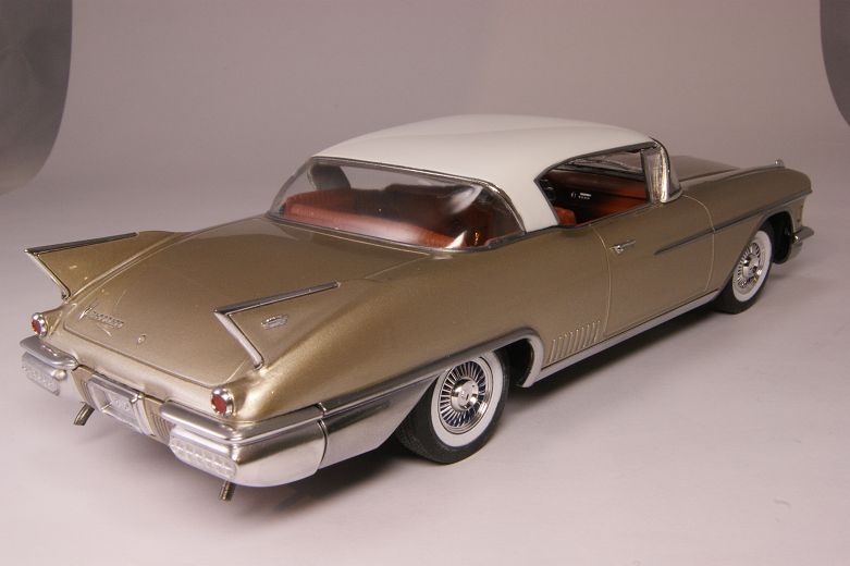

Looks cool. How do you clean off the paint without damaging the foil? Thanks. On another note - as far as I know there is still no really good clear for Molotow. I tried 2k clear and when wet it stayed good, but once it dried, it wrecked the molotow.
I painted with a coat of black primer, several coats of the Testor lacquer, and several coats of clear. To expose the foil, I wet-sanded with #1000 or #1500 paper until I got down to the black primer on the raised areas, then polished as normal with Wright's Silver Cream which took the black primer off as it smoothed out the paint. Worked fabulously, and I'll definitely be doing it again.
If you wait to apply the foil until right before your final coat or 2 of color, you can clean it easily with a tiny bit of lacquer thinner on a conical swab or a sharpened tooth pick.
The thinner will not damage the foil.
I have done it the same way as snake, but be aware that if you polish too much, you can polish through the foil.
You can get lots of nice affects with this technique.
You can use paint & thinner to add color to your badges and emblems as well.
I use this technique before clear and then just clear coat over them.
Steve
Steve
I should have mentioned that I used cheap kitchen foil, which is thicker than the BMF Steve uses and will stand up to more polishing.
One more trick: Larger emblems, such as the crossed flags front and rear on that '68 Corvette I showed above, can have their foil covered with a small drop of Elmer's glue before priming and painting. Just leave this in place until polishing is complete, then pop it right off. It might actually come off on its own during the polishing process, especially near the end. B)

On 12/29/2018 at 8:21 AM, Pete J. said:
I have to add one more comment.  I use all the above methods.  I have been doing the BMF method for scripts for a very long time and it is far and away the easiest way  to get clean scripts.  I have also used BMF to make badges.  Very time consuming but the results are good.  BMF the badge, put a good glop of white glue on the badge, let it dry.  Then a large glob of putty over that to act and a handle.  Let it dry, then put it all off.  Fill the back of the indentation in the BMF with thick super glue and let that cure.  Put the whole mess in warm water to dissolve the white glue and  you have your own badge.  Sand it down to fit and bingo.  Replacement badges.
Steve
Looks great!
Do you trim the BFM as close to the subject as possible, or spread it out a little larger?

53 minutes ago, NuovoSFPD2n3/4 said:
Looks great!
Trim as close as possible.
Depending on the thickness of your paint, the edges of the foil can show through if it is trimmed too wide.
