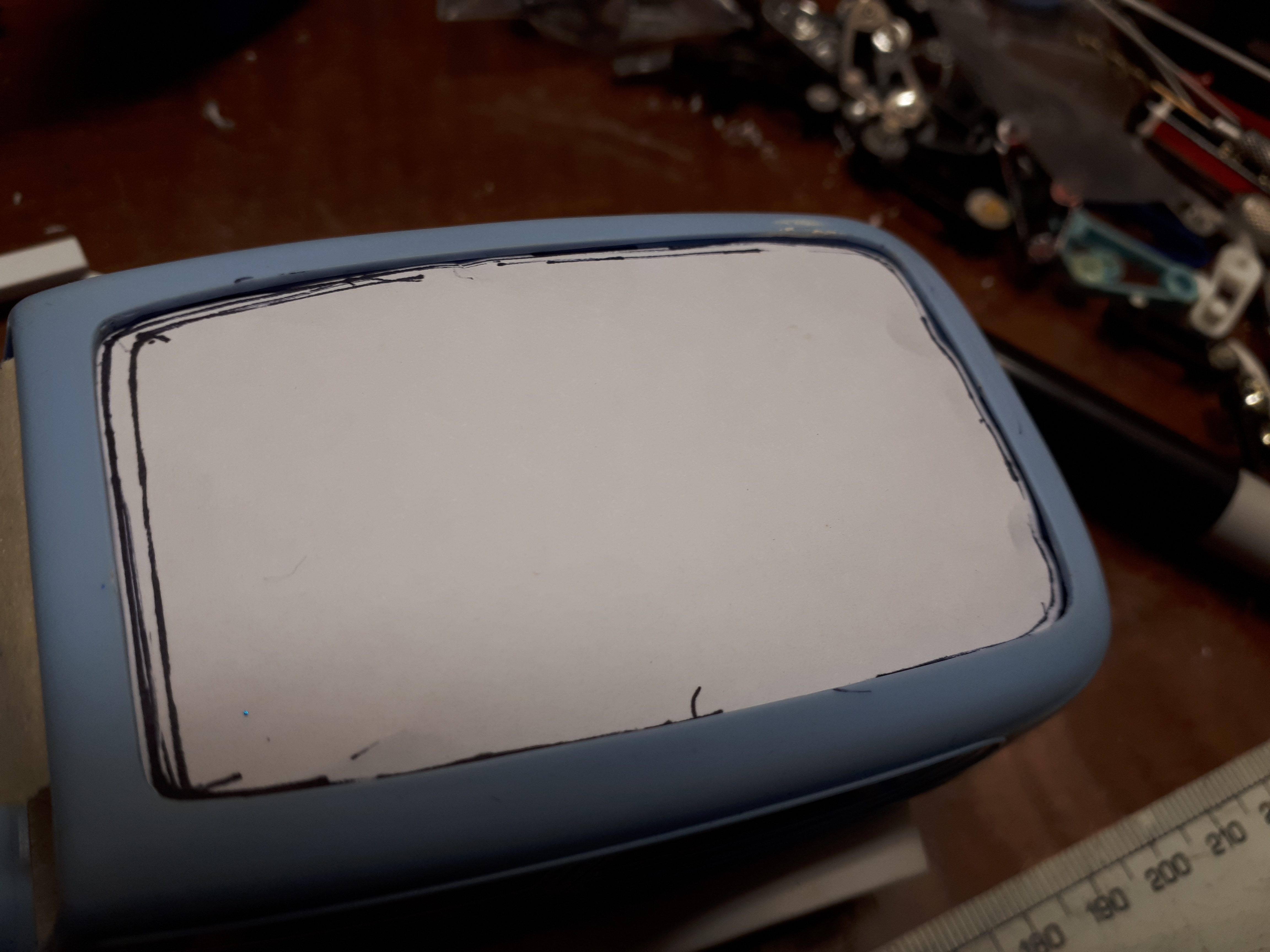

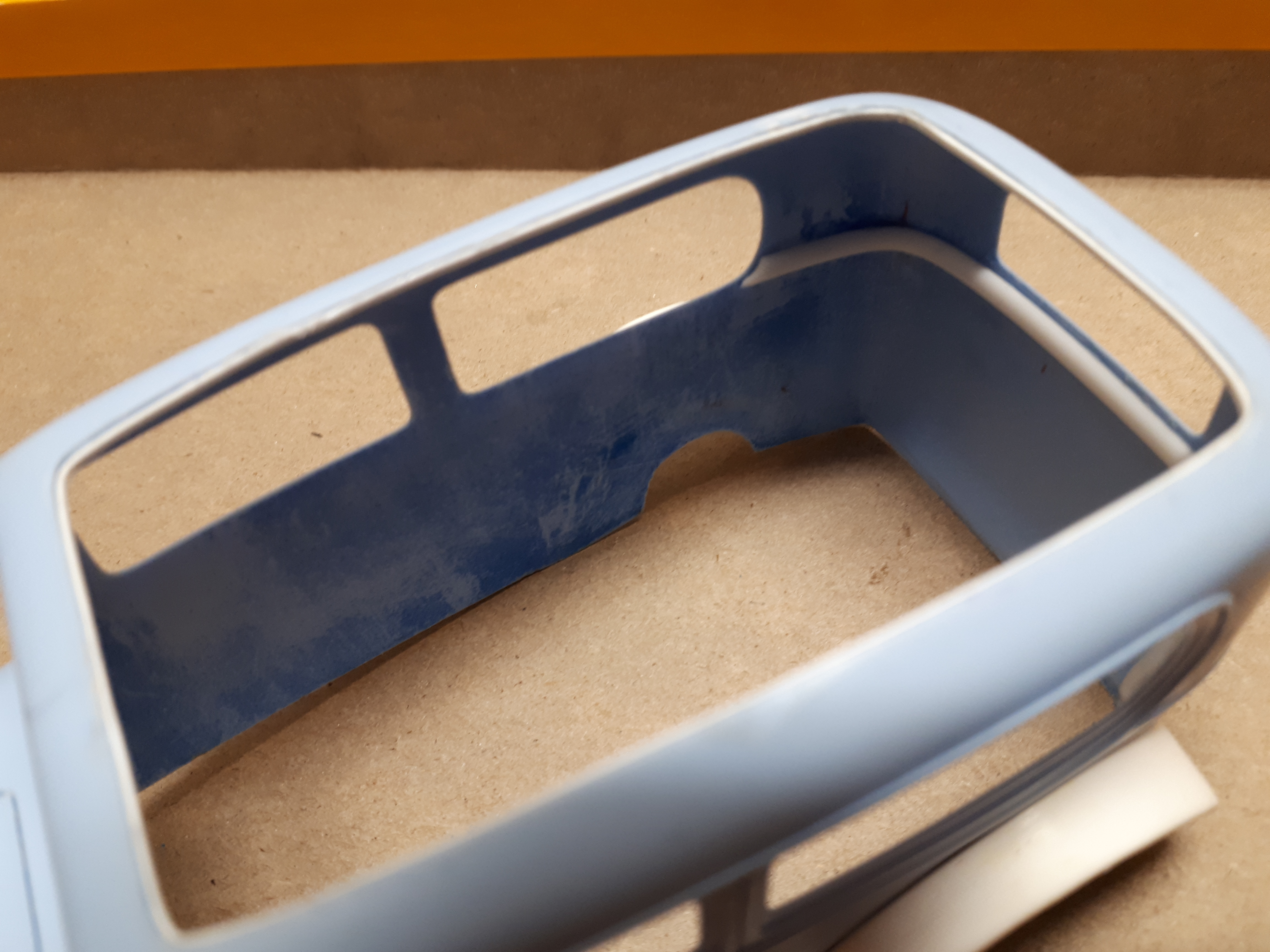

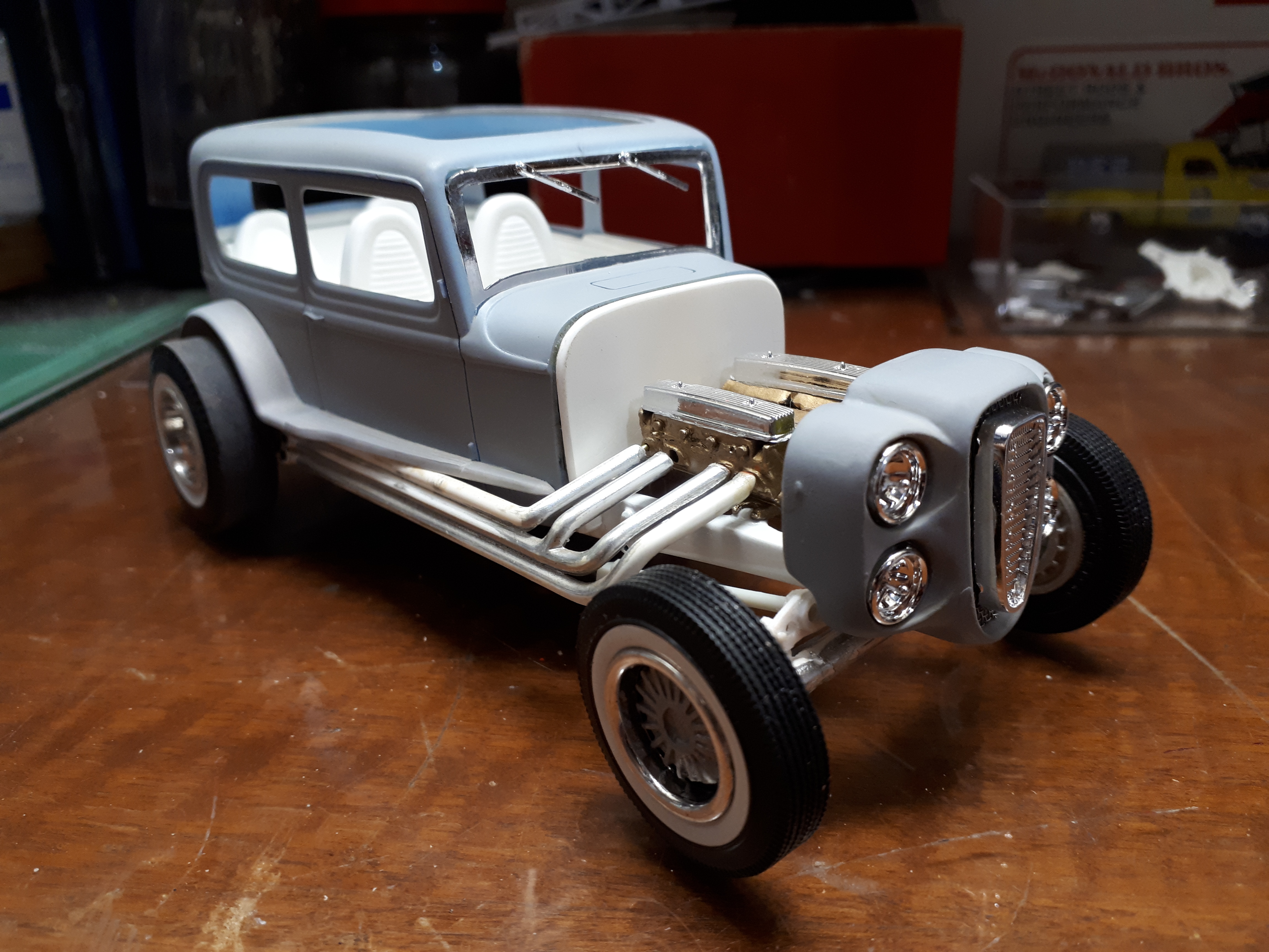

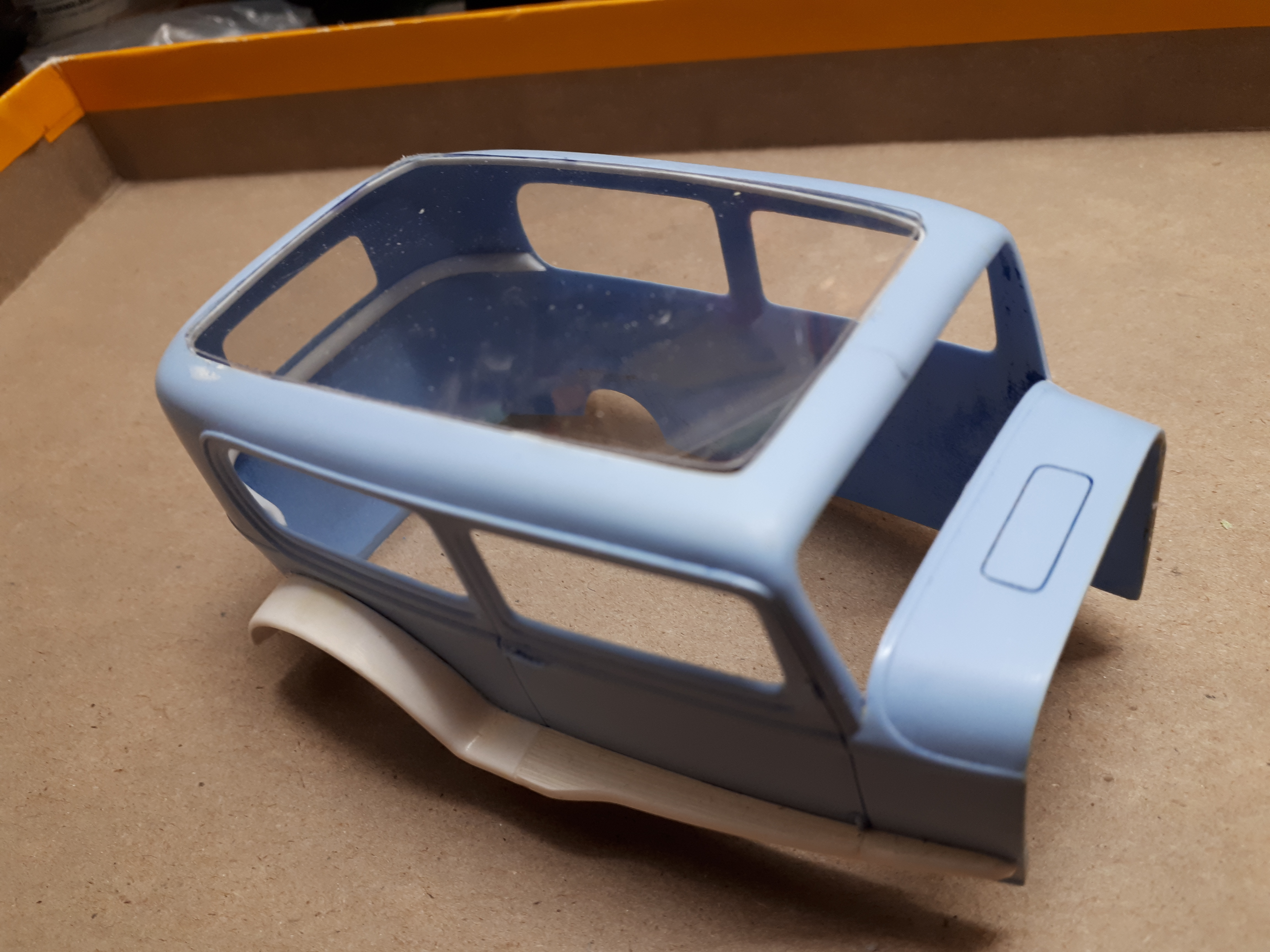

Got a bit done last night. First, I made a paper template of the roof opening and then transferred it to some clear celluloid that will eventually be used to produce a coloured insert. This should be a lot more accurate than a floppy paper template.  Then I carefully glued a strip of thin evergreen along the inside edge of the roof opening to produce a ledge for the clear insert to eventually rest on.

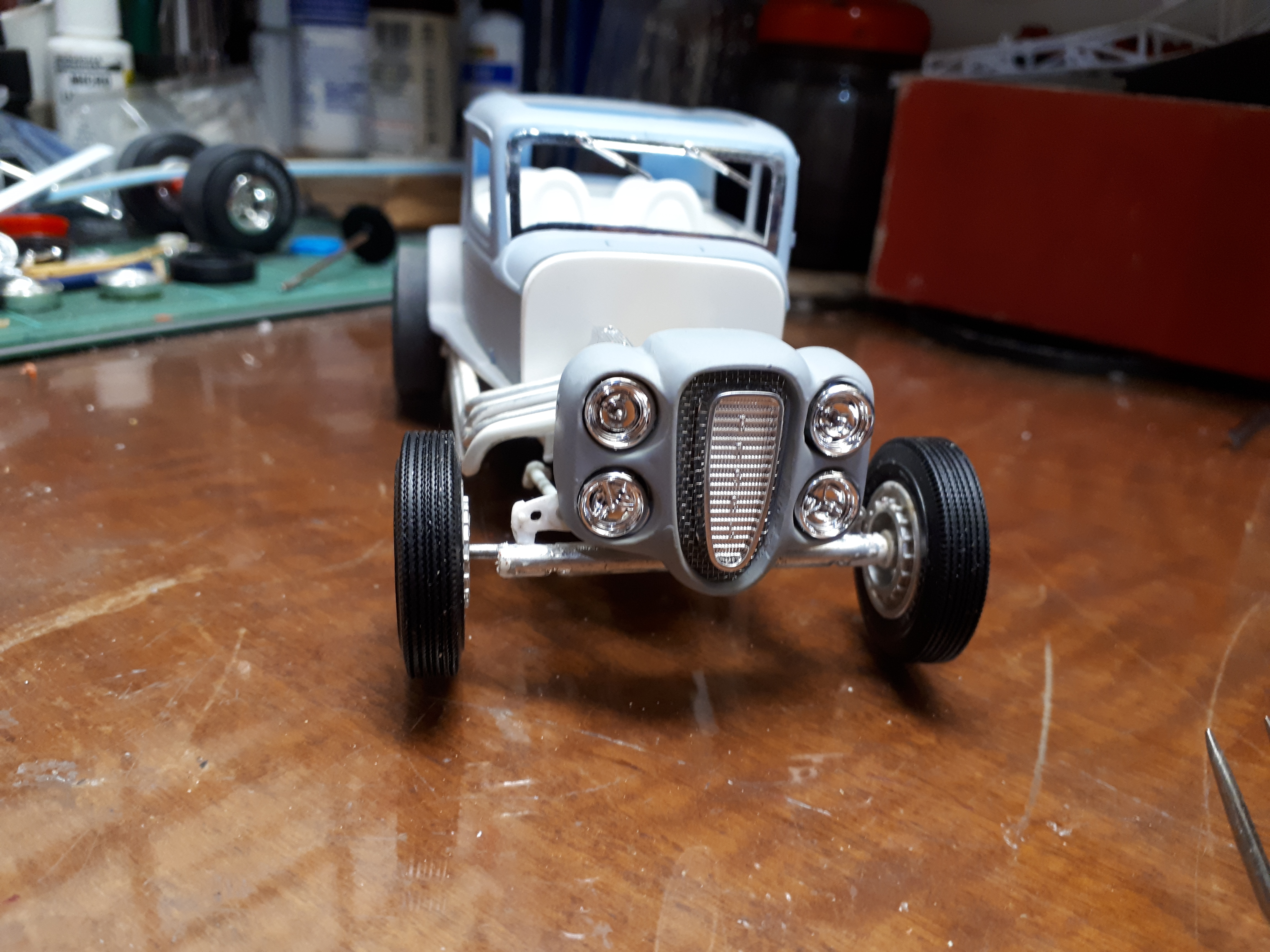

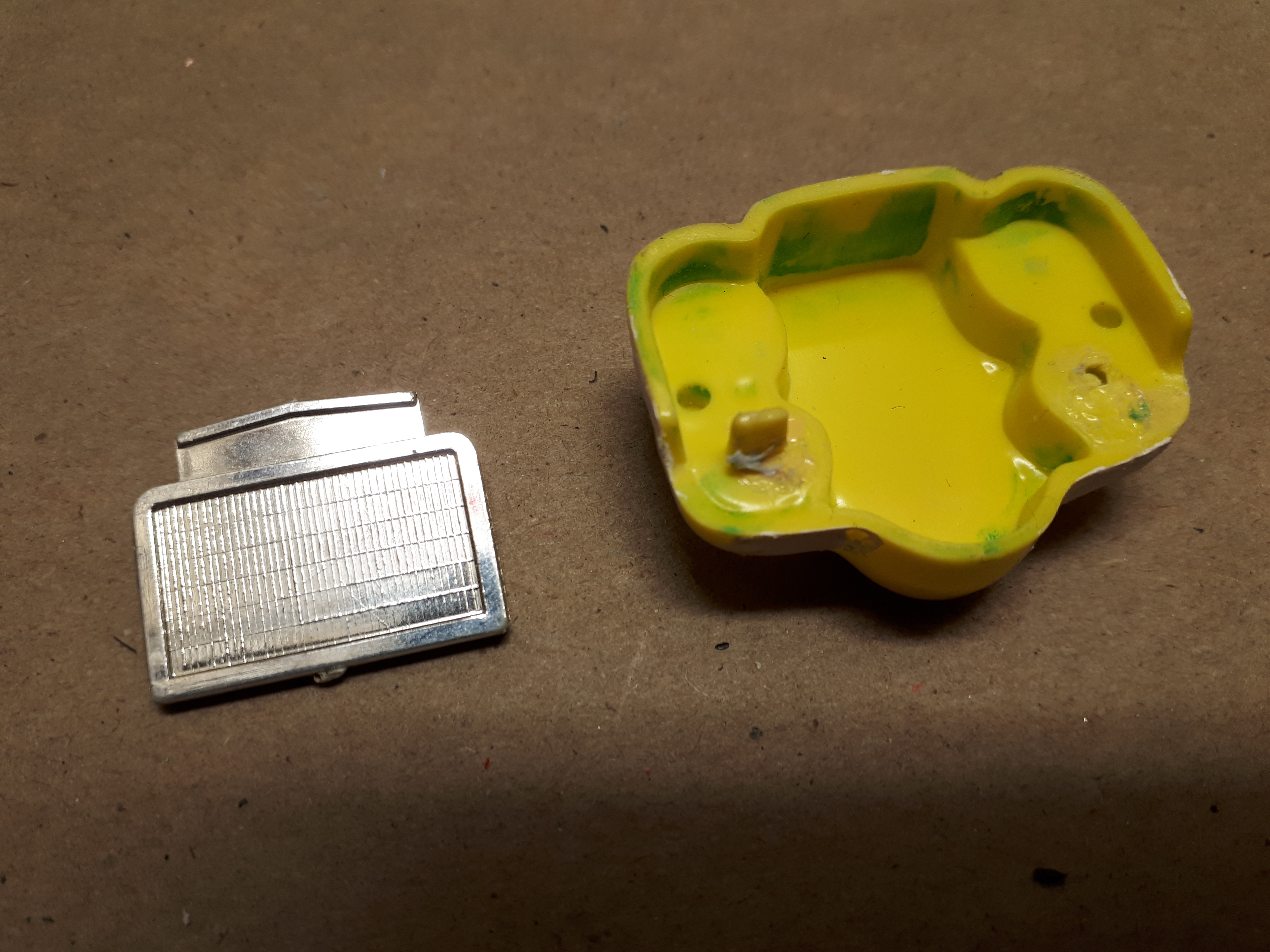

While that was drying, I went scrounging for a suitable radiator.  I found this chromed one from unknown source  and with a minimum of filing it fit inside the custom grille shell.
With everything looking good I dusted a light coat of primer on and this is where I am at now.  But man, that stance!  I just can't see getting this puppy to fly with the straight tube front axle.   Do I go with a dropped axle or is that veering to far from the AMT spirit?

Great job on the rebuild of this iconic kit.  As for the front axle, there appears to be some alignment problems with the grille and the axle, the grille appears to be a bit high; maybe that is just my perspective.  I realize that axle is an original kit piece, but to me it looks like a 4X4 axle without a hogshead, maybe you could substitute some thinner tube or a smaller diameter.  Just some thoughts off the top of my head.  Still, I really like what you are doing with it, and sure wish I could find one without having to mortgage the house.

Just two cents - The original kit had staggered tire sizes front to rear.  The rear bigs were the old thumbprint Firestone slicks.  The front littles were the old implement style drag tires which were much smaller diameter than the slick or most of what we have available now.  It was a natural rubber rake, or in this case the chassis came out level with the straight tube axle.  The Willys gasser in the double kit also had these tires.  Replicas and miniatures has them available.  The whitewalls are a big improvement so I think a dropped axle would be appropriate - maybe something like the chrome axle in the AMT '40 Ford as an alternative to smaller front tires.

Thanks for the photo Norman, that definitely confirms that I need to go with a dropped axle.  That Tudor looks sweet even without the fender running board unit.  It looks like he also might have used the Revell 29 Hiboy nailhead, judging by the pipes.  It is an interesting twist on the original.
And oldschool, you are dead right about the whitewalls - gotta have 'em!  I am very keen to use the AMT parts pack ones as they are so nice and period perfect but I will decide for sure when I get a better front axle happening.

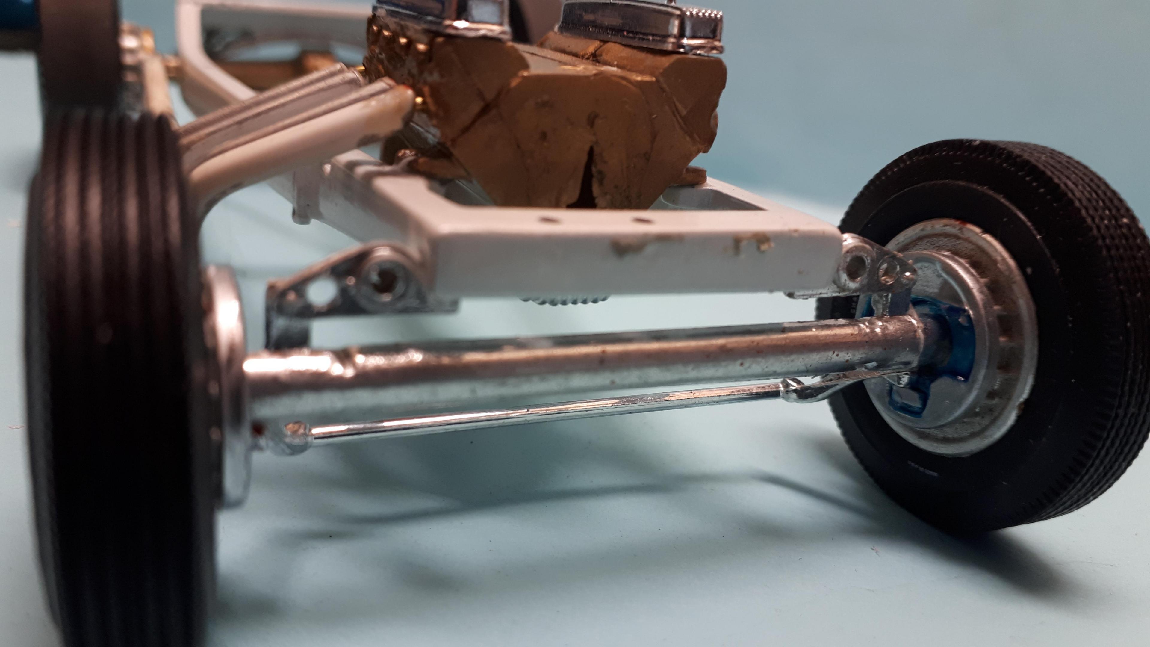

Hi guys, it's been a while but this is finally finished and will be in Under Glass shortly.  I still want to show a few details of the restoration here first.

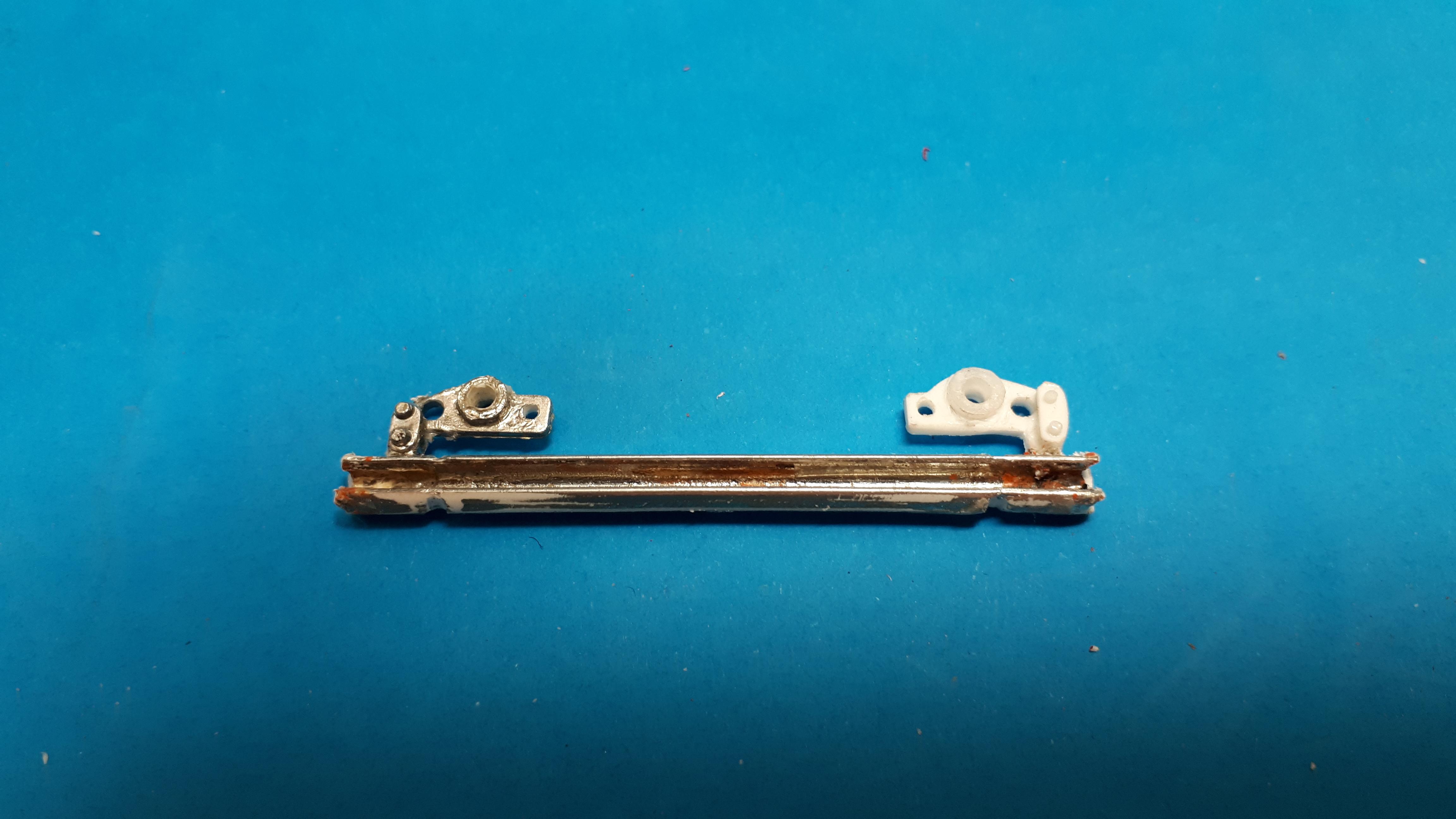

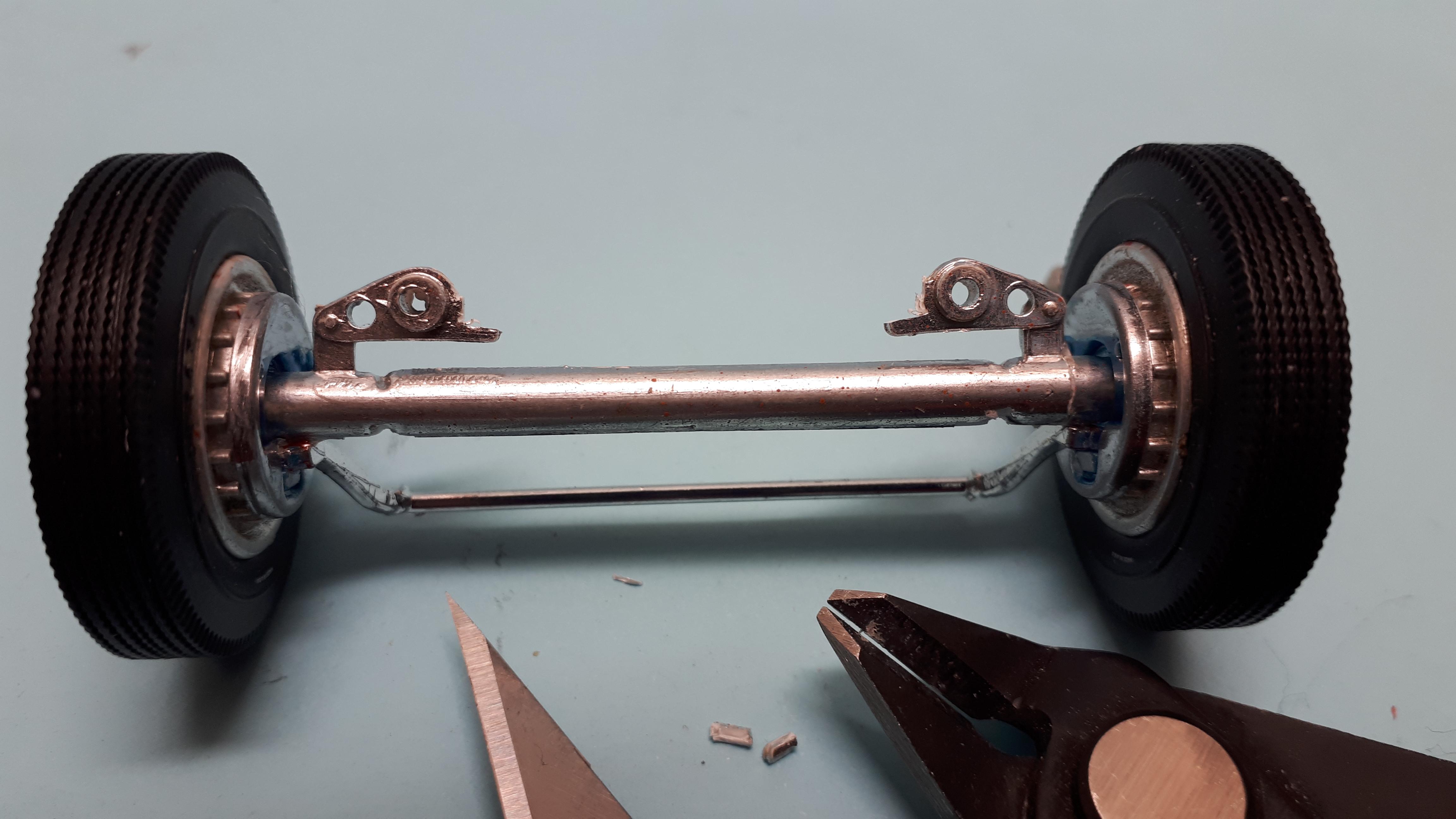

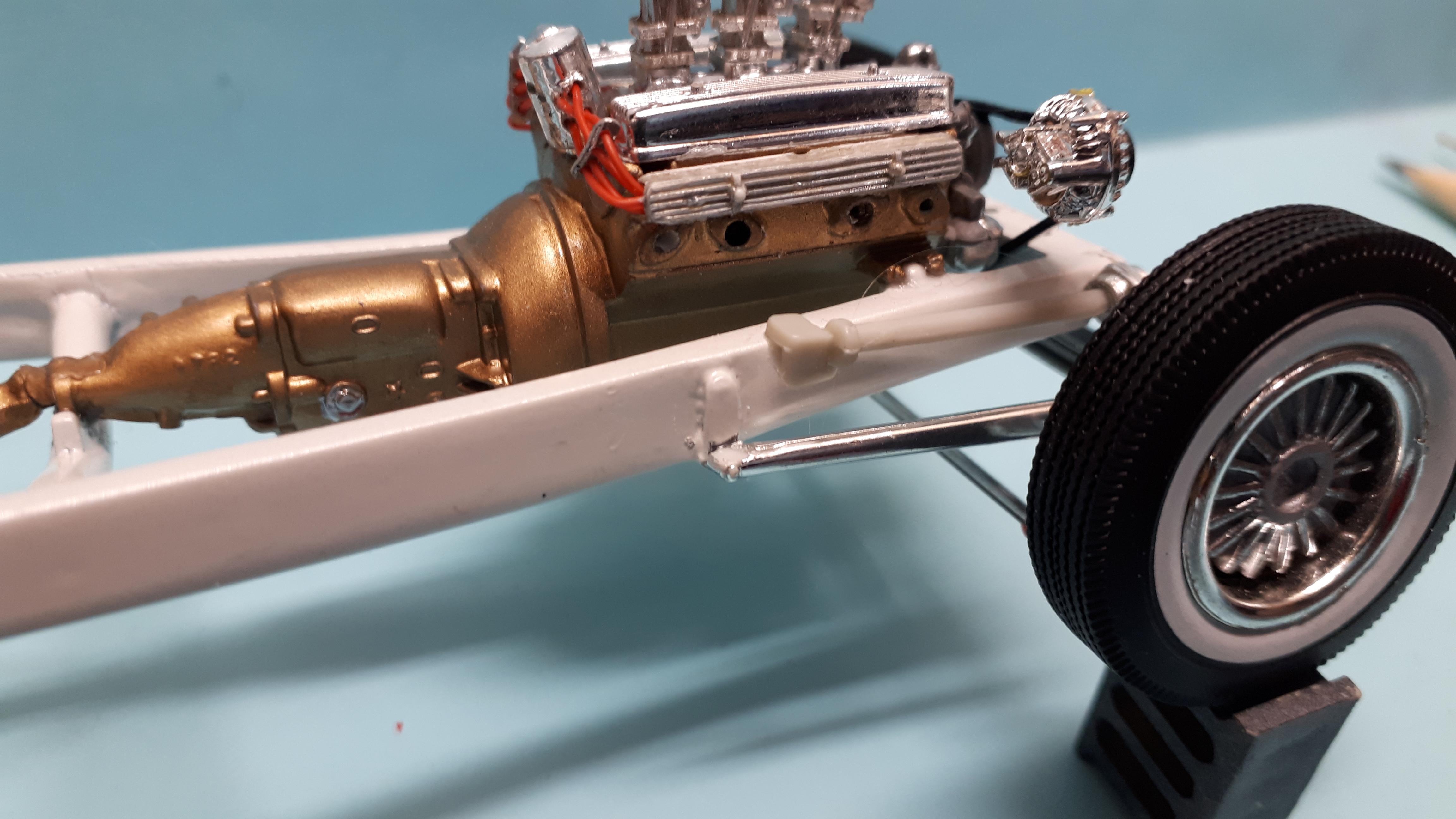

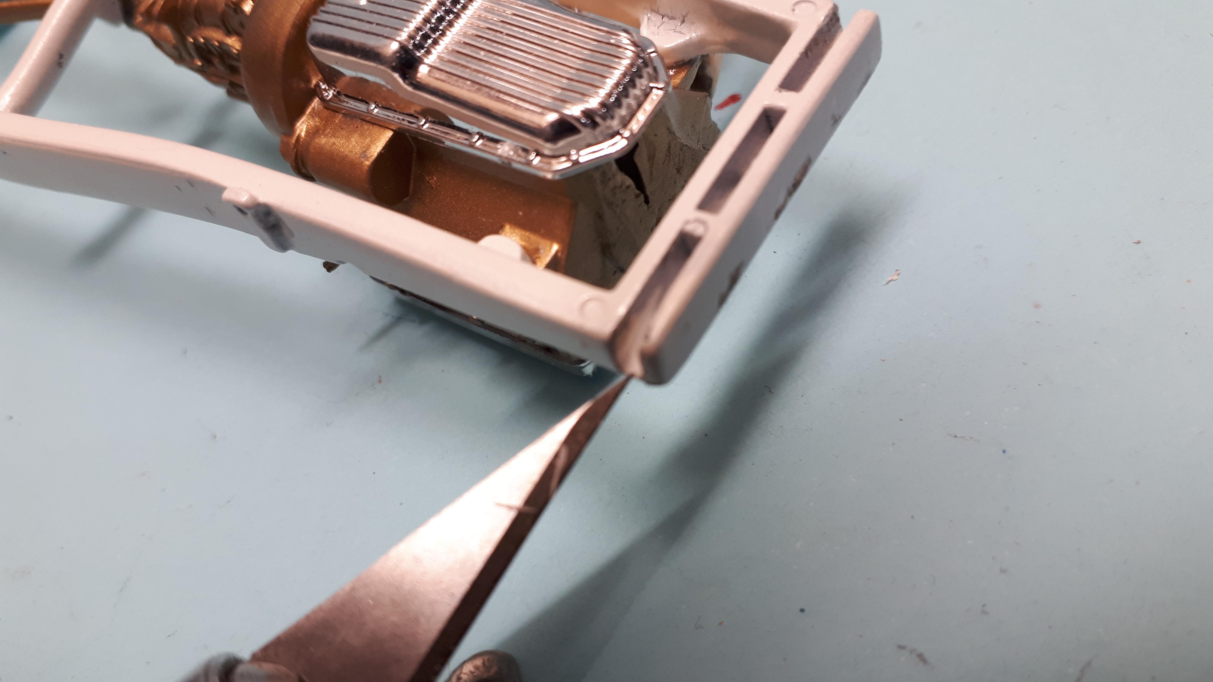

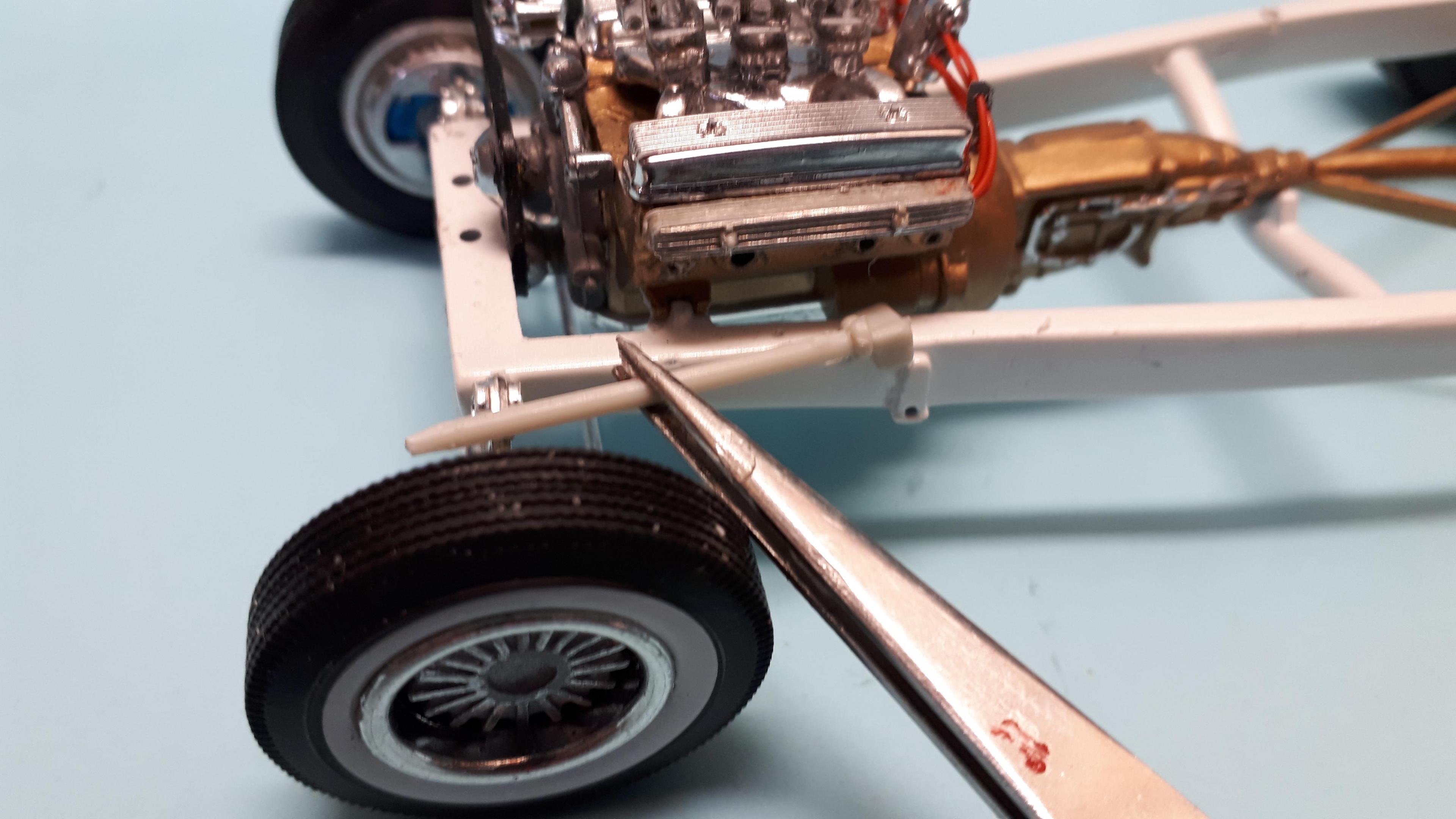

I first restored the original axle but then Steve sent me a much nicer one so I used it instead.  To try and get it down a bit I carefully trimmed the lever shock mounts and the inside of the cross member - I think i picked up close to 2mm, better than nothing.

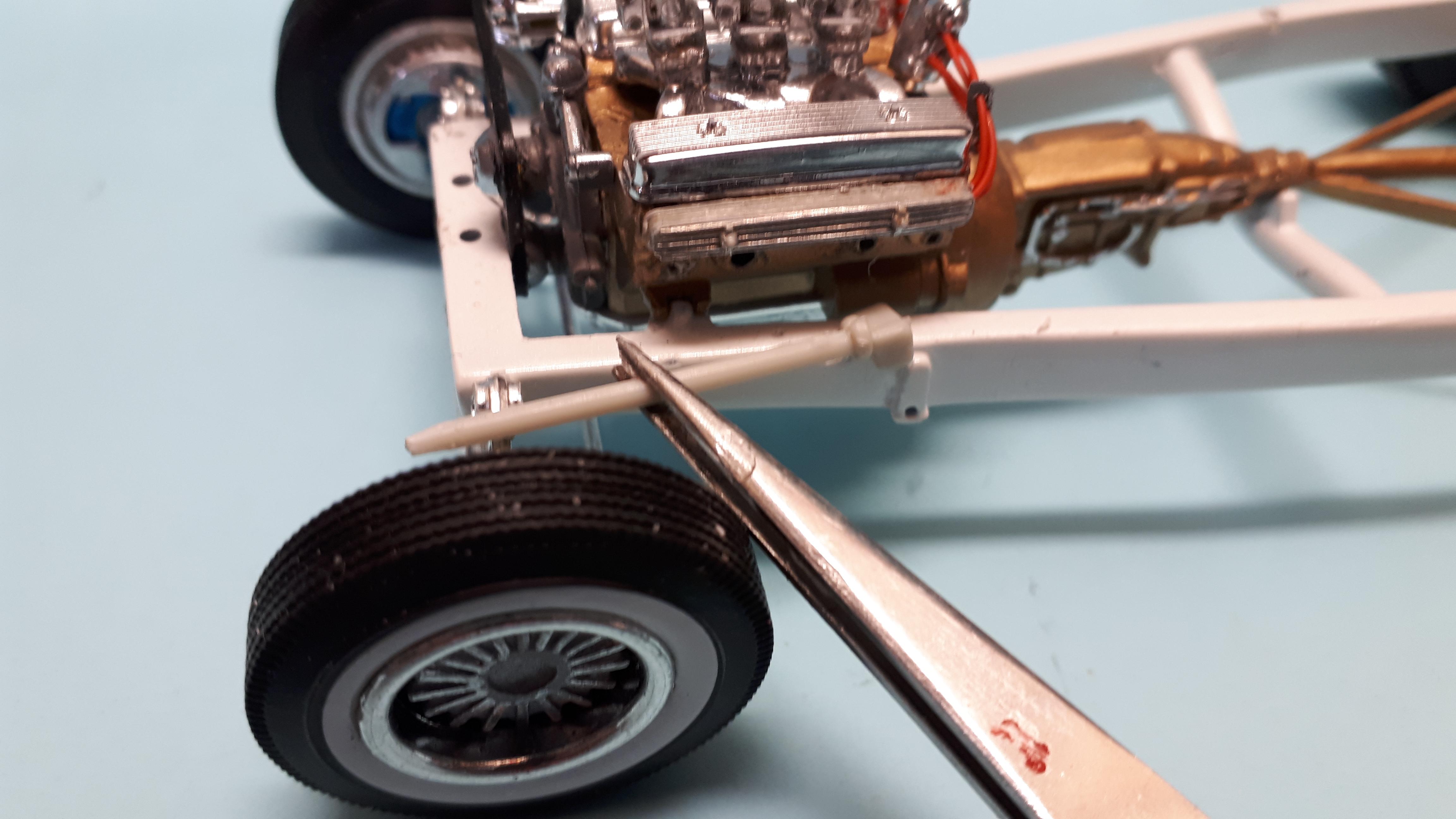

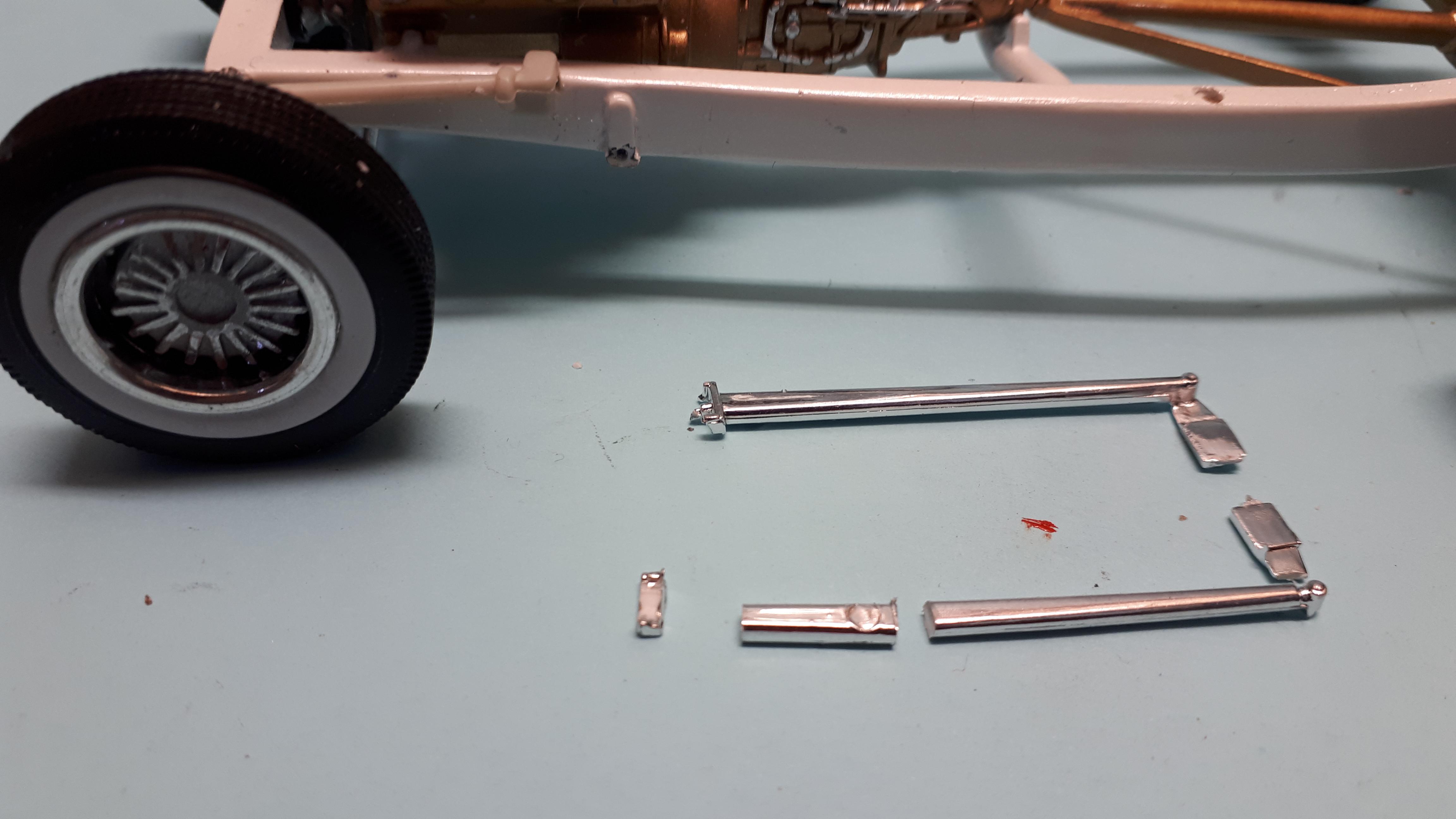

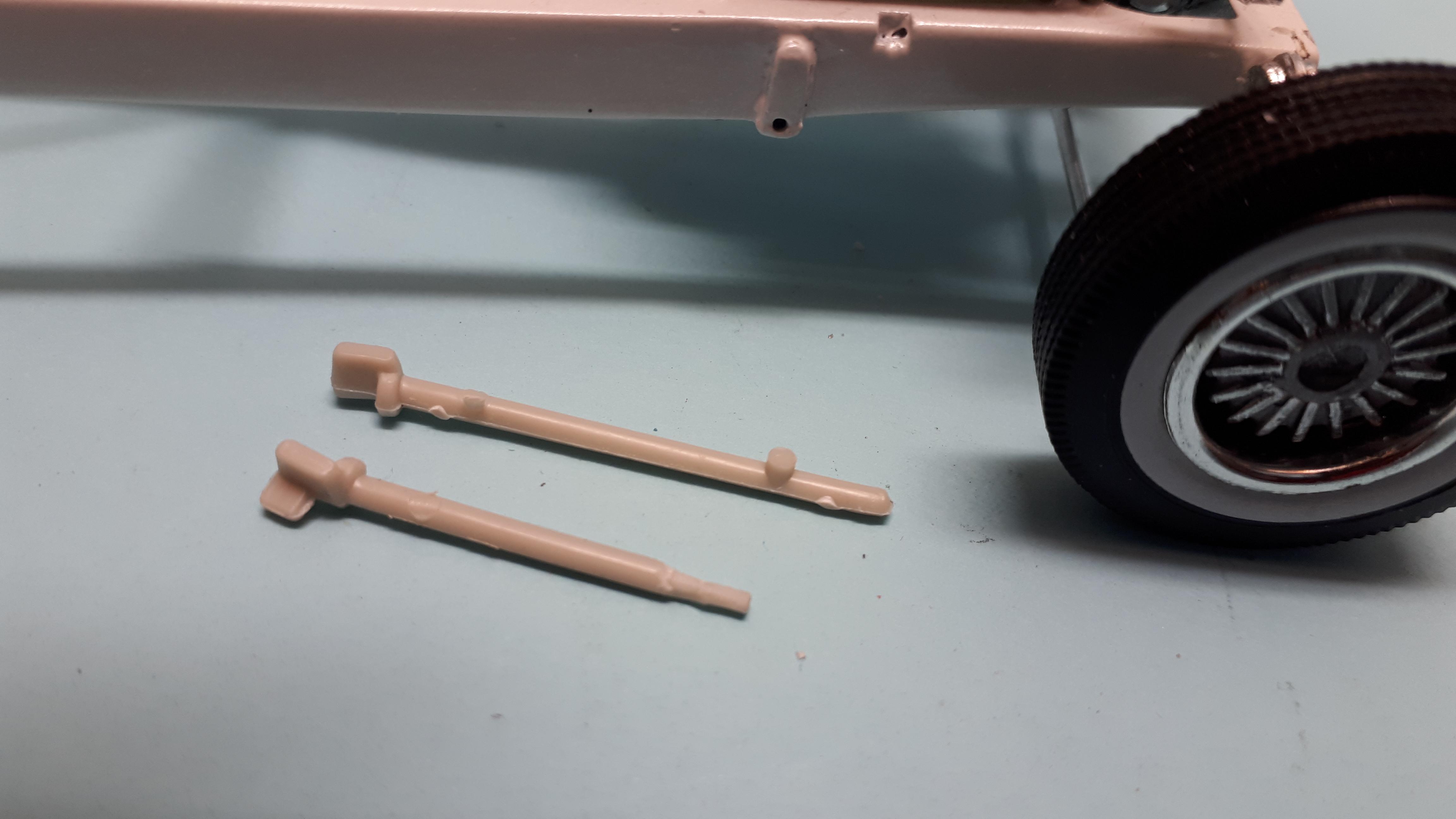

I had to replace everything else form my parts box.  THe torsion bars are shortened versions of the 32 Vicky torsion bars and the radius rods are shortened versions of the Revell 29 hiboy radius rods.

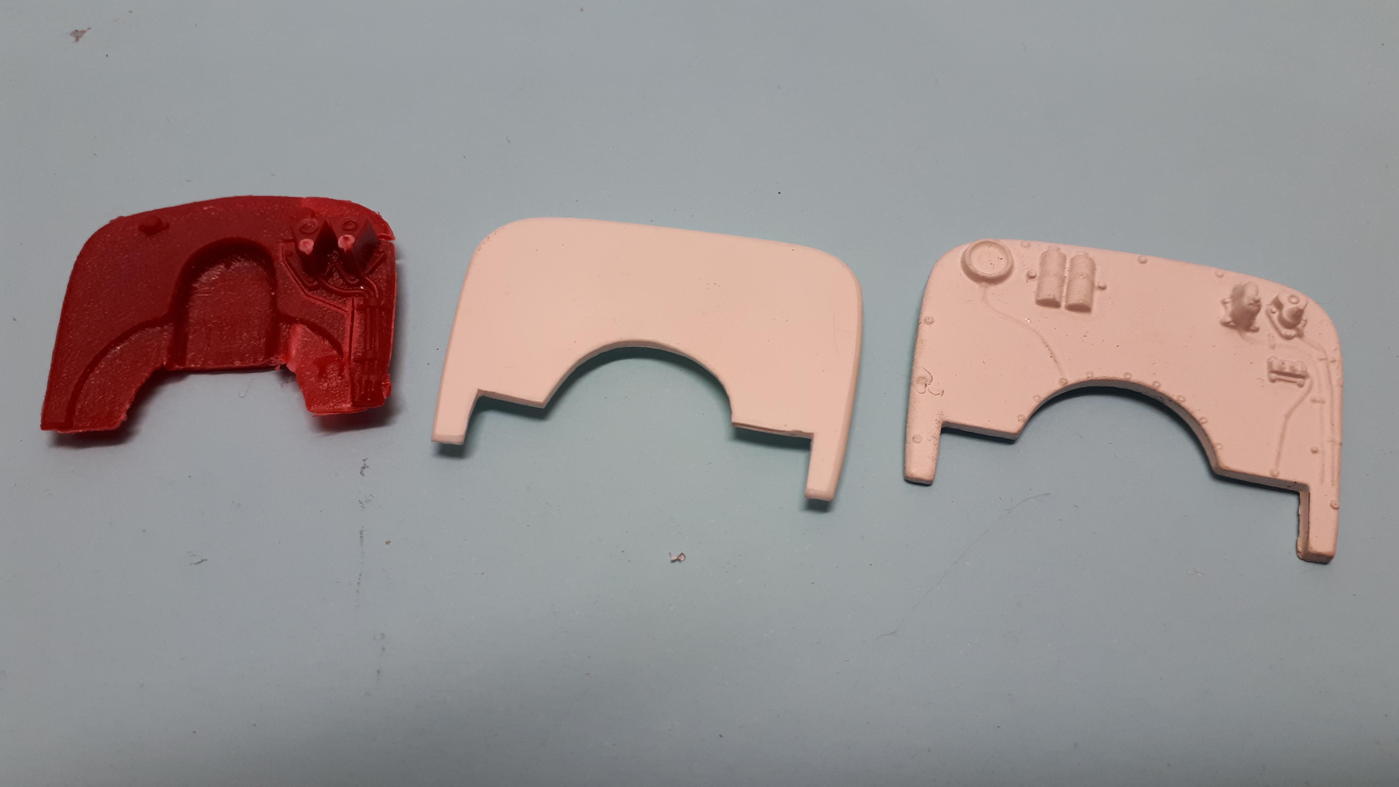

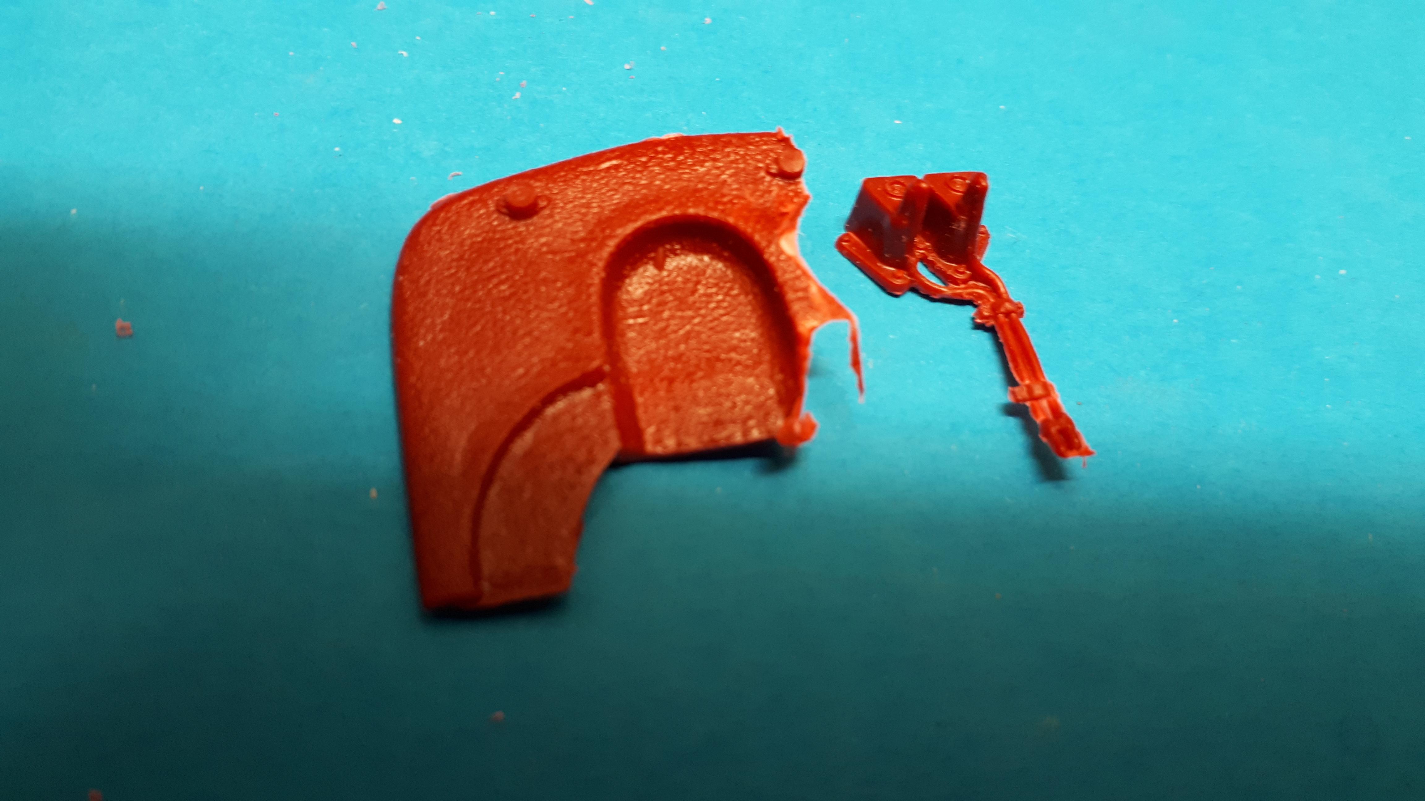

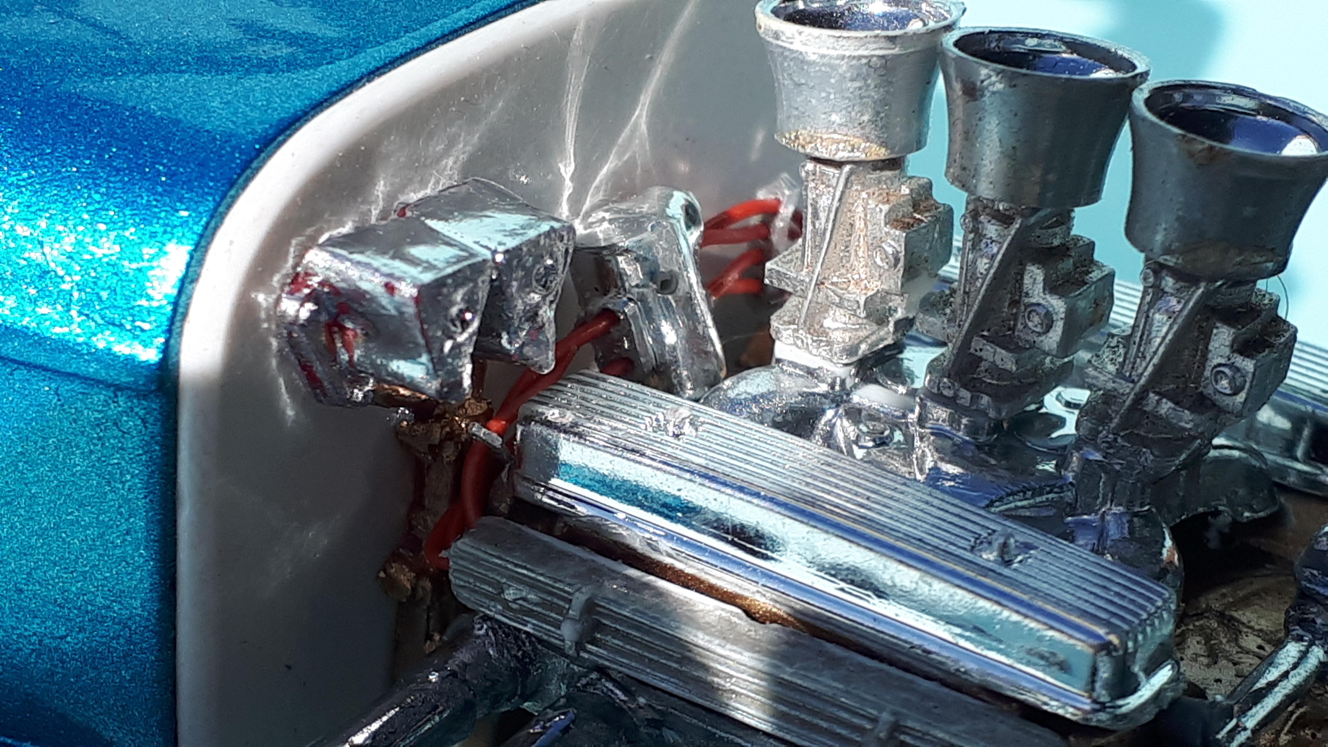

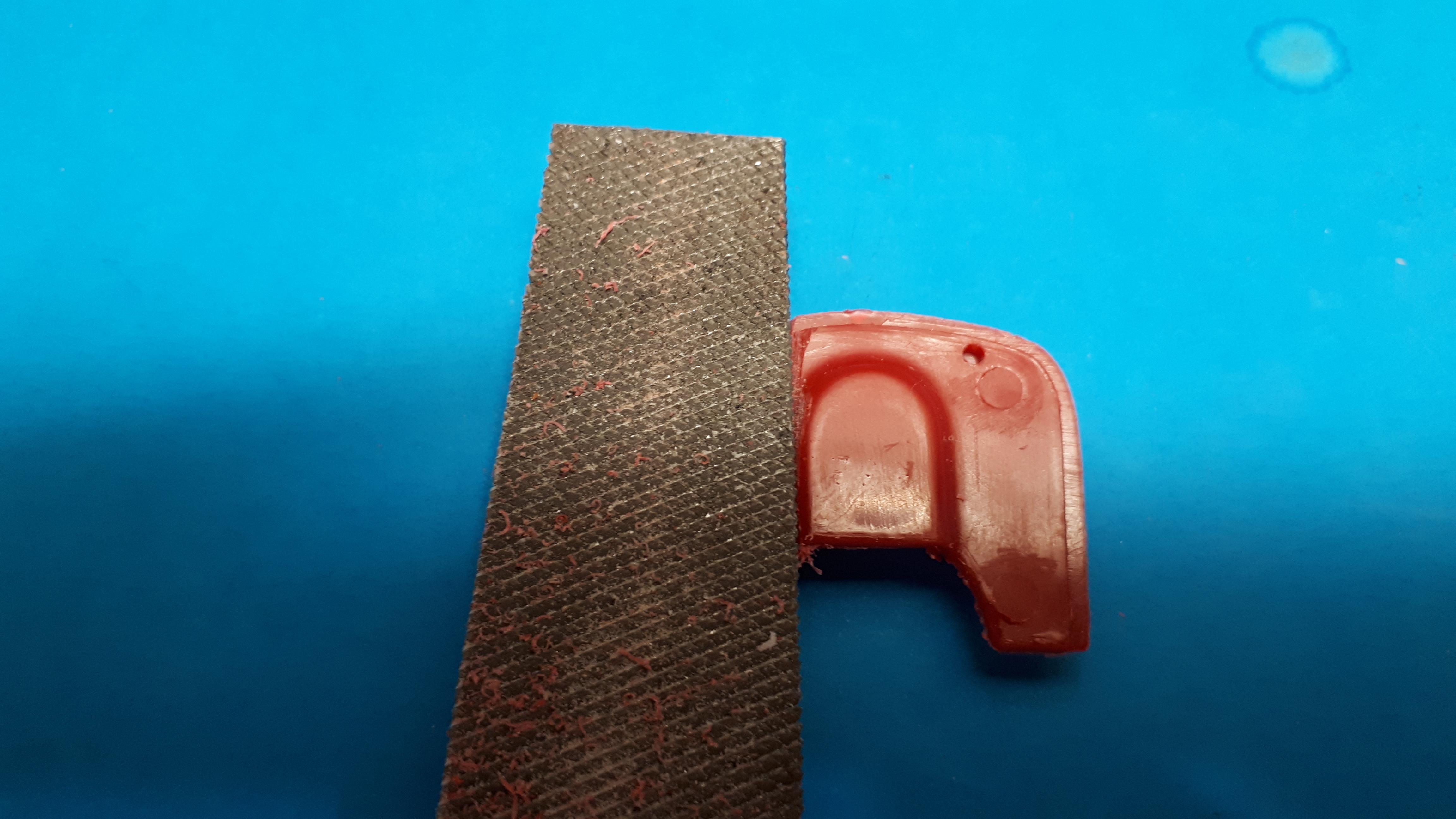

I needed to switch the firewall to suit my standard right hand drive configuration for hot rods in my collection but I couldn't bring myself to cut up the highly engrave originals.( if anyine needs an original double kit firewall to complete a restoration project, let me know and I will send it to you).
I traced the original firewall shape onto a piece of flat styrene and cut it out.  To add some detail, I carefully removed the master cylinder and plumbing detail form an old AMT Model A custom firewall, painted it with Molotow chrome ens and added it to the firewall.  Very happy with the result!

I have an old glue bomb one that I restored best I could. Was missing a few parts but I made do. I couldn't bare to replace the front straight axle. So to give it more rake by shimming the rear spring mount more . It seems to sit better.
