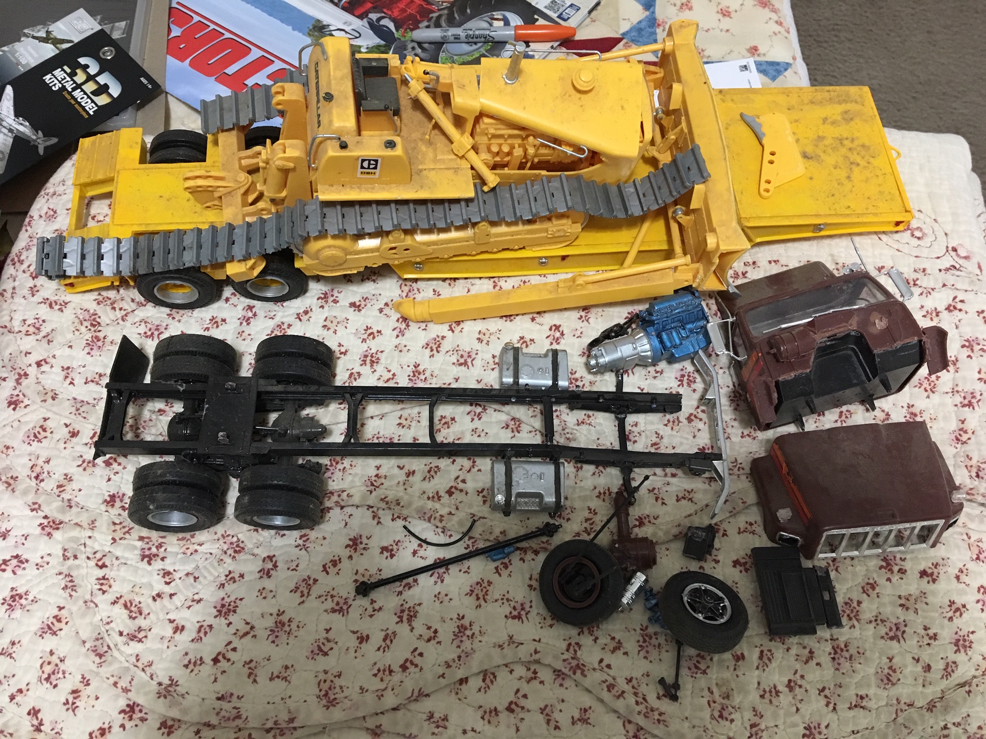

So, this will be my build thread for the B.R.B.O. I am starting with a pile of someone eases problems. I got these kits in a deal from a forum member here. Very happy with the stuff I got and in it was these 3 built up kits. All have some bit of damage, all 3 need to be rebuilt, and lucky for me the Cat D8H was never painted, the cab/body of the F2674 was never painted and the trailer was painted, but done well.
The D8H will not be completely disassembled, I am afraid I will break too many parts. So, I plan to do as little disassembly as possible. I will remove the engine to paint and detail it. Then I will paint and detail the rest. Lucky for me, these things came from the factory all one color, so there is no need to break it apart.
The trailer will go for a dunk in the pond, get stripped and redone. I will pull most parts off, but leave the main deck together for painting.
The truck (F2674) is going to require a lot more work. Just getting this thing apart is going to be a challenge. It is a mild glue bomb. Nothing that will require too much work to fix, but still a chore to get it to a point that I can start the rebuild. Also the frame has been broken and will need to be fixed. With it being in pretty good shape and as hard to find as these things are I feel it is worth it to invest the time in a proper rebuild. I think all the parts are there, we soon shall see.

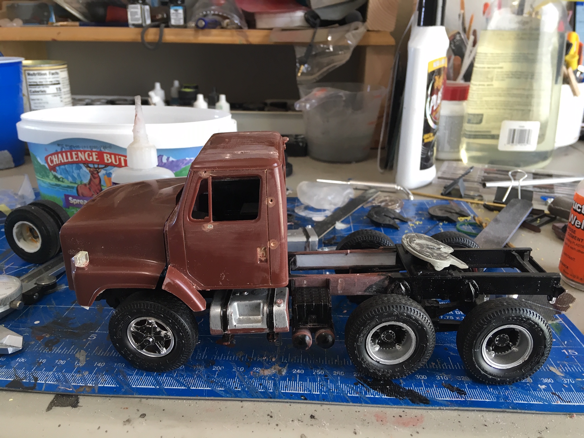

So, work has been moving ahead on these, however it is evidence of my ADHD, or schizophrenia. A little here, a little there.

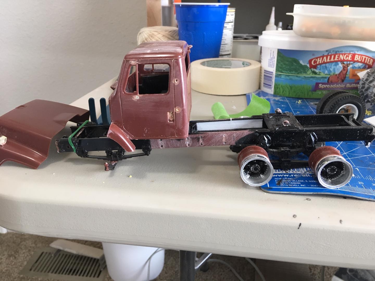

For the truck, I have shortened the frame, it was way too long. I took out 2.5in. Had to repair the frame from the damage it suffered being in storage. The front spindles were broken off and the wheels were glued on solid. I had to drill out one of the axles just to get the wheel off and make a new axle stub. I then had to drill out the king pins and make new ones so the wheels will steer. Everything on this truck has needed major clean up. I am not fond of glue bombs, but I can't buy one of these, so I have to fix it.
The front wheels are way too wide for the tires in the kit. I too 1/8in out of them to narrow them up and make the tire fit correctly.

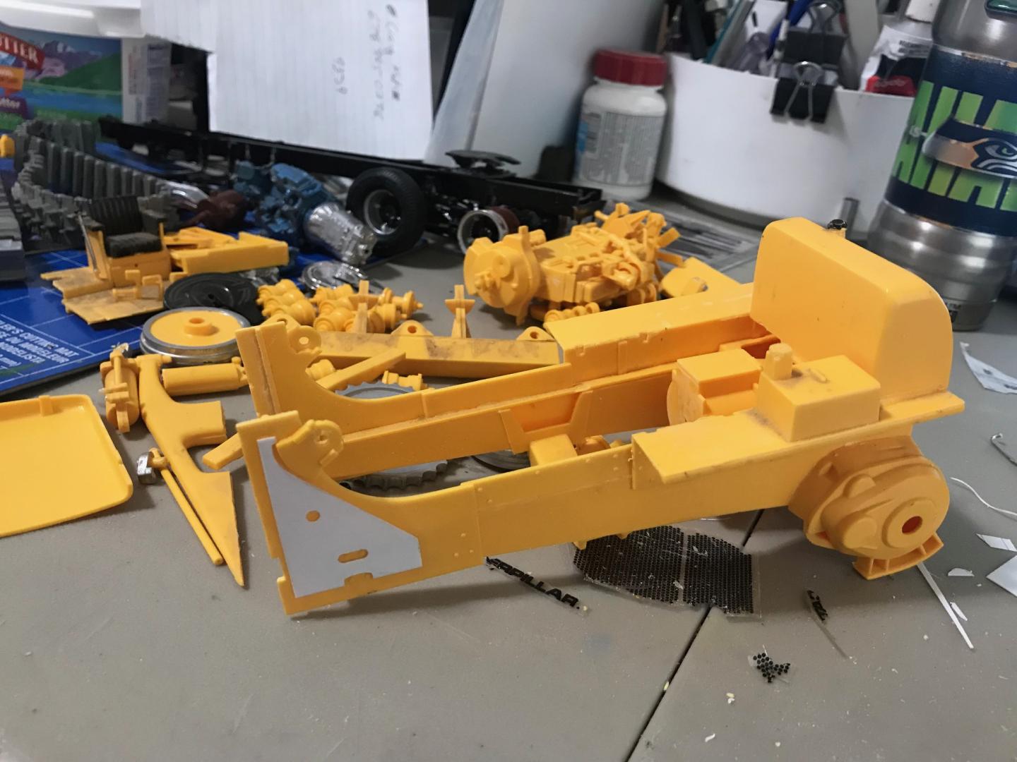

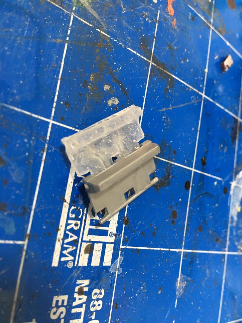

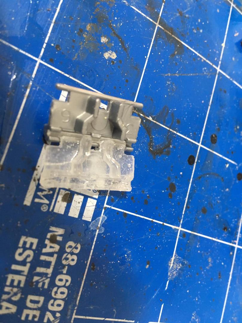

For the dozer same thing has been happening. Its a glue bomb too. I had to make a new track link as it was missing one. I made the mold from a good one using the thermo plastic that you heat in water, then some epoxy resin from Ace Hardware. It turned out almost perfect, just a few air bubbles that will not matter, its a track and should look a little chipped up.

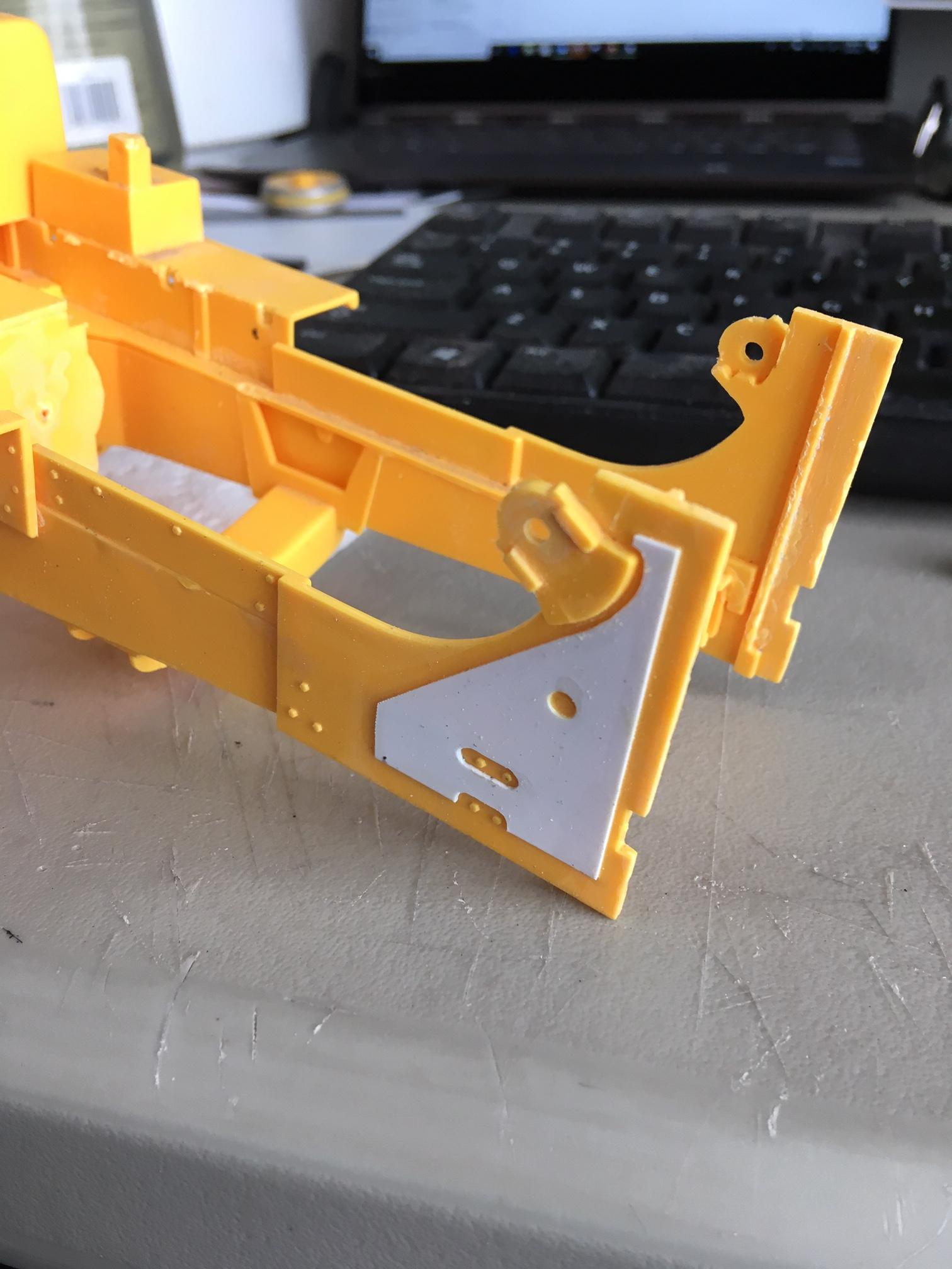

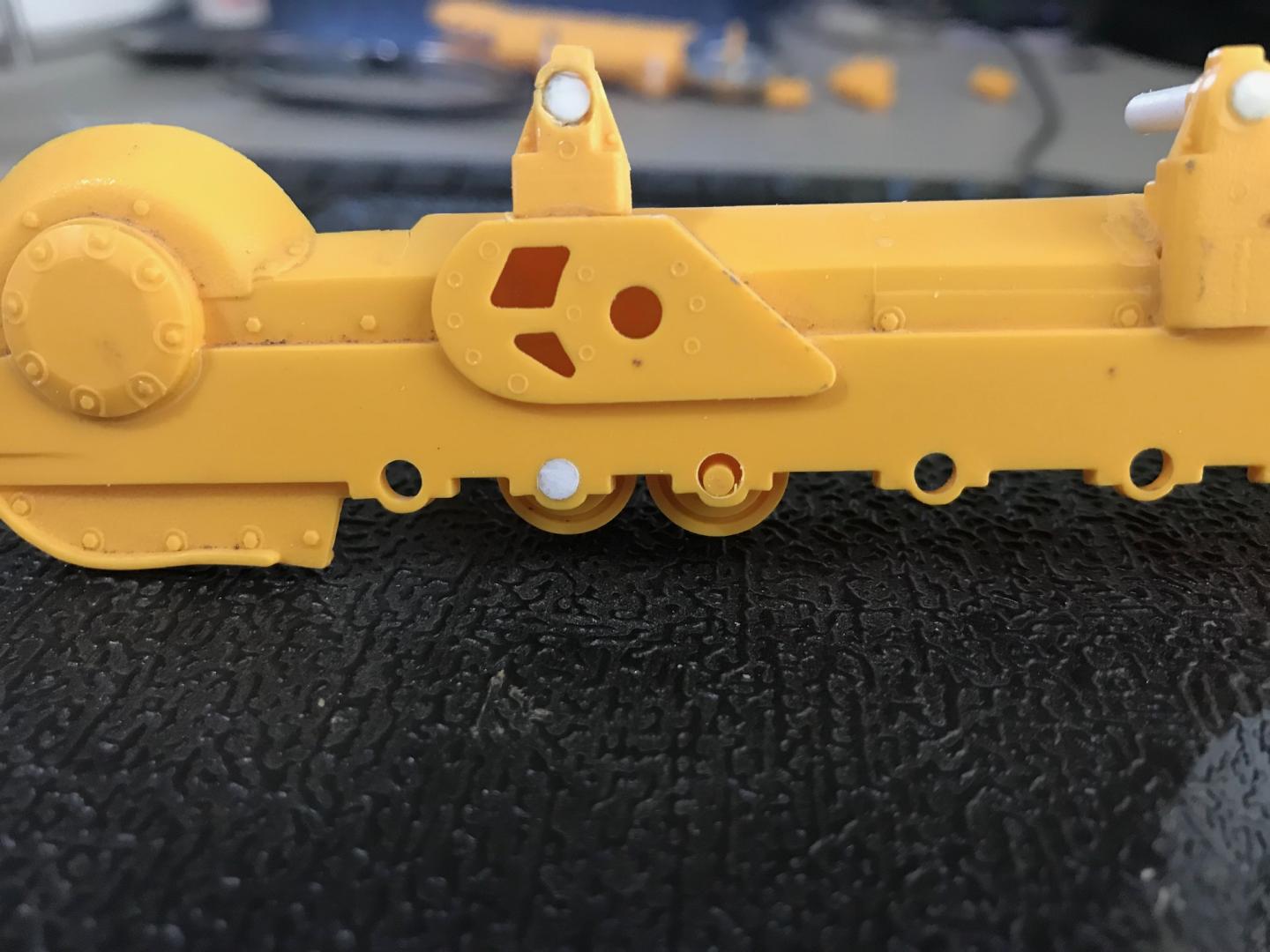

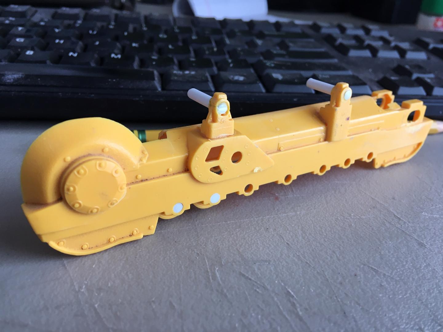

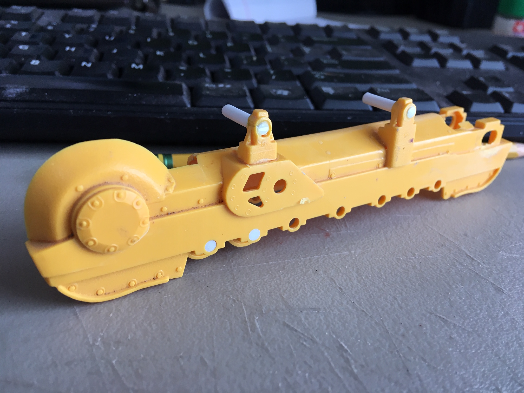

I added the weight plates on the front, the kit only has an outline of it. I am also fixing the track rollers. The holes where the bearing go is way bigger than the shaft on the rollers so they just flop around in there. I have been drilling each roller out and inserting a 1/8in rod, the same size as the hole.
I have also done some work on the drive gears. The edges are very sharp, but in real life they are never sharp, but very rounded and worn. So, I have taken all the sharp edges off. I will also be adding a ring of bolt heads and cutting the segment lines into them.

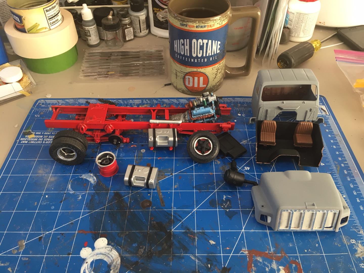

So, in trying to keep up with the at least one update per month rule, I am adding this. I have been really bad this month about documenting things, but here goes.
The engine was mostly assembled, I took apart what I could without breaking anything and cleaned it up, put it together and repainted what needed it.

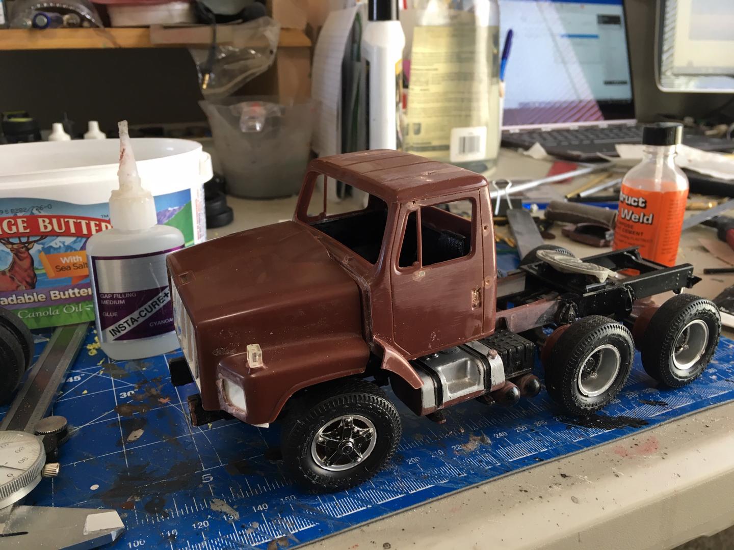

I finished the chassis shortening and had to make some new brakes cans as I lost one, then of course found it after I painted it.
A lot of work on the fuel tanks, wheels, and other parts. The original builder saw no need to sand or scrape off any flash, sprue connections or mold lines. Spent a lot of time fixing that and then painting.
I tried really hard to get the seats out of the interior, but they were going to break into a million parts if I kept at it, so I painted them in place. Also repainted the interior tub. As a fleet truck it would likely have been white, but due to the difficulty and lack of interior details, I went with basic black.
I have several coats of primer on the cab. It was not too bad, but there was a spoiler/deflector on the roof and it left behind some holes and glue marks. These needed a lot of attention. Decal removal also left behind some roughness that needed sanding out.
So, the truck in moving along. If the snow would stop I might be able to get the cab painted.

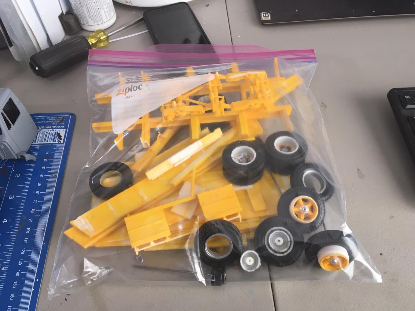

The trailer is in the bag, literally. I broke it apart so I could fix many issue that the previous builder created. I will have to remove a ton of mold lines and fix fit issues before paint.
I should have started with new kits, it would have been easier, however I did not have an extra $120-150 to go get new kits. Anyway, these needed rescue.
As for the dozer. Not much done there other than getting another one. The one I have has quite a few broken parts or missing parts. I needed a way to recreate them without spending huge time or money. So, I was offered another full built kit for a trade of something I had. Now I have everything I need to copy any broken or missing parts for the first kit and still be able to build a second one down the road.
