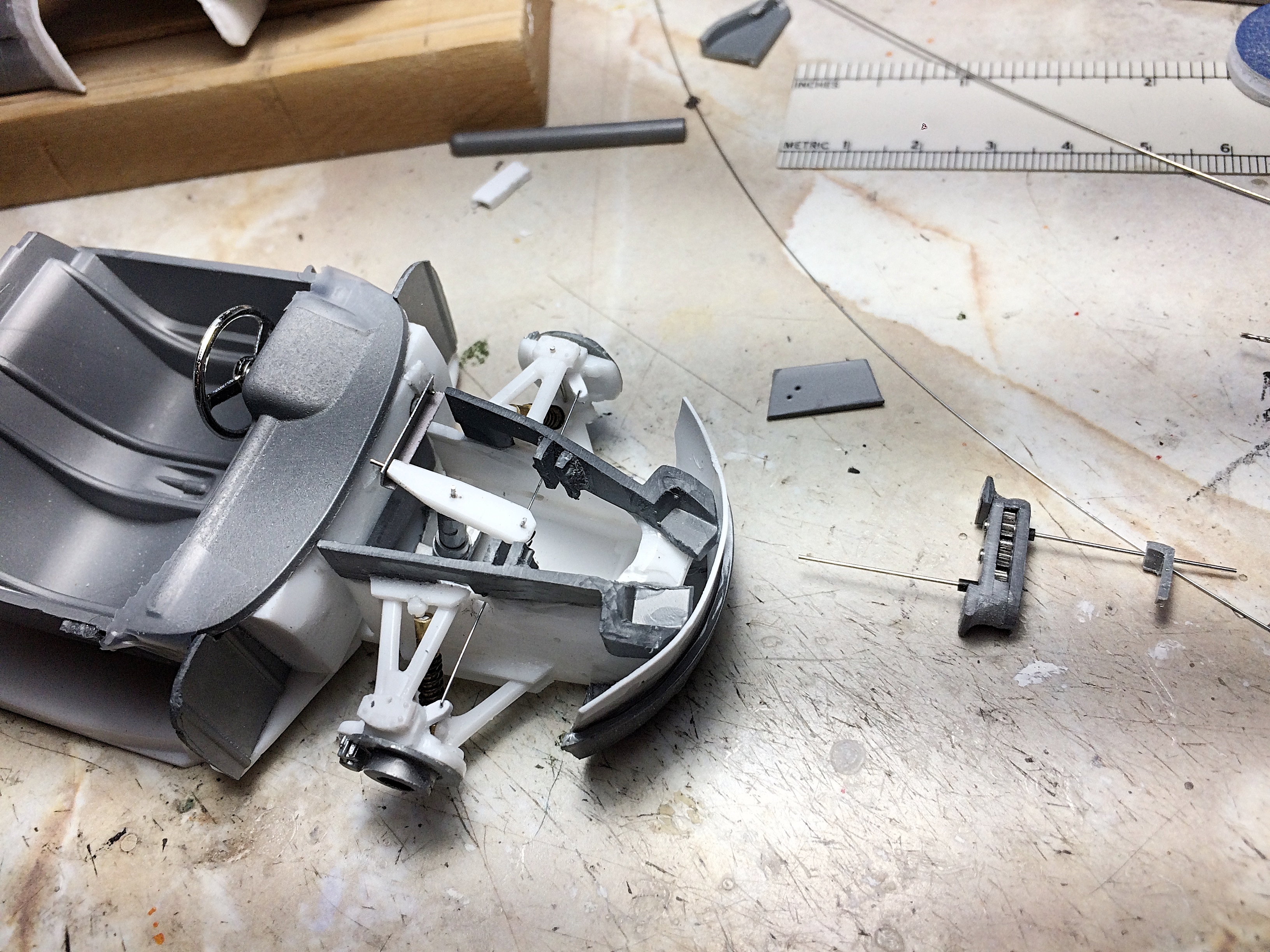

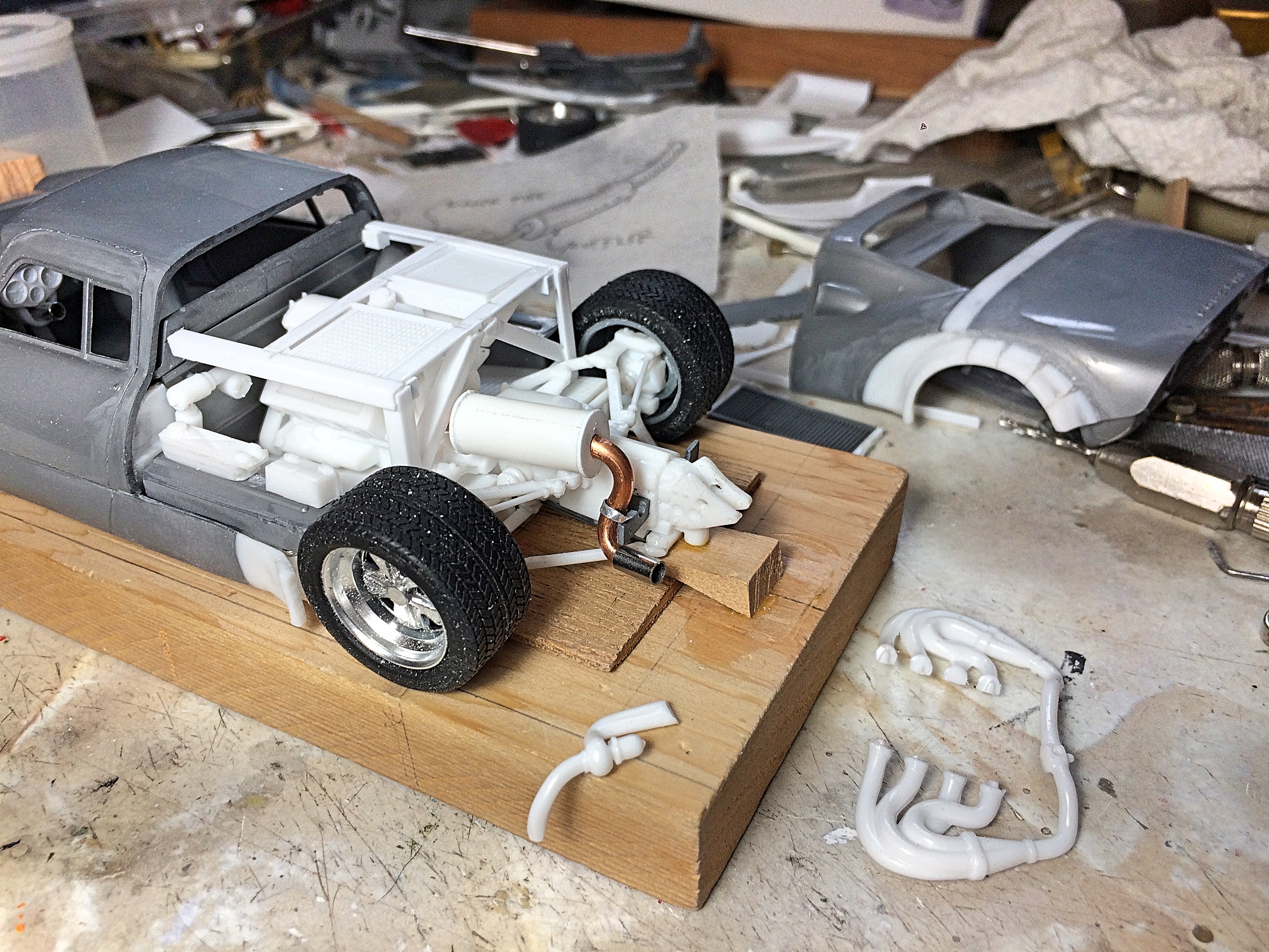

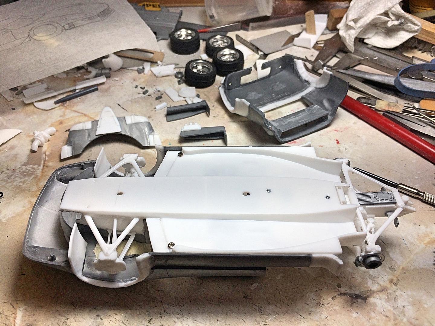

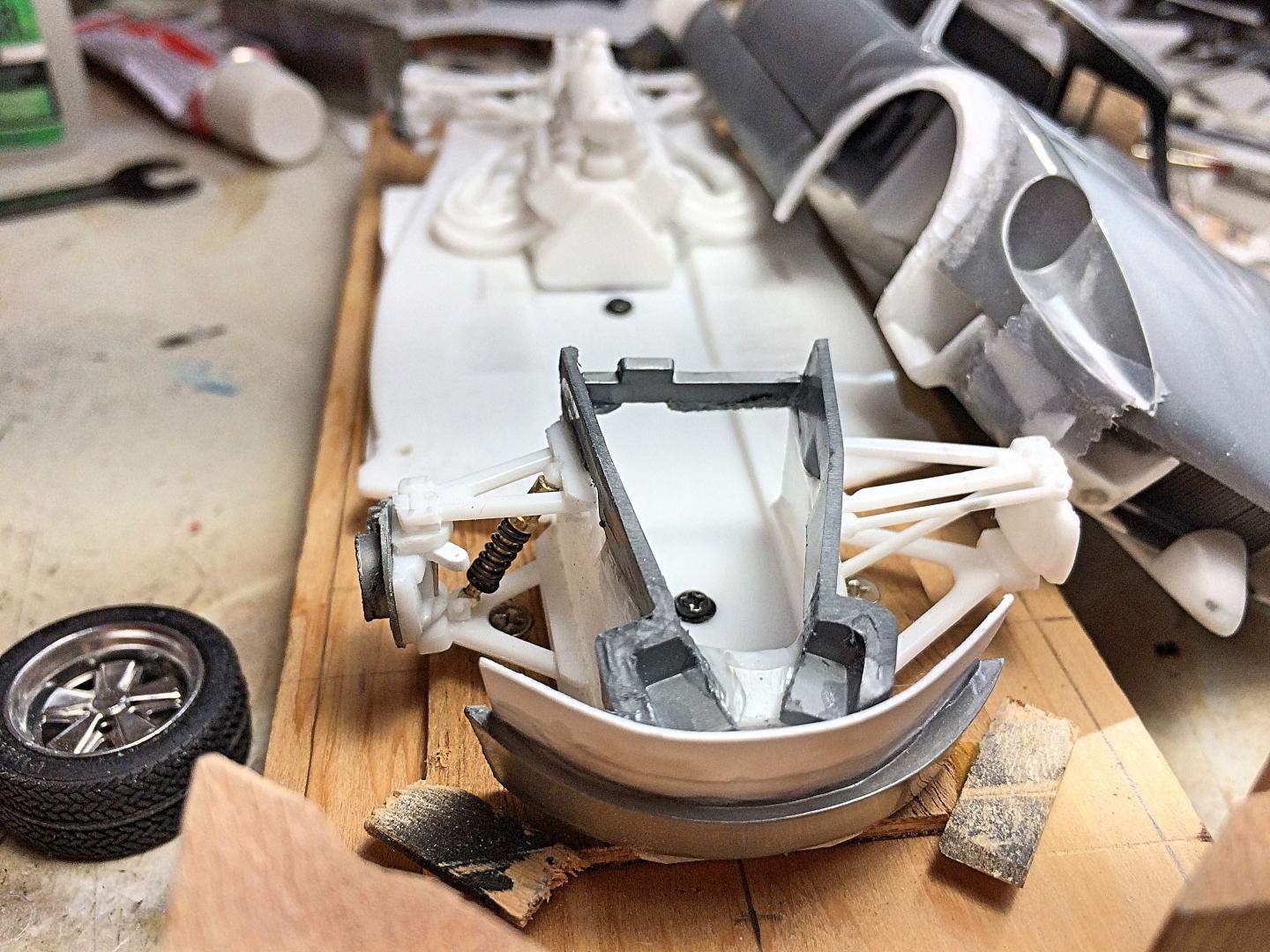

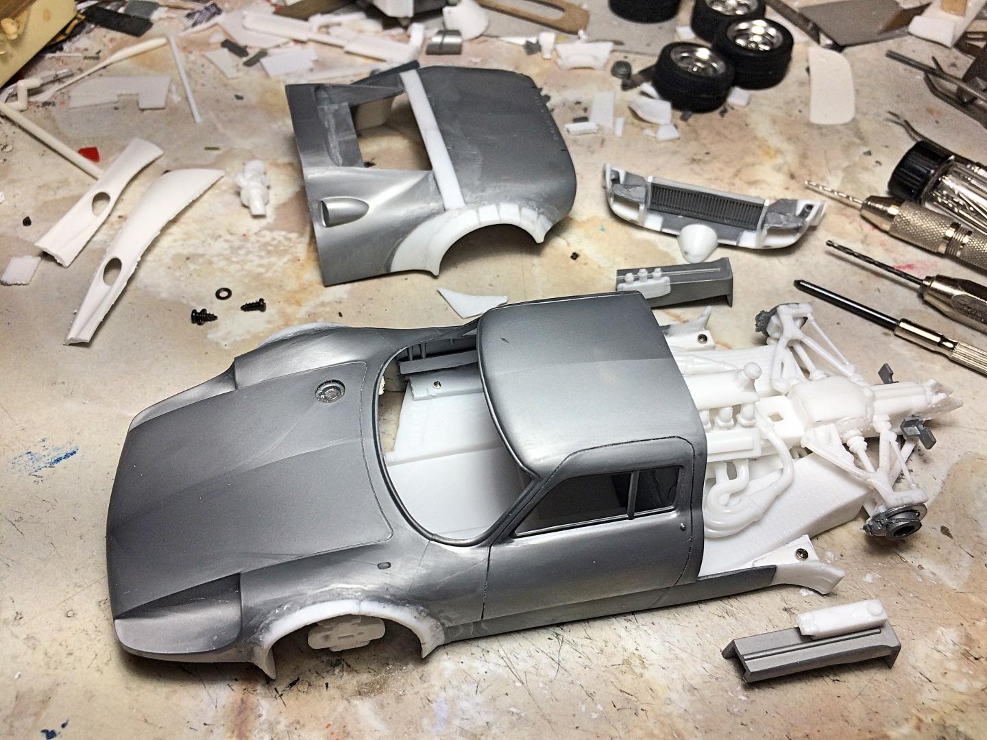

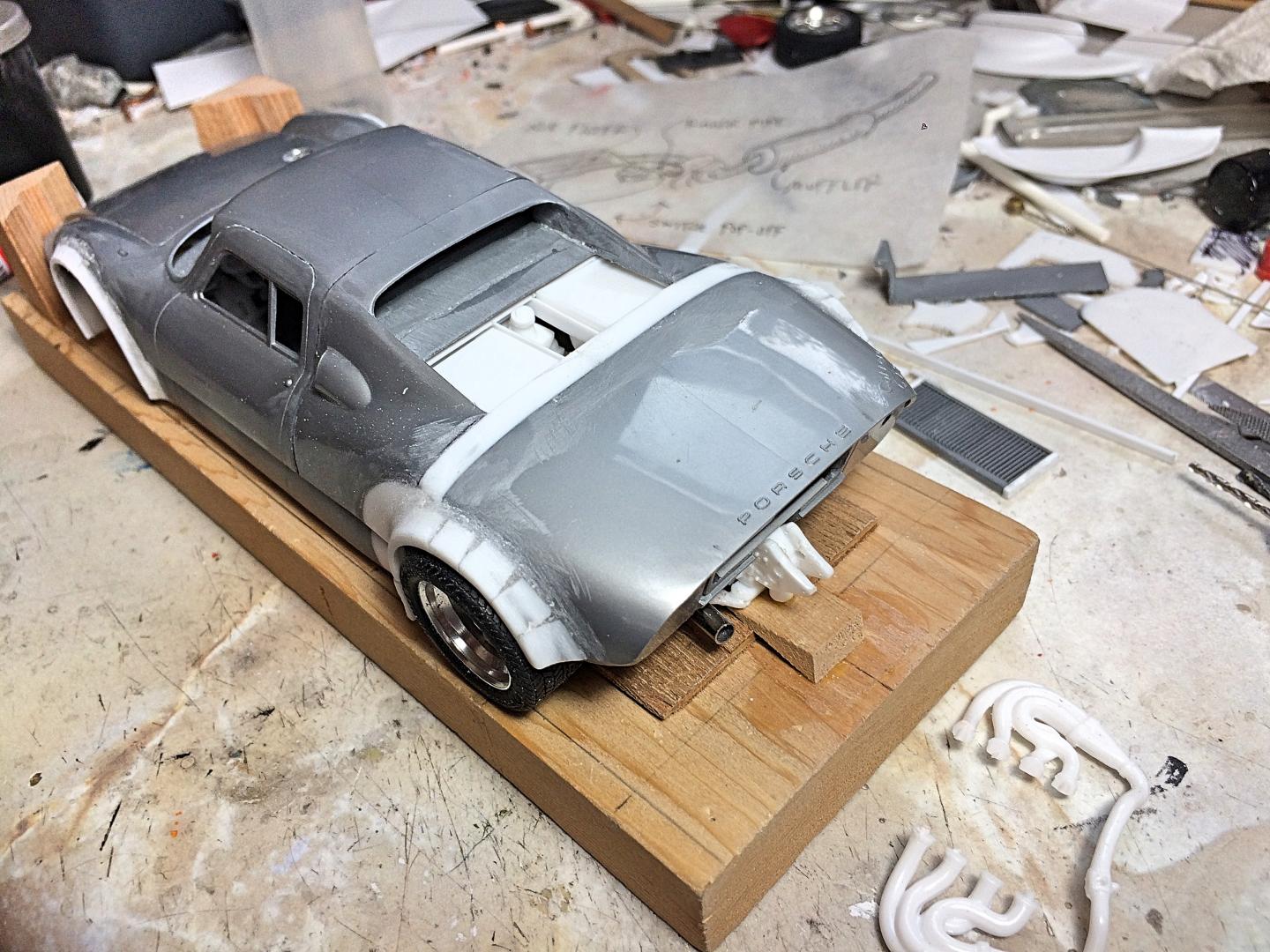

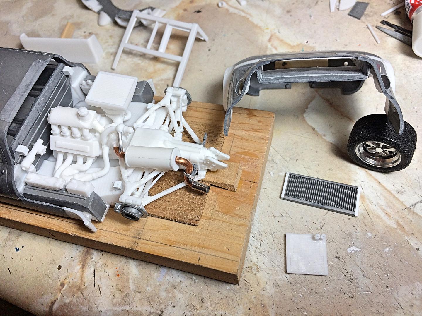

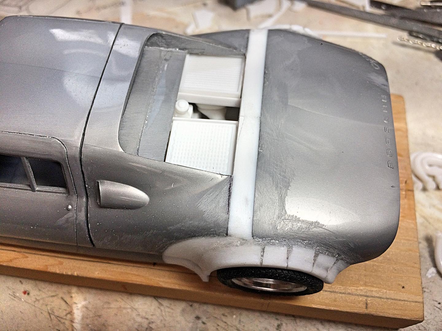

Cool, can post pictures again!  I have some catching up to do.  Here I have chopped up the 904 chassis pan, and used for bulkhead.  Front clip has been modified.  I repurposed the deck grill into the radiator, when the photo-etch radiator face goes over this, it should be killer!
Made the two side box bulkheads, which will hide the body/chassis screws.  Opened up the rear for a grill opening, and made rear mounts for the transmission.  I have also screwed the engine to the chassis.

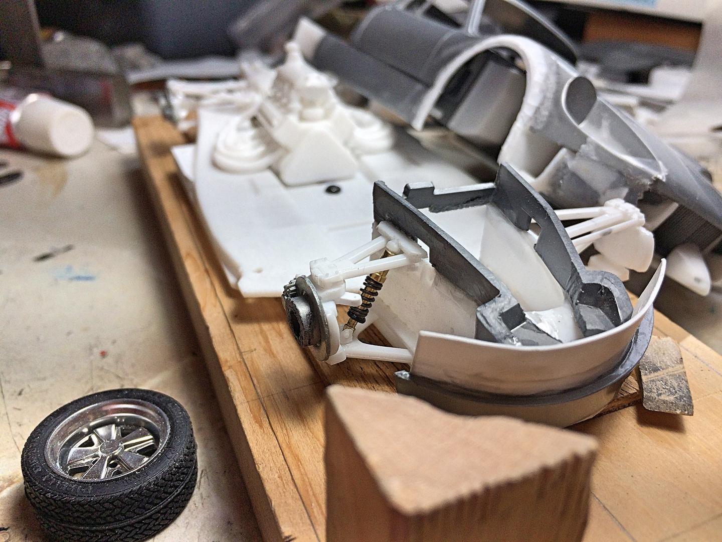

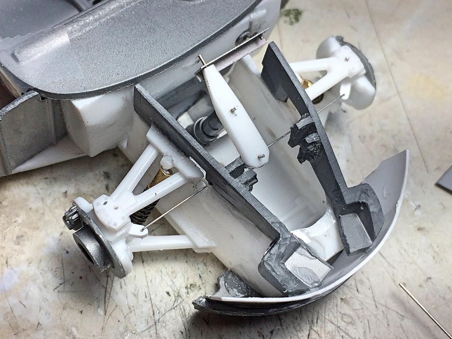

Front suspension is modified.  The race car spring setup, no clue how that worked, I reversed the action arm direction, and added the cheap lighter valve spring/shock unit.  I also made it steerable, the race kit did not.  I added some to the fender flare too, which is Dremel shaped to a closer gap.

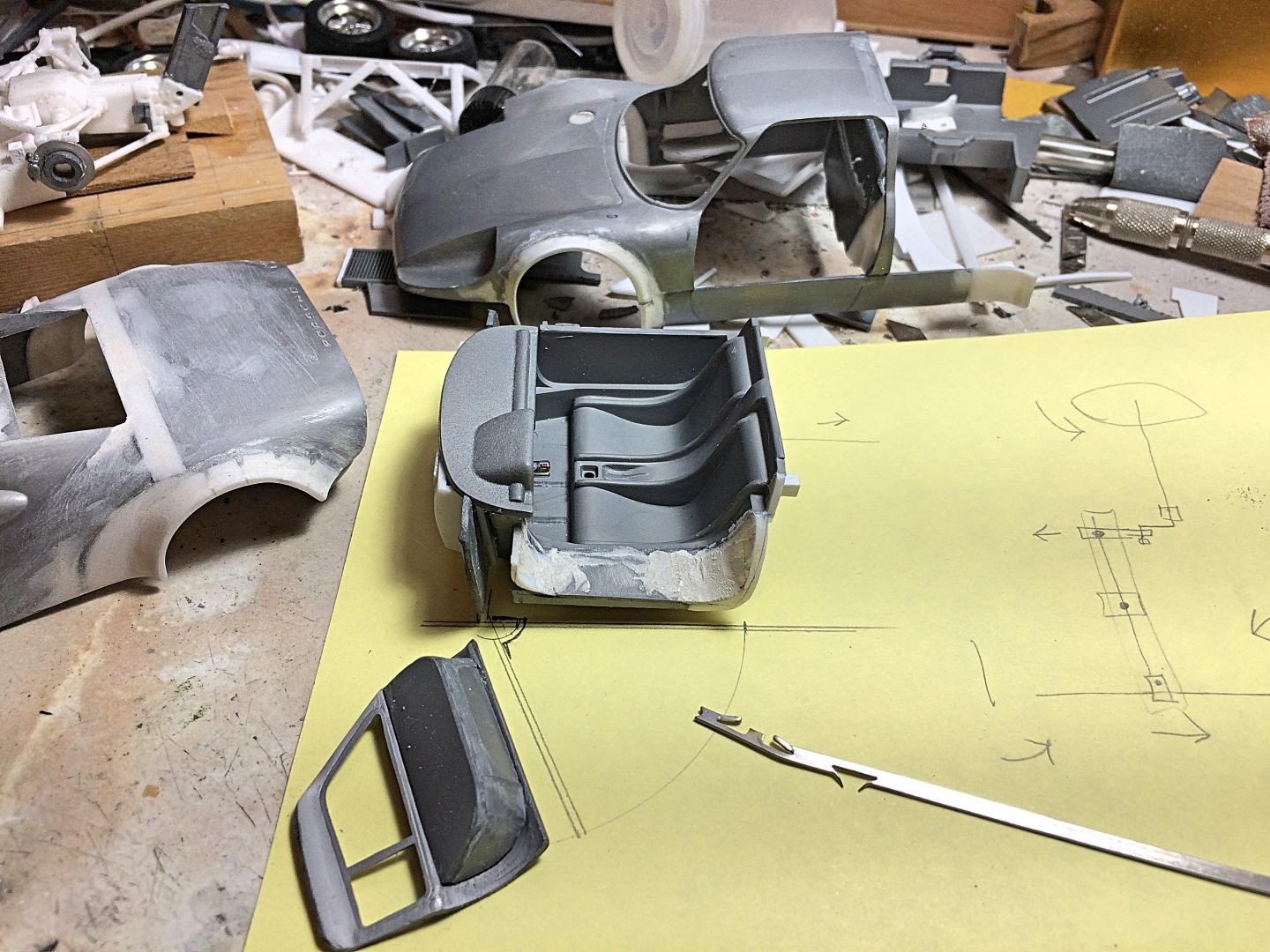

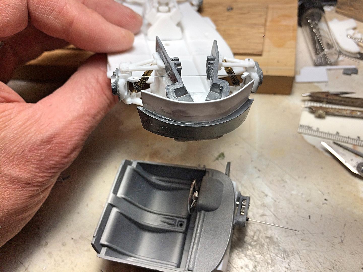

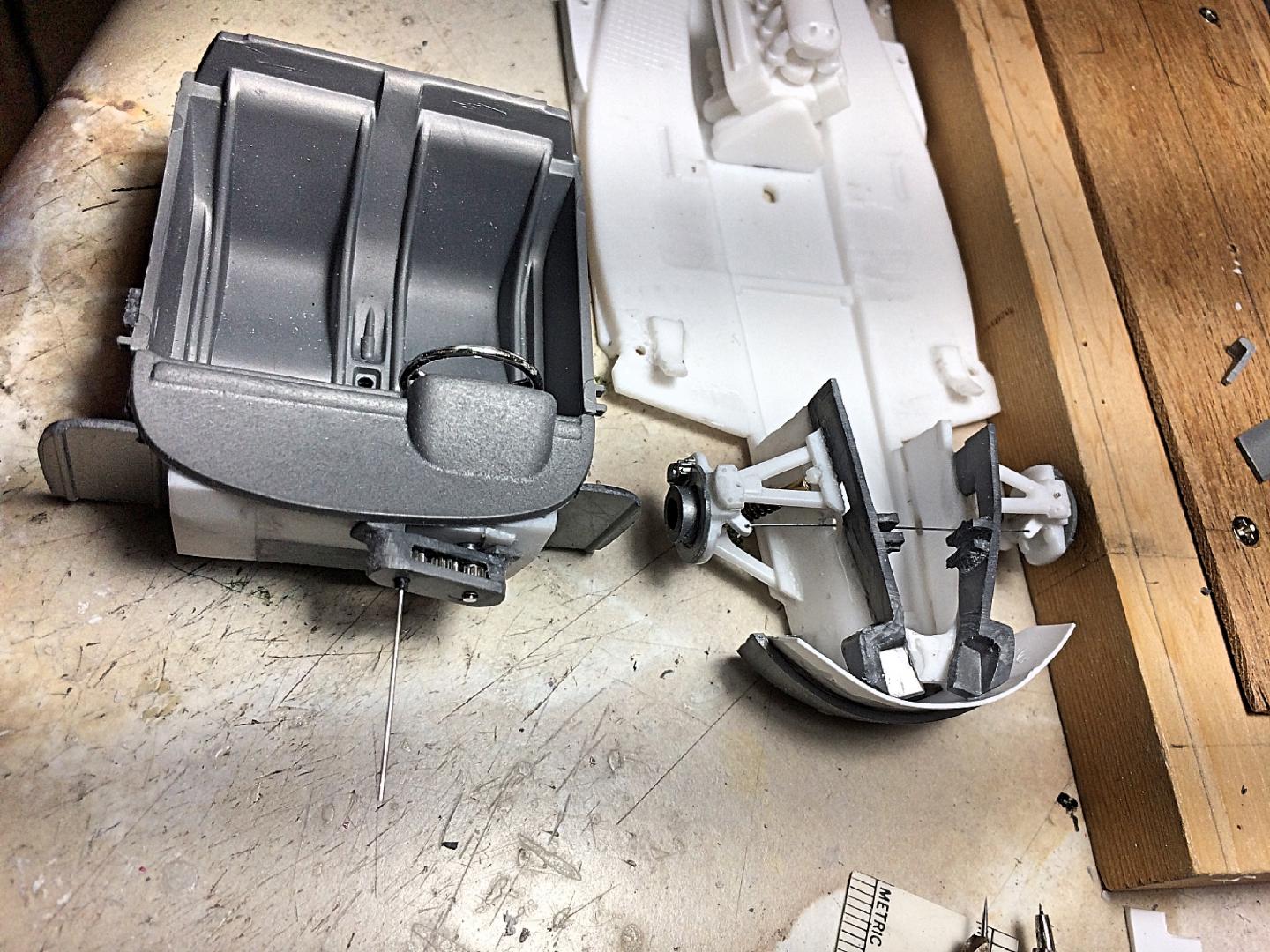

Just for giggles, I wanted the steering wheel to also turn when the fronts wheels are turned.  I made a gearbox, but ditched it because it was not working smoothly.  I figured out a lever system, it's hidden when complete so it does not need to be realistic.

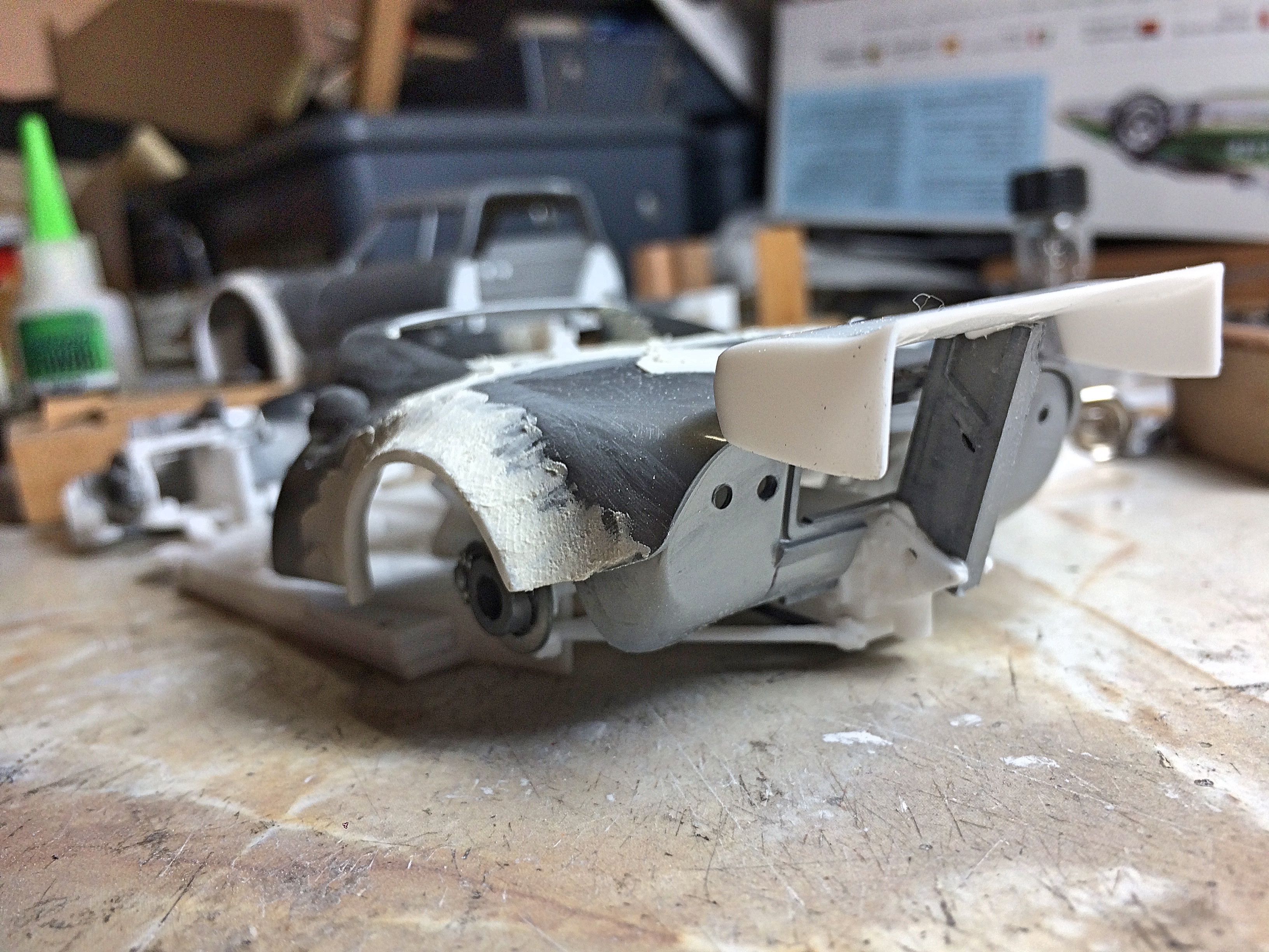

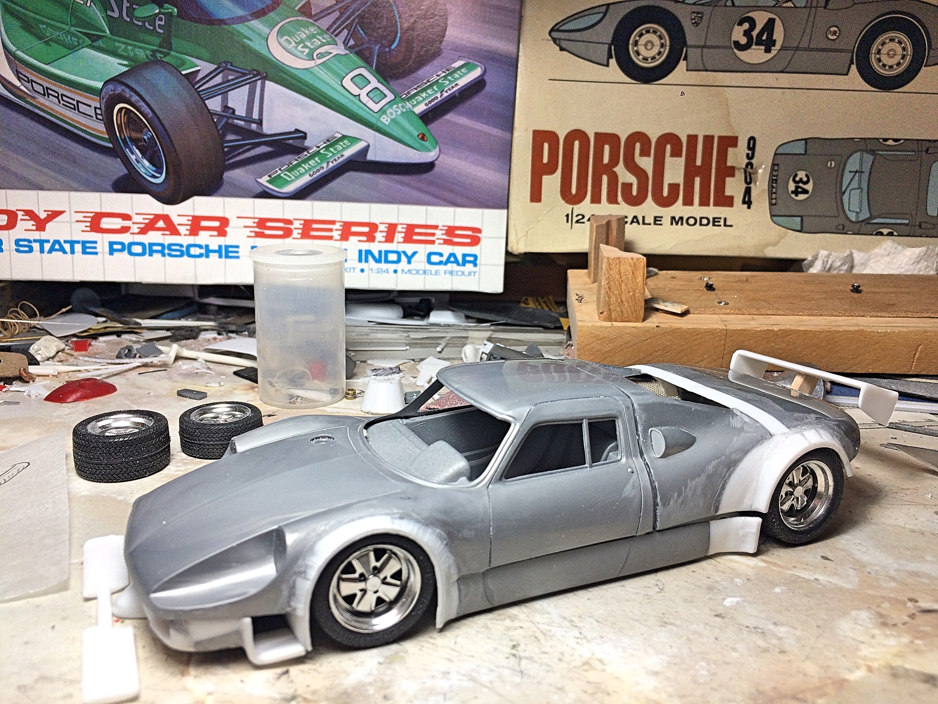

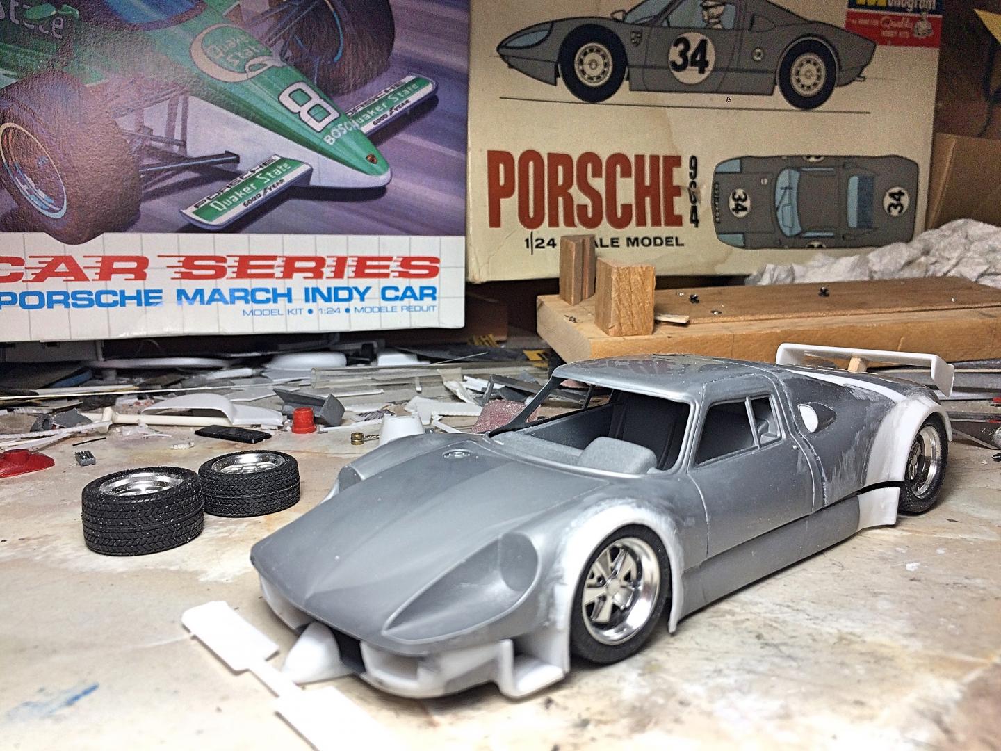

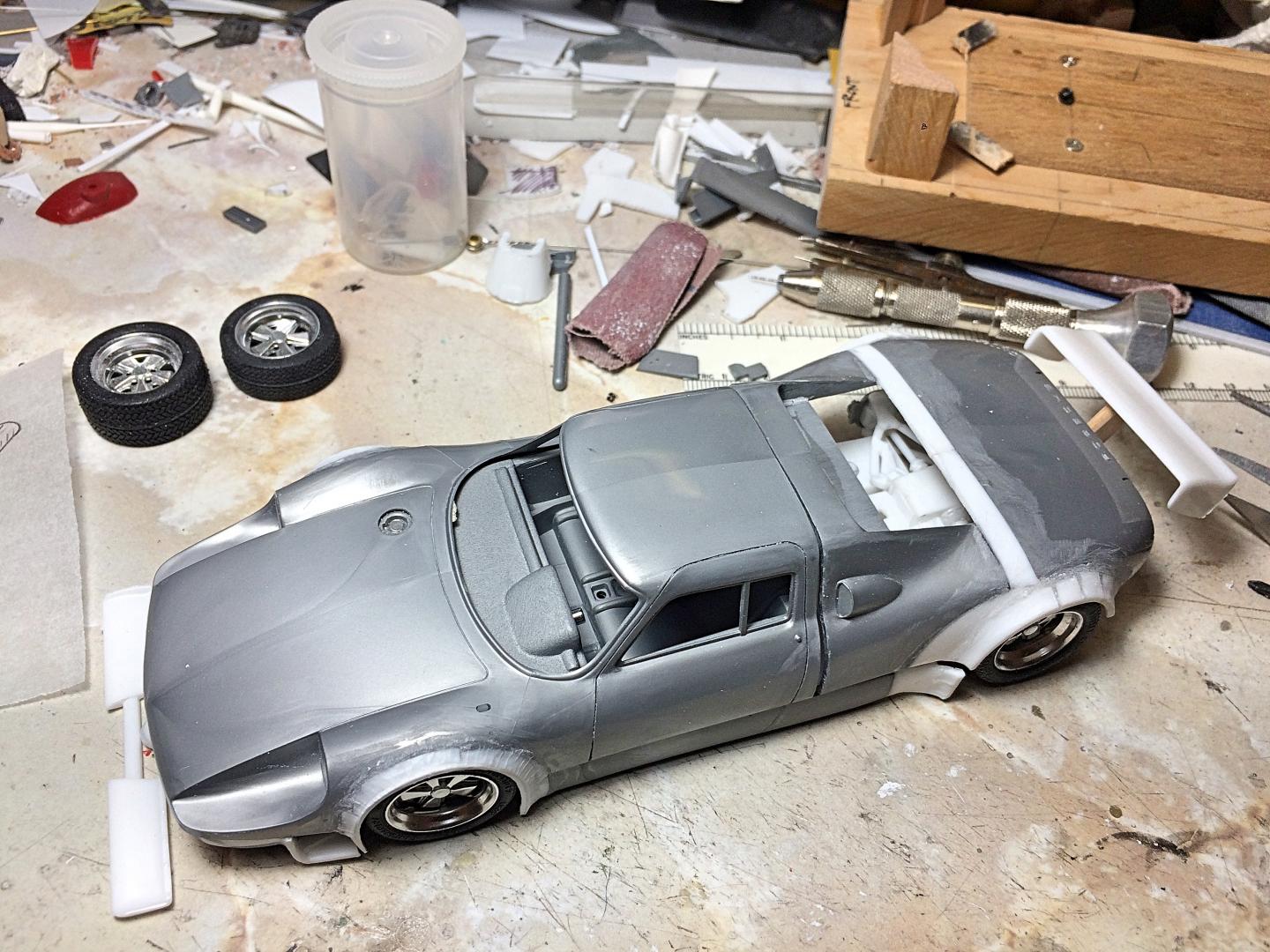

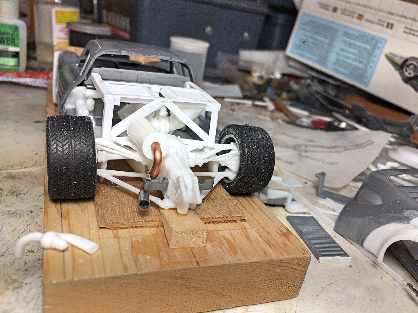

The basic concept has come together pretty well.   The jig has helped, but every time I unscrew to work underneath or to look at it, and put it back on, a slight shift happens, so it's not perfect.  I'm still thinking about using the front wing, is that too crazy?
The engine bay, the Indy car had to fit everything into a narrow body, this is like a warehouse!  It's not elegant design wise, form follows function, but it looks like a fire lookout tower. :lol:  The oil cooler is set on the left side, what was the radiator is now a flat air filter on the right side.  The exhaust is one piece of copper wire, fabricated the muffler and put on before bending the back end, then slid into position and glued on.  The tip is stainless steel tubing, happened to fit perfectly.  Aluminum plate for a mount tab.  I re-routed the waste gate exhaust into the main pipe.  I had to raise the deck behind the window up a little, decided to keep the same air scoops but opened up, added a slot scoop at the roof trailing edge.
I will have photo-etch grills, have not decided on which pattern yet.  Need to make different taillights.  Interior needs some work.  This is at the rough Dremel shaped stage, no sanding/filling/more sanding yet, that progress won't be obvious.

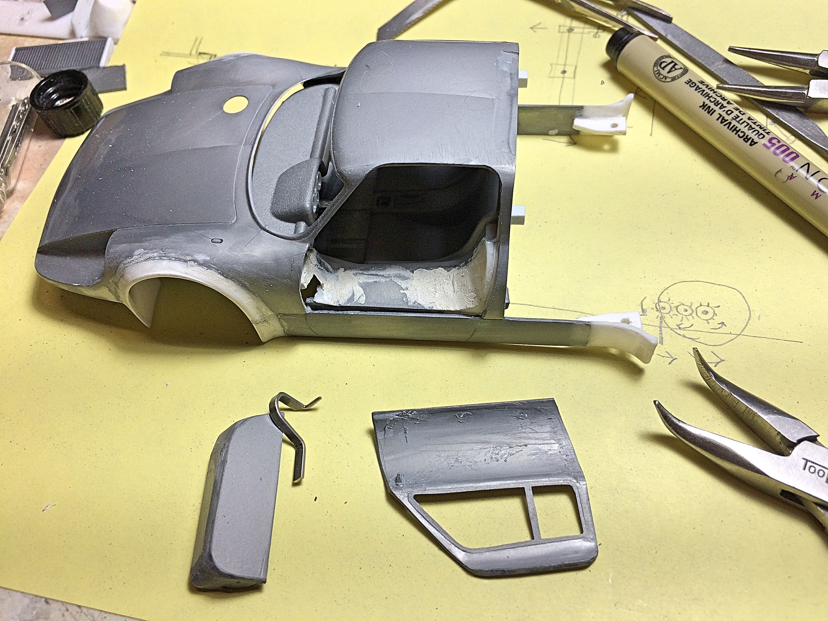

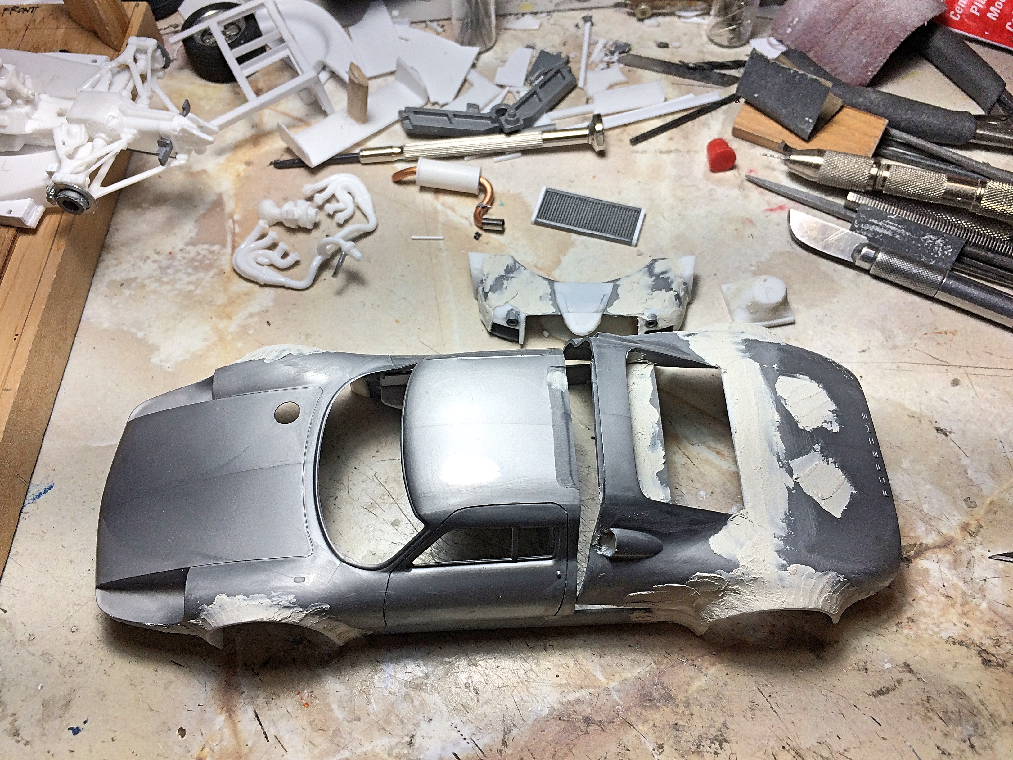

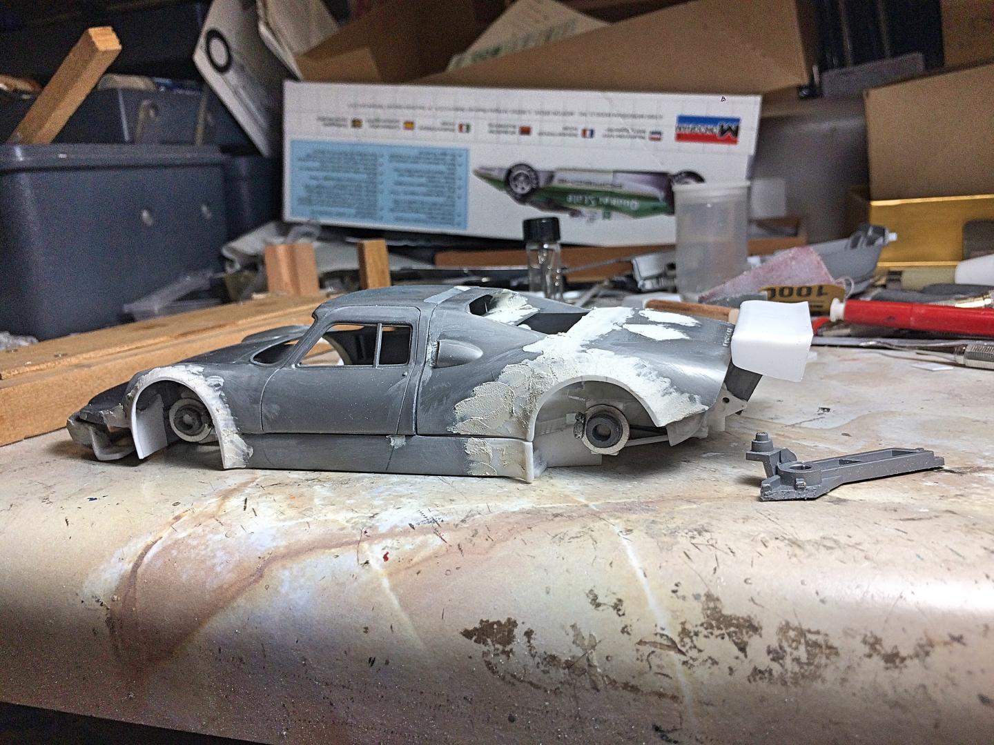

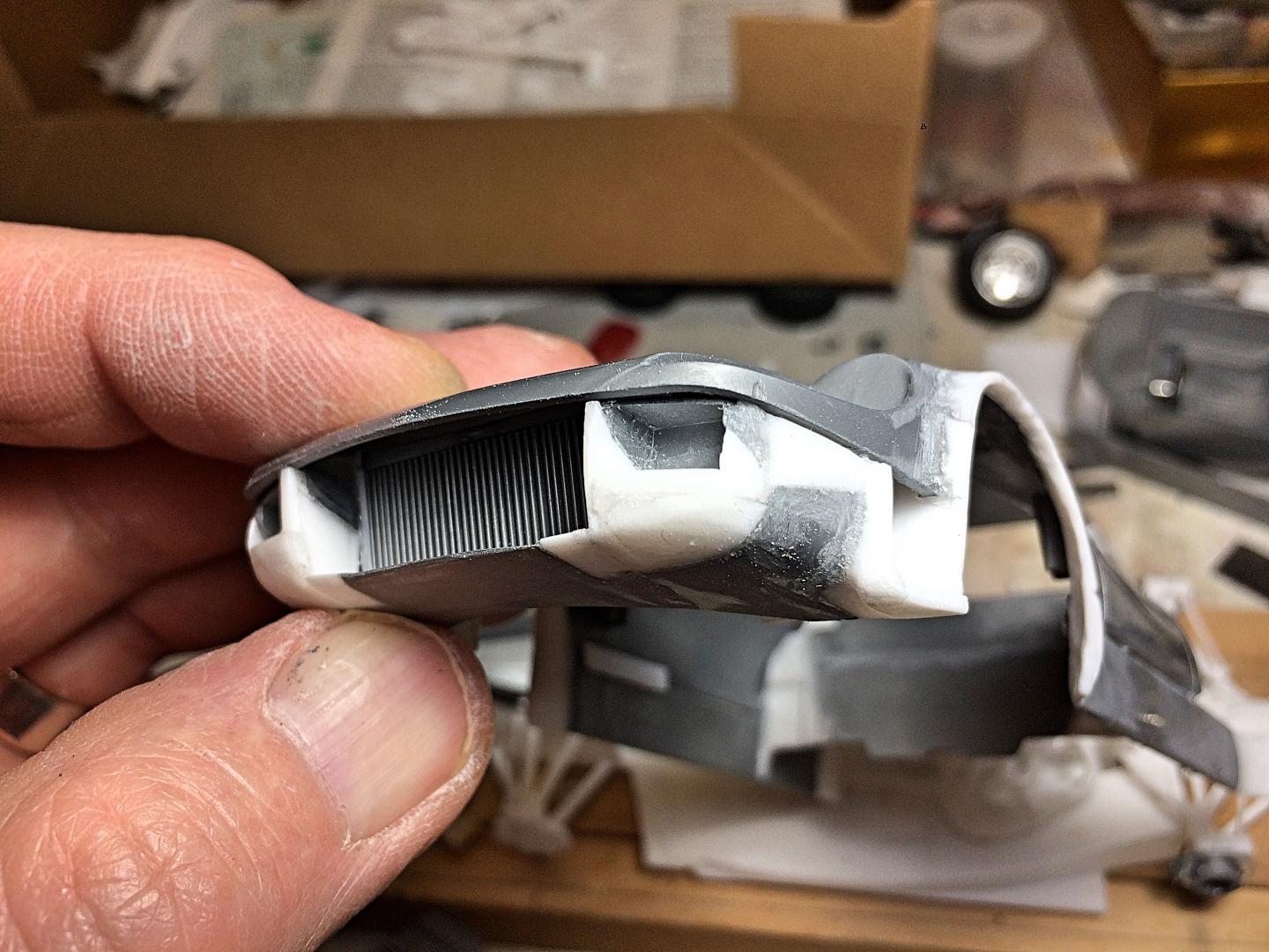

I'm finally to the putty stage!   I soaked all parts that had baking soda added to the glue in water, to make sure any chunks get dissolved *before* painting.  I slathered Squadron putty everywhere, 95% is going to get sanded off.
It's not obvious, but wanted to use a vent detail from the chassis pan somewhere, so stuck in the front wheel wells.  There is a slot-car part that would normally be tossed, adapted for the wing support.  I'm going to make the wing with a hydraulic ram, to act as an air brake.

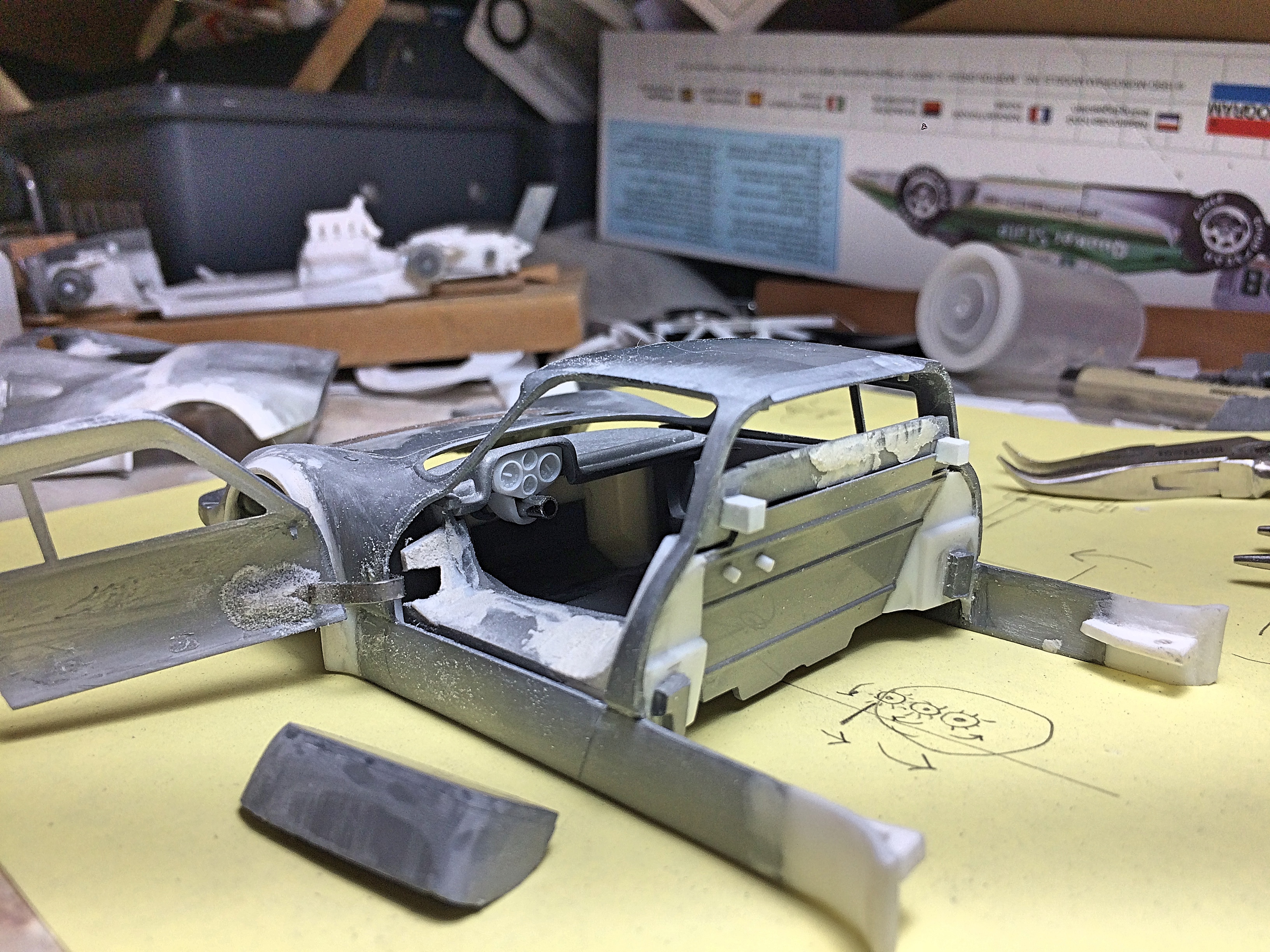

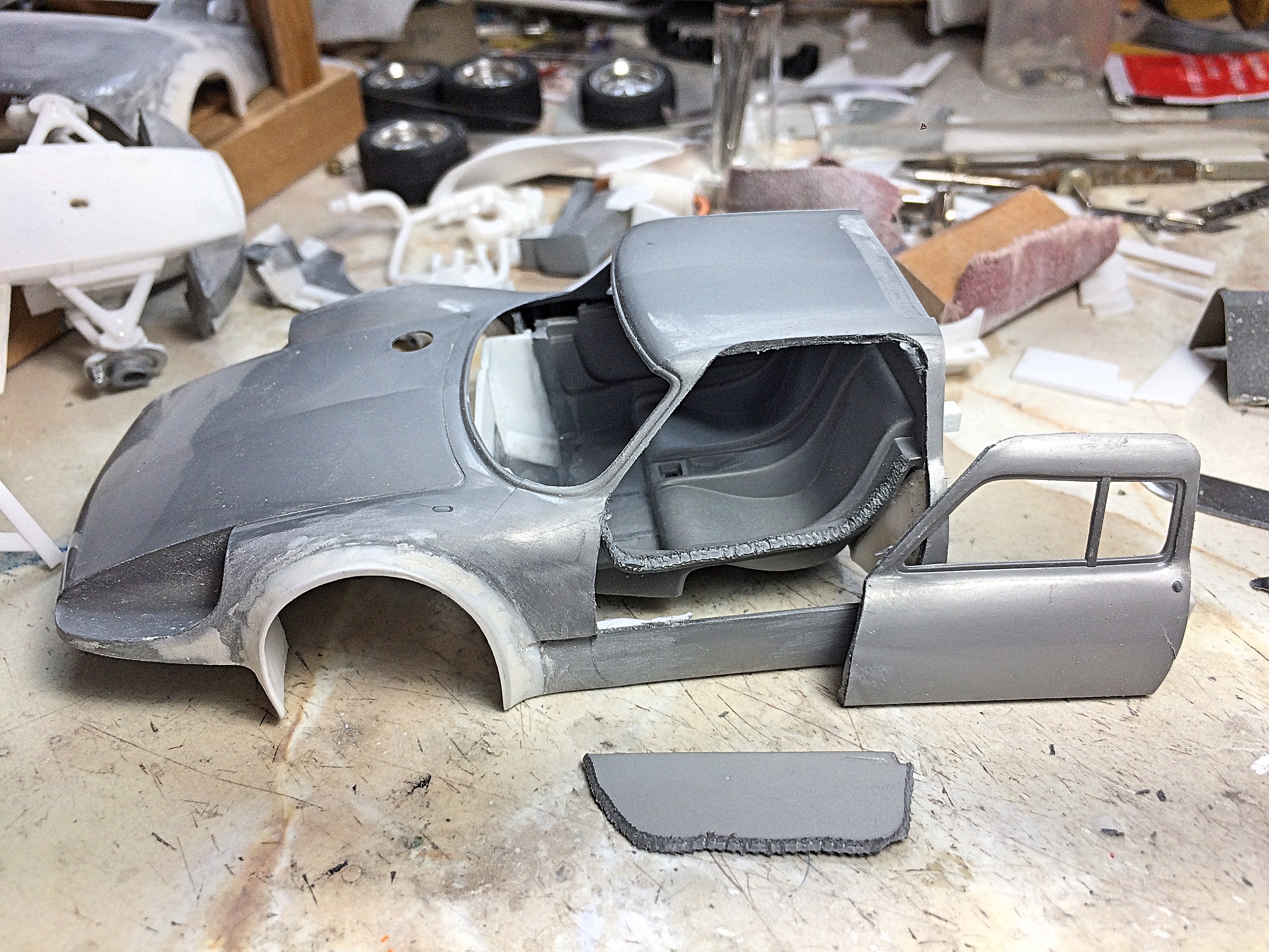

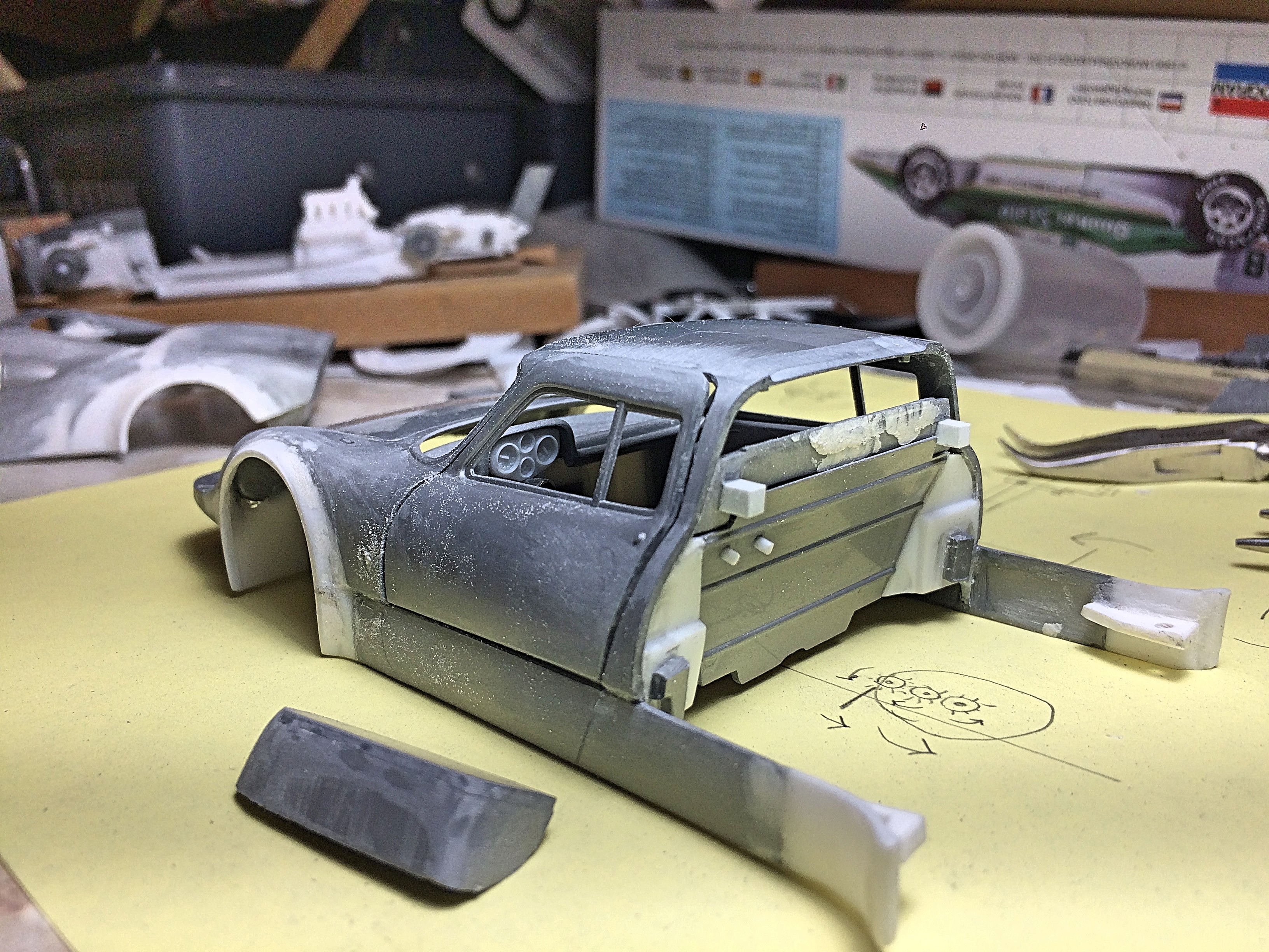

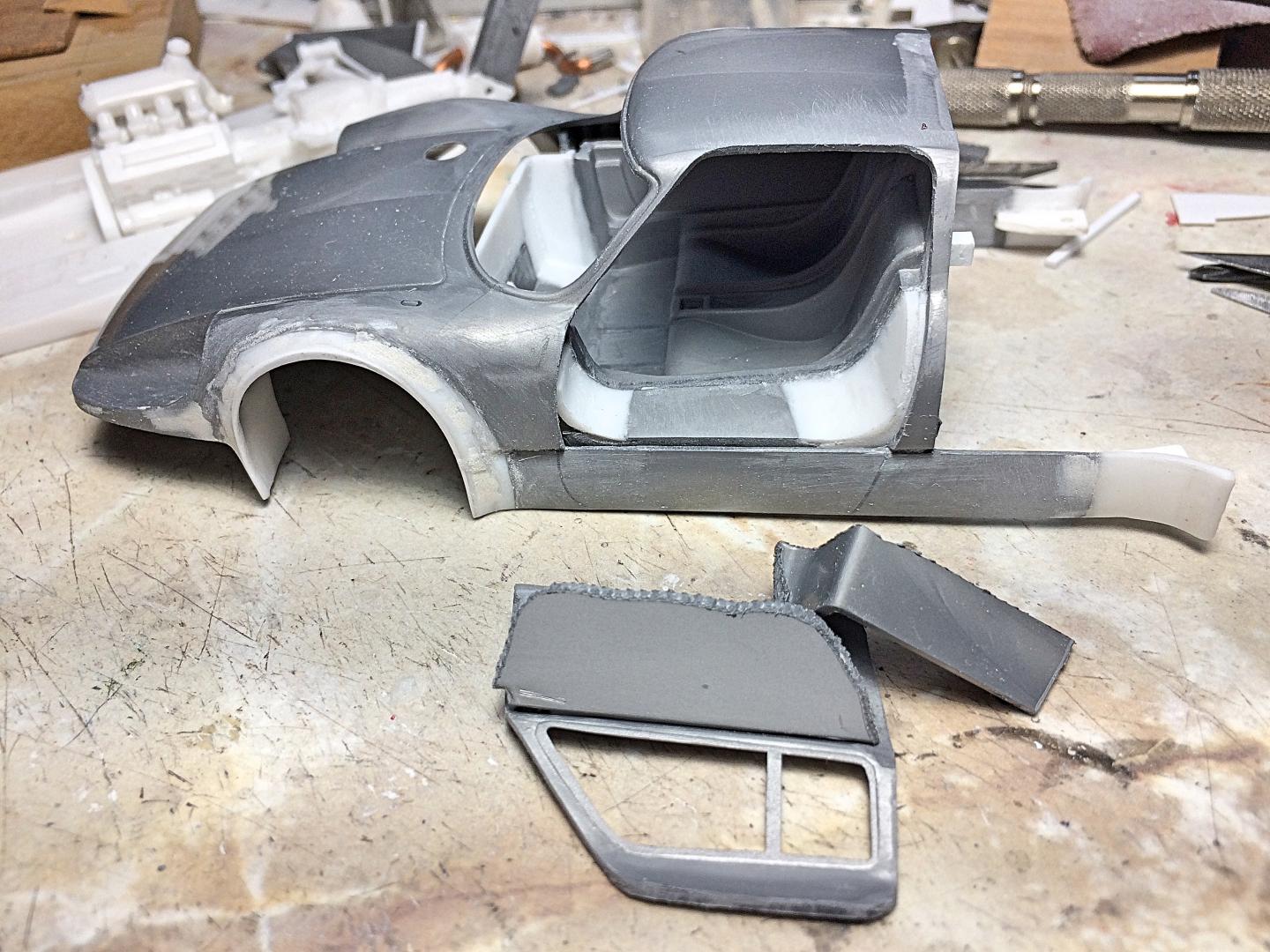

All I was going to do, was rough sand the putty, then thought I should open a door.  I did the usual method of dragging a #11 blade in the door jamb, used the hot-wire to cut the interior door panel in about 1/100th the amount of time.
Superglued in the door jamb, and some tiny pieces at the bulkhead (not seen here).

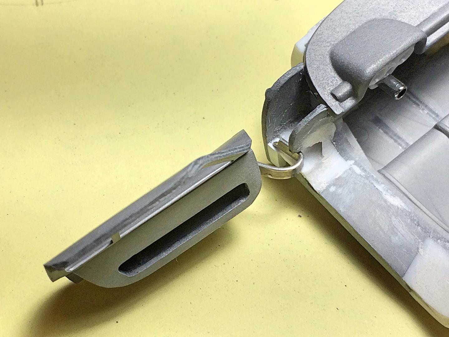

I thought of using windshield wiper stainless steel, that stuff is getting to be replaced by one-unit plastic blade replacement parts, so get them while you can!  I used the Dremel wheel to shape a pin, then bent with pliers.
I was shocked how well this worked, never had a door open this wide without binding!

Last night I refined the door hinge area.  The real car has a really simple door panel, part of the fiberglass body, but I'm contemplating making this look like a carbon-fiber part, with a cable for the door latch release and perhaps add another cable for pulling the door closed.  Also thinking about making working sliding window.  I really should open the other door too, always a trick to duplicate everything in reverse.
