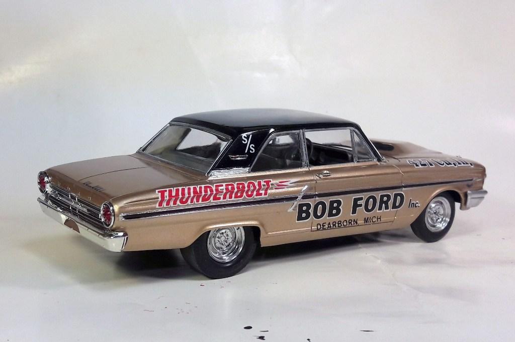

I did this car maybe 2 years ago now, as more of a test than anything to see if I could
A - do it ,,,,,,and..... B - how long it takes compared to BMF work on window trim.
To do all the window trim takes me probably close to 2 hours alone. I think  I had all the window trim done in under 5 minutes with the pen. And once done i sat it aside for a few days and even then handled it very carefully just in case to do final assy of the car. There is no clear of any kind on the chrome.
ALL the window trim ( front , rear and side openings ) is the pen. ( the long body  side trim MIGHT be on this one ,,but dont want to say for sure )
Keep in mind, I don't handle mine.  Once I finish one in the case it goes and 99% of the time it never comes back out.
That said, We  recently moved across country. And  I had every build wrapped in bubble wrap and boxed up to make the trip. I found it and dug it out today . Just for a look see

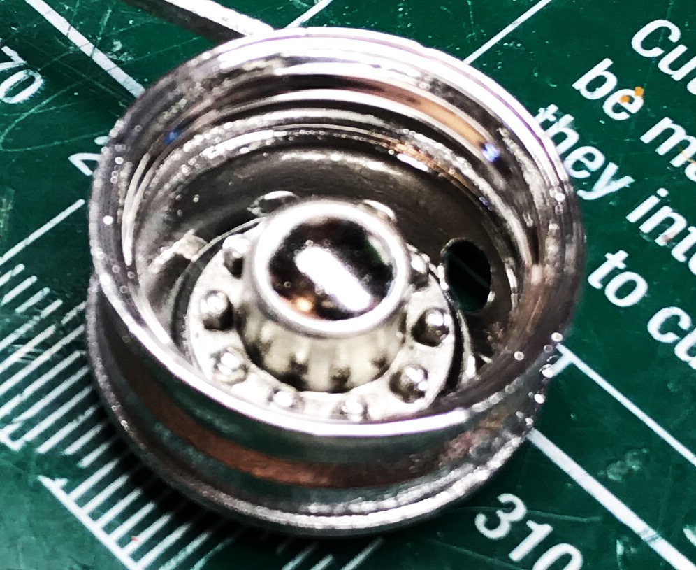

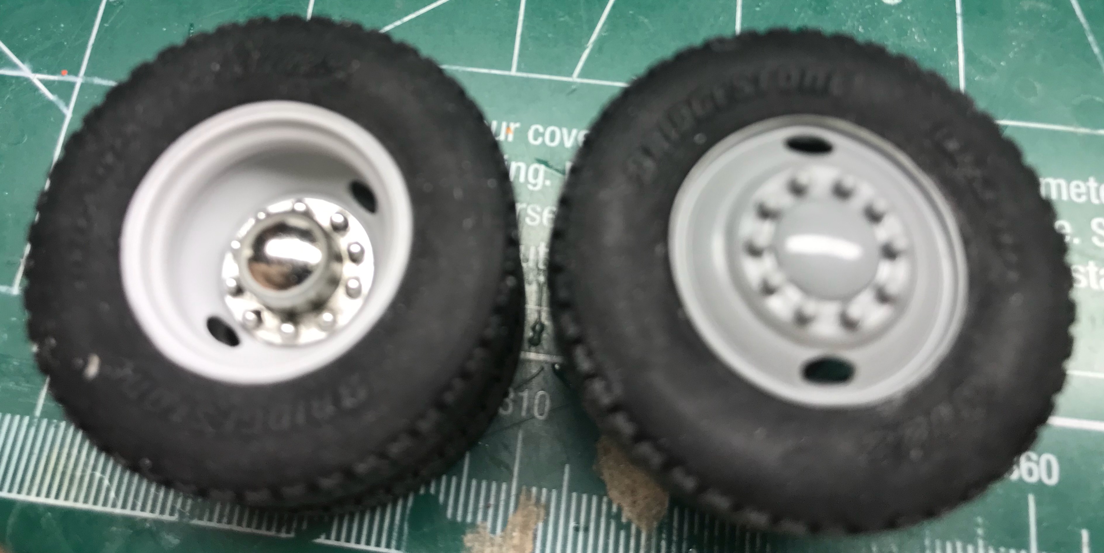

I've used it for a lot of small trim pieces and details, and it worked fine. I then used it for a couple of bumpers and grilles and airbrushed it on. I let it dry for about a week, and today, almost two years later, it looks as good as the day it was applied. I also find that it has a much more scale appearance than overly bright mirror finish chrome. It looks perfect to my eye, and seems to hold up fine. Since I don't build show cars or trucks, I like the appearance with a very bright finish that looks real,
I did airbrush these rims and then brushed some Future over them. The pic doesn't really show it well, but it looks pretty similar to polished aluminum. :)
...And with the acrylic Future topcoat, they can be handled without fear of dulling or rubbing off of the chrome.
