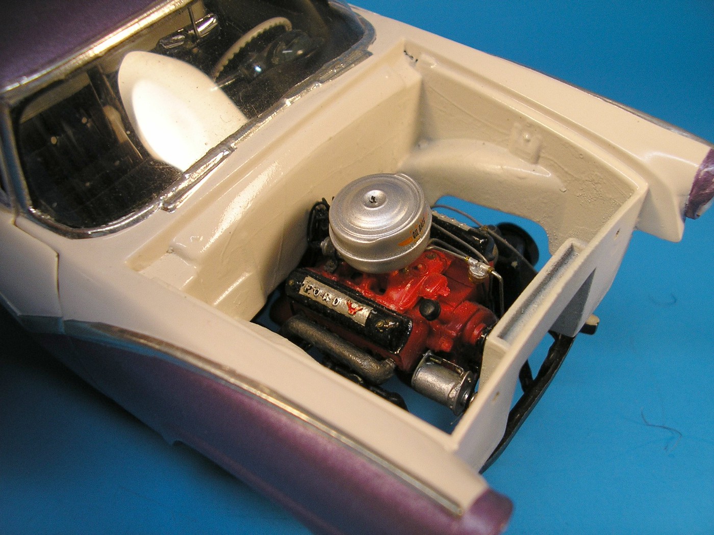

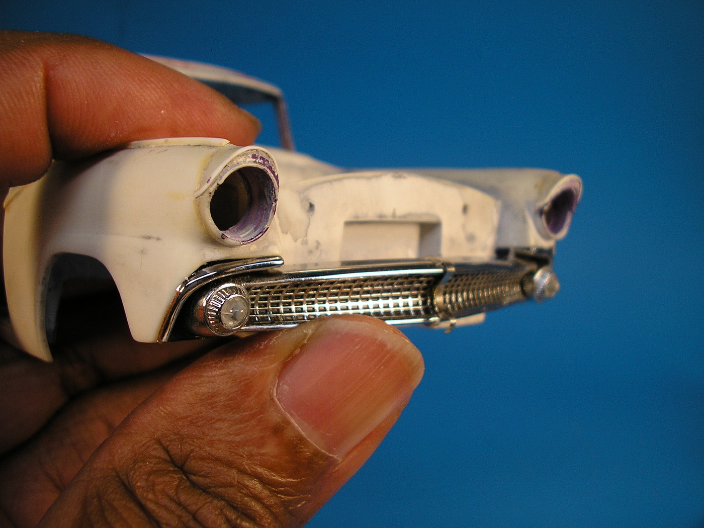

MrObsessive Posted July 29, 2019 Posted July 29, 2019 (edited) I mentioned the other day when I posted my Corvette that I had another resto on my mind instead of jumping back into the Shelby......... just yet. This is a model I started way back in 2005, but got shelved due to bad paint. It's been sitting languishing all this time, and it's literally sitting on top of the cigar box where I'm keeping the Shelby for the time being. I took some quick pics on what the Ford looks like now. I hope to be able to find the rest of the bits and pieces I made before I shelved it, such as the grille, rear chrome piece for the trunk, wheels and tires and a couple other odd and ends. On to the pics! What's going to happen is I'm going to totally disassemble this and repaint it as there are some trouble spots. Thin out the door jambs and I may reconfigure certain contours on the body. This is a MAJOR trouble spot for me. I tried using Future as a barrier for some of the bodywork. I must not have used enough as the bodyword ended up showing up in the paint. So back on the shelf it went undone for literally YEARS. I have a new angle of attack to ward off the ghosting and hopefully no new snags will turn up so I can get 'er done. I'll be thinning the door jambs a bit as there is some interference with the seat. Also, I may add a bit more detail as the jambs are rather 'plain'. Definitely some engine bay detail needed here. Much too bare looking even for a '55 so along the way, I'll have to see what's needed. I'm going to try and make new taillight bezels as the ones that came off a diecast are a touch too big. I'll either get them chromed, or use the Molotow paint. I have the grille (somewhere) so there's not much needed here except some chrome around the headlight eyebrows. The chassis will need some tweaking to make it a bit more tidy. I might make new exhausts as the ones shown appear a bit thin. I'll have to see what's in my supply box. If you're interested, here is the original work done to the model years ago on Fotki. This will show how I did the roof and other mods. Well, it's bedtime for me (third shift) so thanks for looking! If there's any questions, I'll try to answer 'em before I go into work tonight. Edited July 31, 2019 by MrObsessive 1

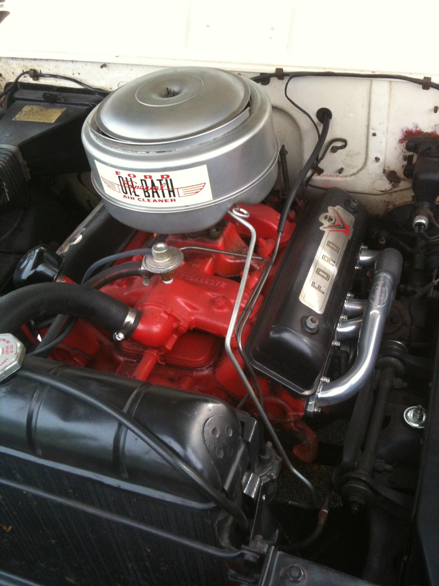

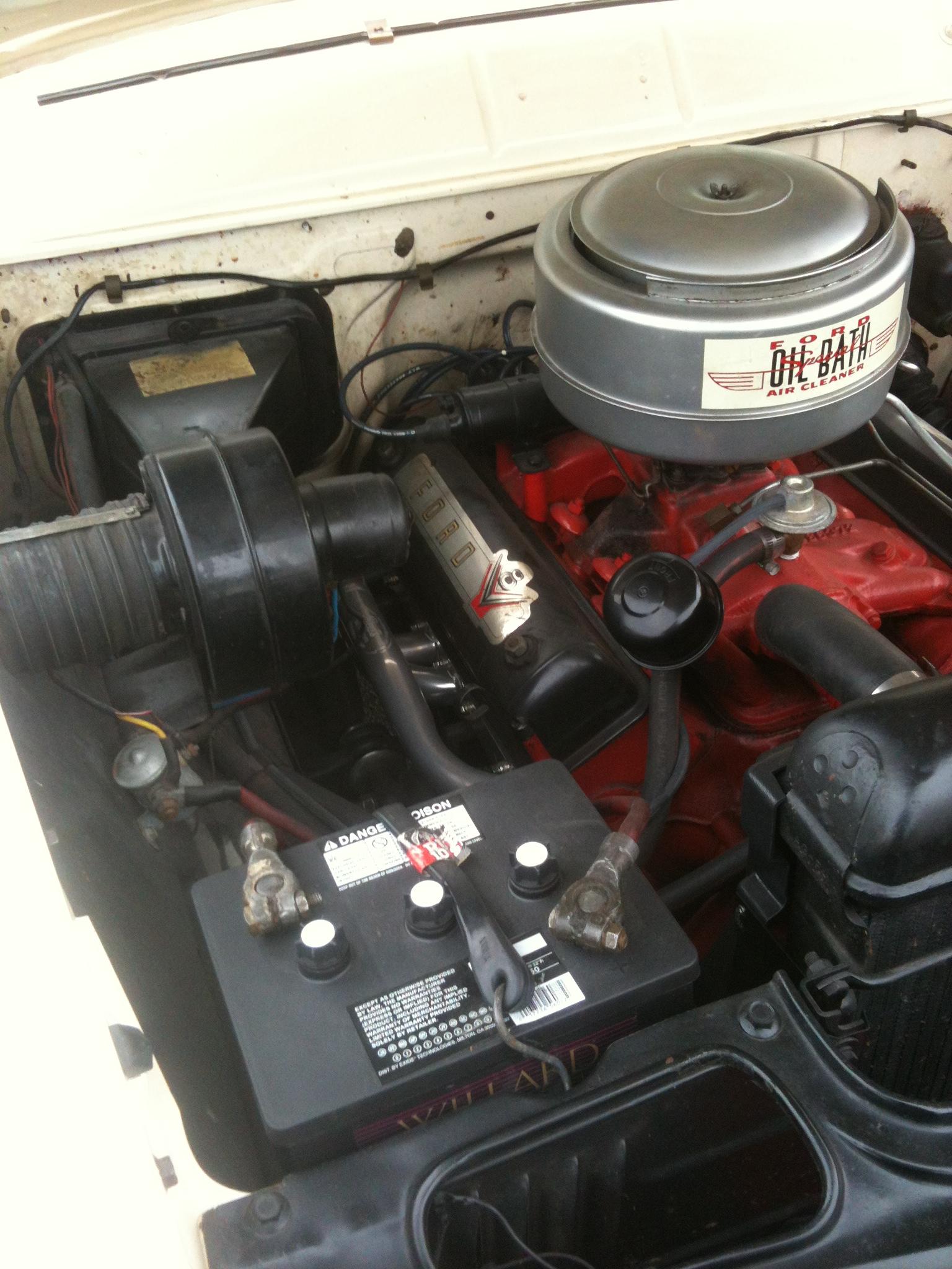

tbill Posted August 14, 2019 Posted August 14, 2019 Not the greatest pics, but some engine/bay ideas. Those of the 55 I used to own.

MrObsessive Posted August 15, 2019 Author Posted August 15, 2019 Tom, just seeing your post.........thanks for those pics! I see something on the engine which I will be changing...........the angle of the distributor. I had it straight up and down and it should be at an angle as seen here. Thankfully I do have the correct air cleaner as I got the one off of the junker Danbury Mint car. 20 hours ago, David G. said: I always enjoy following your work Bill. I'll certainly be along for the ride on this one. David G. Thanks David!
fordf-100 Posted August 17, 2019 Posted August 17, 2019 Beautiful model! Are you planning on doing it in the same color combo? Looks awesome! I wanted to ask what grille you used/are going to use?

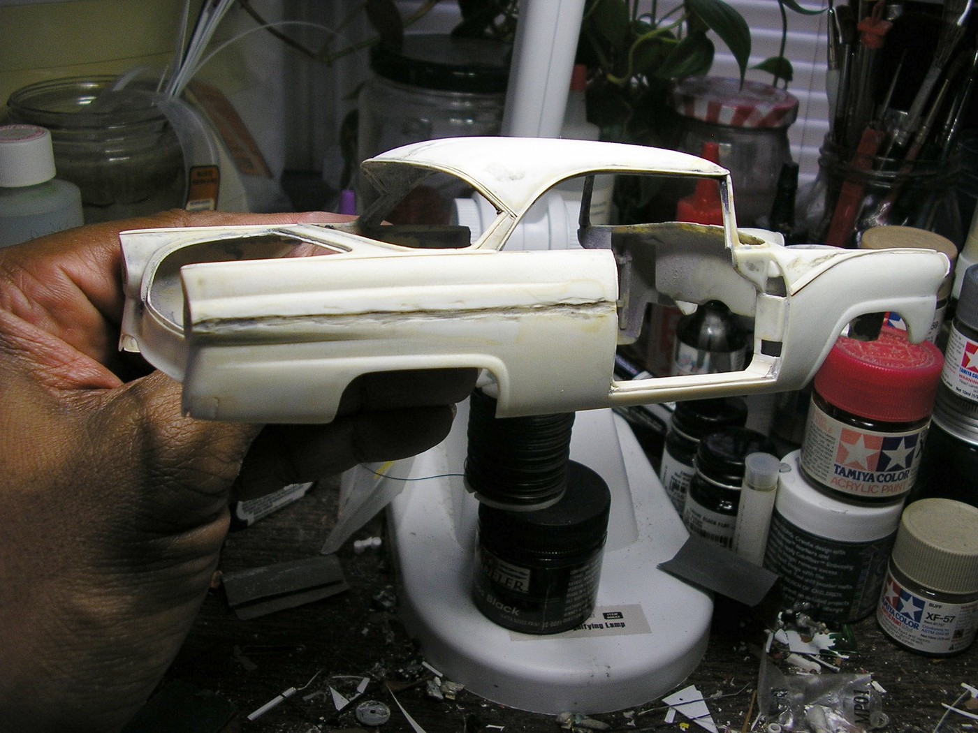

MrObsessive Posted August 17, 2019 Author Posted August 17, 2019 (edited) Here's the latest on the bodywork...........more work than I thought, but at this point I can feel confident there won't be anymore "mishaps" as far as the bodywork showing through a completed and cured paint job. The roof split was the largest (and hardest) to fill in. In hindsight, this should have been the route to go....use as much plastic to fill in the deep split/valley and not rely solely on the putty to not have a reaction with whatever paint/primers that are going to be used. Bodywork is at this point about 80% done. Both sides as can be seen by the pics are totally filled in and this time I tried to use as much plastic as possible, with just a very small amount of putty to fill in any divots and tiny voids. 1 hour ago, fordf-100 said: Beautiful model! Are you planning on doing it in the same color combo? Looks awesome! I wanted to ask what grille you used/are going to use? Phillip, the grille I'm using is a modified one from the Danbury Mint diecast. It had to be narrowed a bit as that one is 1/24, while this model is 1/25. The middle trim piece will need to be fastened back in place as it's broken loose on the bottom over the years. To make things fit a bit better on the sides, I'll rework the leading edges of the fenders to better conform to the outer edges of the grille. That's it for now. At the moment, I'm working on the doors as far as getting the outer door skin work done on those and then it's on to making new door jambs, hinges and hinge supports. More work than I anticipated, but I'm going to try something a bit different in making them open/close and fit better in the body. The hood has a bit of work needed too as where I filled in the scored lines with putty, the oven cleaner made that come loose as well. So far I got those filled back in with plastic and then it's on to smoothing things out. Thanks for tuning in! EDIT: I almost forgot......yes Phillip, I'll be using the same colors as before. Snowshoe White with Regency Purple two-toned. I still have a bunch of paint left over from PaintScratch.com of the purple and not long ago I had to order some Snowshoe White as I had no more of that. Edited August 17, 2019 by MrObsessive

MrObsessive Posted November 3, 2019 Author Posted November 3, 2019 (edited) Well, it's FINALLY good to be able to sit down after over two months and get building again! The new house is a bit smaller than the last one so my model room is not as big. That's OK though as I'm still able to have the "essentials" with me in the room. The last time I posted was back in August which would make sense because it was very shortly afterwards I had finalized things to be moving roughly a month later. In a sense I'm glad some time had passed since I was working on this '55. When I was finally able to zero in which box this was packed in, I was able to see once again where the bodywork was going to rear its ugly head on the roof. So this time I got out the sanding block to sand away any "memory" of the plastic I had used and any imperfections were filled in with super glue. I'm not going to worry about any paint reaction with the super glue as this will be sealed with BIN Zinsser sealer. I highly recommend it for any extensive bodywork that will eventually be painted with hot automotive paints. So now here's where I am at this point............not a lot of progress, but considering trying to get things together in the new place and the shape the Ford is in, I'm liking where this is going so far. Since I had to take the body pretty much apart, I figured I may as well spend the time and redo the door structure. This involved thinning out the door jambs on the body a bit more by using a Moto tool and then checking to make sure both sides were equal using dial calipers. Whenever I need to build up door jambs for opening doors, I like to start with the corners. I'll take some round tubing of a particular size (varies) and cut it so that there's a nice radius for the bottoms of the doors. If you take a look at any 1:1 car, the door jambs for the most part do not have straight corners (there are exceptions......Studebaker comes to mind), but they do have a radius to them. I took some MEK and flowed it on and let it sit for a bit. Later on, I'll use super glue to reinforce the jamb around the perimeter for strength. Here's the door hinges for the driver's side so far. Originally, I had soldered up flat type gooseneck hinges as I was looking to make them more like the 1:1. Then I remembered what happened to the '59 Chevy when due to excessive handling/bending, one of them eventually snapped. Sooooo.............I want sturdiness this time around instead of 100% accuracy, so I went with .020 brass rod and bent it to shape to get the correct opening arc without any binding. The retainers on the inside of the door are glued in at the moment, but once again for strength they'll be superglued in so the rods can slide right in during final assembly, and then I'll epoxy those in so that there's no fore and aft movement of the door during opening and closing. Now that I have everything positioned where I want it, I can make the leading portion of the door jamb and then try to position the interior door panel. Hopefully the dimensions haven't changed too much so I don't have to redo those. With the hinges in place, the door fits in the opening nicely without excessively huge door shut lines. I may tighten up the leading edge of the door just a wee bit more, but I'll have to take in consideration paint buildup to ward off any binding/scraping. I'll be making new vent windows from H channel brass stock........pretty much like I did with the Shelby a while back. The previous ones were plastic and did not survive the tear down of the body. One thing I'm a real stickler about is how the doors appear when they are open. This is where your hinge support placement is critical. If the supports are mounted in any way too crooked and tilted, this will show up on the final assembly if pics are taken of the doors open. You want the supports as straight as possible from a dead on frontal view, and then from the sides you want them straight. So far from this shot here we can see the doors are opening pretty darn straight. You'll need to take into account any flexing outward (or inward) of the body when it's time for final assembly. Too much inward or outward flexing of the body will either have your doors hitting the curb, or looking like butterflies up in the air. Another consideration is the making of the hinges themselves. This is where trial and error come in as you need large enough radii of the hinges so that once again there's no binding and also to give the doors a wide enough opening "arc" to be realistic. So, with the driver's door out of the way as far as hinges, I get to now focus on the passenger side! So that's it for the time being! One thing I like about the house is the way it sits, the second floor is nearly somewhat level with the main road. It's interesting that it was built that way so I get to see some neat cars pass right by the window while I'm working. Directly in front of the house is a one way street and since I have a driveway, I don't have to worry about someone being silly and running into the car. It's interesting also that this is the only part of the street in town that's like that.......everyone else's place is level with the street. One potential drawback is that I can literally see the Susquehanna river right out the kitchen window and especially from the second floor in the bedroom. I'll have to ask one of the neighbors how high does the river have to get before we worry about flooding, but just the same, I'm keeping nothing of value in the basement. Been there and done that! Thanks for tuning in folks! Edited November 3, 2019 by MrObsessive

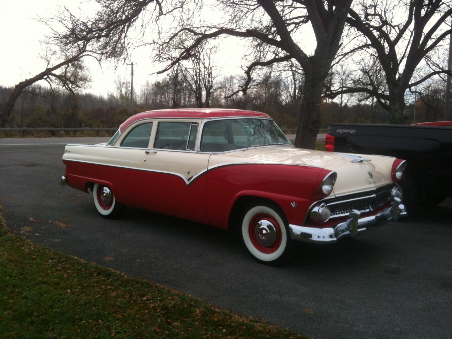

espo Posted November 4, 2019 Posted November 4, 2019 I was catching up on how this build was going. I hadn't seen the pictures of your 1:1 Ford before. That was one clean machine.
