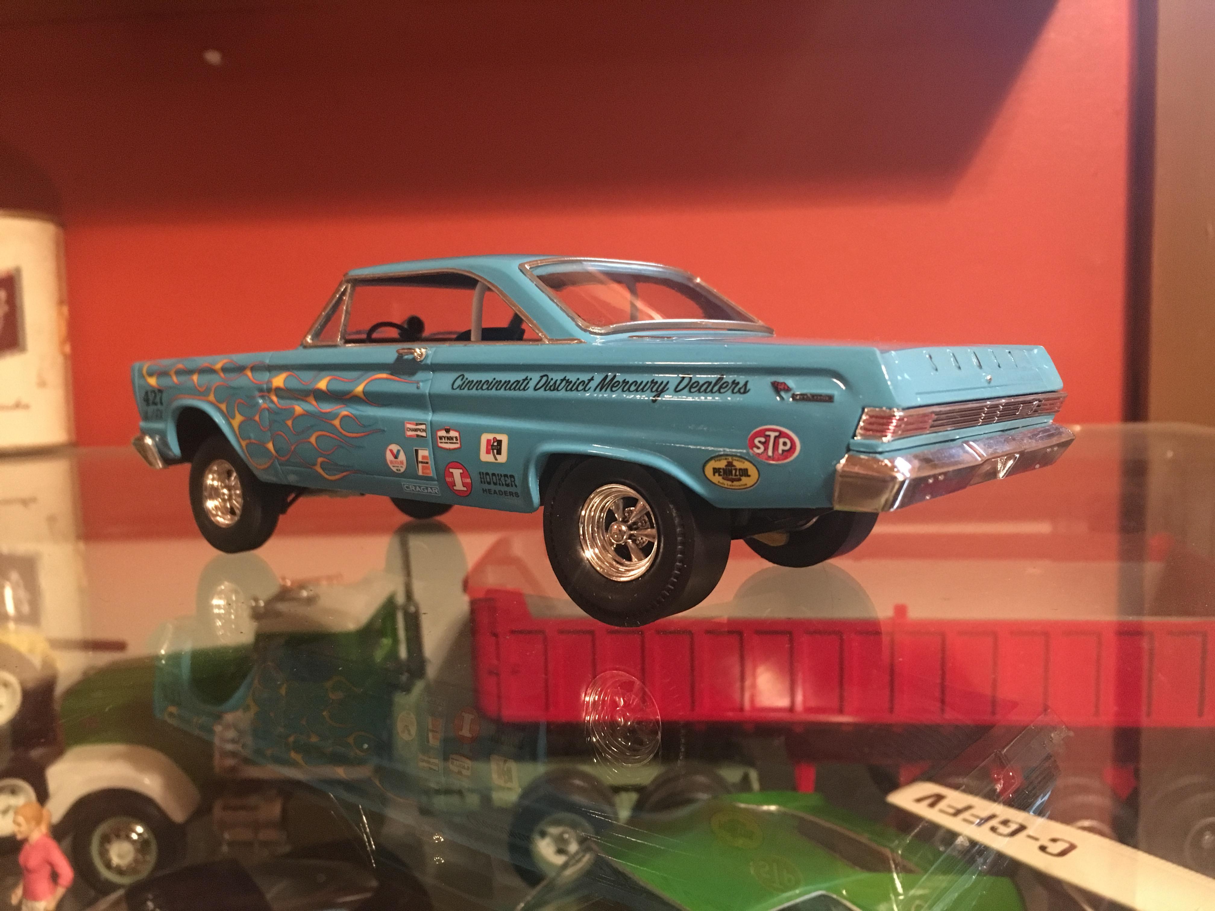

Long time for an update. I've managed to get most all assembled. The Bare- Metal Foiling of the trim drove me nuts!! I have to say, 1/25 scale has been difficult, been having a hard time dealing with the small size of this kit and the small parts. Going to have a look for larger scale stuff, 1/12 or 1/16 looks easier to build. I have all respect to the builders here that turn out the great builds in this scale. Anyway, some pics.
Still have some small parts to install.
Don
That looks great! I’m a big fan of different colors on stuff , I built the first version of this kit and opted for a different paint scheme as well, sorry to hijack your thread with my pic
Thanks for the positives, guys. I have to confess, this was a lot more difficult than i thought it would be. 4.5"x 6.5"x 9.5" box, 7 or 8 sprues of parts, how bad could it be...have to tell you, i boxed it up a few times, mostly when dealing with finishes and fit issues.  Worse part was doing the Bare-Metal parts, did manage to get it done more or less, took about 5 sessions. Stuff seems to have a mind of its own, and it was thinking bad thinks. Went to add the wiper arms/blades, foiling them first. Broke them. Sad. Well, real drag cars don't have them, so that's my excuse. Won't be adding the decals, i like the clean looks of if without. Done with this, i'll post in the finished forum some pics.
