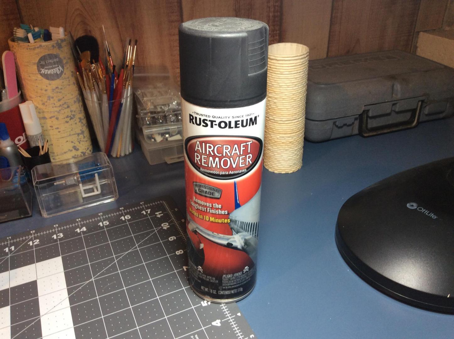

Hotrod 97 Posted September 28, 2019 Posted September 28, 2019 I haven’t used Super Clean, but I have used something called Aircraft Remover. I used to use that stuff to remove paint from small scale diecast cars, so it should work for a larger scale, too. I will say, Aircraft Remover has some powerful fumes, so it should be used outside or in a well-ventilated room.

madhorseman Posted September 30, 2019 Posted September 30, 2019 I myself would not use SuperClean to strip a die cast. Tried it a few years ago, and the whole body was "pock marked". That air craft stripper works best, or brake fluid.

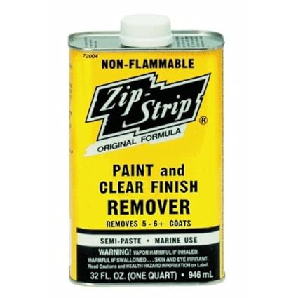

Jantrix Posted September 30, 2019 Posted September 30, 2019 I haven't used it in years, but this was my go to stripper when I was heavily into bicycles.
