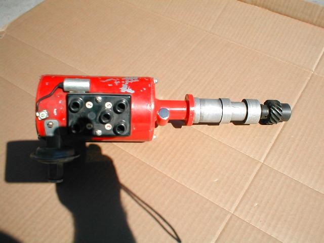

SPALDING / GRANT "FLAMETHROWER" IGNITION SYSTEM
I chose this to kick things off as it makes an appearance in the '40 Willys kit Casey posted on the thread that started the idea. (part #9)
This is a part that is very frequently misidentified as a "magneto". It is not. Rather, it's essentially two single-point distributors in one housing, requiring two coils, and functioning as a dual-point distributor, but with twice the dwell time on each set of points because of its unique configuration. Unlike a magneto, it requires a battery to function, so keep that in mind if you use one. These can be run with or without a vacuum advance can, depending on the application. In general, a blown engine will not use vacuum advance, though the can may be set up to function as a pressure-retard device, common on old-school turbocharged street engines
Introduced in the late 1950s (IIRC), and popular through the 1960s into the '70s, they're still fine units for street or competition use (though parts can be difficult to find). They can be used on any V8 engine.
There are 4 plug wire terminals on each side, wired as shown above.
Several kits include this distributor, including the vintage Revell Ford 427 and AMT Chrysler 392 parts-packs.
What is the purpose of this piece?
32 minutes ago, Greg Myers said:
vacuum advance
Yup. As I noted above, a supercharged engine will most likely NOT use a vacuum-advance can. There is never a vacuum condition in the intake manifold with a mechanical supercharger. All timing advance will be controlled mechanically inside the ignition unit by weights and springs.
10 minutes ago, Greg Myers said:
According to this it is a vacuum advance.
YES, it IS a vacuum advance. Nobody is disputing that fact.
MY POINT is that a vacuum advance has no place on a supercharged engine. Anybody building a model of an engine with a blower, remove the advance can.
A normally-aspirated engine MAY use vacuum advance to advantage.
  • Like 1

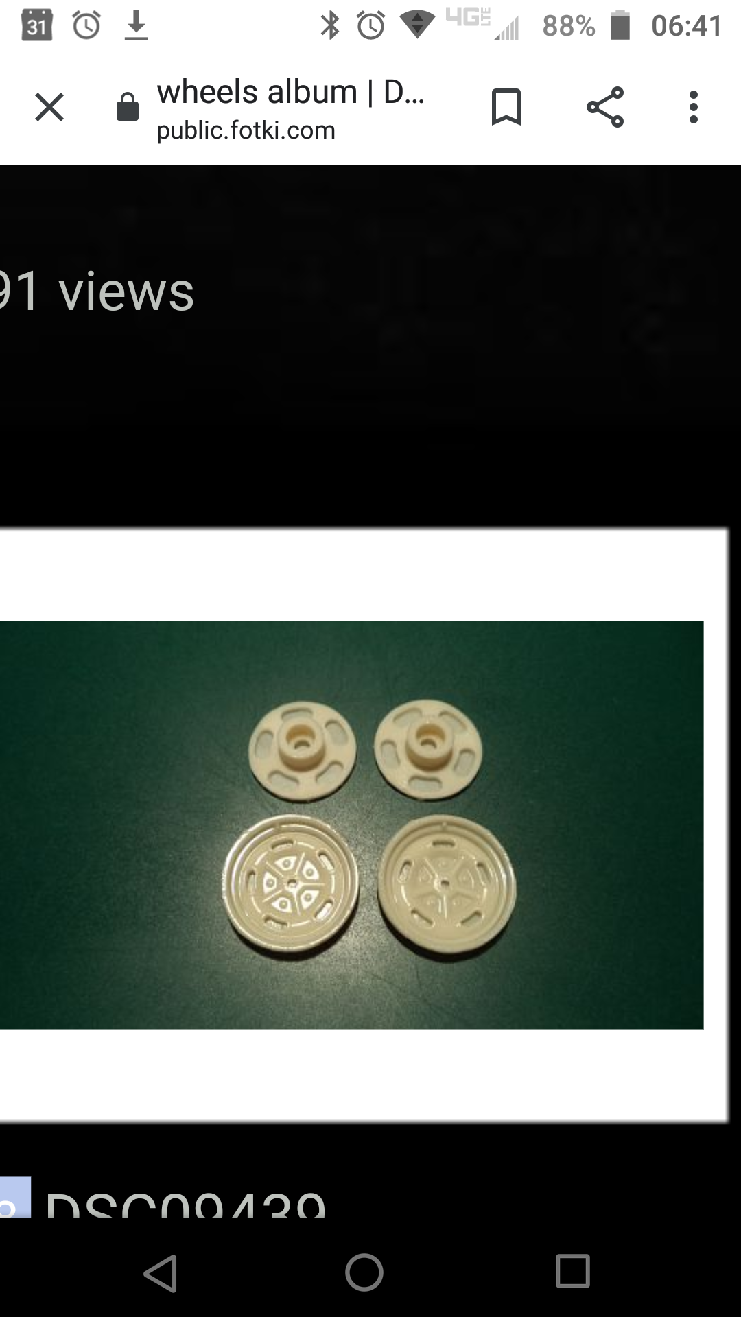

Does anybody know anything about these wheels and what time period they would have been seen on drag cars? The pic is from Drag City Castings site and I am thinking about placing an order, to include these. I like the look of them.

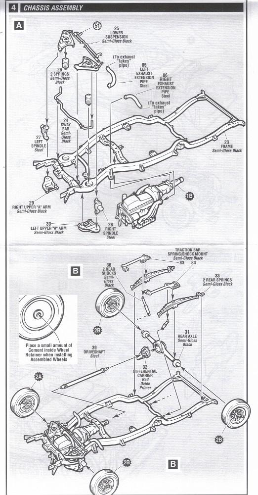

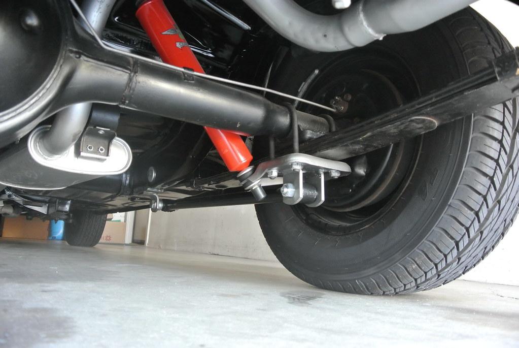

Traction Master traction bars found in early Revell Tri- Five Chevy kits and The last AMT '60 Ford Starliner

51 minutes ago, Modlbldr said:
Does anybody know anything about these wheels and what time period they would have been seen on drag cars? The pic is from Drag City Castings site and I am thinking about placing an order, to include these. I like the look of them...
That design was originated by Ted Halibrand and widely referred to as "kidney beans" because of the bent ovoid shape of the slots. They've been around since the mid 1950s, used on pretty much anything imaginable: drag cars, road racing cars, Indy cars, dry-lakes cars, and street rides.
Similar styles are still in production, one current one being from American, called "Salt Flats".
Edited by Ace-Garageguy
