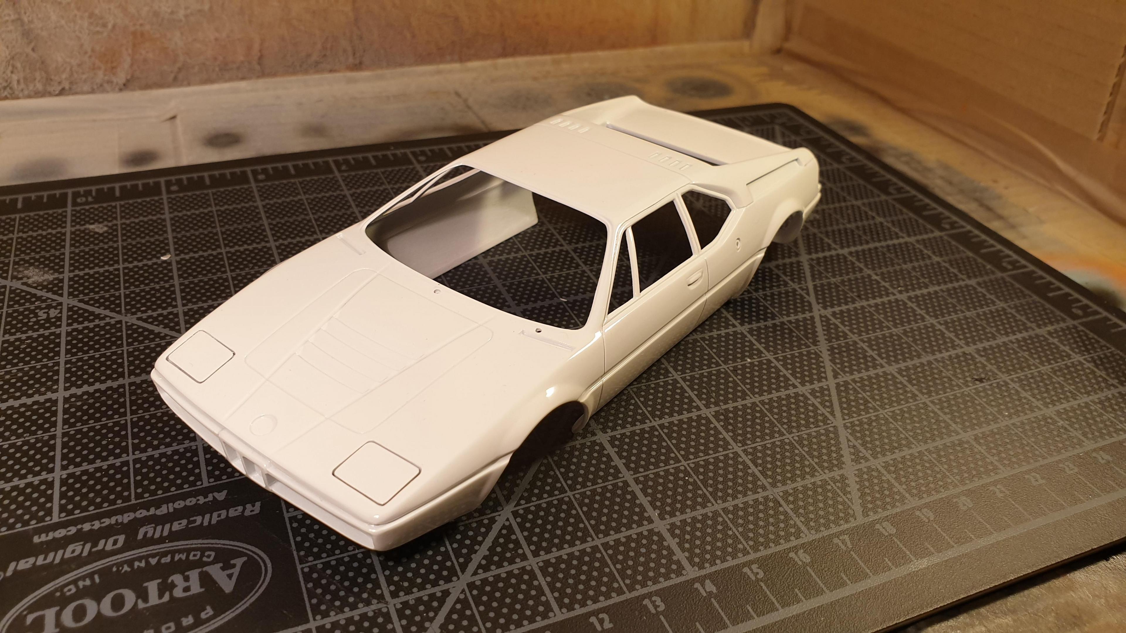

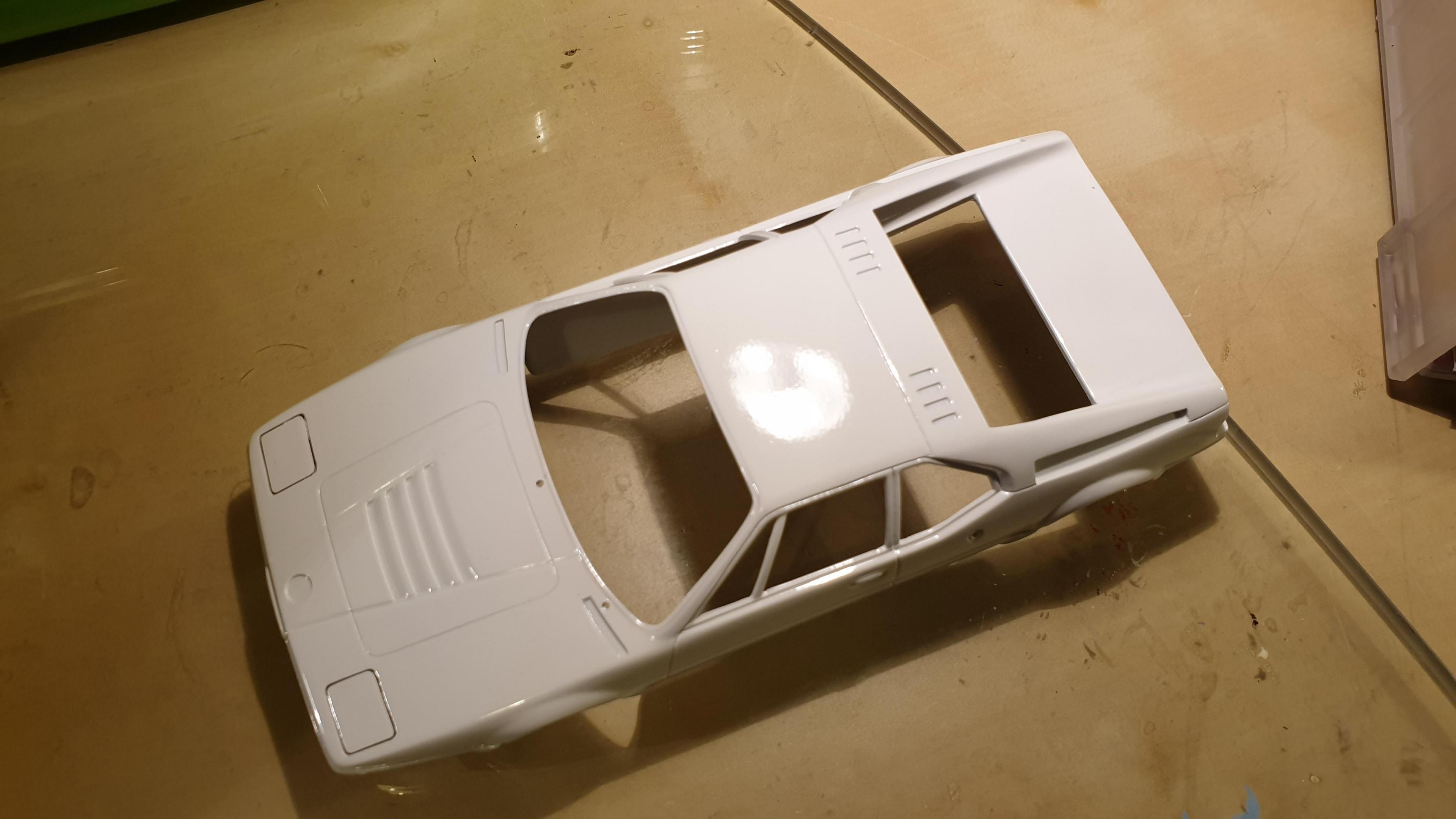

Funkychiken Posted June 15, 2020 Author Posted June 15, 2020 This was clear-coated a while ago - about the same time I did the body for the RX-7 It came out with only about 5 dust blobs, and the finish will be great after sanding and polishing, it's had 2 full coats, so it shouldn't burn through. now for that interior!

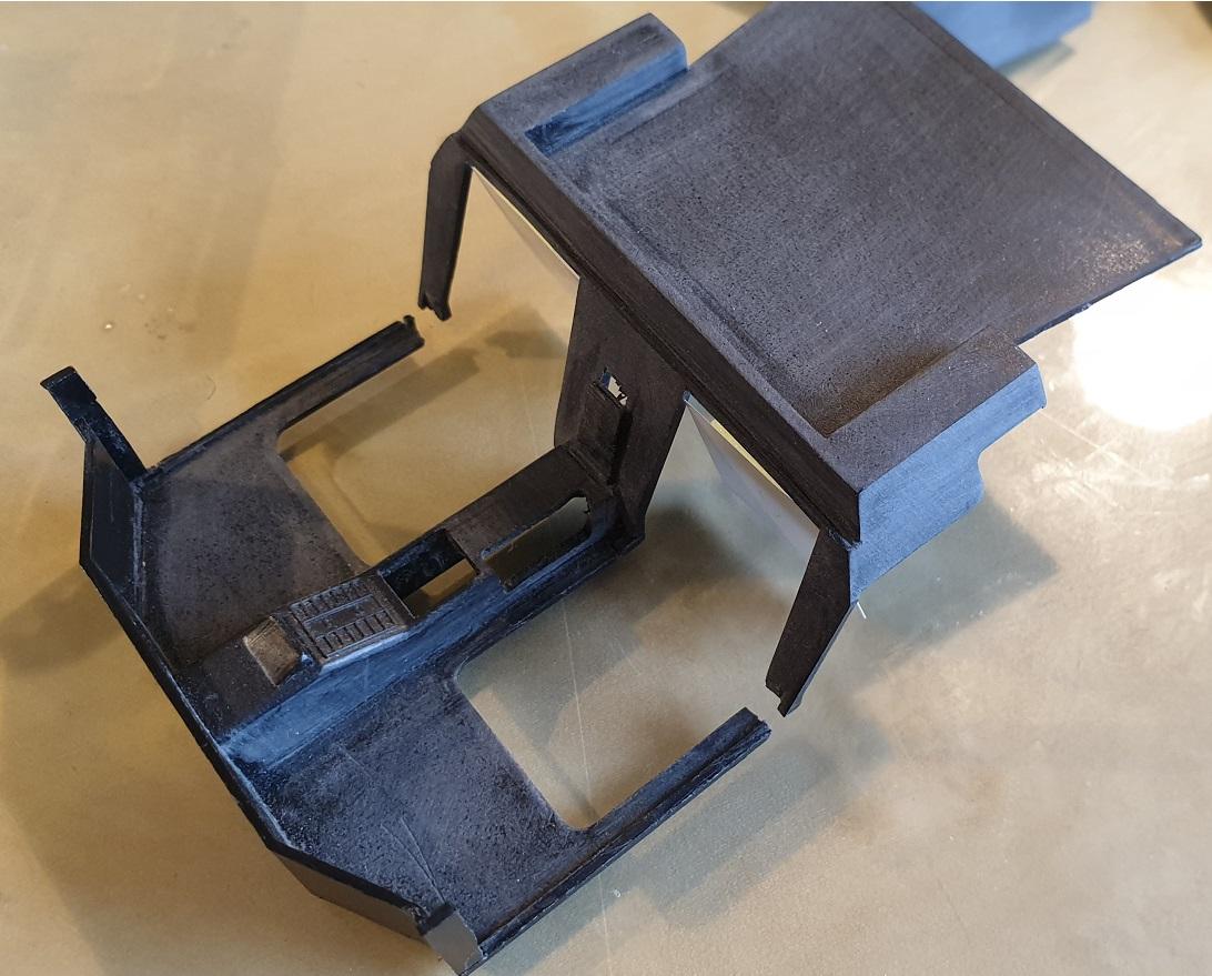

Funkychiken Posted August 8, 2020 Author Posted August 8, 2020 With the Aston finished, I've come back to the M1 Still got to polish out and detail the body shell I've now cleaned up the interior tub as shown here

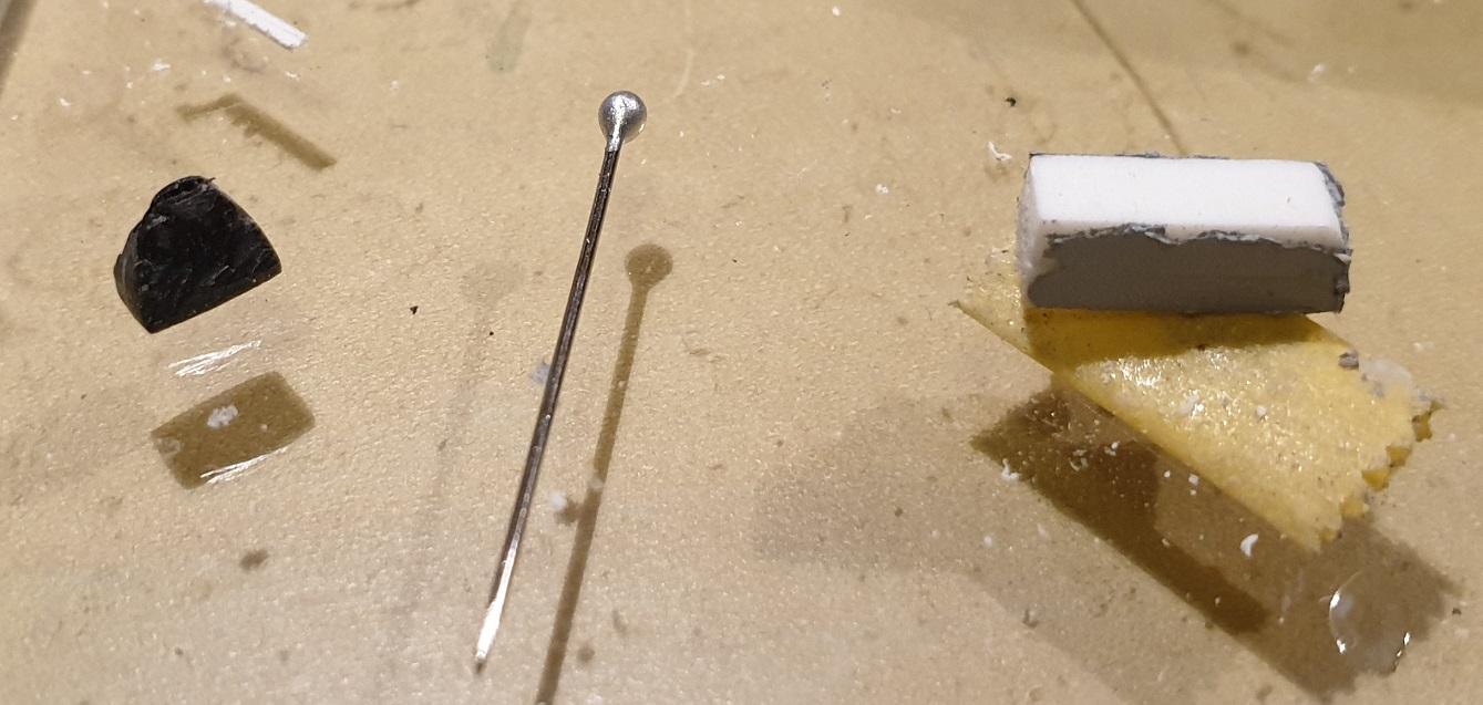

Funkychiken Posted August 8, 2020 Author Posted August 8, 2020 I've cut the gear stick gator in half, sanded it to thin it out & stuck it back together, and i'll be using the dress pin to simulate the end of the gear stick, the white block is going to be the arm rest
Funkychiken Posted August 8, 2020 Author Posted August 8, 2020 The reason there are gaps in the interior tub is because the seats were moulded in and awful. I'm not sure exactly how much you'll see when the kit is finished, but I'm on this path now! I'll be using a pair of 1:25 Corvette seats

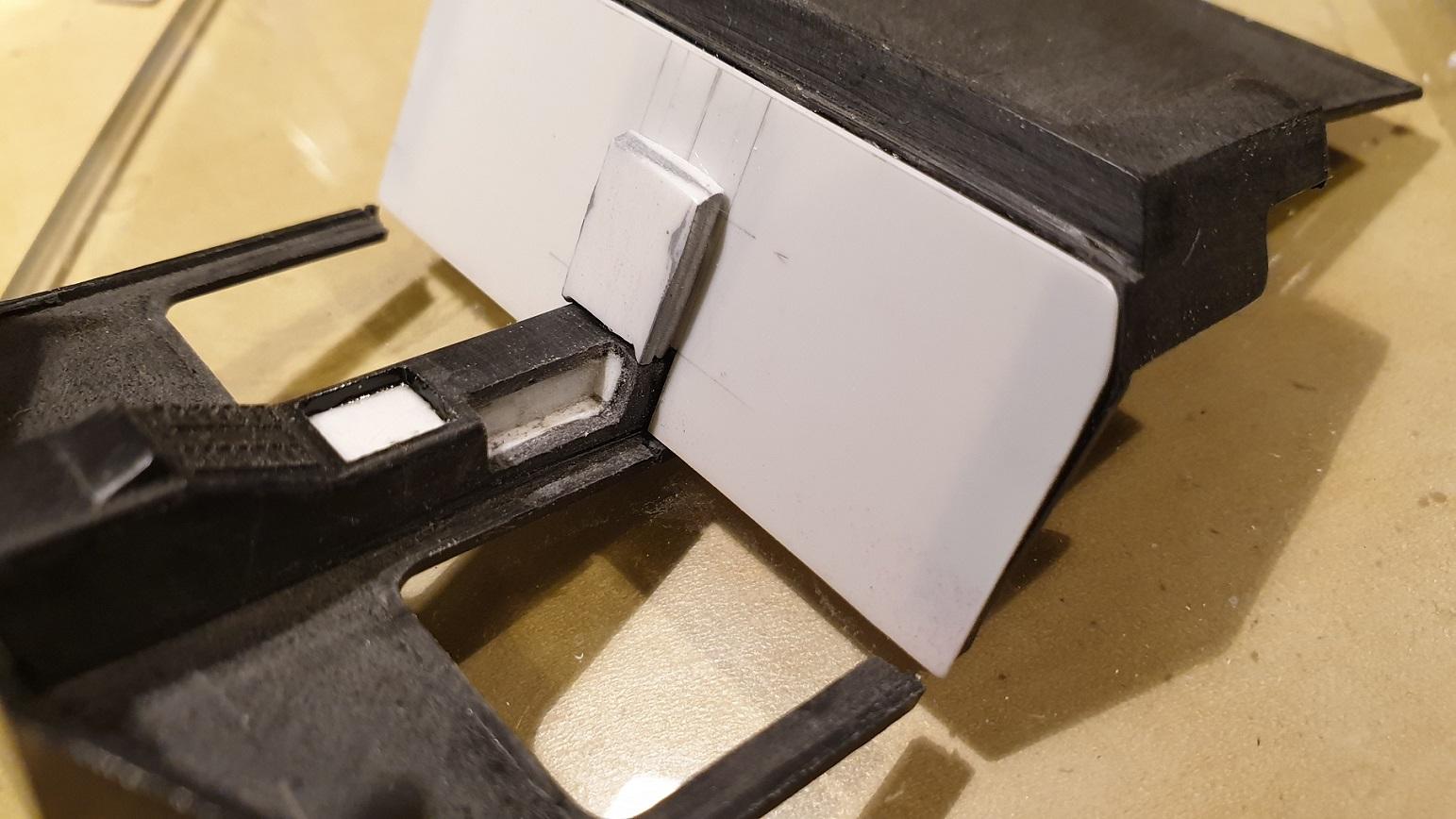

Funkychiken Posted August 8, 2020 Author Posted August 8, 2020 A new back board, the hand brake channel and the area for the gear stick are currently being prepped.

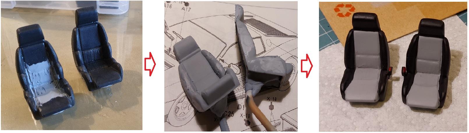

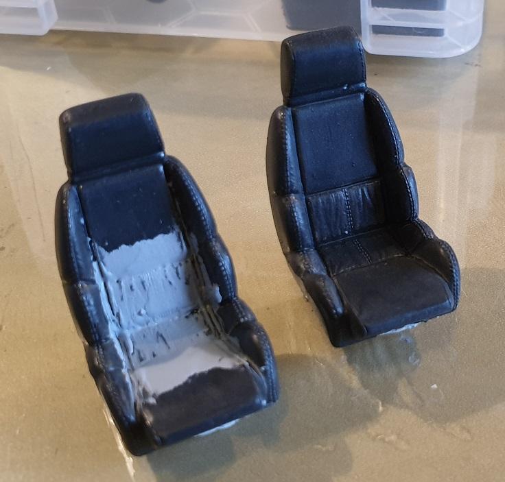

Funkychiken Posted September 17, 2021 Author Posted September 17, 2021 it's been a while, but the kit never left the bench, this is the progress on the seat - they are done...

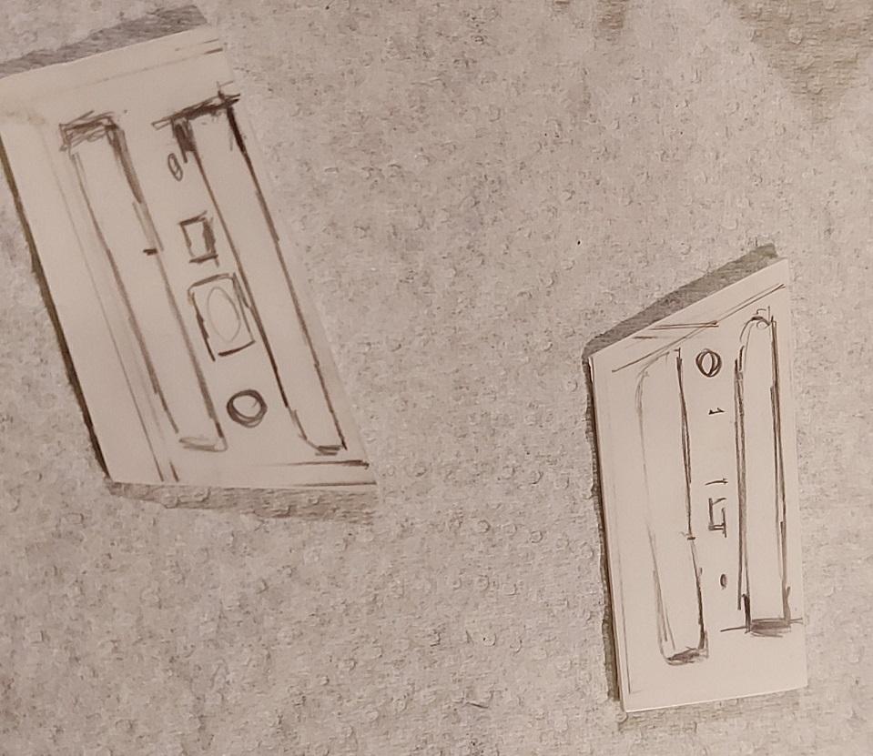

Funkychiken Posted September 17, 2021 Author Posted September 17, 2021 The kit did not come with door cards, just a plain blank side of the interior tub (which I cut out) So using some reference pics, I made these - with a mixture of styrene sheet & putty/filler. finished in primer grey & Tamiya X-18

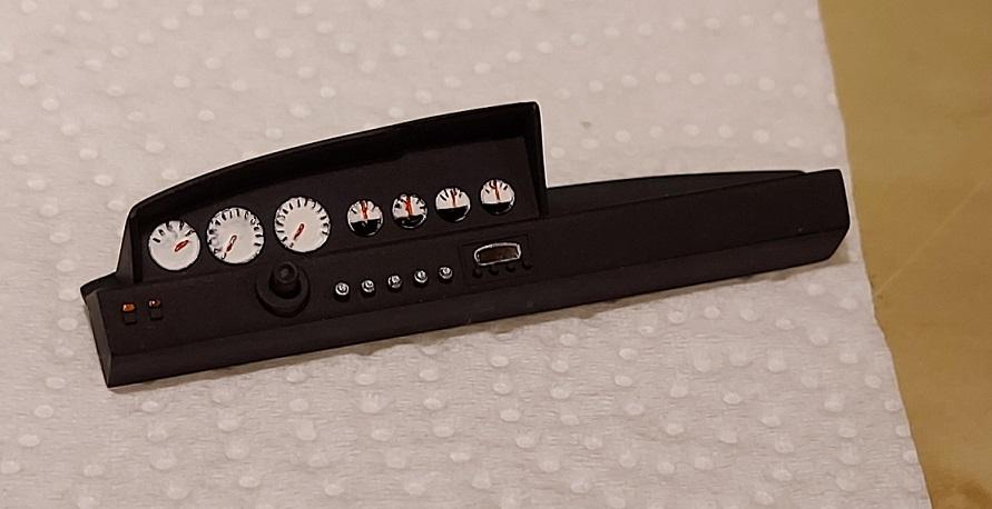

Funkychiken Posted September 26, 2021 Author Posted September 26, 2021 Dash finished. There were no decals, so its a coat of X-18, and silver backed white paint into the dials. It looks better in real versus the pic, so i'm happy with it!
