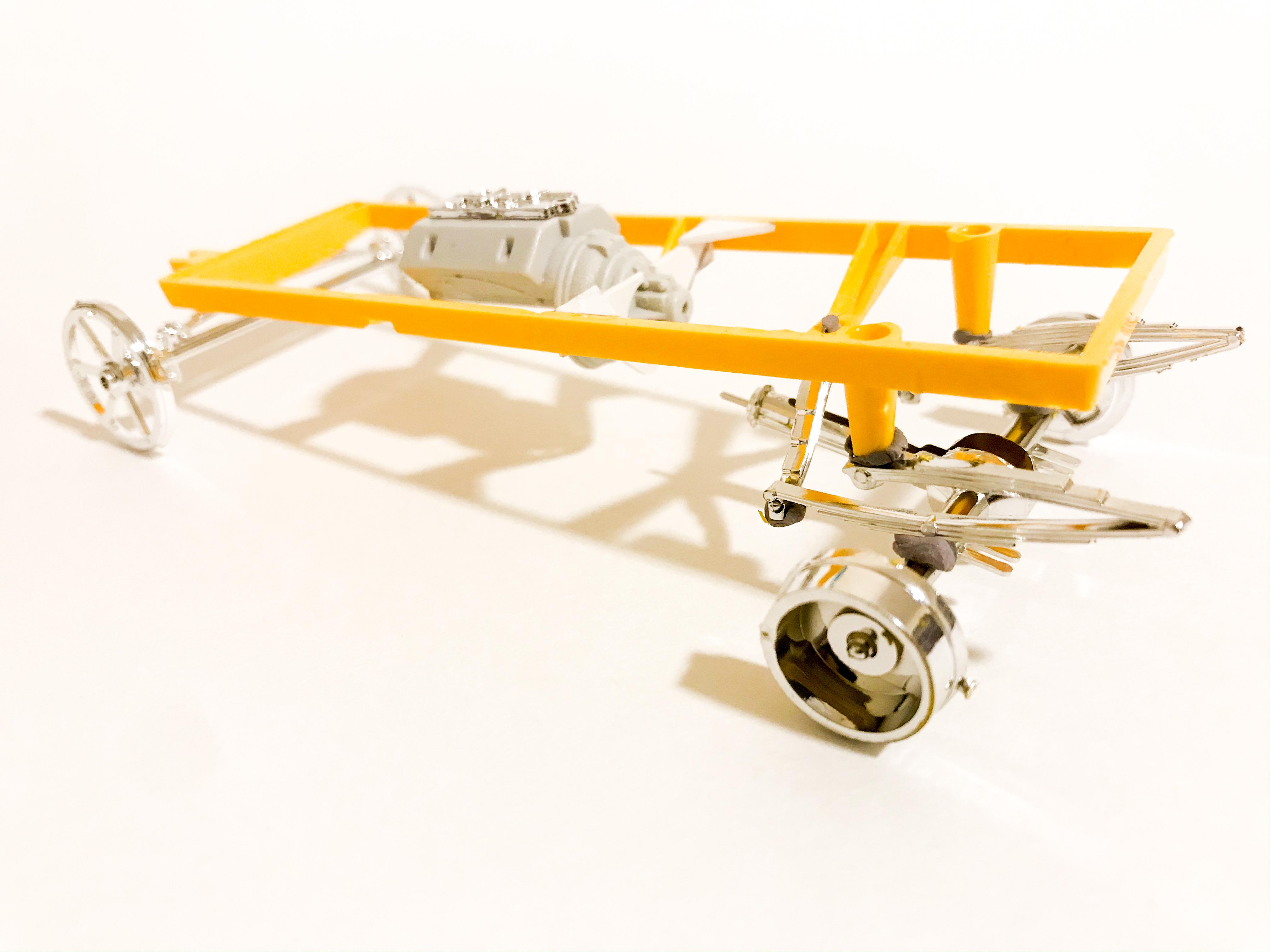

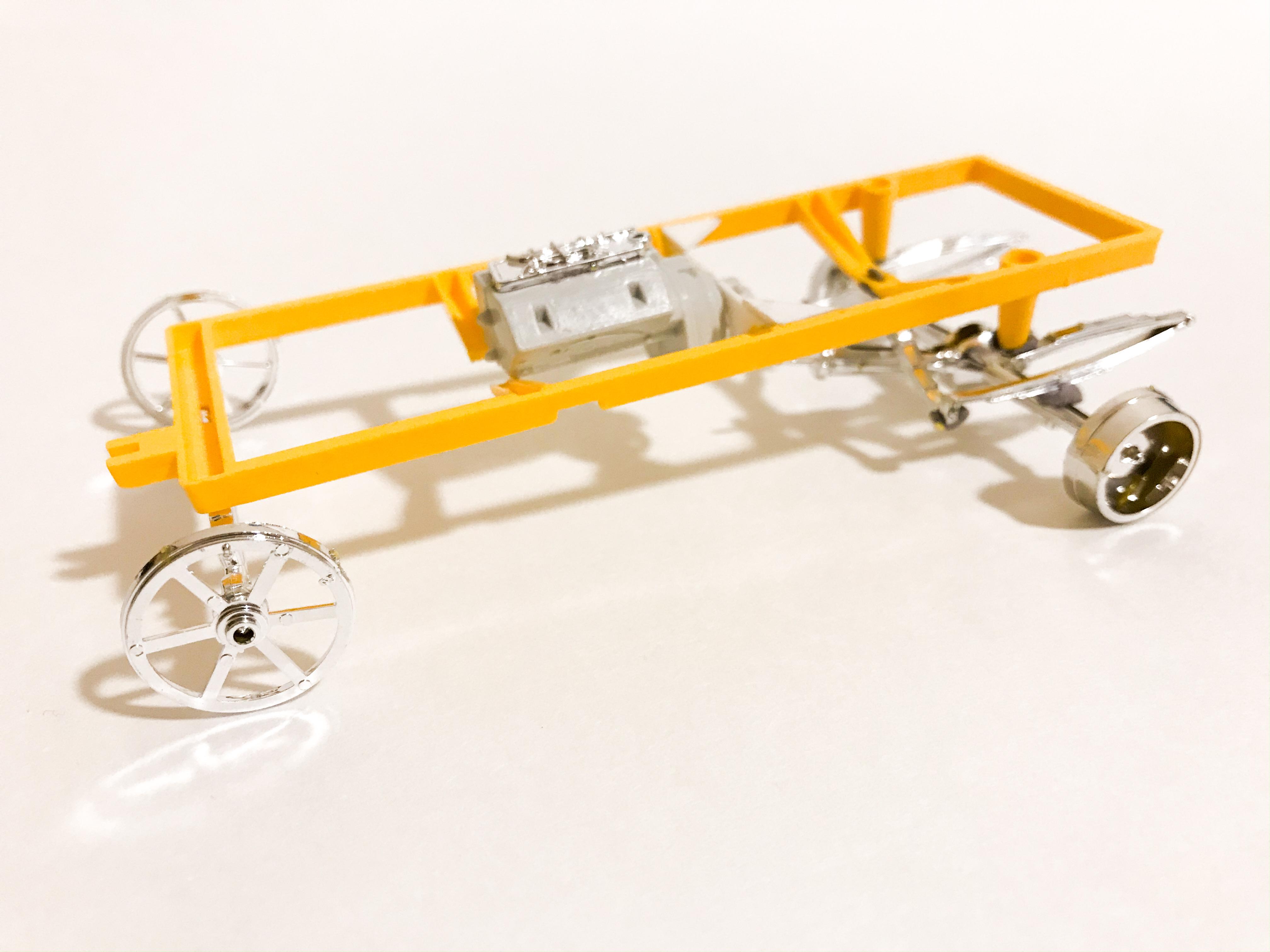

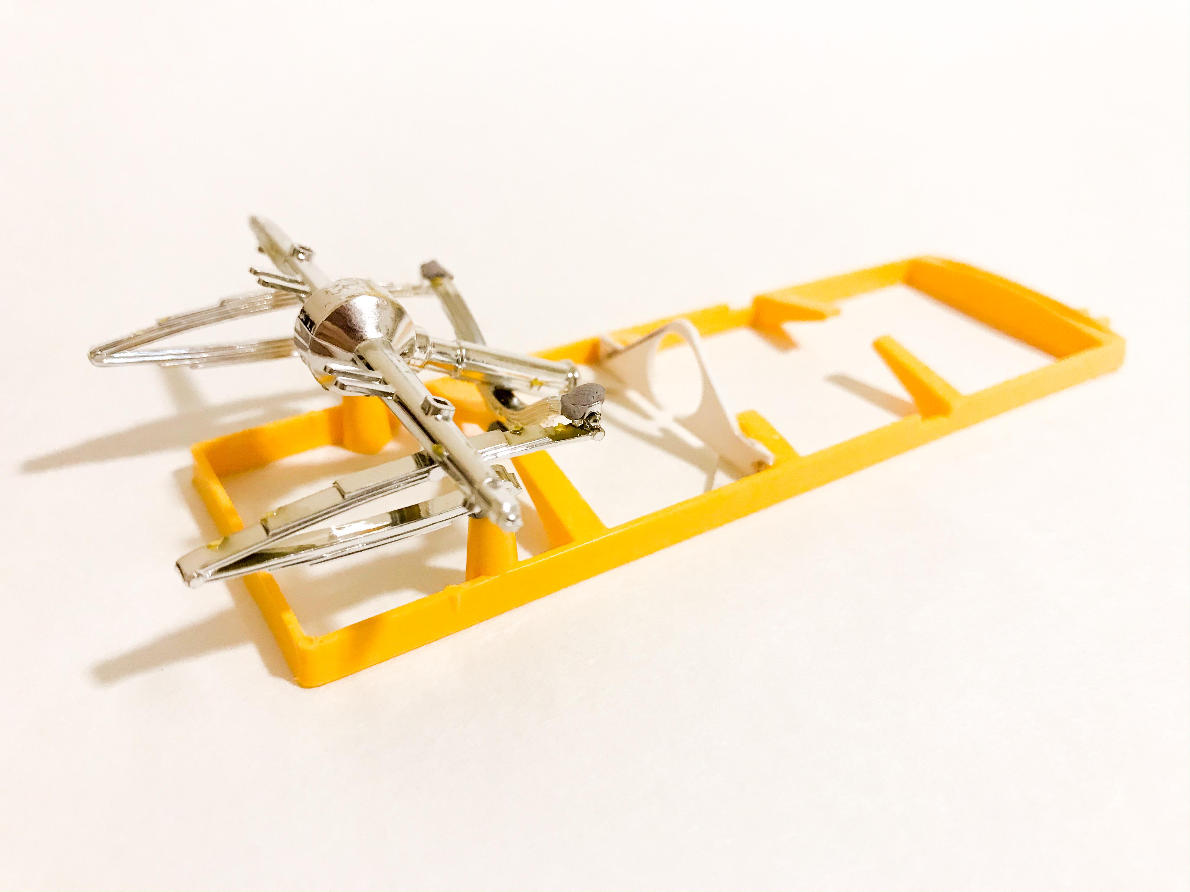

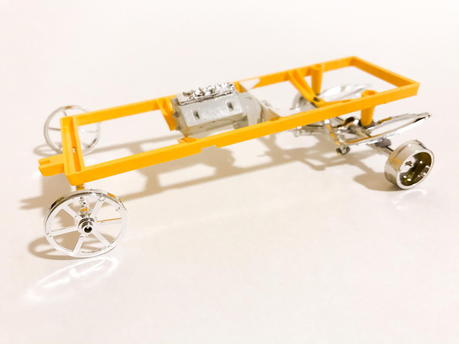

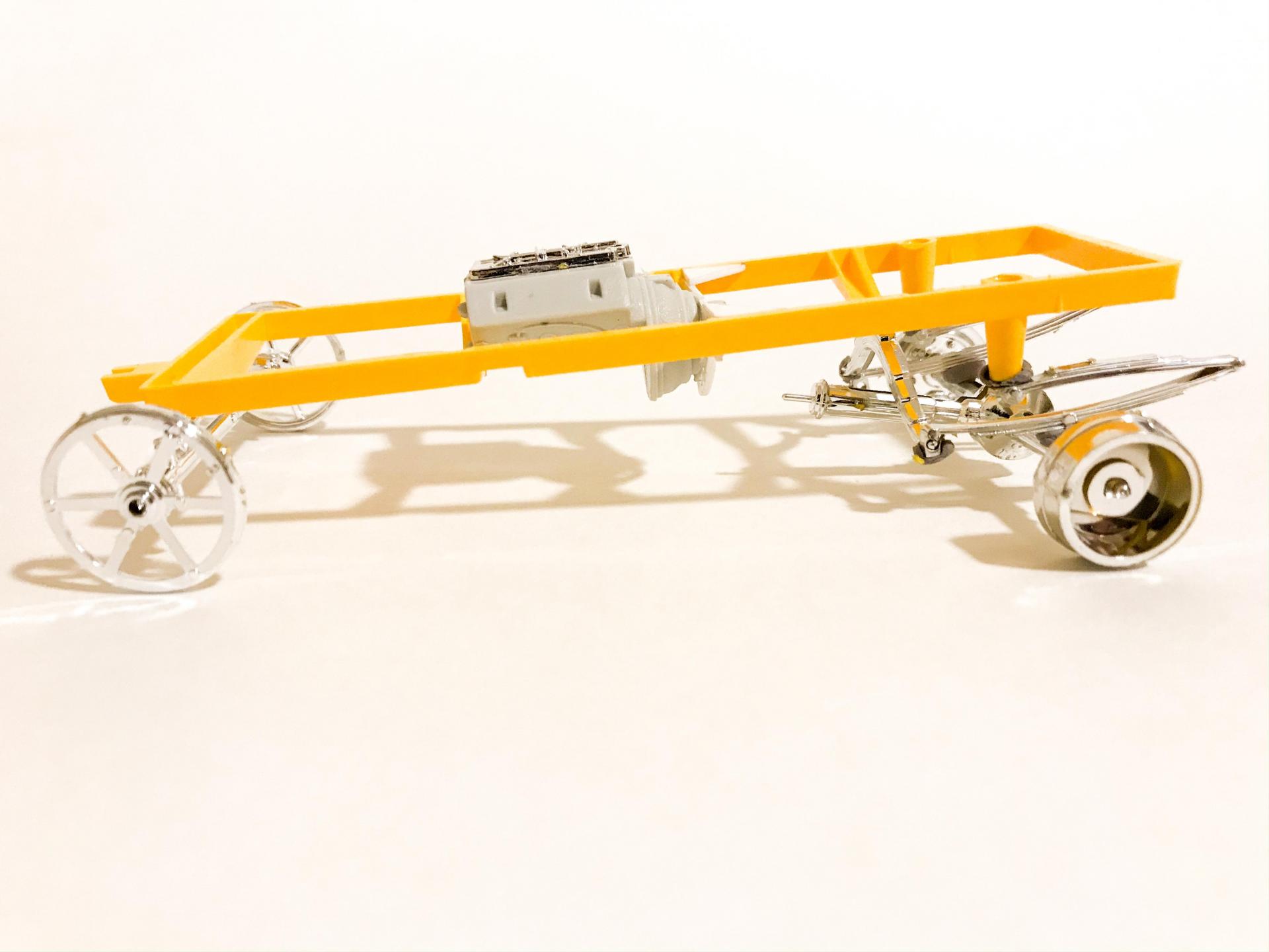

First up was to figure out how to mount the AMT Hemi in the Monogram frame.  The original kit block had pins either side of the trans but I decided on making a trans cradle type mount for mine:

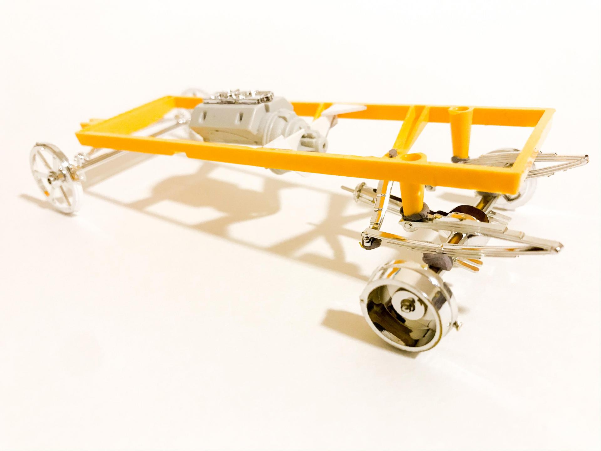

And a quick mock up of the engine in the mount - I’ll need to extend the driveshaft because the original kit transmission was longer but itll work!

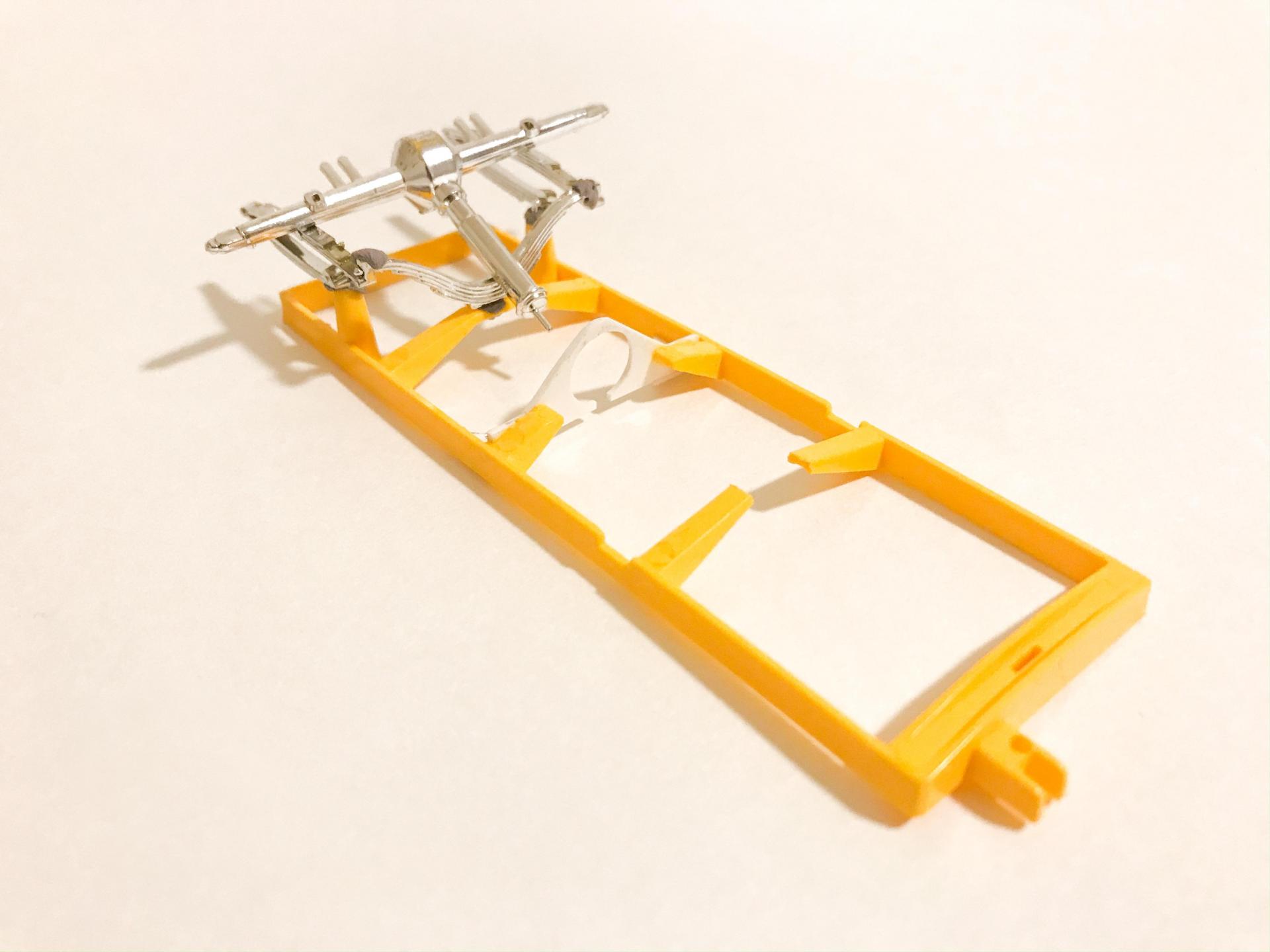

Everything is just poster-tacked together right now for ease of messing with the frame...but dig that weird 5-leaf suspension system:

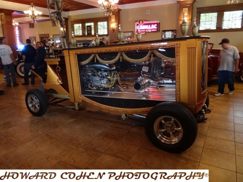

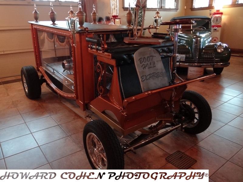

It did make some 'show' passes.........
As a kid I got to sit in Boot Hill....sitting still on a car show floor...it was scary!!!!! at speed!!!!
Edited by Dave Van
Expand
Cool pic!  I hadn’t seen that one - although I did a bunch of reading up on the car today - it’s really cool!  You’re right, it did some exhibition runs, but I guess no one was quite crazy enough to actually floor the thing and see what happened ??

 You might already realize this, but the
engine needs to be mounted at a steeper
angle, aiming it at the rear end more!
  That will help with a few of the issues I
would think?  ?
  But it is looking great, that's for sure!!

You’re absolutely right David - the engine should mount leaning towards the center yolk more, yes!  It actually does lean more when I have the oil pan on there too, and the suspension is all droopy and tacked together at this point making it look even worse...I couldn’t find much in the way of pics of the real car with the ‘body’ off (or indeed a model version in progress) so I’m making it up as I go along here a little!

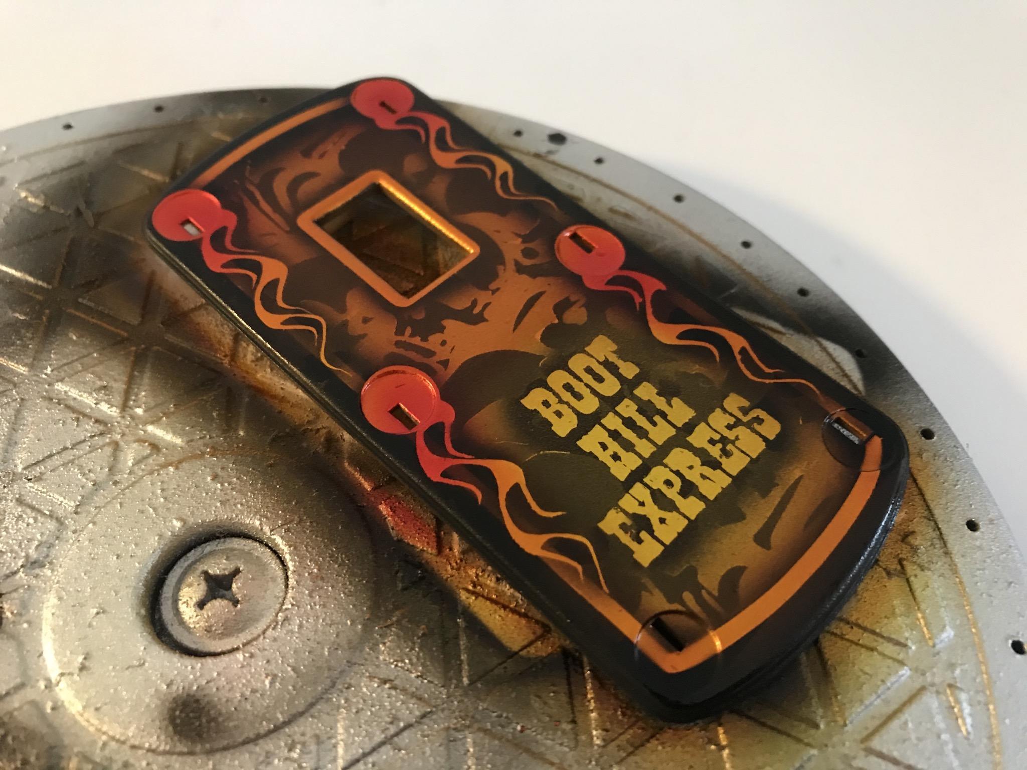

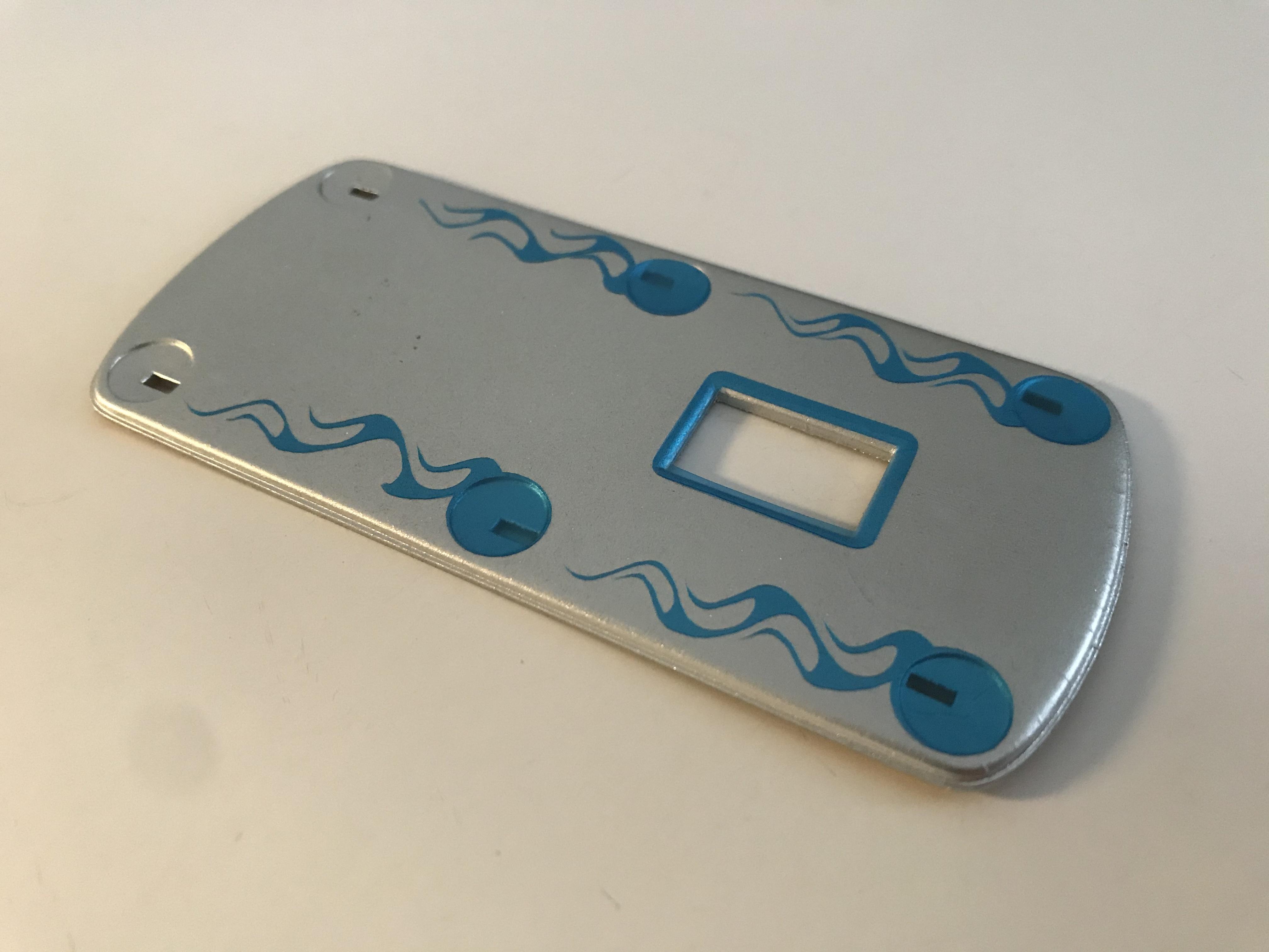

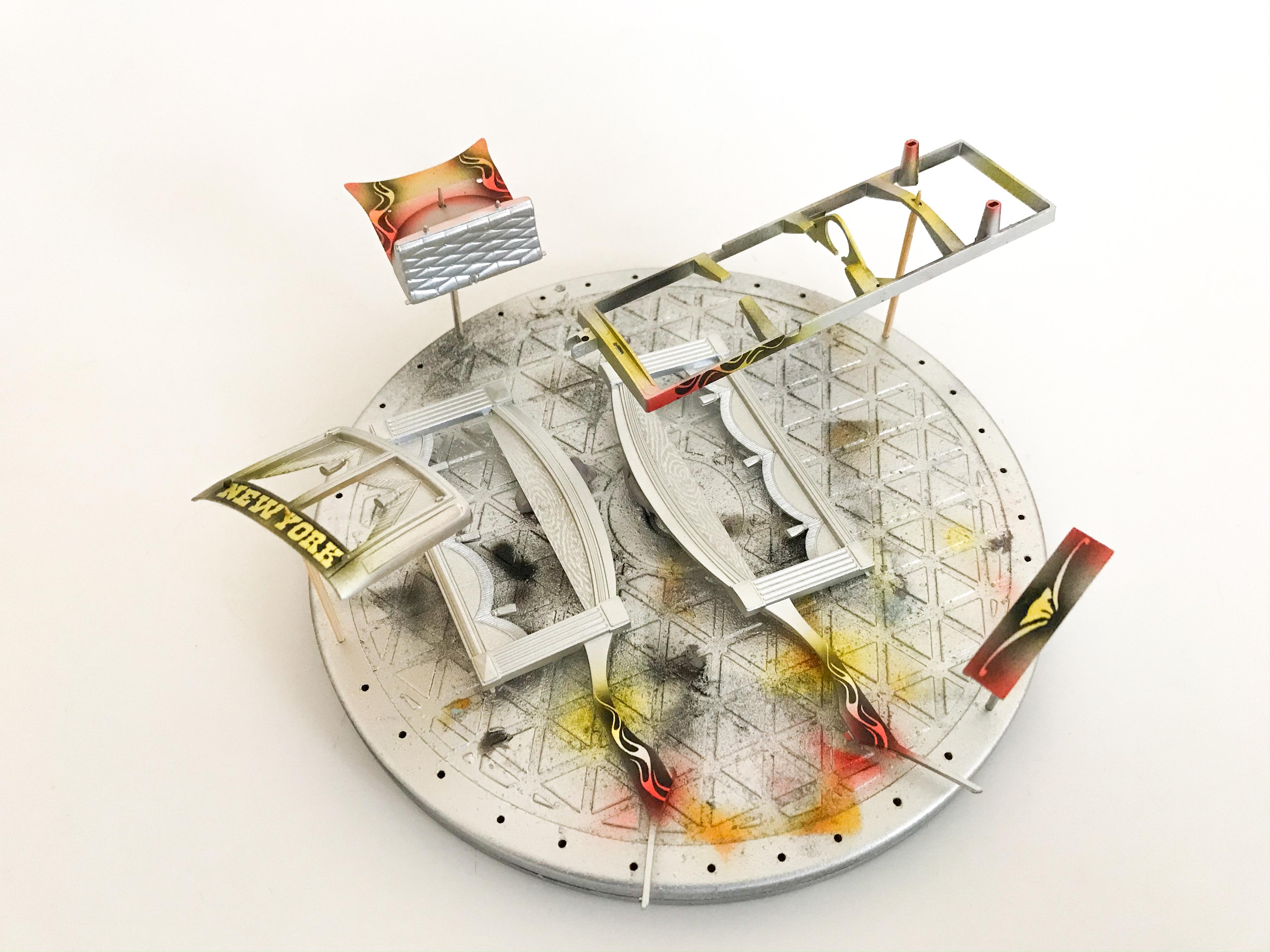

So, into some paint!  I wanted to do a nice candy paint job on this one - still kinda looking like the 1:1 but less wood and more sparkles ?.  So, first up, I shot the body, frame and roof with a chrome silver to act as a base:

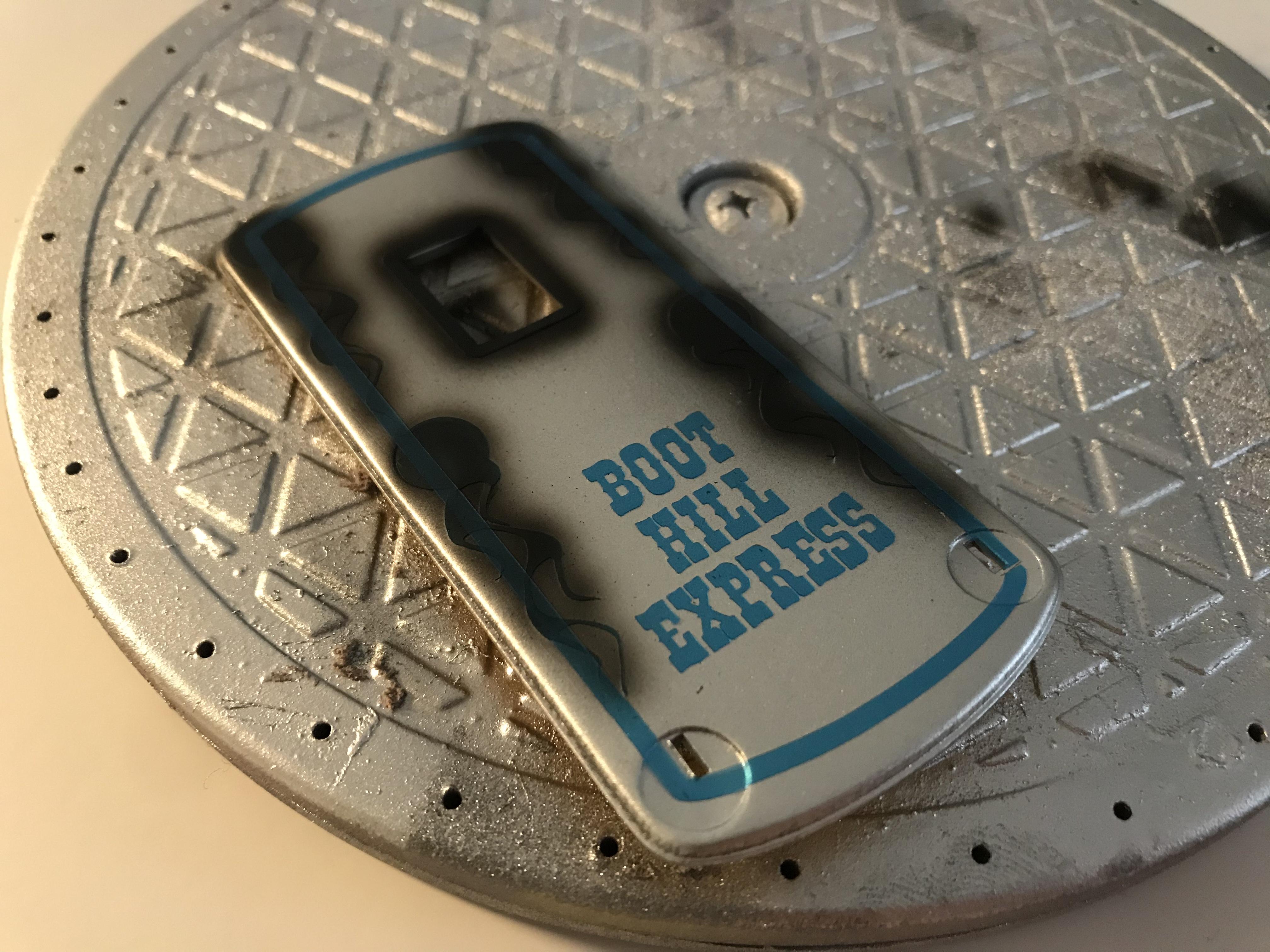

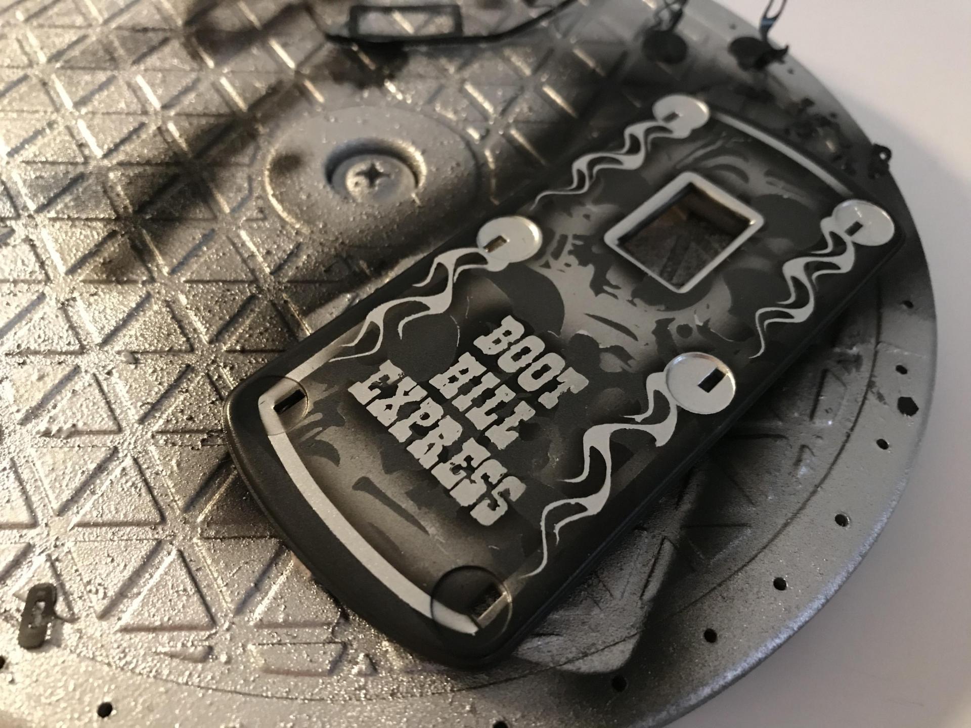

I had an idea I was excited to try on the roof panel, so I’m starting with that.  First up. Some flames:
Next, I gave them an outline - I’m going to run a kind of wide pinstripe around the edge of the roof but I wanted it to look like the flames were sitting over the top of it so I needed to add some depth with a light outline of black:
Next up, I added the stripe and some lettering that I designed (using a font called ‘Boothill’, appropriately enough)...

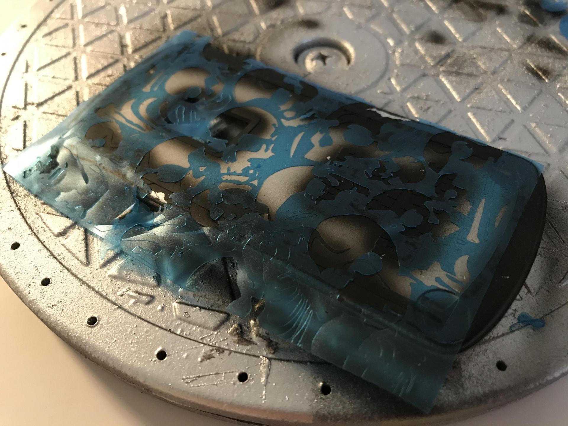

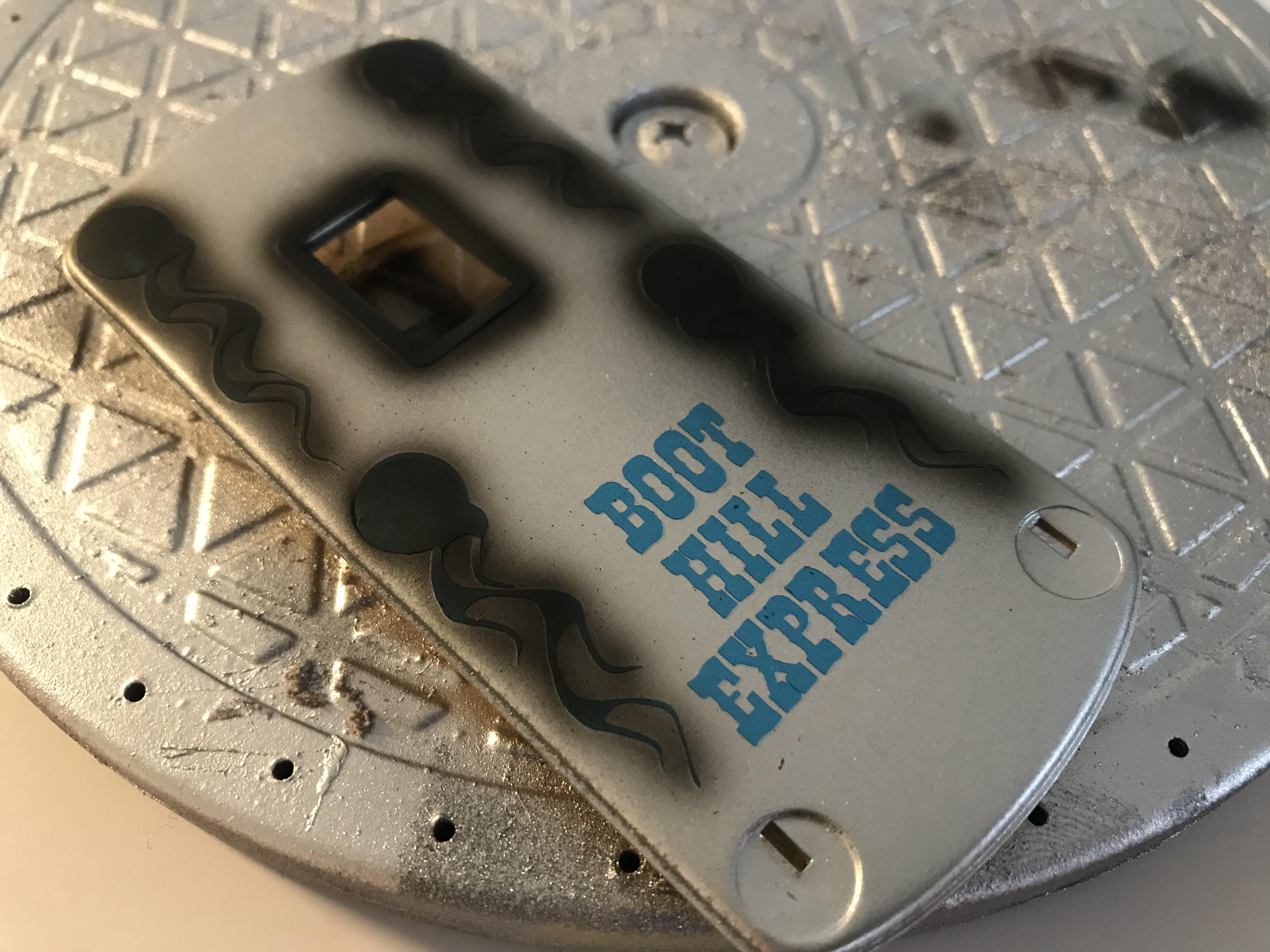

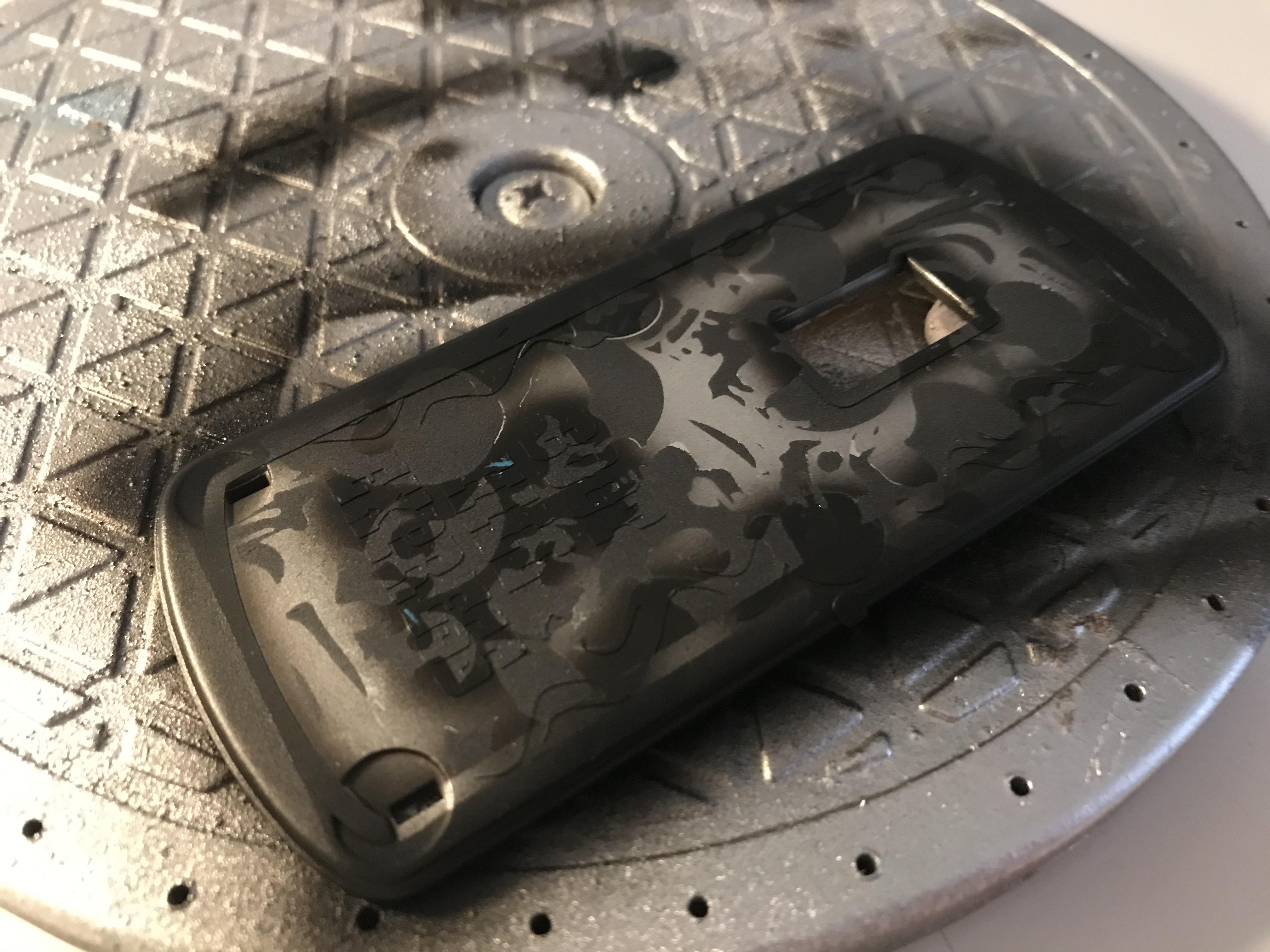

I did the same trick with the lettering as I’d done with the flames, and then cut a skull pattern mask and overlaid that...now, this pattern won’t be super obvious or easy to make out on this panel but I’ll be replicating it elsewhere on the car so I wanted it here too so it all ties together:
I shot some Tamiya gunmetal through that to give some contrast between the bright chrome and the dark black - the gunmetal is somewhere in between so it works well for this part of the process.  Then; we’re left with this:
Finally, I fogged a band of flat back around the edge of the roof to cover those masking lines and then peeled off the masks:

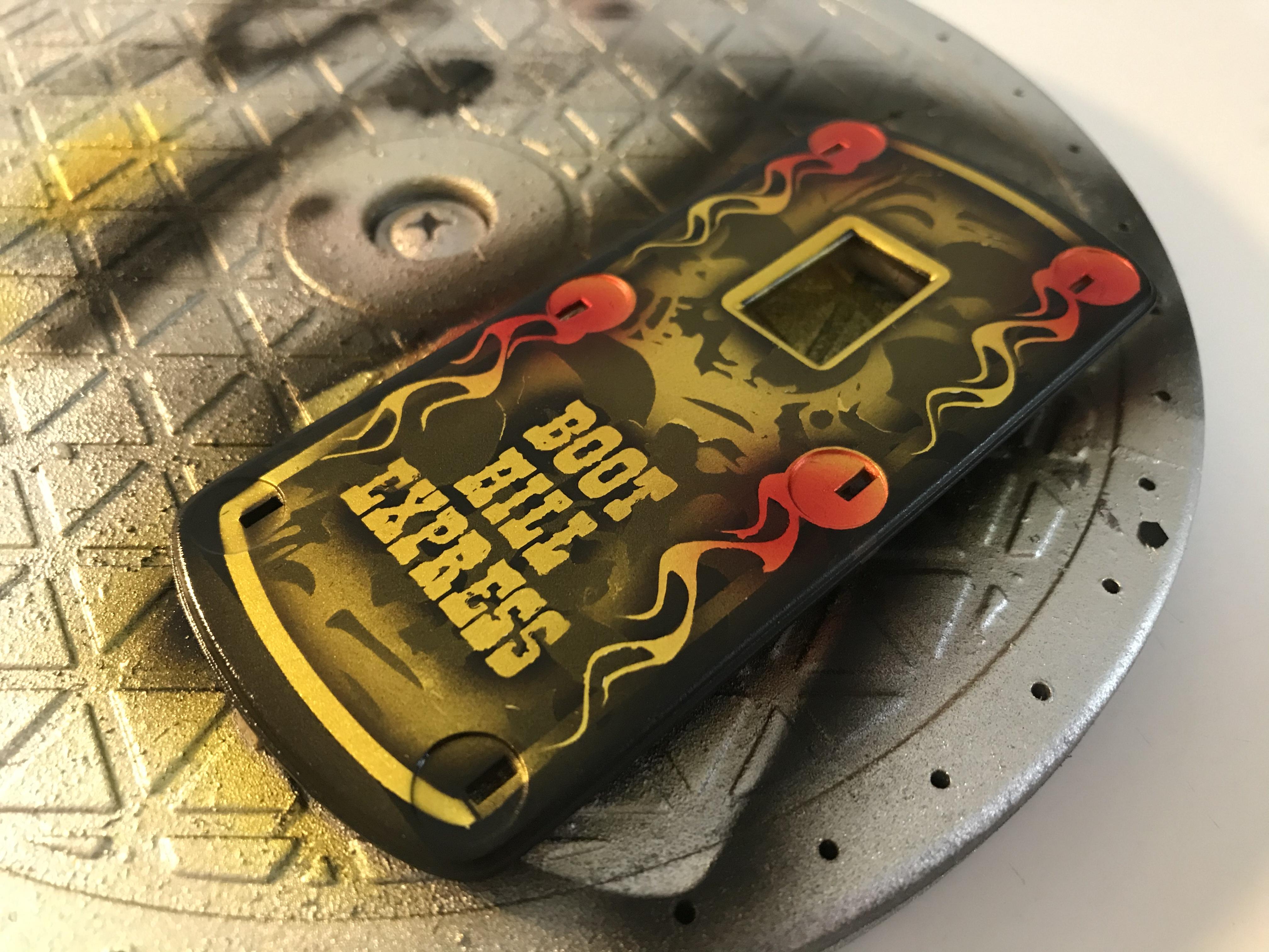

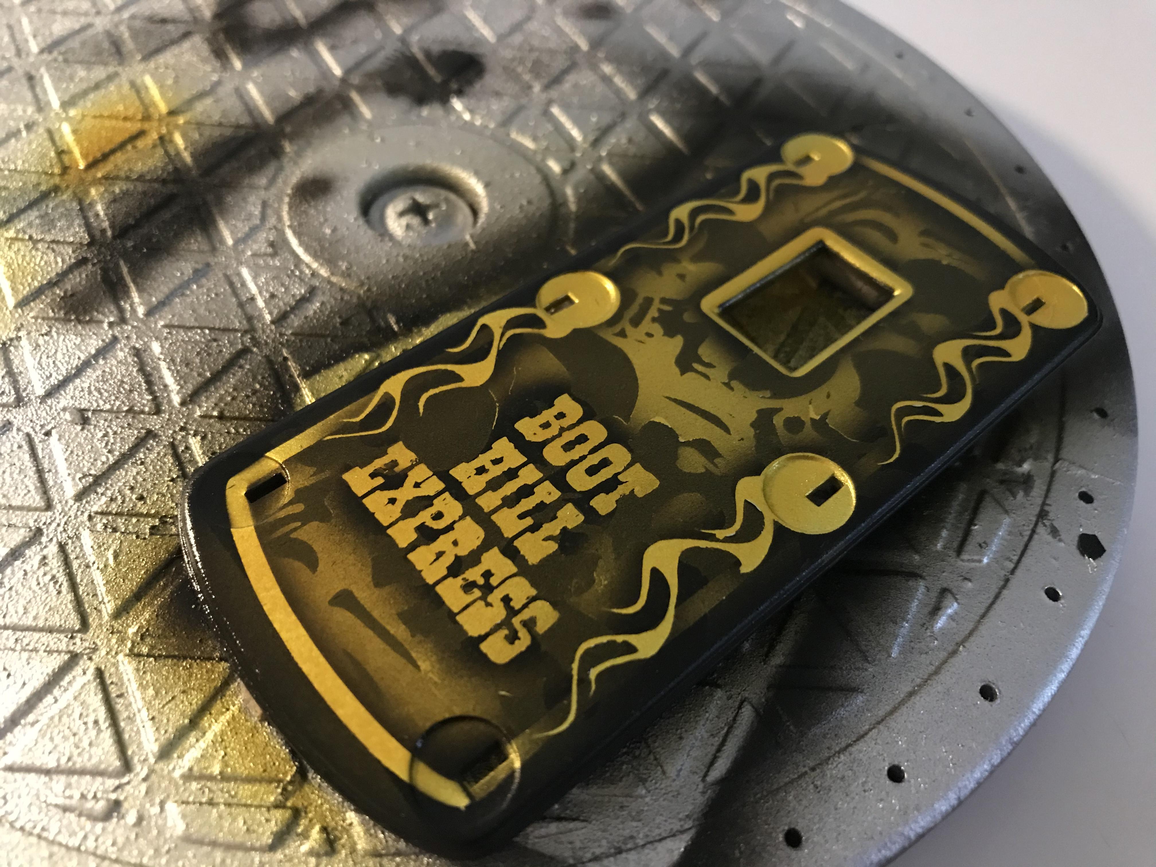

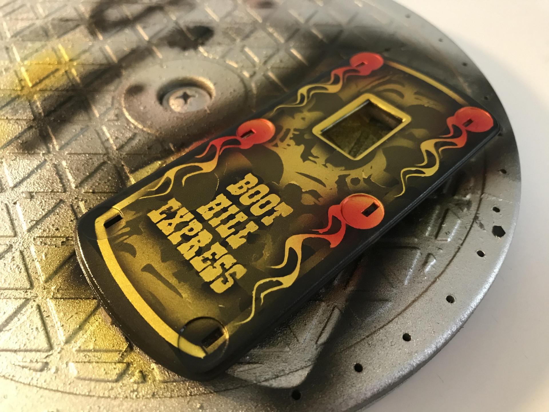

Super pleased with that!  Next up, some candy yellow - I wanted the lettering to look gold so it stands out, but I added some shading to the whole roof with this color anyway:
Then, some little bursts of red on the flames - I would normally do this after the last color but I didn’t want them quite as bold and bright as they would be if I did that...
Then, finally, candy orange!
I’m happy with how that turned out - I need to let it sit a couple of days to harden up before attempting to clear it...actually, I probably DON’T need to leave it that long but I’m cautious of ruining that work!  Plenty more to do in the meantime though...

 That is a tribute I believe, Howard. Lots of different details, wood, engine, steering.  Car went through auction not too long ago. It is currently in Speedway Motors museum in Lincoln NE.
Pics from various sources. Drag pics fun. There are 3, the original, the drag car, and a runner. Virtually identical save for fiberglass on the #2,3 cars
Great build of cool kit.
https://www.museumofamericanspeed.com/boothillexpress.html
boothill-express-ray-farhner-gallery-13.jpgboothillstock.jpgray-farhners-boot-hill-express-30-jpg.3684
Boothill Express By Ray Farhner Rod & Custom March 1967.jpgDrag Racing Cars  (6).jpgDrag Racing Photo's (2250).jpg

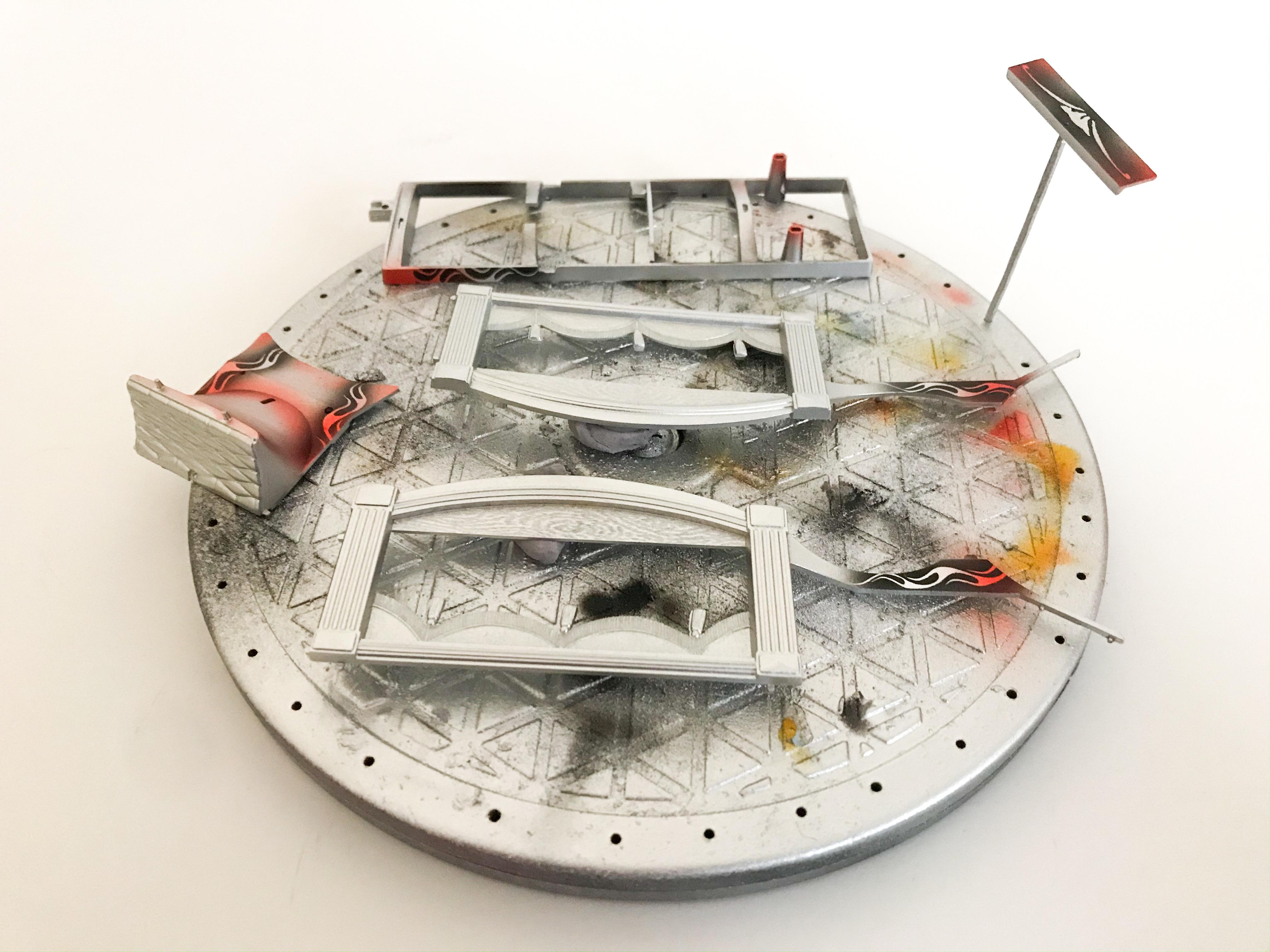

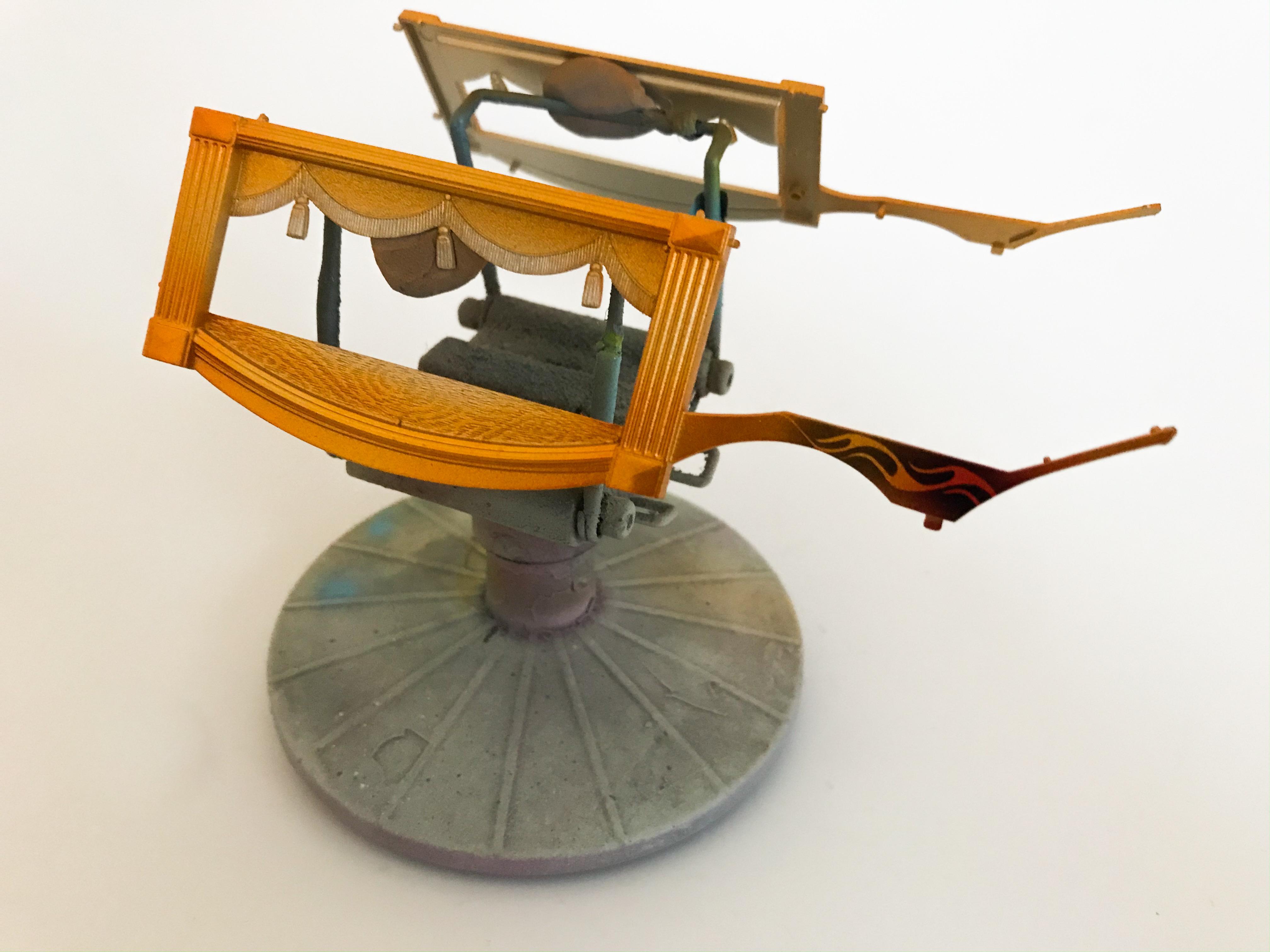

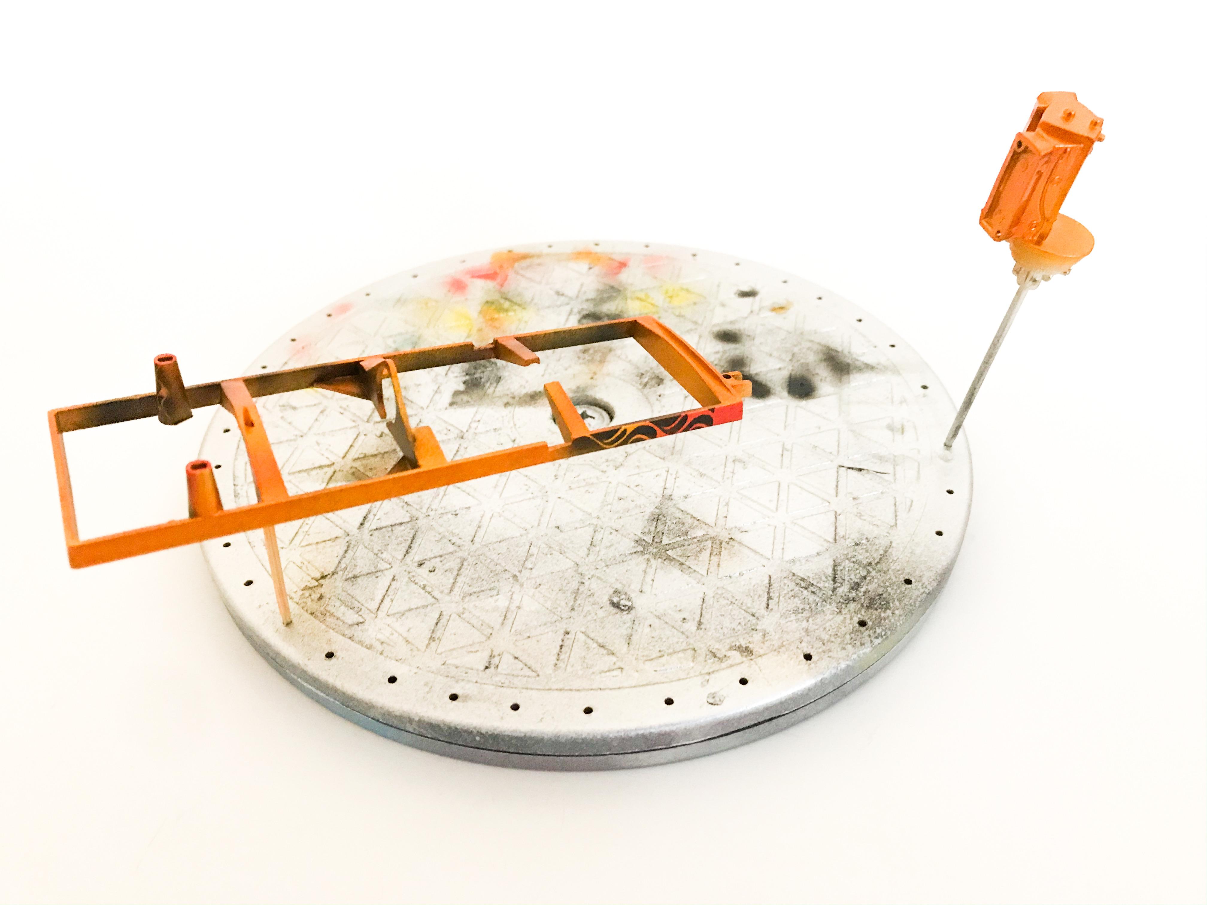

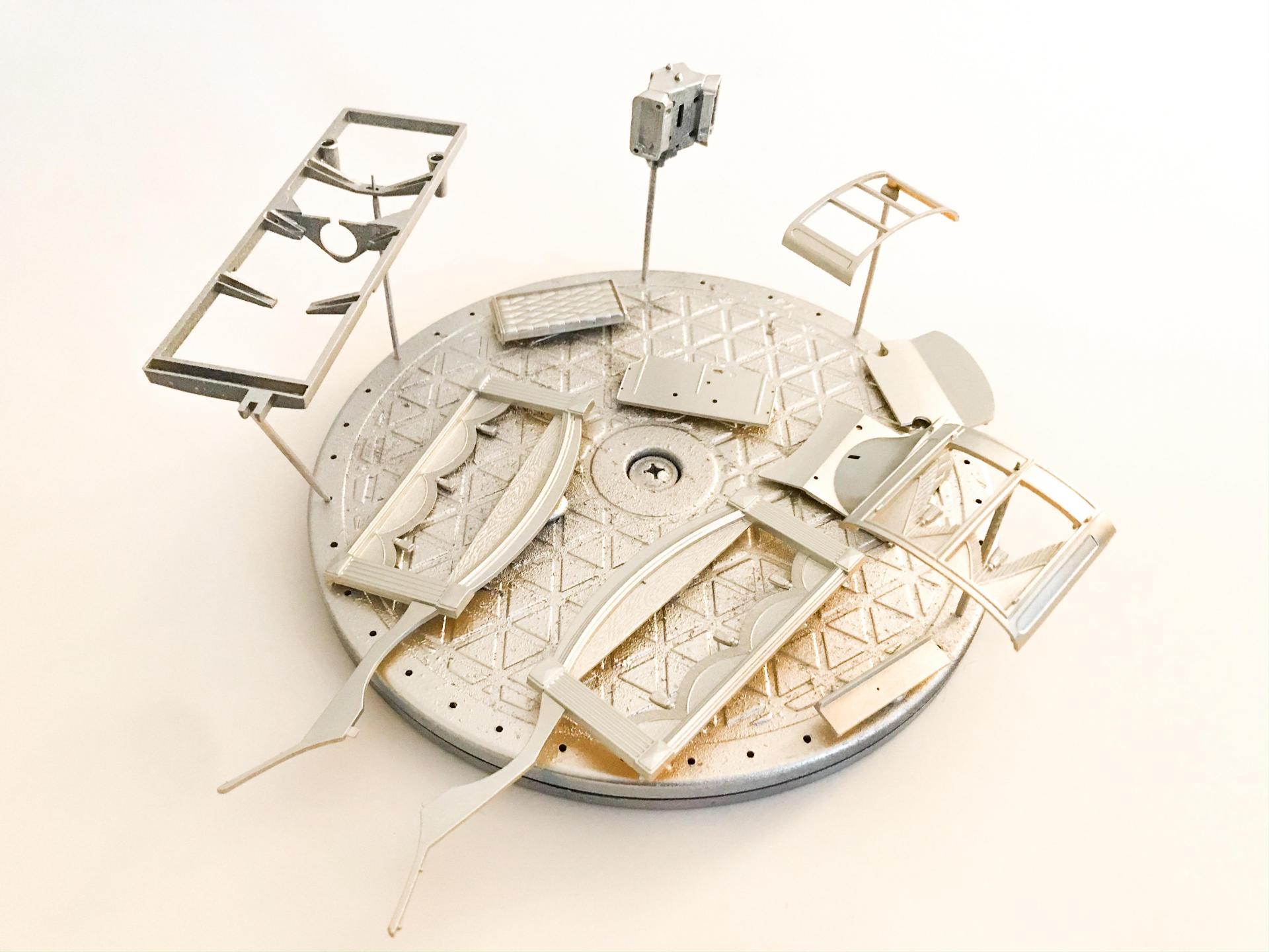

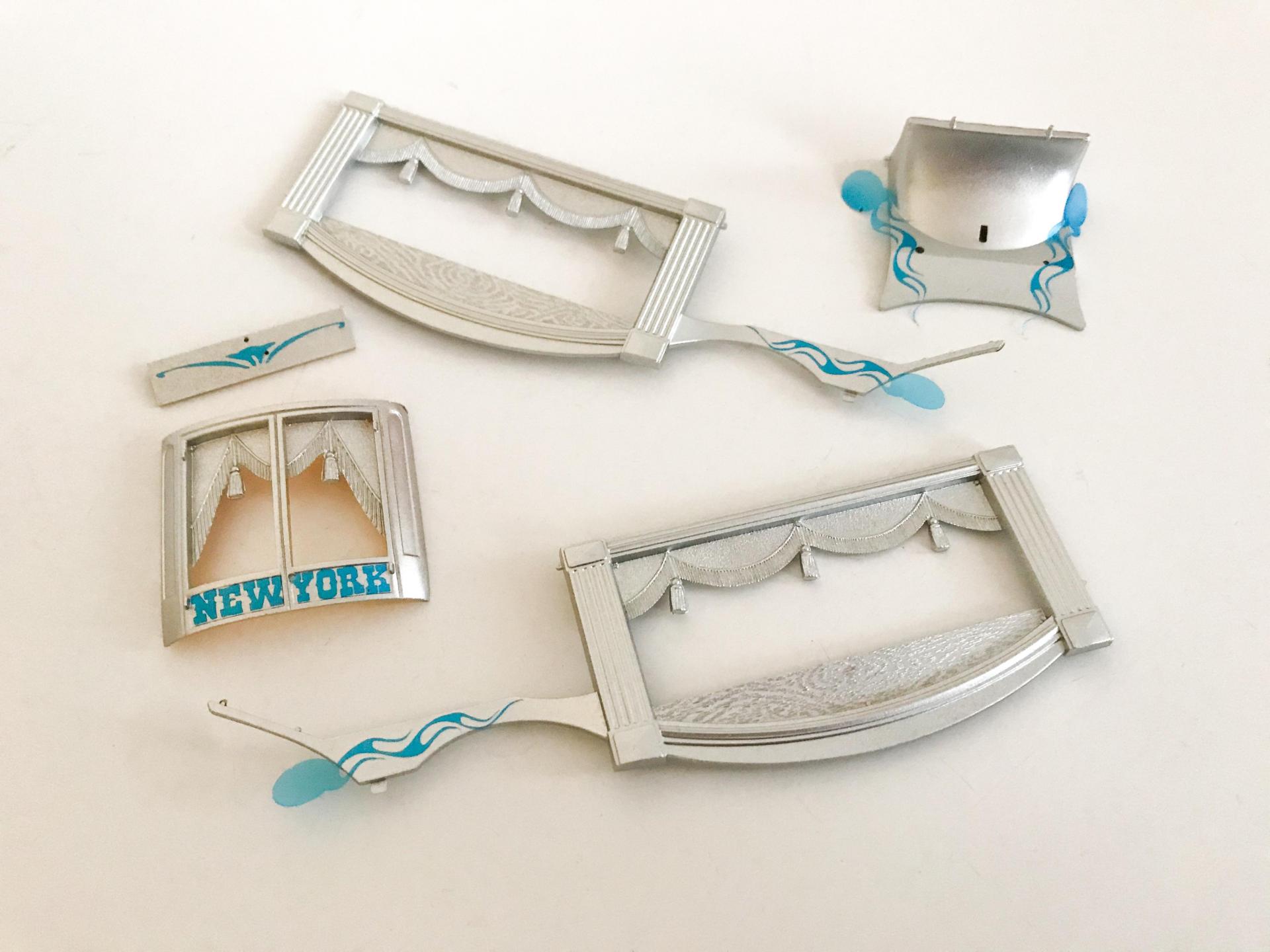

Cut some more masks to add a little detail to some of the body parts and frame today:
Then gave them a little red candy:

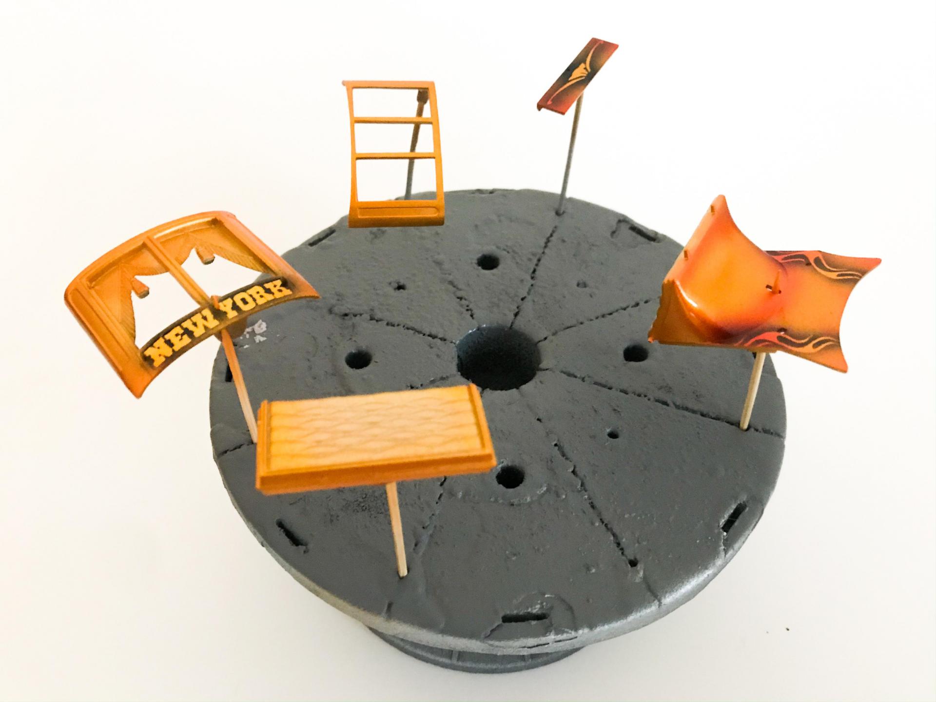

Then some yellow:
And then the main color - pleased with how this candy orange looks on there!
Got a bunch of clearing to do now!  More soon, soon as I’ve done more!
