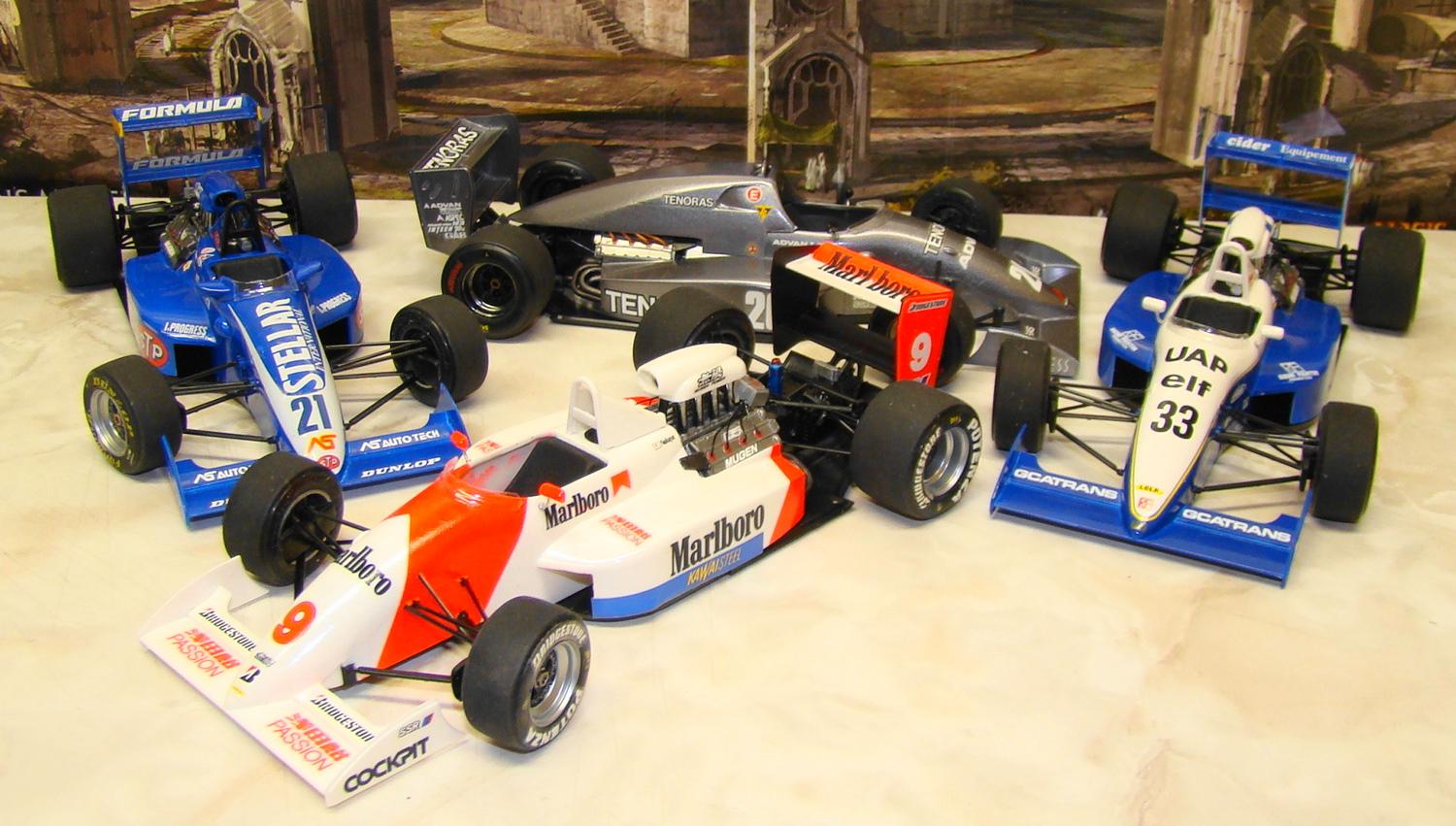

Rich Chernosky Posted December 26, 2019 Posted December 26, 2019 13 hours ago, Art Laski said: Rich, Thanks for sharing your builds. They look great! Did you use the kit decals for the flo red on this one or did you paint it? I would have considered using the decals, but the ones on my kit were a bit out of registration. I'm also wondering if you changed the livery on one, or if there was one you don't have. The other one I have is a red and white car with Cabin sponsorship. I'd like to get them all! lol. -Art Art...I spray most of my graphics now. Large kit decals tend to wrinkle and often, as you say, printed material can get out of register. Color I used for the Marlboro was by Pactra in their Short Cuts line which is usually sold in larger bottles in hardware stores. There are other flourescents you can use. I clear coated the graphics with waterbase clear. It doesn't yellow or change the color of the flourescent. I have other F-3000 1/24 kits made by both Protar and Hasegawa. There are also two 1/20 F-3000 made by Modelers. One is the same Marlboro livery and the other is the Cabin. Got those too. And thank you for the compliments.
