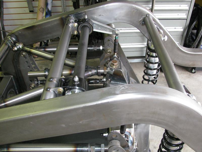

Claude Thibodeau Posted September 11, 2020 Posted September 11, 2020 2 hours ago, AmericanMuscleFan said: Hi again Claude! Thanks buddy, I do appreciate your sentiment about my build! Your suggested solution to triangulate the rear end is a clever idea and I will take a look at the possibility to make it that way if nothing work as planned. At the beginning of the build, my very first idea (put on ice meanwhile) was to use a more traditional approach (like the photo attached) and as mentioned I'll see how I could incorporate this functionality later in the build when the final adjustments on the suspension are started. This part of the build will be very very busy... a lot of attachment points bolts and pins in perspective... I may need some intuitive instruments for the final assembly... ? Thanks again my friend, Francis Hi Francis! Wow, lots of action in this picture: anti-sway bar, 4 bars and a big TRIANGULATED Panhard rod. Quite cumbersome. My idea would achieve the same stability, but with much less mass and weight. And since your Dodge will be a drag truck... might as well save some weight! Keep on! CT
AmericanMuscleFan Posted September 13, 2020 Author Posted September 13, 2020 On 9/11/2020 at 7:11 PM, Claude Thibodeau said: Hi Francis! Wow, lots of action in this picture: anti-sway bar, 4 bars and a big TRIANGULATED Panhard rod. Quite cumbersome. My idea would achieve the same stability, but with much less mass and weight. And since your Dodge will be a drag truck... might as well save some weight! Keep on! CT Hi Claude, Sorry for my lack of knowledge about all the exact names and terms for all these suspensions/stabilisation system components... you are really ahead of me in this area with your vast experience in building real things... Speaking of weight, the mill of a thousand horsepower under the hood should be able to support the few extra pounds... even if that's not the best option when it comes to performance! I might be tempted to go with the most spectacular but the reality could catch me at the end... I keep your idea in my boxes as we say in our part of the country and I will see it when it comes time to take action! Always a pleasure, Francis
