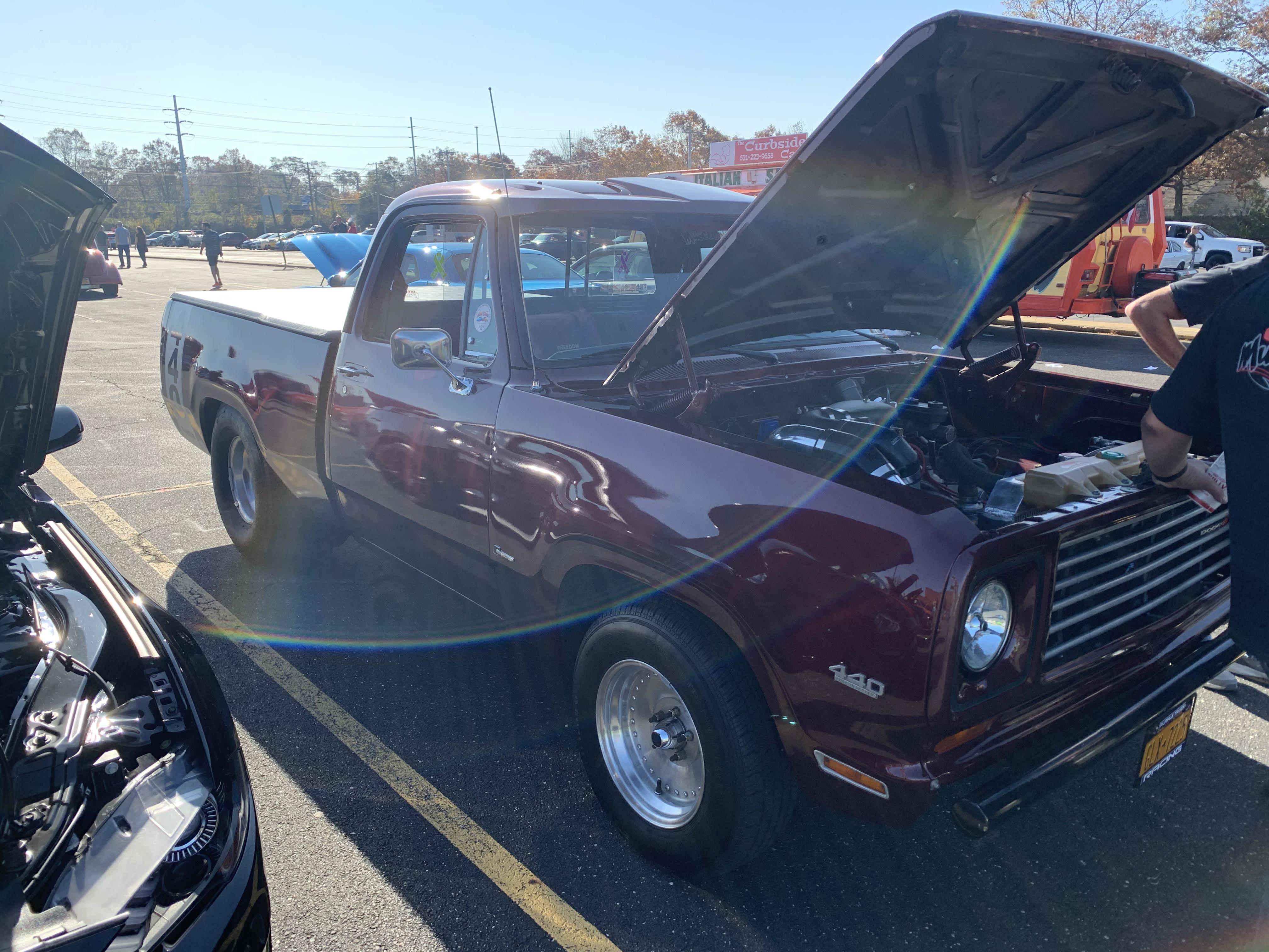

19 hours ago, NYLIBUD said:
Saw this beast at a car show yesterday.I know it’s kind of hard to see with the sun in the background.Not sure what year it is.
Thanks for the pic Ron, it looks like a '72 D100 but it's hard to confirm with the custom grille.
Take care, Francis
