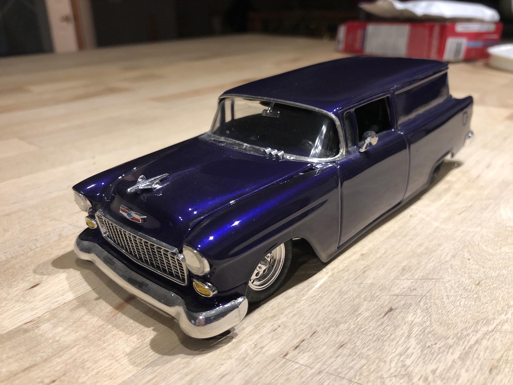

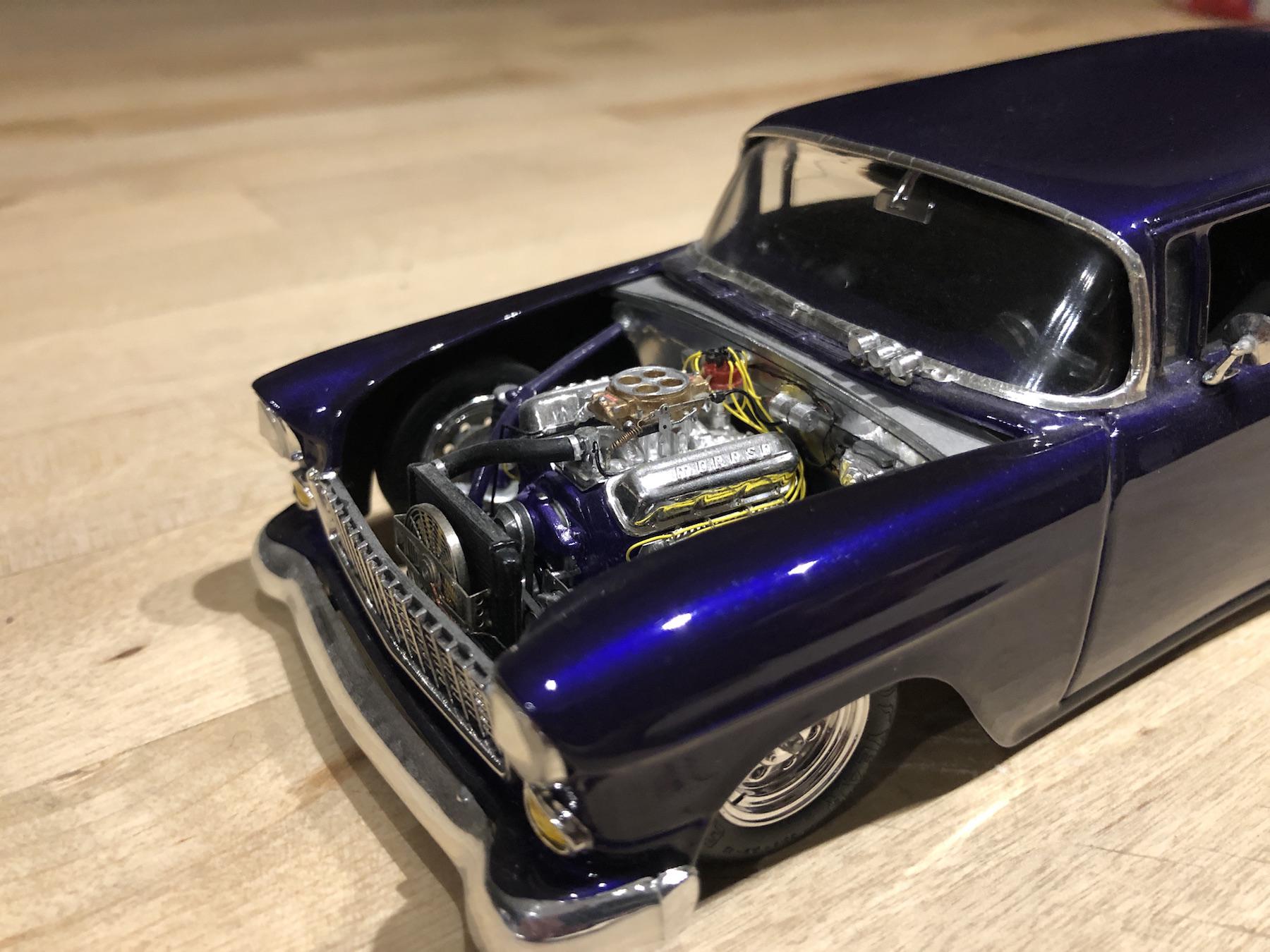

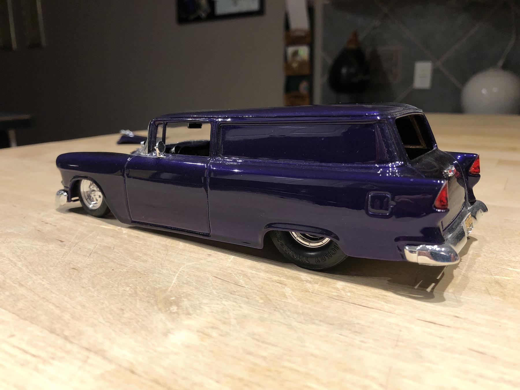

I built this 55 delivery in 2002. I was so honoured to have it featured in Scale Auto (Oct 2003 issue). A friend of mine helped me paint it at his body shop in the down draft booth. It did very well at the shows! A ton of great comments !!! But,......!!!! as the years go by,.... it is dying!!
The body is warping away from the chassis, the hood no longer fits, its sagging in the front right corner, roof sagged and the rear window pop't out!!!! What is up with that???!!! Is it "gassing out" ? Did the paint shrink the body? I have had it displayed in my cabinet, not air tight ... like I said since 2002. I guess the resin body gets as old as me! So what ever it is, your "prize" build could go for BLAH_BLAH_BLAH_BLAH over time!!! BEWARE!!! Sad, all that effort! Has someone else experienced this? Please let me know! Mind you, to little, too late?

When I first purchased this resin body (1st one) I had no idea the quality, the material, the stability. It was one of those "have to have it" to help create the illusion. Now I know!
Never been exposed to sunlight or in a sealed case so,...  Guess live and learn, still a shame

Some resin hoods and other smaller parts warp (curl up) because they have an extremely thick area adjacent to a thin area.  One such example is an early Camaro hood with the Yenko scoop.  I have two of those, from different casters.  They are designed the same way: scoop is mostly solid making the hood twice as thick in the middle.  Both hoods are curled upwards at the rear corners.
The amount of shrinkage with most resins is miniscule.  But concentrate all of it in one direction, and you'll end up with warpage like this.  A resin body that is a copy of a conversion, with say, the roof or body sides changing in thickness by a great degree will also do this.
I stay away from a lot of the thinner castings because of this.  The right material could probably be cast as thin as some pieces are being done, but few of us doing these things have the engineering background to determine which material is best for a particular purpose.  We're using the same resin for everything, usually the stuff we are used to working with.  Even so, if you avoid abrupt changes in thickness, you'll probably be okay.
