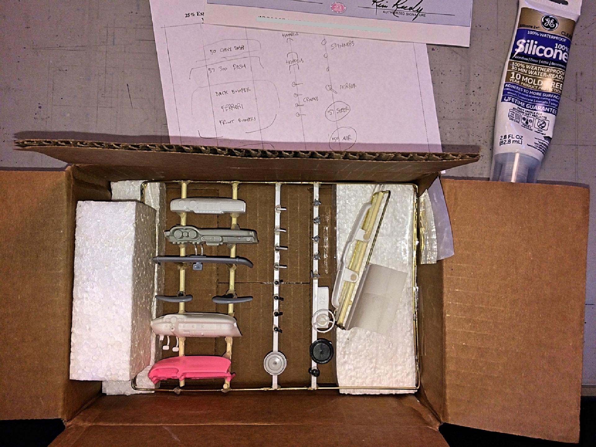

89AKurt Posted February 8, 2020 Author Share Posted February 8, 2020 Ok, sent my projects off to Little Kar Company yesterday. Fingers crossed, look forward to a positive report. Quote Link to comment Share on other sites More sharing options...
peteski Posted February 8, 2020 Share Posted February 8, 2020 (edited) I would have bagged the frame in a Ziploc plastic bag (in case parts come loose during shipping). That is how I used to send mine out. Also, instead of hard Styrofoam cradle in a small box, I would place the bagged part in the center of a bed of packing peanuts, in a larger box. If the box gets slightly crushed or dented, in your type of packaging the frame will get bent or damaged. Using my method, the "peanuts" would just readjust, and the rack would be left undamaged. I spend way too much time stripping, smoothing and racking my parts to take *ANY* chances on shipping damage. And it happens. Good luck Kurt! Edited February 8, 2020 by peteski Quote Link to comment Share on other sites More sharing options...

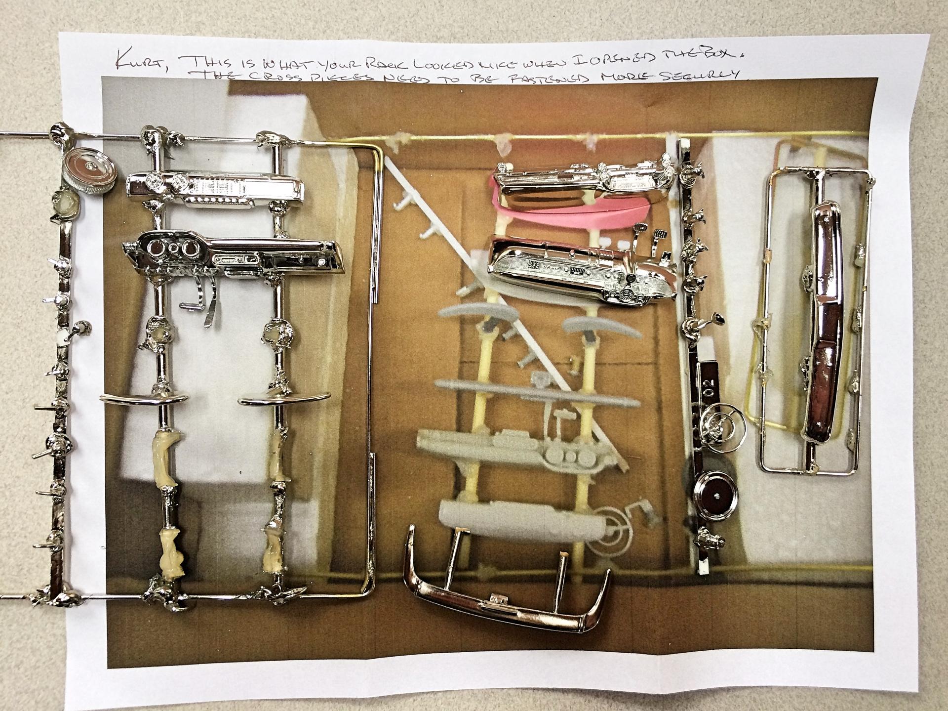

89AKurt Posted March 11, 2020 Author Share Posted March 11, 2020 On 2/13/2020 at 7:33 AM, Greg Wann said: [...] I'm sure if I had such equipment I would be busier than a one armed wall paper hanger. Thanks for the contribution to my topic. I think you would be! On 2/8/2020 at 11:34 AM, peteski said: [...] I spend way too much time stripping, smoothing and racking my parts to take *ANY* chances on shipping damage. And it happens. Good luck Kurt! Thank you too for your contribution. And thank you, it worked! ? Pleased to report, received today! He even took a picture to explain that I did not use enough silicon caulking to attach the sprues. Turn around was better than expected, a couple days over one month. Quote Link to comment Share on other sites More sharing options...
peteski Posted March 12, 2020 Share Posted March 12, 2020 (edited) Congratulations Kurt! Your package was handles gingerly, and the parts look great! Take that Alclad and Molotow! EDIT: While it was staring me in the face, I don't know why I didn't realize that there was an "Oops". Oh well, live and learn. . . . I never use silicone caulking when I mount my parts on the rack. I drill and pin, and use CA glue. Here is one of my racks. Some parts and parts of the reck have been already cut out. The rack is made of Evergreen square styrene. Edited March 12, 2020 by peteski Quote Link to comment Share on other sites More sharing options...
