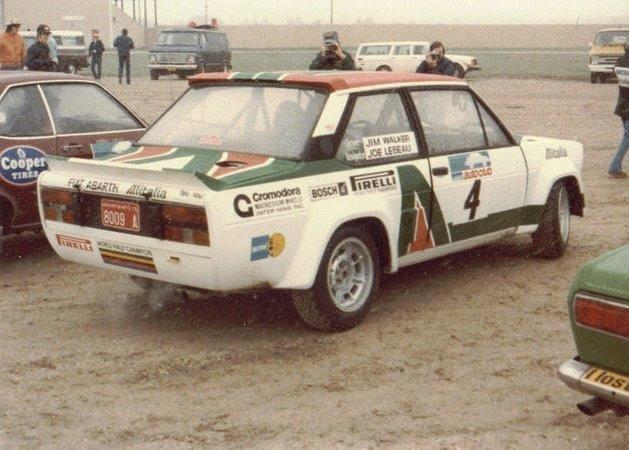

kermn8r Posted June 1, 2020 Posted June 1, 2020 On 5/17/2020 at 5:09 AM, afx said: Thanks Ray Thanks Walt. Do you have any photos or information on Goodwin's car that you would care to share? Sorry JC, I don't have any photos of Goodwin's car. I emailed a friend of mine to see if he has any. Two of the factory cars were shipped to the US for the 1979 rally season. Danny Goodwin got one for West Coast Rallies and Jim Walker got one to run the East coast Rallies. The cars were in Alitalia livery with appropriate changes for identification for NARRA or SCCA Pro Rally. f I did things right, there are a couple photos of Jim Walkers car from the 1979 20 Stages rally in Michigan. If you click on "1978-79/" of the link below it will bring you to a directory of articles on the cars being brought over to the US. If you click on "1980-81/" of the link you can find the "Car & Driver" and Road & Track" test drive articles of the cars. The "Car & Driver" article has some interior and engine compartment photos. http://www.realautosport.com/images/mcmahon/Rally Data/ Bummer about the engine size, but love the work going on.
