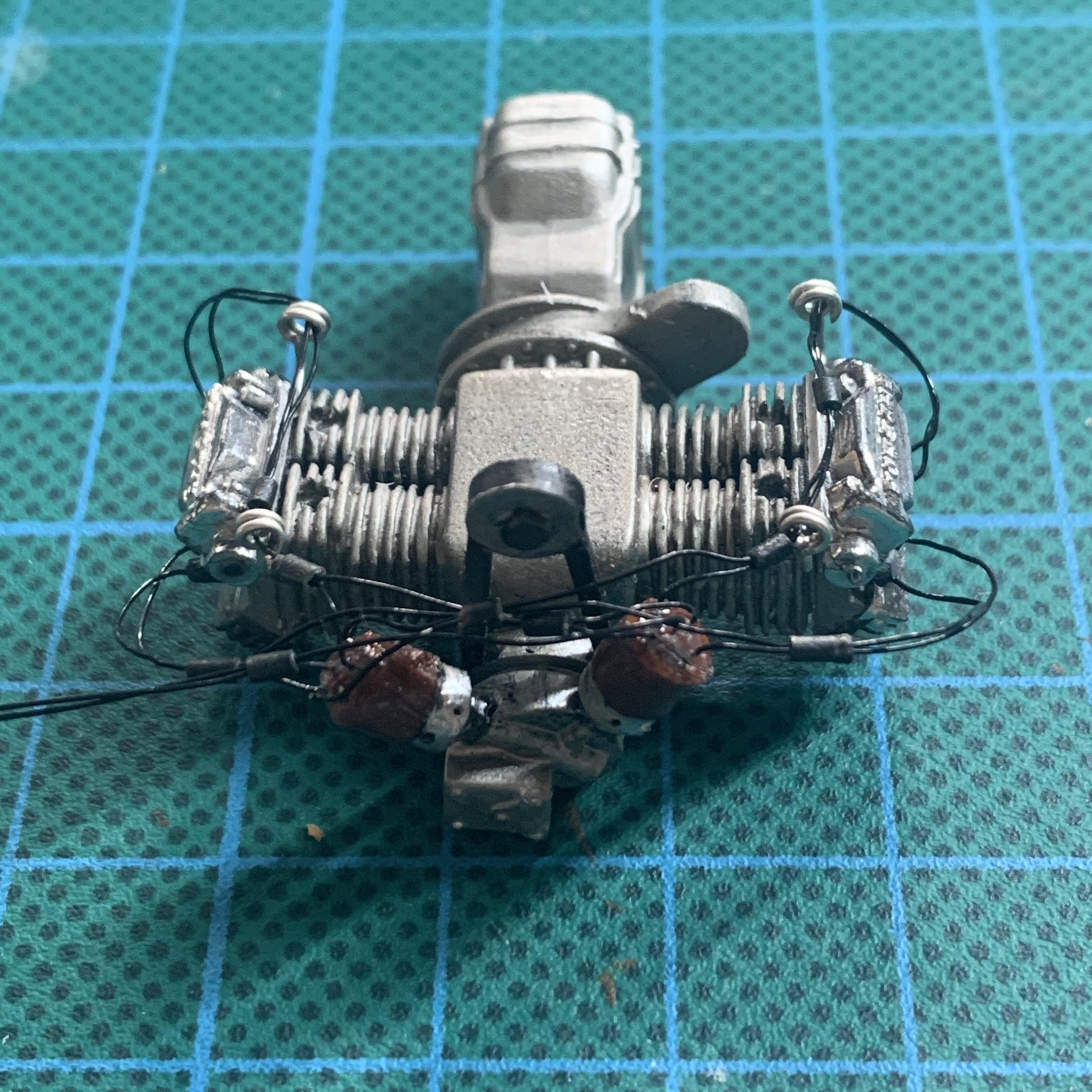

wilronertson Posted December 20, 2021 Posted December 20, 2021 You have given this kit respectful justice. I got this as a birthday present in the Mid-70's (I didn't even know what a Porsche was then) and made it as best I could as a young teenager. I found it when we cleaned out the family home, and kept it in the original box. The glue had separate the parts in places, and I have now repaired the body, and will re-paint as an homage to the James Dean 356 he had briefly before the 550 Spyder. Even though it is an old kit with ill-fitting parts, fat tyres etc it sparked my interest in the earlier Porsches, and 'in the process' of putting together a 550 Spyder (Ukraine model), a 904 (monogram-vintage), a 917 (Heller - Vintage), and another 356 speedster from eBay (different boxing), and the Tamiya 356 Coupe. I am much slower and a little more careful with how I now tackle my learning curve back into the hobby. Here is my progress with the 547 Carrera engine for the old 550 Spyder kind regards Wil

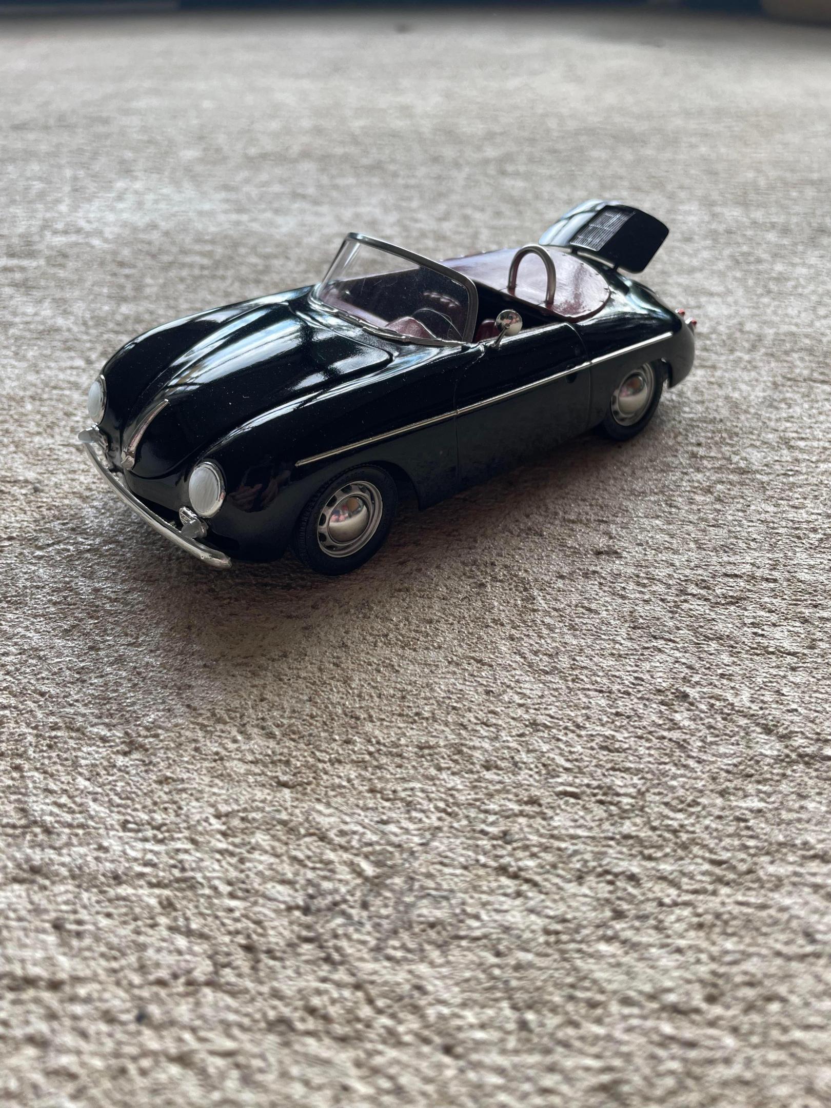

Steamboat Posted April 5, 2023 Author Posted April 5, 2023 Finally finished this one. Unfortunately I don't have photos of the struggles to get it done. I'll post some more pictures in the Under Glass section.
Paul Payne Posted April 5, 2023 Posted April 5, 2023 Really nice job= I built one years ago and added flares. Headlights are from AMT Avanti.
drodg Posted April 5, 2023 Posted April 5, 2023 55 minutes ago, Steamboat said: Finally finished this one. Unfortunately I don't have photos of the struggles to get it done. I'll post some more pictures in the Under Glass section. That is a great job! Oh my I am so impressed.
