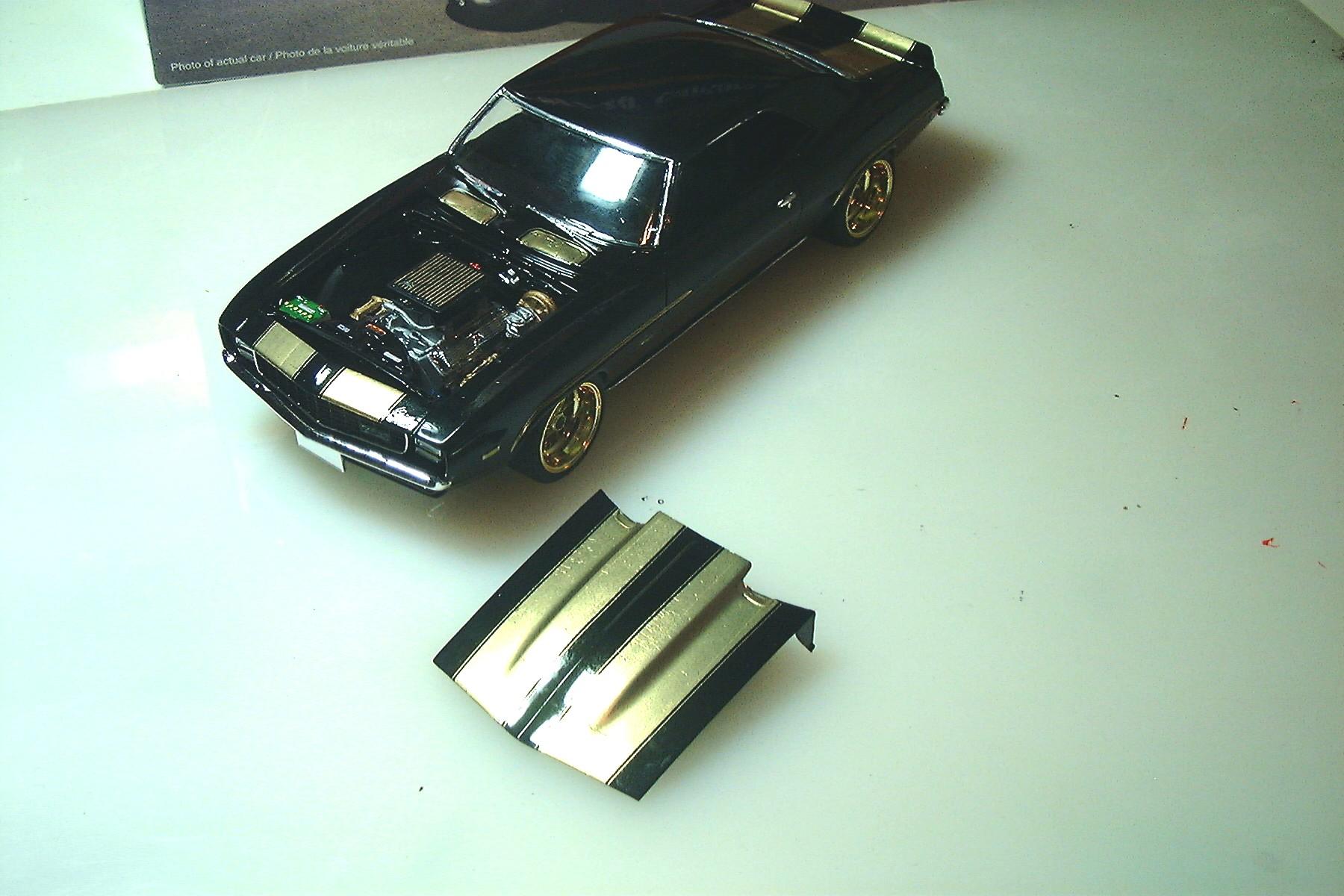

vairnut Posted April 7, 2020 Posted April 7, 2020 Clear lacquer will mess up chrome or gold foil decals - even when dusted on very lightly. To solve this I put a layer or 2 of clear decal film over foil decals before clearing.
Bills72sj Posted April 7, 2020 Posted April 7, 2020 I'll put my 2 cents in here. Alps printed gold decals plus Testors Clear Glosscoat = wrinkled decals. Been using Future brushed on ever since. However, I have never been brave enough to wet sand OR polish ANY of my paint jobs. (seems too risky to me)
DoctorLarry Posted April 7, 2020 Author Posted April 7, 2020 The clear did cause some crazing of the foil decals on my Olds. The clear film decals did fine. Thanks for the tip about putting clear film over them. I ordered a new decal set and will replace the foil 28 numbers on the side but now I know better.
magicmustang Posted April 7, 2020 Posted April 7, 2020 11 hours ago, Bills72sj said: I'll put my 2 cents in here. Alps printed gold decals plus Testors Clear Glosscoat = wrinkled decals. Been using Future brushed on ever since. However, I have never been brave enough to wet sand OR polish ANY of my paint jobs. (seems too risky to me) Agree on using Future brushed on over decals. Been using it for over 50 years, and paint and decals still look great. No chipping or yellowing. Highly recommend it.
Bills72sj Posted April 8, 2020 Posted April 8, 2020 9 hours ago, magicmustang said: Agree on using Future brushed on over decals. Been using it for over 50 years, and paint and decals still look great. No chipping or yellowing. Highly recommend it. It is good at keeping BMF down too.
