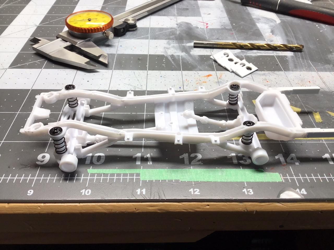

NOBLNG Posted April 6, 2020 Posted April 6, 2020 (edited) This one has been cooking in my brain for awhile now. I have a ‘71 Jeepster Commando, and wanted to replicate it. But I figure I will go a little wilder with this one than I did on my 1:1. I was going to use the Commando frame, but the TJ drivetrain is much beefier looking and nearly the same wheelbase. Thoughts or insights welcome. Edited April 6, 2020 by NOBLNG

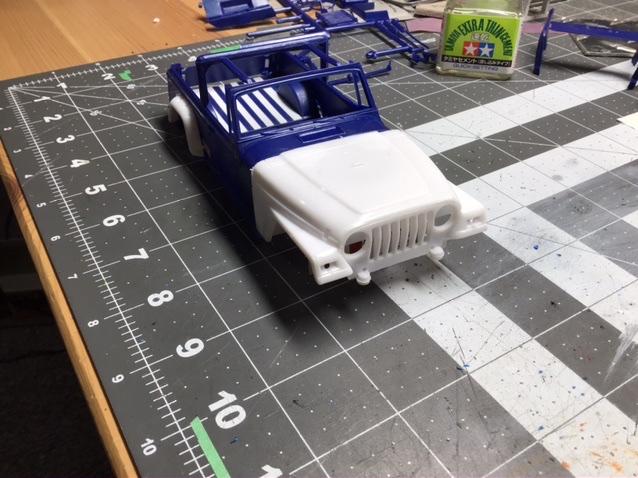

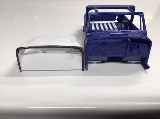

NOBLNG Posted April 6, 2020 Author Posted April 6, 2020 I am also putting the TJ front clip on since I really despise the look of that AMC bullnose front end. It shouldn’t be too hard to blend despite a slight difference in width. I braced the front clip before removing it as I want to open the hood also. The Revell kit did not have an opening hood or an engine. I’m not sure what engine I’ll use yet. Maybe the Hemi or 5.0 litre from a ‘32 Ford kit? Definitely not the V6 from the Commando!

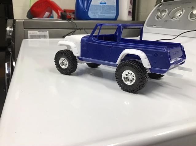

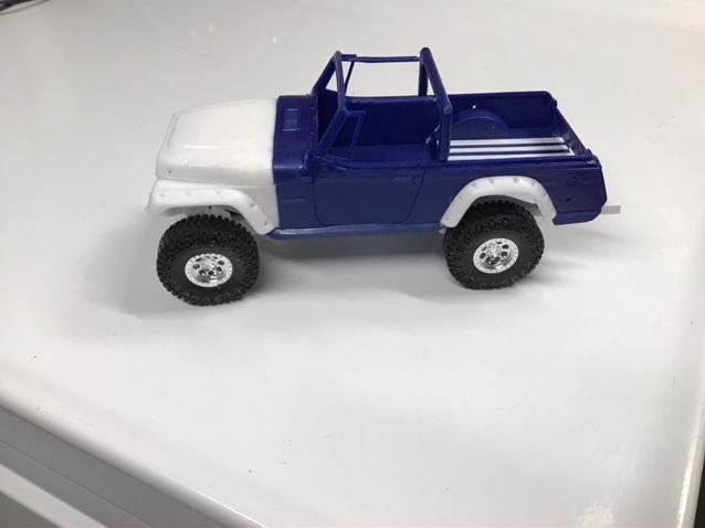

NOBLNG Posted April 6, 2020 Author Posted April 6, 2020 (edited) On 4/6/2020 at 9:45 AM, espo said: With the longer wheel base and the Commando back half of the body this should be interesting. The TJ is actually a little shorter wheelbase, but I am going to have to stretch the frame to get the front wheels centered in the wheelwells. I’ve had to give it a scale 2” body lift to clear the frame rails over the rear axle. This was an easy fix using the old hockey puck trick.? Edited April 7, 2020 by NOBLNG
NOBLNG Posted April 6, 2020 Author Posted April 6, 2020 1 hour ago, crazyjim said: What's old hockey puck trick? Some 4x4 guys would stack hockey pucks on top of the mounts to get a body lift.?

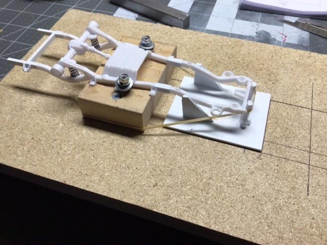

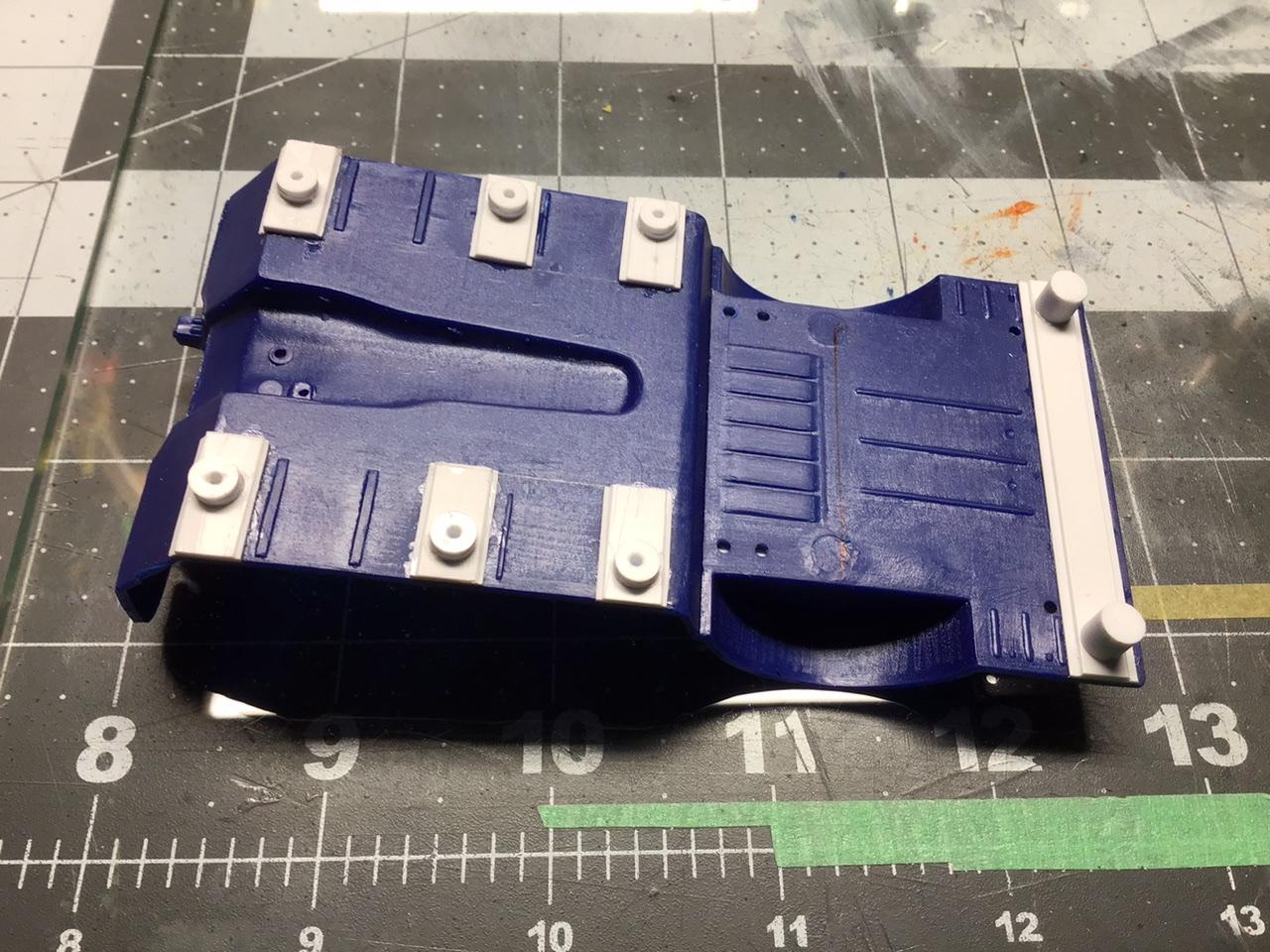

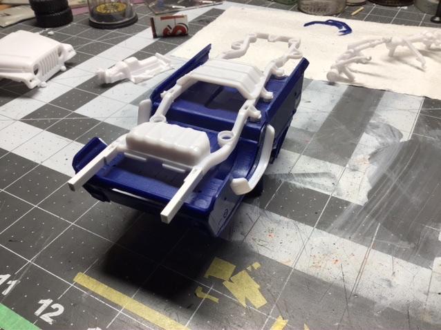

NOBLNG Posted April 7, 2020 Author Posted April 7, 2020 (edited) I’ve filed off the tiny bumps that were the frame locating pins and replaced them with .050 styrene pins. Fabbed up some body support channels along with a rear cross member and mounts. I also added another scale inch (.040”) of lift and I can easily add more later if needed. I trimmed a tad too much out of the wheel-wells, so I have to add that back and re trim them. I also removed the fuel tank. I will either move it rearward to line up better with the filler cap or fab a custom one? Edited April 7, 2020 by NOBLNG

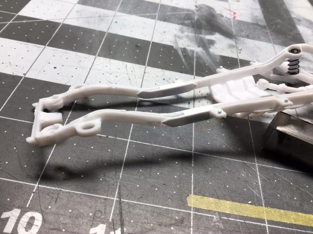

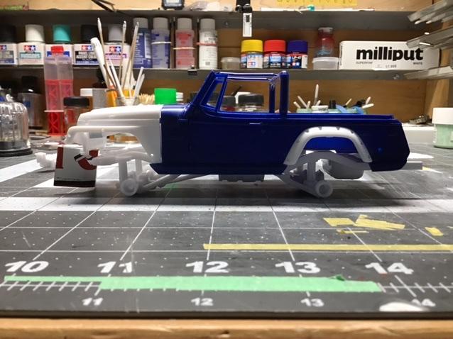

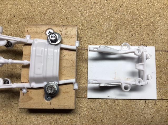

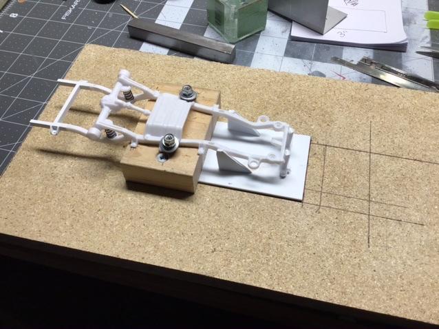

NOBLNG Posted April 9, 2020 Author Posted April 9, 2020 (edited) There is quite a difference in the shape of the Jeepster and the TJ. The TJ is also a tad wider, but the plastic is thick enough that it can be sanded to width. I’ve added some Milliput inside the hood as I think I will be very close to sanding right through the hood when I try to mate it to the Jeepster cowl. I’ve also stretched the frame by 13/32” (scale 10-1/8”) to put the front wheels where they need to be. I kind of like the slicing and dicing but I am in uncharted territory here, so I hope this all works out. Once I have the power train located I will likely have to lengthen the rear driveshaft and move the skid plate forward? Edited April 10, 2020 by NOBLNG

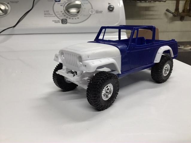

NOBLNG Posted April 10, 2020 Author Posted April 10, 2020 (edited) I fish-plated the frame where I lengthened it today. I also sanded the hood to shape. I didn’t get into the Milliput, but I think I am close?. I cut the hood free and glued and pinned the front clip to the cowl. I stretched it a scale 10-1/8” which puts the frame mounts slightly out in front of the TJ kit location, but I think I need it for tire clearance. Edited June 4, 2022 by NOBLNG Spelling?
