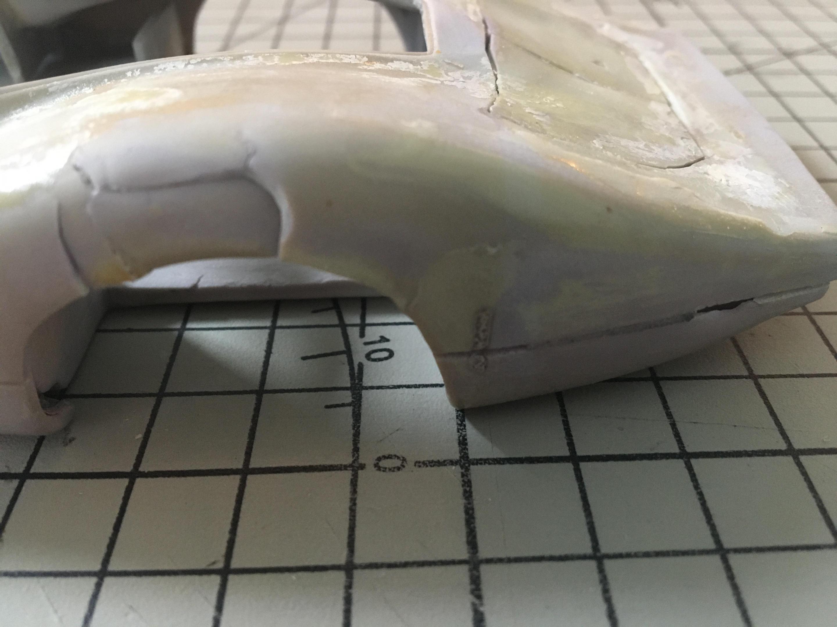

aurfalien Posted May 16, 2020 Share Posted May 16, 2020 (edited) Hi, Would any one have advise on how to harden a rubberized resin body that was stupidly soaked in an alcohol bath? I'm stripping it in SuperClean which doesn't seem to be causing further damage. Once cleaned of any paint etc... my plan was to freeze it for a few days and then slowly reinforce with strategically placed styrene while filling in any gaps, holes etc with Tamiya white putty. After I feel that the body looks good, I was going to use a polyurethane based acrylic primer. Is this a good plan? Is there anything I am missing, should change or add? The kit is my beloved Fisher 908 and rather then discard, I've decided to restore it out of respect to Paul Fisher, his work and his craftsmanship. I'm still very sad over his loss of home and business during the Cali Paradise fires as I can relate going through the same thing in the Cali Woolsey fires. Thanks in advance. Edited May 16, 2020 by aurfalien Quote Link to comment Share on other sites More sharing options...

aurfalien Posted May 18, 2020 Author Share Posted May 18, 2020 I'll start a build thread soon however so it begins. I've stripped it as much as comfort would allow. I feared prolonged soaking in SuperClean would have destroyed it. Still rubbery but the chassis is giving it some stability. I feel like a surgeon piecing together a shattered hip. Man alcohol ate it up like some one eating a breakfast burrito. Quote Link to comment Share on other sites More sharing options...

SfanGoch Posted May 19, 2020 Share Posted May 19, 2020 Like the others said, chalk it up as a loss. It's not that the urethane used was bad. There is no need to ever submerge resin parts in order to clean them, especially in solvents. IPA, and other solvents, is absorbed and breaks down the resin when a resin object is submerged for a prolonged period of time. Brushing on alcohol on the surface, then scrubbing the parts with a nylon bristle brush followed by washing and rinsing in warm water is sufficient. I keep recommending Testors Easy Lift Off to strip paint from styrene and resin parts; but, it seems like I'm talking to myself. Just brush a coat (NEVER EVER submerge any plastic or resin in it. It isn't necessary.) of ELO on the parts and, in about 20 minutes, the paint will start to wrinkle. The paint can be removed by scrubbing it off, followed by washing the parts in warm water and dishwashing detergent. If there is any remaining paint, repeat the procedure. Quote Link to comment Share on other sites More sharing options...

bobthehobbyguy Posted May 19, 2020 Share Posted May 19, 2020 On 5/17/2020 at 8:53 AM, aurfalien said: Thanks Steve. It's been sitting for about 2 years now. However I am looking forward to problem solving the situation. The car is still soaking as I tried to fix it before using resin and super glue which is coming off. I'm hoping to strip is über clean before attempting a restore. Personally I don't think that it is restoreable. The soaking has chemically changed the resin otherwise it would have happened. You could spend a lot of time rebuilding and have it degrade with time. I think the best advice is to chalk up to experience. And put the effort into another project. Quote Link to comment Share on other sites More sharing options...
aurfalien Posted May 19, 2020 Author Share Posted May 19, 2020 (edited) 20 minutes ago, bobthehobbyguy said: Personally I don't think that it is restoreable. The soaking has chemically changed the resin otherwise it would have happened. You could spend a lot of time rebuilding and have it degrade with time. I think the best advice is to chalk up to experience. And put the effort into another project. Give me some time, you may be surprised. At that point we can decide if I'm just an assembler or if I am in fact a builder. The gauntlet has been thrown down, the challenge has been accepted Edited May 19, 2020 by aurfalien Quote Link to comment Share on other sites More sharing options...
