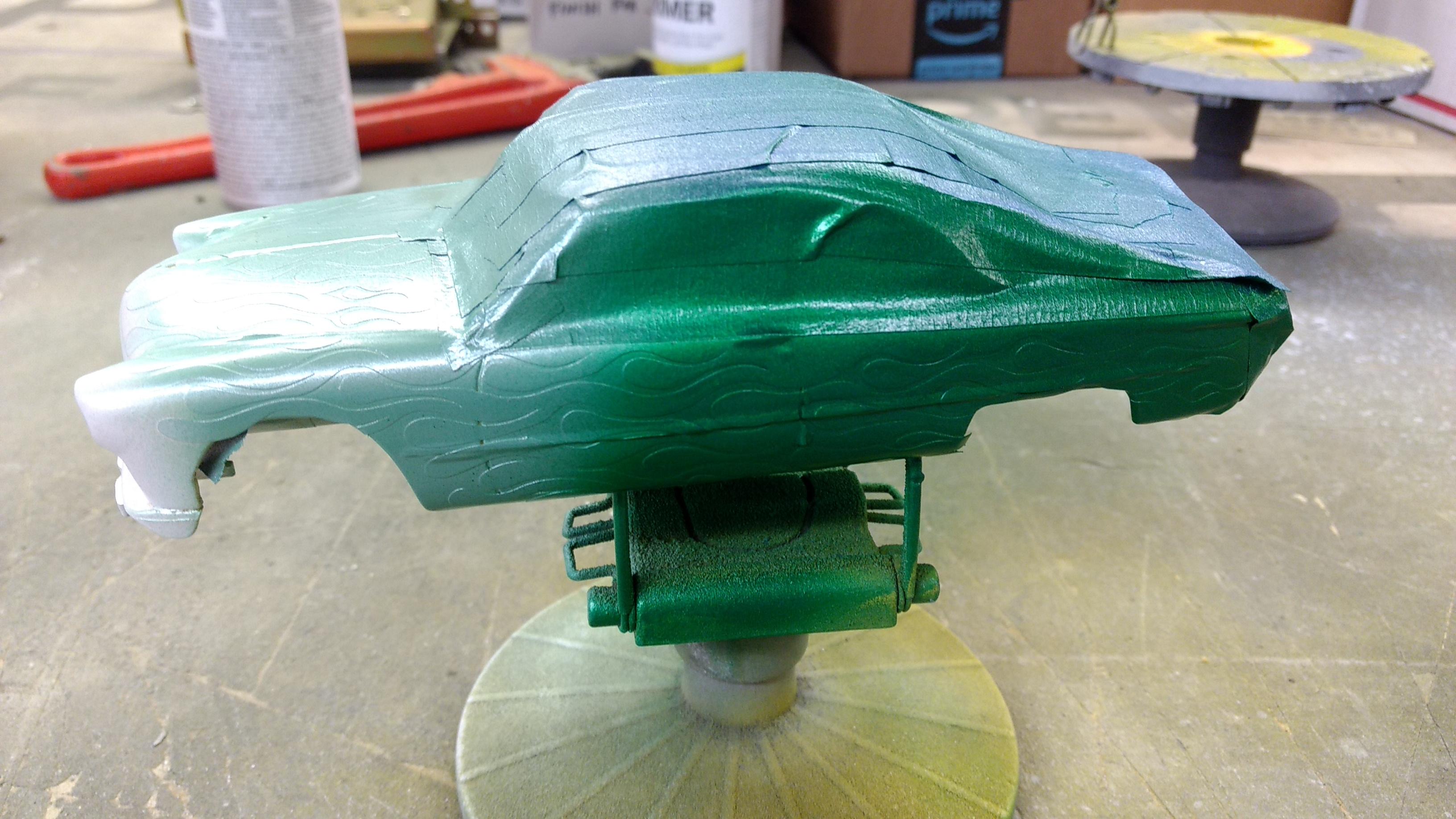

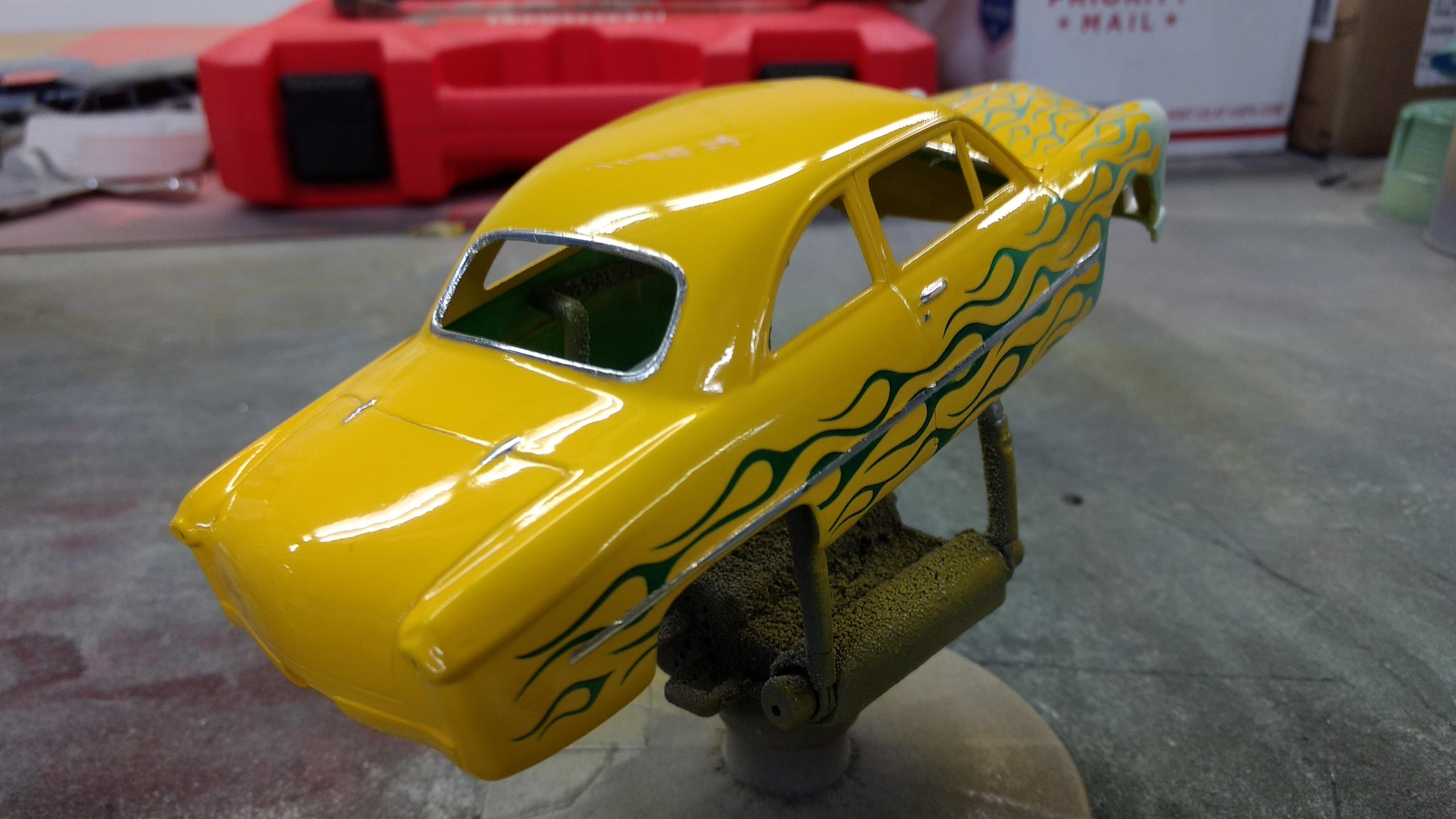

I sectioned and painted this back in June of 2018 and I'm just getting back to it. Throwing some BMF on it today and have been sectioning the interior.
The last photo is where we are at today.
Later-

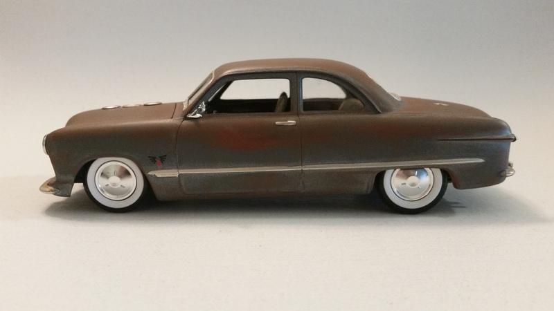

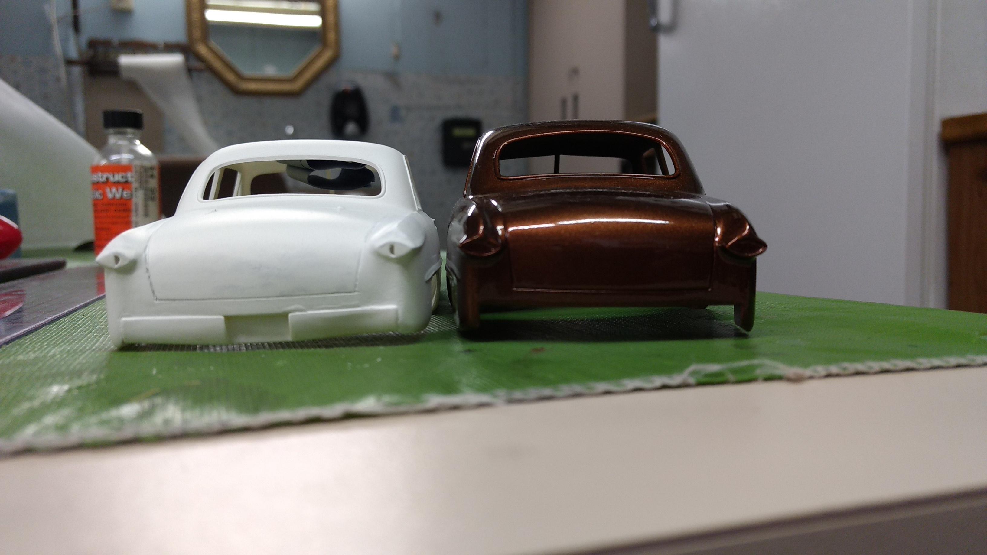

Great looking flames. The section job looks real smooth. So what's the story on the little root beer Ford ?

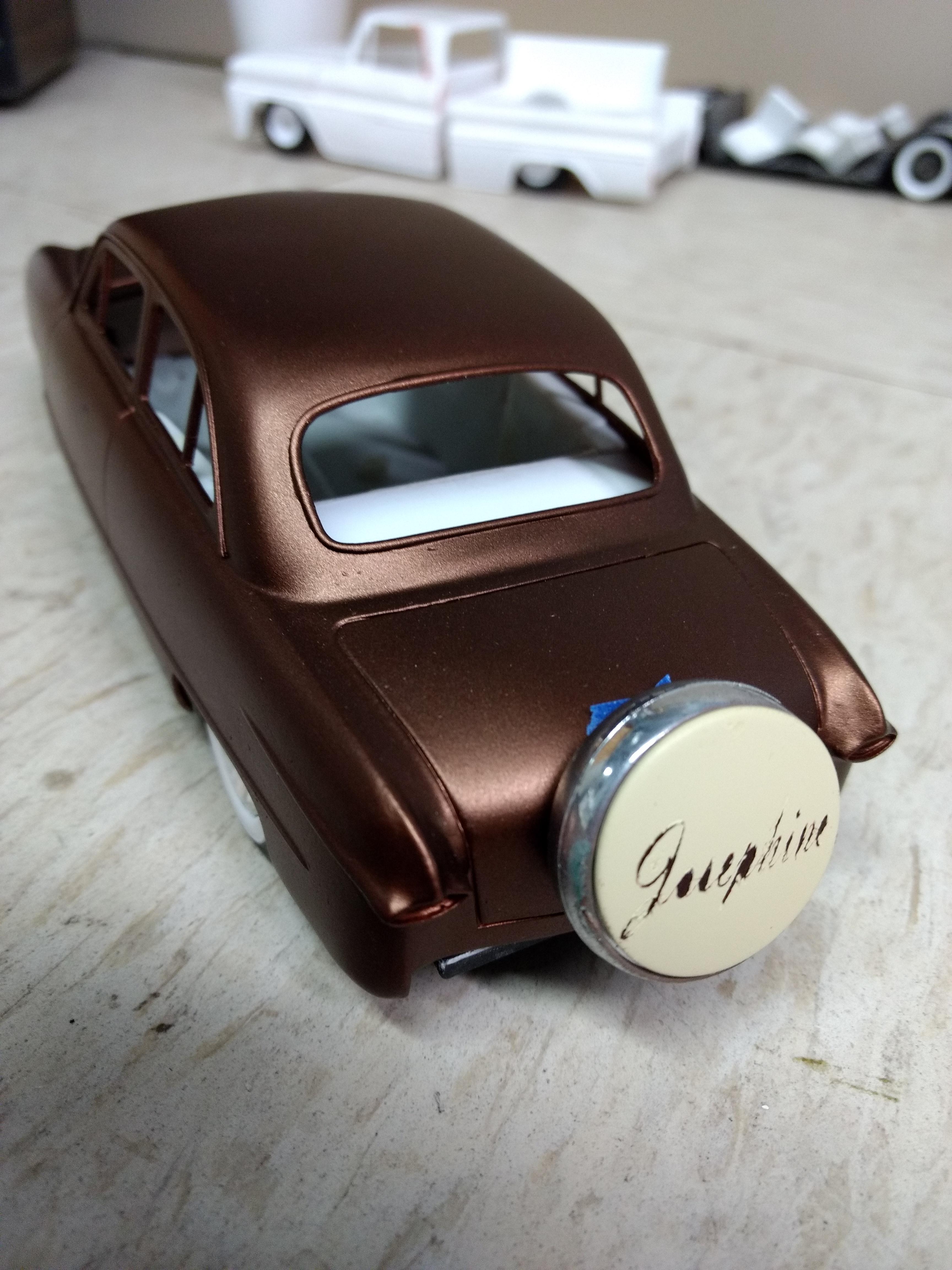

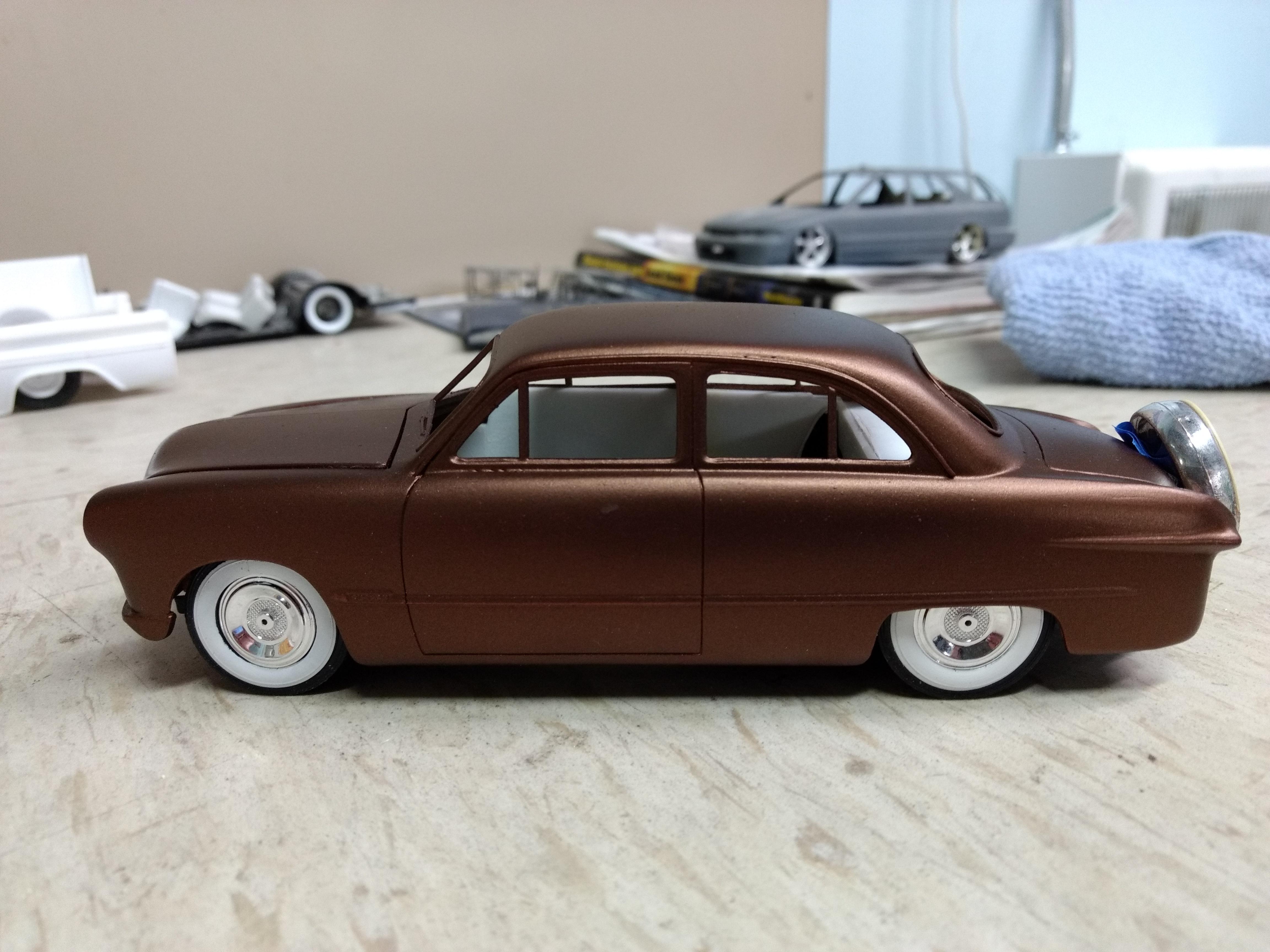

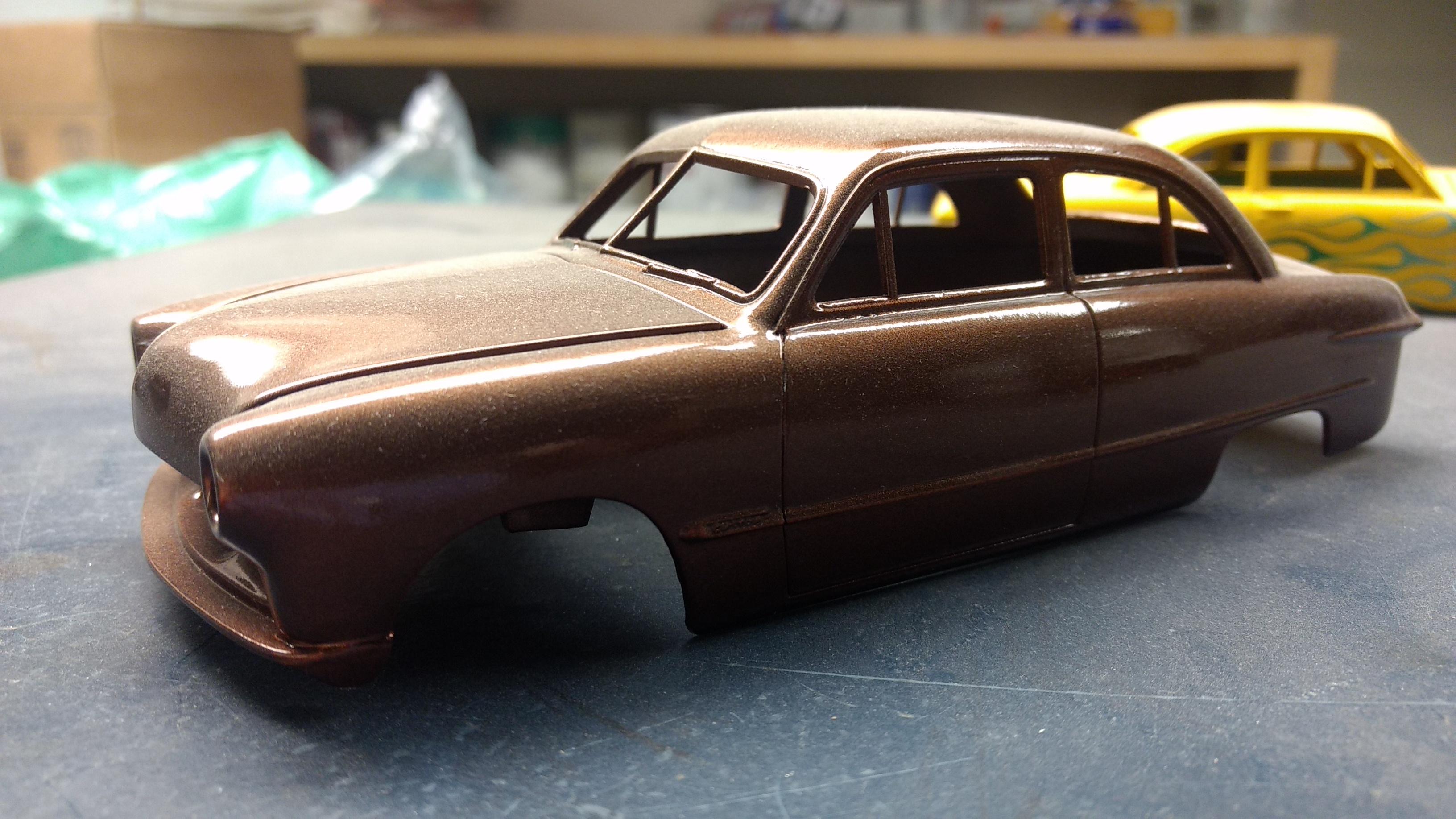

Thanks David. The brown Ford is Josephine- the girl next door. It is a stalled project 50 Convertible that I added a stretched 49 Ford coupe roof to make a 50 Sedan. The paint is a HOK gold (maybe Pagan) with HOK Cocoa pearl over the top.

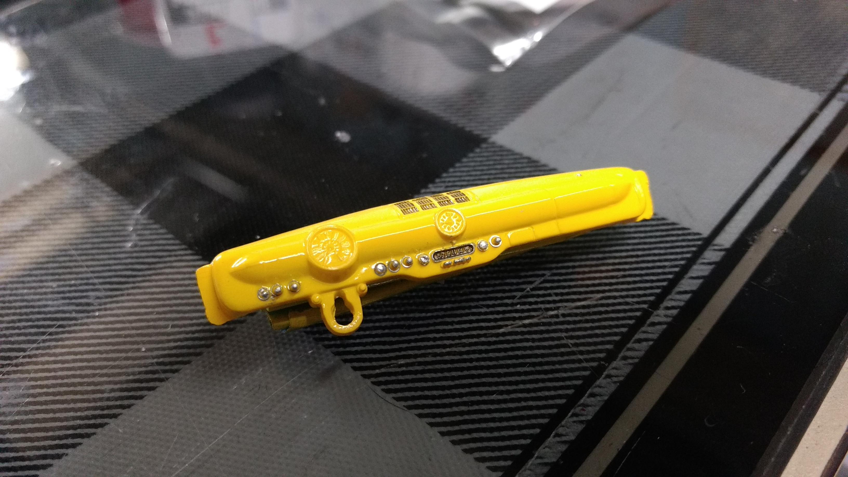

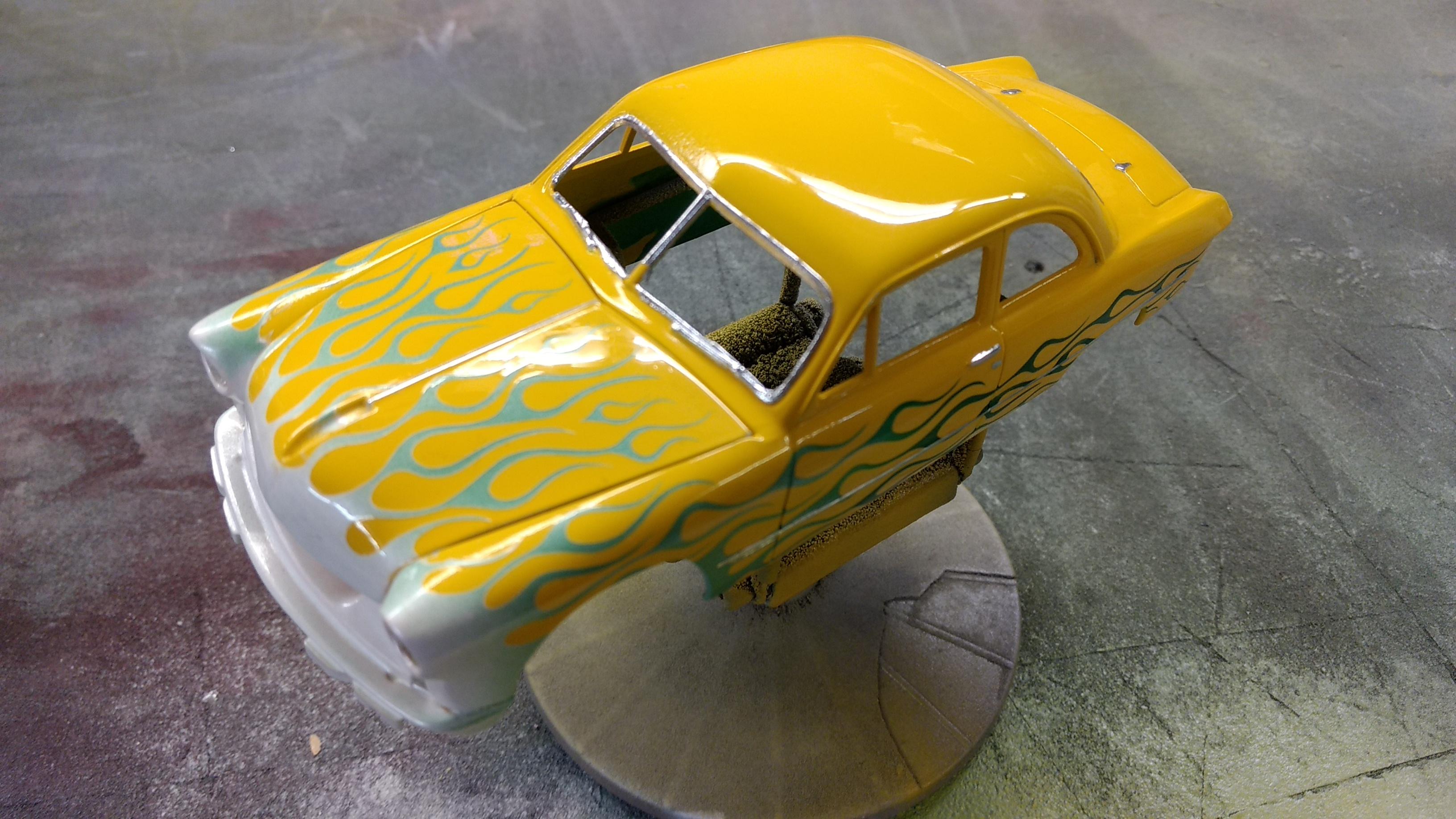

Got the body wet sanded and polished. Got to touch up the BMF and do the Molotow around the side window frames. The dash is done with the exception of the dials. I ordered decals from Best Model Car parts. Working on the steering wheel and column.

That is turning out very nice- well executed custom touches, paint and flame job. I too am appreciating Josephine. Great work on both so far.

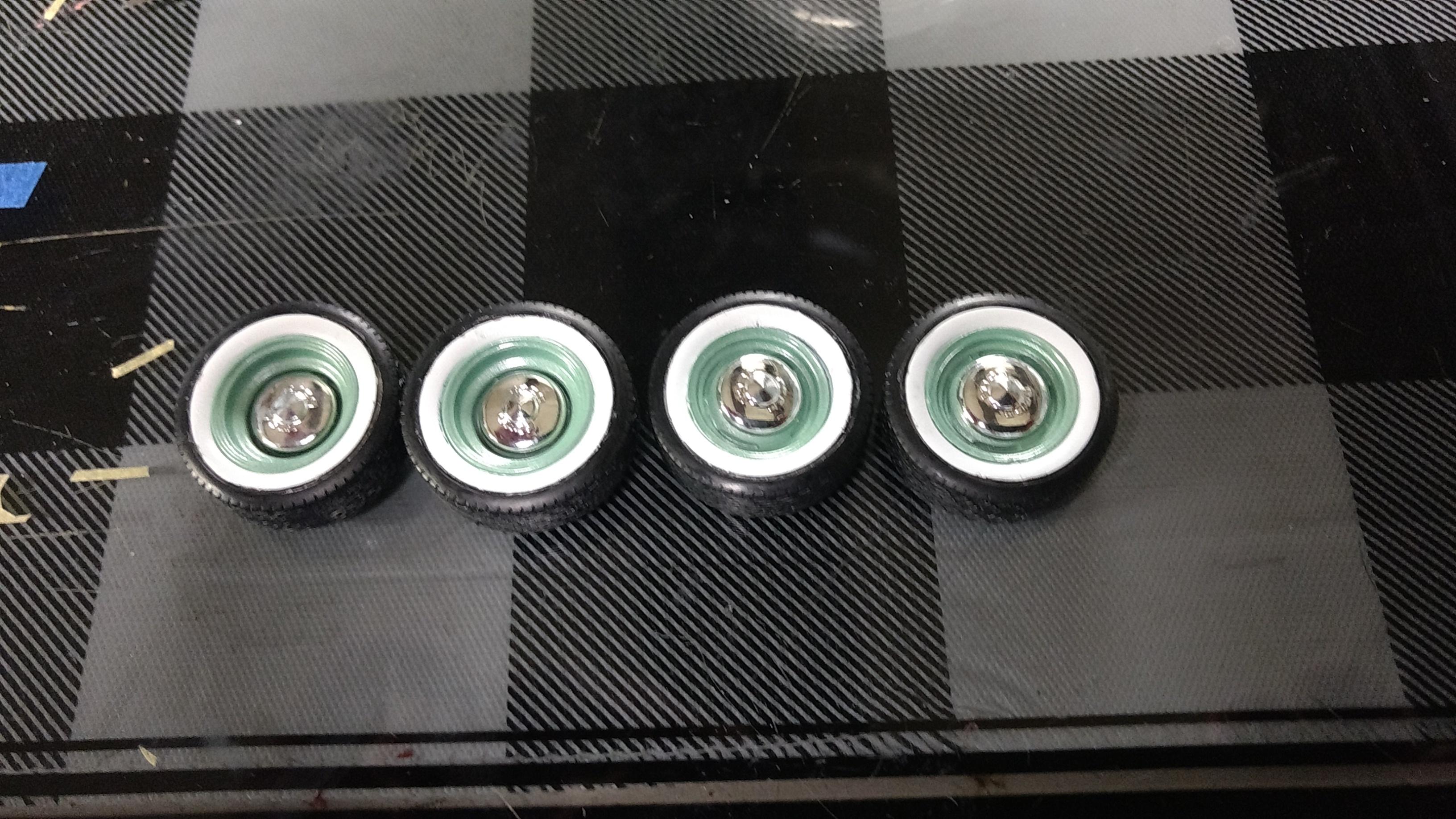

Got some work done on the tires and wheels. I need to let these thoroughly dry before I mess with them and botch something.

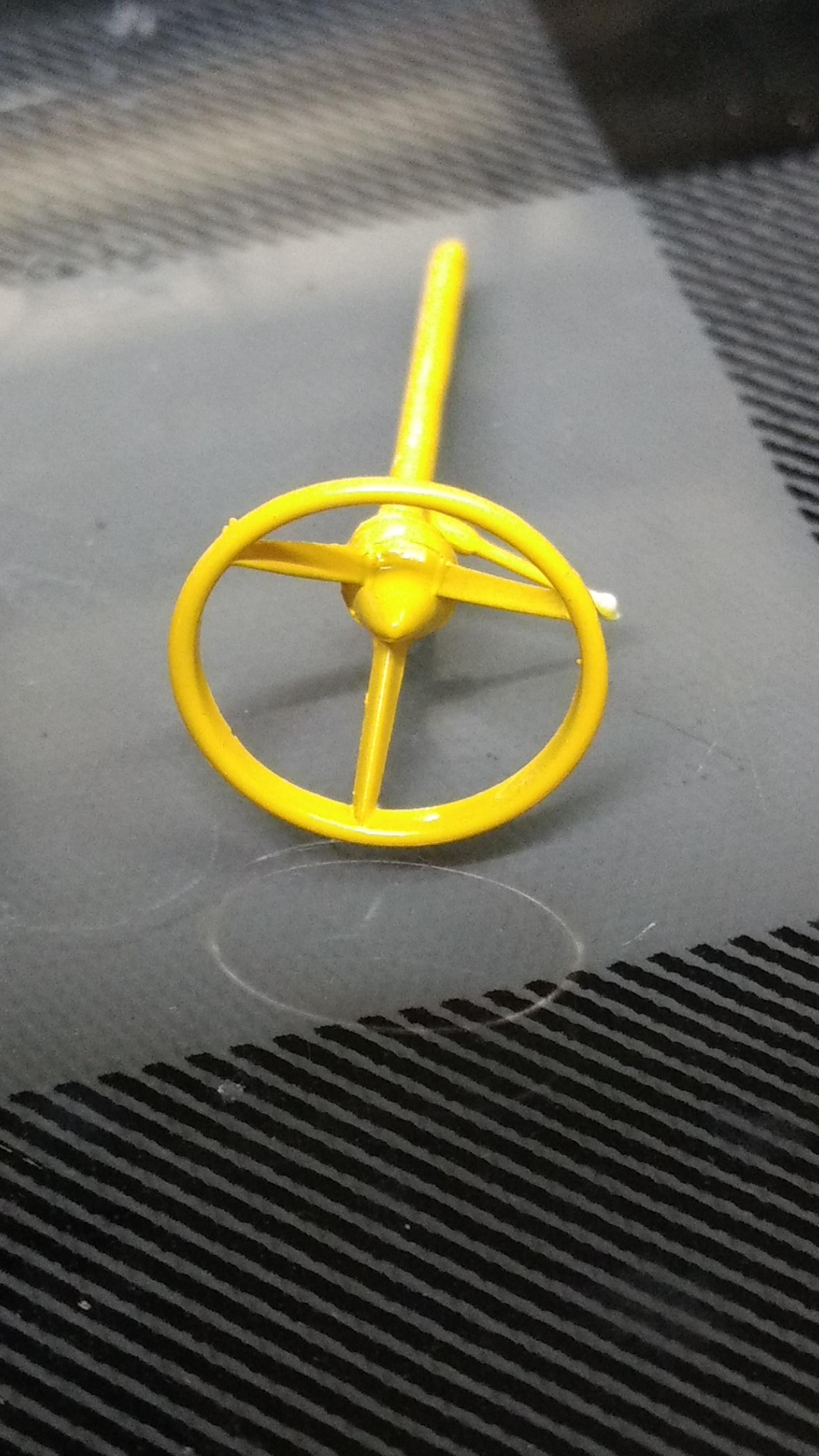

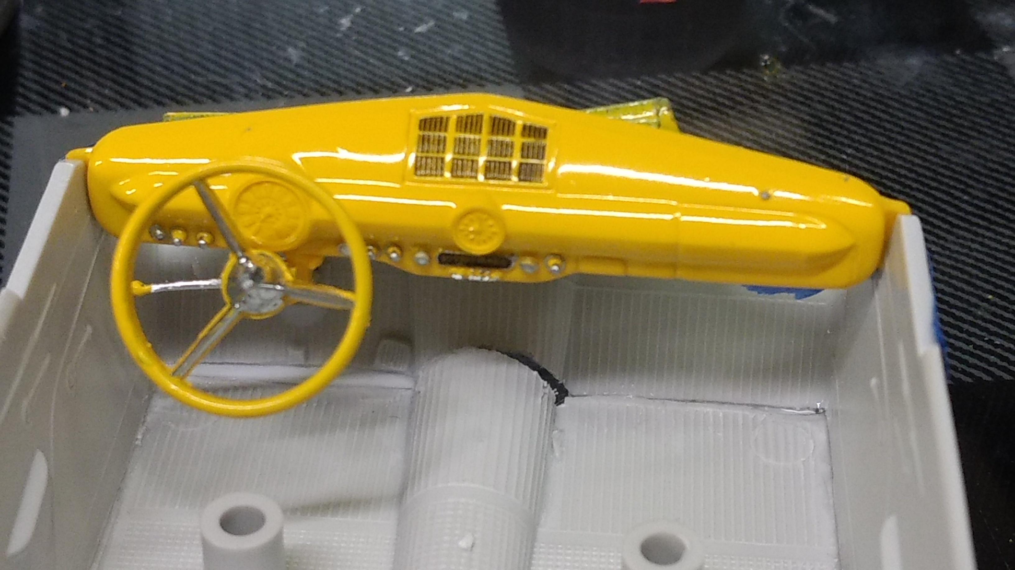

Good morning! I'm still plugging along on this during breaks at work. That's why progress is slow.
I got the dash and wheel completed, with the exception of the gauge decals. I am waiting to get them from Best Model Car parts. They should be here in the next day or two. The steering wheel and column are just sitting in place.

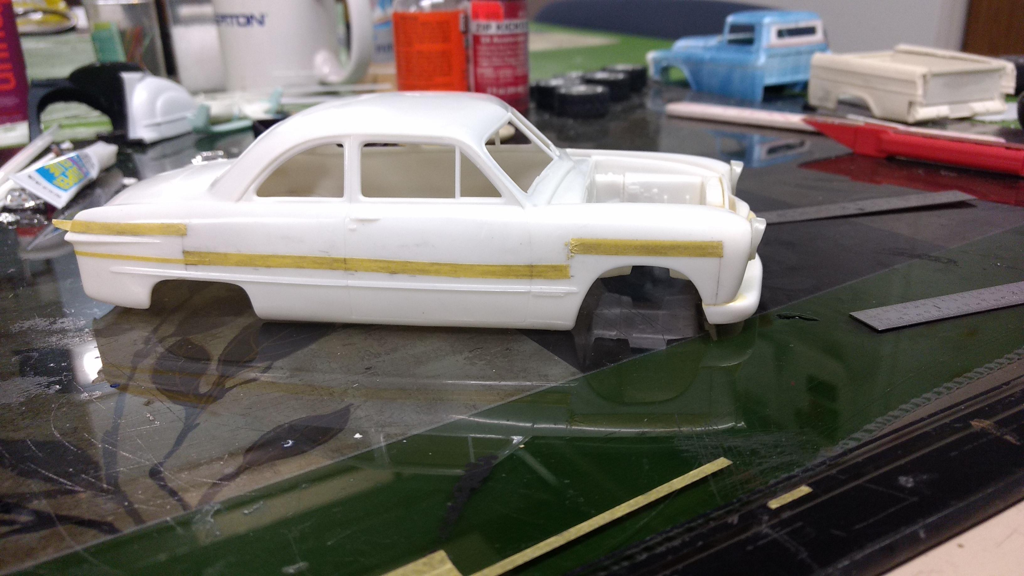

Because I painted the body a couple of years ago I didn't think about the chassis fitment. In order to get the front suspension lower I needed to redo the front wheel wells. I know the sequence of events is completely wrong. Oh well. I cut the wheel wells out and redid them with trimmed down wells I had laying on the bench from an 84 Chevy pickup. Once I get this all done I will tape off the engine bay and spray it yellow.

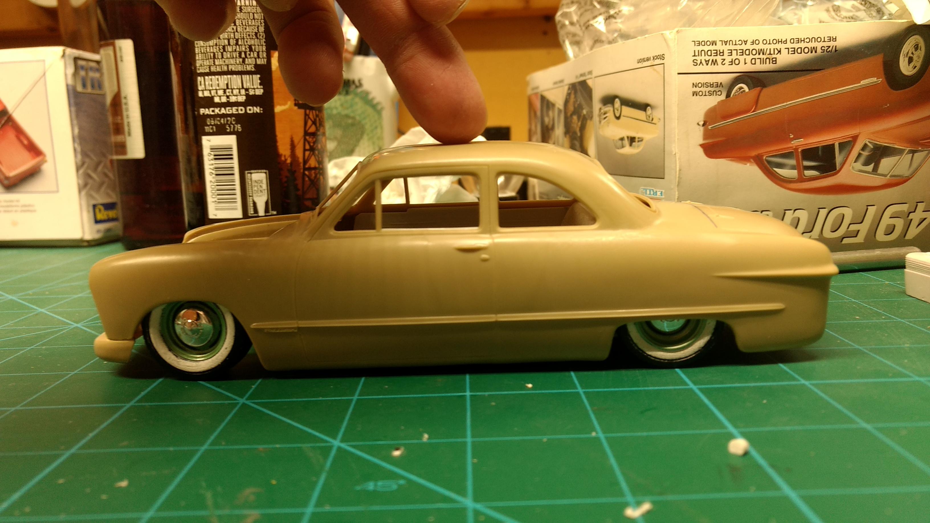

On 6/19/2020 at 6:40 AM, Modlbldr said:
Getting a quick look this morning at how it might sit.
This kit is double tough to get low in the rear. I added lowering blocks between the spring and axle and ended up with the axle nearly on the frame. And it's still not low enough. I thought the rake looked cool so I left it. To get much lower will take some chassis surgery.
Yeah. That's about the look I've got right now with lowering blocks but I need to get the rear a bit lower. I may c notch the frame and move the leaf springs inward to be able to mount them up higher on the frame. I think I'm done for today.
Later-

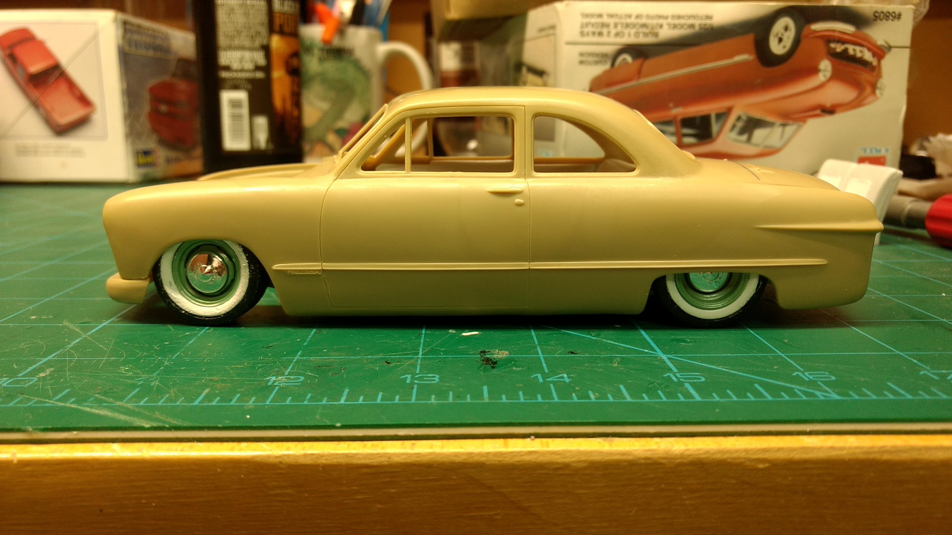

So, I spent some time last night adjusting the suspension to get it low. I cut the rear axle free of the leafs and added lowering blocks. Up front I cut off about half of the mounting tab length for the cross member/ a arm piece. I mounted it all up using a spare body. I think it looks pretty good. First pic was about halfway through the adjusting. Second pic is all done.
