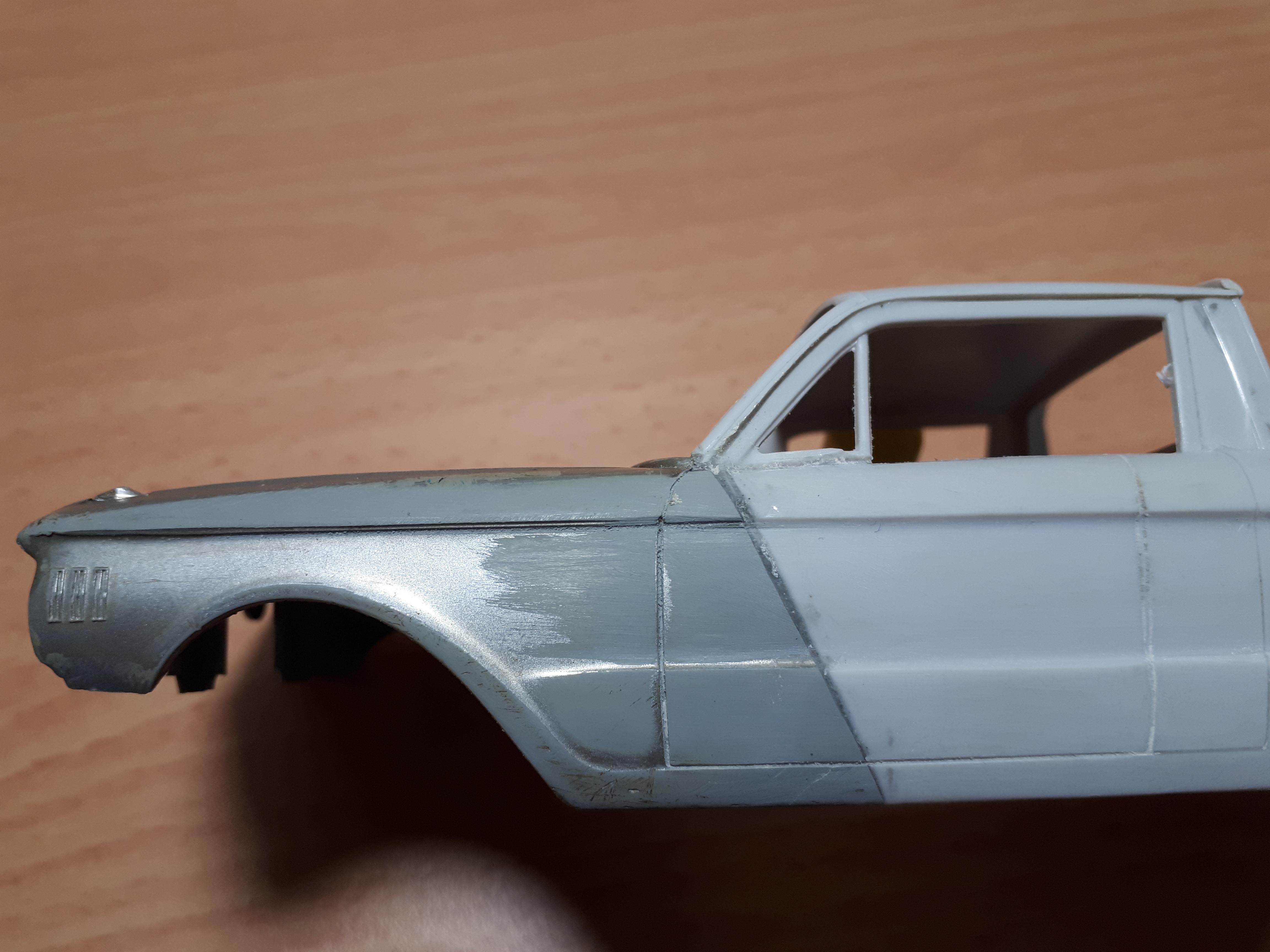

Unfortunately I can't find my earliest pictures of the beginning of this conversion but hopefully these ones will show you how I am doing.
Edited by alan barton

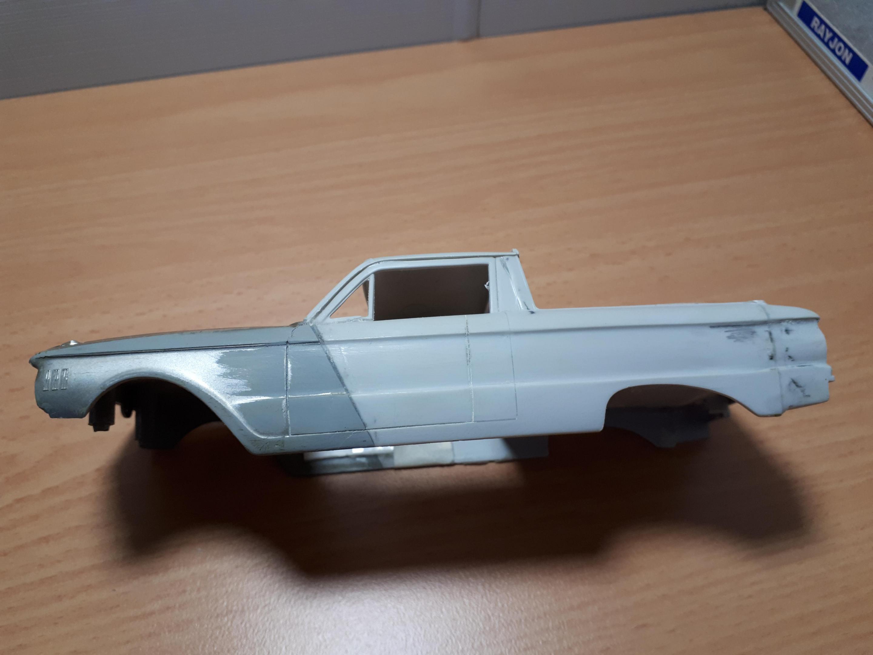

As you can see from those last photos, the body lines were a perfect match, a credit to the accuracy of AMT models back then.  When the American Ranchero was trialled in Australia, Ford found that the rear overhang got hung up on the deep creek crossings that are common in the Outback. So they lopped a bunch of the back.  I suspect the bed remained about the same length as the US version as the shorter four door sedan front door was used to get some of the lost length back.  I shortened the AMT kit about 8mm and it does require some massaging of the body  lines when you do that.

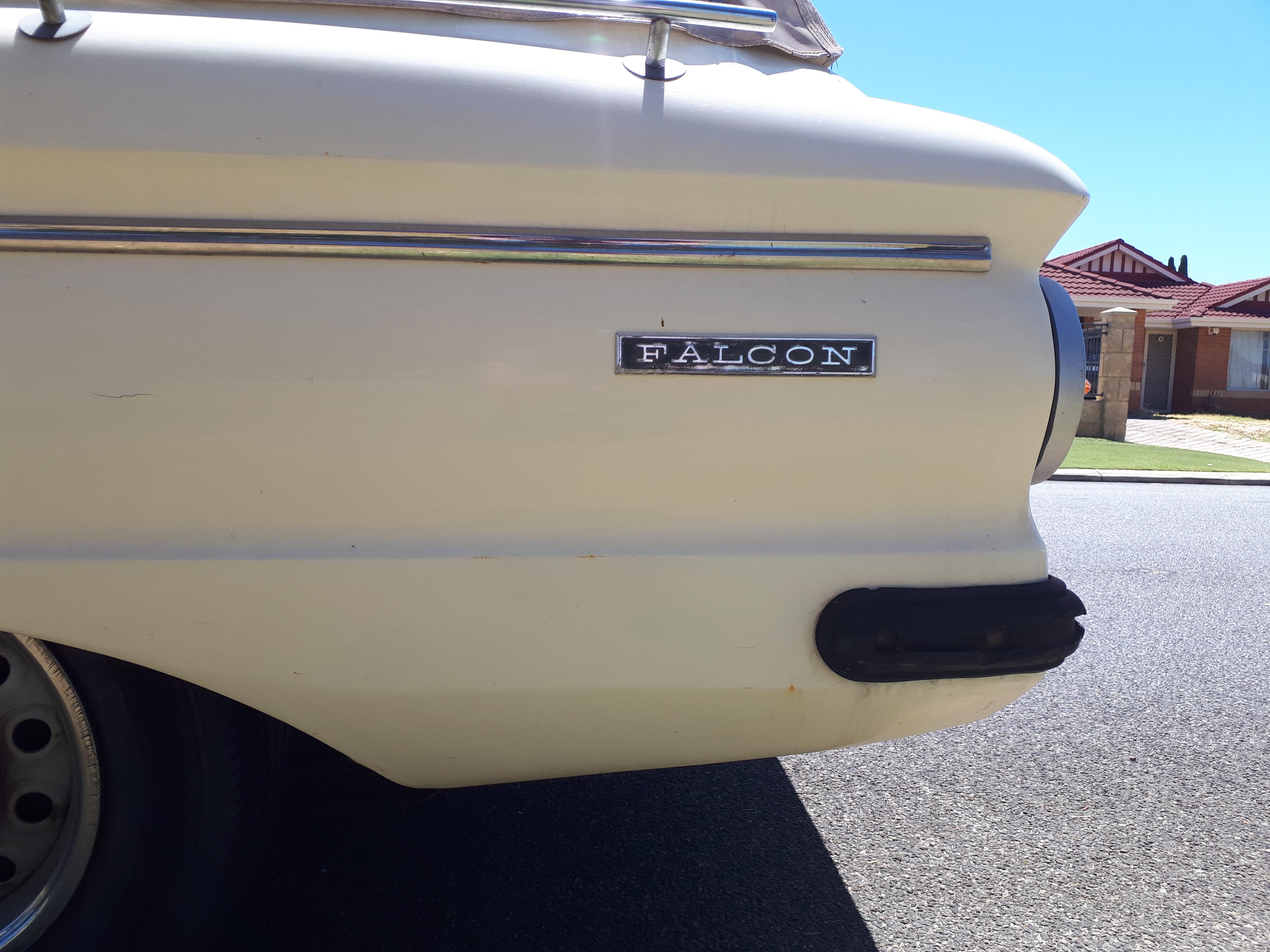

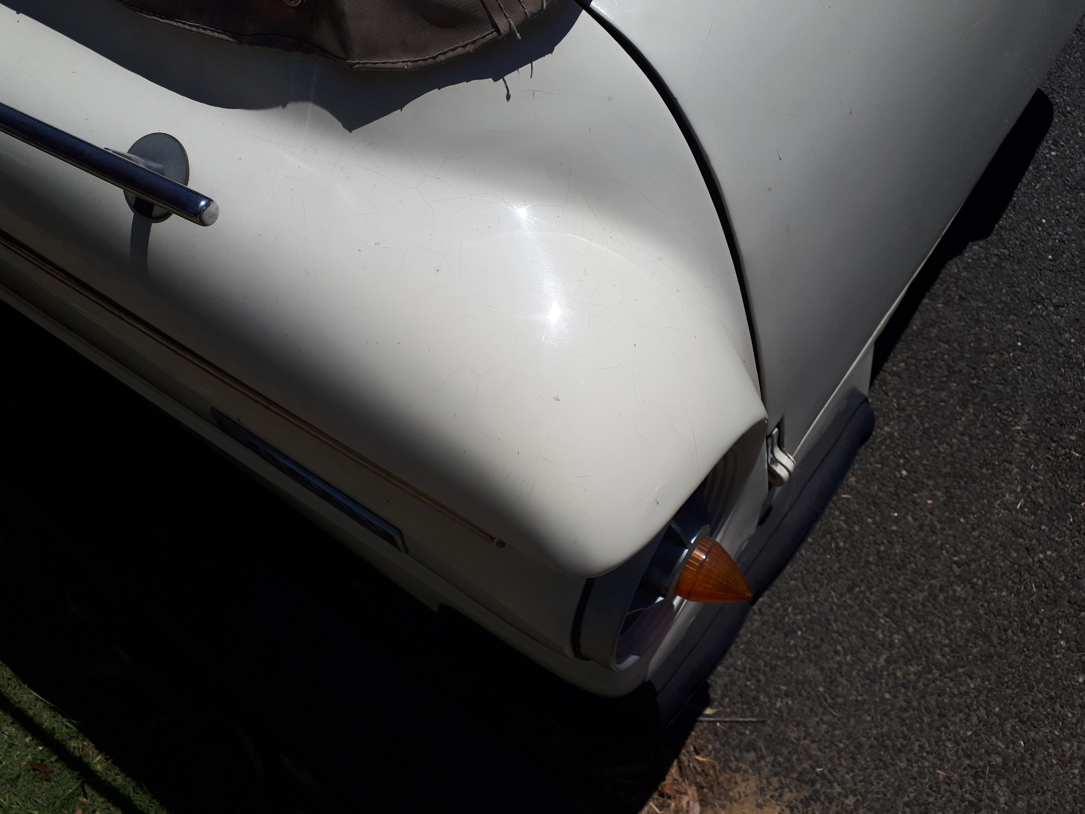

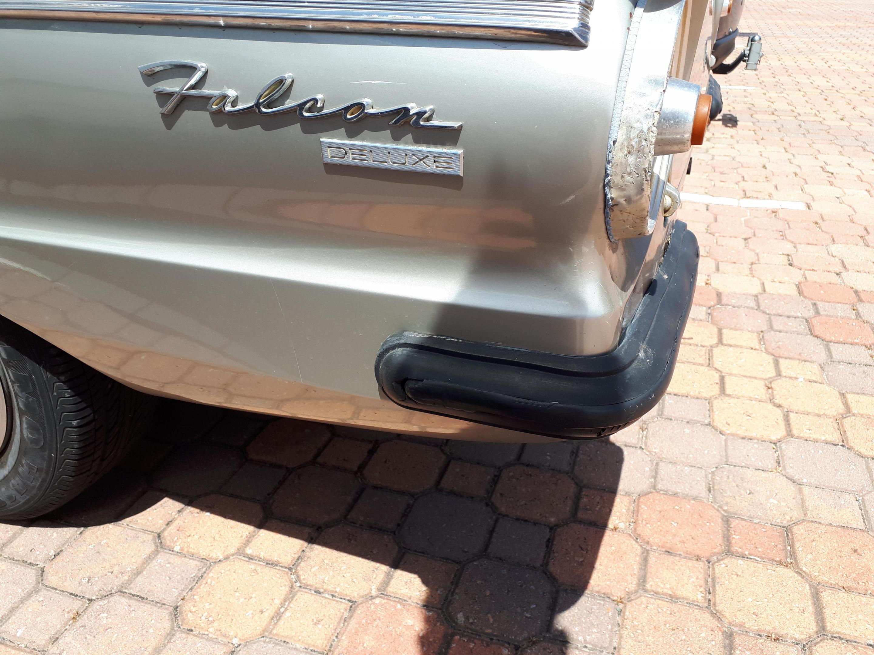

Here's some photos of the back of a real one.

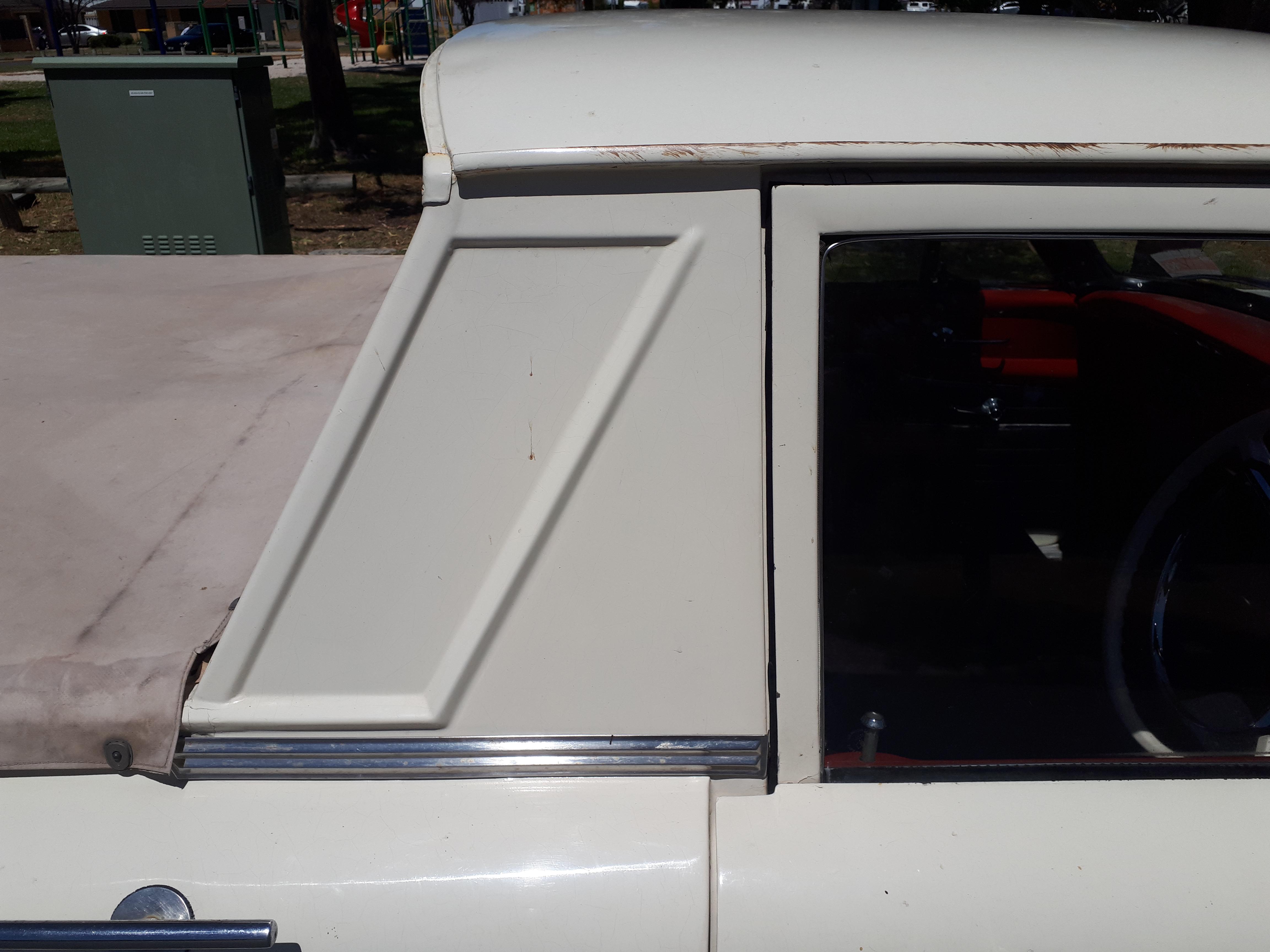

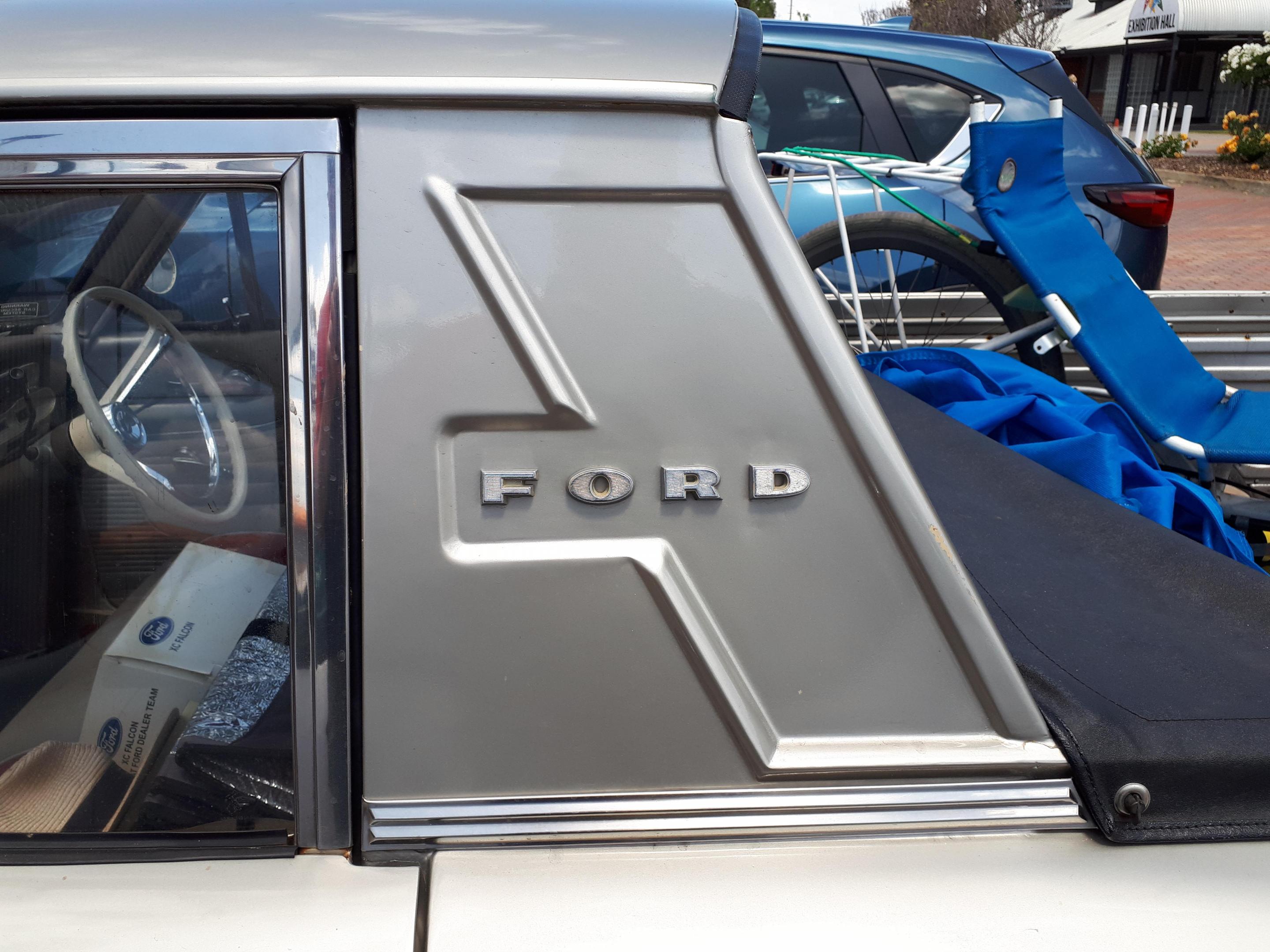

Instead of the fairly crude vertical pillar on the Ranchero, Ford Australia came up with a T bird inspired roofline. It has an interesting recess that I am going to have to recreate.  From these photos you can see a difference that I wasn't aware of until recently, meaning I have to redo a section. The early XK, XL and XM models had an additional indent with the letters F O R D in it while the XP  didn't.  Still, at least I caught it before I went too far.  I had to shorten the trailing edge of the roof, push the door frame and door lines forward and cut a hole to begin making the indent.
THe white one is an XP while the silver one is the earlier XM.

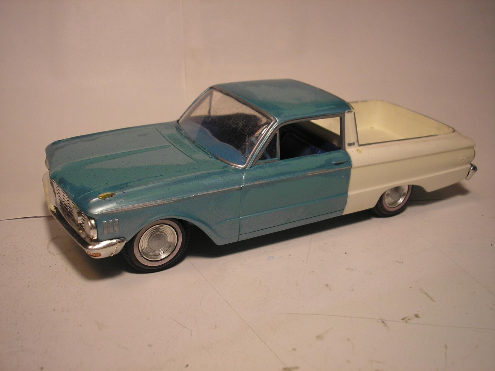

Very clever body mods. I drove a '61 Ranchero with a '61 Comet front clip, doors, dash, and drivetrain in high school back in the '80s that I built from mostly free cast-off junk. I didn't realize at the time that I was building a ute! I built a model of it around the same time. The car is long gone, but I still have the model.
It looks like you are getting the proportions just right, though it looks like you may have taken just a tiny bit too much rear overhang off, maybe 1mm. You will have to scratch build the grille and single headlights, and I think your front bumper has a wider license plate recess.

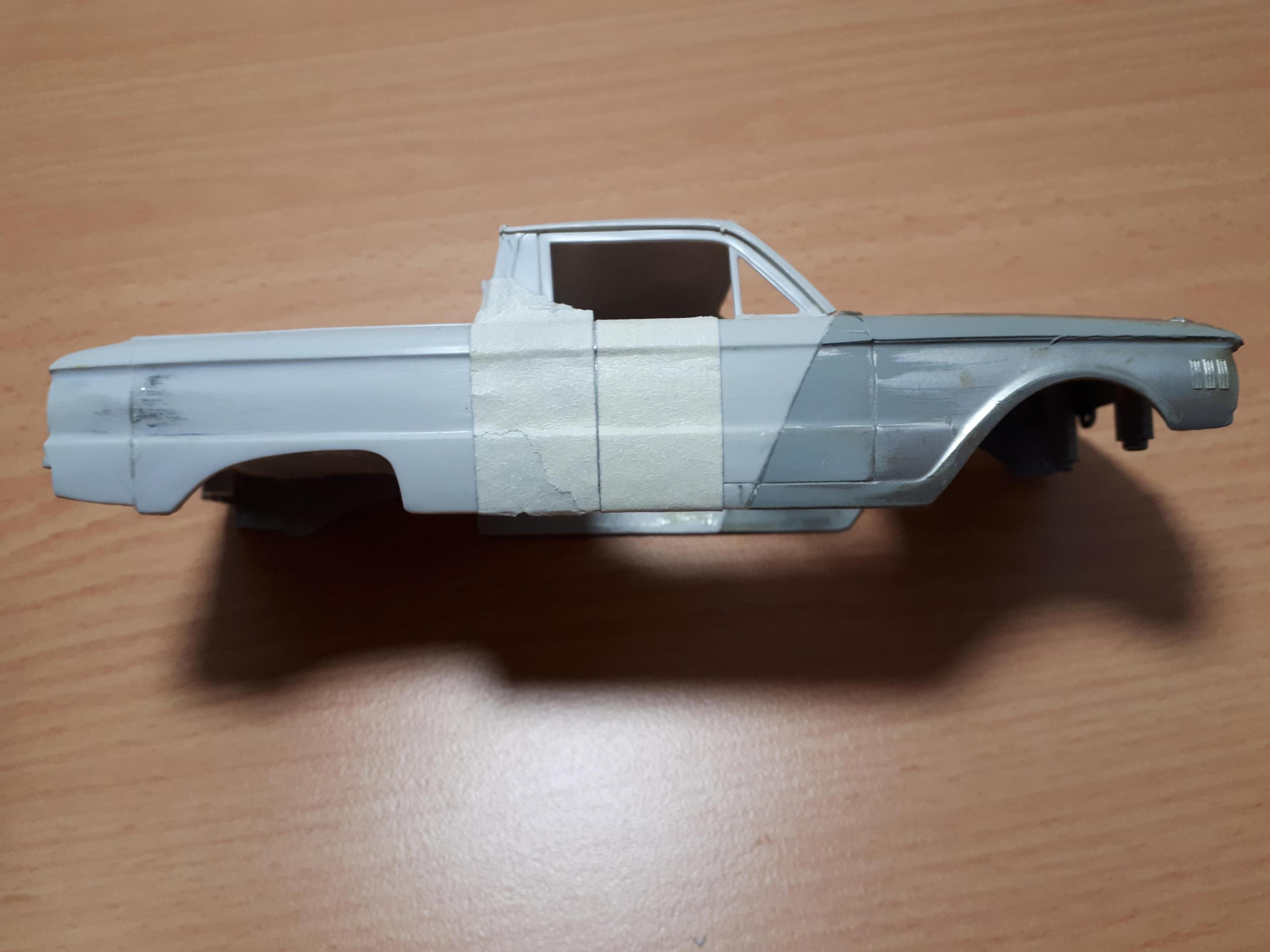

Mike, did you cut the Comet doors and roof at the rear to get a better fit?

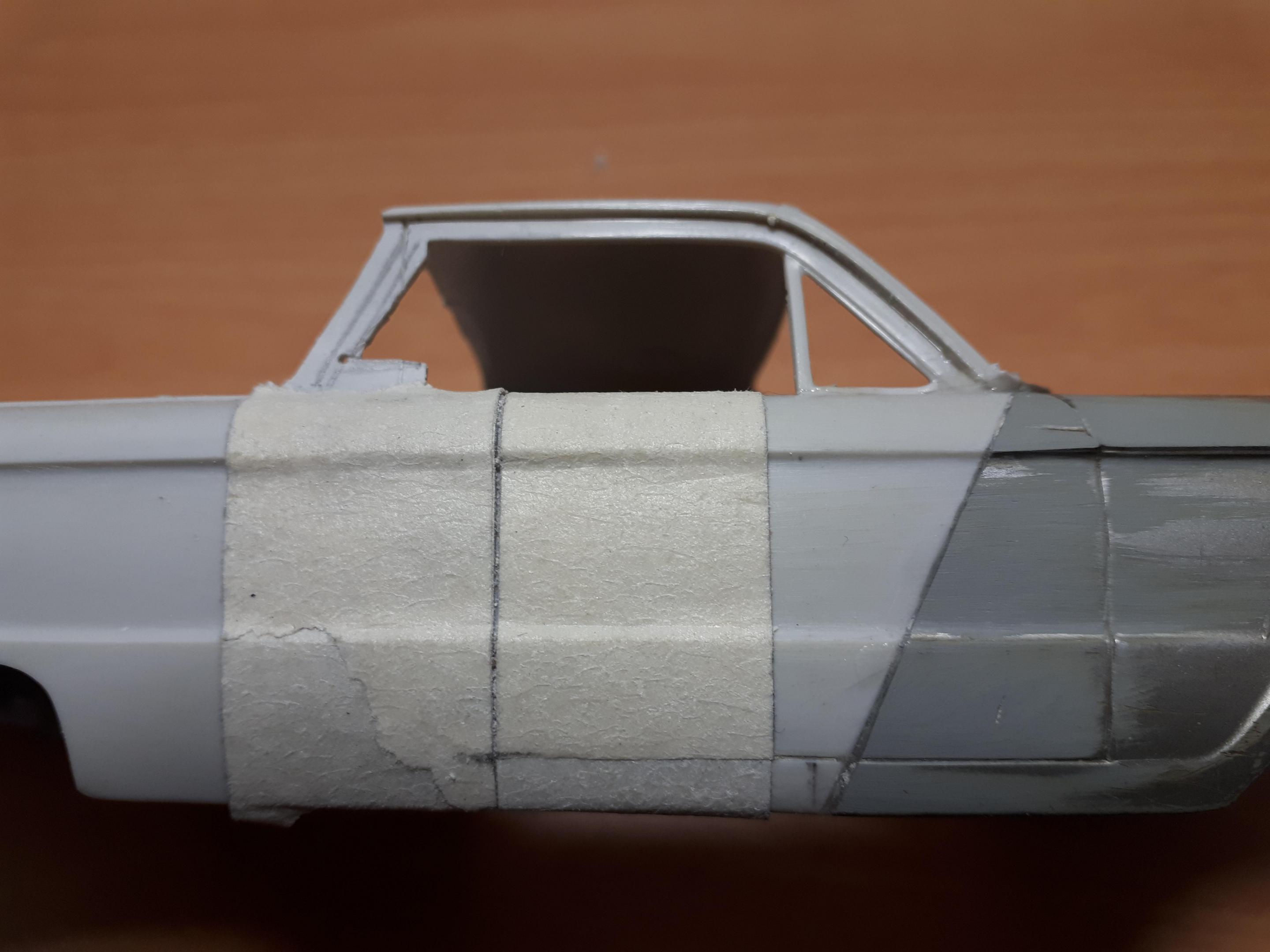

And Alan, why did you make that angled cut through the doors rather than at the jamb?
Finally to both: What glue did you use to attach the promo body to the kit body? Thanks!
Chris, Yes, the Comet roof was trimmed to fit up to the Ranchero bed trim at the rear of the roof. The Ranchero doors are the same and they would have worked, I used the Comet doors to get the door trim like on the real one. It was an accident that it came out to be the same basic colors as the real trucklet. I used super glue to join the two plastics.

Thanks everyone, I'm glad this one is getting some interest.  I've been on and off this one for several years now but I still have some way to go.

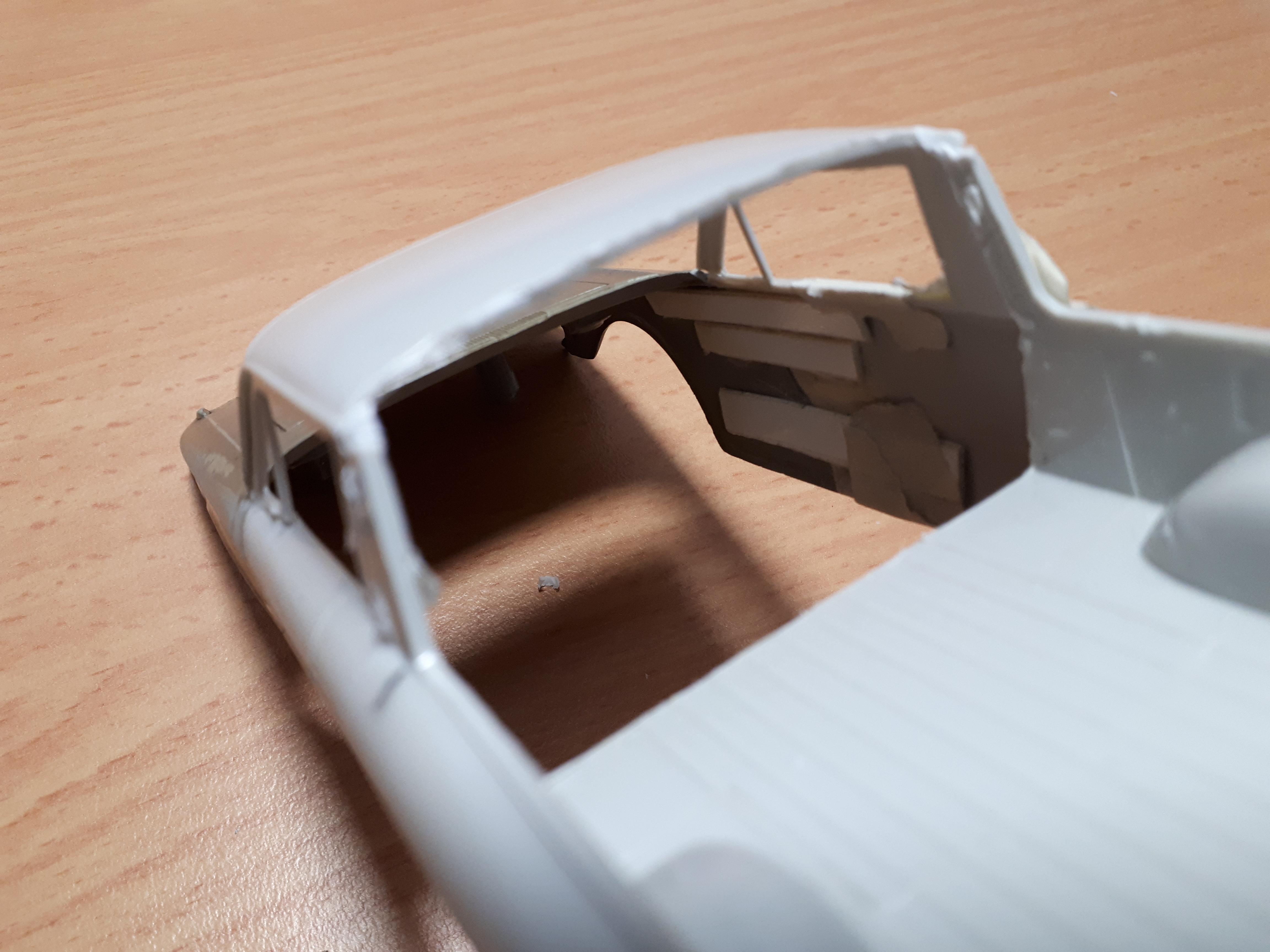

Chris, I used an angle cut for a few reasons.  Firstly, when I do this sort of bodywork, one of my biggest stumbling points is panel lines. It seems that no matter what tools I use and no matter how careful I am, I get a line with a hickey in the middle that is almost impossible to repair.  I would have been setting myself up to fail if I had joined on the door line itself.
Secondly, it is a longer, stronger joint and somewhat easier to clamp up and hold in alignment because of that length and angle.  I am real happy with how this part of the conversion turned out.

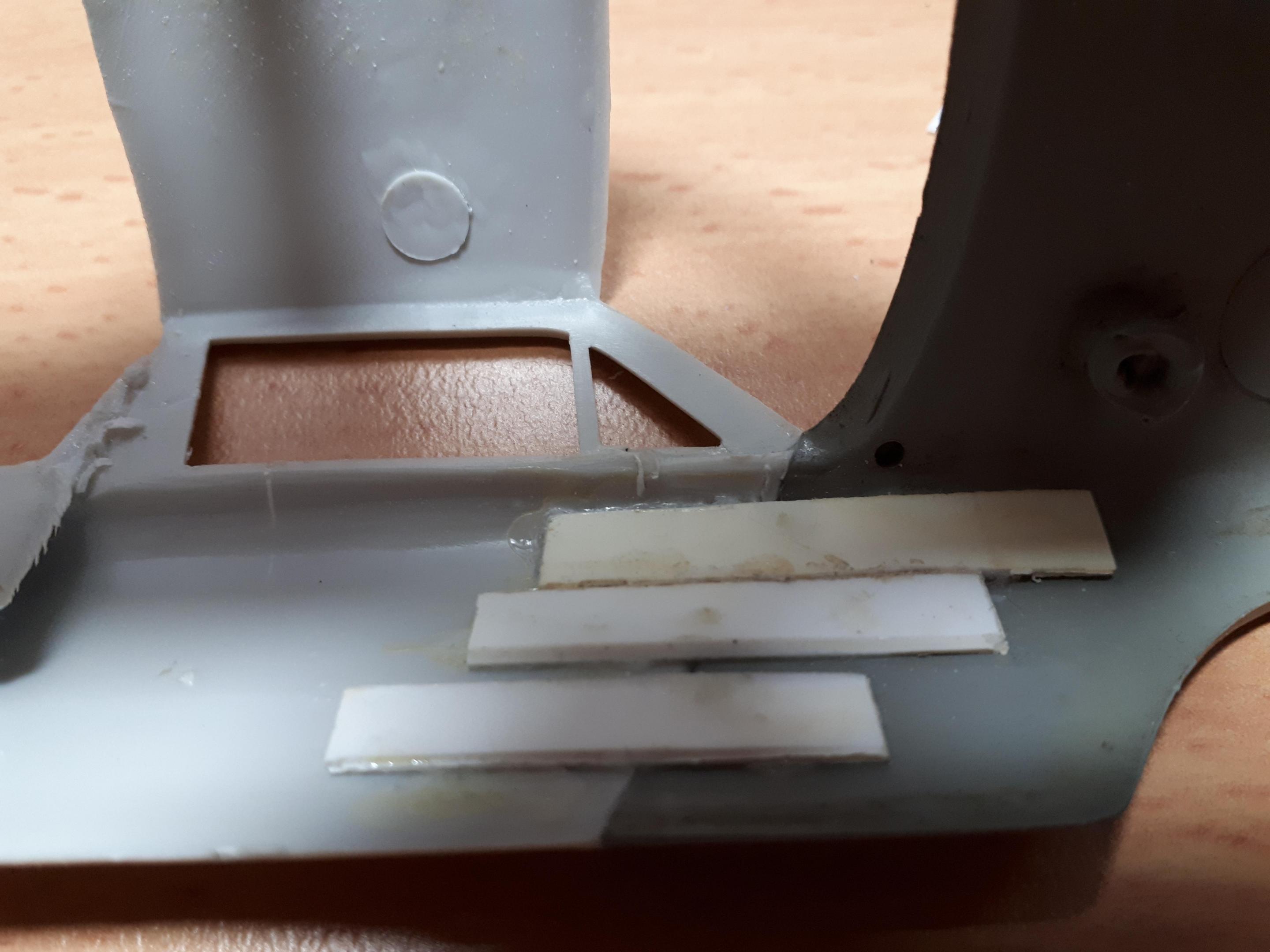

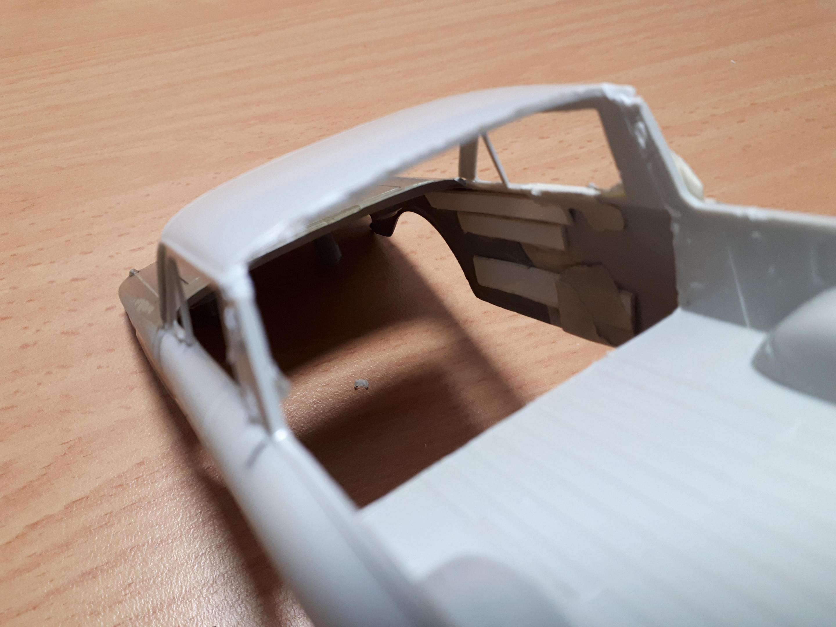

I laminated strips of styrene on the inside, gluing the back half solidly to the body before sliding on and gluing on the front clip.  And you may laugh, but my glue of choice for any work like this is Testors tube glue in the orange tube.  Nothing else sticks like it.  I would rather use spit than the thin stuff in the bottles - it has no stickum!  And without stickum, you can't manipulate this sort of joint.  I've been working on this body and having to handle it roughly for a long time now and there is no sign of it cracking.

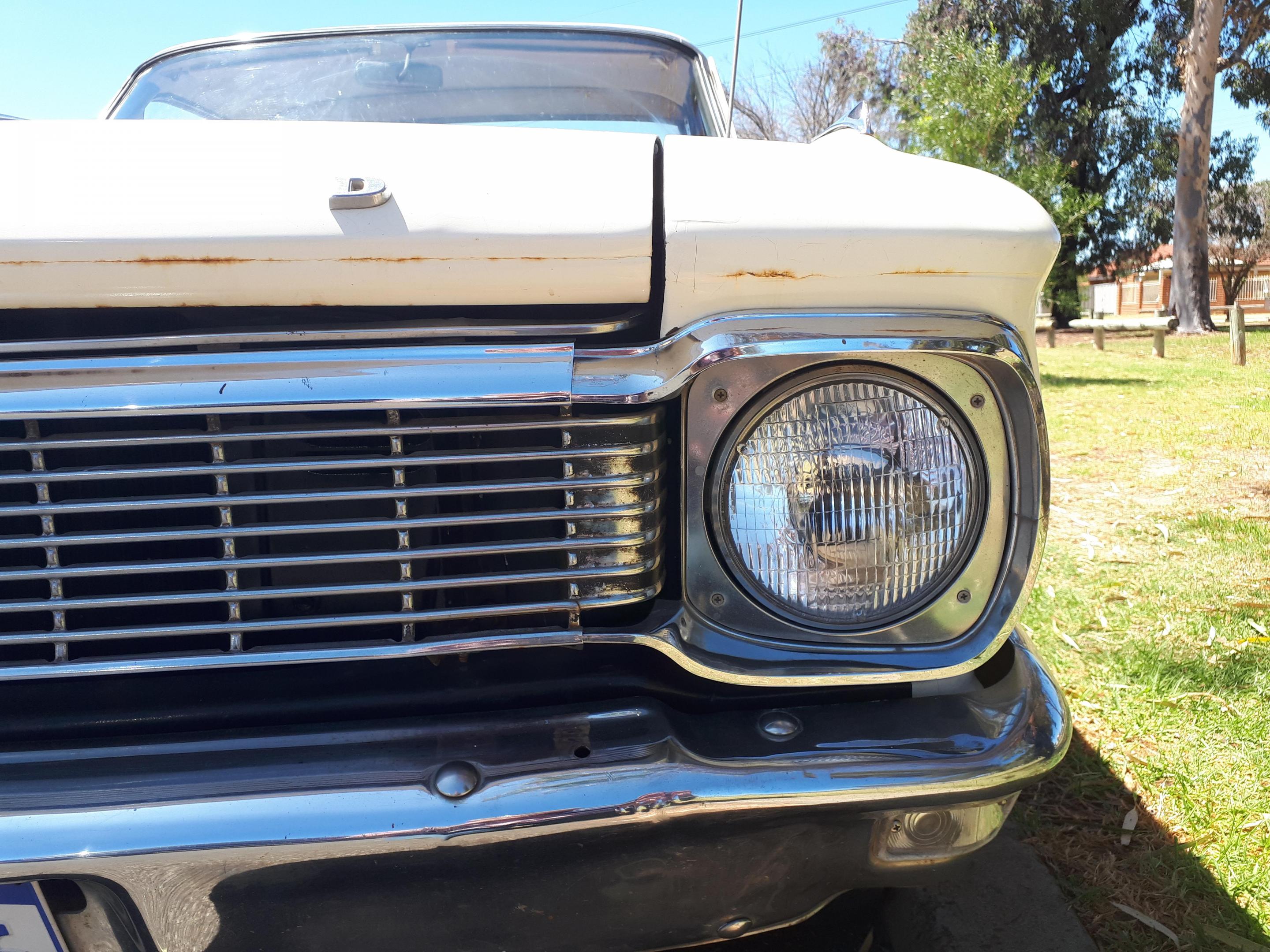

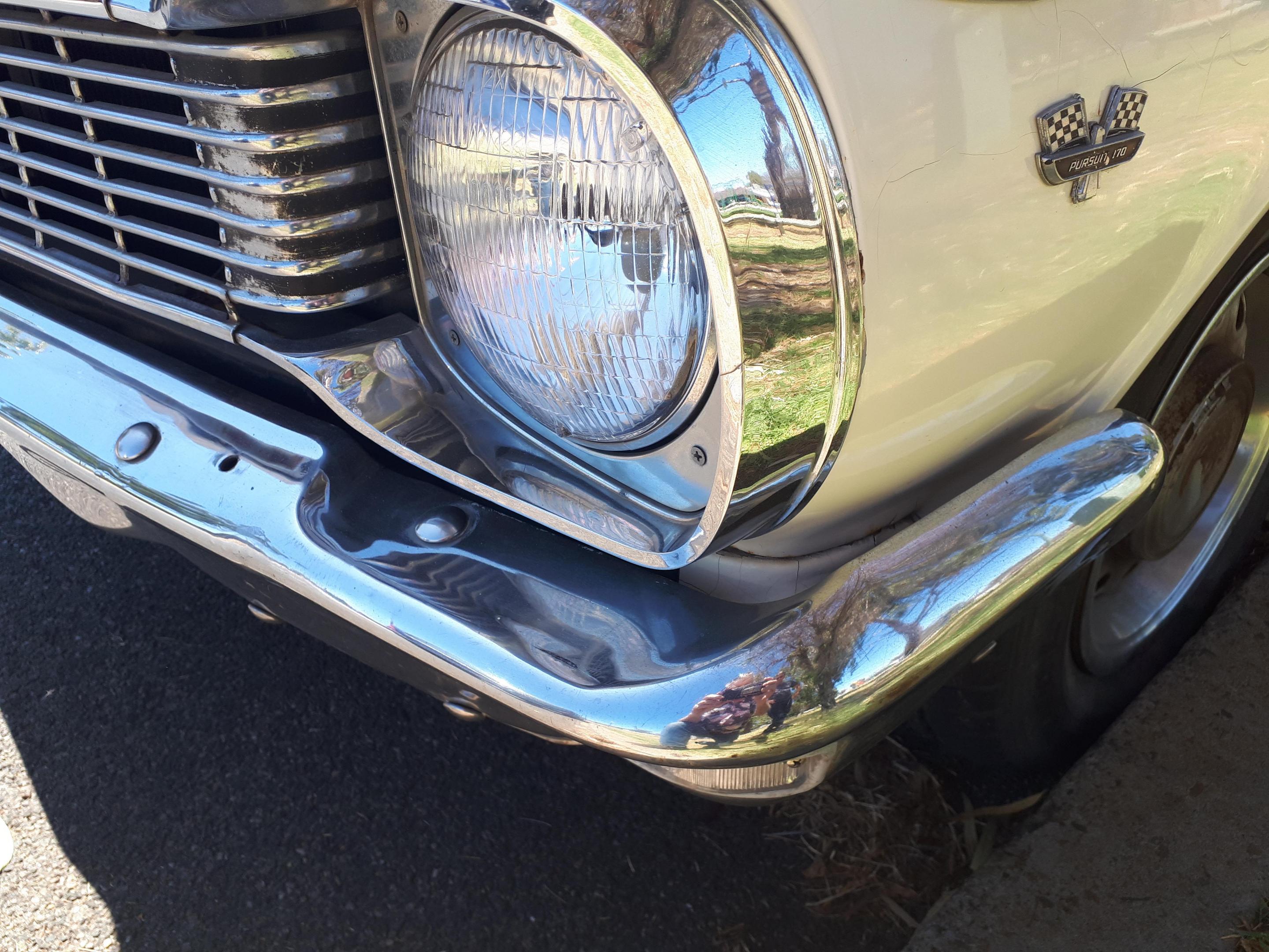

My Comet bumper looks pretty clsoe in the number plate and turn signal area.  I need to remove the lip around the plate recess and I need to render two recesses to clear the headlight doors.  Not too much work.

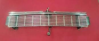

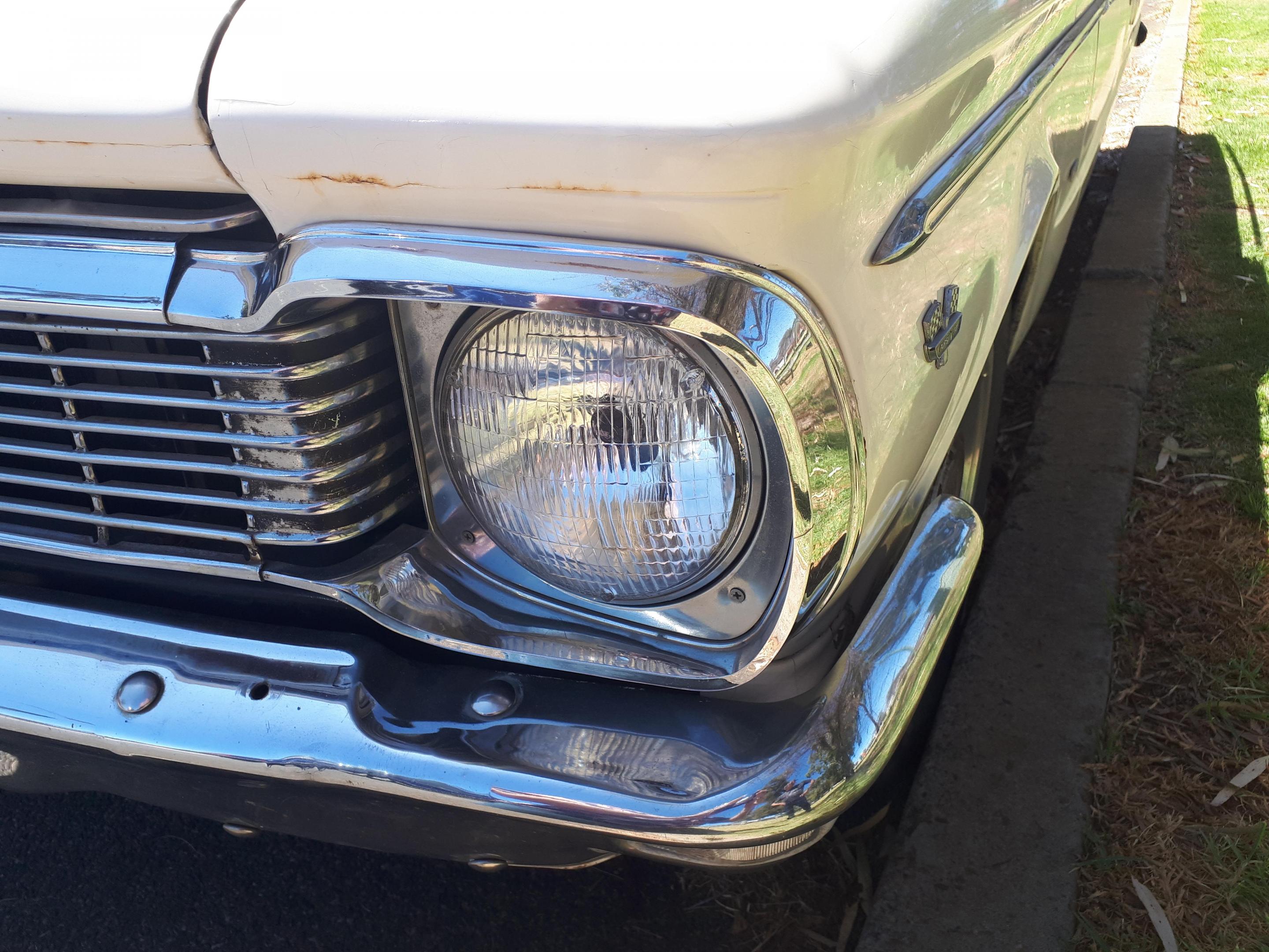

The grille is absolutely the toughest part and I have done nothing at all with it yet. My options include carving ti from wood and then casting or vacforming, fabricating the whole thing from styrene strips ( oh, the humanity!) or chopping something else - I am on a remote mine site at the moment and don't have access to my stash but I'm thinking there might be shapes in both the stock and custom grilles from an AMT 64 Chevy.  I'll post up some photos here so that anyone with some ideas can offer them up.

Looking at your grille, Alan, I think the MCG grille for the '67 Impala would work for your needs. Check out the Supernatural Impala thread in the Kit Reviews section for a picture (should be on page 18 or 19).

There's a lot going on in that grille, lots of scratch building with strips of styrene, or 3D printing could be the simpler approach with a better outcome if you're not into involved carving and filing away at fussy little bits.

The Grill by it's self looks a lot like the '66 Chevelle El Camino or Wagon by Revell. The Headlights are another matter. They remind me of the Headlights used on the Revell '69 Nova kit. The Chevelles had a 4 Headlight setup and the Nova had single 7" Headlights much like the car in your picture. I don't know if you have either of these kits or can find pictures of them to get an idea of what I'm thinking.

I  think I do have a spare Nova grille at home, I will hunt it out when I get back from the bush.   I have only done a few small things to the roof over the last few nights but if I get more done tonight I will post more photos.  Doing a twelve hour shift with a half hour bus ride to the mine each day seriously cuts into modelling time and some nights you just can't be bothered!
