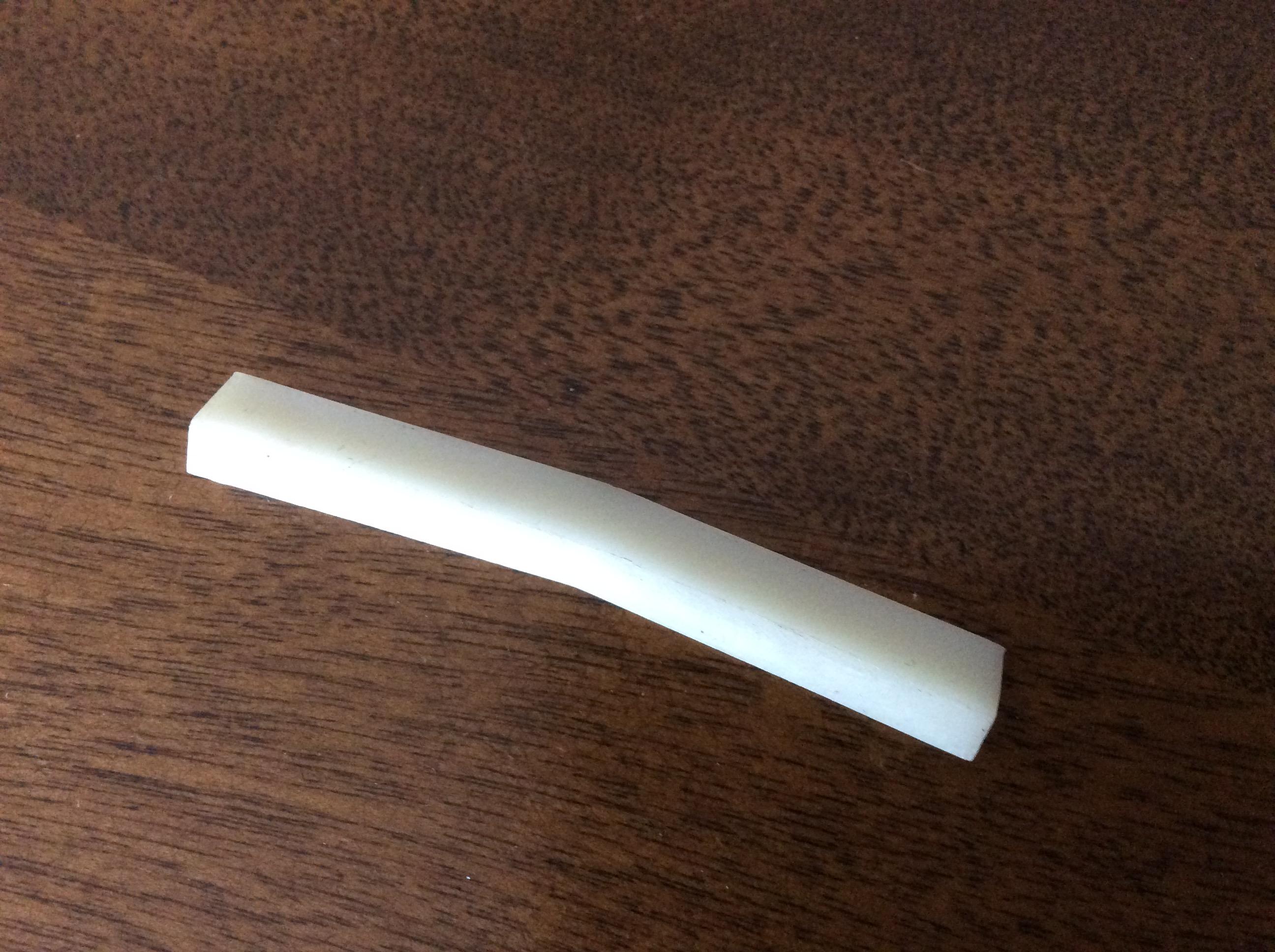

64Comet404 Posted August 26, 2020 Posted August 26, 2020 On 8/23/2020 at 6:35 PM, Goodwrench3 said: No - it cannot be stripped. But they do take paint well ! These pictures are of a Salvino's Olds 442 rear spoiler. It once was chrome, now it is stripped. It can be done, but it takes time! On 8/23/2020 at 12:21 PM, Dave Van said: Anyone have luck stripping Salvinos?? We over at Randy Ayer's NASCAR forum have yet to find a way that works......yes..it's real metal. Good news is Salvinos is offering some kits w/o the chrome.... Dave, it is possible to strip the chrome. Put the parts you want stripped and cover them with bleach. It takes time for the bleach to react with the metal, but eventually you will start to see some black particulate in the bleach. Dump the bleach out, scrub the part with a toothbrush, and cover with fresh bleach. Repeat until clean. You have to leave the parts to soak for at least 12-24 hrs per session. This is a method that I learned from a builder on the Salvino's Facebook group, and it does work! Good luck with stripping the parts!
