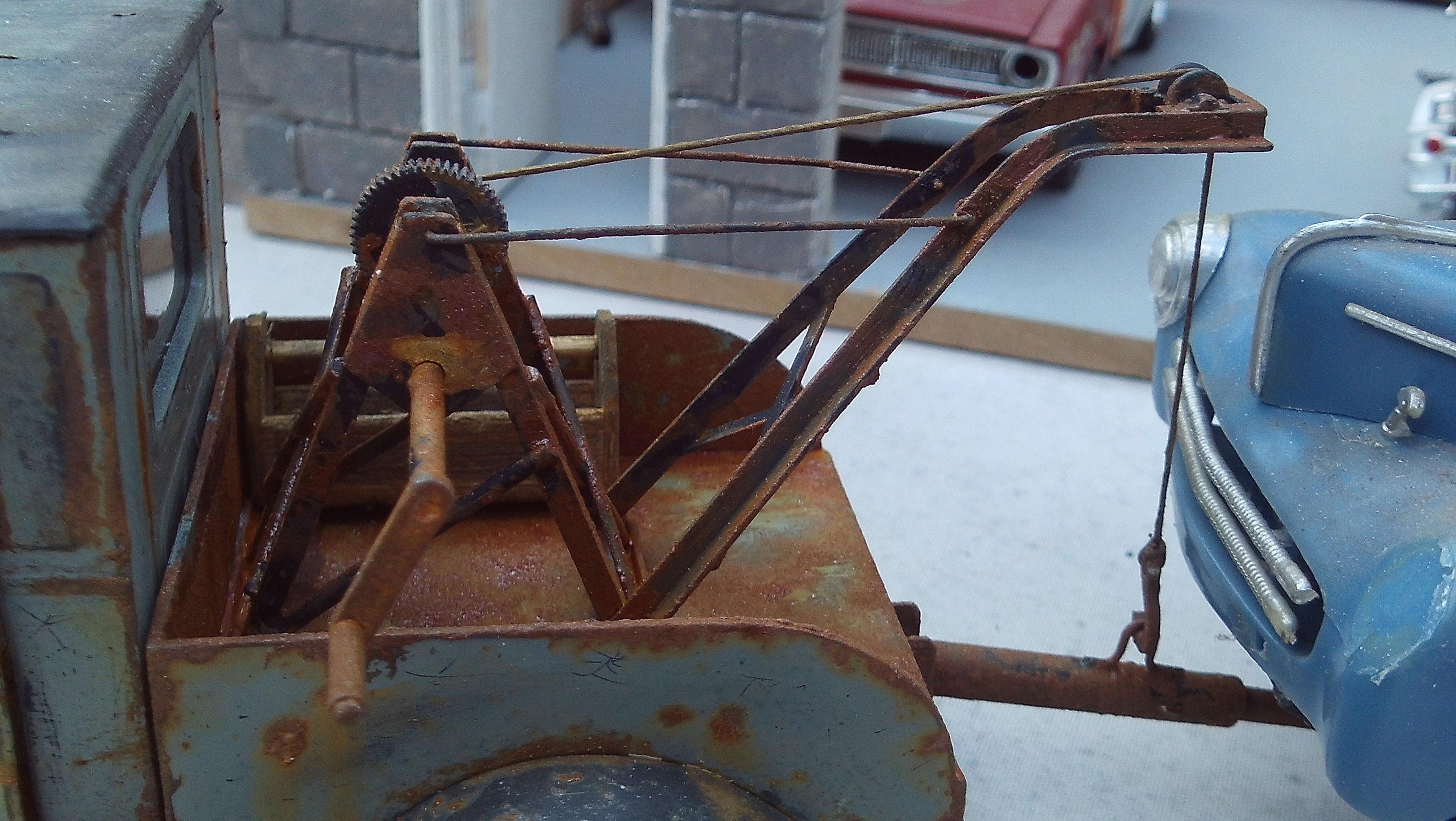

mchook Posted August 11, 2020 Posted August 11, 2020 On 8/8/2020 at 2:00 AM, DougS said: I tried a couple of quick samples just to see how it is going to work. When I get the hang of it with a little practice I think this is going to be a pretty cool technique. Expand I use this all the time. I found that if you use the solution sparingly, put it in a zip lock bag & let it sit a few hours or overnight you get the beat results. Good luck with it, it's lots of fun to use. Here's my latest using this stuff.

Shardik Posted September 9, 2020 Posted September 9, 2020 On 8/11/2020 at 10:23 PM, mchook said: I use this all the time. I found that if you use the solution sparingly, put it in a zip lock bag & let it sit a few hours or overnight you get the beat results. Good luck with it, it's lots of fun to use. Here's my latest using this stuff. Expand I love the realistic yellow/orange halo around the edges of the rust. I assume this is an effect of the product itself. Was this applied over the paint?
mchook Posted September 9, 2020 Posted September 9, 2020 On 9/9/2020 at 4:29 PM, Shardik said: I love the realistic yellow/orange halo around the edges of the rust. I assume this is an effect of the product itself. Was this applied over the paint? Expand Thanks, some of the orange is from the product & some is tamiya weathering powders. Yes, it goes on right over the paint.
