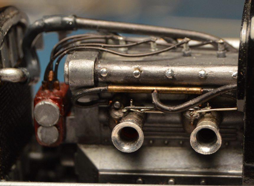

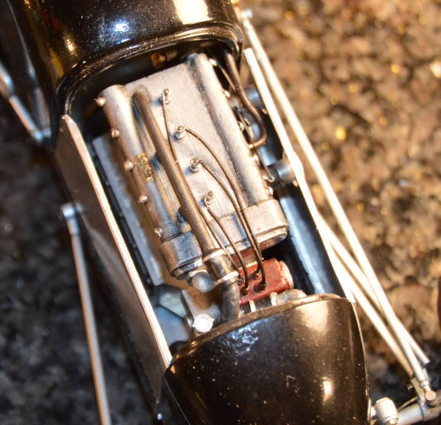

Straightliner59 Posted November 19, 2020 Author Posted November 19, 2020 I've got a lot of work done, on this thing, but it wasn't flashy, so, I haven't updated this, in a while. I am very close to putting the wheels on it. I'm doing "punch-list" stuff, toward that. When I looked at the engine, I couldn't help but notice that it was lacking something. It dawned on me that the same method I used to make the snaps, would also help with the look of the engine. I used the inside-tapered brass tubing punch to make some small domes from aluminum duct tape to cover the nuts on the cam covers. Rather than use the tape in its natural form, I dulled its finish with a pink eraser. Once I had applied the discs, I used a short piece of aluminum tubing, again tapered on the inside, but, not sharpened, to seat the edges of the discs over the nuts I think it worked out pretty nicely! Here are before and after shots. As always, questions, critiques and comments are welcome! Thanks for looking!

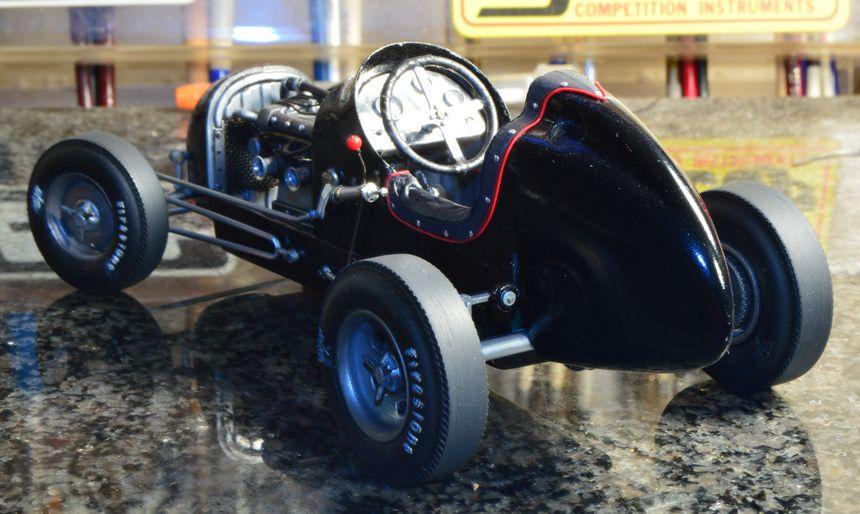

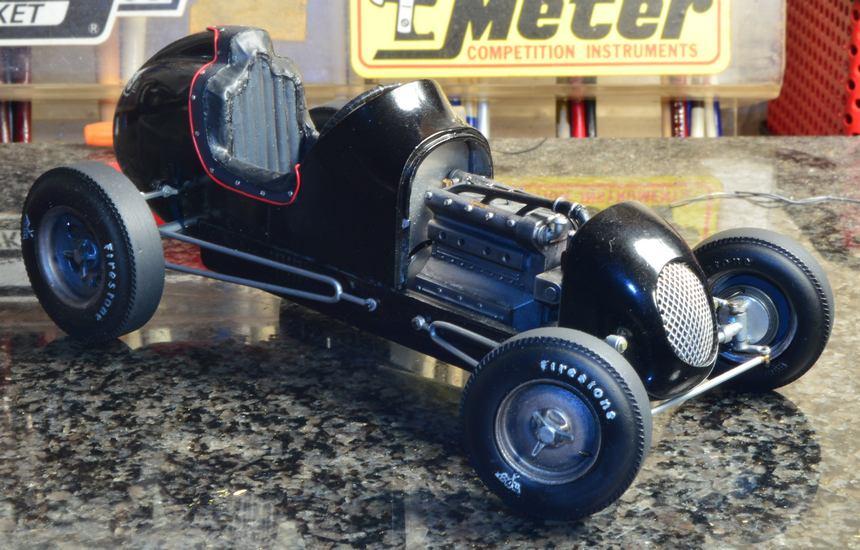

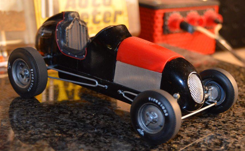

Straightliner59 Posted November 22, 2020 Author Posted November 22, 2020 It's on the wheels! I think I got everything done that needed to be, before mounting them. We'll see, I reckon! Next up is sanding the film from a sheet of flashing, so that it can be cut and annealed, and work on the hood can commence. Critiques, questions and comments are always welcome! Thanks for looking...

Straightliner59 Posted November 22, 2020 Author Posted November 22, 2020 One hood side panel is well on its way...

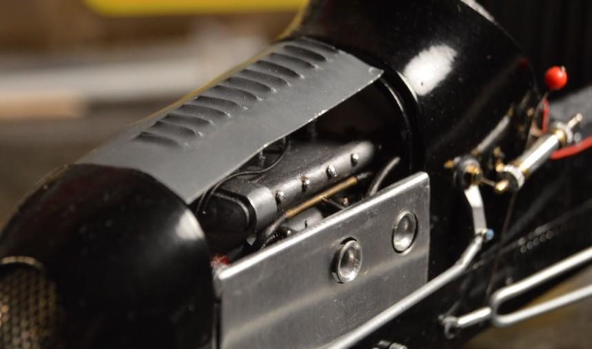

Straightliner59 Posted November 22, 2020 Author Posted November 22, 2020 57 minutes ago, AmericanMuscleFan said: I was just wondering if you could try using a not-too-sharp wood chisel and try punching (or just embossing) the louver shapes one at a time with the aluminum foil resting on a piece of soft wood? I don't know if it could work? However, you will need to draw the lines with a pencil to guide you for a consistent and precise repeating pattern. This is just a suggestion, I know how resourceful you are my friend... That is exactly what I intend to use. I've played around with it, some. Wood works okay, but leaves something to be desired. I am thinking of milling a simple, angled slot in a 1/4"X1/2" piece of aluminum, just to accept the tip of the chisel, and keep the depth, and, therefore the shape, uniform. I'm thinking that'll work pretty slick! Meantime, here's the other side panel. It will need to be cut for exhaust clearance.

Straightliner59 Posted November 23, 2020 Author Posted November 23, 2020 I have the side engine panels roughed-out. I wanted to see what it looks like, down between them.

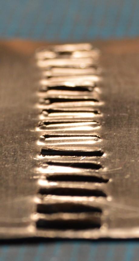

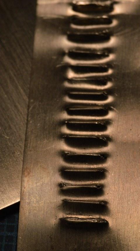

Straightliner59 Posted November 24, 2020 Author Posted November 24, 2020 I think I am getting closer to figuring this out. It takes some time to clean them up, as the technique is pretty crude, but, it's showing some promise. Still a couple of tweaks I want to try...
Straightliner59 Posted November 24, 2020 Author Posted November 24, 2020 I did a bit of cleanup on the test sheet, and shot some primer on it. Just another couple of changes, involving alignment, and--well, I am confident that I can make these happen for this project! I just want a few near the rear of the hood, like the kit has.

AmericanMuscleFan Posted November 25, 2020 Posted November 25, 2020 You are heading in the right direction Daniel, your louvers are pretty nice and will be perfect after minimal cleaning! Impressive!!!
