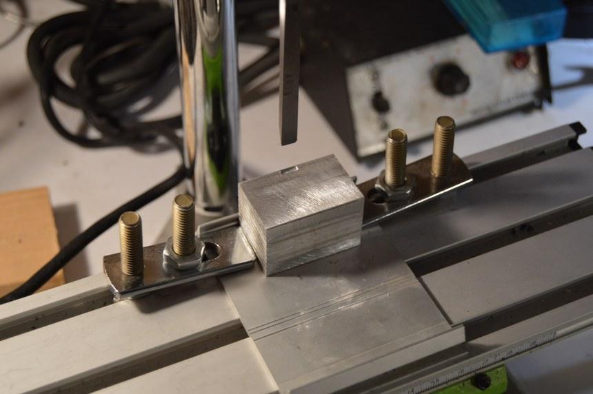

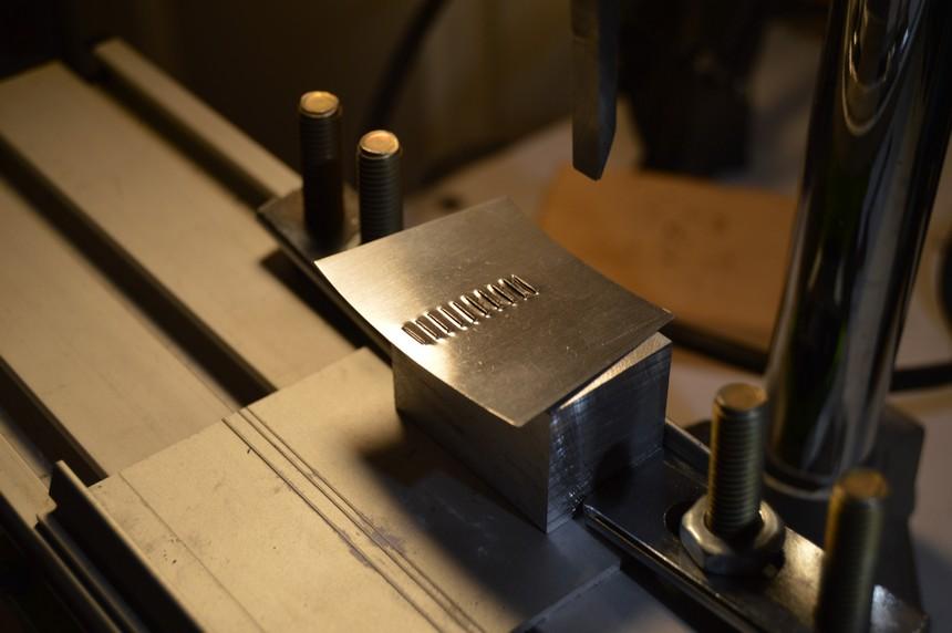

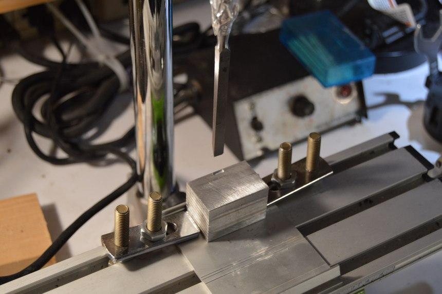

Straightliner59 Posted November 25, 2020 Author Posted November 25, 2020 Now, we're talkin'! I cut the handle from the chisel, then turned the tang(?) down, until it would fit into the plunge shaft of my Dremel drill press. Until I come up with something better, I simply mounted it with aluminum duct tape. I milled a slot into a chunk of aluminum as a receiver and stop, to keep the size of every louver (louvre--Hi, Steve! ?) uniform. Preliminary tests are even better than prior efforts, and much easier. One noticeable difference is that the press/die method prefers un-annealed sheet. Still...
Straightliner59 Posted November 26, 2020 Author Posted November 26, 2020 A final improvement to the press. I was reluctant to take the drill press apart, at first. Once I had done that, and tested the validity of my hypothesis, I realized that, to make it viable, the chisel had to be mounted more solidly. A drill, a tap and an allen screw later, and we're good to go!
Straightliner59 Posted November 26, 2020 Author Posted November 26, 2020 The reward of persistence! One take, no dubs! I haven't even cleaned these up. Man, am I happy with this!

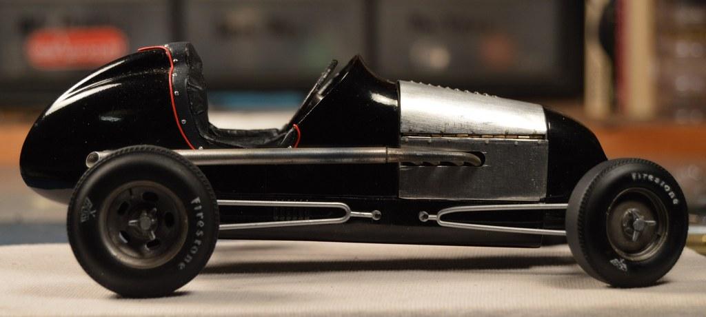

Straightliner59 Posted December 1, 2020 Author Posted December 1, 2020 (edited) I made a piano hinge for the hood. I had to fudge the mounting of it, due to the fact that I still haven't figured a way to get a clean, tight fold, along the bottom edges of the top hood panel. So, I drilled the hood panels and the hinge, and inserted plastic model RR rivets, and swaged them on the inside. I will smooth them down, a bit, and paint them with the hood, that will make them less visible. The hinge operates very smoothly! The hood only needs some minor tweaking. In my excitement to assemble it and test fit it, I forgot clean it all up. Guess that'll take longer, now! The exhaust pipe is only set in place. I am still working on its hanger bracket. As always, questions, comments and critiques are welcome! Edited December 1, 2020 by Straightliner59
