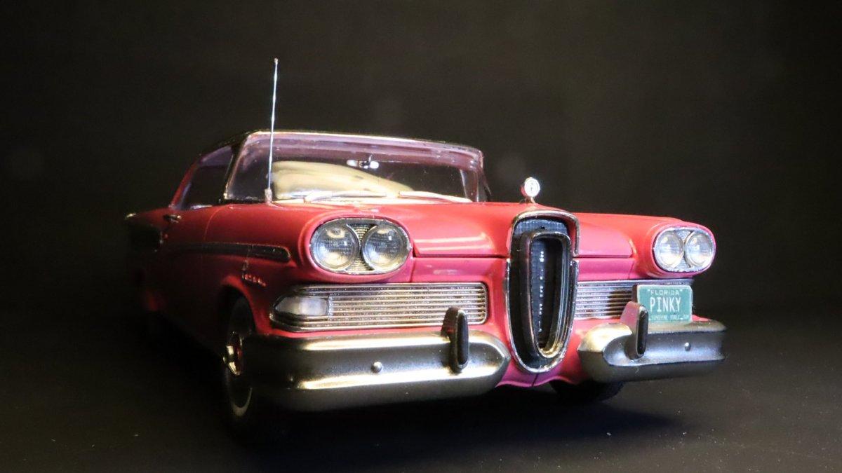

David G. Posted February 17, 2021 Author Share Posted February 17, 2021 (edited) Hello All! It's time for another update... obviously. As my recovery progresses, I find that I'm able to spend a little more time building than I could a couple of months ago. So here are the results of my recent efforts. I was able to get the foil work completed as well as some detail painting. The more this build progresses, the more I find myself liking the way it looks. What was that slogan? "The thrill starts with the grille... and never seems to end" Yeah, well.. Pink and black and chrome! You can't get much more 1958 than that! As always, thanks for taking the time to look and please feel free to comment. David G. Edited February 17, 2021 by David G. typo Quote Link to comment Share on other sites More sharing options...
randyc Posted February 18, 2021 Share Posted February 18, 2021 That really is looking great. Glad you're healing. Quote Link to comment Share on other sites More sharing options...
espo Posted February 18, 2021 Share Posted February 18, 2021 Glad to see you're back to work on your Edsel. The foil looks good , keep us updated when ever you can. Quote Link to comment Share on other sites More sharing options...
bisc63 Posted February 19, 2021 Share Posted February 19, 2021 Ditto, keep healing and keep modeling! This Edsel is SHARP! Quote Link to comment Share on other sites More sharing options...
David G. Posted February 19, 2021 Author Share Posted February 19, 2021 18 hours ago, randyc said: That really is looking great. Glad you're healing. Thanks Randy, I'm pretty happy with the progress I've made on both fronts. 18 hours ago, espo said: Glad to see you're back to work on your Edsel. The foil looks good , keep us updated when ever you can. Thank you David, I appreciate your comment. Actually, I never quit working on this one but there were many times when I couldn't do as much as I would have liked. I did place on myself a firm commitment of at least thirty minutes every week as a part of my self-imposed therapy. The good news is that in the past couple of weeks I've been able to make more progress than in the previous couple of months, so I should have this one finished fairly soon. 5 hours ago, bisc63 said: Ditto, keep healing and keep modeling! This Edsel is SHARP! Thanks for your comment Rusty, I'm glad to see that you're still following me on this one. Hopefully I'll have another update soon! Best Regards, David G. Quote Link to comment Share on other sites More sharing options...

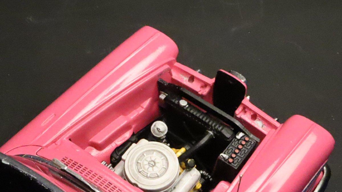

David G. Posted February 26, 2021 Author Share Posted February 26, 2021 In the directions, it looks as if you are to put the radiator support in place, install the upper and lower radiator hoses, then lower the body on the chassis. I initially built mine this way but when I went to lower the body on to the chassis, I discovered that the flare at the top of the radiator support wall was too wide to allow it to slip into the engine bay. I ended up removing it and replacing it after I secured the body to the rest of the chassis. Not only did this necessitate the removal and replacement of both radiator and the hoses (the lower of which I may end up leaving off) but now the hood contacts the radiator support and is about 1/2 mm from closing flush. 😕 I may have misinterpreted the directions but I thought I'd share the information just in case. Looking at the assembly from this angle, I can see no way that the radiator support can be installed in any other way than from above. Because I couldn't get the radiator support to settle in quite properly, it sits a little high and lifts the hood by about 1mm. It looks like I should be able to file down the top of the support a sufficient amount to allow the hood to settle in properly. I guess if model builders don't have any problems to solve, we can always create our own. Pressing on, David G. Quote Link to comment Share on other sites More sharing options...
Force Posted February 26, 2021 Share Posted February 26, 2021 Yes because of the shape of the radiator support it must be installed from the top, maybe your problem is that the locator pins at the bottom of the support hasn't gone into the holes in the frame rail they are supposed to go into, if you tweek it a bit so they will go or cut them off the support may go down a bit further. Quote Link to comment Share on other sites More sharing options...
doorsovdoon Posted February 26, 2021 Share Posted February 26, 2021 This one is really fighting you, isn't it?! Looks like you're winning though. Keep pushing, she's looking great,👍 Quote Link to comment Share on other sites More sharing options...
David G. Posted February 27, 2021 Author Share Posted February 27, 2021 16 hours ago, Force said: Yes because of the shape of the radiator support it must be installed from the top, maybe your problem is that the locator pins at the bottom of the support hasn't gone into the holes in the frame rail they are supposed to go into, if you tweek it a bit so they will go or cut them off the support may go down a bit further. Thanks Håkan. I do get that now but the directions seem to indicate otherwise. Or at least they did to me at the time I assembled that bit. I did consider removing and reinstalling it as you suggest but I feel I have it in there as well as I can get it. I'm also concerned that that may cause more damage than just filing about 1mm off the top of the radiator support. I feel that I have more control over that option. 11 hours ago, doorsovdoon said: This one is really fighting you, isn't it?! Looks like you're winning though. Keep pushing, she's looking great,👍 I think that this is more a story of me fighting against myself Gareth. Nearly all of the difficulties I've encountered with this build are of my own doing. I think the Rustoleum problem is 50/50 as I should have known better through previous experience. It's like I say: "Model builders, we're problem solvers who create our own problems to solve!" I'm also glad to know that you like it. I do feel that the results are worth the effort I've been putting in and it's great to have that confirmed, thank you. David G. Quote Link to comment Share on other sites More sharing options...
misterNNL Posted February 27, 2021 Share Posted February 27, 2021 I'm liking the color choice here. This would have looked right at home in the parking lot at my Junior prom in '59! Quote Link to comment Share on other sites More sharing options...
David G. Posted February 28, 2021 Author Share Posted February 28, 2021 On 2/26/2021 at 11:27 AM, Force said: Yes because of the shape of the radiator support it must be installed from the top, maybe your problem is that the locator pins at the bottom of the support hasn't gone into the holes in the frame rail they are supposed to go into, if you tweek it a bit so they will go or cut them off the support may go down a bit further. Hello again Håkan. I found some time to do a little work on this yesterday and I ended up taking your advice to remove the support. It came loose much easier than I though it would and I was able to adjust the clearance issues from the bottom and reinstall it with little difficulty. Thanks for that. I'll see if I can post a pic later today. 18 hours ago, misterNNL said: I'm liking the color choice here. This would have looked right at home in the parking lot at my Junior prom in '59! Thanks Tom. In person it's quite striking, I hope my photos can do it justice. David G. Quote Link to comment Share on other sites More sharing options...
David G. Posted February 28, 2021 Author Share Posted February 28, 2021 OK after following some good advice (thank you Håkan) I was able to get the hood seated properly by taking a little off the bottom of the radiator support assembly. I even got that nasty CA accelerant stain cleaned up! Now to install a few more fiddly bits, then a final polish and I should be done. Thanks to everyone for their patience, advice and kind comments. David G. Quote Link to comment Share on other sites More sharing options...
