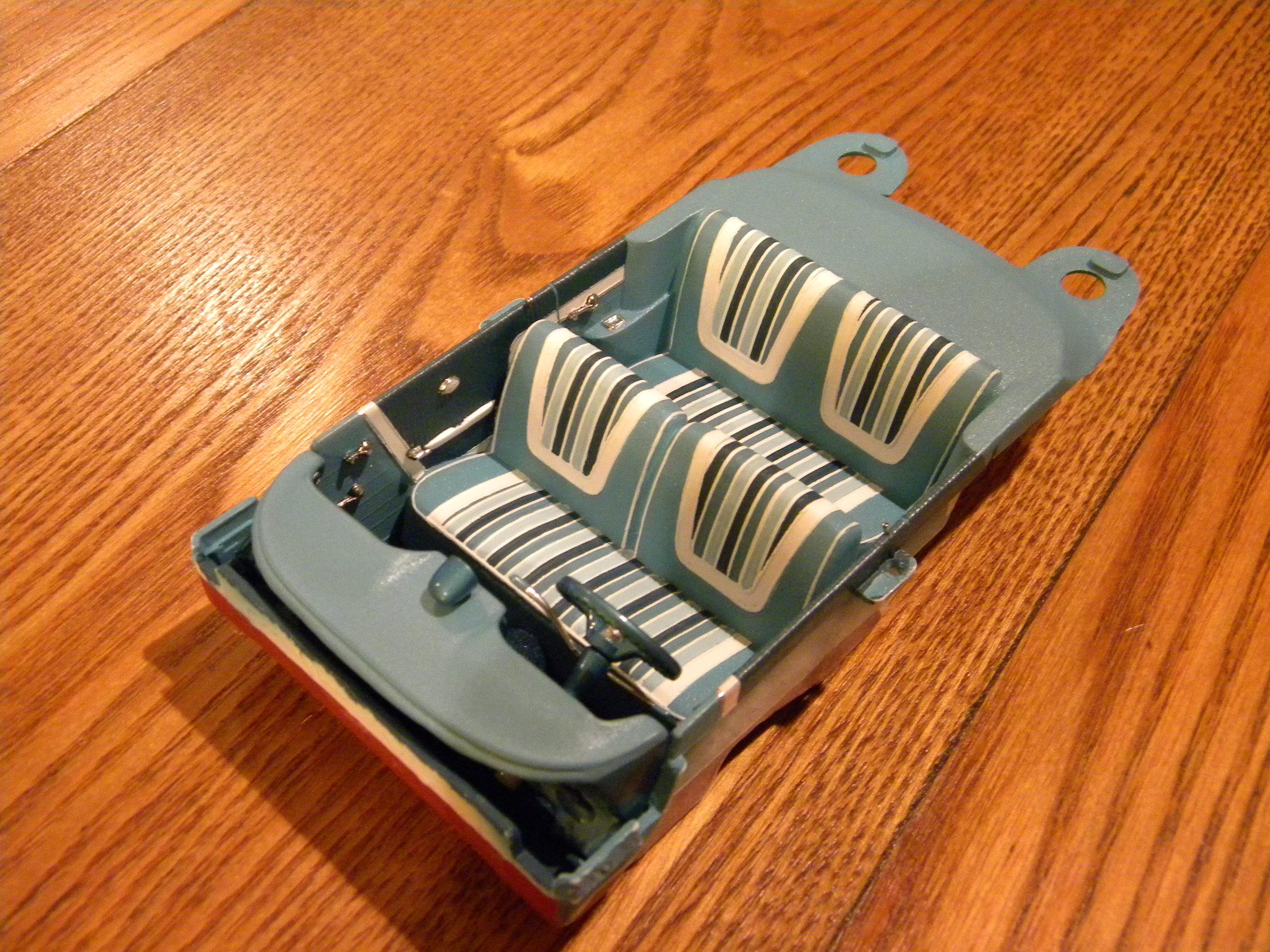

TransAmMike Posted November 13, 2021 Posted November 13, 2021 8 hours ago, StevenGuthmiller said: Well, it might not be easy to explain, but I'll try. I started by laying a piece of tape all the way across for what would be the farthest side of the pin stripe. I could have measured this, but it was close enough to the wide stripe to eye ball it. Then I laid the next piece of tape along what would be the inside edge of the pin stripe, using the other piece of tape, and the edge of the wide stripe, (which was visible through the tape) as a guide to get it as straight as I could. I'm sure that some might think that I went about these stripes strangely, and I guess the way that I did it might have contributed to it not coming out exactly as I would have wanted, but there was a method to my madness. Because of the way that I approached them, I didn't have to cut and try to handle and keep straight long and extremely thin pieces of tape. Only the piece of tape used between the two wide stripes needed to be cut thin, (in retrospect, it could have been a little thinner) and even that piece was difficult to wrangle and keep straight. I hate to think of trying to cut and lay out pieces of tape thin enough to separate the wide and thin stripes. This way, the rest of the pieces of tape were 6mm Tamiya tape that I just had to cut a clean edge on. Steve Hey thanks Steve for answering my question. Very clean lines. I have one roll of Tamiya tape and it just doesn't see to stick well enough to me for crisp lines. I just started a '62 Catalina and that 4 tone seat pattern is gonna be a bear!!
StevenGuthmiller Posted November 13, 2021 Author Posted November 13, 2021 (edited) 1 hour ago, TransAmMike said: Hey thanks Steve for answering my question. Very clean lines. I have one roll of Tamiya tape and it just doesn't see to stick well enough to me for crisp lines. I just started a '62 Catalina and that 4 tone seat pattern is gonna be a bear!! Tamiya tape is naturally lower tack than something like regular masking tape, but it's much more flexible and does a much better job than masking tape at leaving a super clean edge. Just make sure to burnish down the edges pretty well, and shoot the first couple of coats of paint lightly and you should be very happy. Remember, I used Tamiya tape on this little gem. Steve Edited November 13, 2021 by StevenGuthmiller 1
TransAmMike Posted November 13, 2021 Posted November 13, 2021 1 hour ago, StevenGuthmiller said: Tamiya tape is naturally lower tack than something like regular masking tape, but it's much more flexible and does a much better job than masking tape at leaving a super clean edge. Just make sure to burnish down the edges pretty well, and shoot the first couple of coats of paint lightly and you should be very happy. Remember, I used Tamiya tape on this little gem. Now thats what I'm talking about Steven. If I can get it almost that good I'll be happy?
