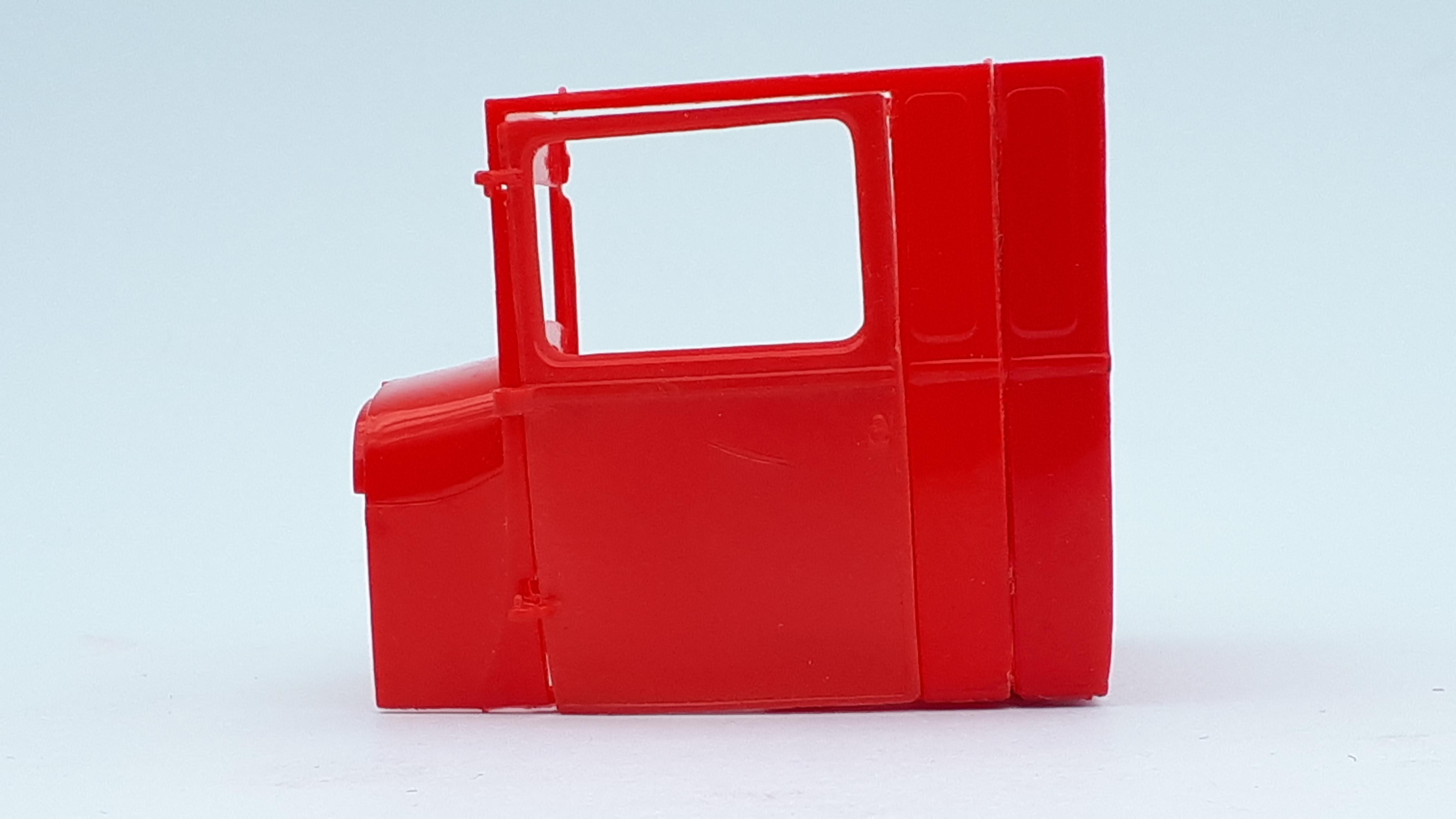

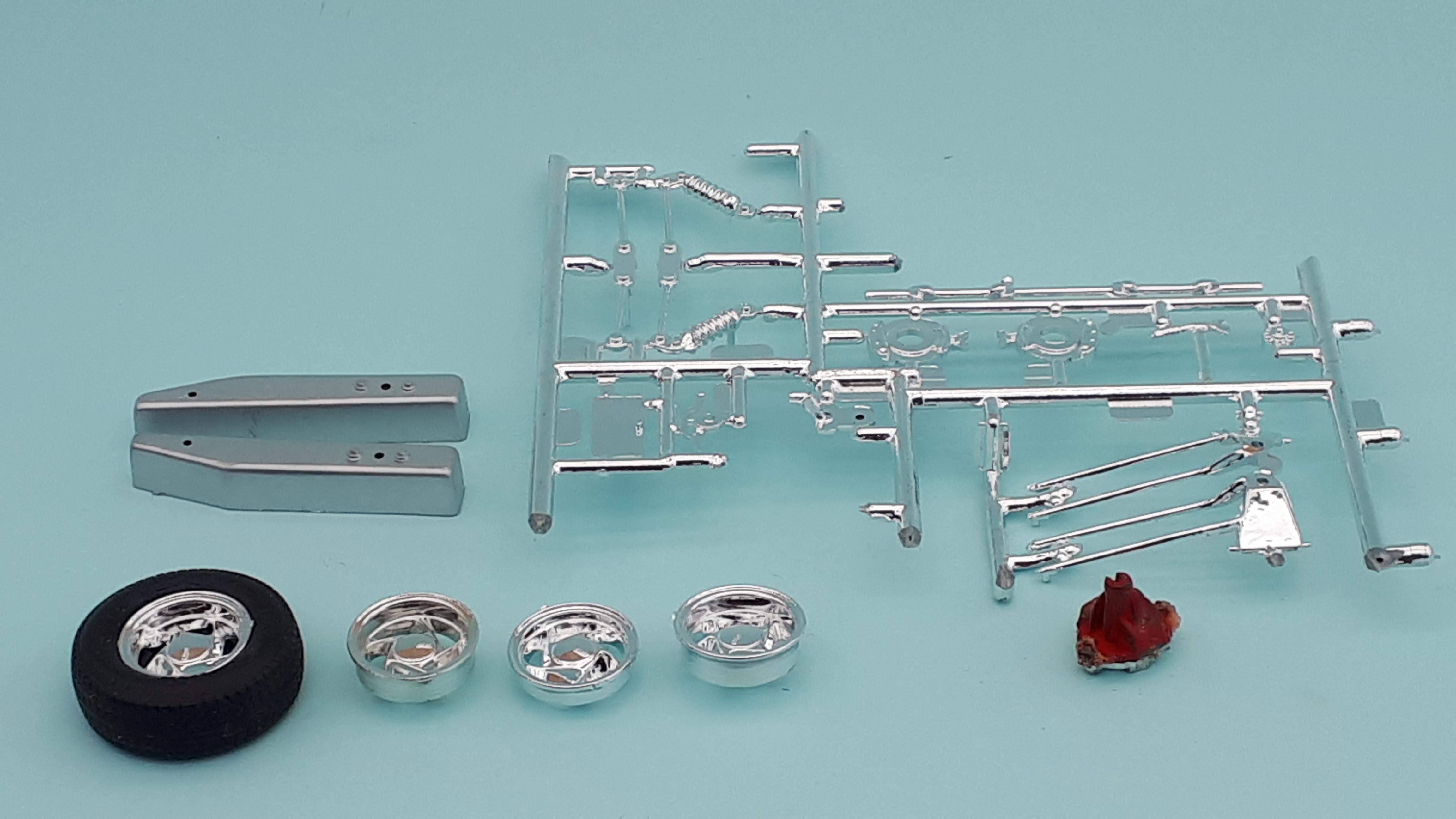

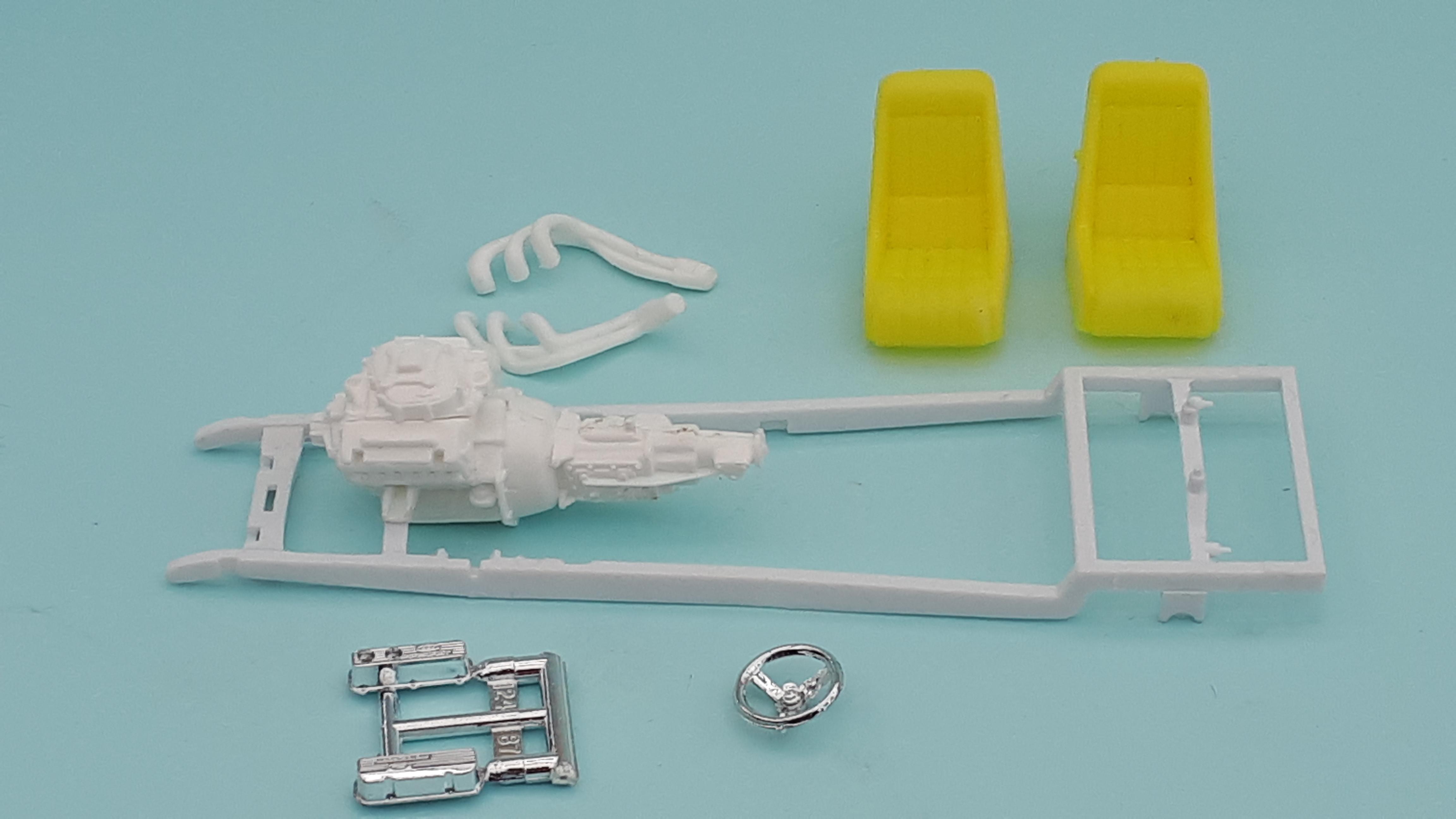

I'm not  sure how quickly this build will go but looks I've got the right parts to get there.  The vast majority of the body components will come from a Hot Rod series issue of the kit - the smooth hood sides and tailgate in this issue are made for the job.
  • Like 1
In a pair of happy coincidences, I will have the right parts to complete a build that I first contemplated back in 1992 after photographing a real rod at Valla Park Rod Run on the east coast. They had used two rear cab pillars to make an extended cab to suit the owner's plus-size frame. I recall driving my roadster back to Western Australia and getting two pickup bodies out, cutting and joining them and for whatever reason, putting them away until last night!
I think this will add a nice, eighties appropriate twist to the rod -  after all, if I photographed it in the early nineties he probably built it in the eighties, right?  The second totally unexpected twist concerns the pickup bed.  This came in a box that a mate gave me and some painting had been done, and the pickup bed had been shortened AT THE FRONT!  Turns out it was cut  in exactly the right place to match up with my extended cab, as you can see in this bodgied up photo. Ya can't make this stuff up.  The original builder had used the most recent white plastic version and sprayed a so-so coat of red on the body panels but that was as far as he got.
For running gear, I will forgo the Revell Model A pickup kit altogether and kit bash this combo.  Revell 29 roadster chassis as recommended by Kit, Buttera T series Jag IRS as well as the front seats, steering wheel and saddle tanks - what could be more eighties than saddle tanks? To fit with a Boyd style dare -to-be-different theme, I dug out a Ford V6 from the Revell ASA Thunderbird.  From what I have read this is really a Chevy V6 with Ford rocker covers but I will move the distributor to the front to keep Tim's blood pressure down!
I think the wheels might be from a Revell 69 Corvette only because of the colour of the plastic.  Unsure whether to keep the high polish chrome or go for billet aluminium - knowing me I will try two of each on opposite sides.  I used to be indecisive, but now, I'm not so sure!
Not shown but I will probably use the Superbell dropped tube front axle and four bars from the Revell 32 series. Tubes were more common  than I beams in this era.
No idea of colour just yet but I keep seeing red!
Cheers
Alan

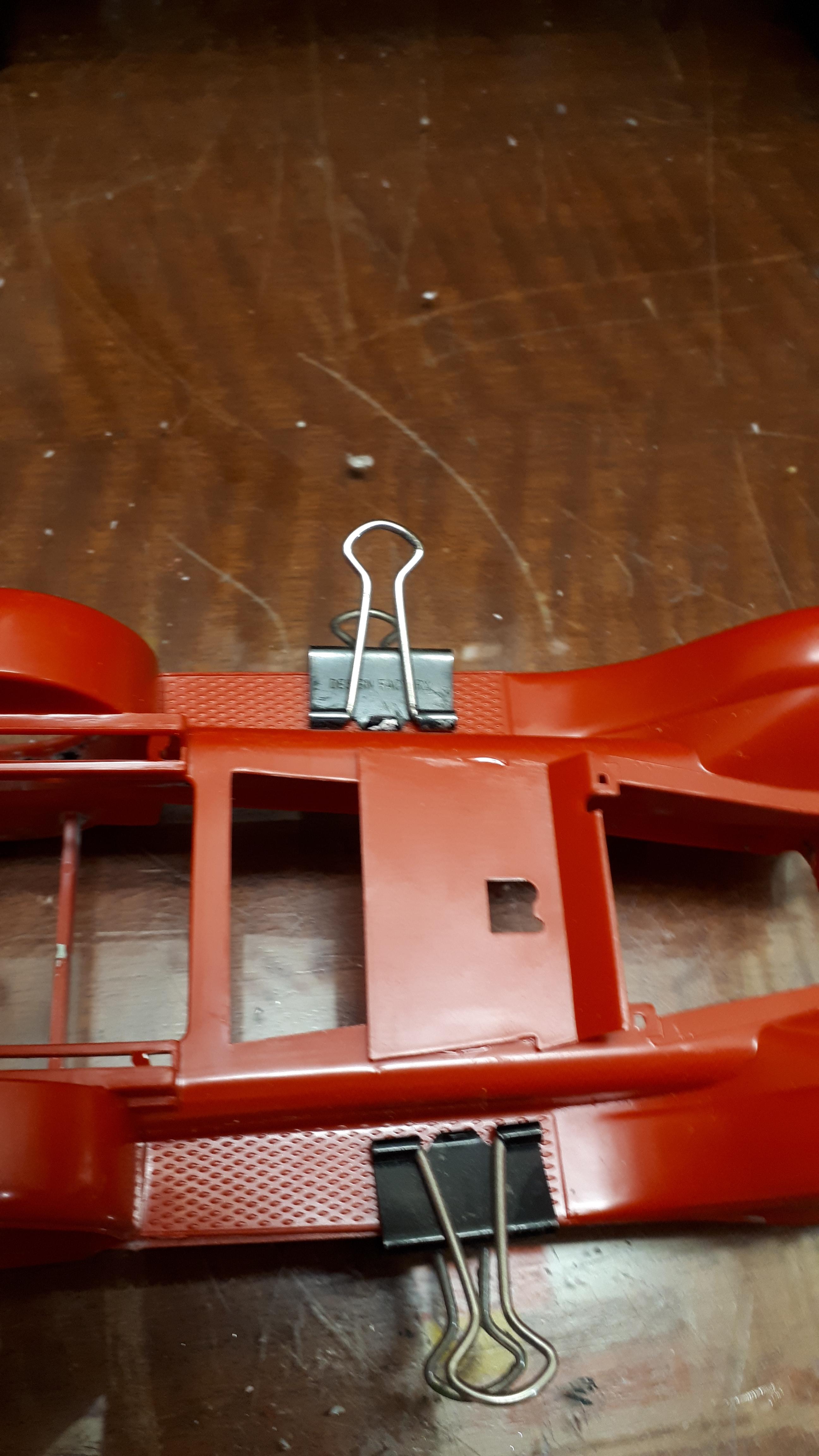

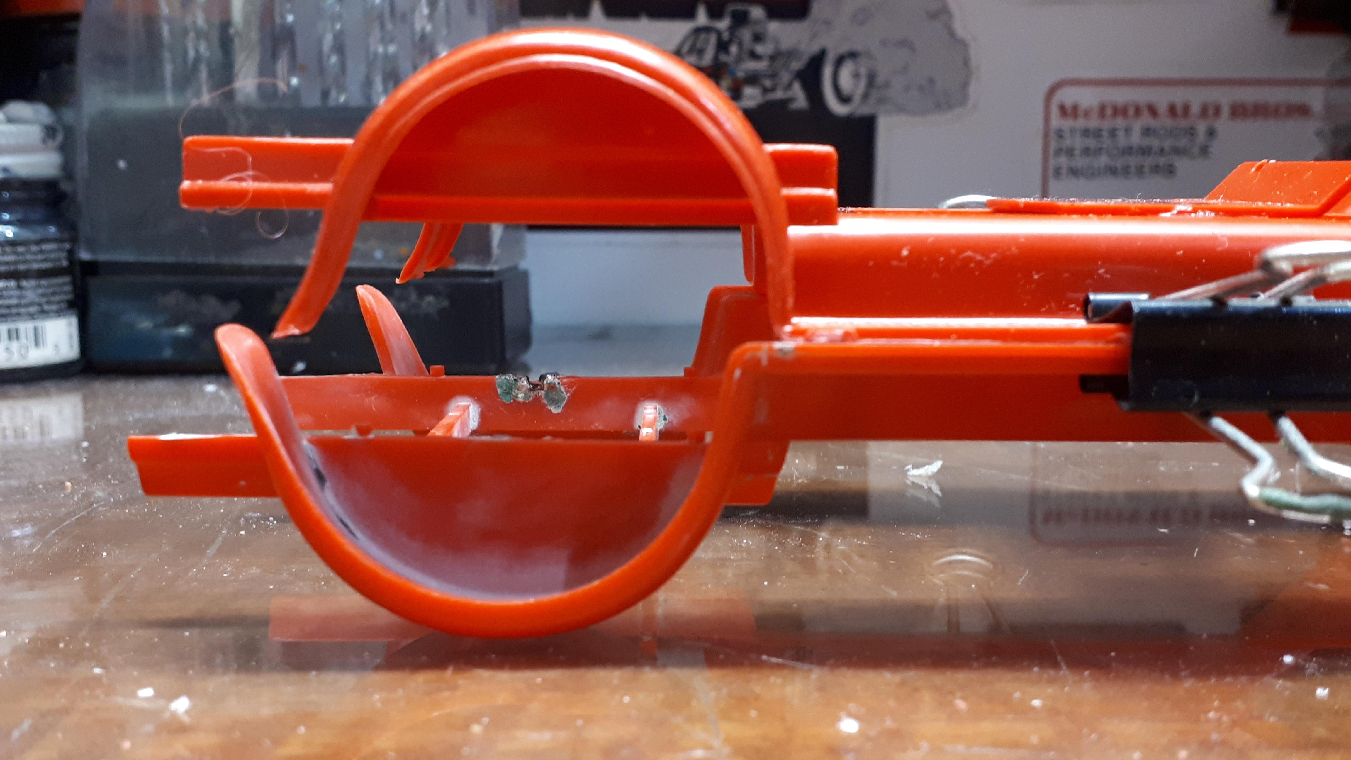

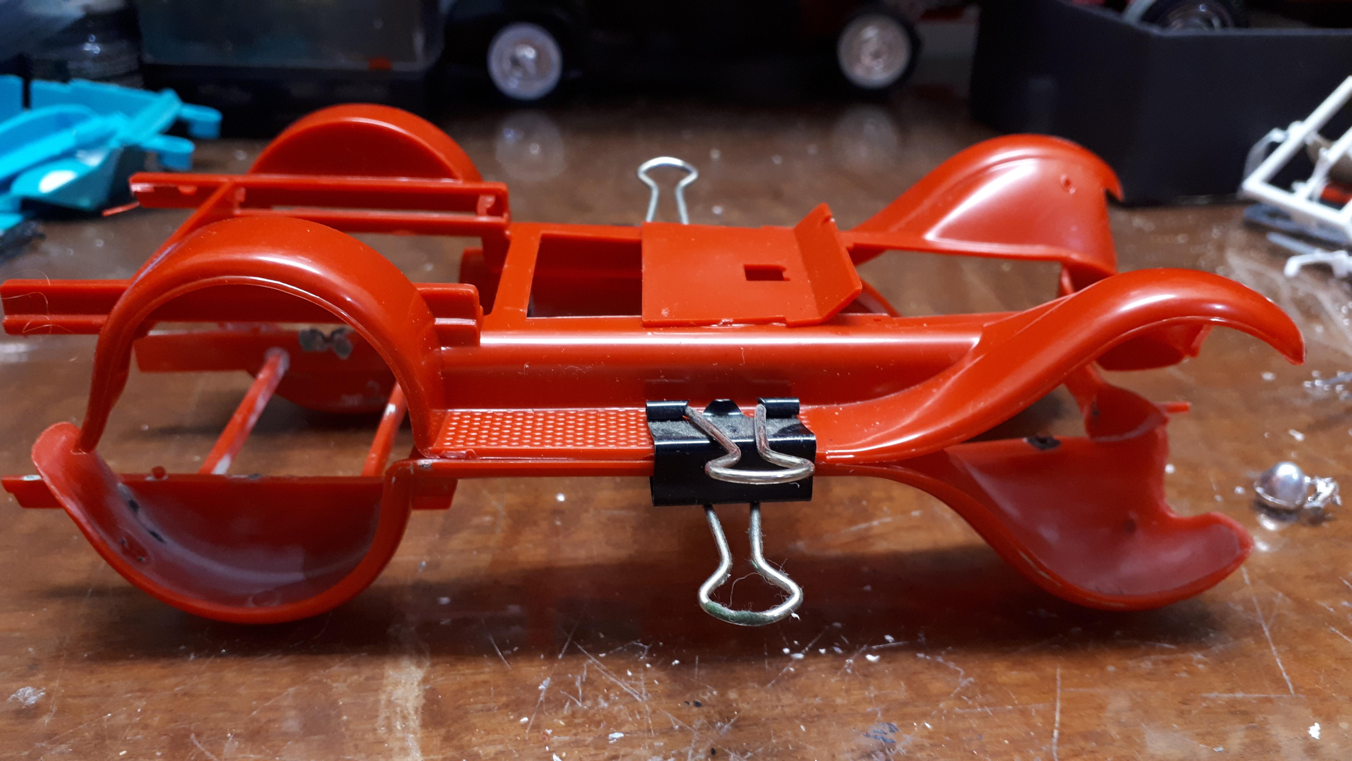

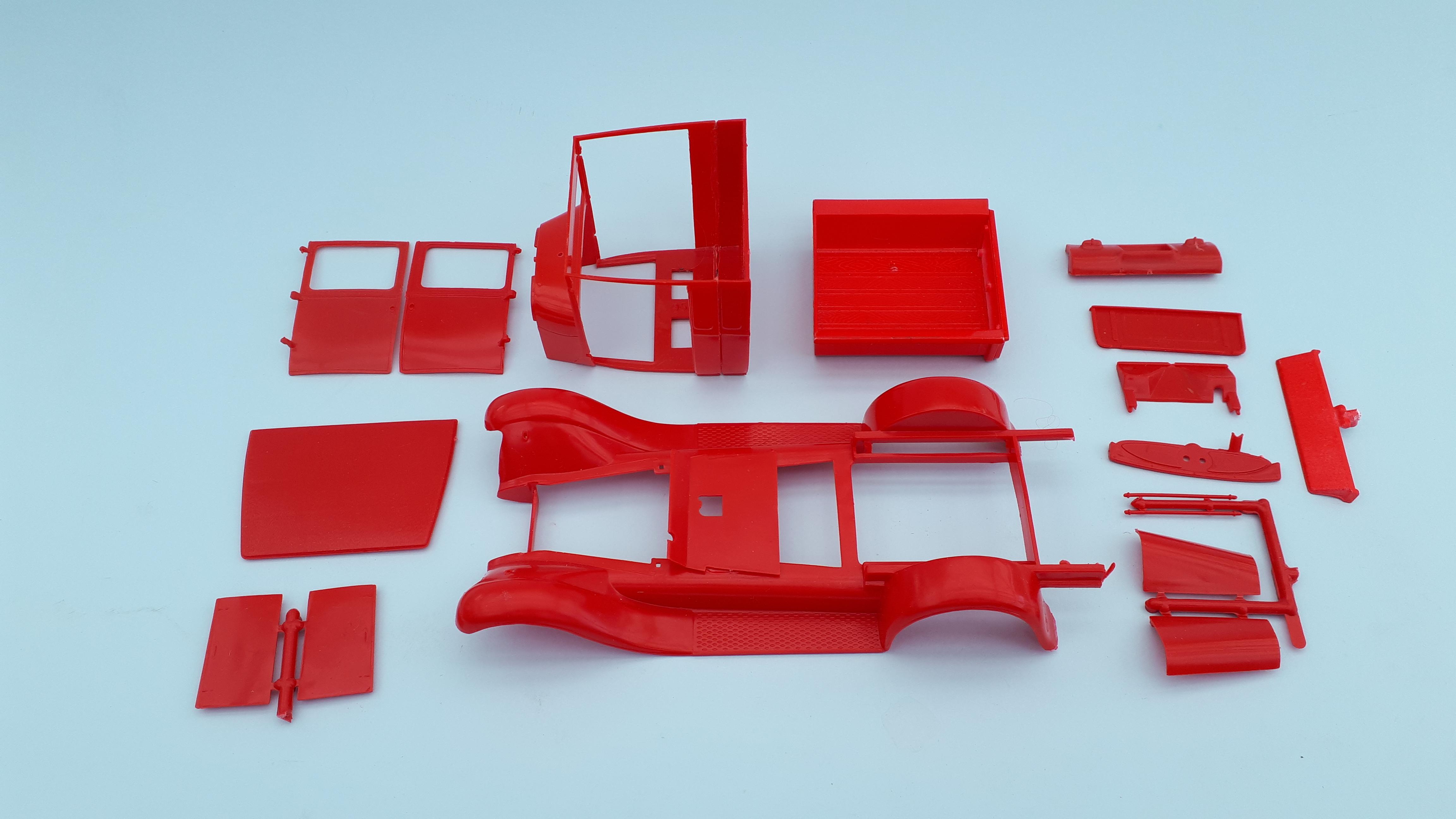

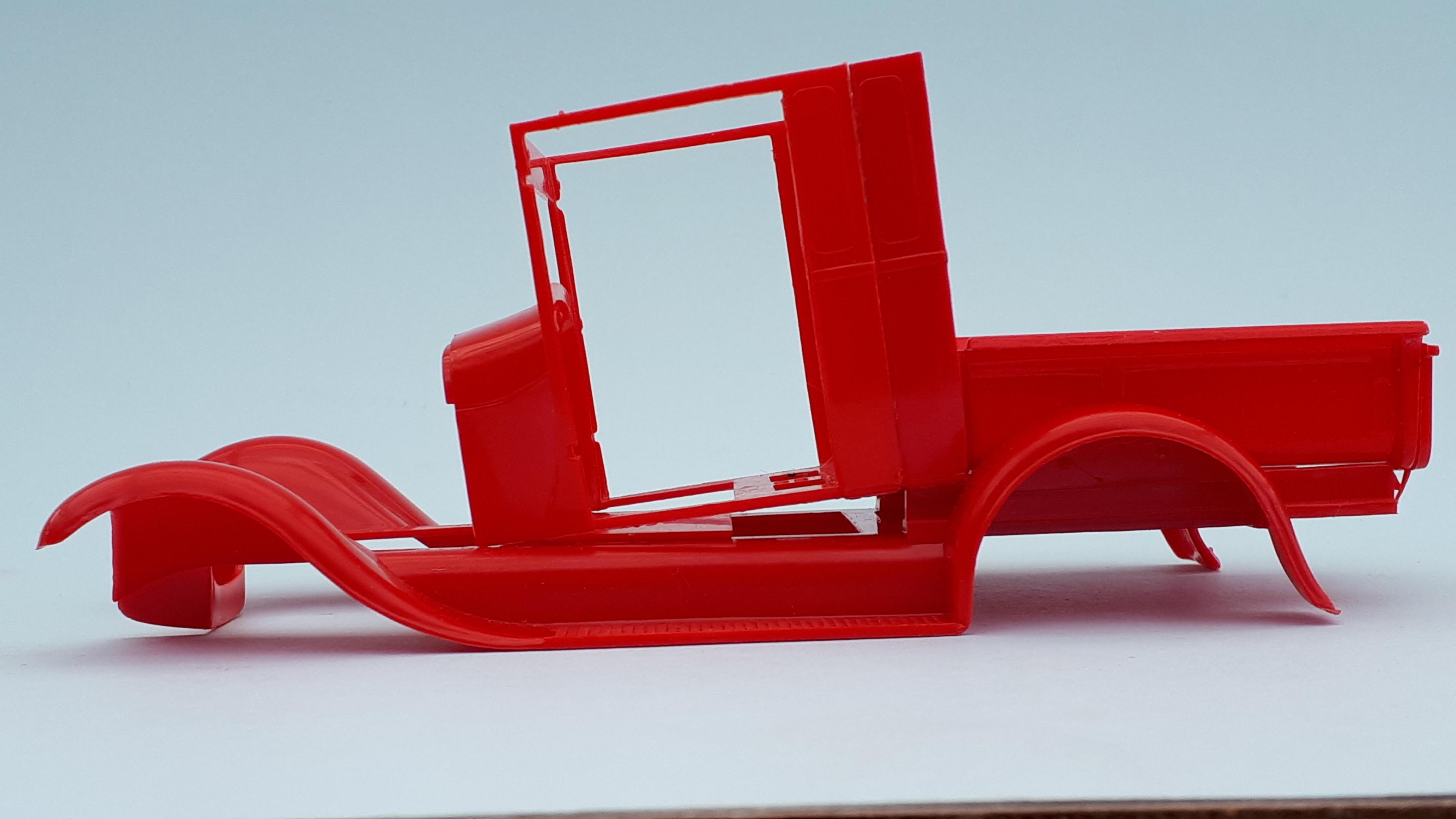

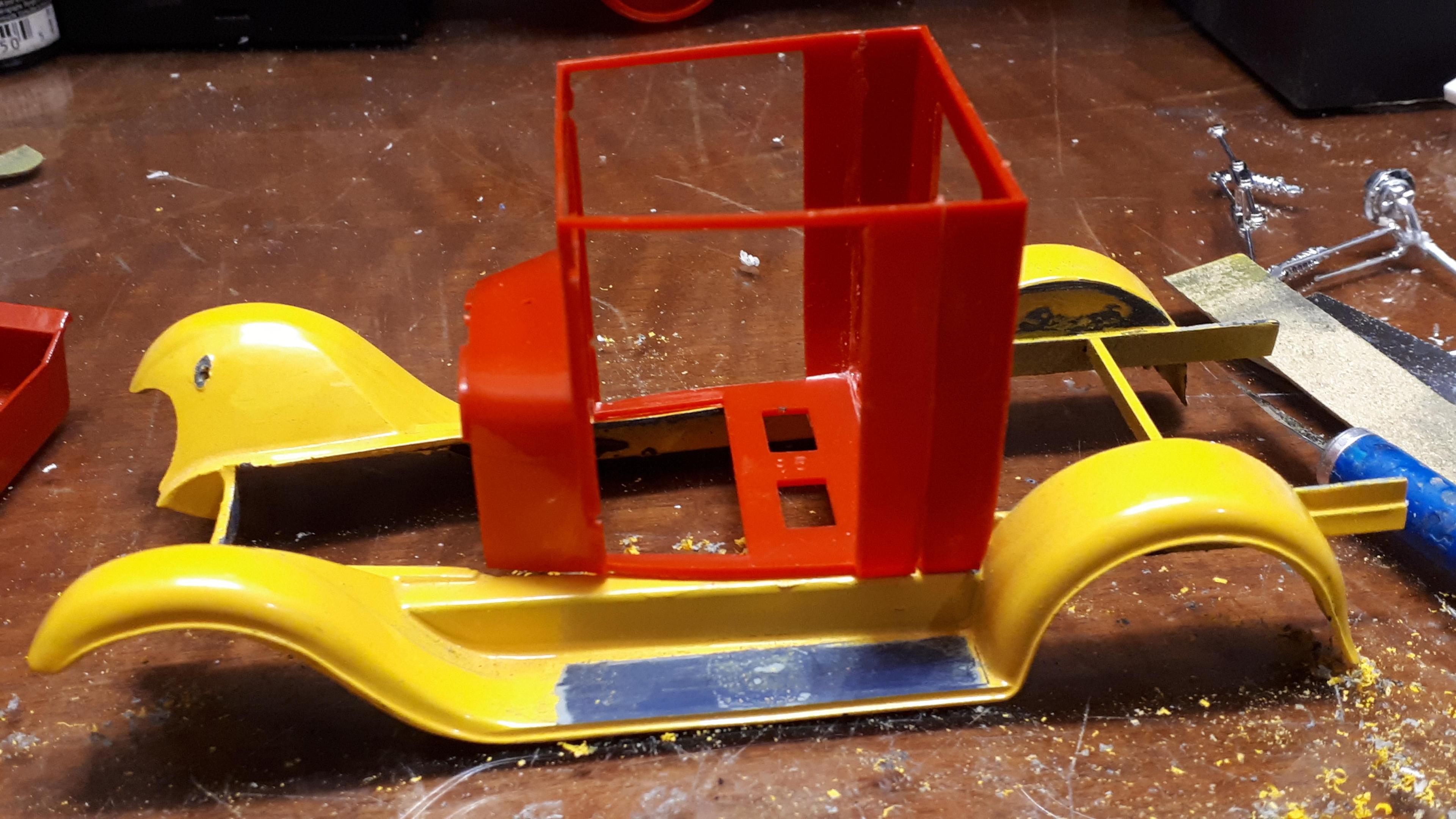

O.K., guys, you are going to love this one!  i spent some time tonight gluing the Jag rear end together, sanding seams off the V6, basic stuff.  I then started trial fitting the extended cab to the Revell fenders and determined that it just wasn't going to fit - the lower corners of the cab were going to hit the fenders no matter what I did.
I started digging through my Revell Model A PU box - there are roughly enough parts in there to build four of them.  I picked up another red fender unit and it suddenly dawned on me that it was not a Revell one, it was a Monogram Boss A Bone version. Must have got dropped in there by mistake.  Then a light bulb went off.  Maybe a 1/24th fender unit would have enough additional length to allow the cab to fit.  It did!
But would that make it out of scale with the rest of the cab?  Amazingly NO!  The Monogram and Revell fender units are within thousandths. of a mm to the same width. Who'da thunk?
But wait, there's more.  The Boss A Bone unit was in pretty good nick, a remnant from my younger brother's model building days and quite clean after I had stripped. it. I avoid chopping up "historical" parts if i can find something less precious.  I went back to my Monogram pickup box and found, of all things, the fender unit from a Bandai Blue Beetle. Yep, the Japanese company did a pretty good, pretty detailed knock off of the Monogram kit. It was originally powered by the ubiquitous Mabuchi can motor that the Japanese infected their kits with. The very dark blue plastic has a very thick coat of Testors Bright yellow on it, and serious glue burns from the step plates that I glued on in my teen years. And it DOESN'T have the exhaust holes in the top of the valance panels, so no need for filling
So now I'm going to sand off what remains of the running board detail for the smoothie one piece fender unit look and I will be one step closer to getting all these bits to work.  Only down side is that the Revell roadster frame wont fit at all but I am happy to rework a Monogram one, still retaining the running gear I had previously planned.
Check these pics out - what a fluke!
Yep, it's going to work!  I used a sharp Xacto to scrape off the damaged ( and simplified) running board detail from the Bandai fenders and then sanded it as smooth as I can for now. Into the stripper tonight, primer tomorrow and we will see where this goes.

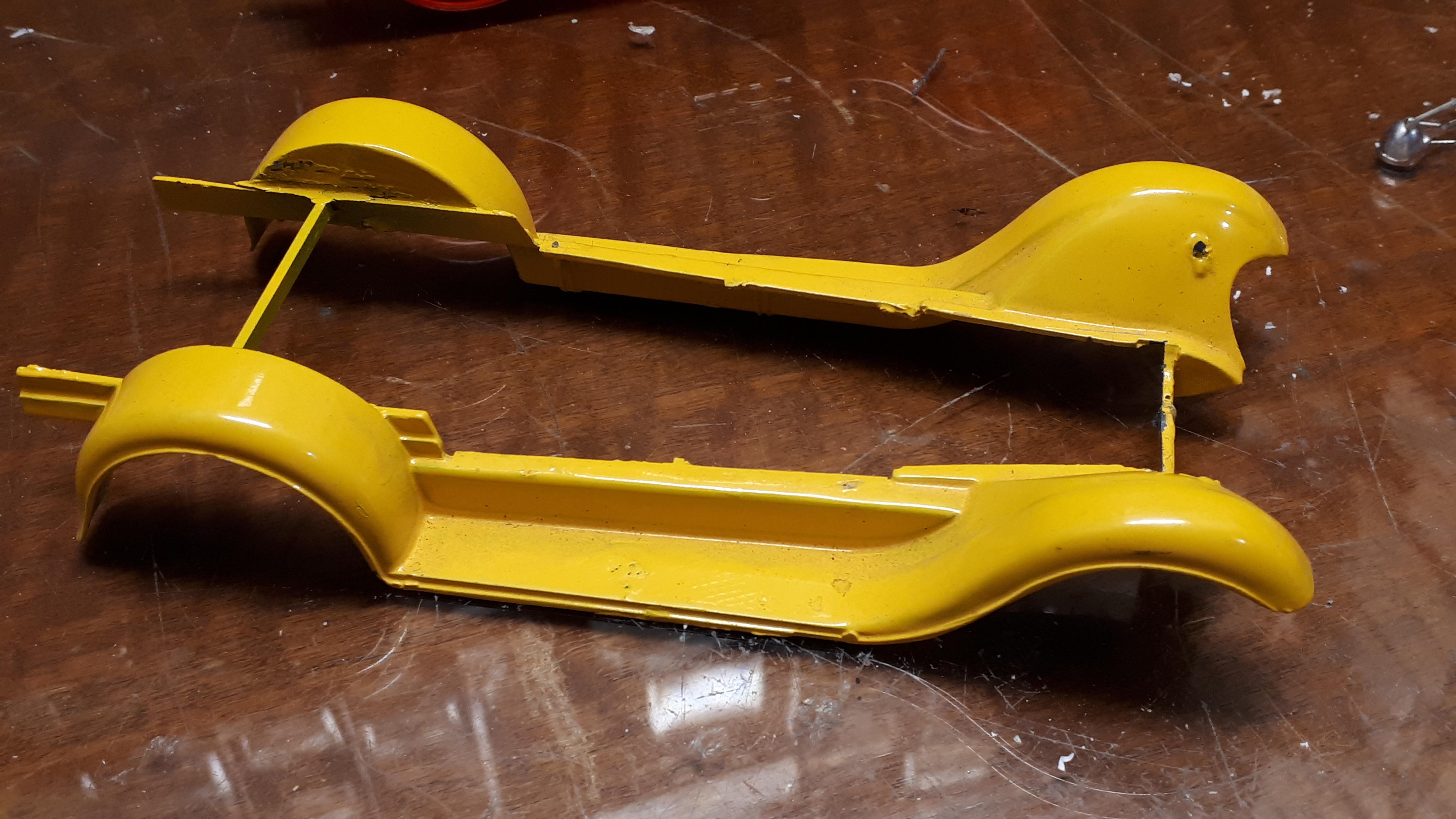

Thanks for the words of encouragement, Kit.  I got the yellow fenders stripped back to dark blue plastic yesterday but an old crack re-split through the front splash apron so that is getting re-inforced at the moment.  Not much photo worthy stuff happening yet.
