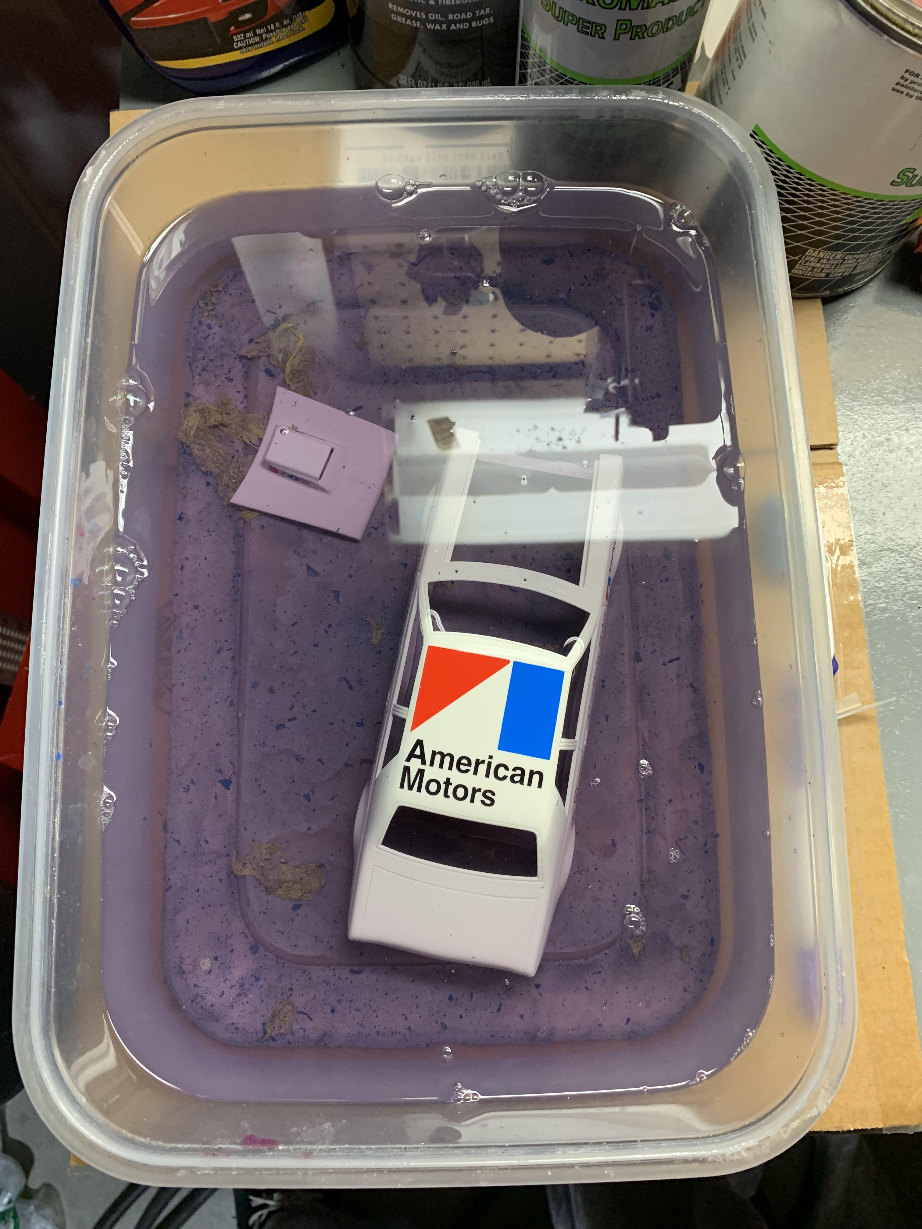

catpack68 Posted February 26, 2023 Posted February 26, 2023 (edited) Sucks you had to strip it. I try not to clearcoat over decals as I have had problems in the past. I would’ve left it just is but I understand.Looking forward to seeing it painted again and finished? Edited February 26, 2023 by catpack68
dragcarz Posted February 28, 2023 Author Posted February 28, 2023 On 2/26/2023 at 11:00 AM, AmericanMuscleFan said: Well Roger, despite the problem with the decals I'm glad to see that you are continuing the build of the Hornet because it's really a rare and interesting subject. Thanks Francis, I really appreciate the feedback from this forum. It’s setbacks that put some great builds back in the box never to be finished. Scott8950 put the repaint into perspective for me. I enjoy showing my builds at shows, I’ve won a few trophies mostly second and third places, but I don’t show them to win a trophy. I just want to share my build and perhaps make a contact with someone of similar interest. Let’s face it, there’s not a lot of model car builders out there and those that are, seem very quiet about it. Im definitely not on your level, or those of Clay Kemp or Jay Savarese ( hope I spelled the right), and probably never will be, and I’m ok with that! I enjoy the challenge and building something most people don’t have. This time, no clear over the decals!
dragcarz Posted February 28, 2023 Author Posted February 28, 2023 On 2/26/2023 at 11:34 AM, catpack68 said: Sucks you had to strip it. I try not to clearcoat over decals as I have had problems in the past. I would’ve left it just is but I understand.Looking forward to seeing it painted again and finished? Thanks Scott, it’s primed again, and this time, no Clear over the decals!

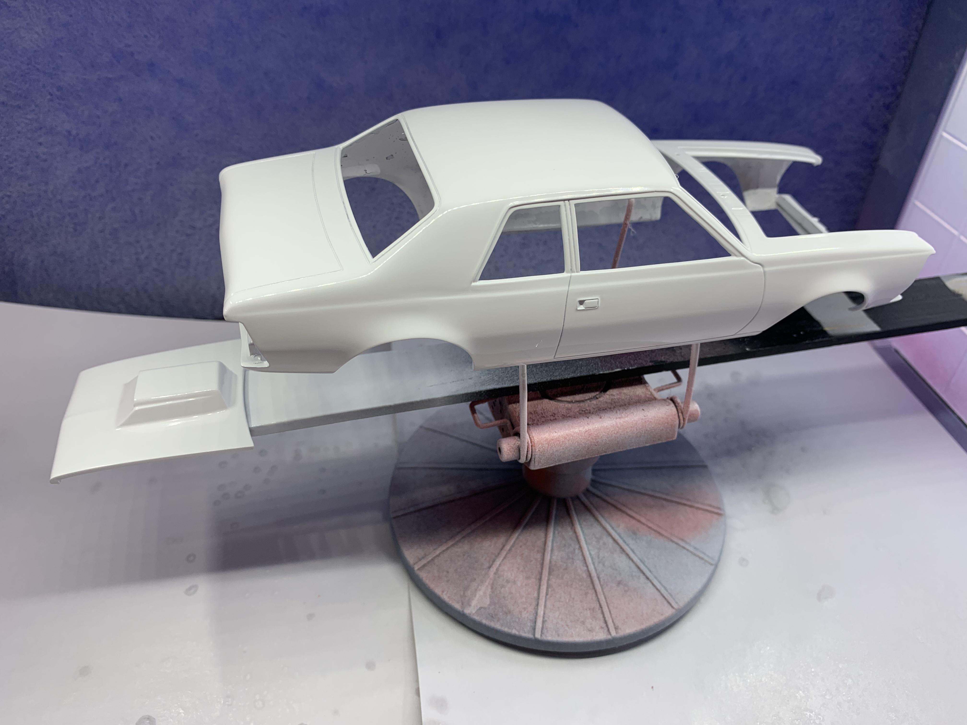

dragcarz Posted April 14, 2023 Author Posted April 14, 2023 9 hours ago, Zippi said: I've always been a little Leary about shooting clear over decals. You get it right Buddy. Thanks Zippi, I sprayed the Hornet tonight with Tamiya RS 29, Pure White. Fingers crossed!
Scott8950 Posted April 14, 2023 Posted April 14, 2023 10 hours ago, Zippi said: I've always been a little Leary about shooting clear over decals. You get it right Buddy. It has bitten me a couple times in the past now i always do a VERY light coat then i wait about 10 minutes and repeat before I spray a wet coat on. So far its worked..

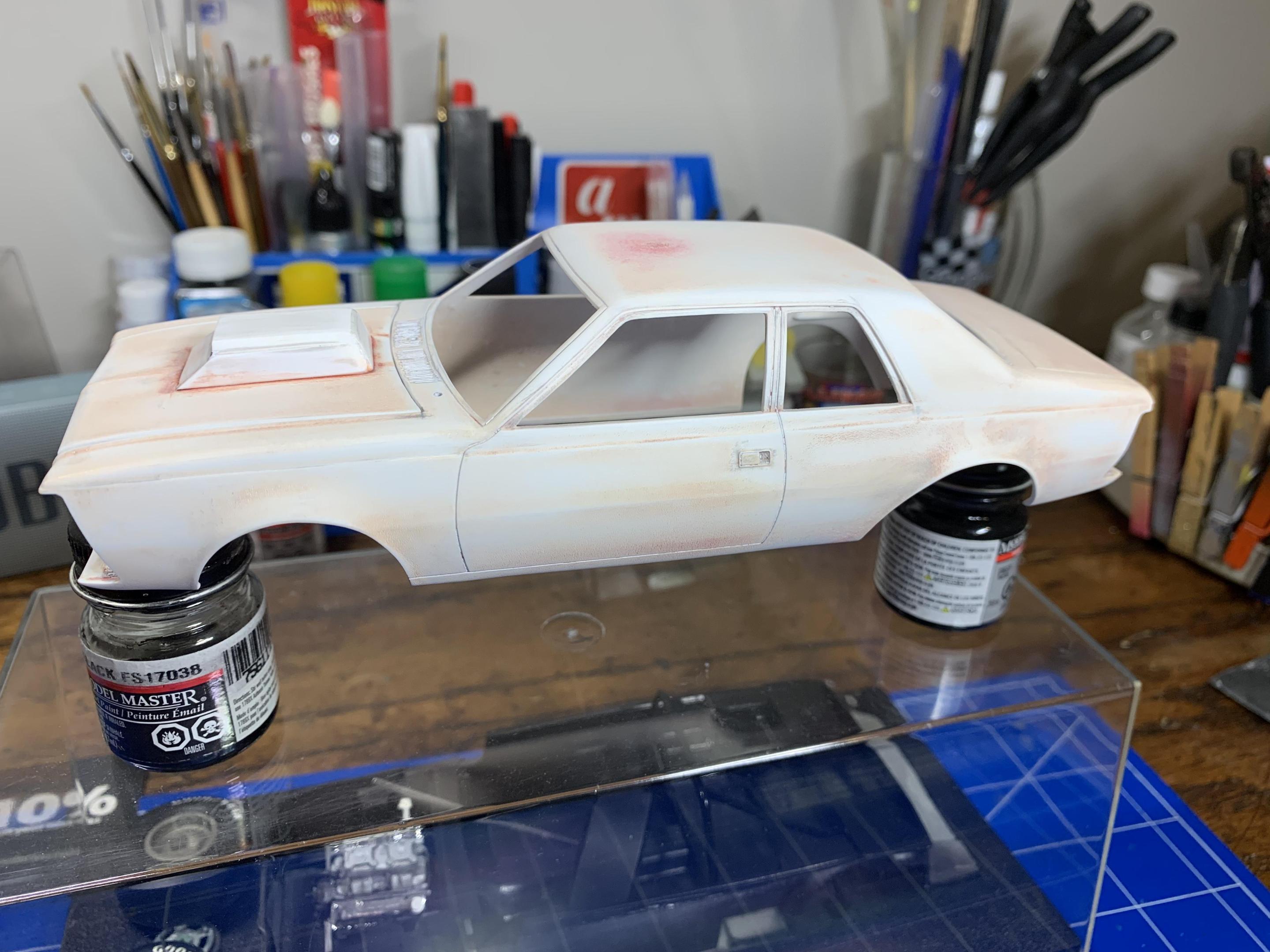

dragcarz Posted April 16, 2023 Author Posted April 16, 2023 The Tamiya paint crazed and bubbled. It’s back in the stripper.
Zippi Posted April 17, 2023 Posted April 17, 2023 On 4/15/2023 at 8:26 PM, dragcarz said: The Tamiya paint crazed and bubbled. It’s back in the stripper. That is strange. The body was prepped and washed and let dry right? What primer did you use?

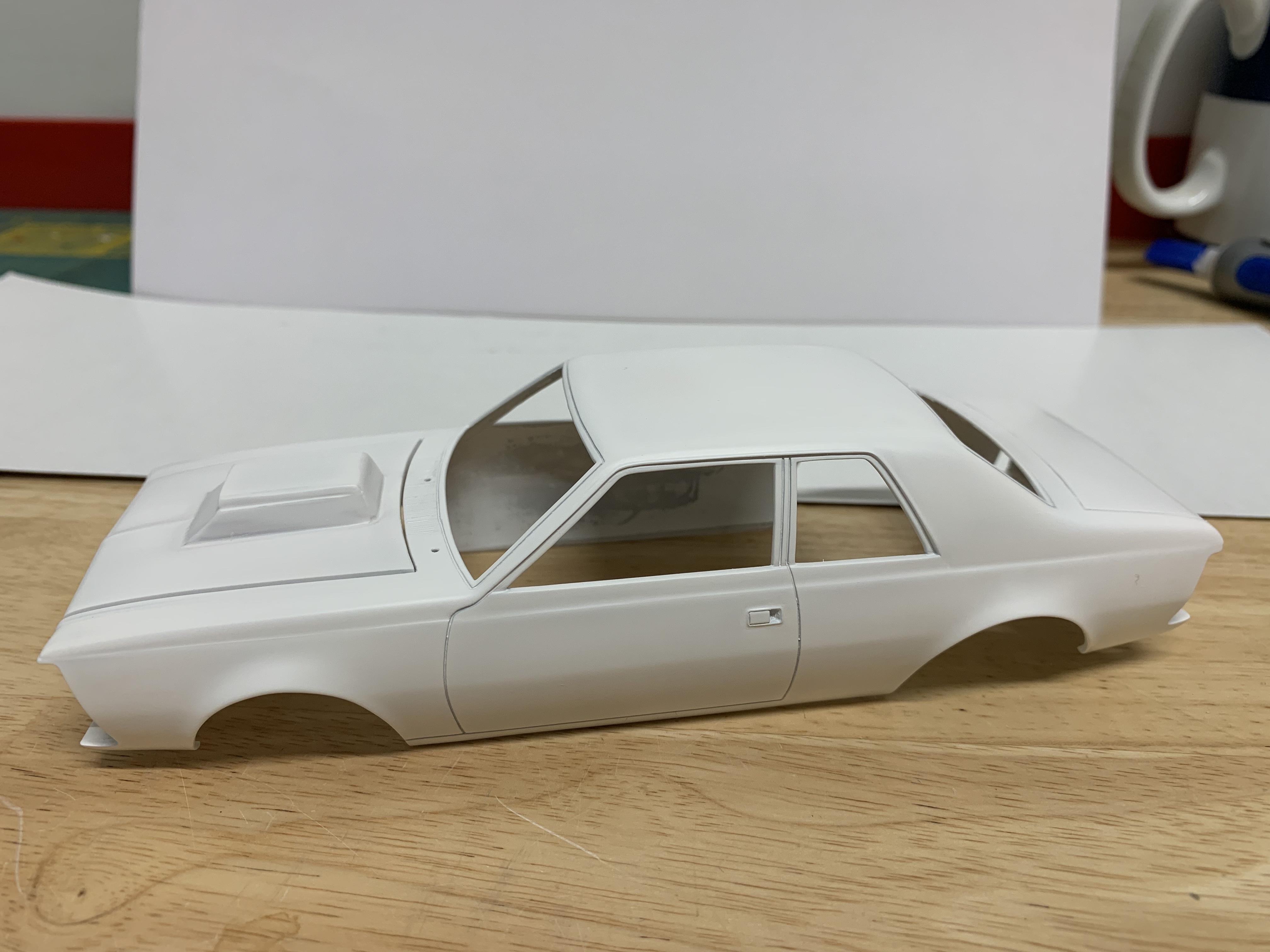

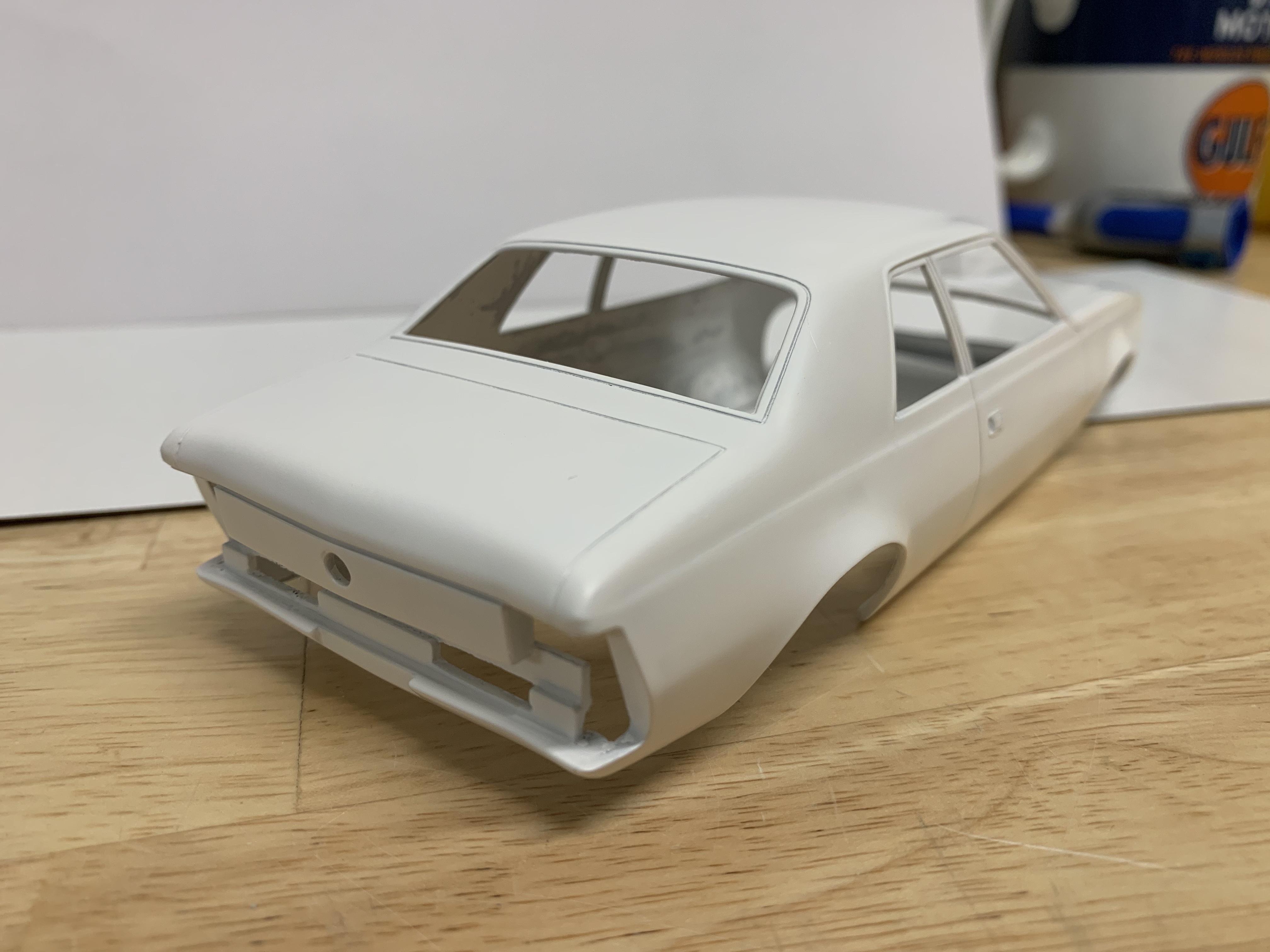

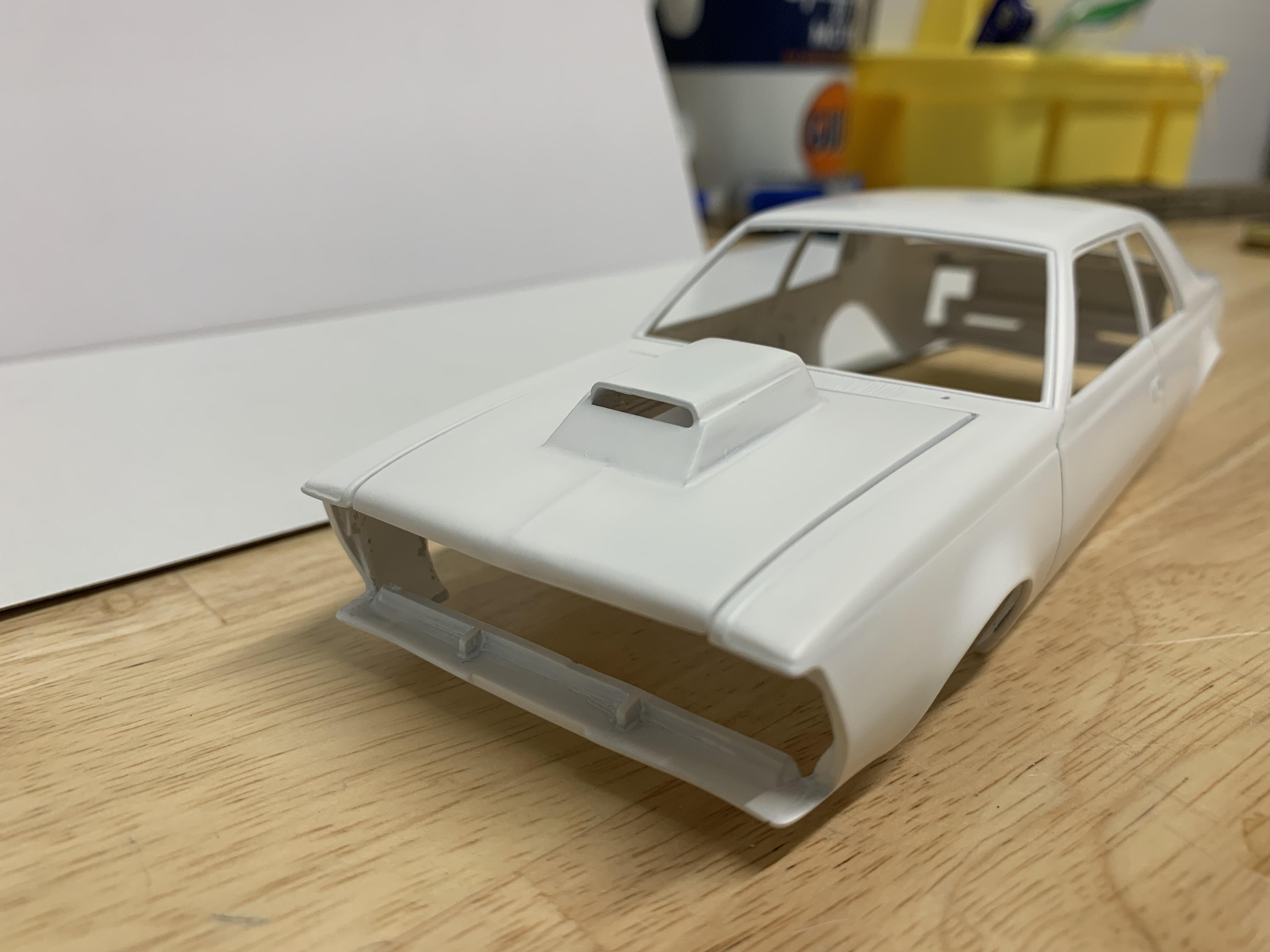

dragcarz Posted May 8, 2023 Author Posted May 8, 2023 I stripped the body, then sanded any and all primer off, repaired the body work and it’s back in Tamiya primer. I’m trying to get my courage up, and some lower humidity and warmer weather before my third attempt. 3
Straightliner59 Posted May 8, 2023 Posted May 8, 2023 What a lot of difficulty you're dealing with, with this thing. Your perseverance is admirable! Nice work, Roger.
David G. Posted May 13, 2023 Posted May 13, 2023 It looks smooth and clean and ready for paint. Best of luck on this go round. David G.

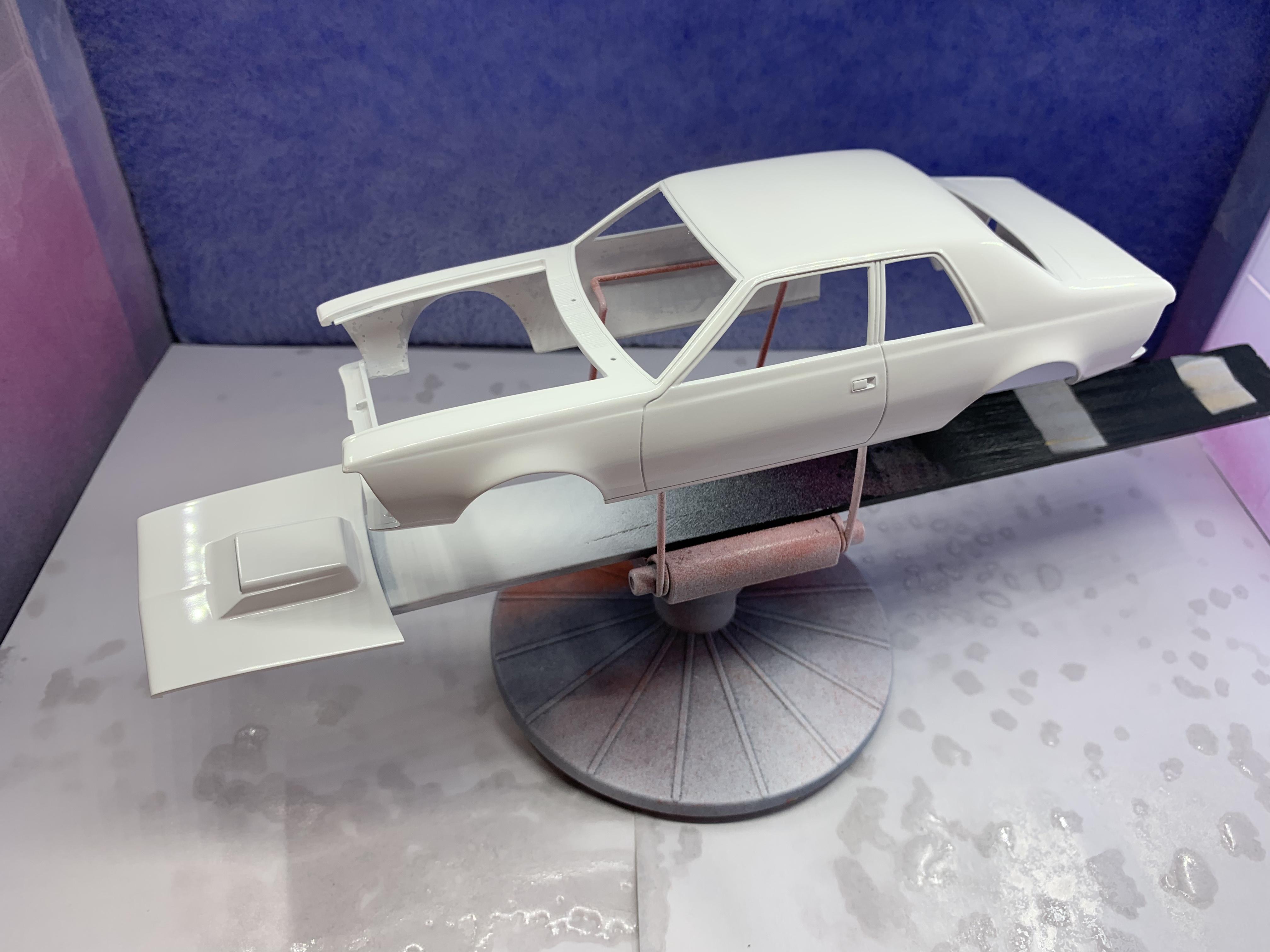

dragcarz Posted May 21, 2023 Author Posted May 21, 2023 Beautiful weather for painting 77 degrees, 39% Humidity, so I reshot the Hornet. A couple Fisheyes in the roof, but nothing that noticeable, especially after the large roof decal is applied. Im gonna wait for a while before I clear it and apply decals. 2
