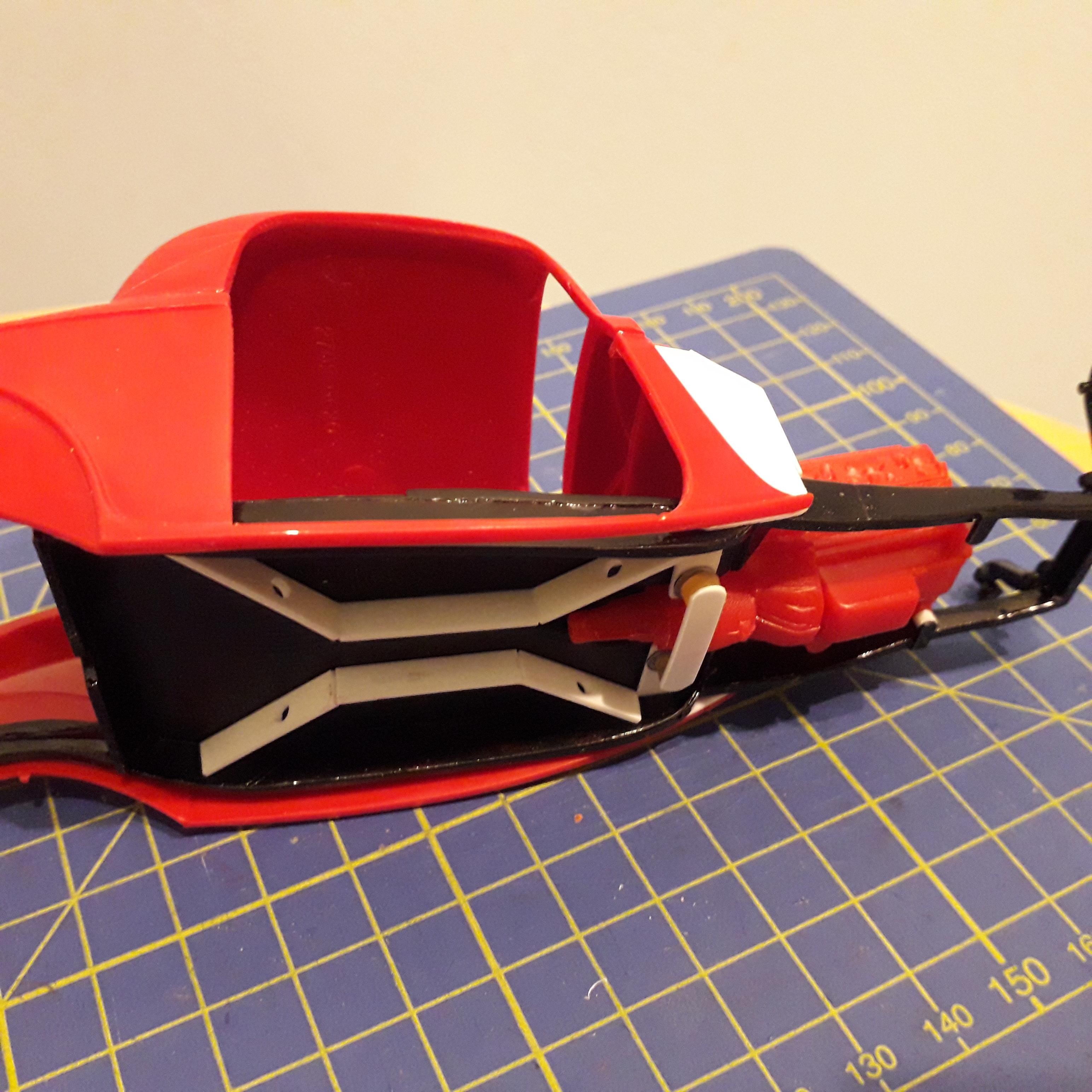

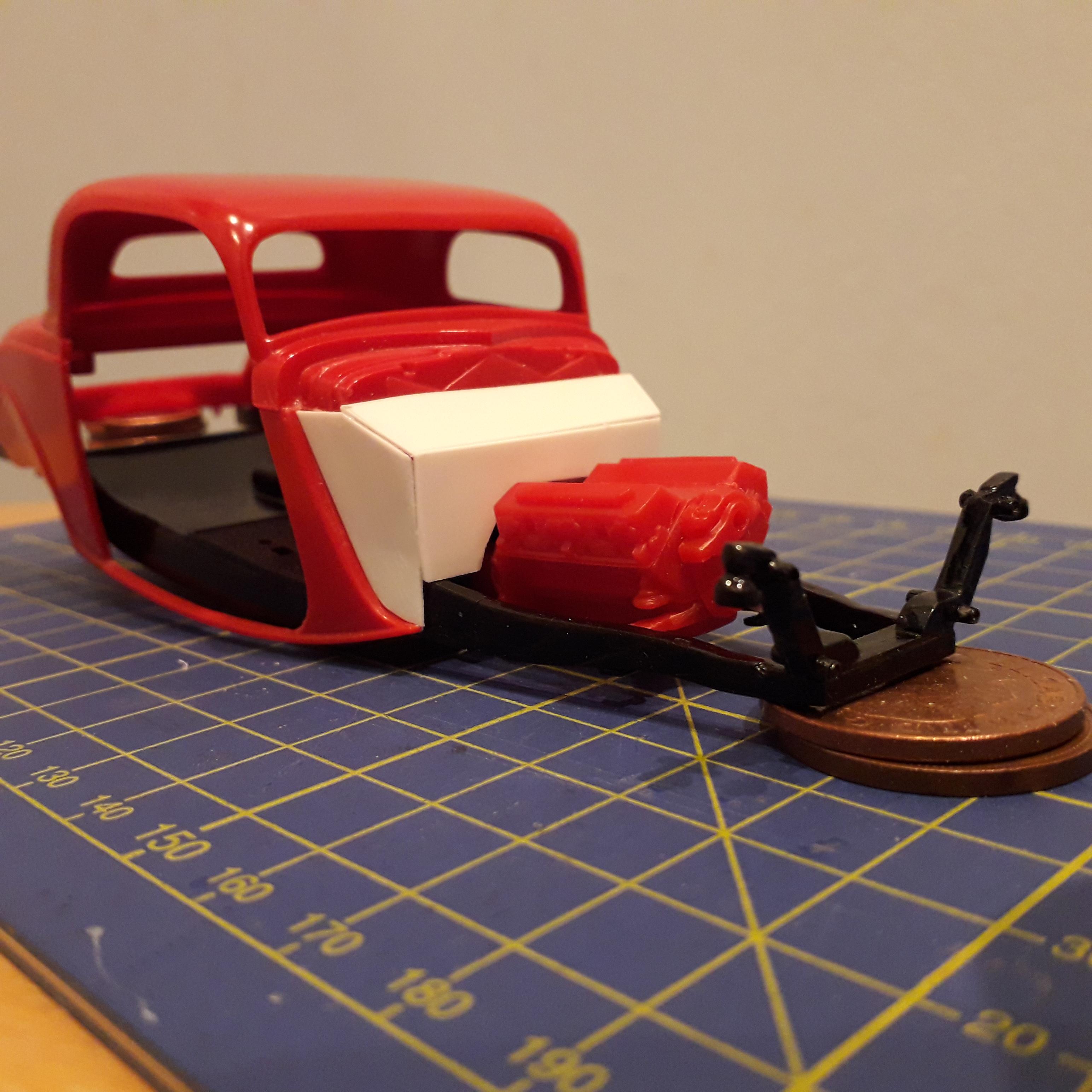

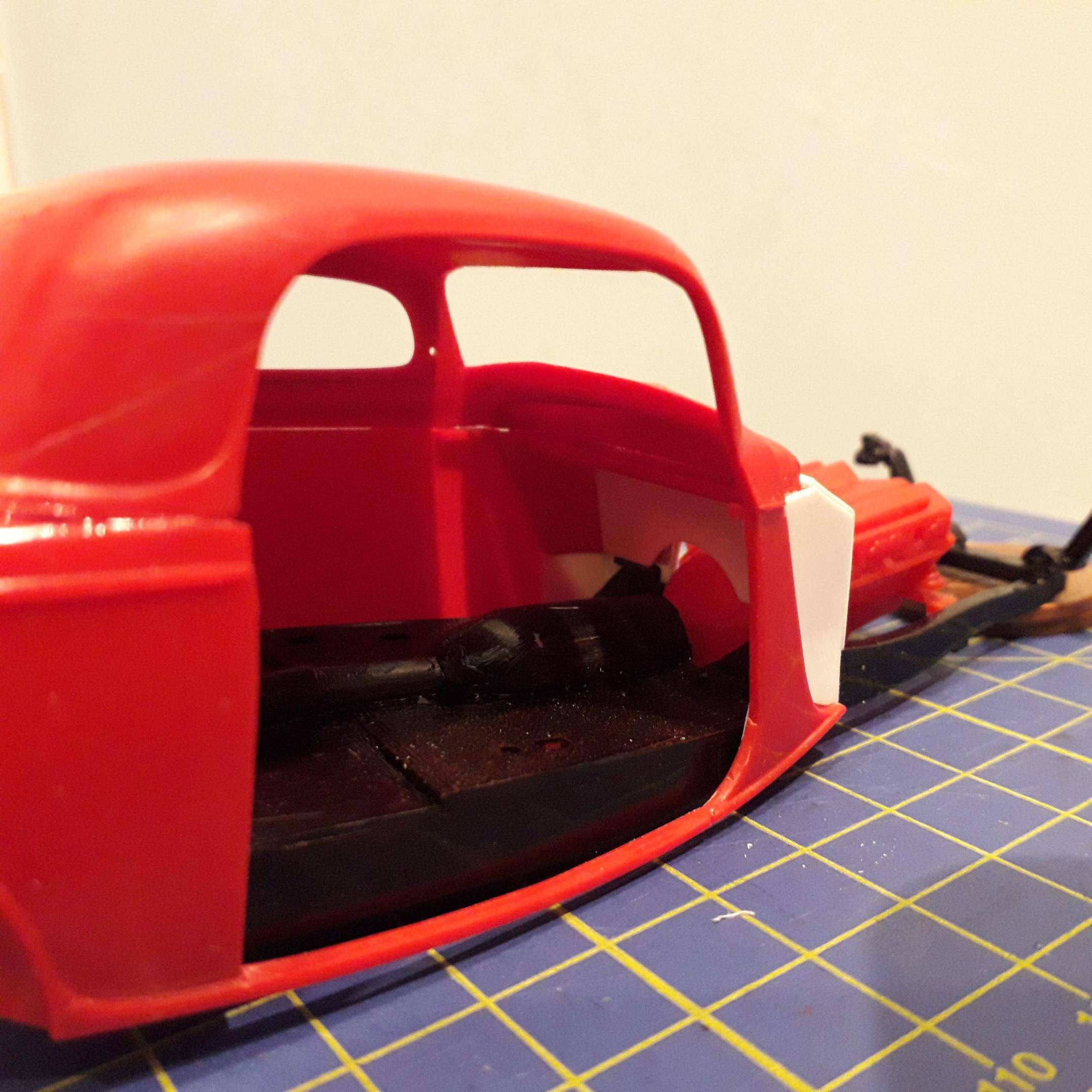

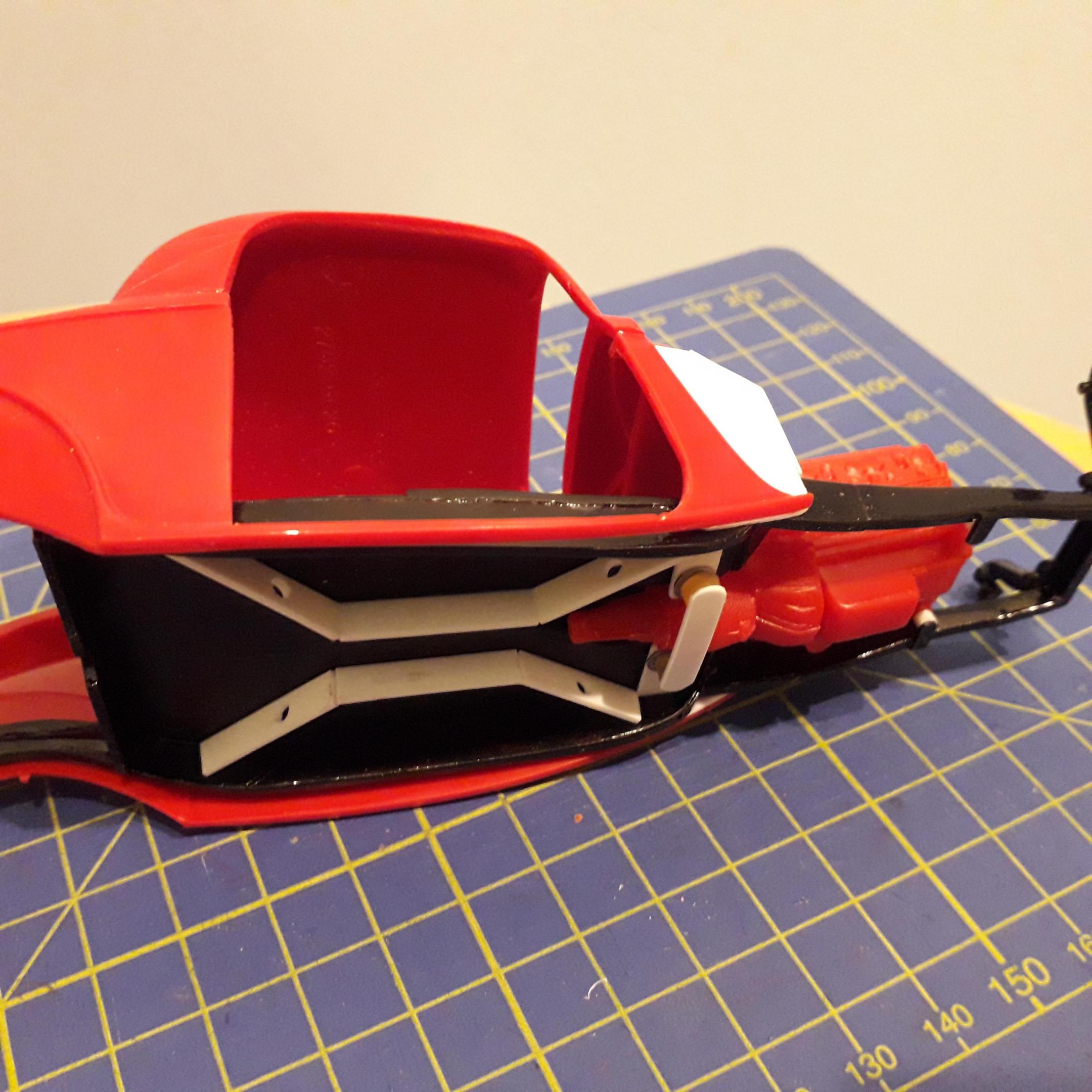

Lowlife ! ! Posted January 16, 2021 Author Posted January 16, 2021 Thanks for the input Gents ! Ive been concentrating getting the main parts together, before fussing over the details. Im using a new floor, new suspensions, new engine, new wheelbase and radically altered suspension height. So nothing fits ! I started by fitting the engine, replaced the now shortened front chassis rails in a new position, then new engine mounts. Inside a sharpie pen was cut up and used for the gearbox hump and a tube used for the prop cover. This will be carpeted next. New chassis rails, with a new gearbox mount, ( including holes for the exhaust to pass through ) Front crossmember was just too narrow so i had to split it and mount it on a new crossmember. Ive also rebuilt the firewall, again, to close the gap more around the gearbox. Needs a panel to finish off the gearbox / firewall area, but I can't find anything yet that I can use for this ? All painted black for now, i should have taken pics before the painting ! !
Claude Thibodeau Posted January 16, 2021 Posted January 16, 2021 Hi Martin! It moves forward, very well, bravo! For your floor "bell" to tie the sharpie hump to the firewall, you may want to give a try to either: nose drops squeezable plastic bottles have a styrene screw-on cap (most of the time). This happens to be just the right size to cover the transmission bellhousing/case most of the time. Slice and glue the required section, and voilà! Or, you could try to use a section of blister pack, like the type used to protect new lightbulbs. Many have rounded shapes that you could cross-section to adapt and bridge your current gap. Just my two cents... Hope it helps! CT
Lowlife ! ! Posted January 16, 2021 Author Posted January 16, 2021 Great Idea Claude, thank you for the suggestion, this part is next on the list to make !

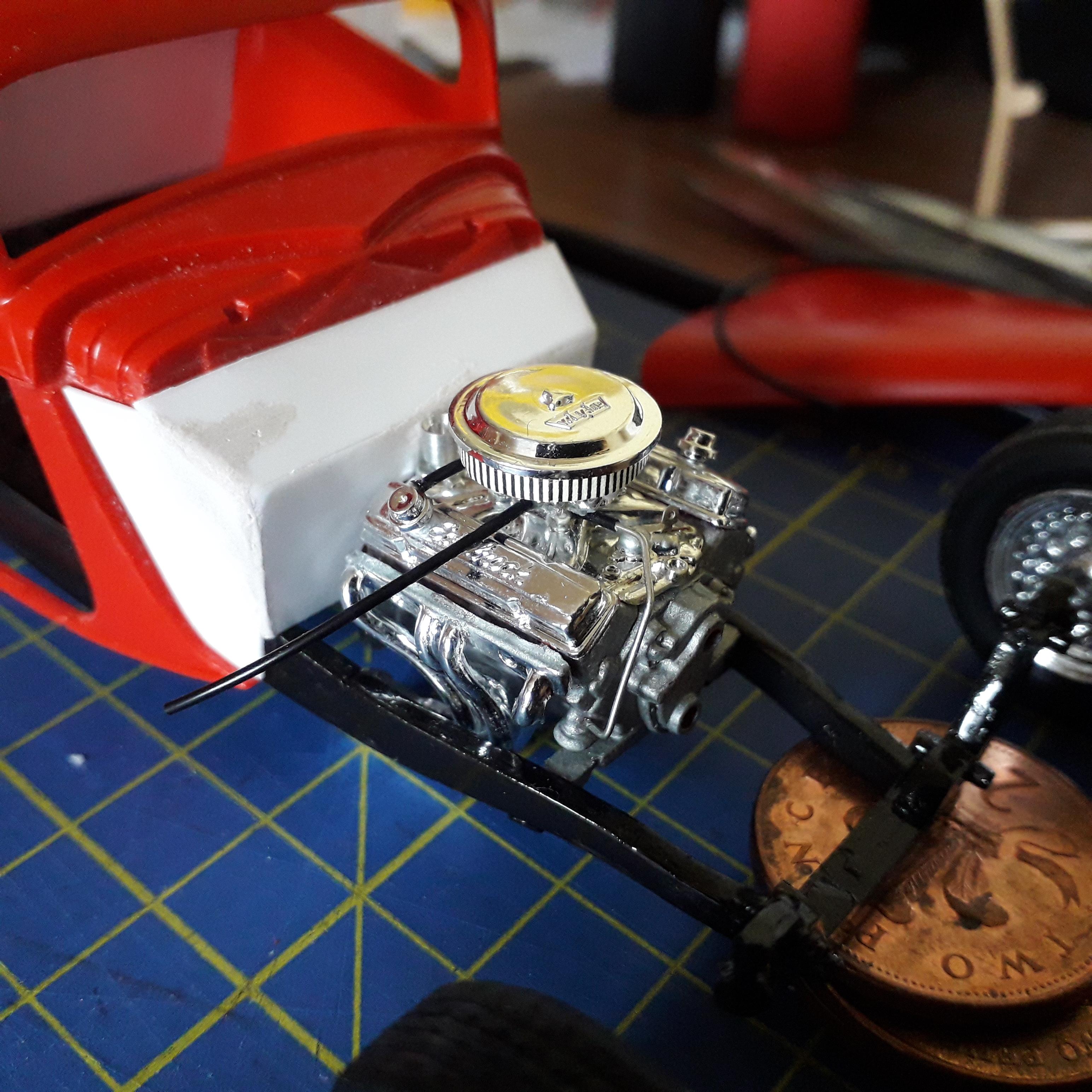

Lowlife ! ! Posted January 26, 2021 Author Posted January 26, 2021 Started throwing together a small block, nothing special just a simple crate engine ! Headers may have to change as they sit a bit low, and ive run out of wire for the metal distributor. Might try adding seperate pulleys and a fan belt too...

Claude Thibodeau Posted January 28, 2021 Posted January 28, 2021 Hi Martin! Great mill. Most of the 33/34 had a small cavity added in the firewall, to clear the distributor and avoid any rubbing... Yours is very tight! CT
beeRS Posted January 29, 2021 Posted January 29, 2021 Nice work on that small block Martin. It’s perfect for this kinda rod.
