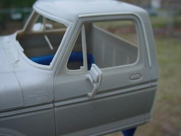

I drill and mount my mirrors onto lengths of straight pin. See test fit here. See passenger side pin inside body.  Only cut the pin when you are ready to permanently install. As others said, glue from inside.
As a bonus the long pin keeps small parts from getting lost and can be used as a mount point when painting the part.
I found it’s only necessary to drill one post. Here are mirrors with pin cut, ready to mount.

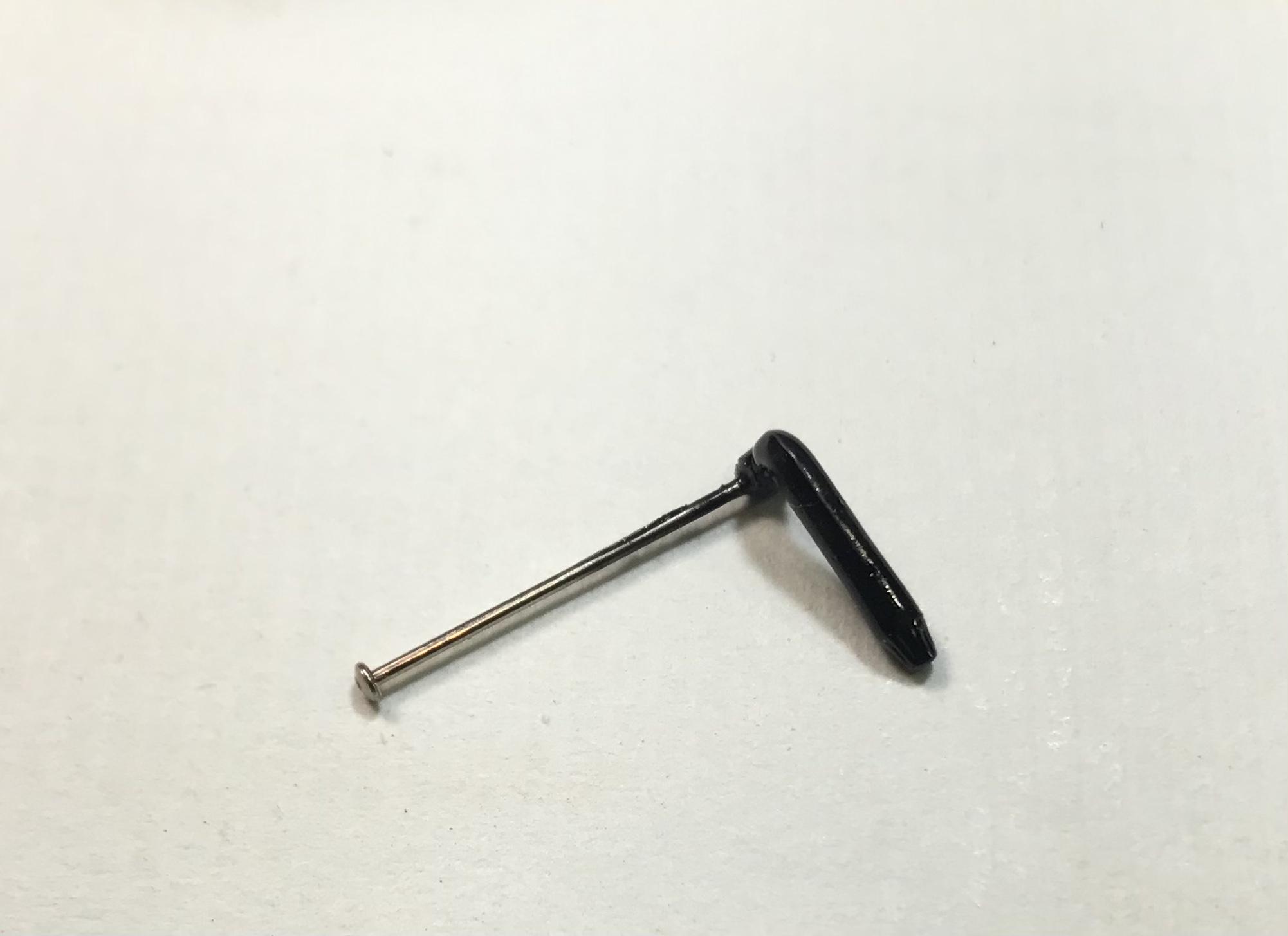

Here’s a hose I pinned tonight. Note it was spray painted on the pin. Once satisfied, the pin was cut to necessary length and right now it’s on my Jeepster.

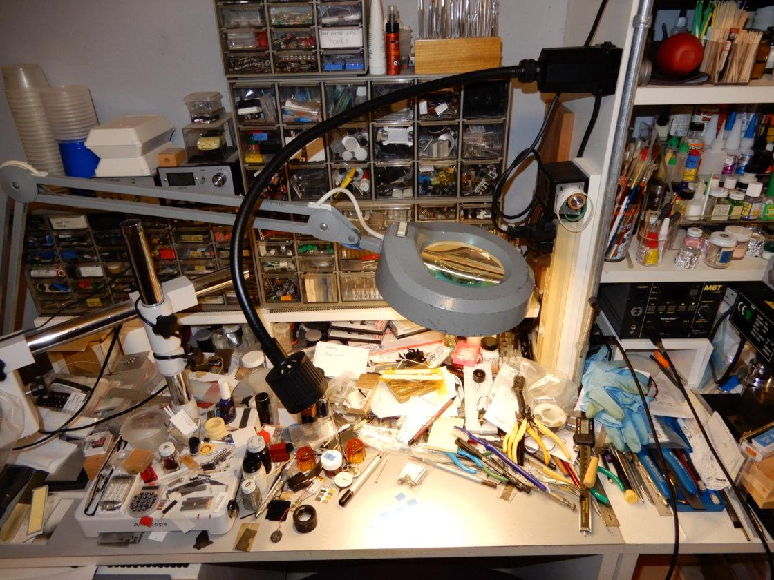

My caliper almost never leaves the top of my workbench! If I can find it there that is.:DPeteskiWorkbench.JPG.5a77392b0b31ac978940fa5e616f0171.JPG
Actually, it is there, visible!

OK Tom, if this is the game where you have to find the item, I give up, where is it???
16 minutes ago, TransAmMike said:
OOPS!!!! I see it?
Don't feel bad - my workbench often gets out of control. I work on too many projects at a time, leaving me about 1 foot square of working surface. :)
But I'm Peteski, not Tom.  Dont' accuse him of having a messy workbench!  ;)
That wasn’t me, it was Pete!
I have maybe another ten square inches of visible bench space! ?
