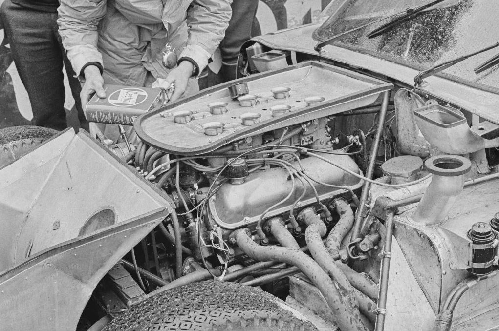

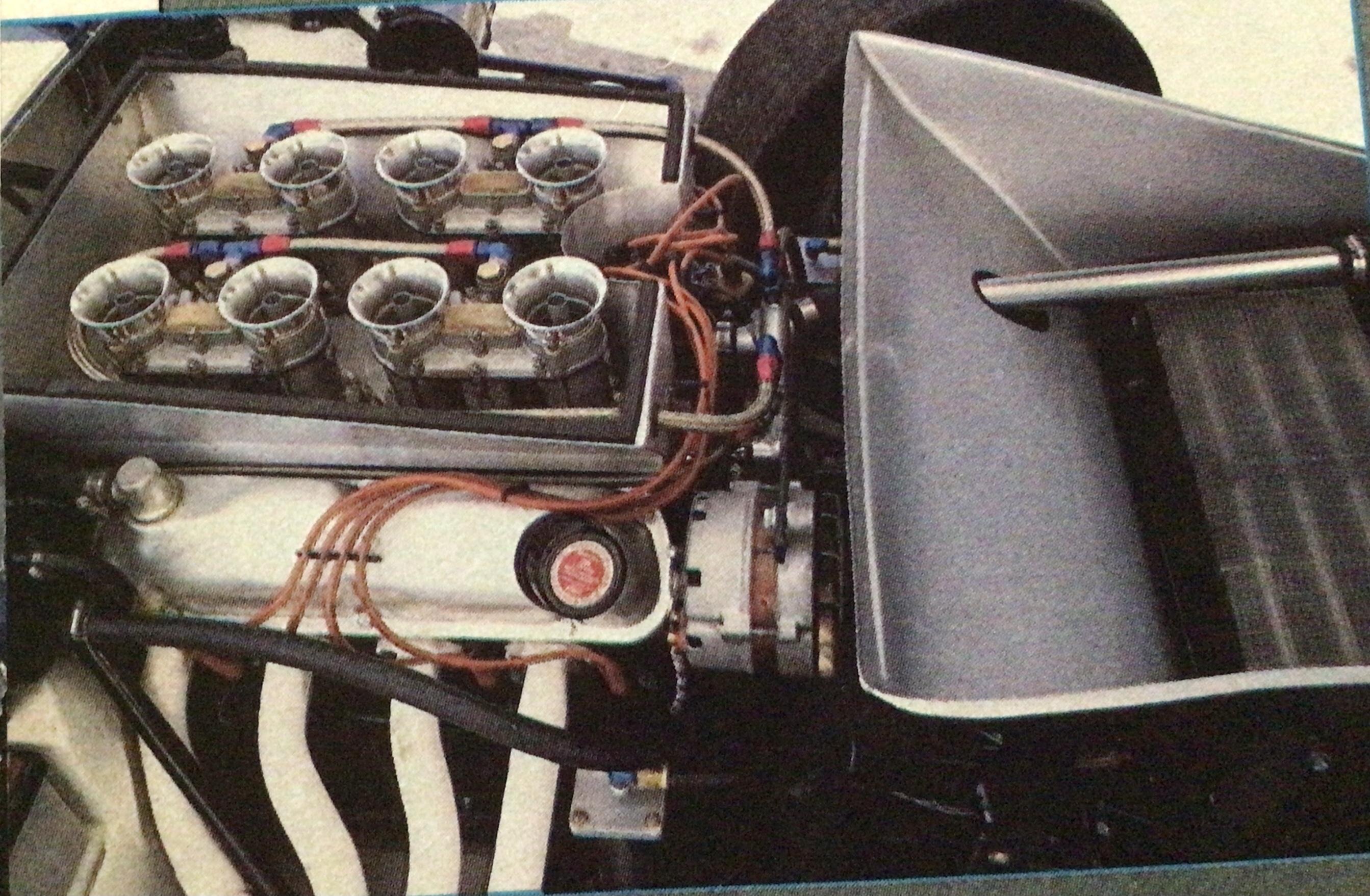

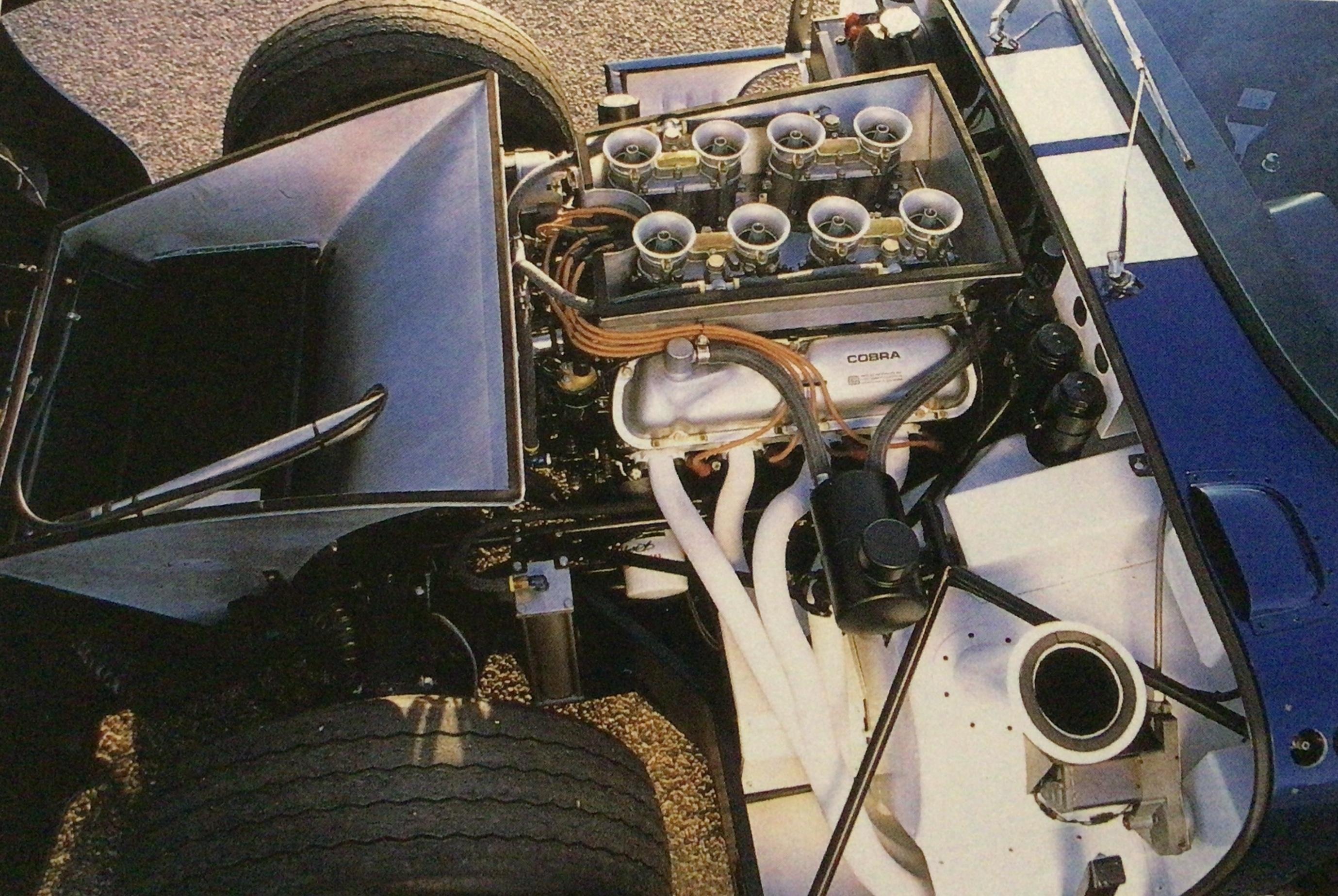

Thanks Paul! I’ve noticed that the earliest versions of the original ones are always lacking a heat shield/ (cold air box)  around the carbs, but at some point it appears that all of them wind up having it installed... apparently to protect from vapor lock? I am currently trying to scratch build my own heat shield/ (cold air box) which is proving to be quite challenging. The model doesn’t come with one, nor does it give any hints of how to construct your own.

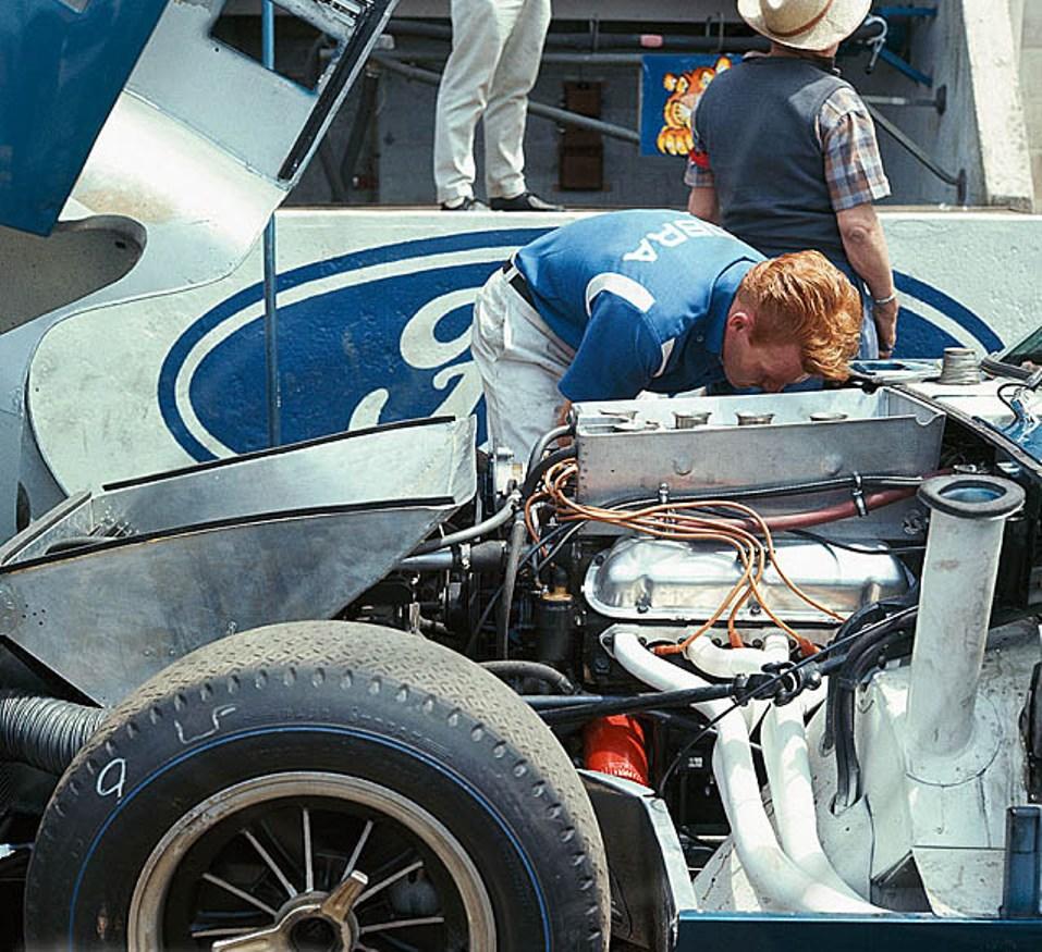

Nice work on the cold air box Josh.  I've built a few of HRM's FIA engines, they are a nice bit of kit. This one I installed in a FIA roadster.
DSCN4452
Thanks JC! ... Ive seen that FIA Cobra of yours before- Beautiful, clean build! Thanks for posting the pic... It’s such a clean pic, I’ll use it for reference?

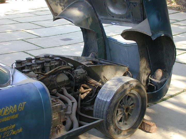

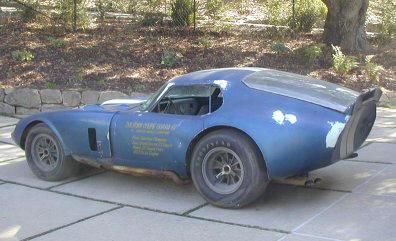

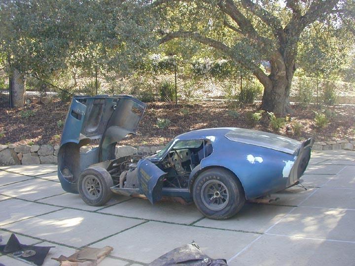

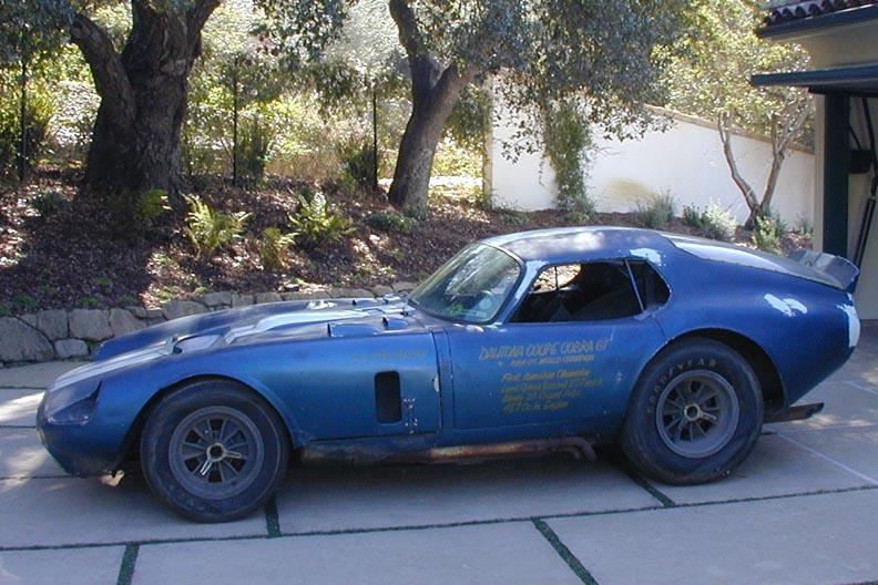

On 1/20/2021 at 8:21 PM, Paul Payne said:
Thought I would share a few pictures of a real one I found on line.
ok, i   almost  never tell this story  because it's  like seeing a  UFO.      In   1991  i'm  riding  my  mountain  bike  in a residential  area   San  Carlos  California.   Parked in front of someones house  is a truck  and trailer with  this car  in this condition  .   i  know   .....the odds  of seeing a UFO  are much higher  and does not jive with story of this car hidden away somewhere in Los  Angeles   since  the 60's.   but there was no  mistaking  this car  and why would you make a  replica  of a  thrashed race car.
