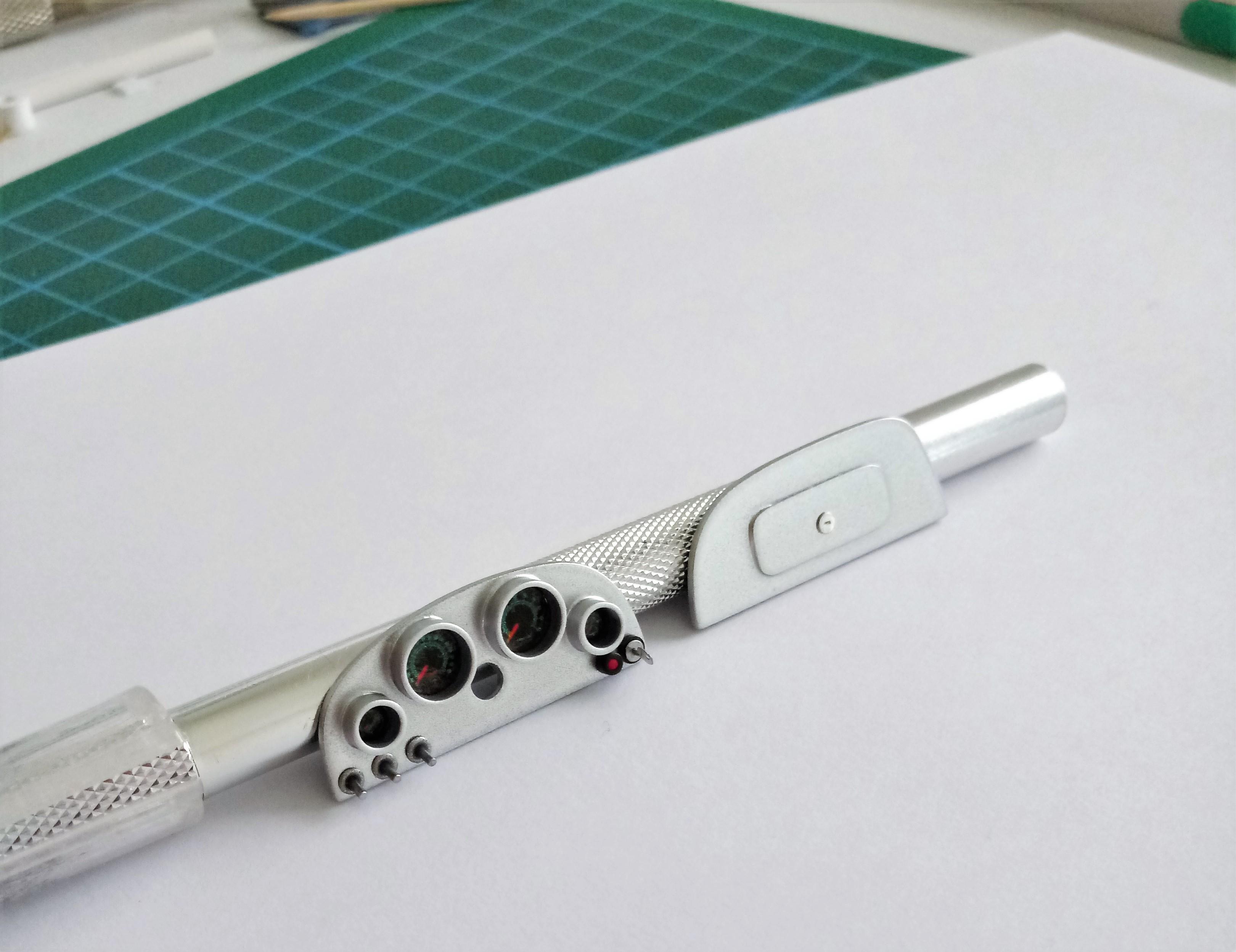

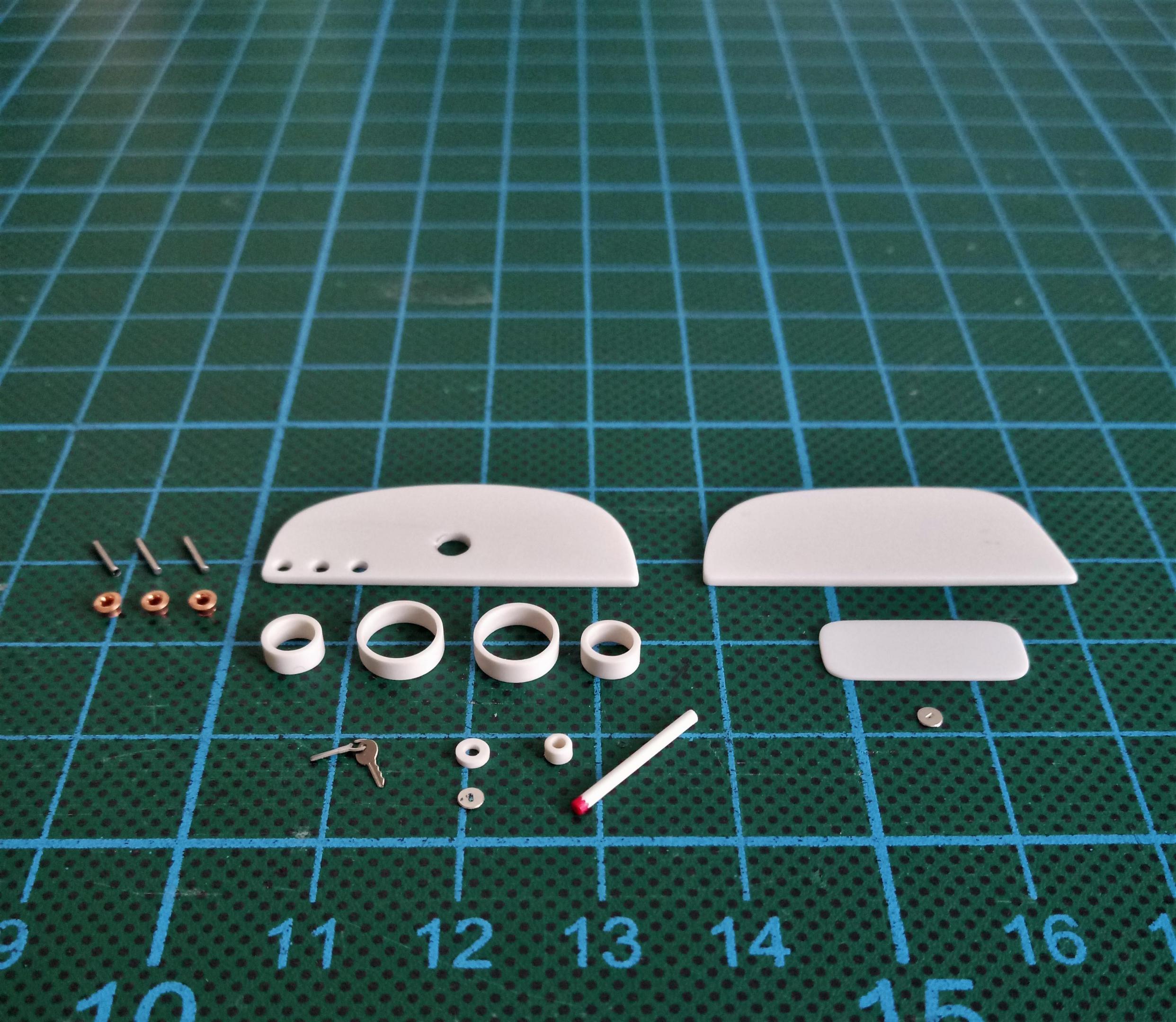

If you have been on Tim Boyd's Hydro Vee thread in the kit review section, you will know that I too really enjoy building model speedboats but wow, you are taking this to the next level!  The sharpness of your paint masking and decal cutting is superb - I simply can't get over how flawless it is.  And your scratchbuilt parts, they to are beautiful.  May I ask, what do you use to cut the instrument rings so cleanly and perfectly parallel?  When i attempt that I tend to get a crooked surface that takes a lot of trimming to get right.
I am very much looking forward to seeing this one finished.
Cheers
Alan
Hi Alan. Thanks a lot for you comments. To cut the instrument rings cleanly I use a simple technique:
The first thing I do is take a pipe with the desired diameters.
Then I cut a piece off by rolling the blade over the pipe until it breaks.
The broken piece is for the garbage can.
Now I take the pipe and carefully sanding down the cut surface until it is smooth and even with different types of sanding sticks from the drugstore (from rough until very smooth).
Then I cut another piece off by rolling the blade over the pipe. This time, however, in the approximate width that the rings should have.
Now you have rings with a clean edge on one side and an unclean edge on the other.
Now I put a strip of double-sided tape on a small sheet of plastic and put the rings very next to each other on the tape with the unclean edge up.
Then I use the mentioned sanding sticks from a drugstore and sand the rings down until I have reached the desired height.
By laying the rings next to each other they will get the same height while sanding.
As a last step, I sand single ring on the edges and inside with 3000 sandpaper to get a clean surface.
I hope that was explained in an understandable way. If not, just write to me again. Making the rings is a very simple and quick process.
