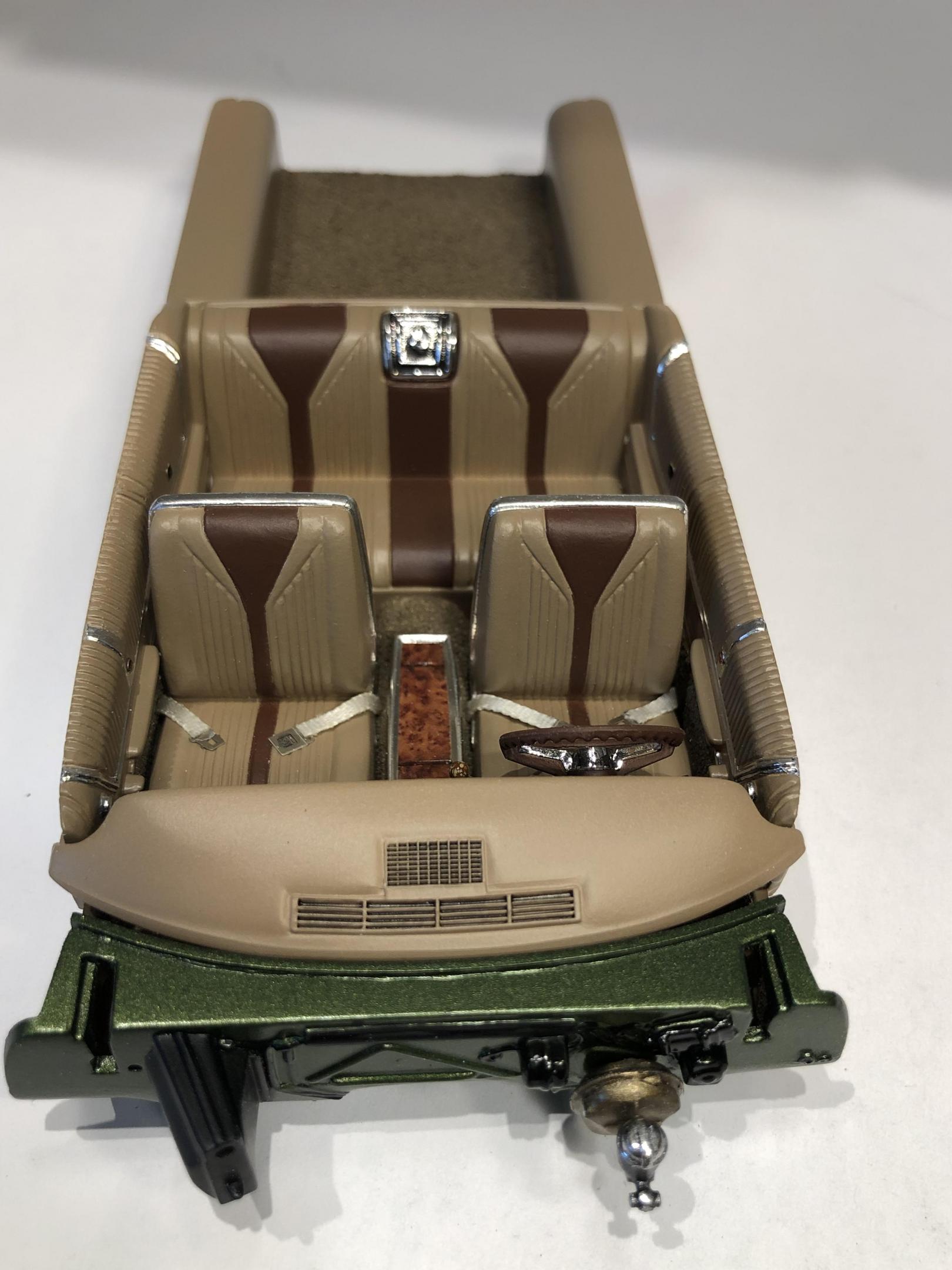

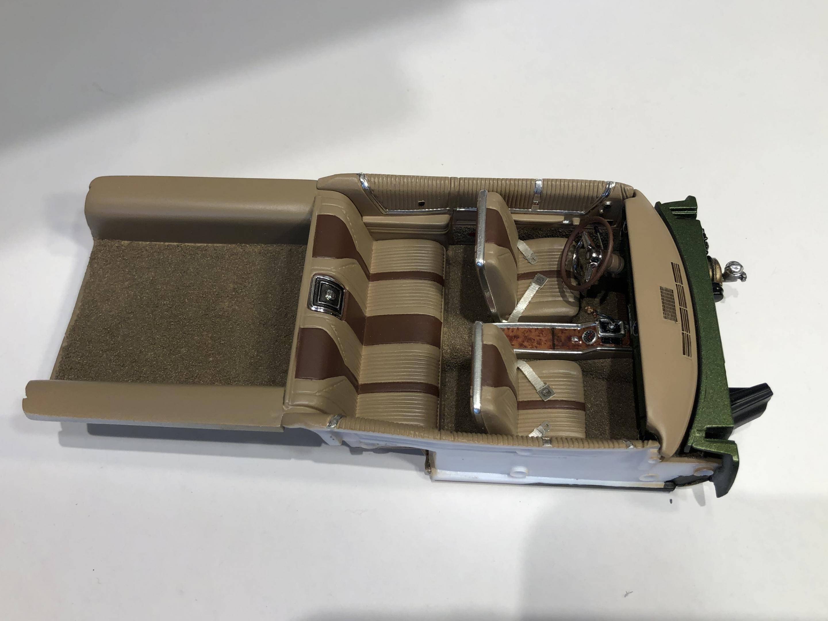

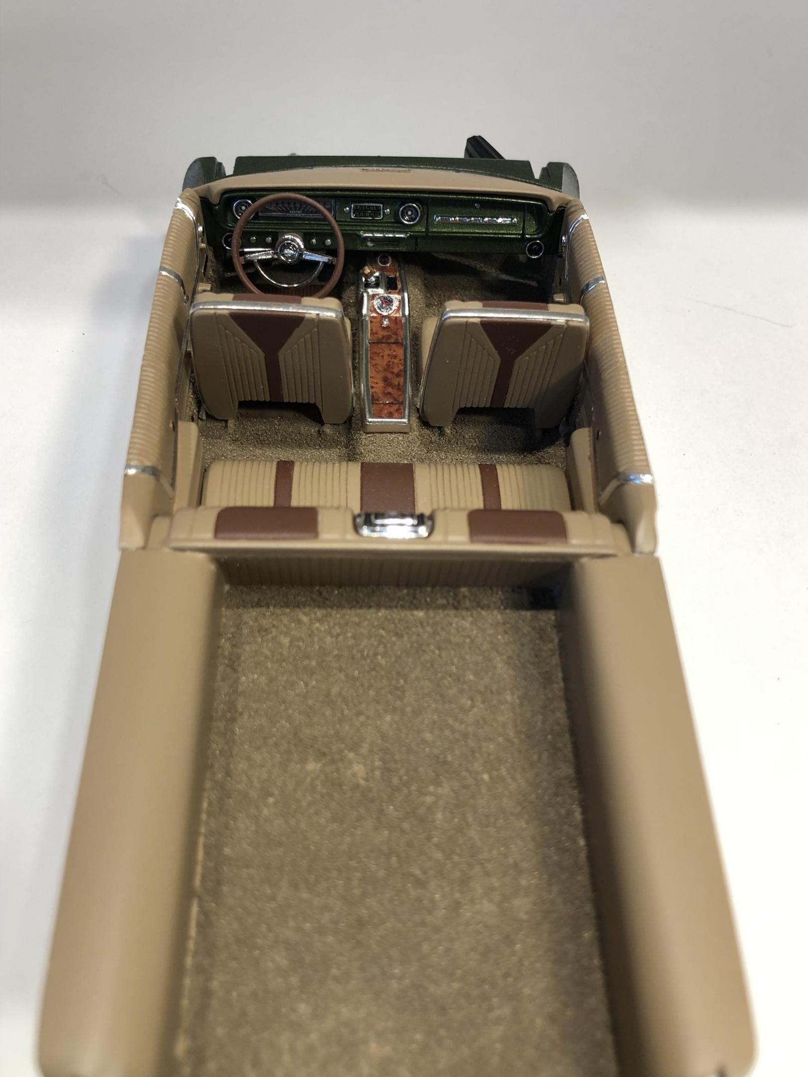

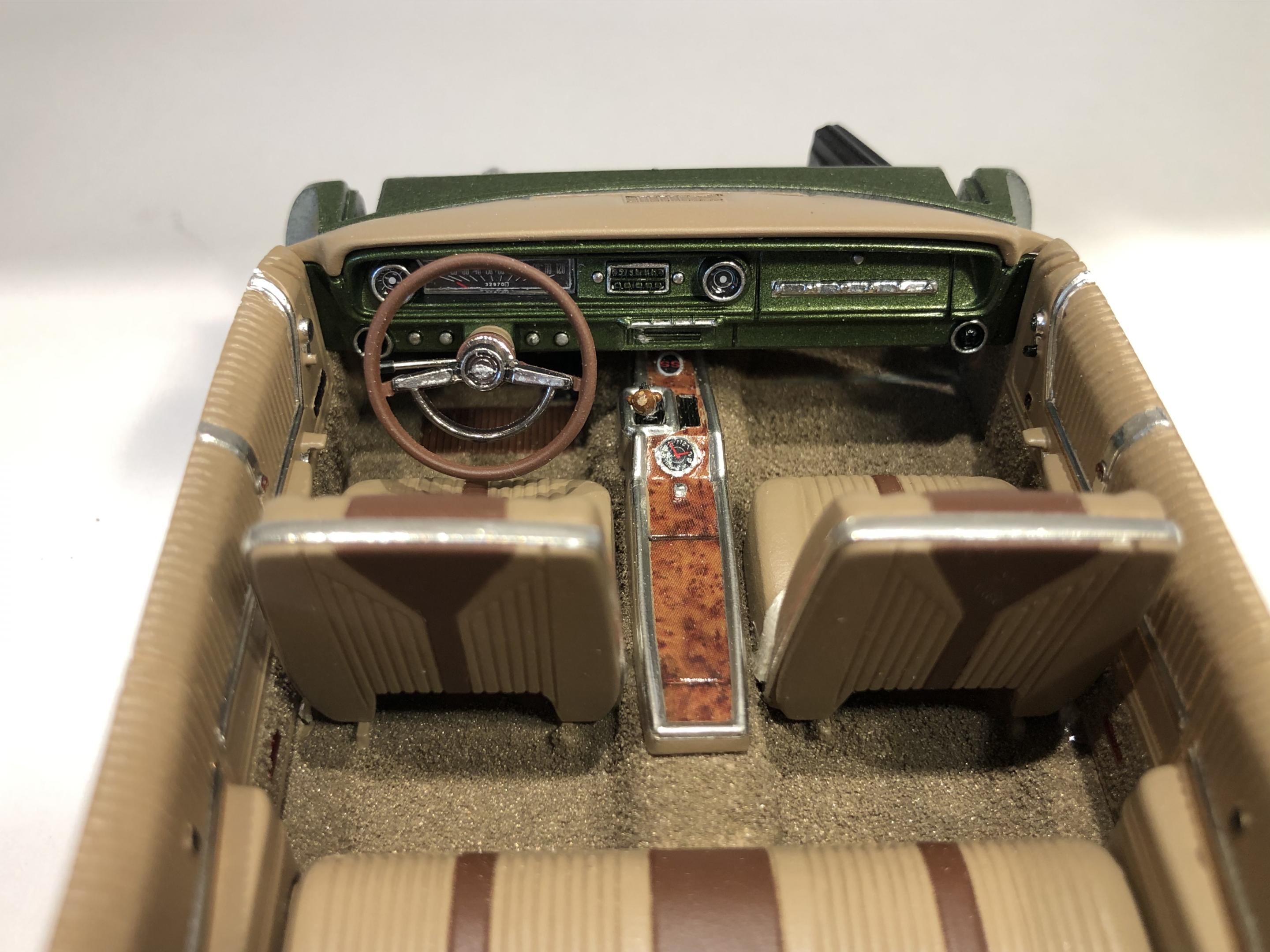

Interior is now complete. I’m actually quite happy with how this turned out. The interior will likely be the best part of this build, more on that later….. I was trying to replicate a wood shifter knob to match the console, didn’t turn out as good as I hoped but not terrible either.
I may still add rear seat belts.

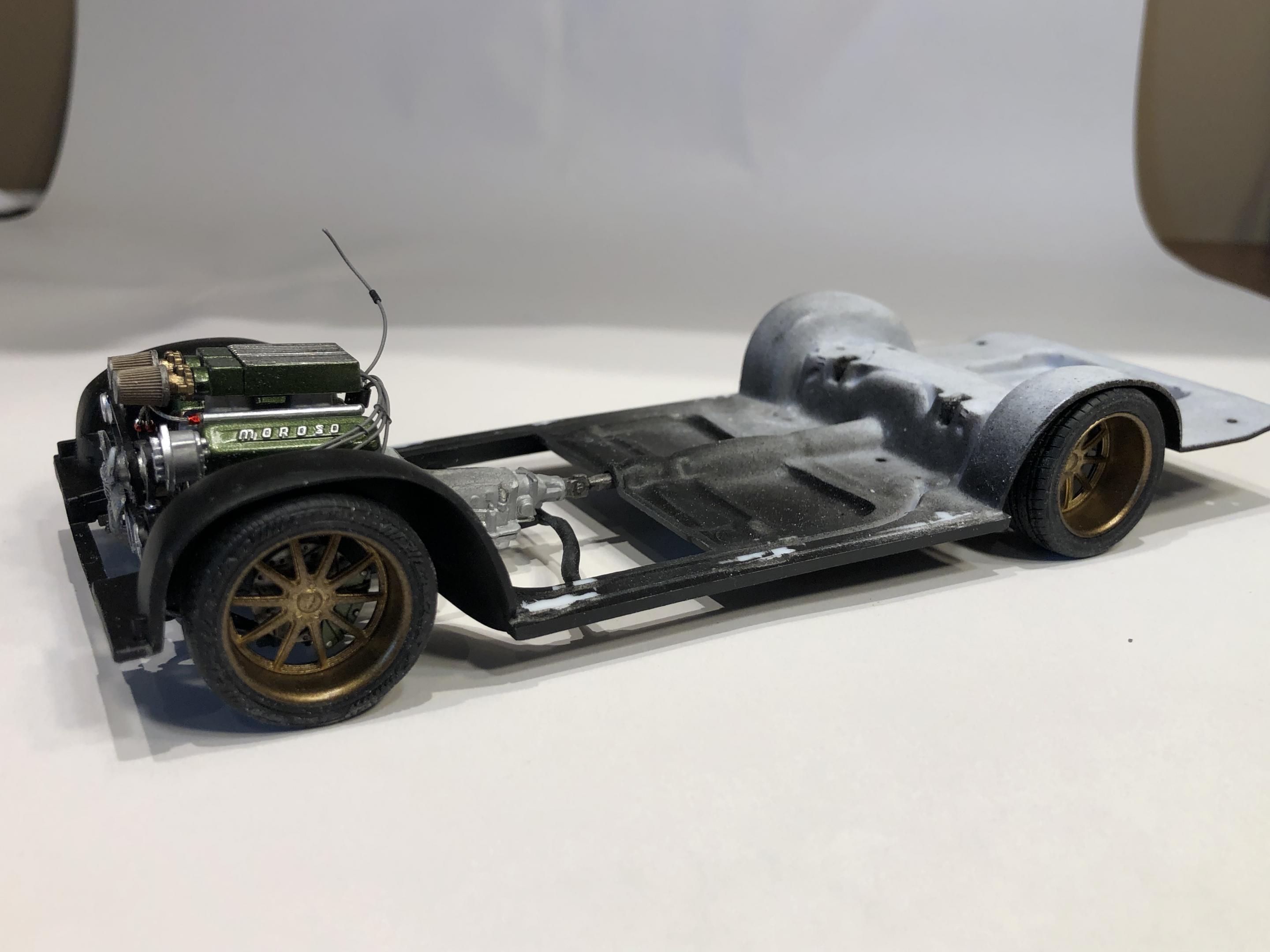

Chassis is pretty close to finished too. Engine and wheels are now permanently attached.

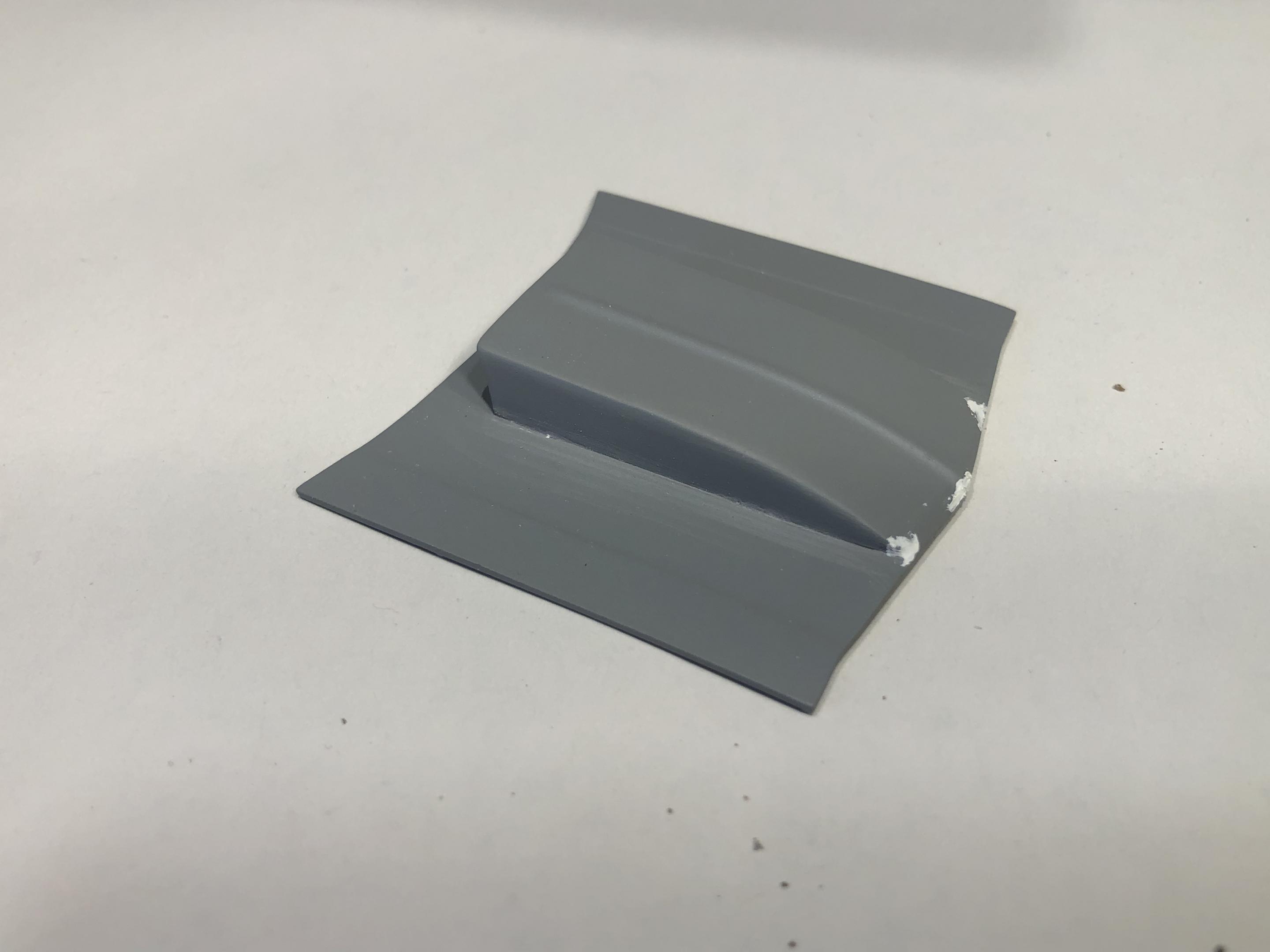

The scoop is attached to hood and just needs a little finesse to be complete. Bigger than I intended, but it will add to the wagons attitude.

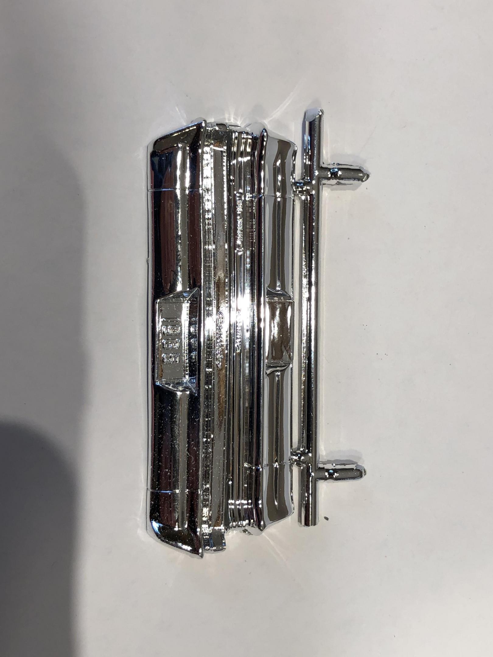

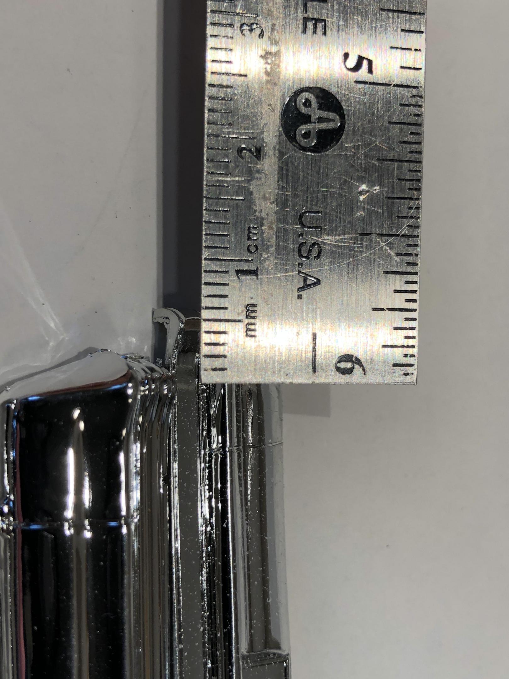

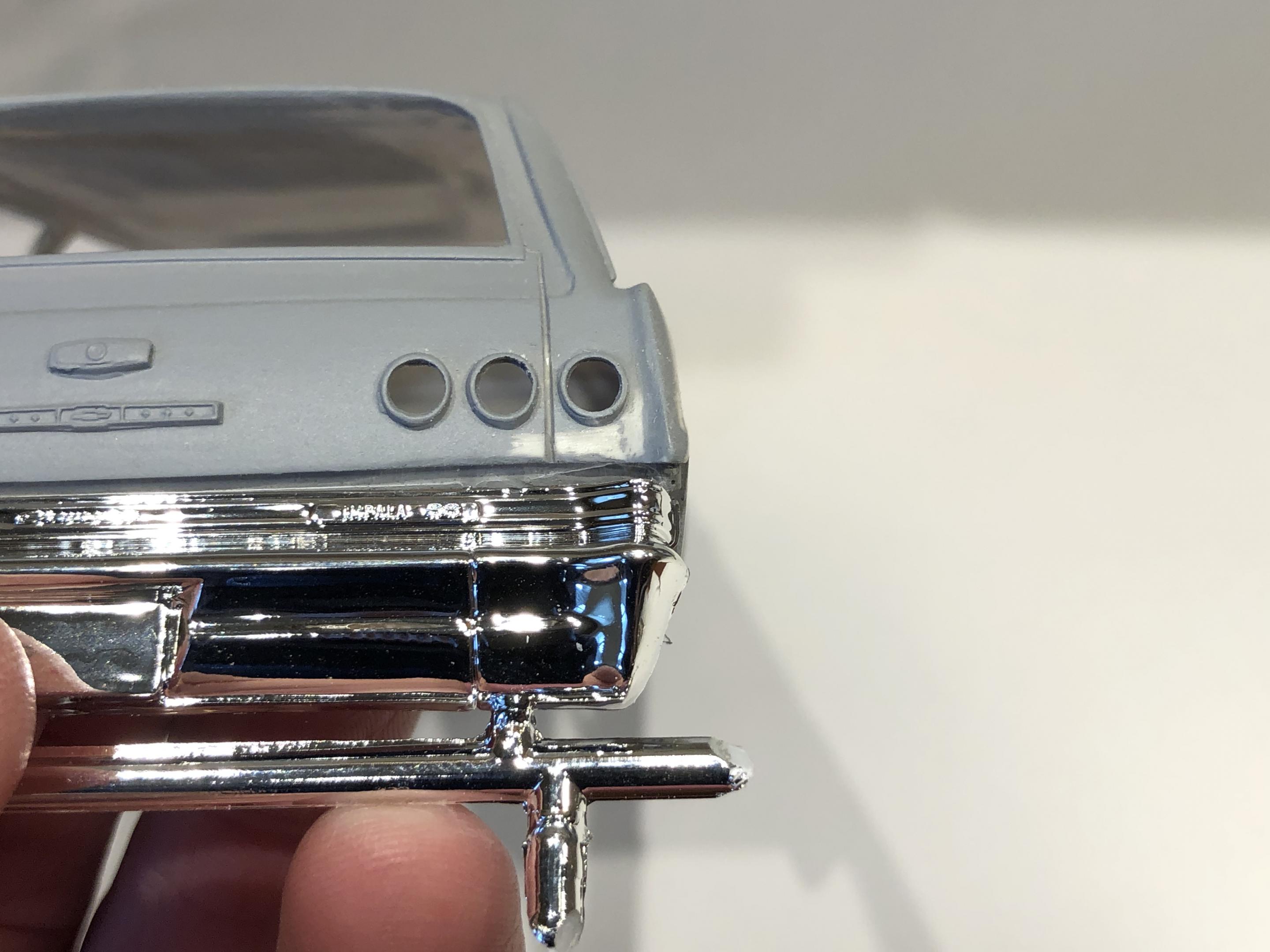

Here’s the latest. The kit supplied rear bumper is about 3 1/2 scale inches too wide, the Foote kit bumper is about 2 scale inches too narrow!!!
Side by side you can see the difference. Wayyyyy more than just a 1:24 or 1:25 scale difference. The really odd thing is that the front grill and bumper from the Foose kit fit like a glove. Thank god, or the project might be back in the box! I haven’t decided on a fix yet, but it might be cutting the long one to suit and painting it. If anyone has ideas, bring em on. Here’s how they line up on the body.
It was laugh or cry…I laughed.
I also spent some time on body clean up and fitting the glass, no surprises there yet.
That’s where I’m at now. Next step will be figure out the bumper issue, then final body prep.

Isn’t that a Modelhaus kit? Didn’t it come with a rear bumper?
Yes sir! That wide one came with the body. My first 2 Modelhaus kits were really well done, this one is a bit “off”.

I went digging and pulled out mine. I had never even unwrapped it when I bought it. Darn! My rear bumper looks just like yours.. too wide! The pity is that is so nicely chromed!
I will bet that it’s the same fit on the original annual.  The only way I can figure to fix it would be to separate it into three pieces, right at the seams of the end caps. Remove a bit of material from either end of the center piece.

I know! The Chrome is well done, it’s a real bummer. Curious if your body has a twist in it? When I place mine on a flat surface, it has about 2 scale inches of twist diagonally front to back. Just curious. I think you have the right idea for the fix, removing from the middle won’t work with the license plate recess.

Magnificient interior, bravo!
To your bumper problem... I'm thinkink aloud here, but... Could you do a mashup of the narrower bumper's upper section (it might match the rear panel width...) with the wider bumper lower section) ? I bet the seam would be barely noticeable, if you take a sharp Tamya panel scriber blade. And the two bumpers must have mostly the same profiles, only in different "scales".
Then again, I'm judging just from your pictures, but you be the judge. This way, you would still enjoy the OEM chrome on both parts, and you could even move the lower section further forward, making for a cleaner contemporary look.

The whole thing is beyond great but that interior, looks like a real car!!!  Great job!
Hello Brian, Thank you very much sir!
16 hours ago, oldnslow said:
Fantastic work , Steve , need some belts for the rear passengers though . ?
Hi Robert, well, I told myself “if no one calls me out about the rear seat belts, I’ll leave well enough alone”. Darn you! I guess I’m adding seat belts! Oh, and thanks for the compliment too.

You’re close, very close. With your words of wisdom and experience in mind, I sat at the desk and in a matter of a minute or two I have the fix…I think. My first mistake was trying to figure out a fix with one bumper. So it turns out that the narrow (Foose) bumper is very close to the correct width, but the panel above is too narrow. So… I will separate the upper panel from both bumpers, shorten the Modelhaus one and reattach. For me, I think it will be easier to shorten one then add, I might re-evaluate that once pieces are separated and add to the Foose piece. The bonus here is that I was considering doing that panel either body colour or perhaps in carbon fibre, so that will be easy now!
Man, I love this forum.
Claude, thanks for having me look at the problem in a different light. The solution was staring me in the face! Many thanks, and as always thank you for following along. Your 2 cents are worth a lot!!

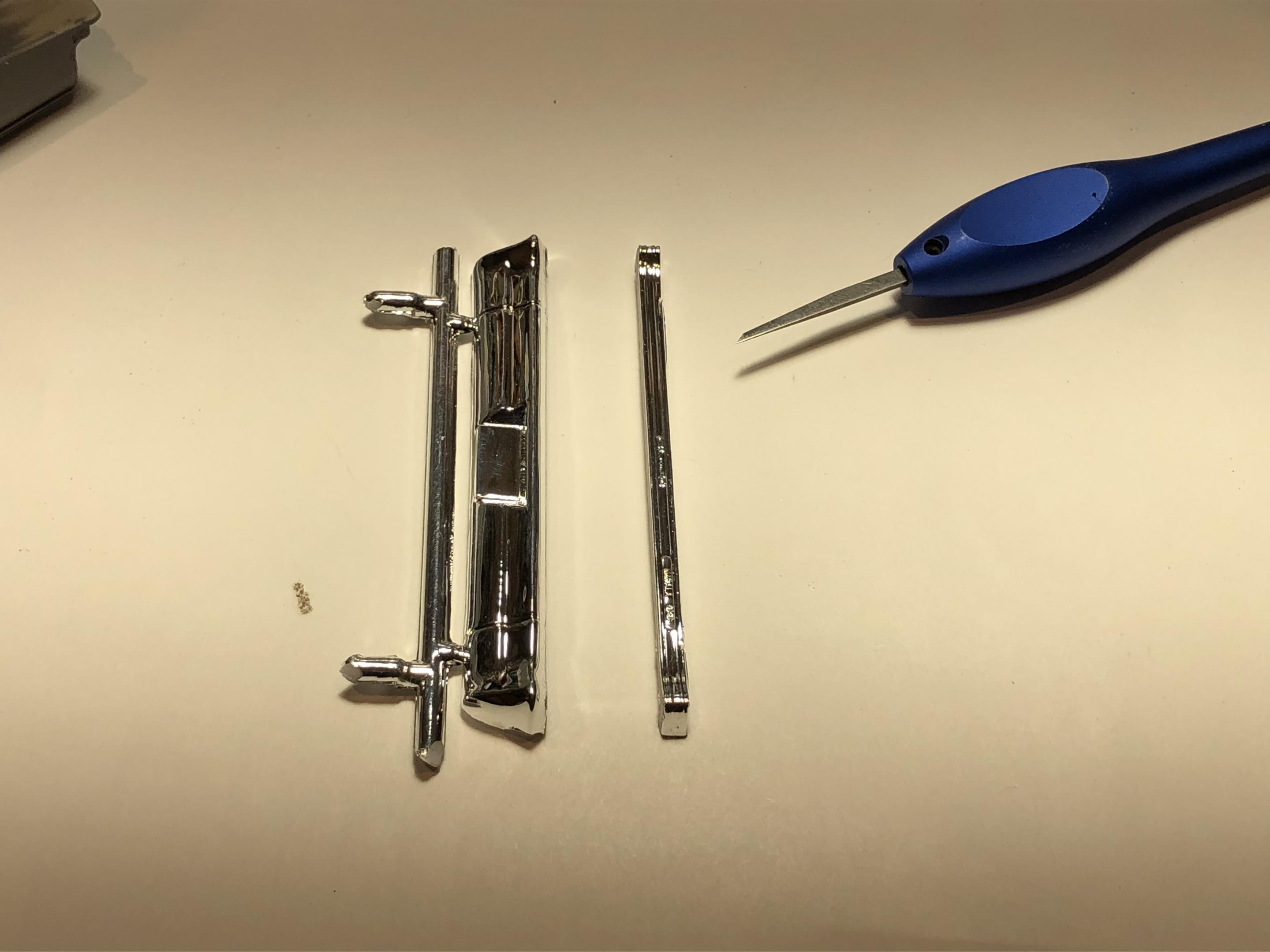

Hi guys. Well, I procrastinated just long enough for my new scribing tool to arrive! Big thanks to Luke (“Cool Hand”) for sharing the info on the tool.

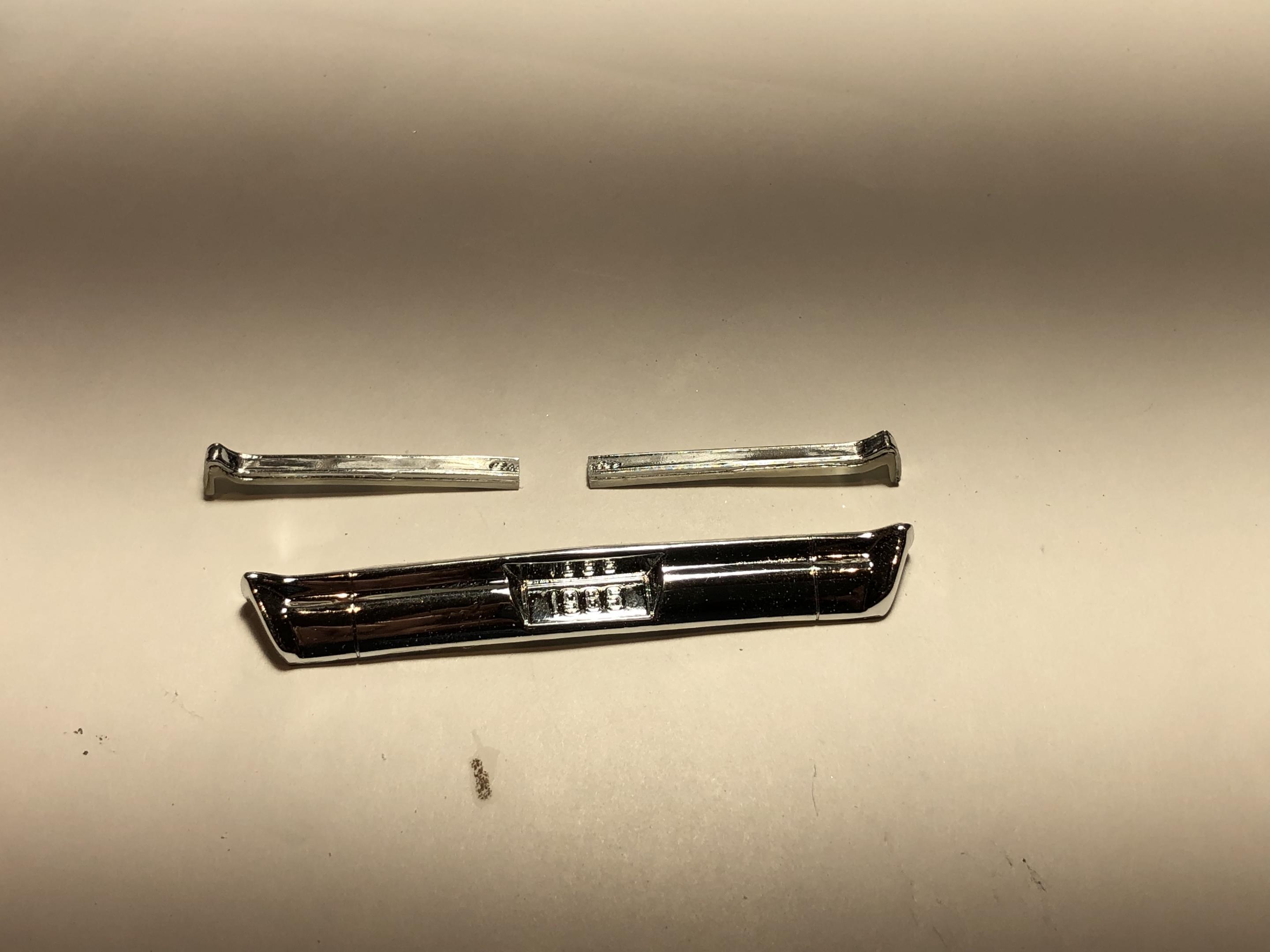

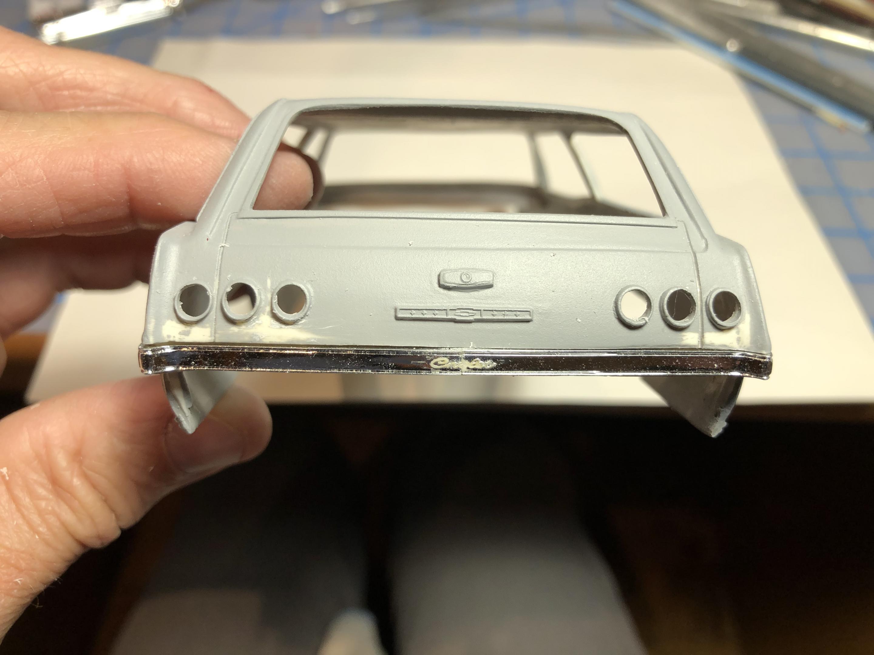

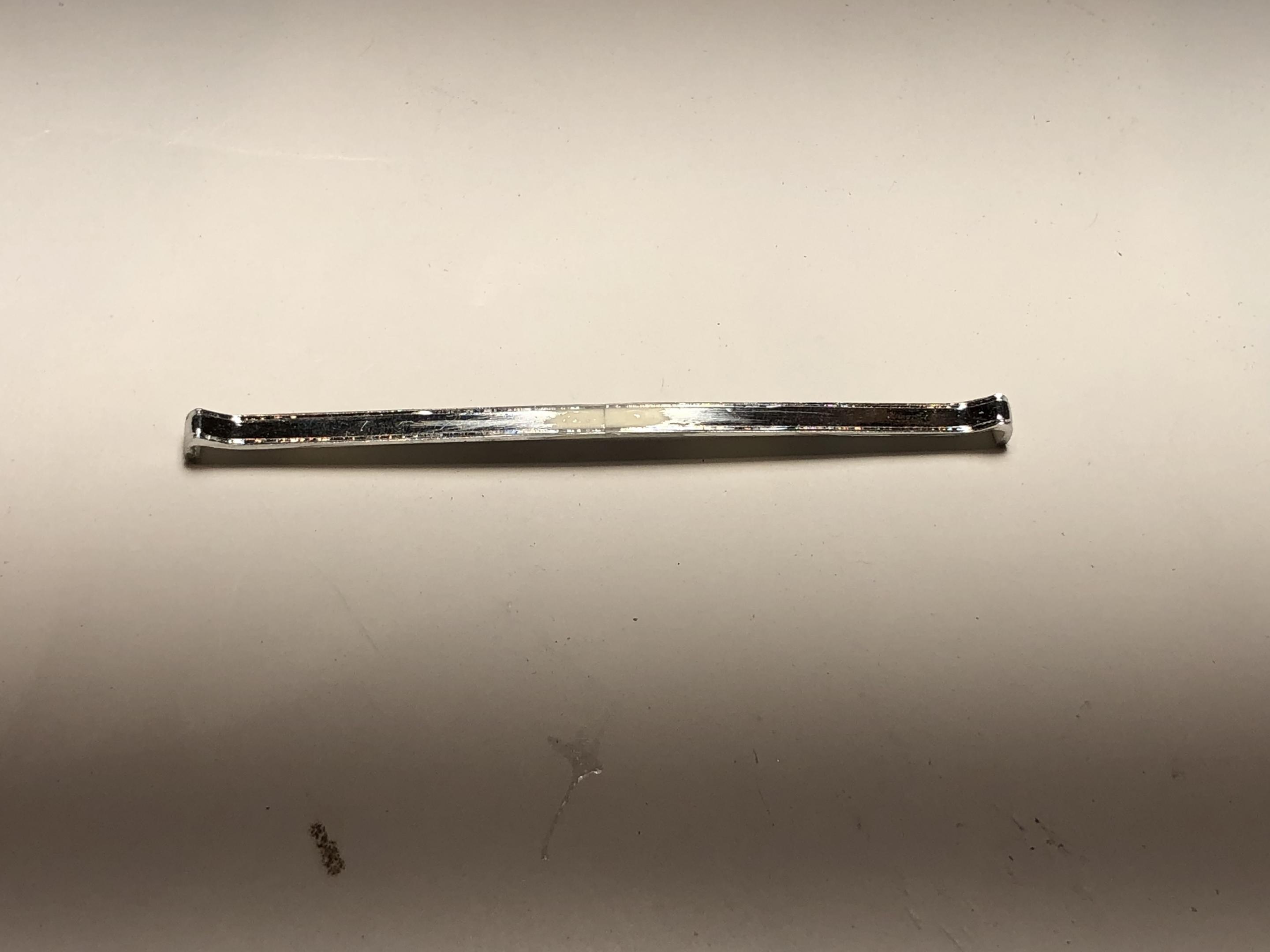

Time to fix up the rear bumper. First, separate bumper and upper panel from the Foose kit…using my new scriber!!

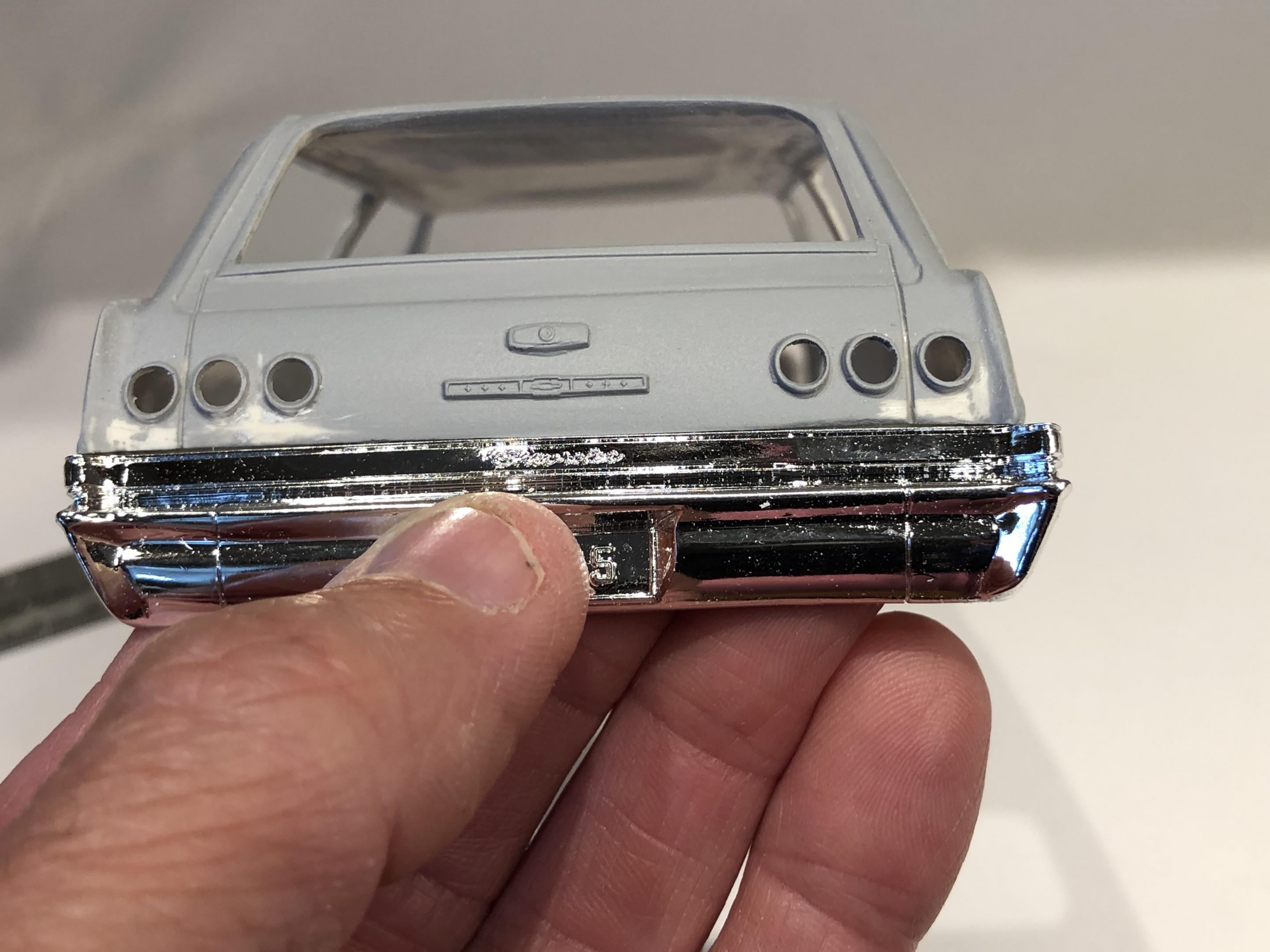

Ha! Easy peasy. The Foose bumper is a near perfect fit, a tick narrow, but that should give a nice “tucked in” look. Next, separate the same pieces from the Modelhaus unit and remove 3 1/2 scale inches from middle.
Re-assemble…
After some sanding and fiddling it’s a perfect fit.
The panel above the bumper will get cleaned up, primed, and painted. Right now I’m thinking it will be carbon fibre with thin BMF around the raised outer edges. Once I get it primed I will make a final decision on that.
Thanks again to Luke. The scribing tool works really well, I would recommend it to anyone. I suck at posting links, but the info is on his ‘63 Nova Ute WIP thread. I’ve used the back of #11 blades and some other scribes, this definitely worked better. I did have to order it from Luke’s country waaaaayyyyyy across the pond in Australia, but it arrived within a 2-3 weeks. Worth the wait!
