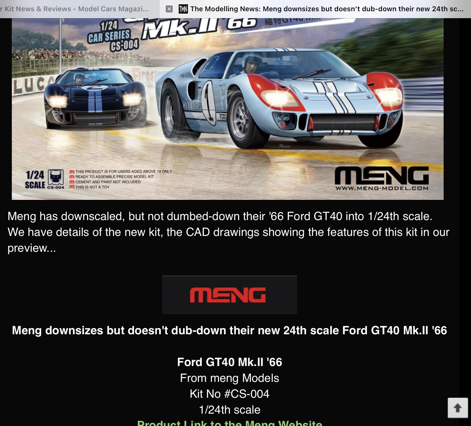

Search on GT40 in the forum.  There are many threads on the Fujumi kits and trans kits and conversions done with the base MKI or MKII kit.  It’s the best kit in terms of accuracy of the body but unfortunately nothing opens on it.  The MENG kit looks interesting kit since it will have an engine..  All the other kits from the 1960’s have their good points and bad.

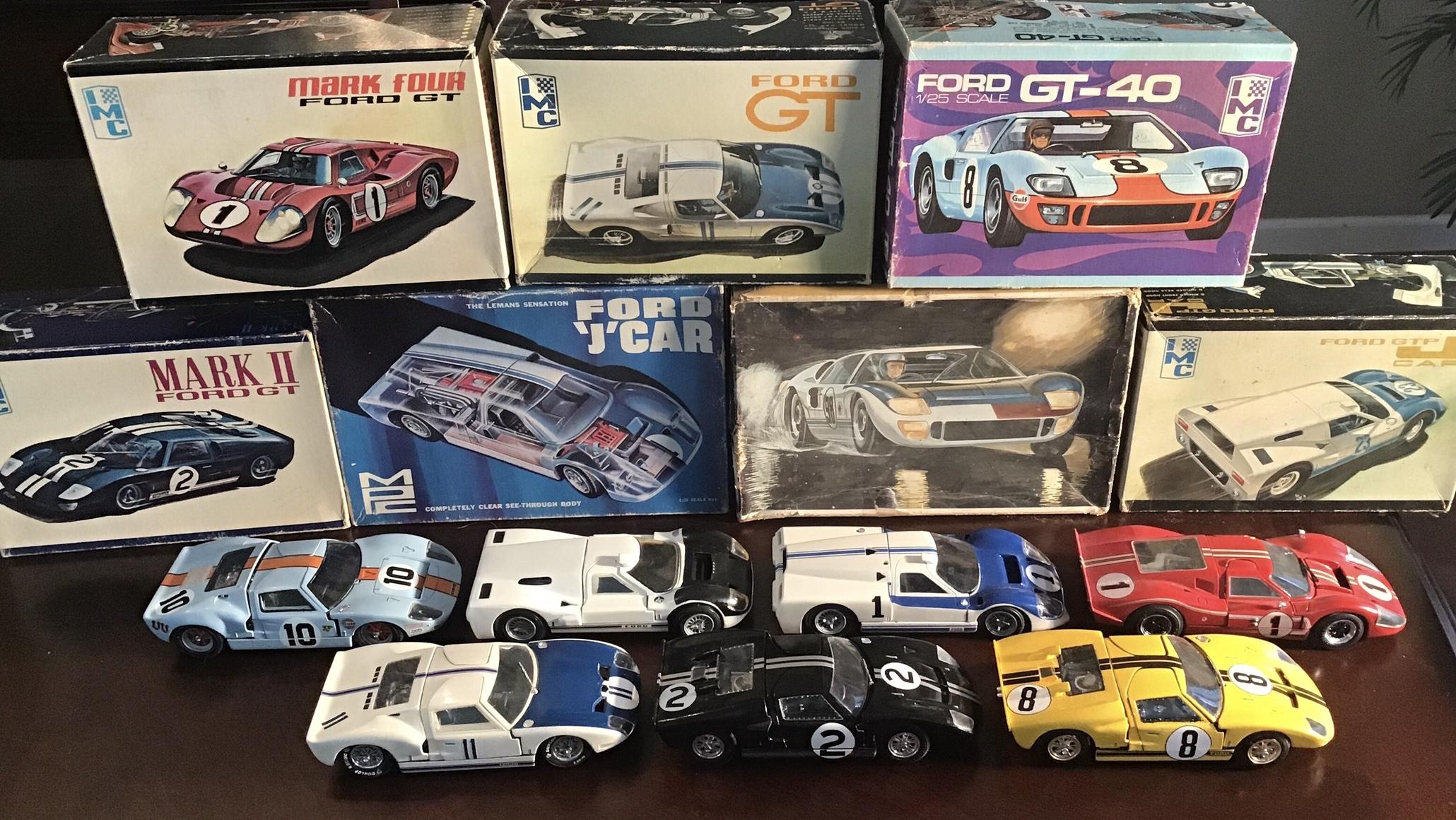

I have 4 of the Fujimi tooling GT40's, the Mk I Chassis P/1017 1966 Spa-Francorchamps car, the Mk II P/1015 No 1 and P/1046 No 2 from 1966 LeMans 1 2 3 win and the Mk I P/1075 No 6 Gulf wich won the 1969 LeMans race, I also have one Revell GT Prototype and one each of the Testors issues of the IMC Mk I, Mk II and Mk IV and the MPC Mk IV...but no J-car so far.

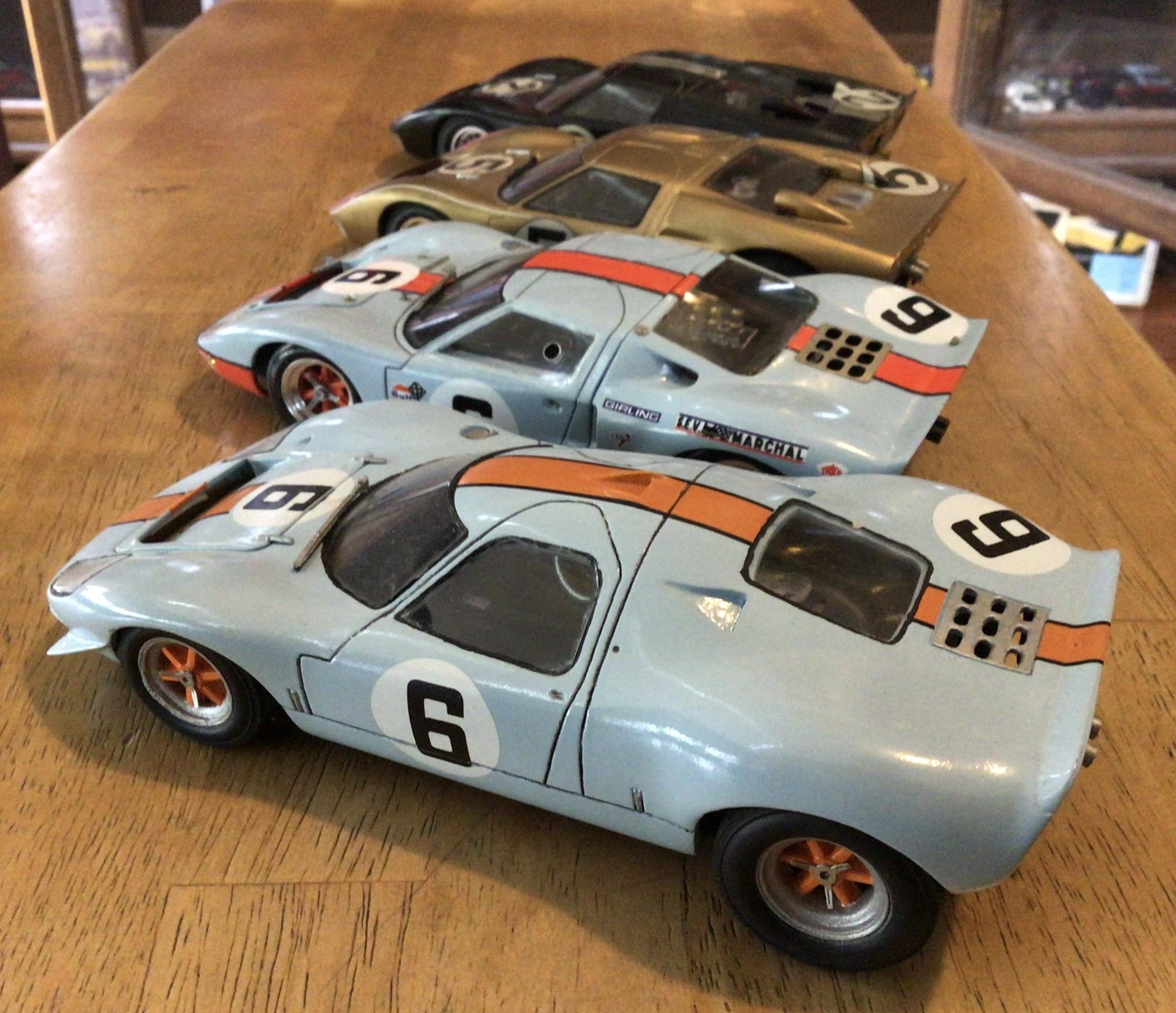

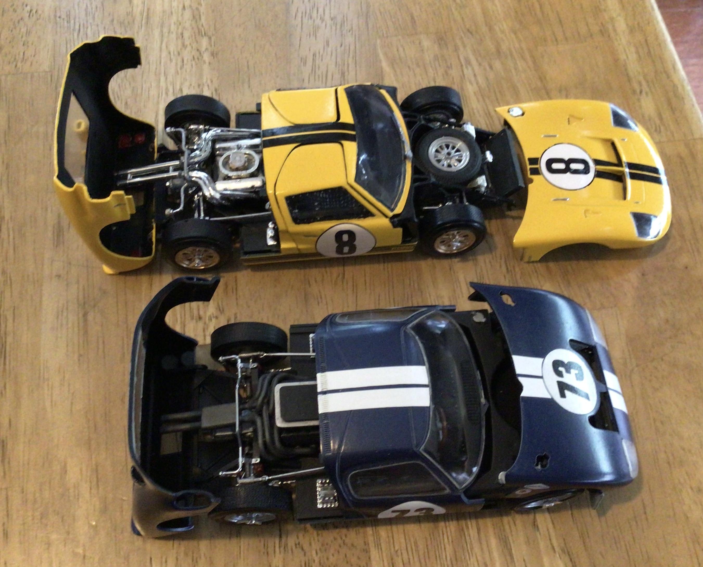

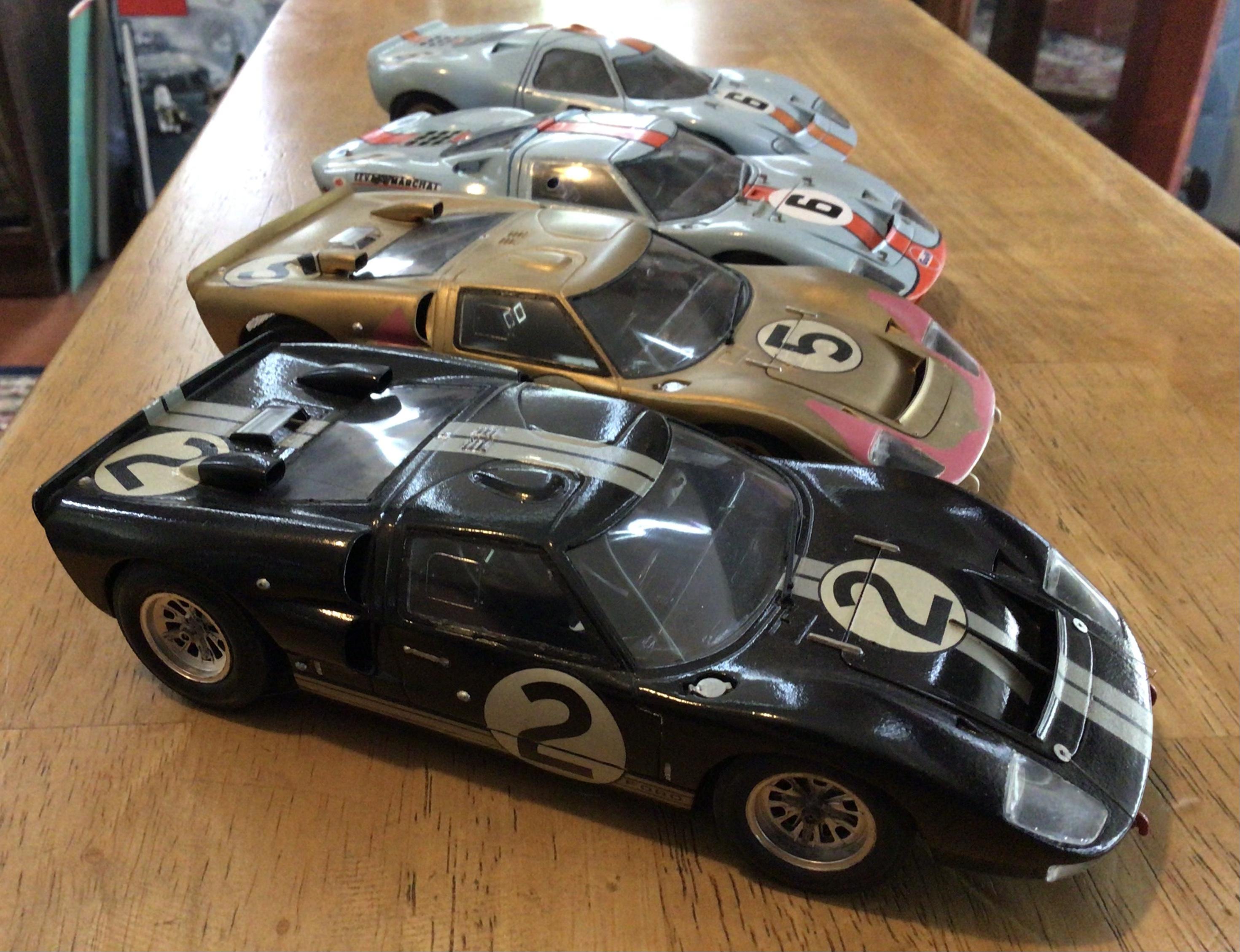

Some my older builds of two Fujumi MKII’s, a Mini Exotics and THunder Valley with Fujumi chassis, and the Aurora/Revell MKI and a IMC MKII.  The Thunder Valley transkit kit was long before any other transkits or engines from HRM.
