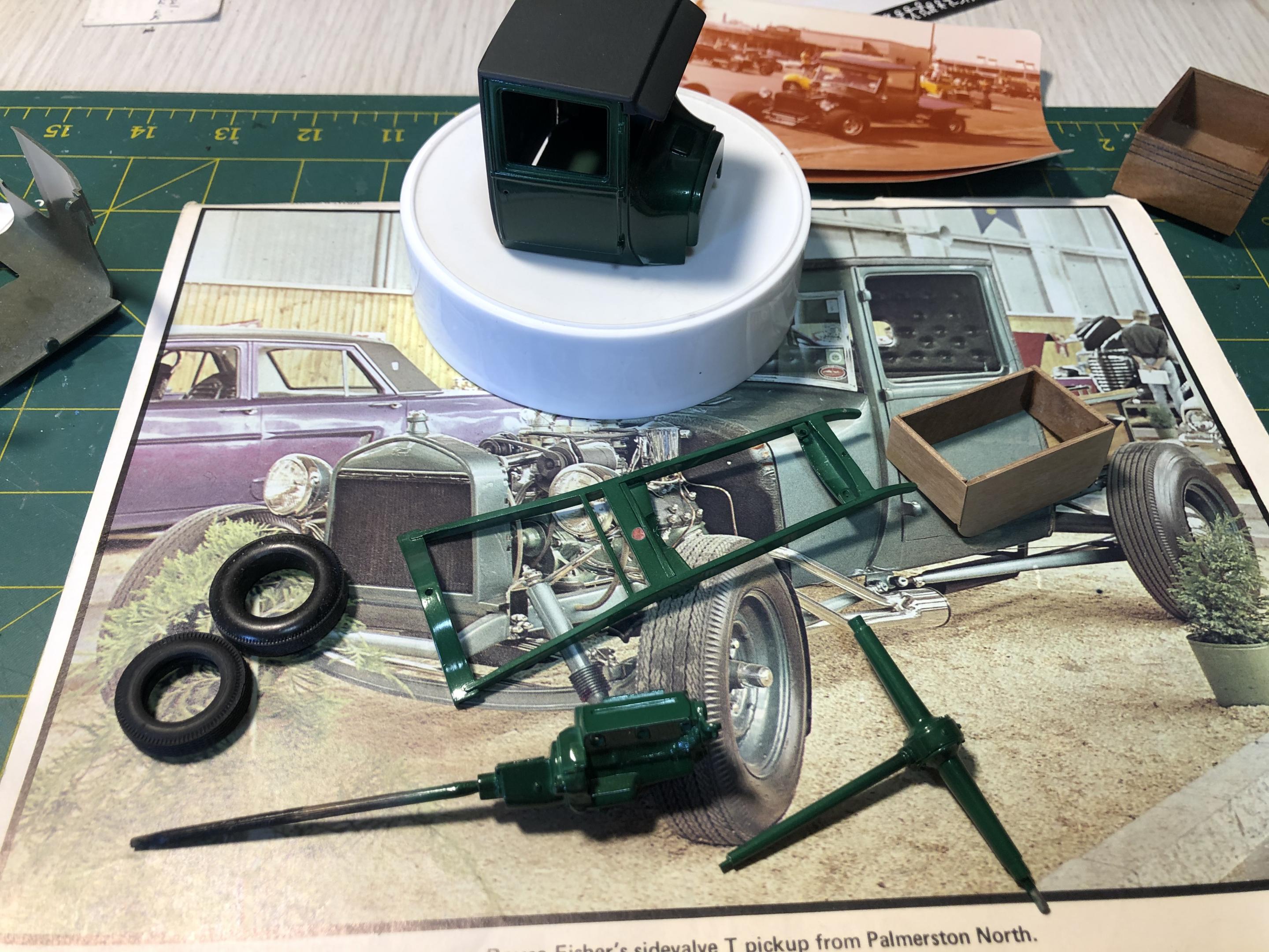

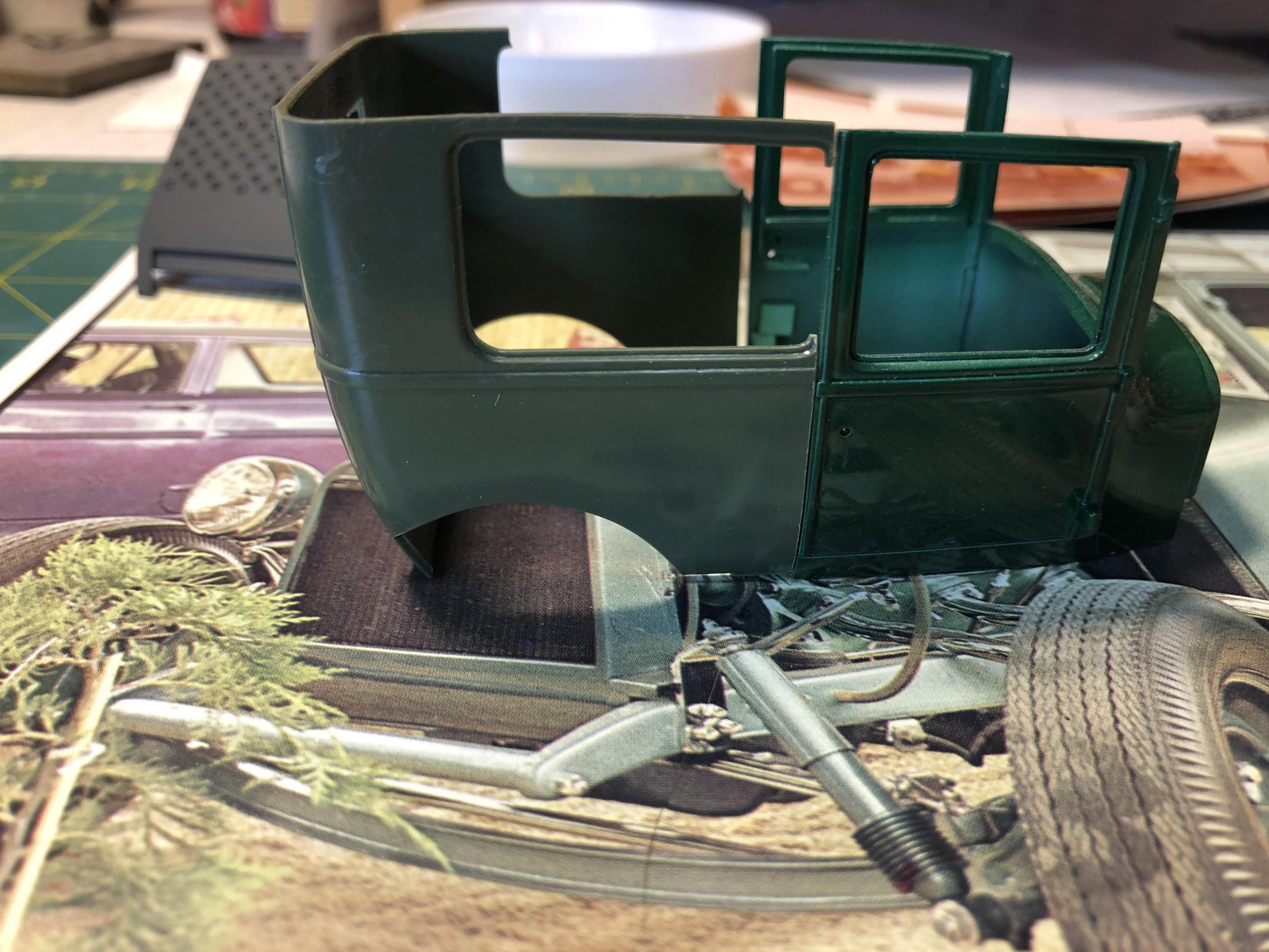

bill-e-boy Posted April 22, 2021 Posted April 22, 2021 Yonks ago a local rodder - Royce Fisher - built a closed cab from a cut down 26 T Tudor sedan. The build started in the early-mid 60's and was on the road in late 60's. I remember seeing it in 69 at a gas station. I lived about 45 minute drive away from the city where the Royce was based. I eventually moved there too. The NZ Hot Rod magazine article attached is from 73 and I remember attending that show. The club that Royce was a founding member of is having their 50th anniversary this year. Unfortunately Royce passed a number of years ago but he is remembered and the profile of his pickup is often used in club monograms and letterheads. I started the build a number of years ago and it is now at painted stage but I am not happy with some colour choices. The chassis and running train are a bit lighter hue of metallic green than the body - I will redo this The stumbling block when I first started the build was the chrome headers but we have a work-round for that now The kits used are the Lil John 26 T Sedan and the 29 Pickup - both Revell The sedan was cut as shown More pix later

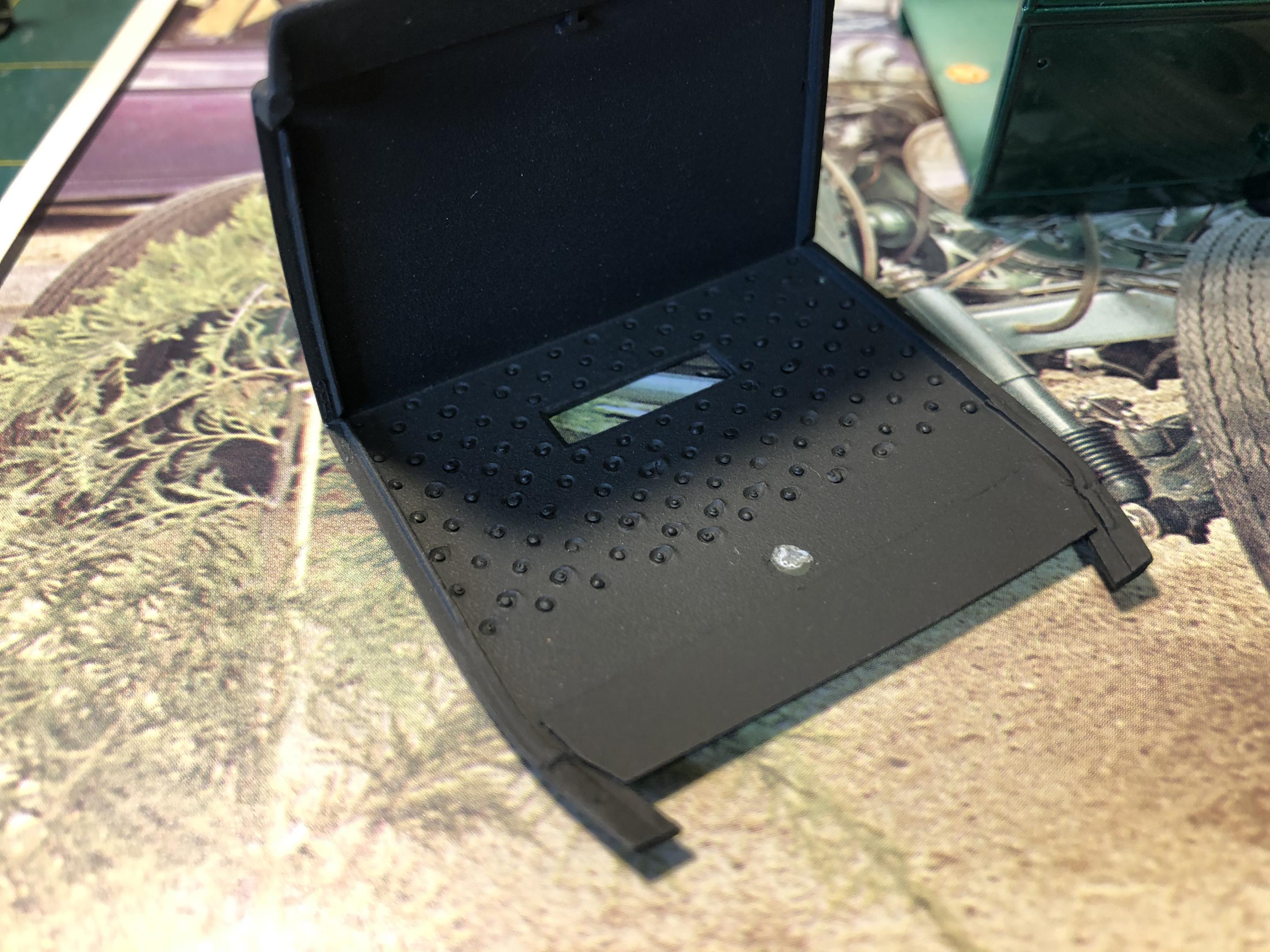

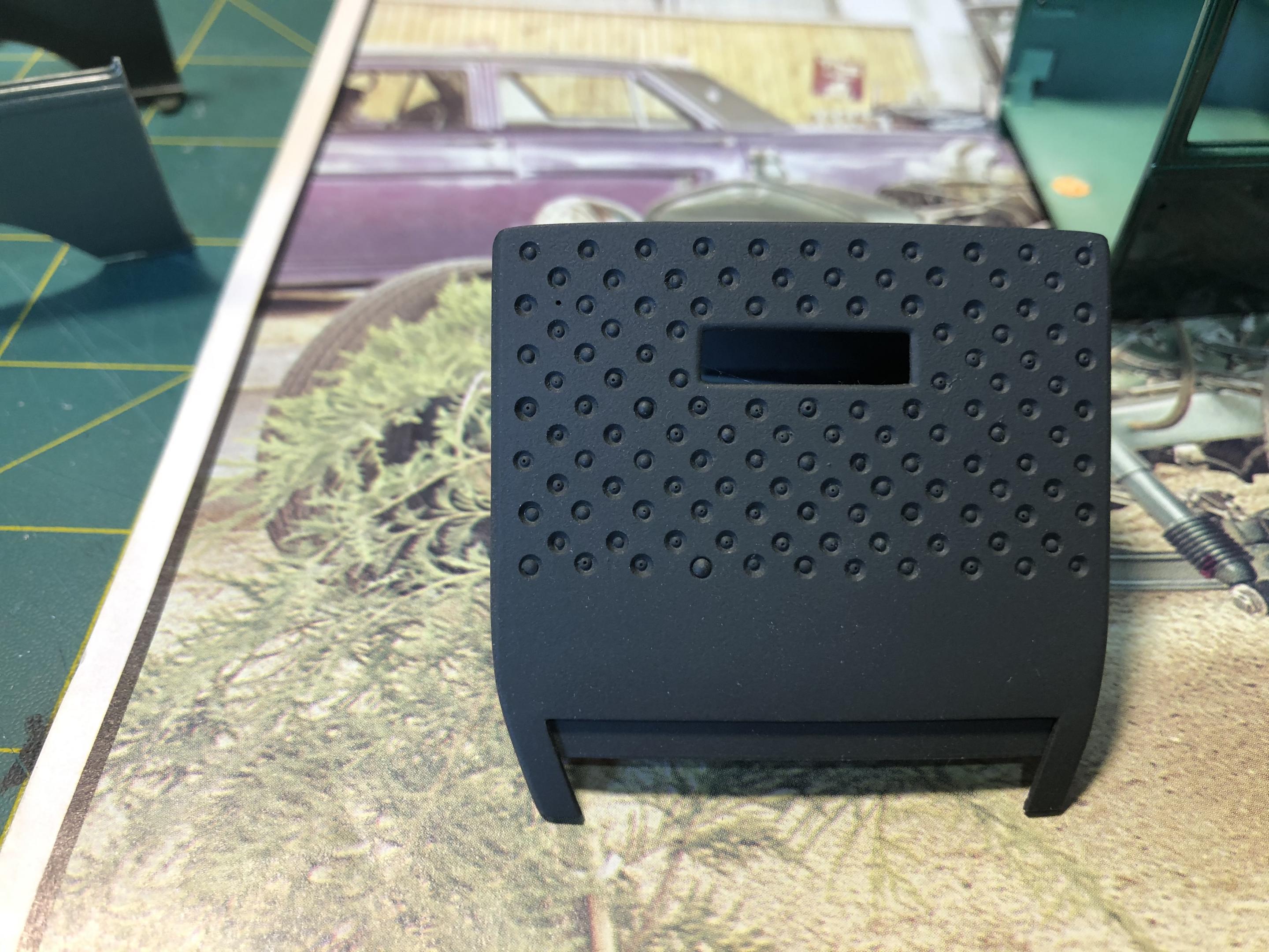

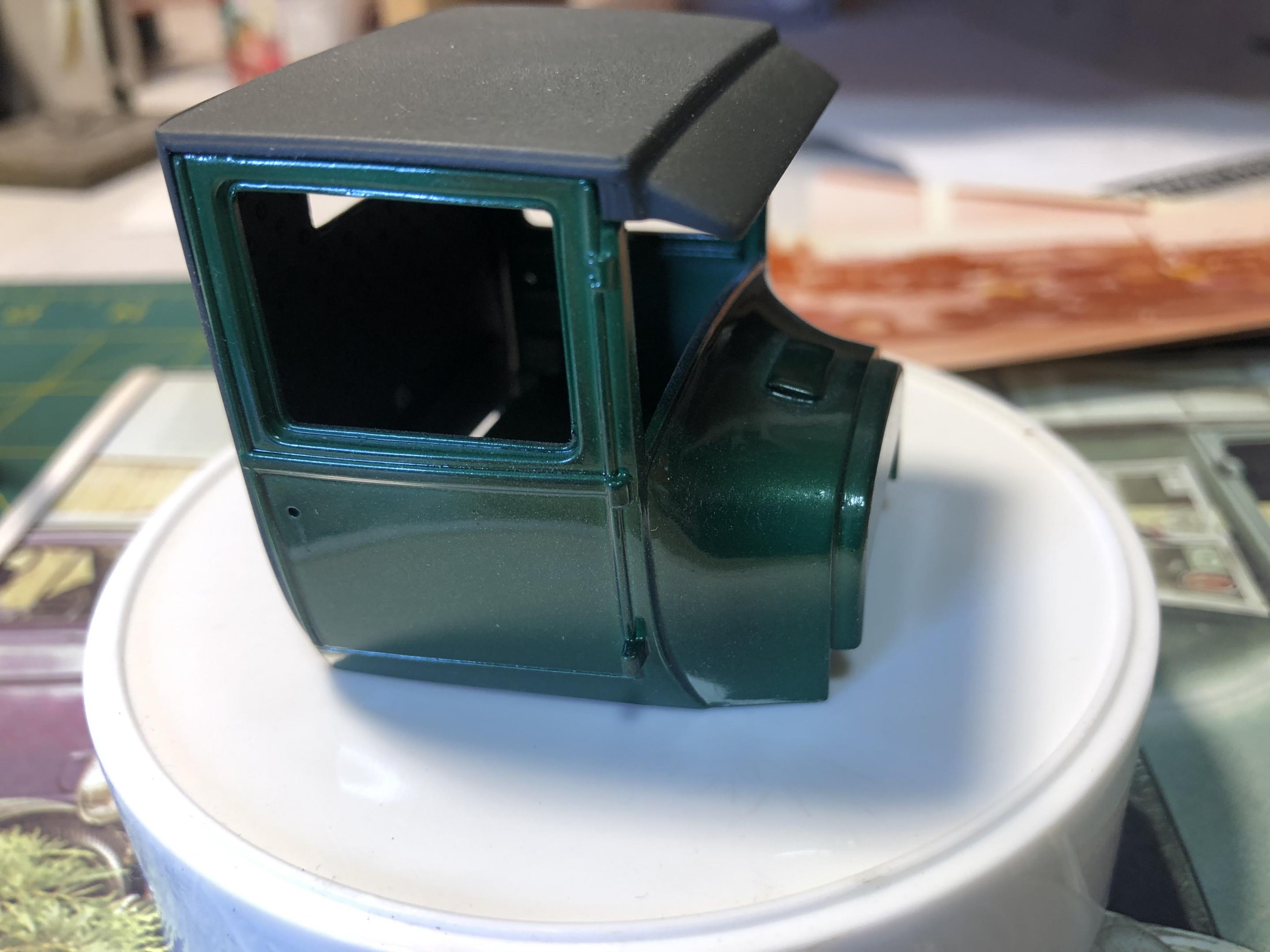

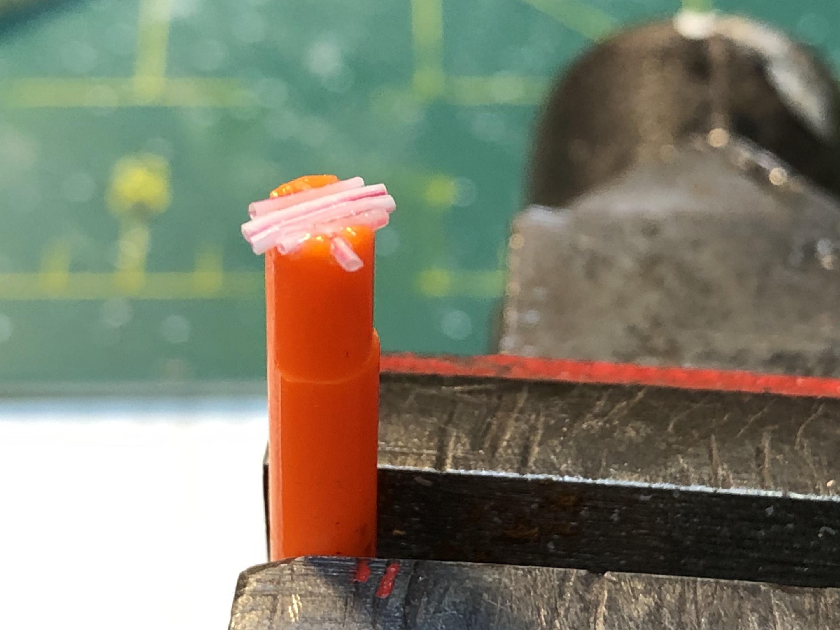

bill-e-boy Posted April 30, 2021 Author Posted April 30, 2021 Some more pix of where I am at The rear of the cab if upholstered in vinyl and has a mountain of buttons. The method to make these was to heat stretch some sprue and then cutting into 10mm long pieces. These were placed close to a hot soldering iron to make one mushroom head. Meanwhile the button pattern was marked out on the cab and holes drilled and then countersunk. The next step was to insert the button into a hole cut to length and mushroom with the soldering iron - it took some time from memory So we now have buttons on both sides The assembled cab The chassis is from a Revell 29 RPU and has been shortened. The motor is from a Revell 40 Convert that had a SB Ford installed into it. The distributor is wrong as the rod has a later model motor with a crab style distributor - another mission to find or make one. The rear tyres shown have white wall inserts that need to be painted and the fronts (not shown) are from a Tamiya Lotus seven. The originals were 14" rims that had V8 centres welded in that gives it a nice tyre rake. More to come

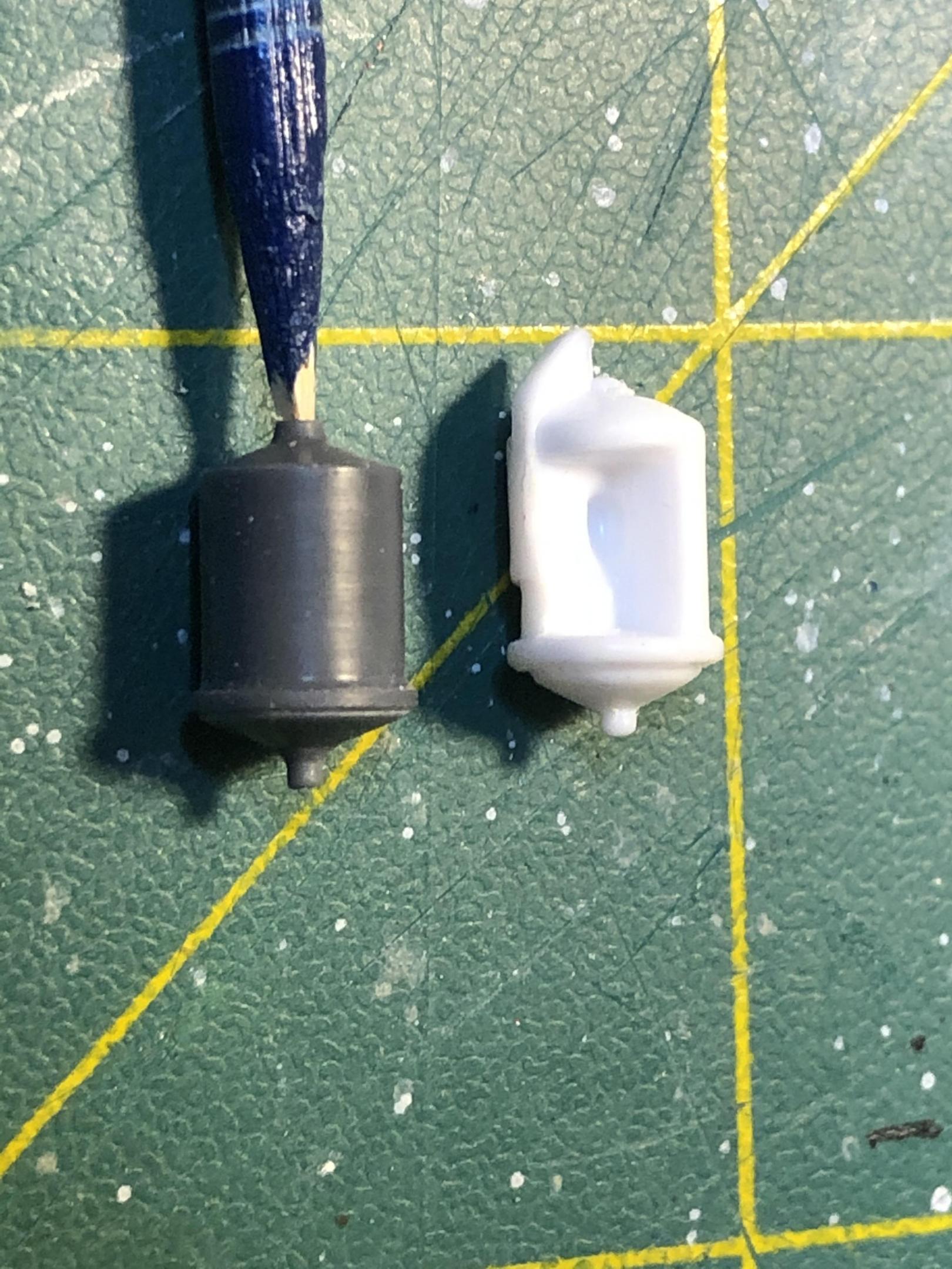

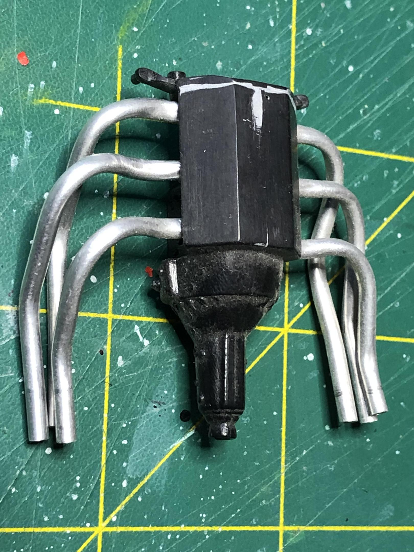

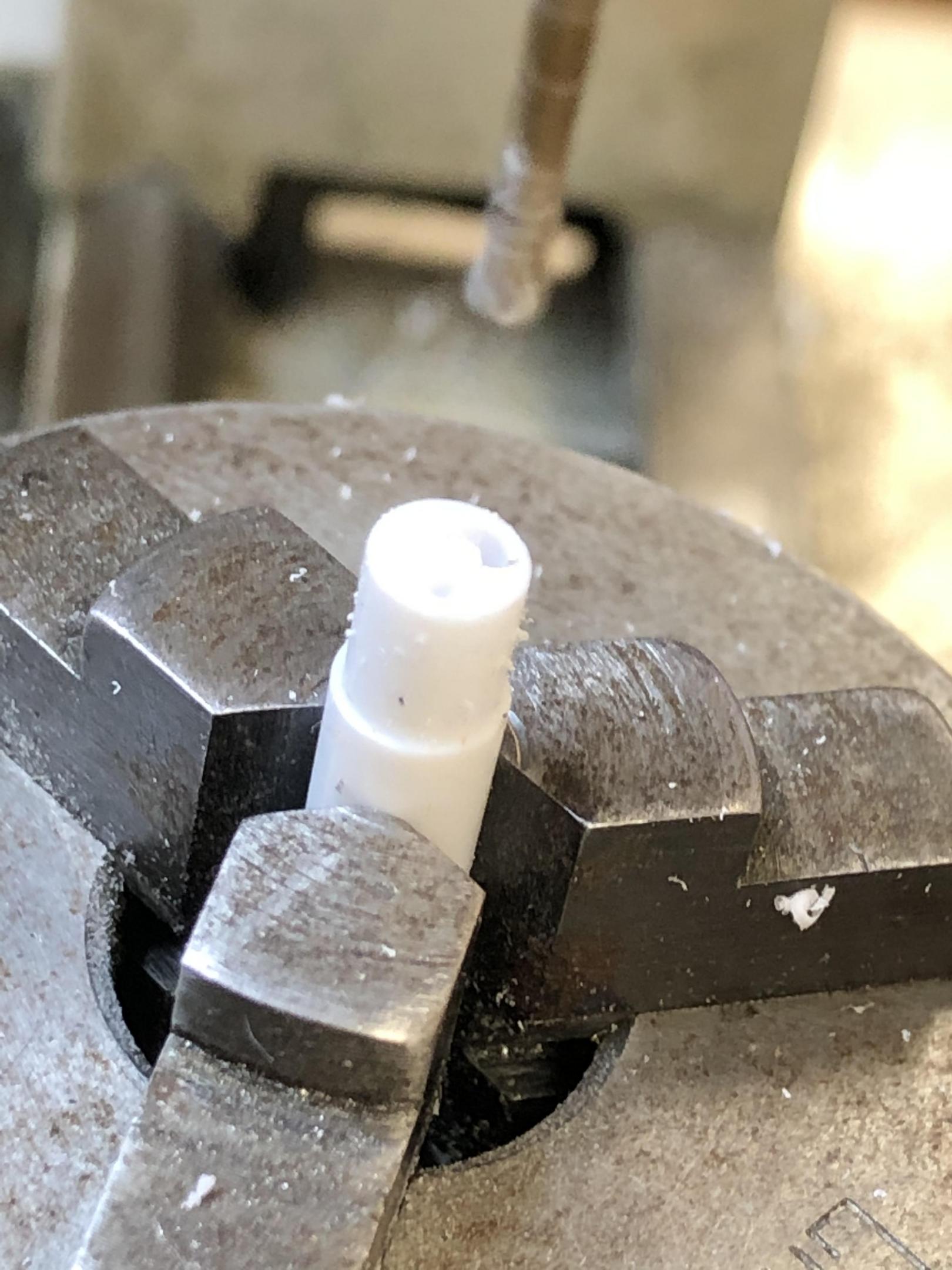

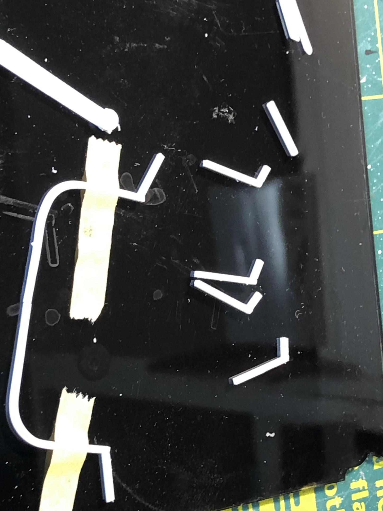

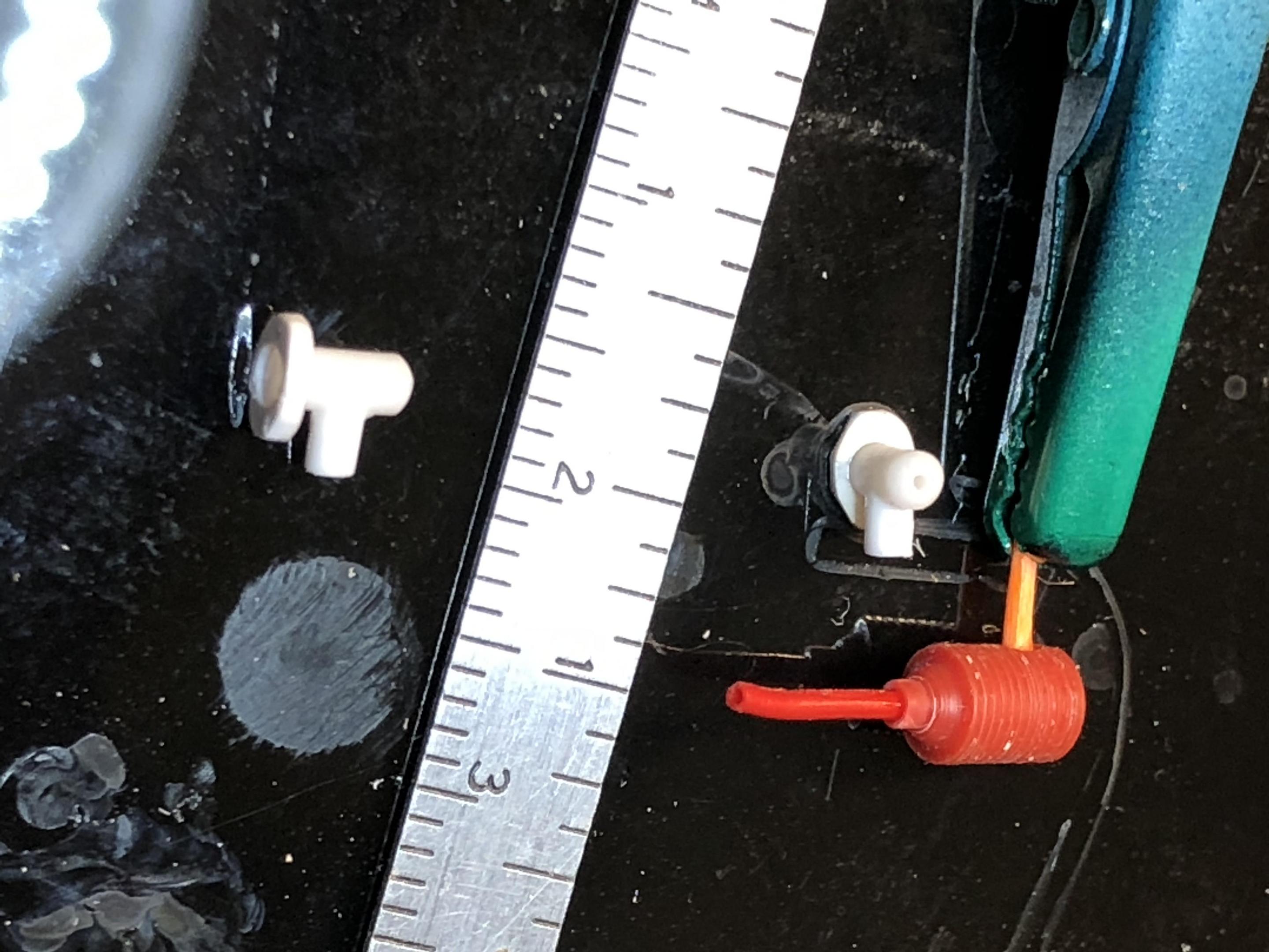

bill-e-boy Posted May 1, 2021 Author Posted May 1, 2021 One of the major stumbling blocks that I could see was the headers. The originals were made from Holden car tail pipes and snake around the radius rods. The collectors were made from flathead oil filter housing. This was a novel idea but filter housings in 1/25th are few and far between. The other block was chrome plating. When I first started the model just 20 years ago there was no chrome paint systems available. My first attempt at the headers was not a great success but a couple of attempts later I ended up with that in the pix below. The motor is from an AMT 40 Ford but this has now been replaced by the Revell flattie. The oil filter that came with the Revell flattie has a big hole in the rear - quick solution machine one from some plastic rod. While I was at I need a couple more for the header collectors. First the oil filter It looks huge but the main body dimension is just 5mm Next up machine the collectors. This needed a different machining approach. First turn the barrel part then change the lathe over to mill function and drill the header pipe entries, the back to lathe operation to machine the cover end of the collector. The lathe/mill is an Emco Unimat 3 which I picked up second hand awhile back with this job at the top of the to do list but such is life other jobs came first. Pix below is the drill out of the collector for the header tubes. Its a bit hard to see as the white plastic was difficult to photograph More to come

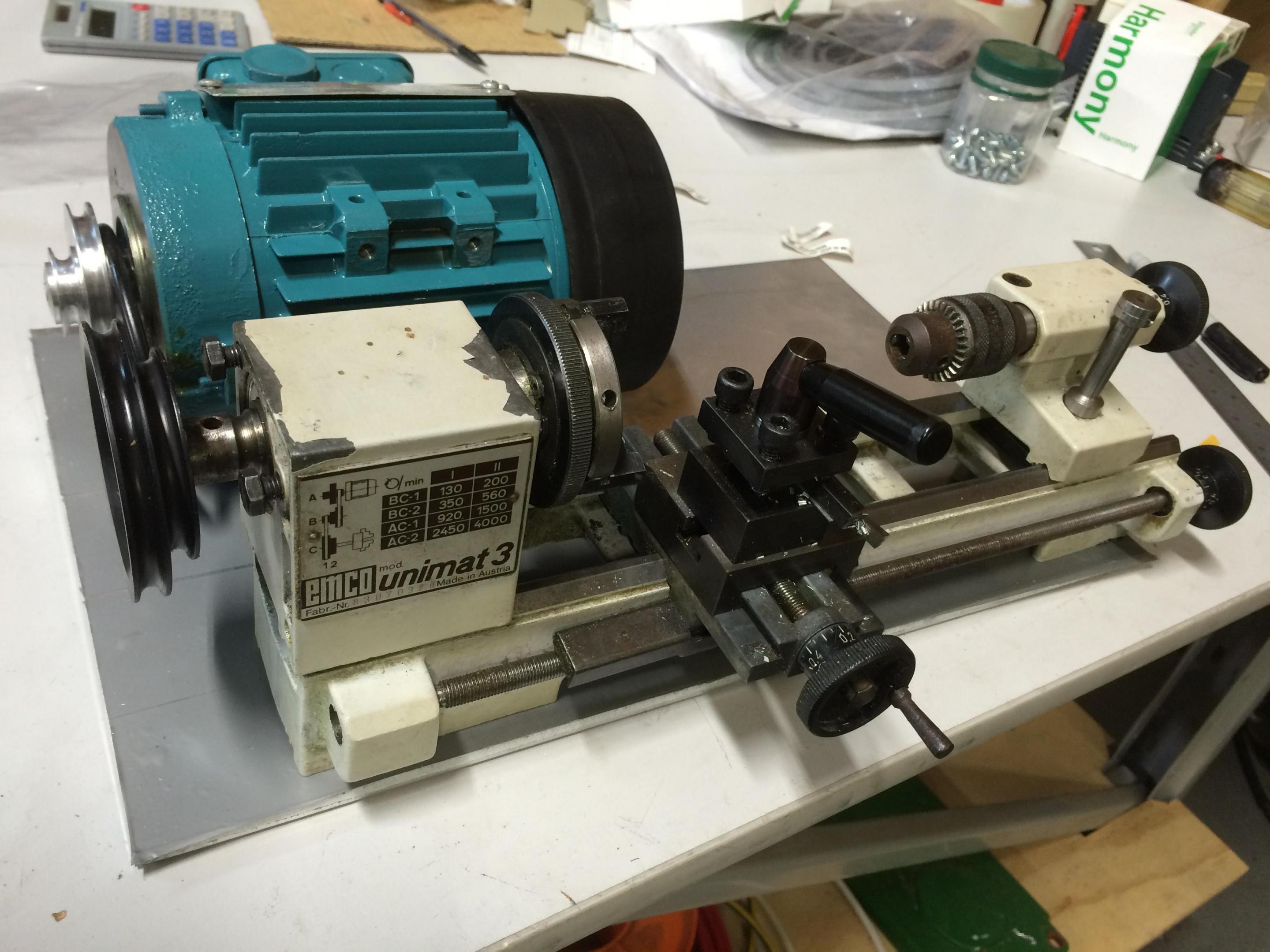

bill-e-boy Posted May 1, 2021 Author Posted May 1, 2021 Pix of lathe - it has had the original motor replaced with a the smallest three phase motor I could find and fitted with a variable speed drive.
Alan Barton Posted May 2, 2021 Posted May 2, 2021 As I looked at the first photo of the button tufting I thought "why doesn't he just use pins?" and then saw the second photo with the button tufting on the inside as well and thought - "Man, that just might be the cleverest idea I have ever seen!" Great to see these old rods being recreated in scale. I have a few Aussie examples on the bench at the moment. Royce must have been a short guy - there can't have been much leg room in that cab, and that comes from a guy who drives a Model A roadster with a recessed firewall! I have a Model t closed cab project of my own, but lacking any spare T Tudor bodies, I am grafting a Revell 27 tub cowl to a 29 Closed Cab body. Should get the same result but there is a lot of filling required to blend the smaller cowl into the body. I like your way better! Cheers Alan
bill-e-boy Posted May 2, 2021 Author Posted May 2, 2021 Hi Alan, thanks for the kind words Royce was close to 6ft tall and he had issues with the cramped confines of the cab but he still drove it around. I remember he and another rodder drove from Palmerston North to Auckland in the middle of winter to enter into a show. Auckland is about 500km from Palmy. He also went to the South Island in it too. The guy who has the pick up now said its pretty hard to get into and out of I just remembered the back section of the body is the remainder of the top of the 26 T When I made up the buttons I made heaps as stretching sprue is an inexact science. I see the occasional 26 T on the local auction site, either sedans or the delivery. Your project looks interesting

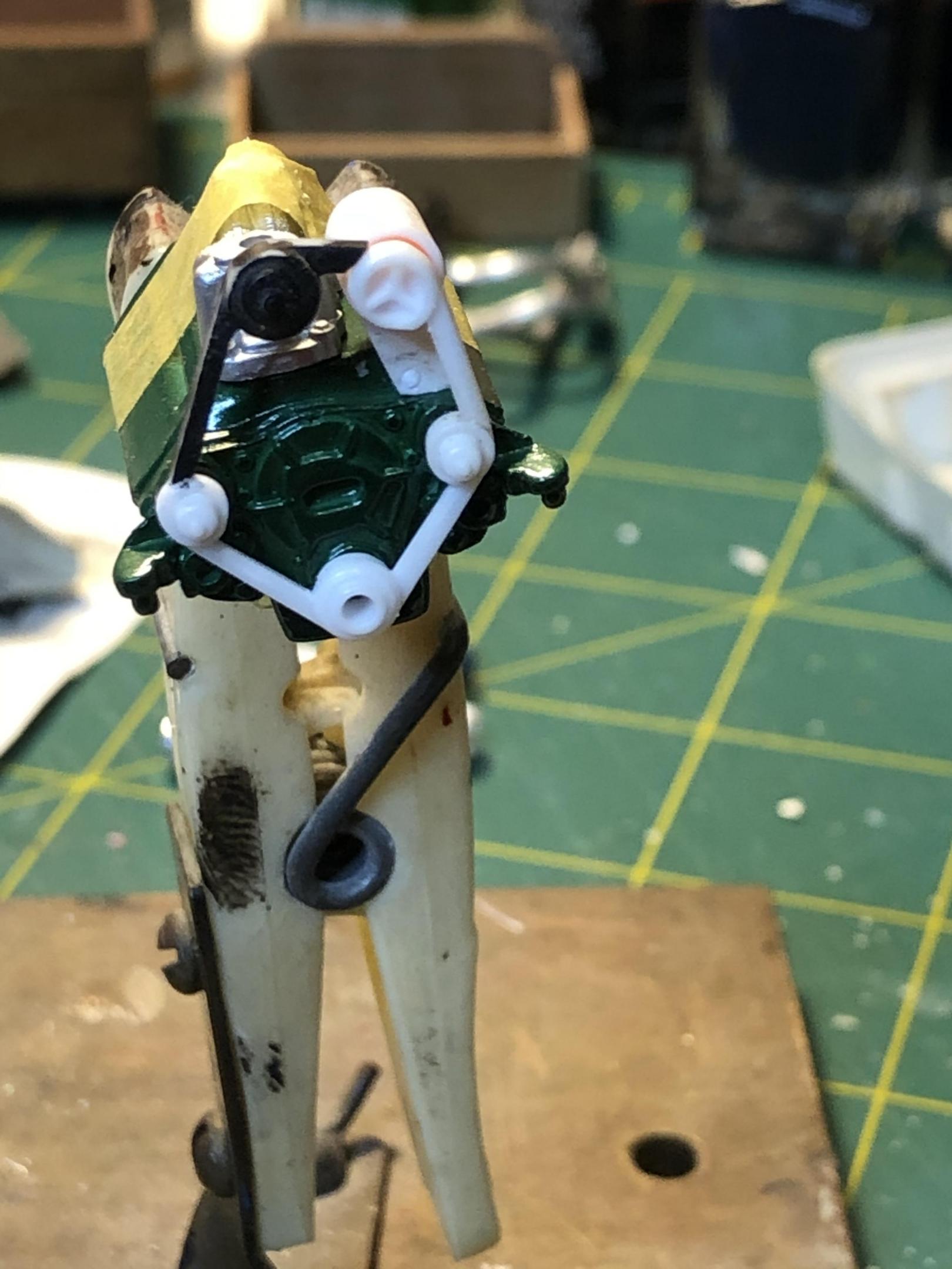

bill-e-boy Posted May 13, 2021 Author Posted May 13, 2021 Thanks for the kind words Been hammering away at the small stuff Needed and crab style distributor so made one up. Took a couple of attempts to get it there. Started with some sprue that I machined to the needed diameter then filed a groove for the terminal posts. The posts are insulation striped off some some small wire and cut to length. A cap was glued over the groove and insulation then cut to length on my lathe with a stub to fit into the hole in the front of the engine block It is now complete but the pix will have to wait as the pix fairies dealt to the photo The next thing to sort is the fan belt and generator. As a 2 carb manifold is used the generator needs to be moved to one side - in this case to the left hand side of the block. A matter of cutting up fan belts and pulleys, fab up a bracket for the gennie and idler pulley. Royce used the front of a generator in the stock location for the idler A bracket was made up for the oil filter and pinned to the LH head Meanwhile while the glue is drying on one part we work on another - The brackets for the pickup bed are made from 1mm square plastic rod. I did these last time I had this out but they all needed regluing and trimming to length. The next thing to do is paint and chrome so that some assembly work can be done on the chassis. The list is still long More to come

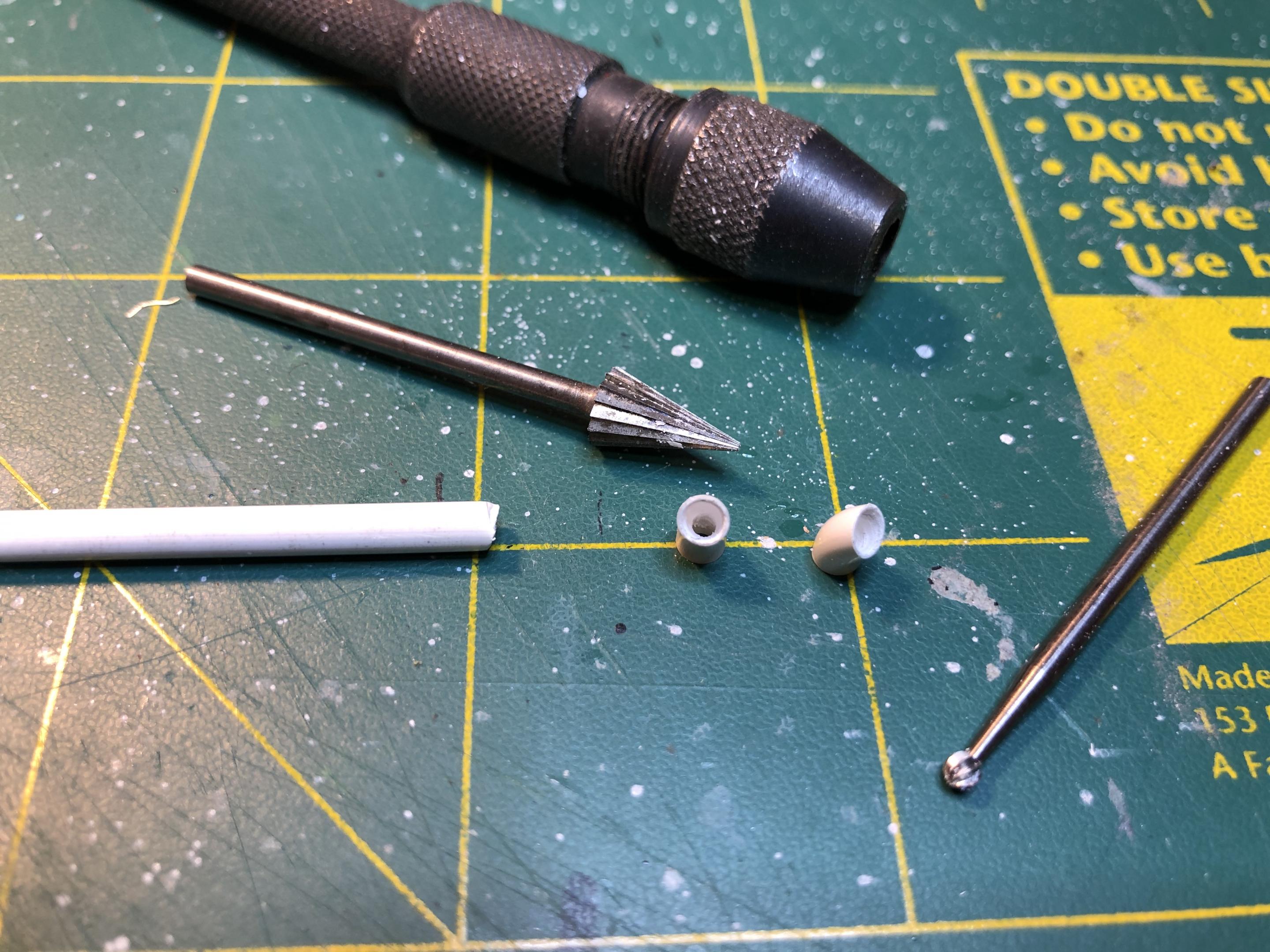

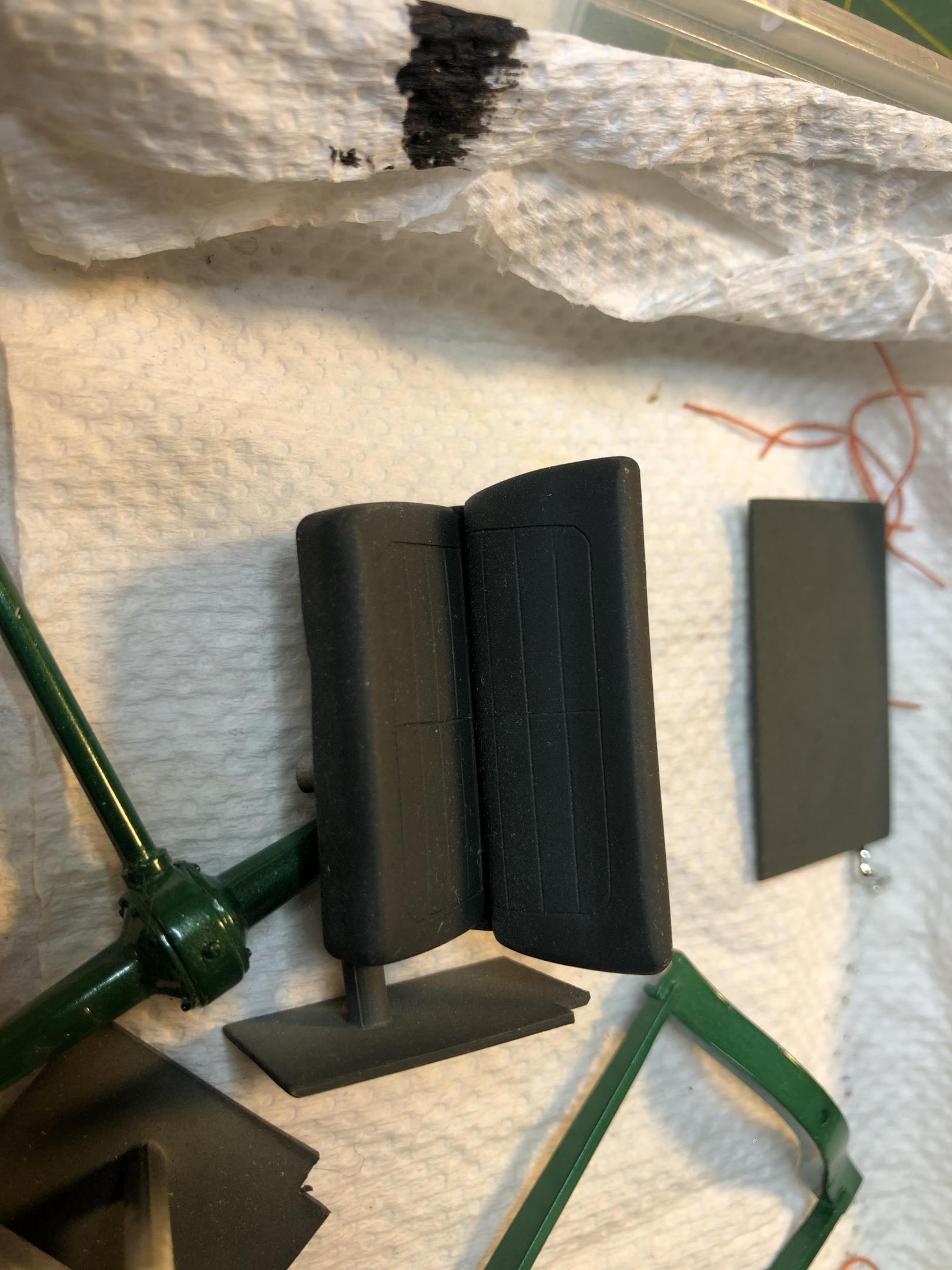

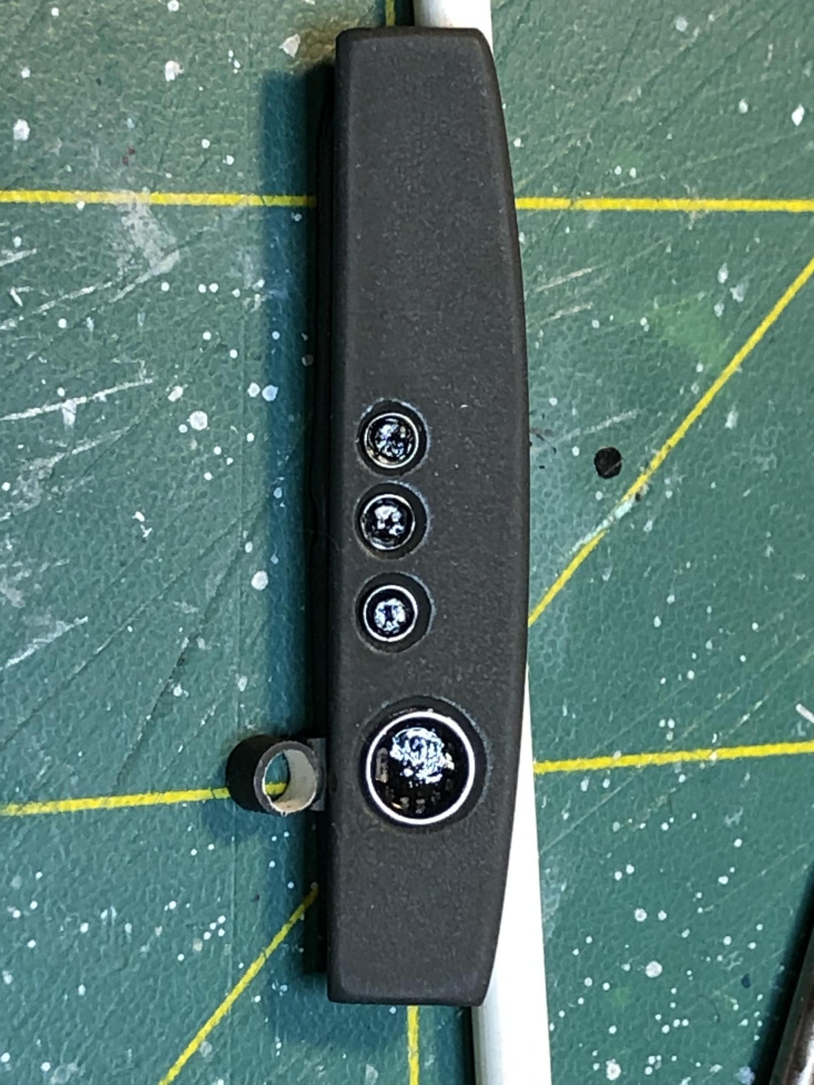

bill-e-boy Posted May 20, 2021 Author Posted May 20, 2021 More work on the small things like carb air horns. Heat bent some plastic tube, cut to length on the inlet side and hand reamed out with Dremel cutters held in my big pin vice Dash board and seat from last time I worked on this - maybe 10 years ago. The seat pattern was scribed into a sanded down plain seat using guides for the corners and a straight edge for the straight parts Slowly getting all the small bits finished and painted More to come

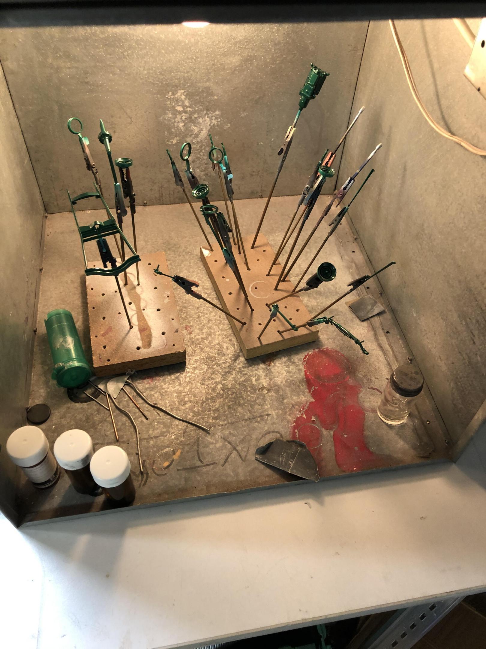

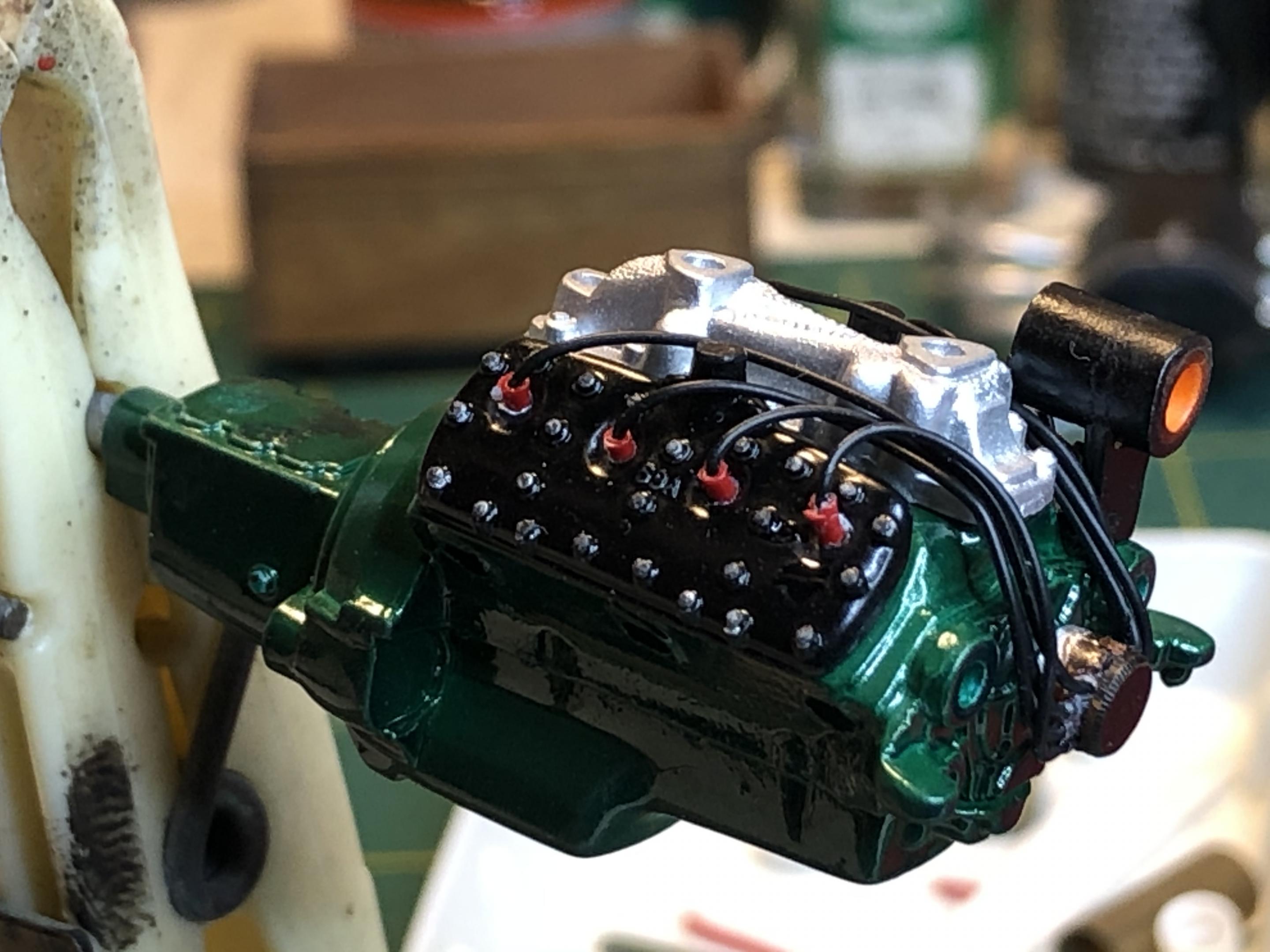

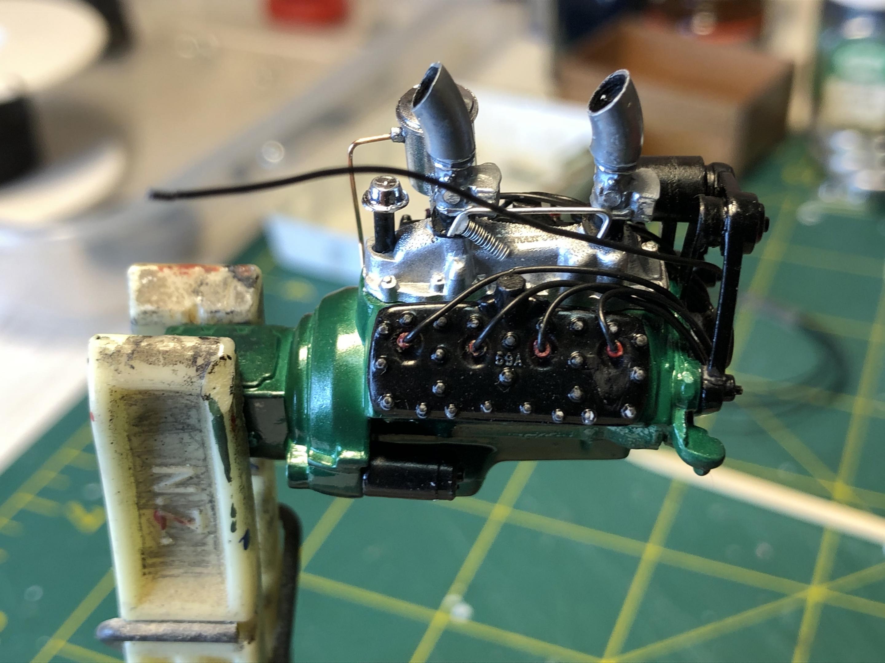

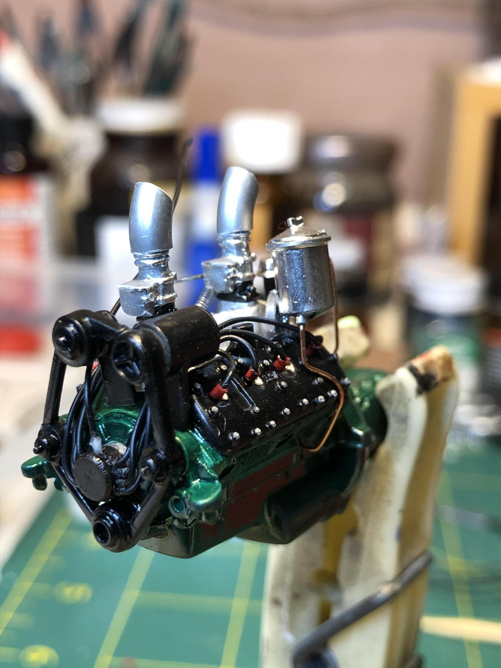

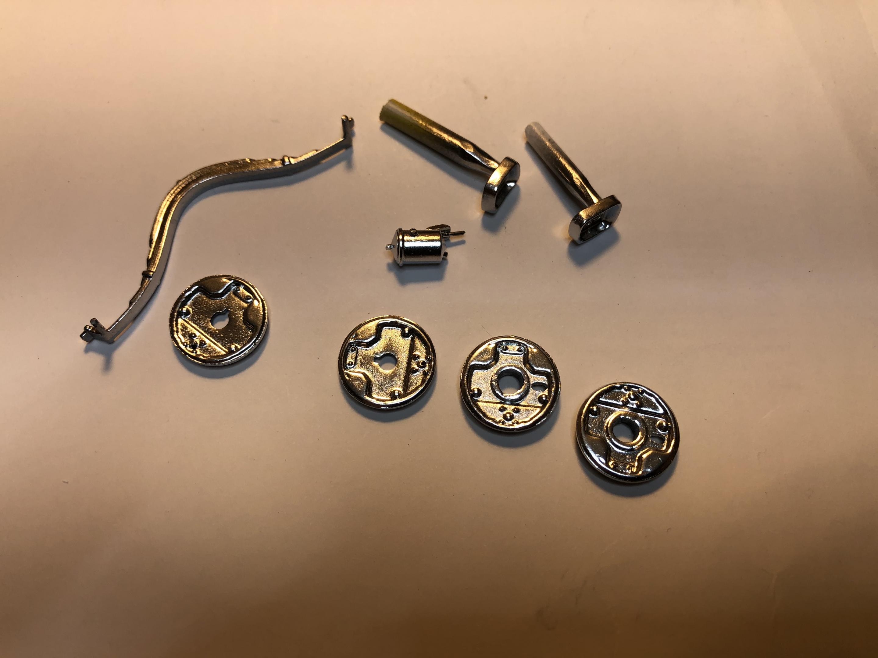

bill-e-boy Posted May 25, 2021 Author Posted May 25, 2021 Working on more small stuff and getting paint on them A bunch of parts ready to come out of the hot box And chrome parts that were originally painted with Alclad and now overcoated with Molotow. The pix is a little dark but the finish on the parts is really good Got some time on the motor tonight. Now partly dressed Looks like I may have to redo one red sleeve. They are all yet to be painted black but left it red for the photo - black on black is very hard to photo A lot of parts have been or are about to be painted. The paint is Testors Jade Green in the little square jars - this was the original paint colour and I luckily found 3 jars in my stash. It is quite thick and needs to be thinned about 200% so goes a long way The next on the list is to paint the body again as there are a few areas that have not been covered properly More to come

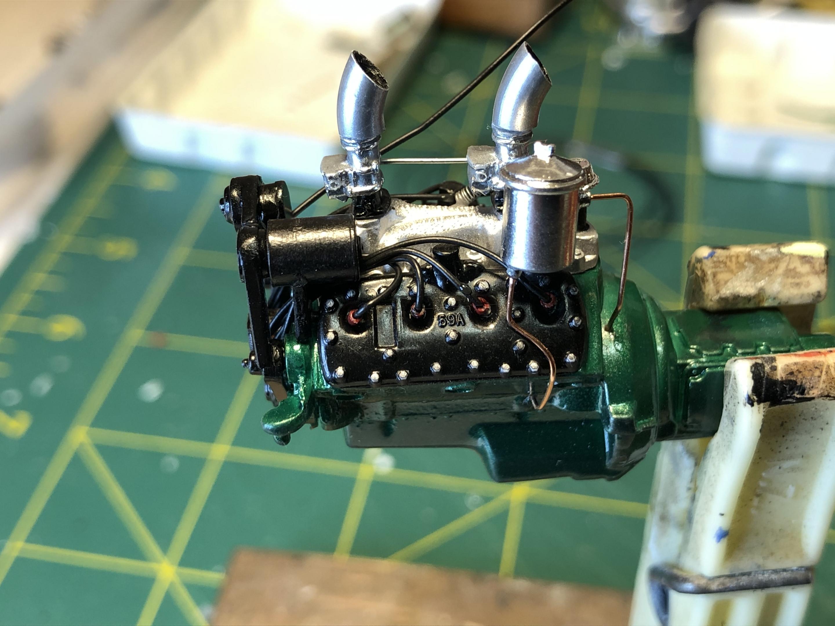

bill-e-boy Posted May 27, 2021 Author Posted May 27, 2021 Fixed the bad spark plug boot. Have decided to leave red but with a black wash Been working on more scratchbuilt detail items I turned up a beehive coil and made some brake and clutch master cylinders from rod and plastic card. Need to get items to the paint booth but a few more items to get ready first. Wasted an evening looking for a fuel pump and oil breather and was about to scratch one up when I rechecked the pix I have to find that the fuel log is fed by a line that comes up from the chassis - looks like Royce may have used an electric pump next to the fuel tank -DOH!! Next on list is carbs and more engine detail
bill-e-boy Posted June 2, 2021 Author Posted June 2, 2021 I have been working on getting more coats of green paint on all the parts that require it. The original paint was a bit thin so more green squirted on. Body and chassis clear coated too. It is like going down memory lane using Testors enamels again. Used to be my paint of choice Got more work done on the motor with assembly and detailing almost complete

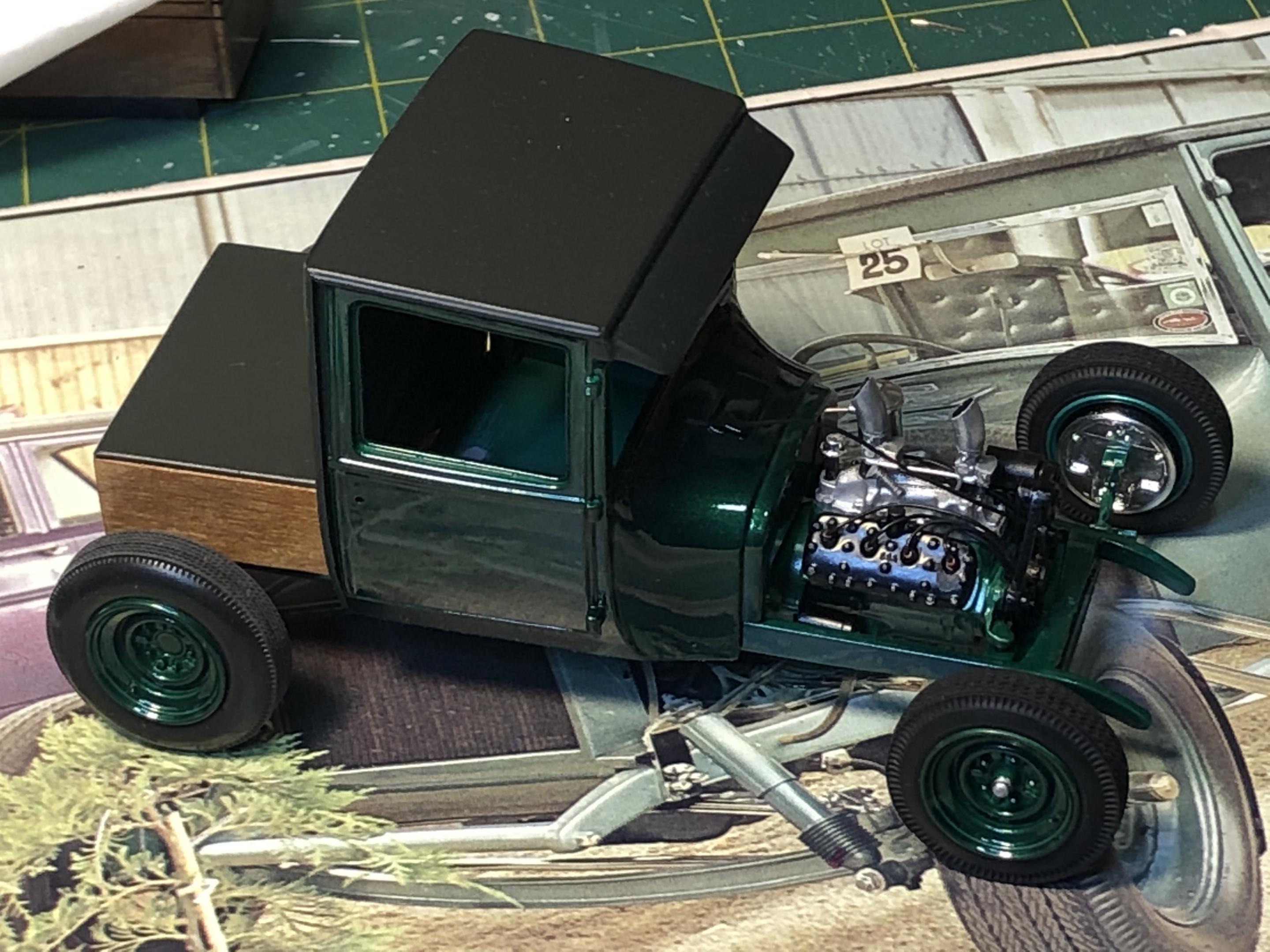

bill-e-boy Posted June 5, 2021 Author Posted June 5, 2021 Thanks Kit Things moving on A quick mock up

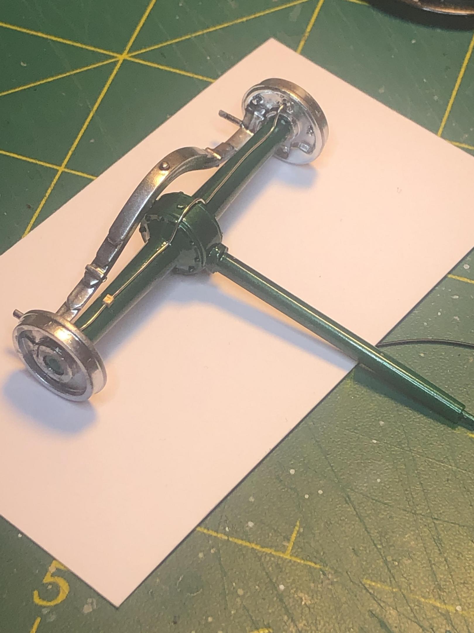

bill-e-boy Posted June 9, 2021 Author Posted June 9, 2021 Thank Robert Been working on getting it up on wheels Brake lines, backing plates and spring on the rear end first off Next up attach rear radius rods and then move on to the front end. I am happy that it is all going together OK as I did some of the engineering 20 years ago All together ready for the next step - Install the motor - I needed to change the front mounts a little. This is done - just waiting for the paint to dry The wheels are on loose and to check all OK
Tom Geiger Posted June 9, 2021 Posted June 9, 2021 Love the engine! Color contrasts really make it! Glad you left the red boots!
