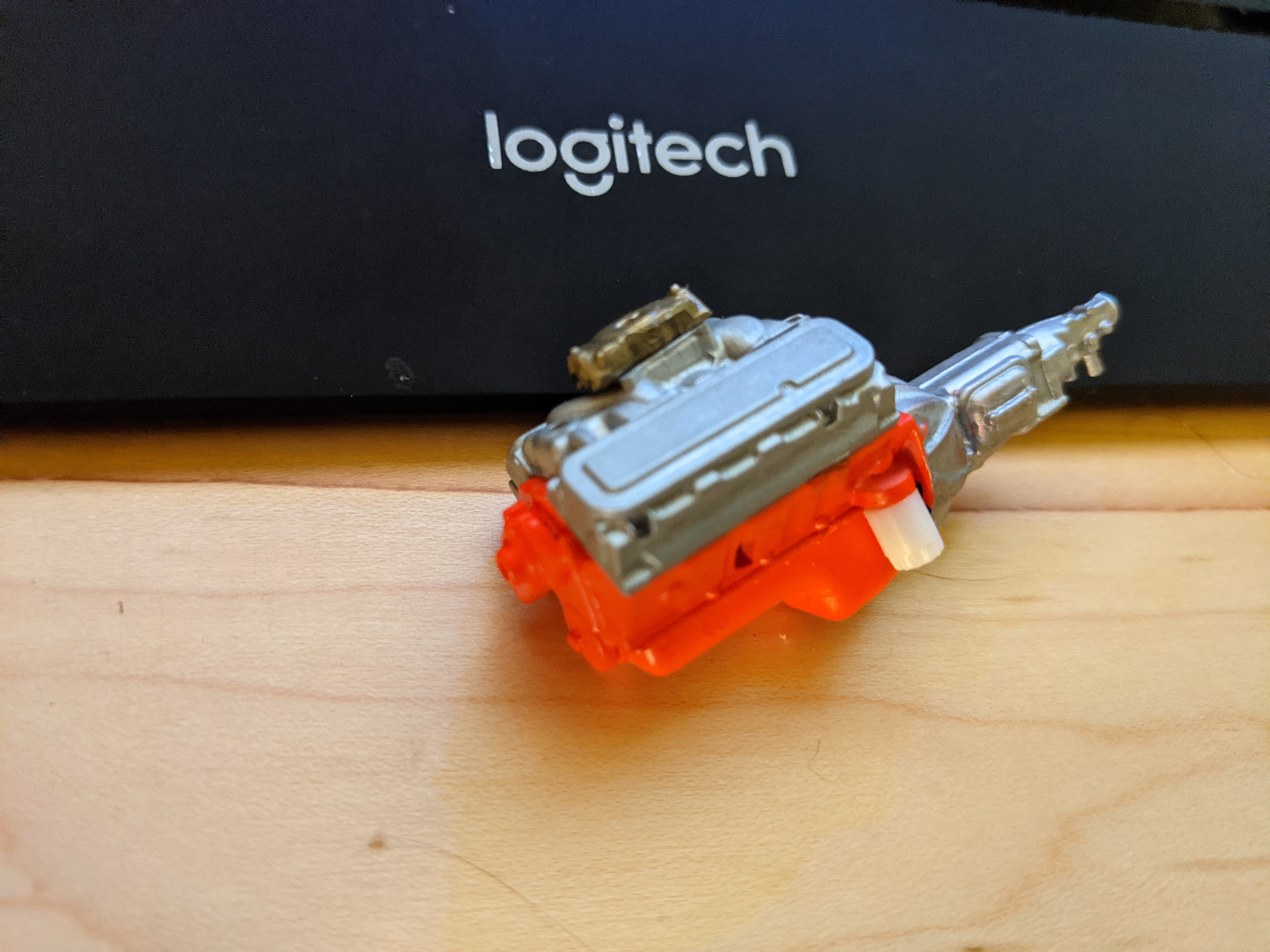

Rodent Posted May 16, 2021 Posted May 16, 2021 Yes, in the case of my '69 I wanted to replicate an L78/L89, so I assembled the block, pan, and front cover and used 1:1 engine paint over Tamiya pink primer. The heads, intake, and transmission were later painted aluminum. I actually used three types of aluminum paint, but it all kind of wound up the same color. The carburetor is a mixture to try to replicate a Holley. Exhaust manifolds are painted steel, but aren't installed yet. I need to drill the heads for plug wires.

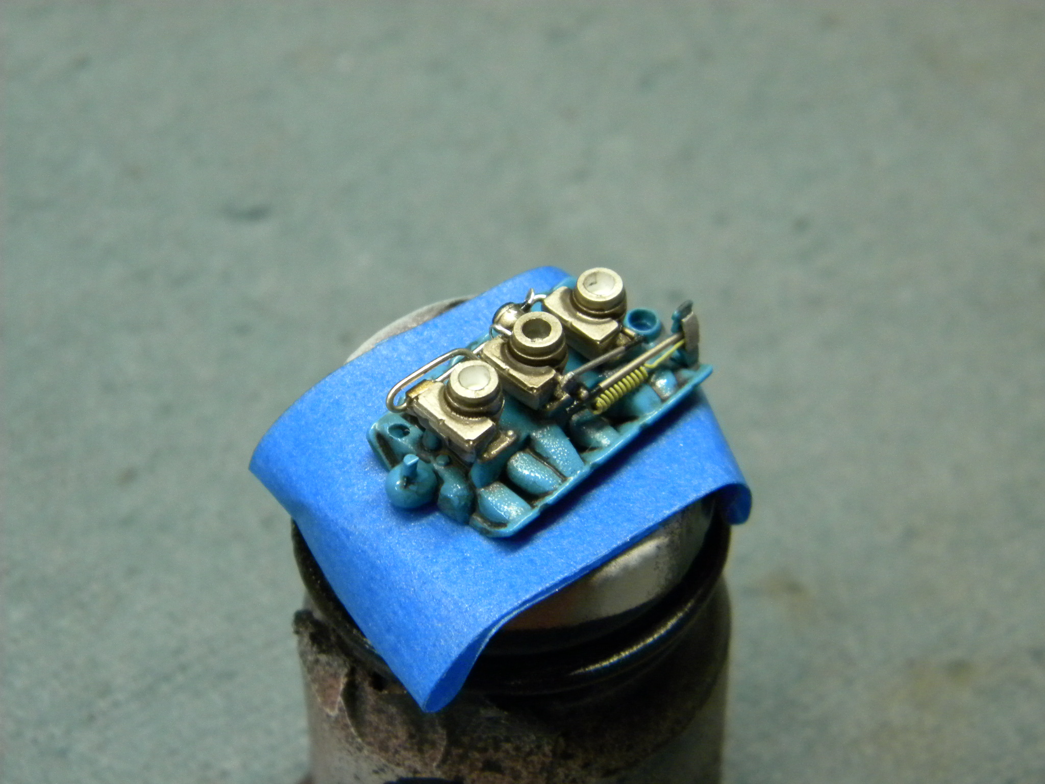

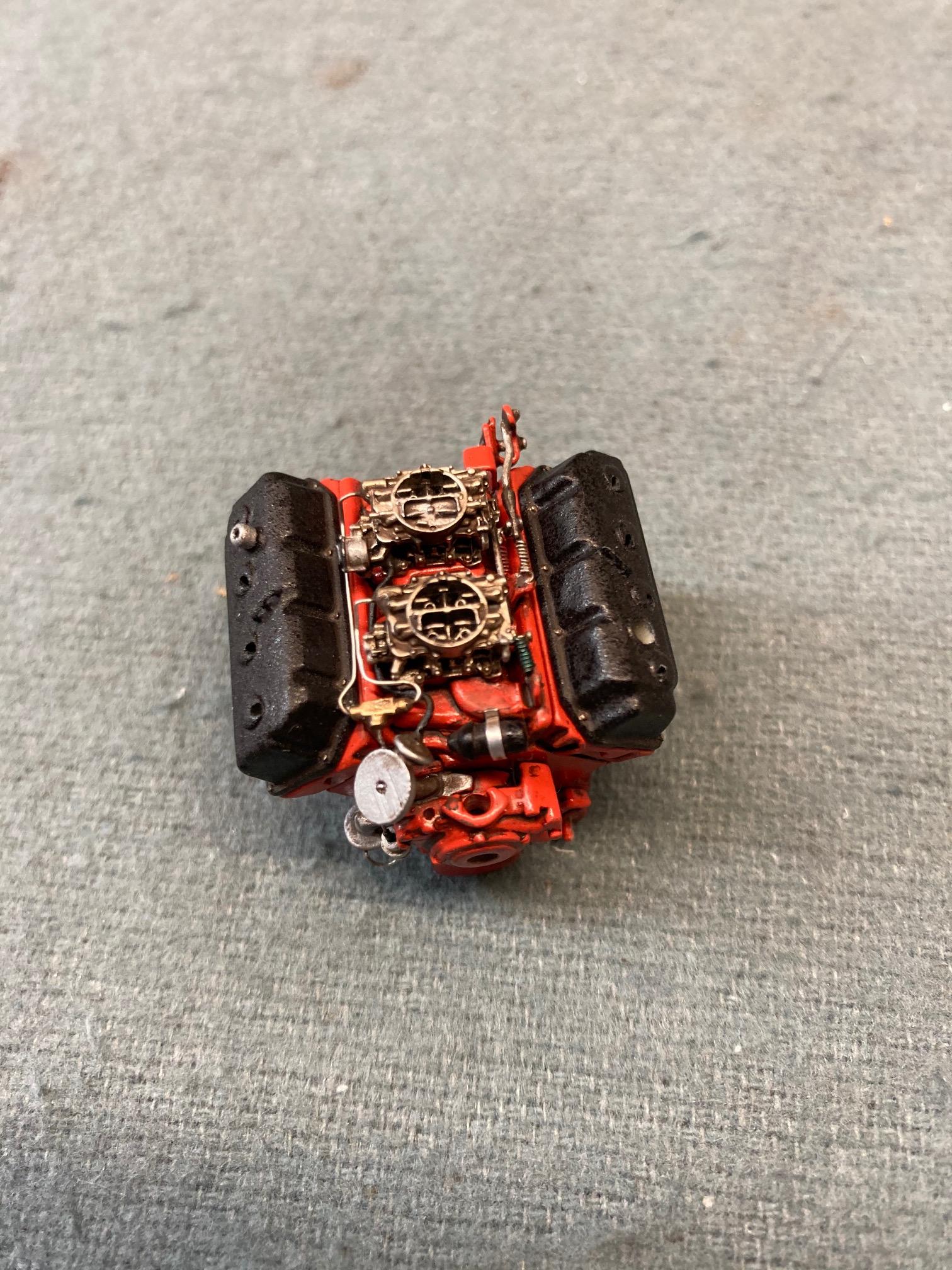

StevenGuthmiller Posted May 17, 2021 Posted May 17, 2021 I agree to an extent with the "paint as an assembly" theory, but probably much less so than others might. I almost always assemble the engine block halves and heads before I paint, but in most cases, I leave off the pan, valve covers and intake manifold to be assembled after. Part of the reason for this is that many times I look at individual assemblies as a separate model as I progress and it's much easier to do all of the intricate carb linkage and fuel line detail for example, if the intake manifold is not attached to the block. Sometimes certain parts can just be in the way as you work. As an example, the oil pan in most instances, just makes assembly of the other details more difficult, because I can't set the engine down on a flat surface and keep it vertical while I work. Therefore, for me the oil pan gets installed relatively late in the process. Sometimes you have to look at the big picture and the logistics of how the build will commence to strike the right sequence. Steve
Zippi Posted May 17, 2021 Posted May 17, 2021 Nicely put Steven. Is that solder for your linkage and if so what size?

StevenGuthmiller Posted May 18, 2021 Posted May 18, 2021 On 5/17/2021 at 5:41 AM, Zippi said: Nicely put Steven. Is that solder for your linkage and if so what size? The majority of the linkage in this case is constructed from stretched sprue. Steve
