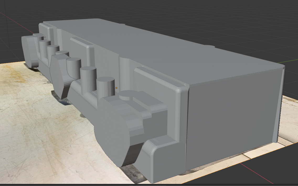

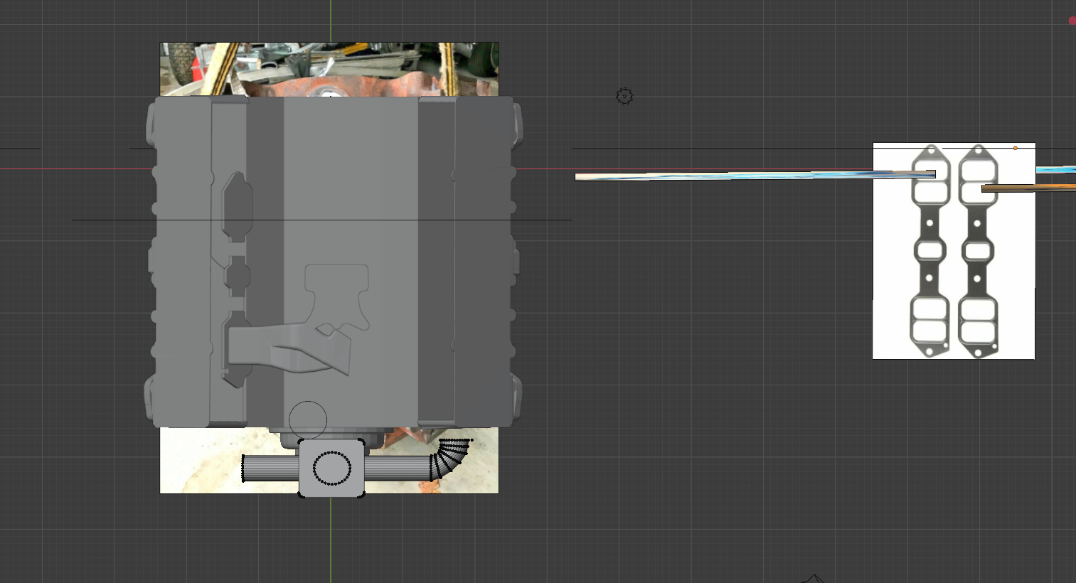

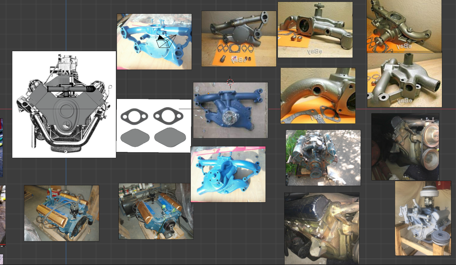

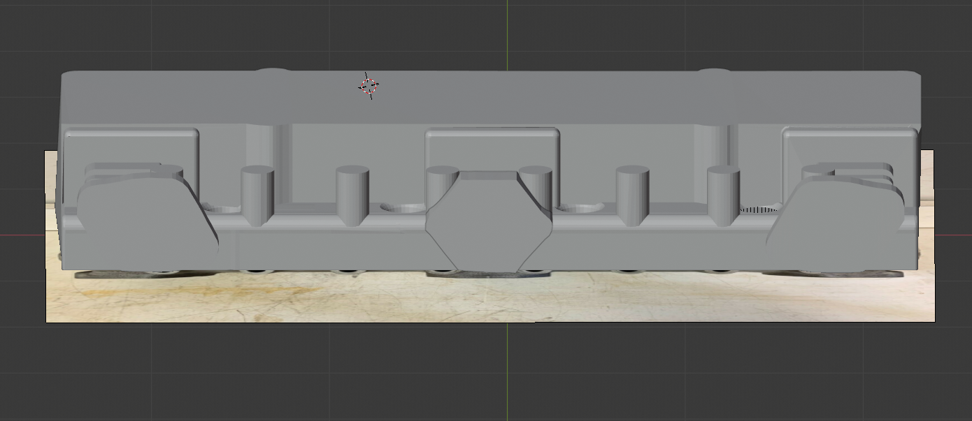

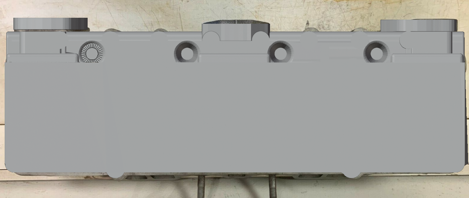

So here's what I worked on today. I have a free file of a 53 Cadillac Eldorado convertible that is one of the best files I have ever found. There is a body and a beautifully detailed interior, but no engine. There for, I'm creating a 1953 Cadillac 331 engine. I'm currently working on the heads.
Selection_266.png.6be3767ea7fe4a2ecc1c8ebca107b8bc.pngSelection_267.png.a83d303fe885e3e3820bd3ca1859e63f.pngSelection_268.png.7f450645d832177ac78249beeecb0f4b.pngSelection_269.png.6546bc46d87f12d5d5c743c59c287b0e.png

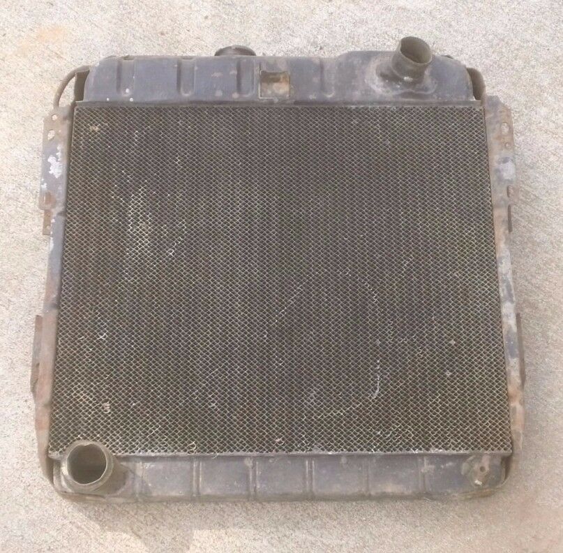

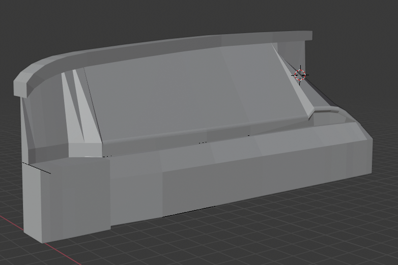

So now I have a basic horse collar. Now I need a radiator. I need the real thing and not a replacement part.
417240109_195555PlymouthPlazaSavoyBelvedereRADIATORCORE.jpg.770467245b5798a5cab2f81d11c35c90.jpgradiator.thumb.jpg.f48386e532879ce26c10cdf57d750c71.jpgrediator.png.70eb99af98a278c9153373c6b2ed2fff.pngrediator1.png.1ab0dbbedb7017e7a2865733eea8ea89.png

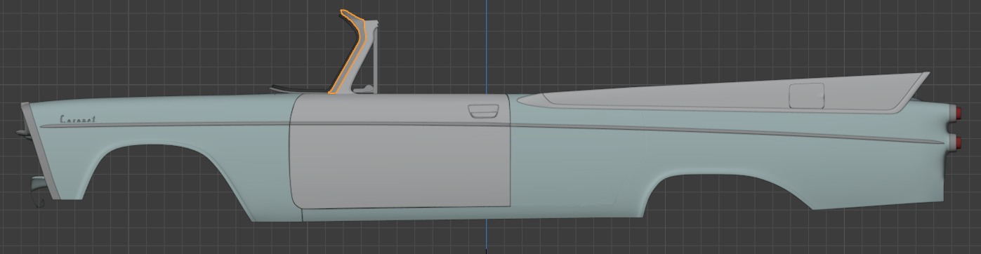

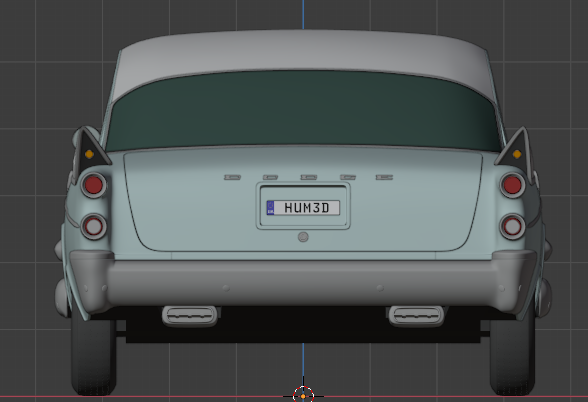

Now that I've shown how I reworked the body on the 55 Dodge, have a look at another Hum3d file of the 57 Dodge 4 dr.
Selection_270.png.bf6a59ee0fddd8bf5146405d8858ccee.pngSelection_271.png.178209cf5f66c07f8b9da9cf4303ae10.pngSelection_272.png.5f7761545b50df77f8e2cfda3b27b1cf.pngSelection_273.png.9af19da3ca3e8c7bb9f432956a042367.png
This is what I want to create. A Custom Royal Lancer D500 convertible.
Of coarse the top and back door had to go.

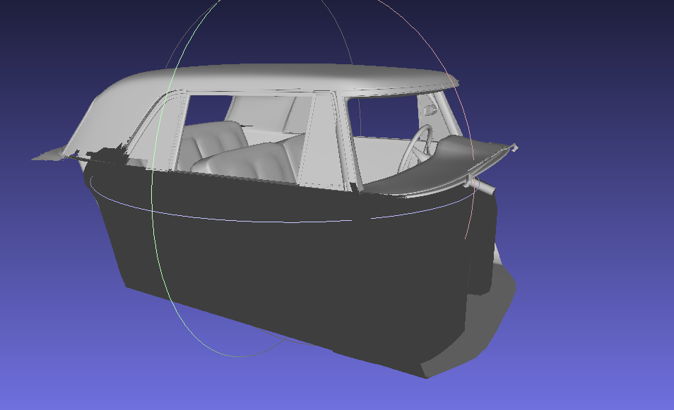

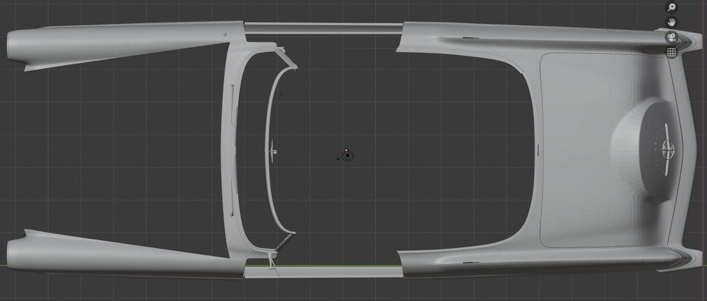

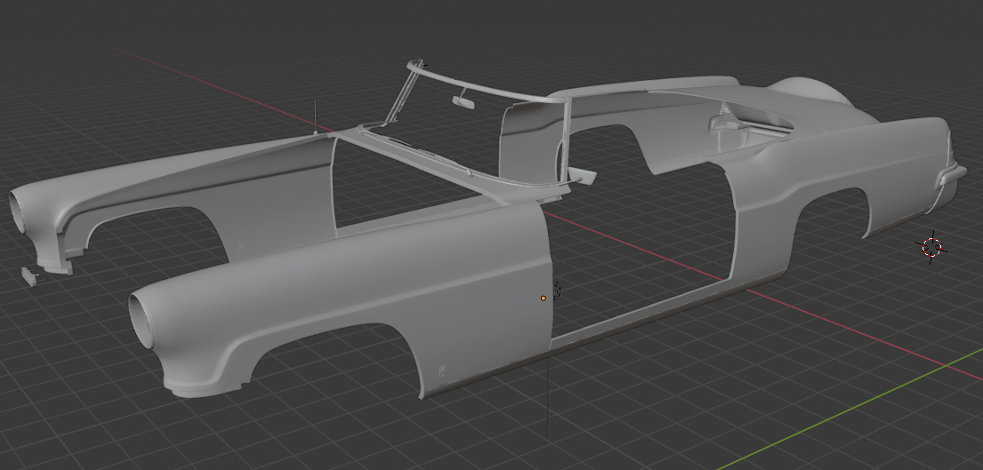

As you may have figured out by now, I switch between projects to keep from going stale on any one. There is one more file I needed to complete my wants. The 4th of July I found it for the price I love most. Free. A Hum3d  1956 Lincoln Continental Mark II. I've been busy doing other thing to other projects. Add to that, a member of this forum requested one of my Chrysler A block 318 engines with trans and I had to print one out to send to him. Back to the Lincoln. When you buy direct from Hum3d, the file separates into the individual parts. Not the case with this one. I've had to separate them. Here's the complete file.
the front bumper
the hood and grill
the interior
the tire and wheel, hubcap
and finally. the body for print. Notice it's a convertible. That's because: a- I like convertibles and b-  they print easier, better.
Selection_282.png.c2260273ea645f618d88a54c6700796f.pngSelection_283.png.8f1e5f17352b4d3f4e6bf4fd54451a3e.pngSelection_284.png.ccd3ef684a223d7aa6f6772a1c165baf.pngSelection_285.png.57e085553704ed57e04e15aac9e3b972.png
Yes, there is a file for the doors.

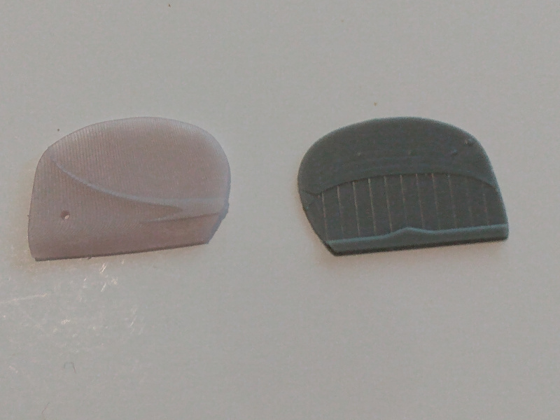

The inner and outer door panels are separate as this type of resin doesn't scribe well.

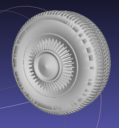

Have you done weighted tires? I have a few vintage WW tire designs that I did a while back, but wasn't all that successful at adding the sidewall bulge.

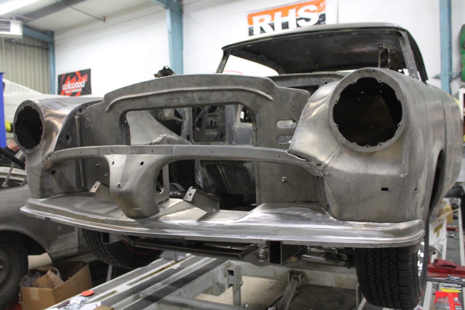

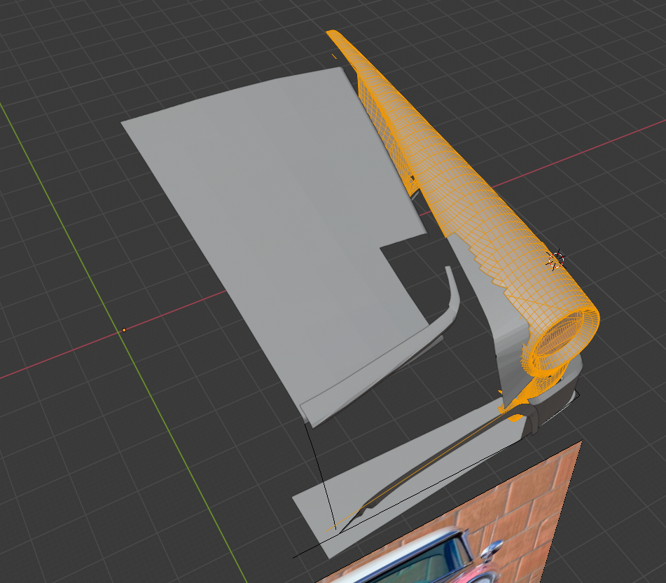

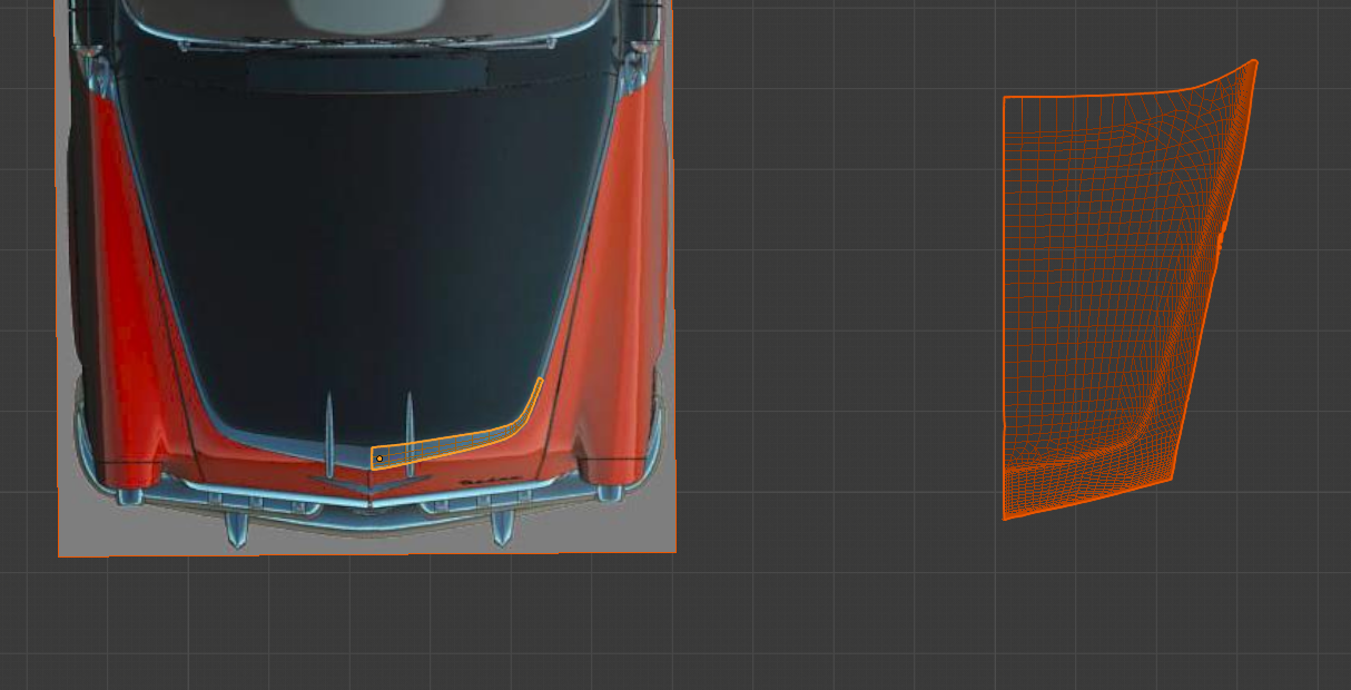

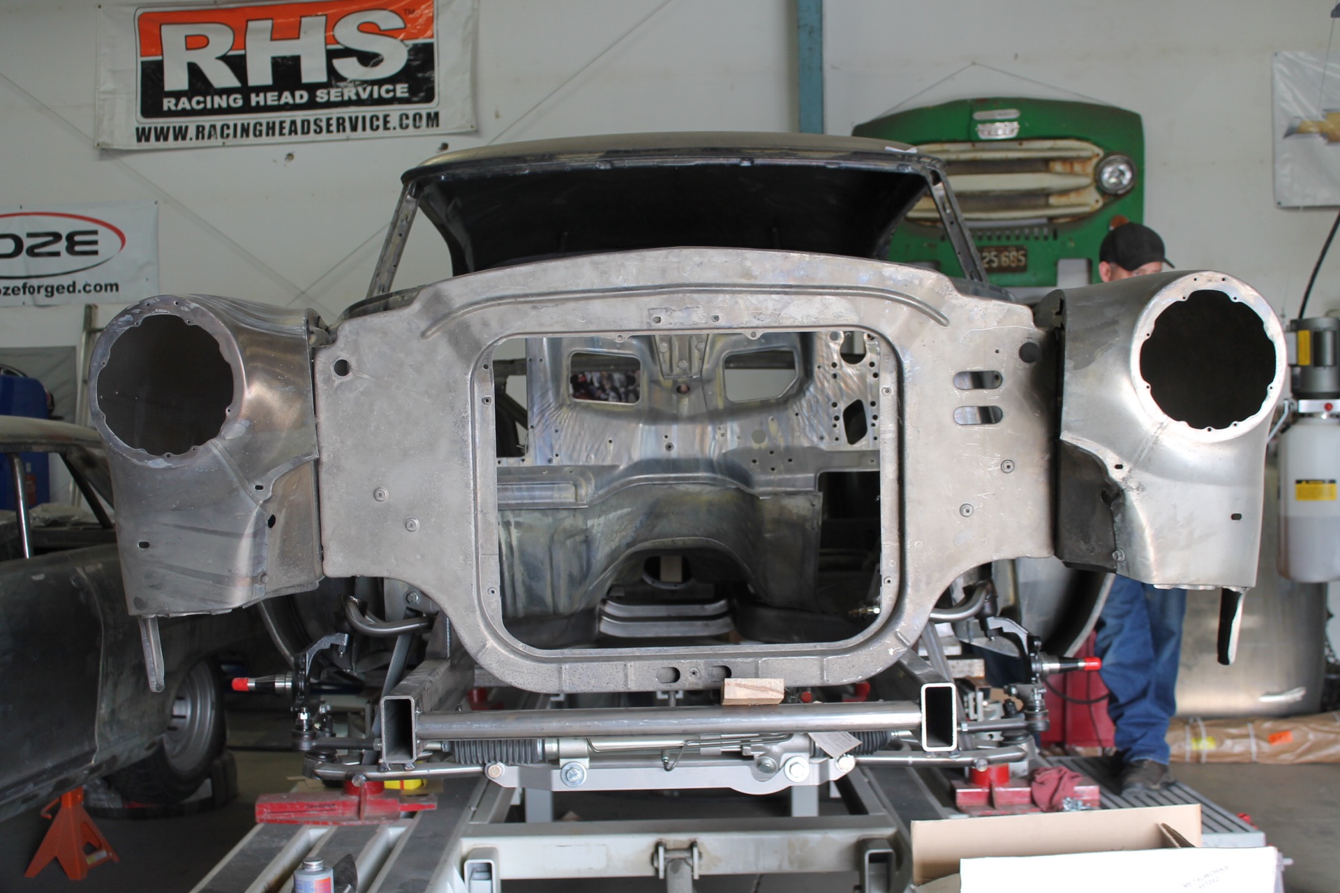

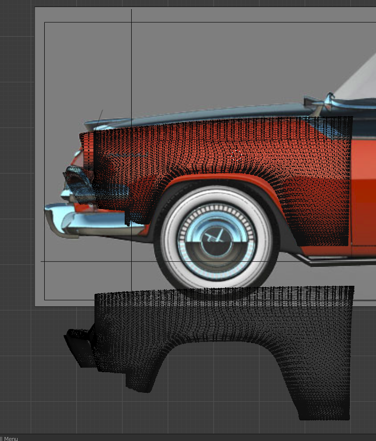

It's been awhile since my last post. The inaccuracies of this Hum 3D file are unbelievable. I had started a 56 Dodge cad file and figured I could save time purchasing a Hum 3D file of a 55 Coronet 4 dr. Wrong decision. I would have been better off finishing the 56 file. I can"t find anything, if anything, right about this file. Currently, I've been working on the front fender And
front end. I have corrected the slant of the fender top. I have corrected the wheel well opening. I have corrected the slant of the hood on the. I have started a correct hood on the fender. I have started the correction of the front fender and grill opening. The only way to fix these errors is by creating patch panels. What you see highlighted is the original file pf the front fender plus corrections  I have noted above.
Selection_386.png.a48c67c81c0d3d4fcf764e99a0cf01c4.pngSelection_387.png.68a790b46b1388d0e7537b380c13778d.pngSelection_388.png.e8ee4aa51eb74bb89267fd3def0afe8e.png
Here is what the front end looks like.
1956-dodge-coronet-bare-metal-front-sheet-metal-and-wheel-mock-up-7.jpg.d63b403016dde5300bea0f3100542694.jpg1956-dodge-coronet-bare-metal-sheet-metal-mock-up-14.jpg.52f3f36d78fcb42ca28ba9d7744769b2.jpg1956-dodge-coronet-bare-metal-sheet-metal-mock-up-24.jpg.1c998a4903de5d56e9da7482a24a890f.jpg

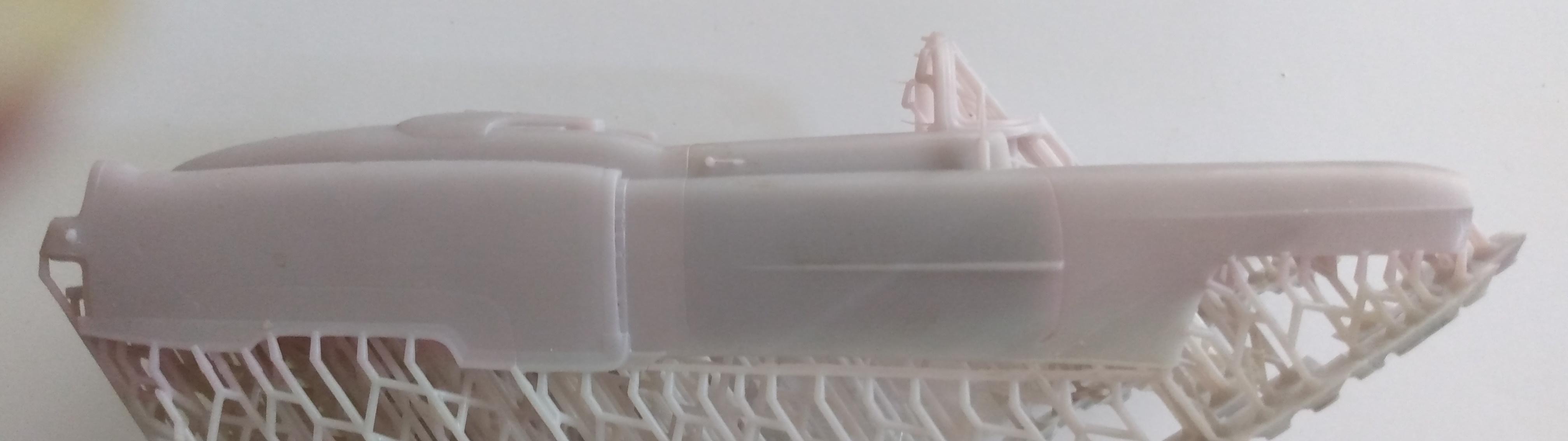

Here are some pic's of the file and test print.
420792317_53Caddyvert.png.e8ea4a5cf4c6b68683de63aca0902558.png93949317_53Caddyvert1.png.c14d195cd4d7dd94c891945a8b2d91b2.png
A test print.IMG_20210521_124315935.thumb.jpg.0a458c3bb8aee66c2a8de95a462a5a51.jpg

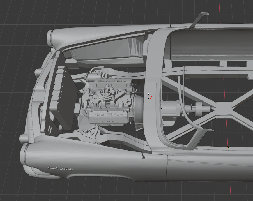

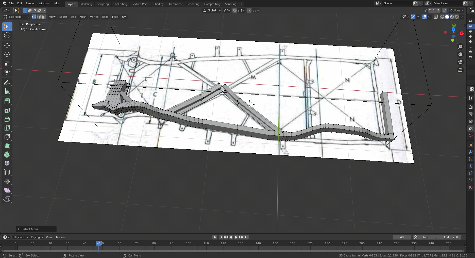

the frame is 85% complete.
The engine is in early process.
Selection_429.png.7ad72e09c999067a0d9ad7176dbe52c5.pngSelection_430.png.eb8dbb9fcb8f0347835d1e679bee0150.pngSelection_431.png.8105839d426f94011a8a75302dcb8784.pngSelection_432.png.f7665b2dd2e4961c2c68510413301144.png
