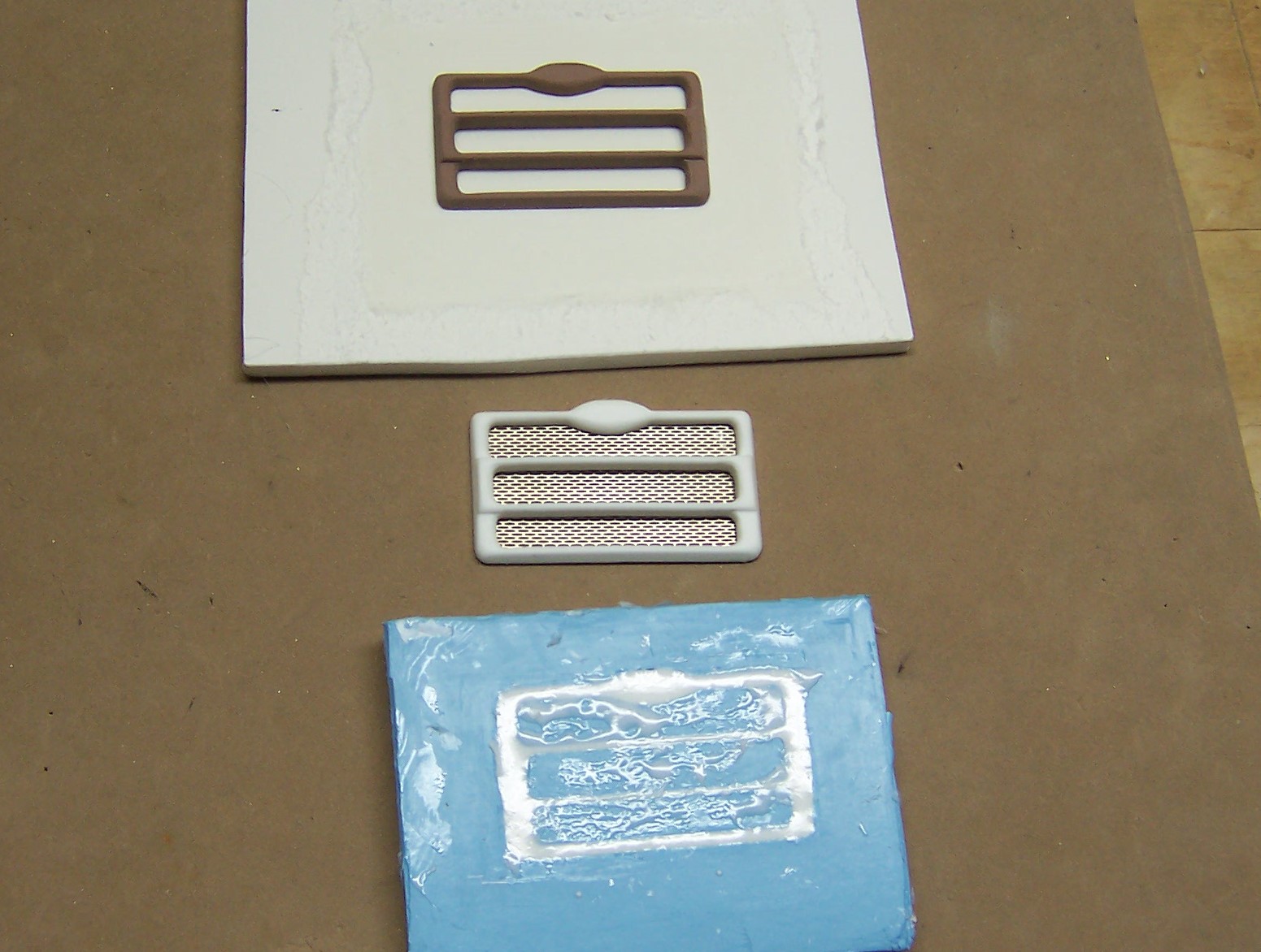

Chariots of Fire Posted August 26, 2021 Posted August 26, 2021 (edited) I'll start by showing a simple mold for a truck grill I needed for a piece of fire apparatus. I built a box out of foam board using a piece for the bottom as well. I use a hot glue gun to put the pieces together. In the photo the master for the grill has been made and is glued to the base. In the foreground are the two parts of the M-M RTV. Some people use a third cup and pour the contents of each cup you see into it. I just pour all of the blue part into the white part and mix it well. In the photo below the mixture has been poured into the mold and will be set aside to cure. It is a good idea to spray the mold and the master with mold release agent before pouring. This insures that the cured mold will separate from the master and the box without tearing. The RTV should cover the master completely. Use a probe and move the RTV around in good shape as you are pouring, making sure that there is no trapped air that will leave a void. This is especially true if the master has any amount of undercut. Once the mold has cured you can tell that by touch. If by touching the mold surface it leaves a finger print, the mold is not fully cured and it will be tacky. Let it cure for 3-4 hours. After it is cured break away the sides of the mold box to reveal the mold. Carefully pull the mold away from the bottom of the box and master. You will end up with a mold like shown below on the right. In addition two castings have been made of the grill already. The upper one has a piece of photoetch mesh behind it to show how it will look. Note in the photo above the bottom casting. That flash is just a skim coat. When pouring the resin for casting in a mold such as this the mold needs to be filled completely, obviously and without any bubbles or voids but you don't have to over fill the mold. If you get too much resin in the mold screed some of it away and you will be left with only the smallest amount of flash to remove from the cured resin. Here is another mold being made to produce an engine block, oil plan and bell housing. The masters are made of plastic, Renshape and a bell housing from the parts box. The exact same procedure outlined above was used to produce the resin copies shown in the photo below. The masters are on the foam block with copies of each piece shown next to it and an assembled block and bell housing using a second set of resin castings to build up the engine. Below is the grill casting in the mold. In this one there is just a bit too much resin that when cured will have to be sanded away to make it flat on the back surface. Next up I'll go over the kinds of containers I use for casting the resin and will show a pour for a two part mold. Edited August 26, 2021 by Chariots of Fire add material 2
