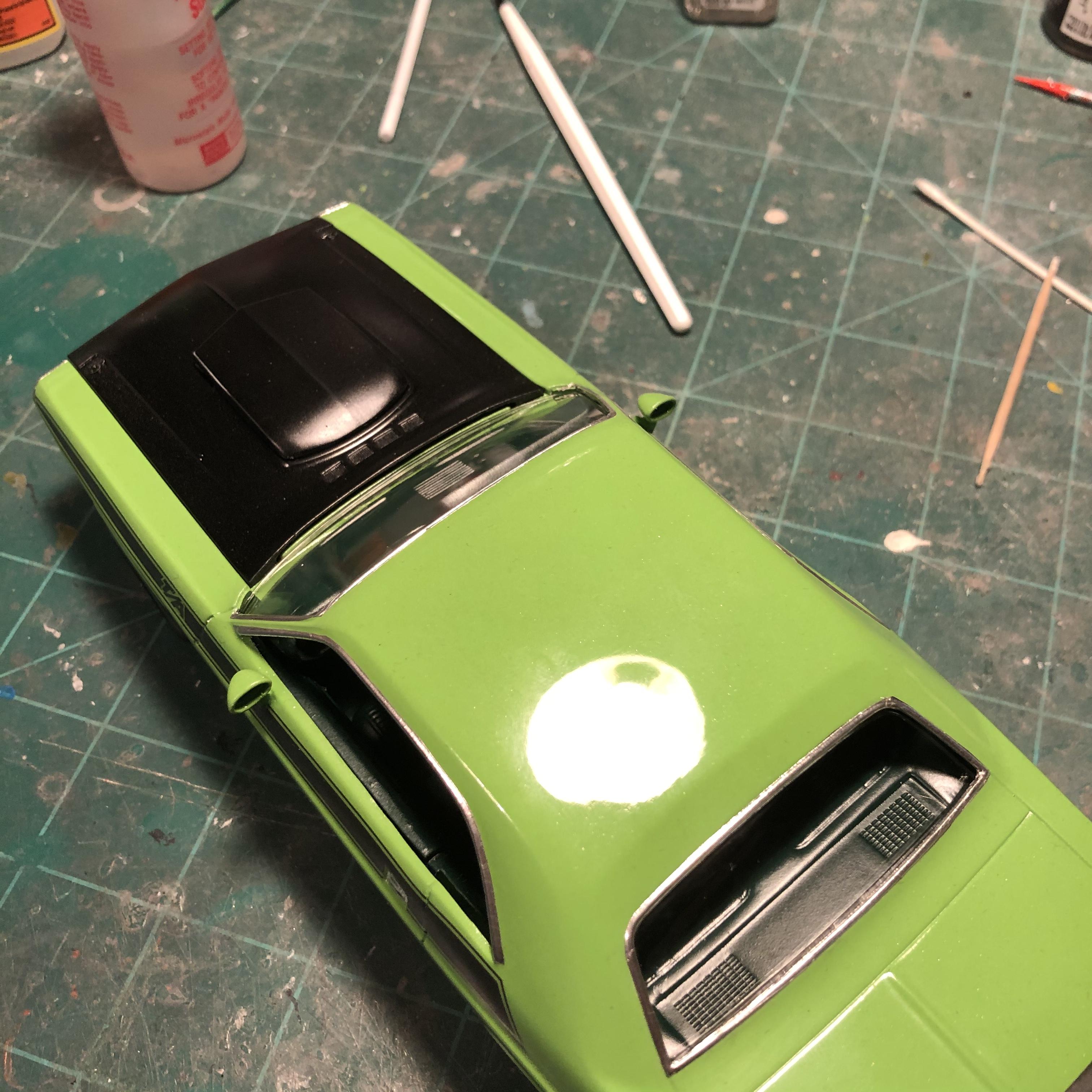

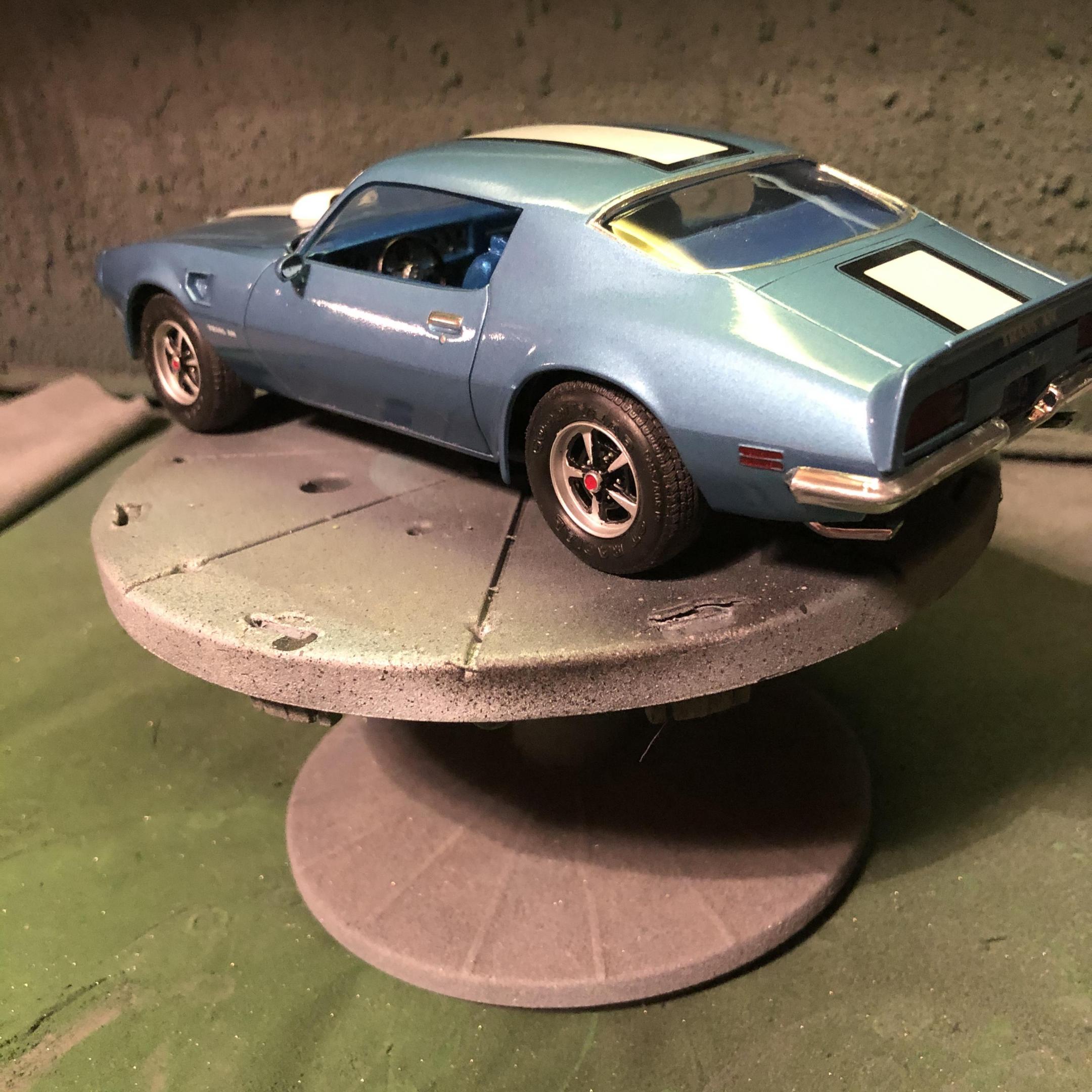

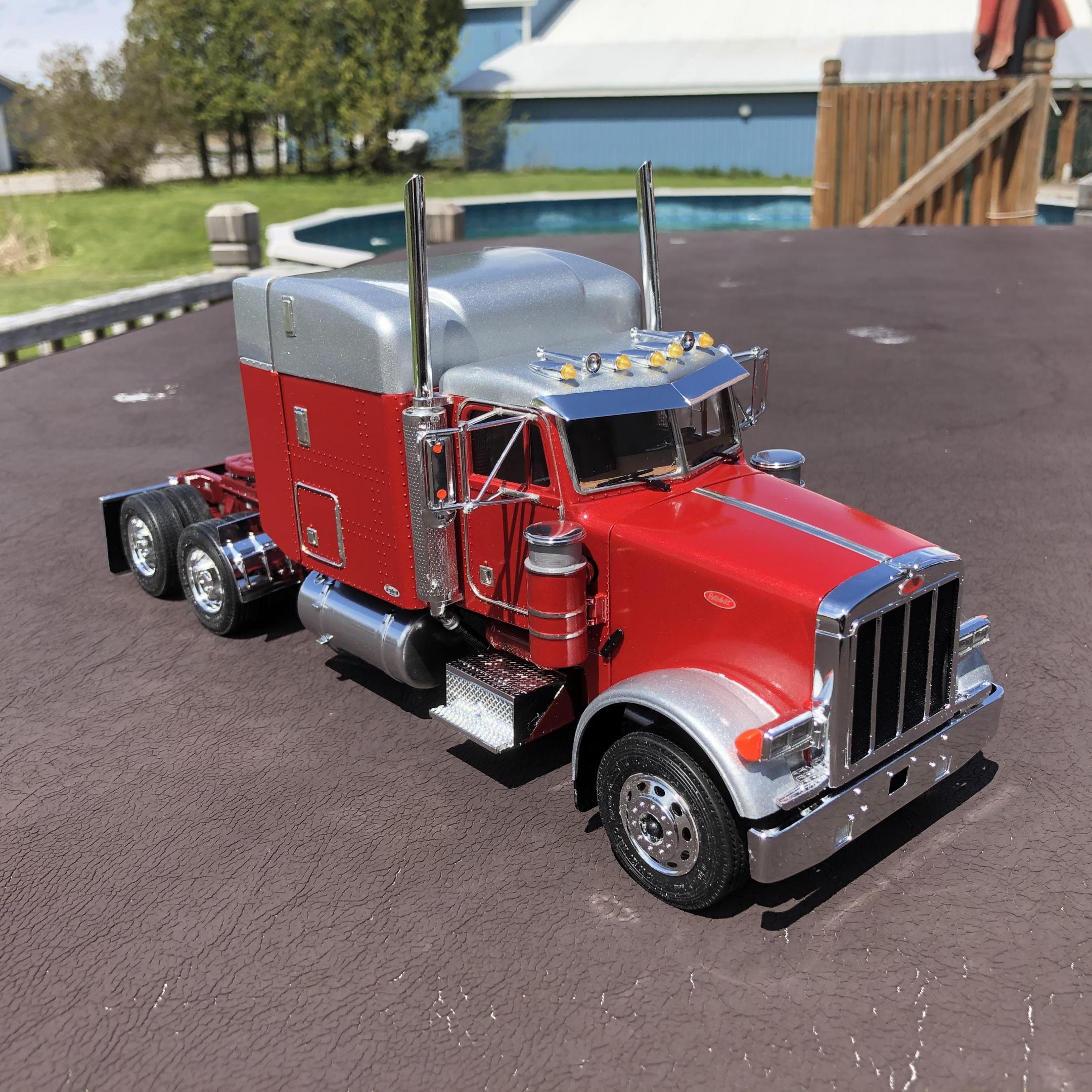

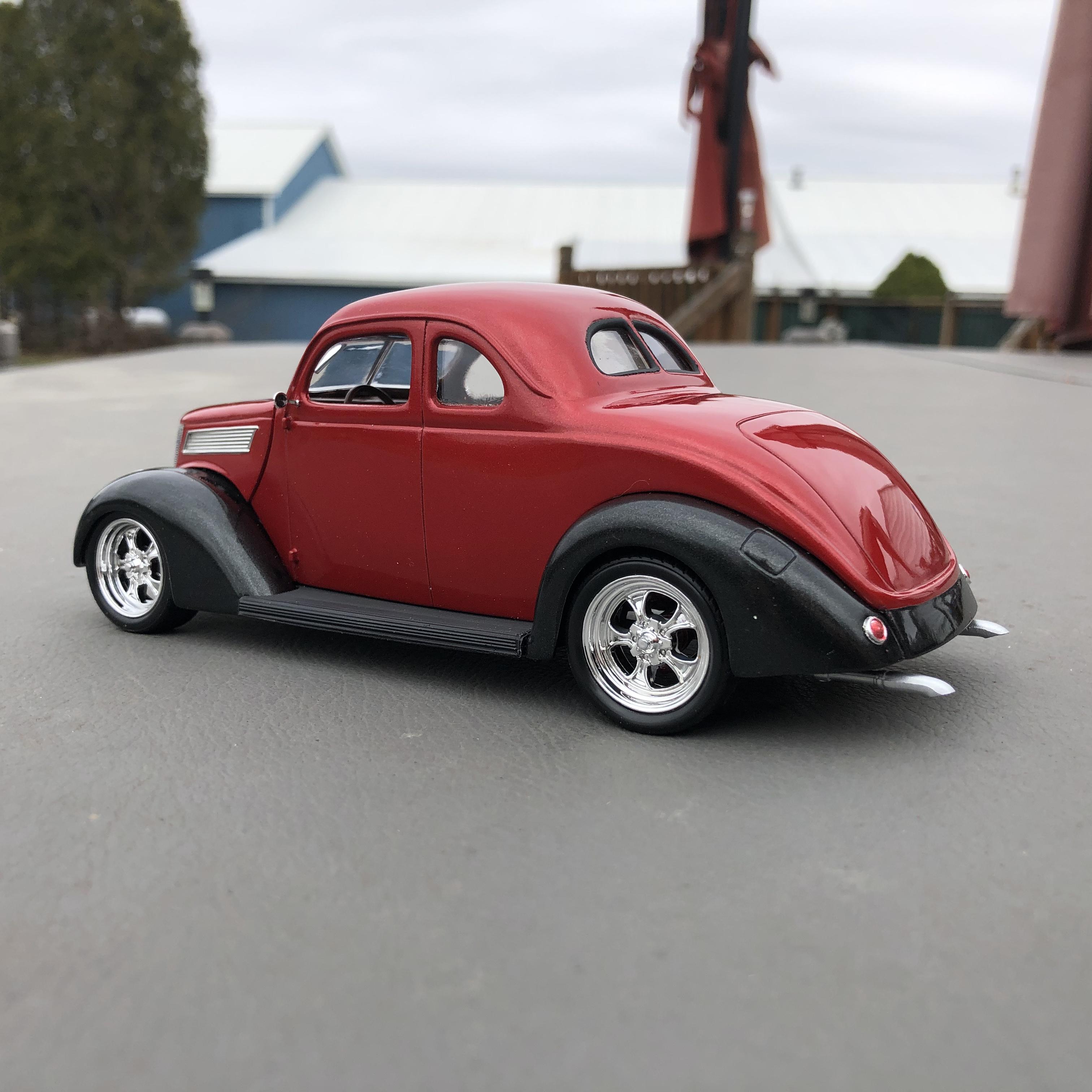

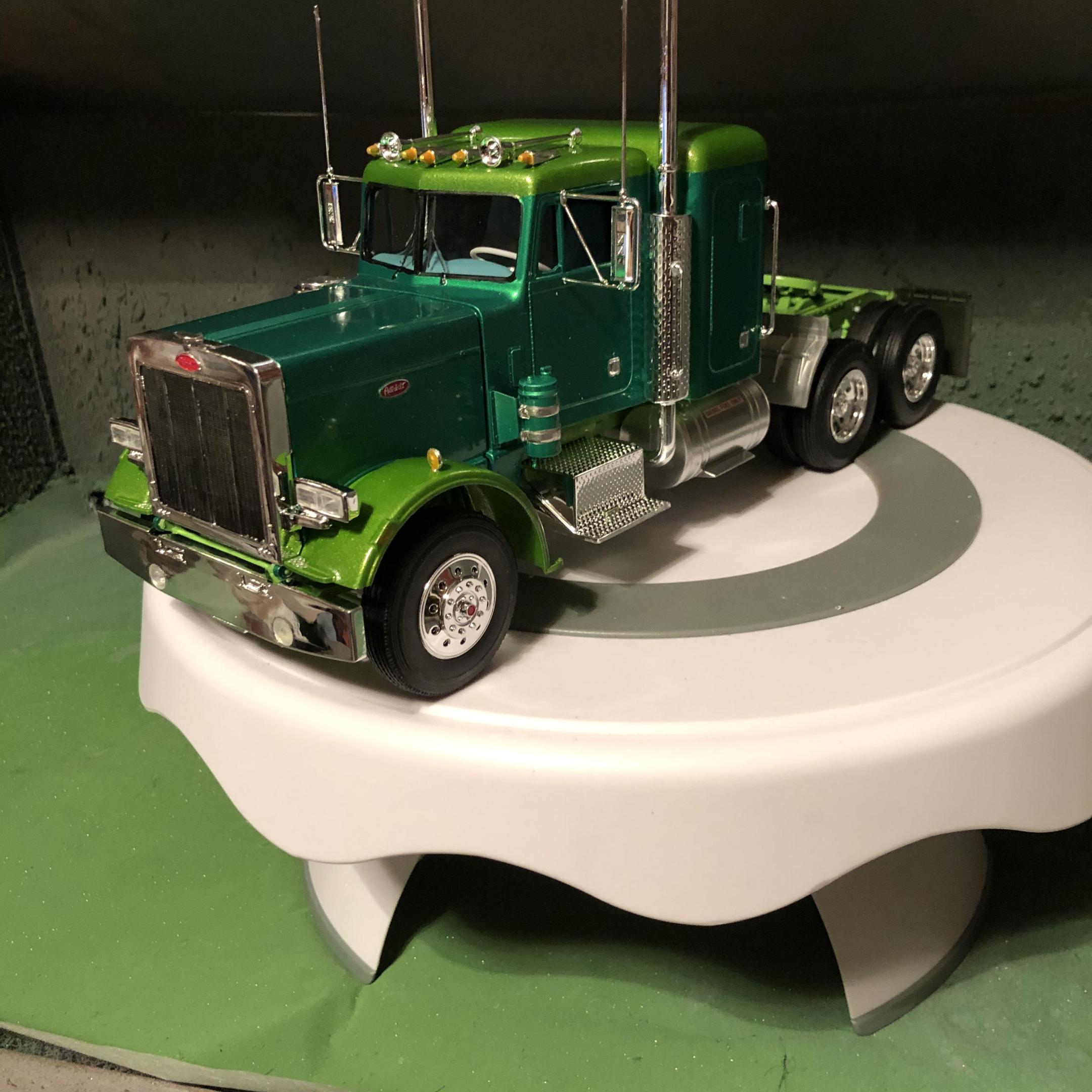

tbill Posted September 15, 2021 Posted September 15, 2021 (edited) Just for clarification, these were painted with testors model master lacquer spray cans, colors and clear coat, nice results are possible with these paints. Of note , the green snap pete was built in less than 24 hours during the Daytona 24 hour race. P.S. I only use rattle cans, took quite a few paint jobs to get them looking good, I have several models I’ve painted up to 3 times before I got it right, master the spray bomb first . Edited September 15, 2021 by tbill Added text
